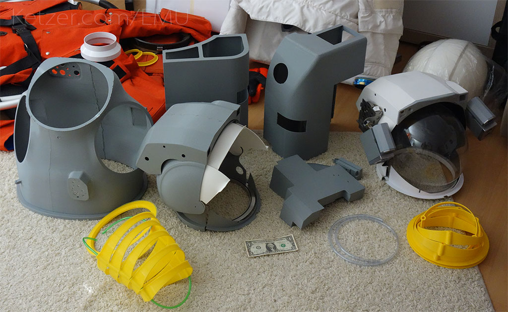

I recommend the Anycubic Chiron. It has a 40 x 40 x 45 cm print volume.
I have been using it to print the large parts for my EMU suit.

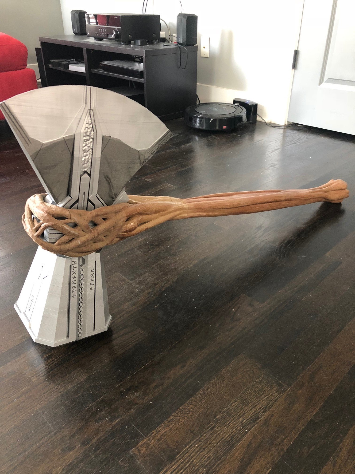

Another recommendation for the CR-10. I'd "practiced" on an Ender 3, so I'd really gone through the learning curve with that printer so by the time I was getting the CR-10, it really was just plug, level the bed, and print for me. It's a great printer, with a good sized bed that should do well for most pieces of the armor you want to build. I used it to print a Stormbreaker last year that turned out great. You can see some of the print lines in the hammer head and blade, but that's mainly b/c I didn't have time to sand it.
