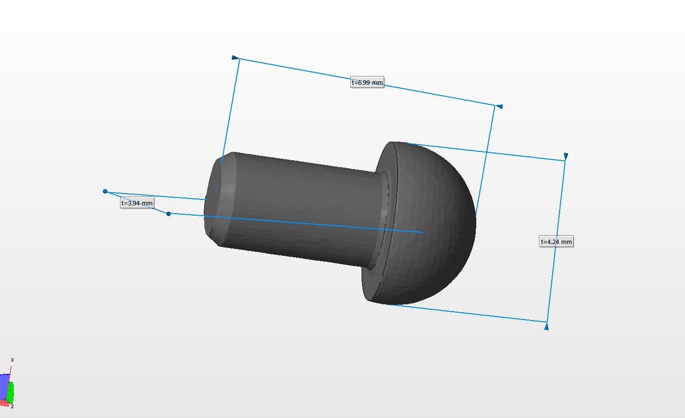

I just had a quick look and it seems as though the main issue is that the small parts may get lost during the polishing process. I'll copy and paste the reason from Shapeways below as it's quite interesting to read about the process. I'll also add a picture of the part that they are referring to. I think the easiest ways around this will be to either choose a material that doesn't require the same polishing procedure or I could just lengthen the post on the 'shoulder' part so that it's combined dimension is above 25mm, which would mean adding 10mm to it.
Shapeways - "
Model or Part Too SmallDescription This product has parts that are too small to be manufactured in this material. In order for us to print, clean, quality check, and ship your model, we must be able to handle all of the parts without losing them through various stages of manual and automatic processes. We therefore require that the smallest part of the product to have the sum of its dimensions be greater than 25mm. (X + Y + Z > 25mm). All materials specified as dyed or polished are manually cleaned and then submerged in a circular vibratory tumbler full of thousands of ceramic pellets for several hours. Each pellet is approximately 4.5mm wide and 11mm long, and will exert a slight pressure on all sides of your model during polishing. Any part that is smaller than the size of one pellet is typically lost or not polished consistently on all of its surfaces. We encourage you to iterate on your design to ensure a quality print. Please consider: 1. Enlarge or remove the unattached parts of your model that do not meet this requirement. Or 2. Order this model in a material with a smaller minimum size requirement.(Unpolished Strong and Flexible, Detailed Plastics, or Frosted Detail Plastic) ".
I'll still try adding slightly different variations to see how it affects the prices etc. but I may first concentrate on trying the original design with a modified/lengthened part.
Let me know what you think.

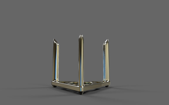

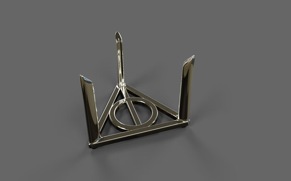

Made some progress with a display stand for the Snitch, kept it simple but managed to incorporate the Deathly Hallows symbol into the base.
Here's a link to the Shapeways page in case anyone is interested in seeing the models. I changed my name from Turbo Sausage to Form 3D on there but it's still me. If you have your own 3D printer and would like to have a go with the file for yourself please PM me with your details/intentions. Cheers
