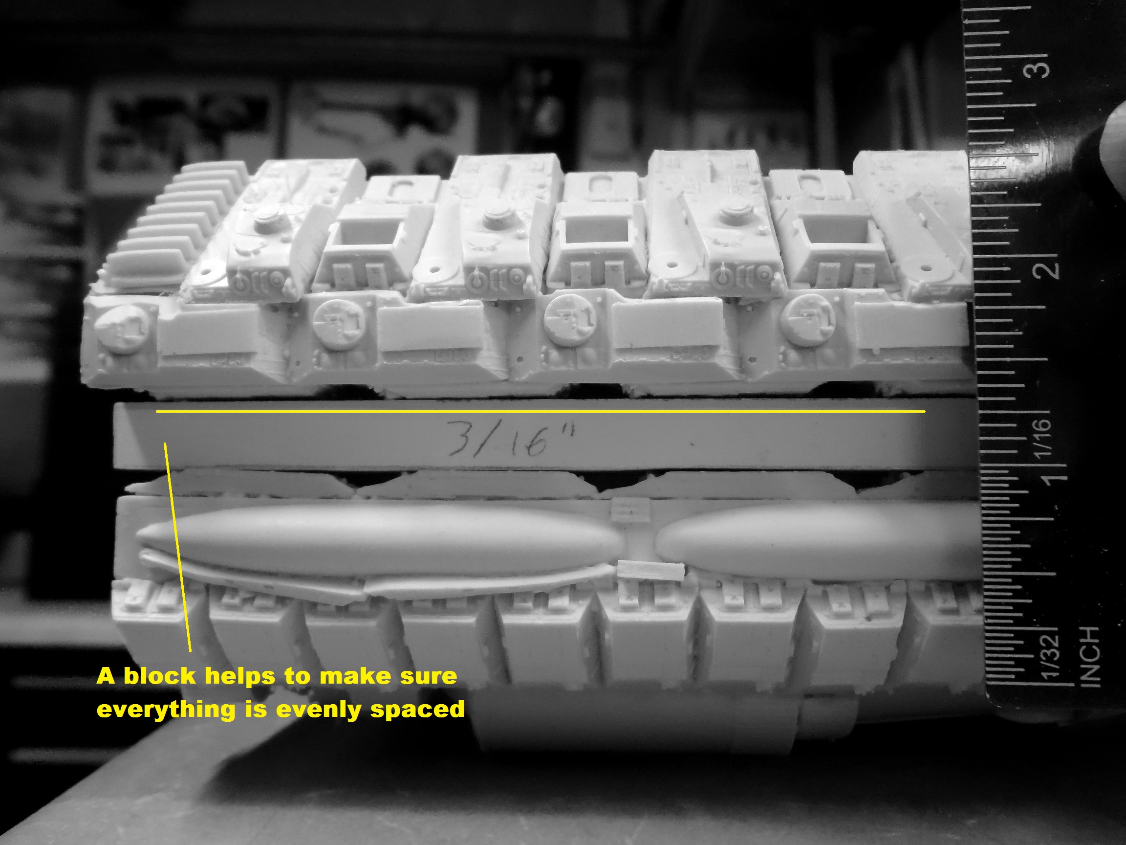

Just wondering if there's any more instructions like this for the greeblie placement.
Yes, Randy also posted this, thought I'd reposted it already, sorry. There's still a few pieces I'm in the dark about myself. I'll post the particulars later, gotta go get glueing. :)
Found another handy hint by Randy:

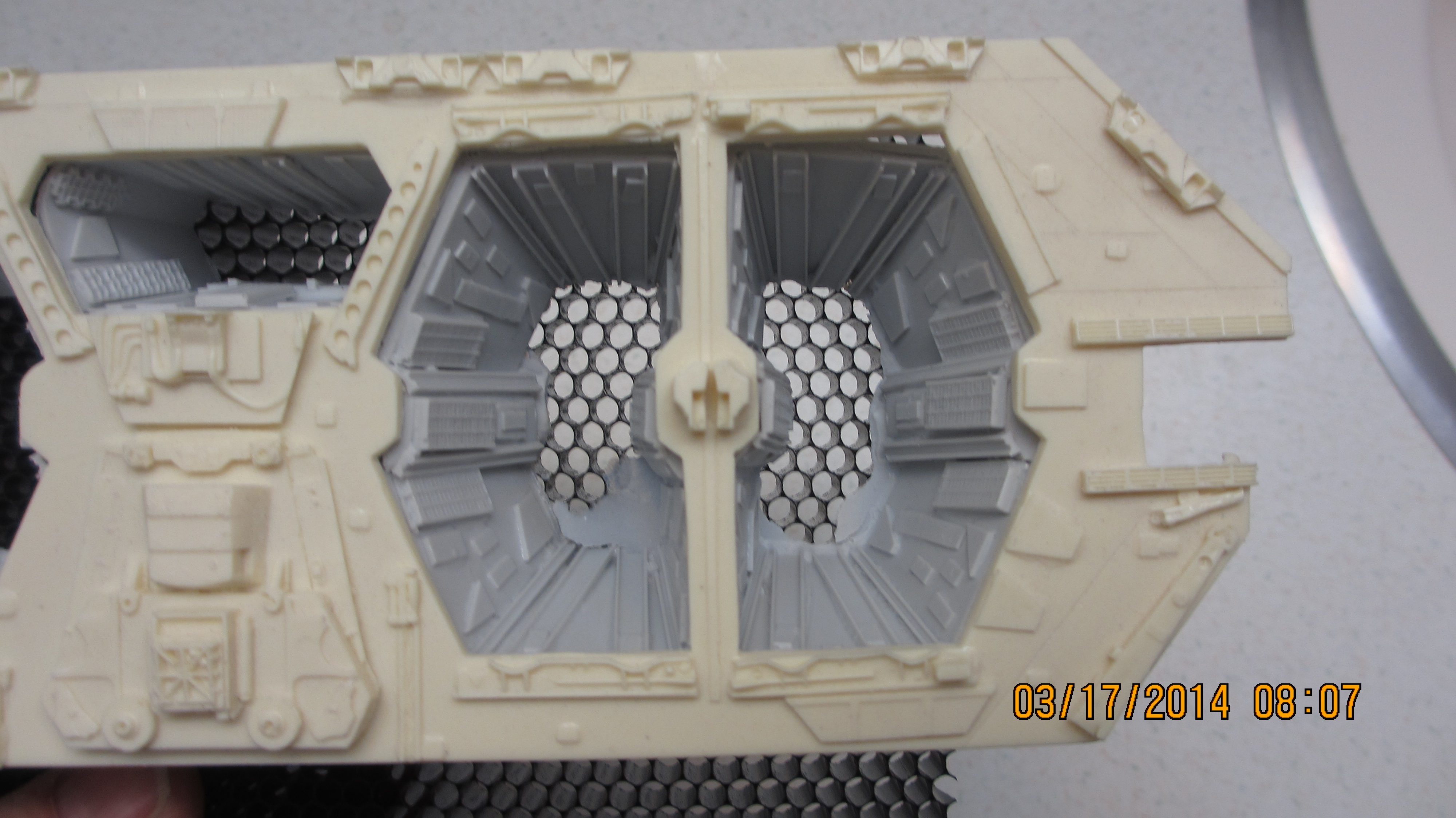

btw, I got the honey comb material I ordered a few days ago that was shown by belleauwood in post #237. the 1/8th " honeycomb is bang on as your going to get. I took a shot of the parts sitting on the honeycomb which I don't remember seeing done yet.
Ah so they were off the originals. I think print will do better on thin pieces like that. Yup, the arms on the Karl pieces are fragile, three of mine broke. They pop straight back on with no join visible.
