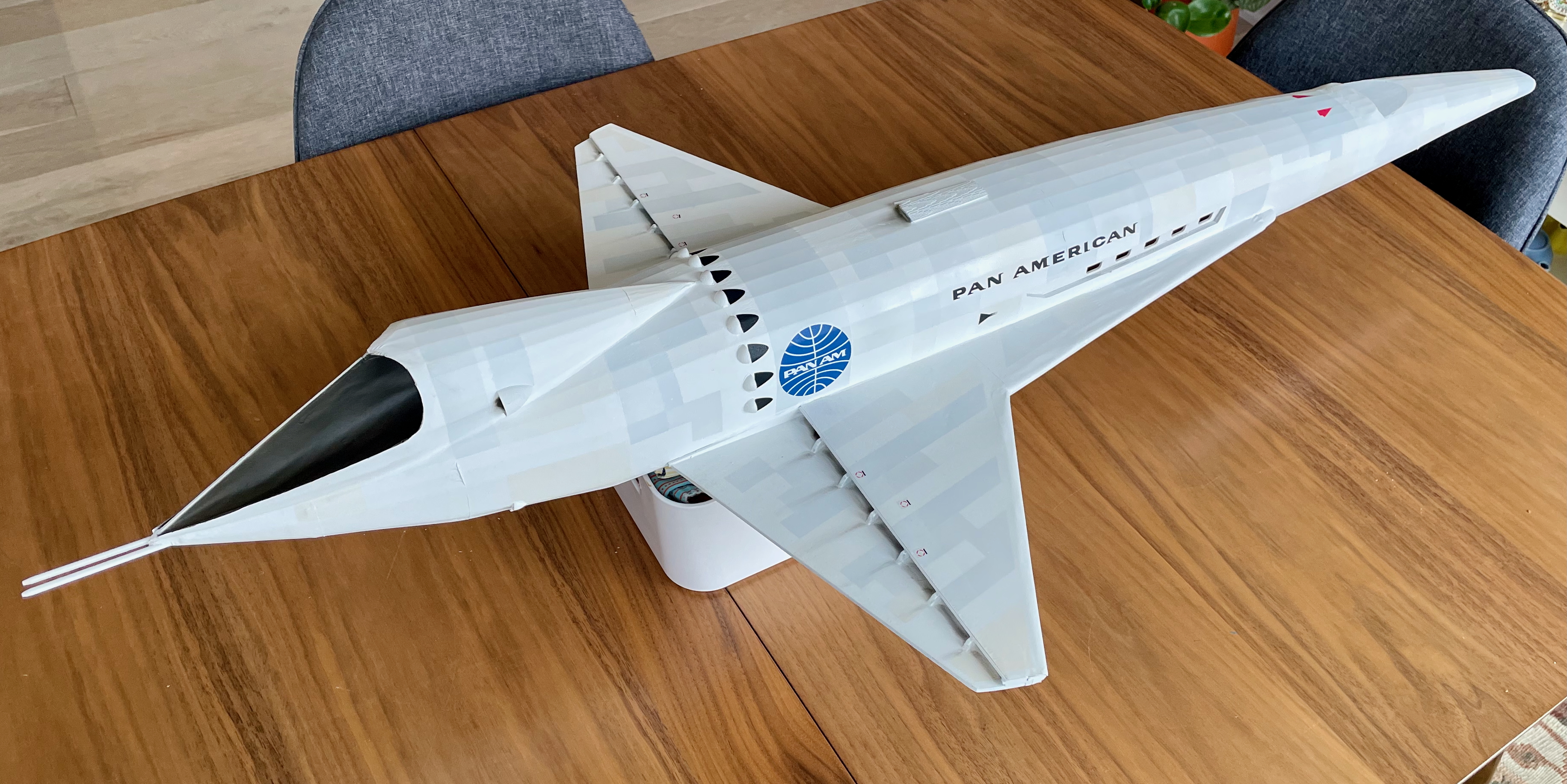

Starting to paint in the panels. I suck at it — but this is a great way to learn. Of course I can't scribe panel lines (in the ultra thin Monokote, ha ha) — but it will just have to be what it is.
Which it's probably worth conveying again — this wasn't an attempt at making a 100% studio-grade replica. (Studio-scale, yes!) Start from the other end: we're going to make a balsa "plane" — how close to "kit-model" can we get it while still staying more or less true to its balsa pedigree.
I've already cheated by adding a handful of 3D printed bits. But I console myself that they could also have been vacuum formed if I had the setup to do so.
Getting there...yep, the paneling is quite the work on that model. As for a vacu-formed project, depending on the size of your machine, you could always do it in sections;)(y)(y)
Thanks. Yeah, the vacuum forming would be minimal (not the whole model!). Little scoops and such.

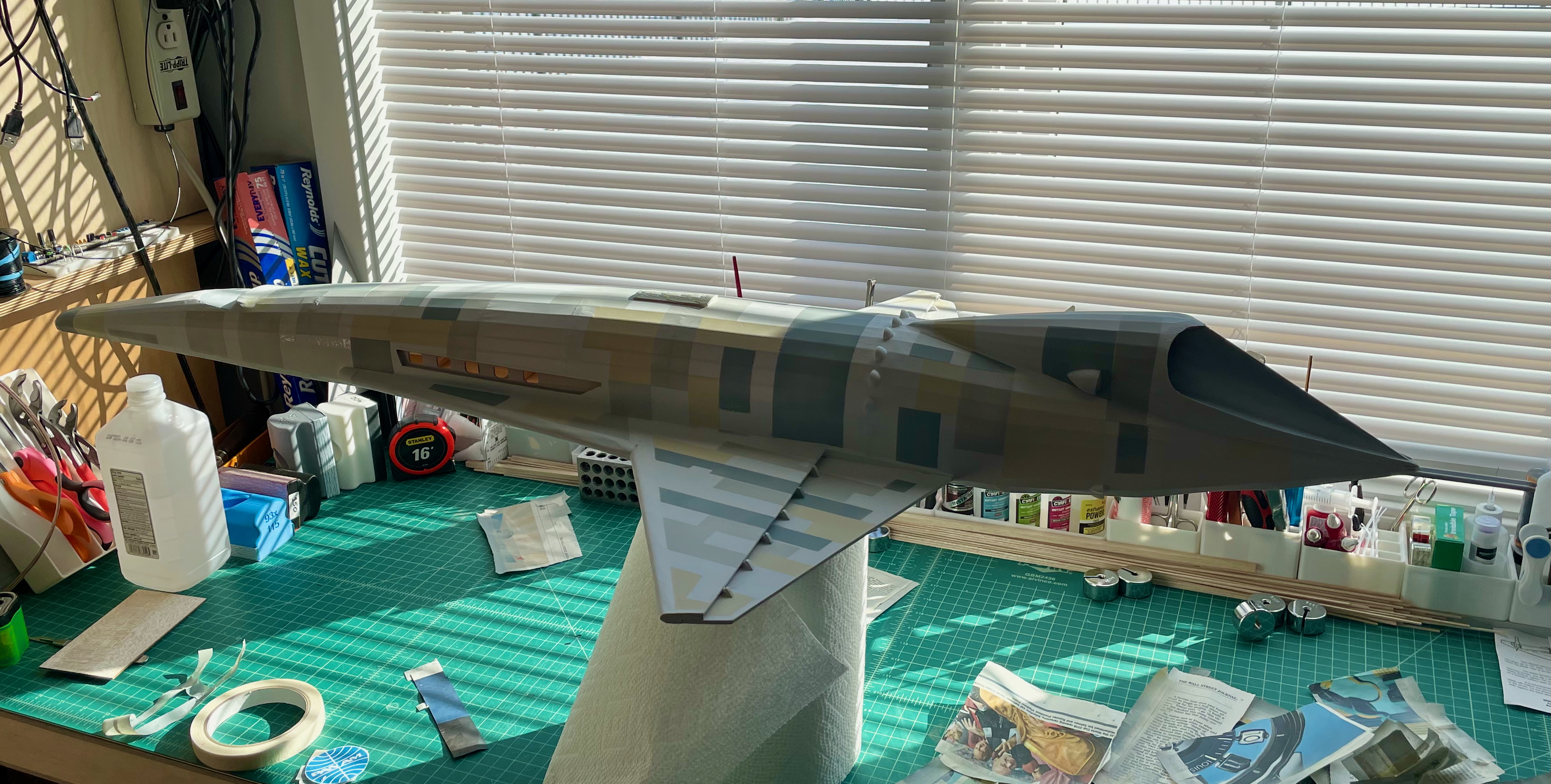

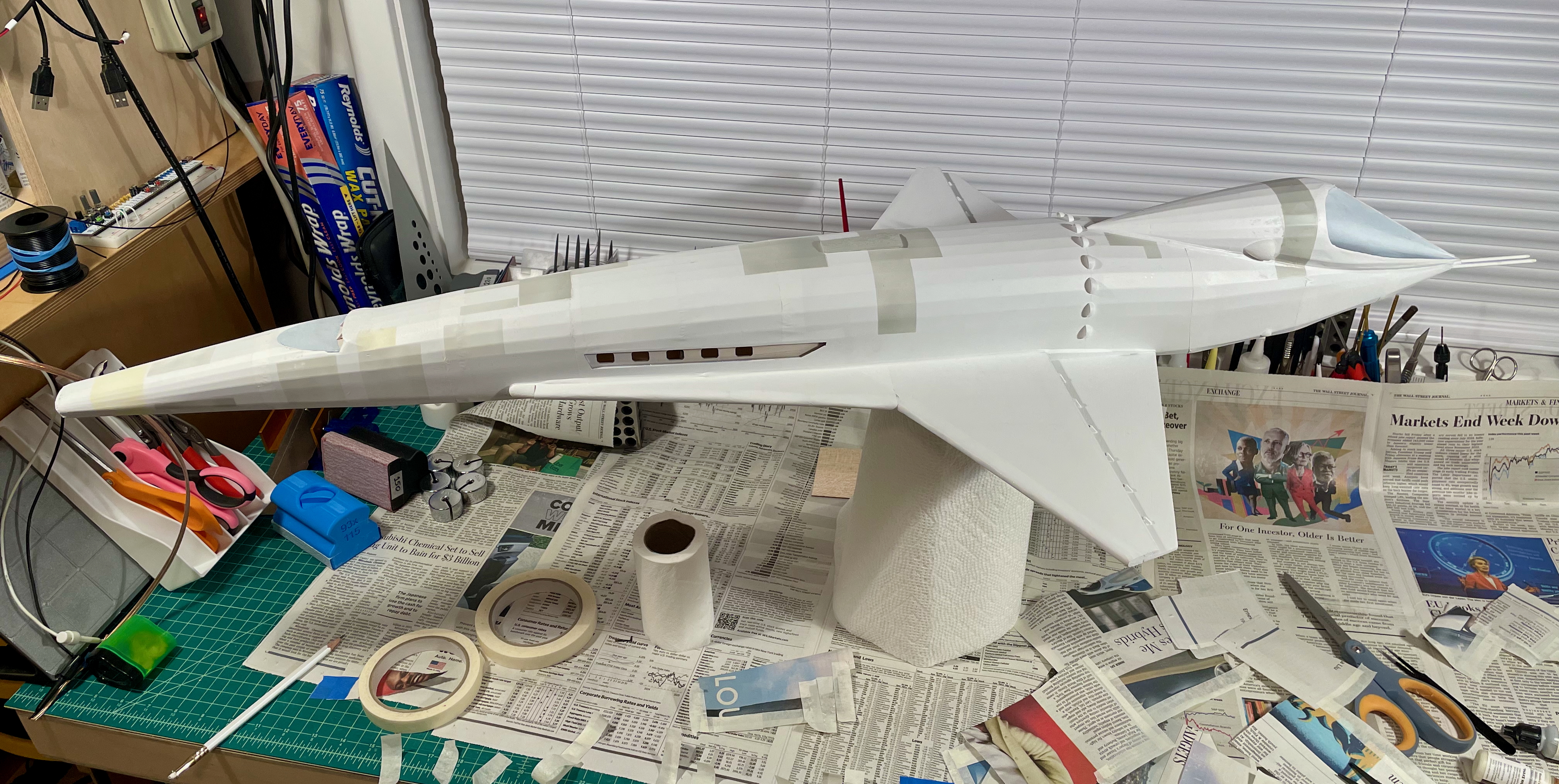

Panelling is wrapping up. I screwed some bits up so will spend a day fixing up. Then I can begin putting soft layers of white over the whole thing to take the panelling down closer to white.

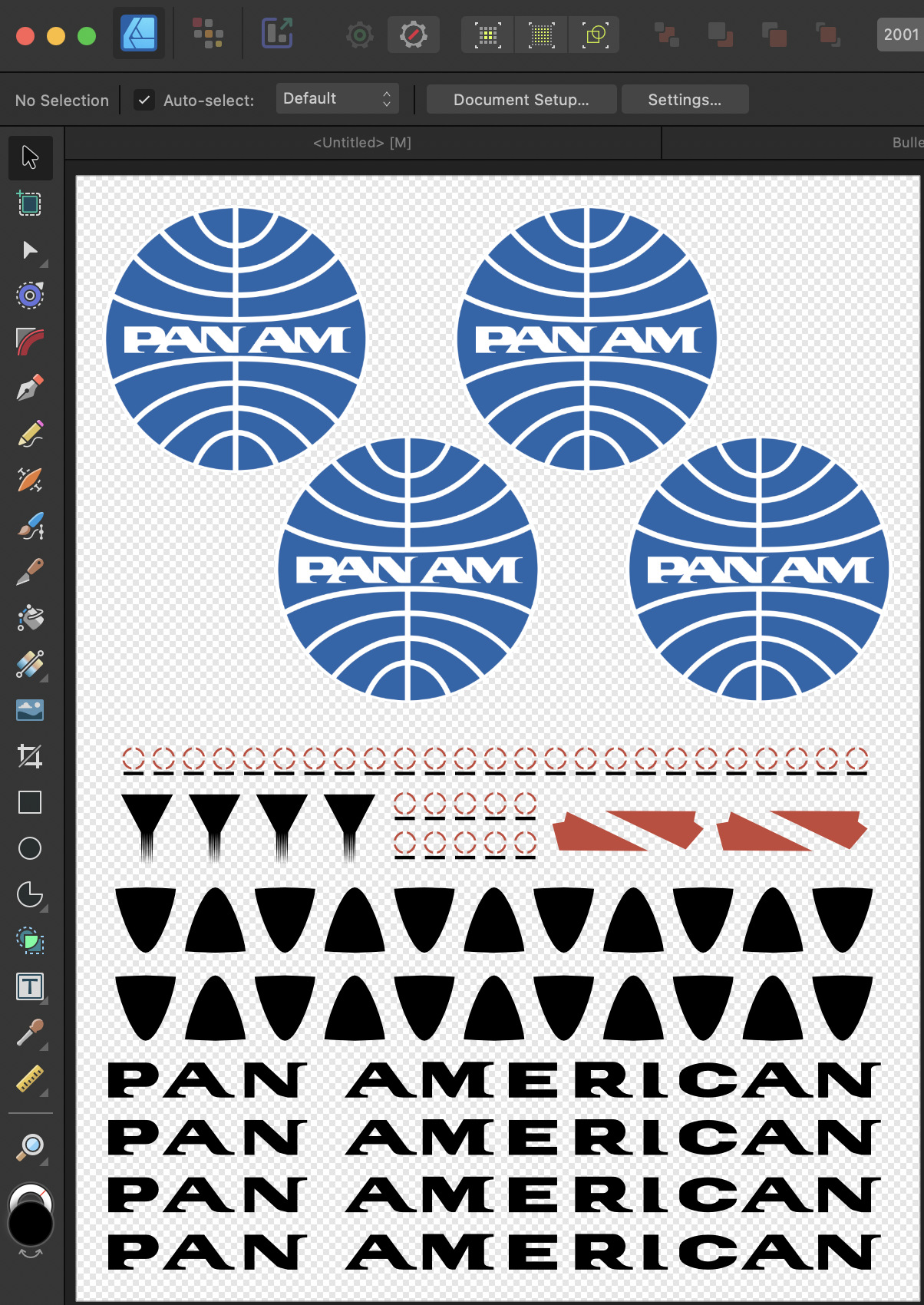

Went ahead and created artwork intended for decals to scale. I happen to love Affinity Designer rather than renting software from Adobe. (Just a satisfied customer.)
Sent the art off for water-slide decals.

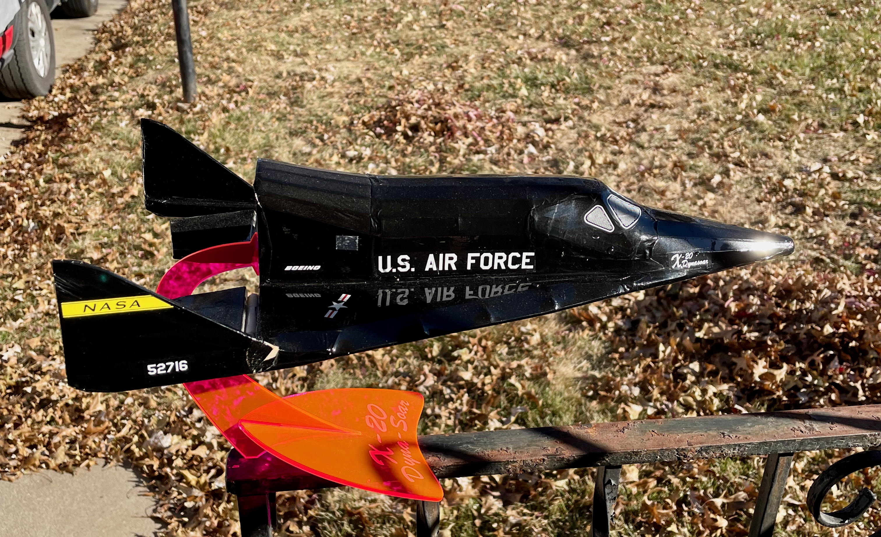

I've only had custom water-slide decals made once before. They looked excellent but the site I ordered them from (years ago) is no longer. The last photo is a X-20 Dynasoar — the first scratch-built balsa model I built. It shows here the water-slide decals I had made.
