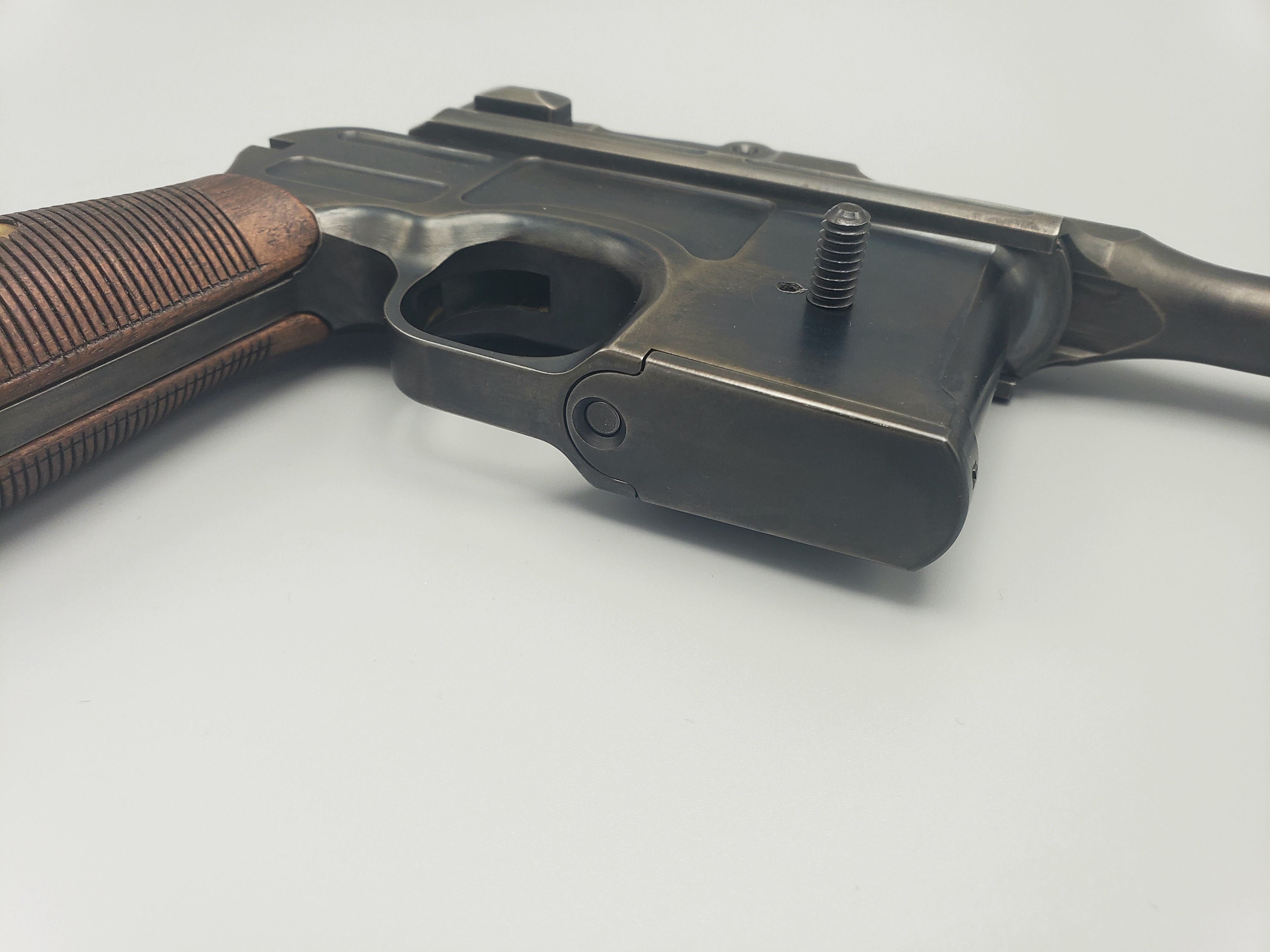

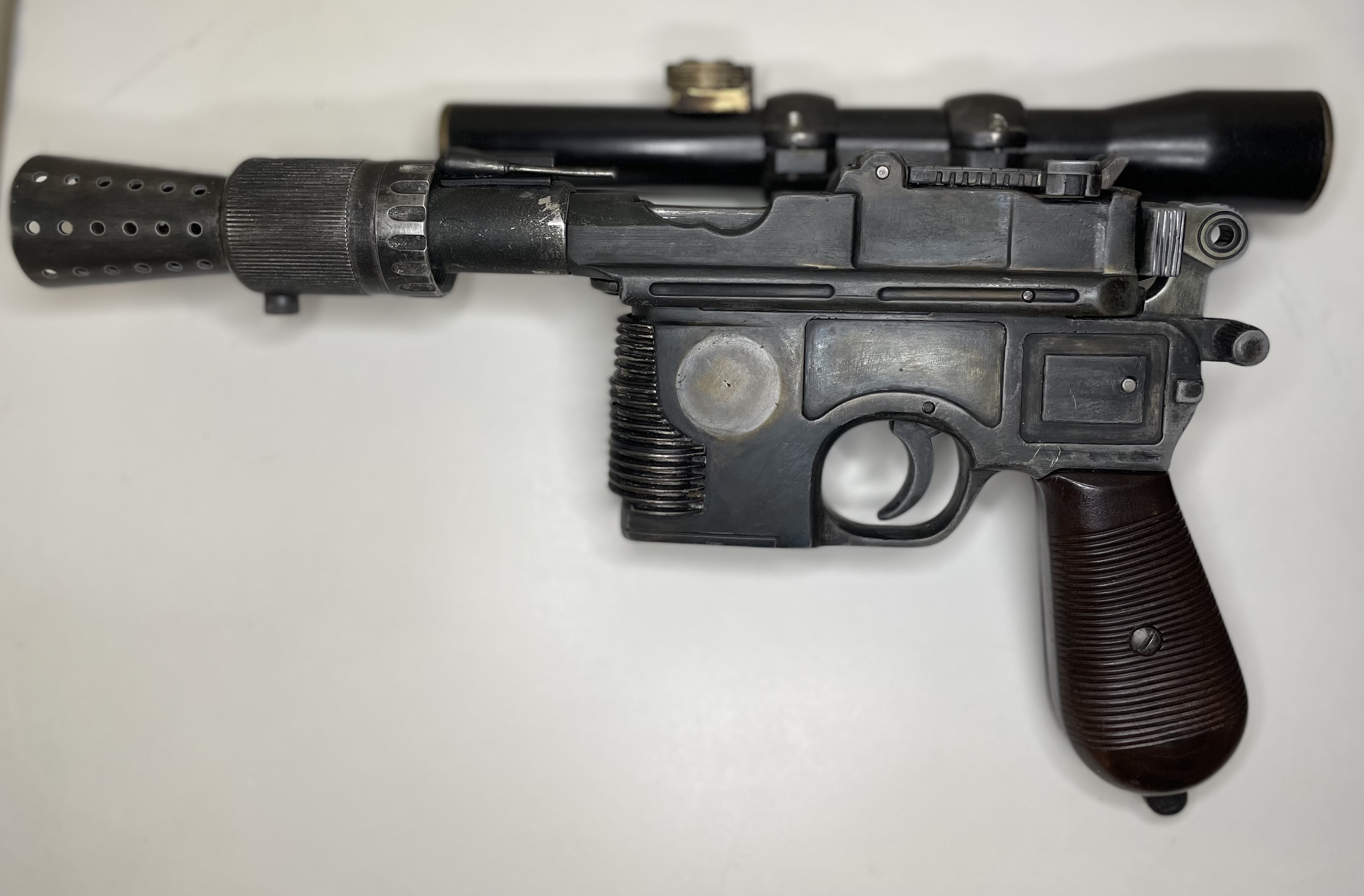

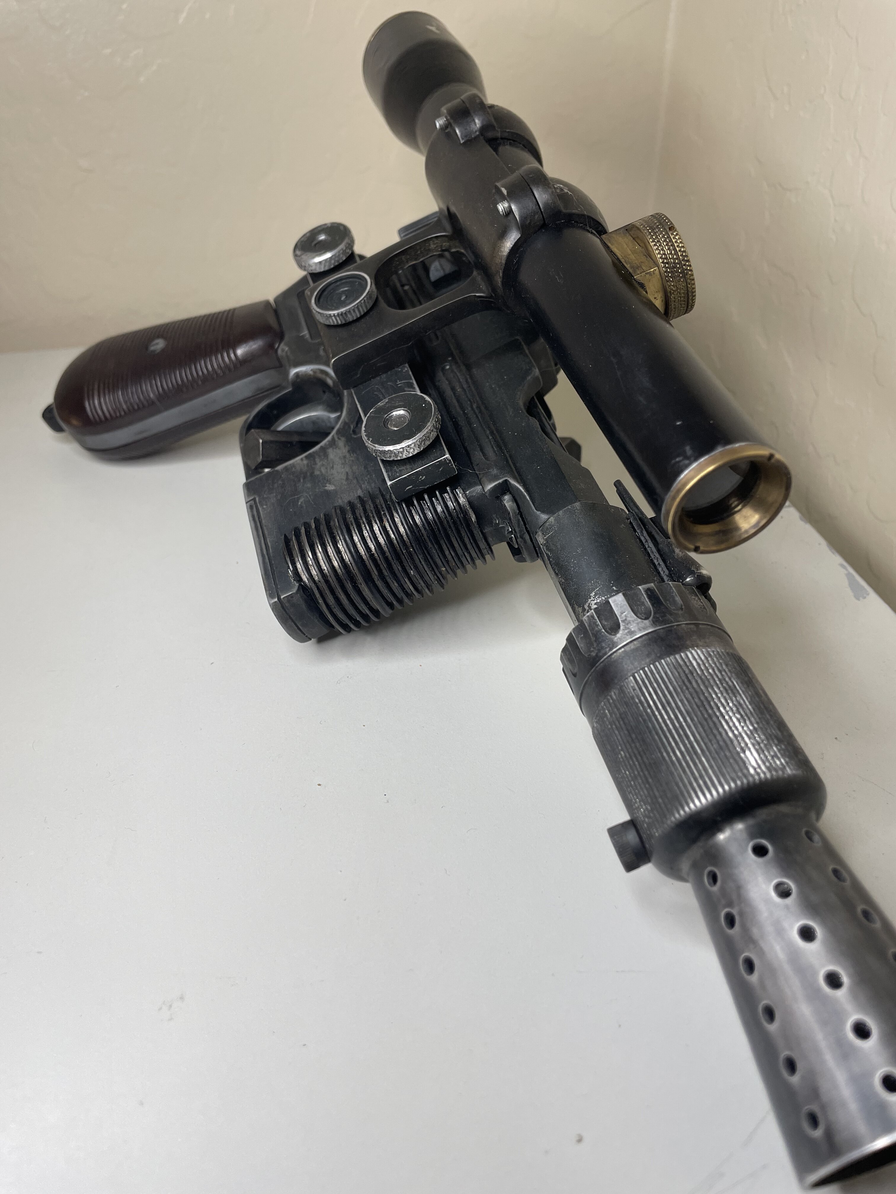

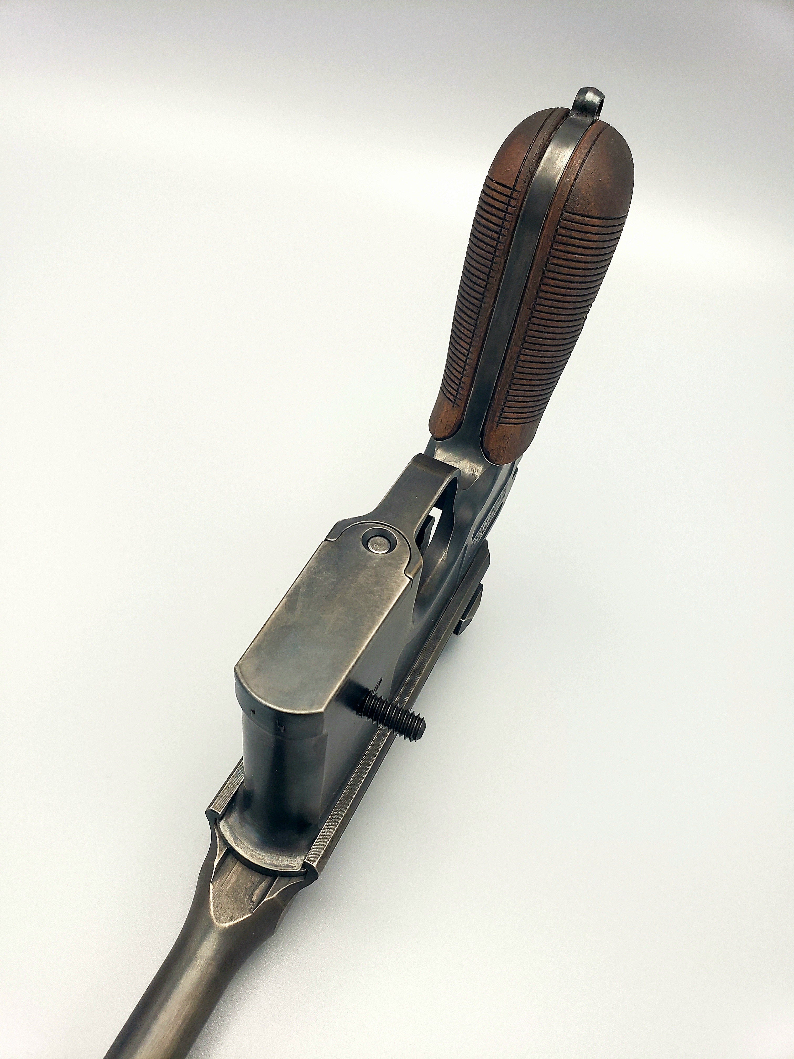

Not the first DL-44 to pass through my hands, but just finished assembly this week. I decided to do something different. It feels a bit lazy, I know, and it's definitely not something everyone would want...but while I was painting it, I ended up deciding NOT to do any weathering or distressing. I just liked how it looked clean so much that I thought it might be fun to keep it clean. At least for a while.
edit: I didn't notice until I posted it...something about the lighting in these pictures actually makes the paint look a little worn in spots...I guess it just WANTS me to distress it. I looks clean in person.
Very nice blaster. I like the clean look.
These objects came new from the manufacturer at some point, right? I finished my Greedo blaster recently and haven’t weathered it yet. I’m very much enjoying the unused sheen of the different blacks and textures of plastic and metal.

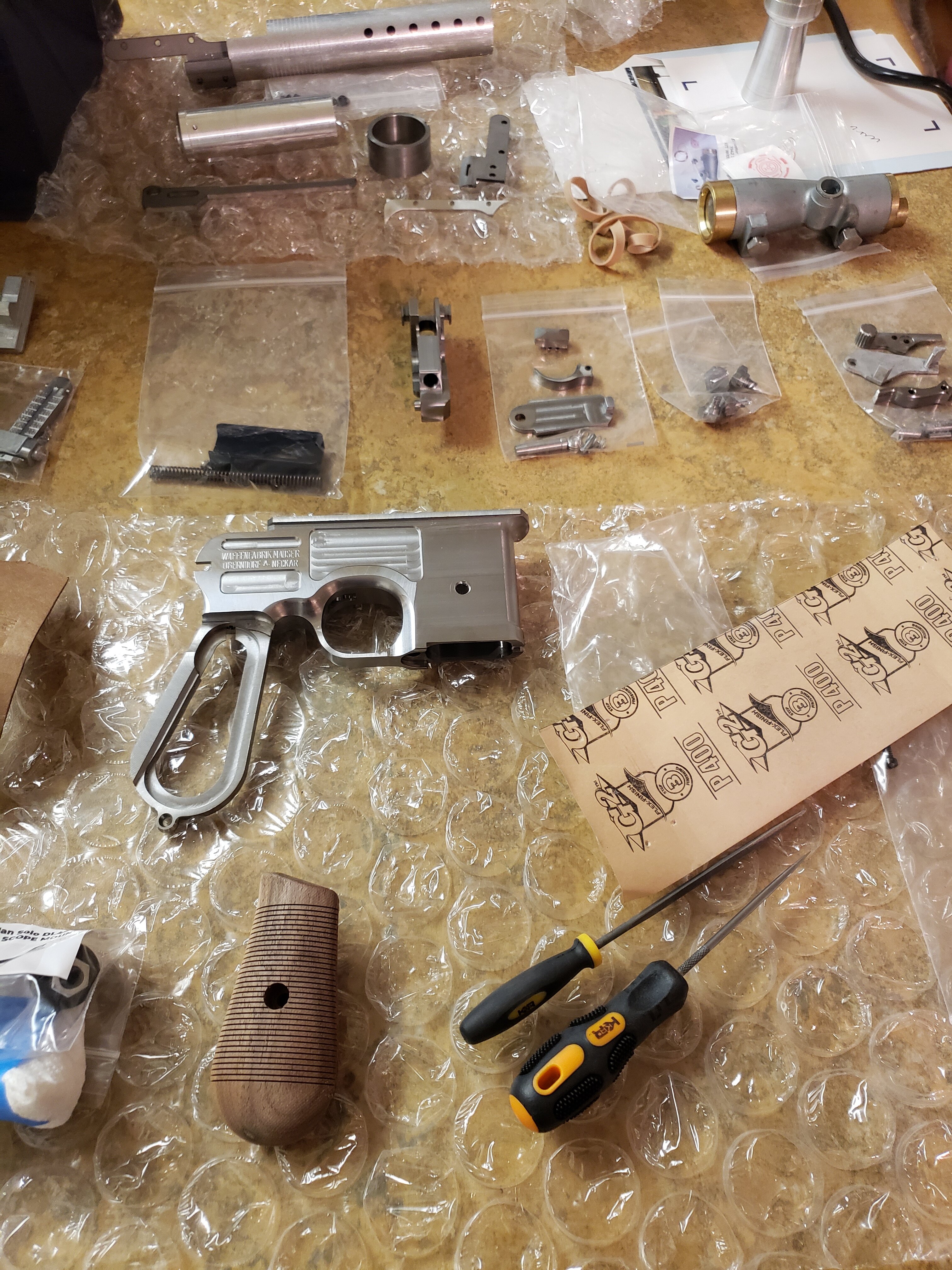

Nice build- turned out great! I’m about to tackle a steel FM of my own. This is my first DL 44 and i had a couple of quick questions if you dont mind:
what length did cut the barrel to?
how did you decide where to drill /tap the holes for the scope mount?
any tips on drilling / tapping the holes? (Don’t want to make any rookie mistakes)
Thanks!
Jonflake88
Thanks! That’s awesome, you’ll love it, it’s a great kit and fun process. If you’re getting field marshals full steel kit, then all of that will come pre-drilled and cut. You’ll only have to worry about that if you’re doing a denix mod.

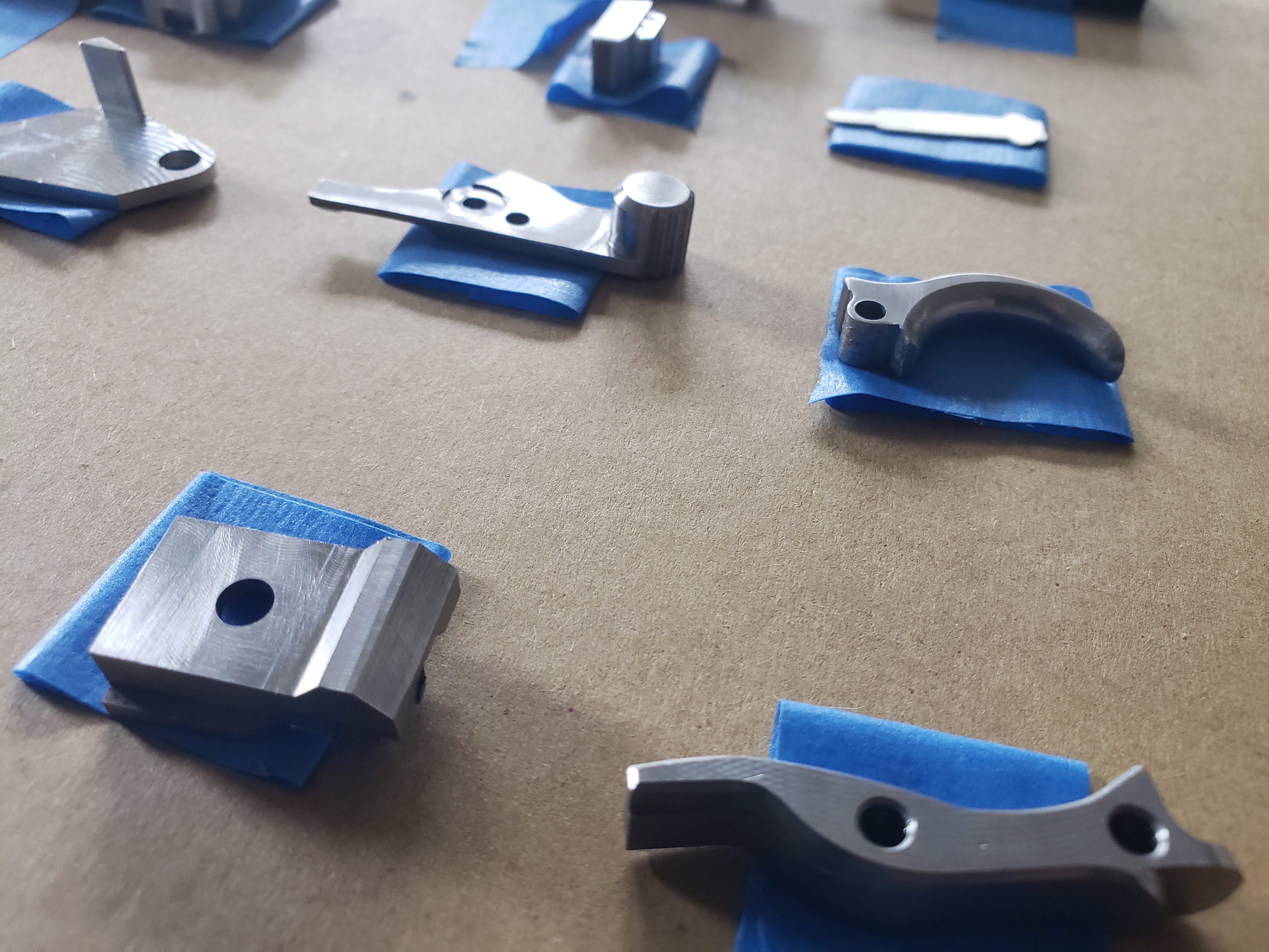

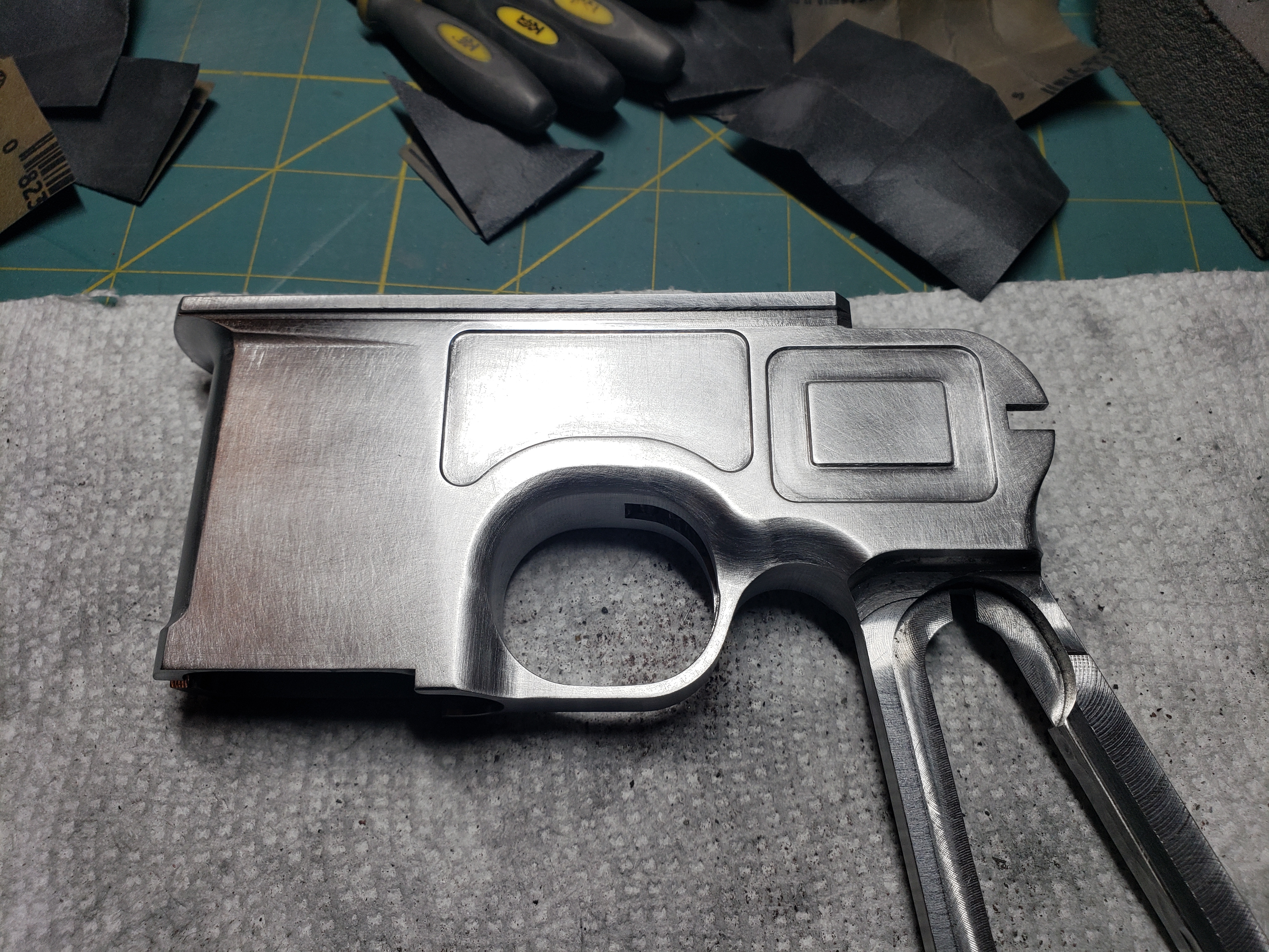

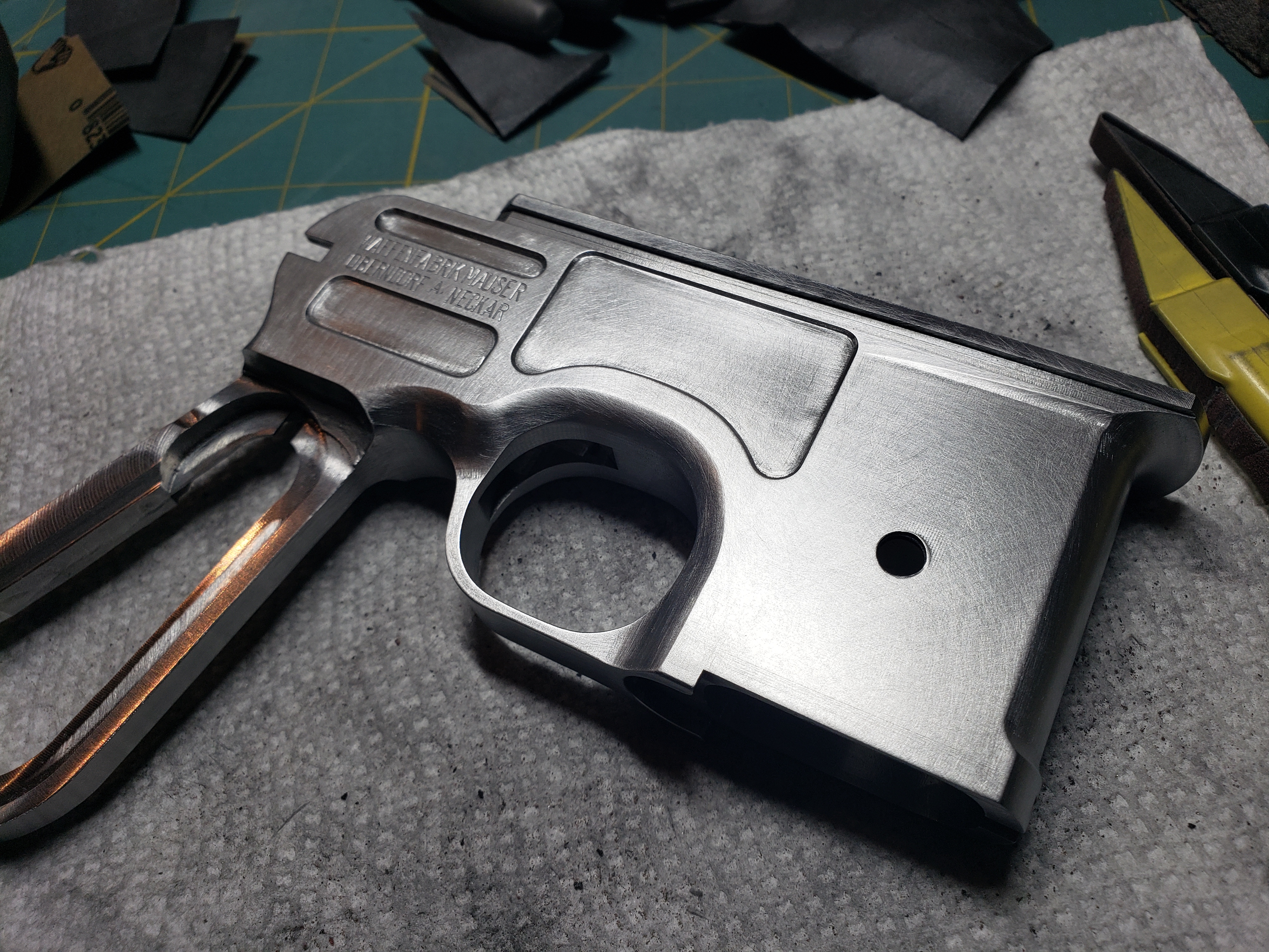

Here are my FieldMarshal denix builds….

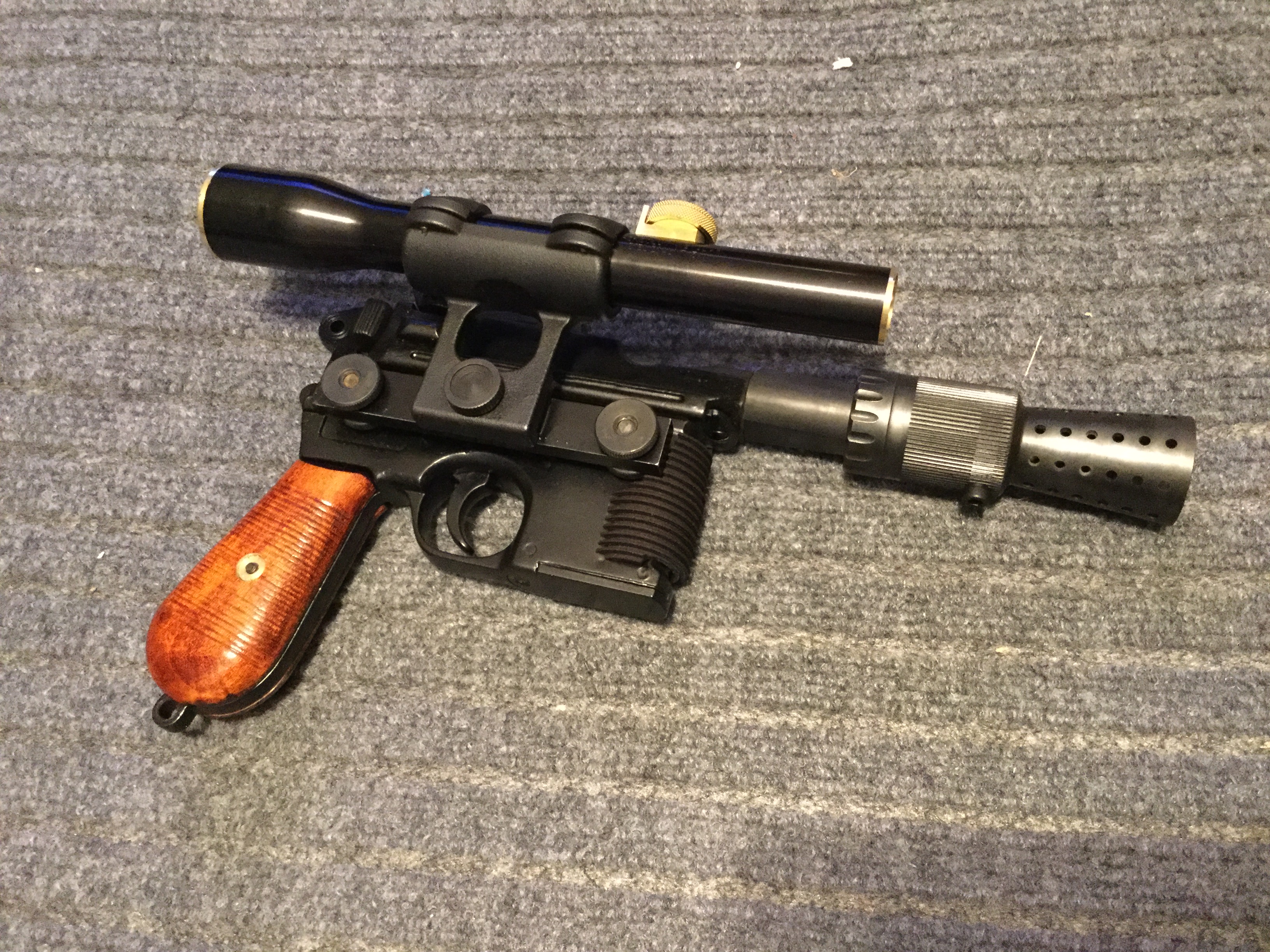

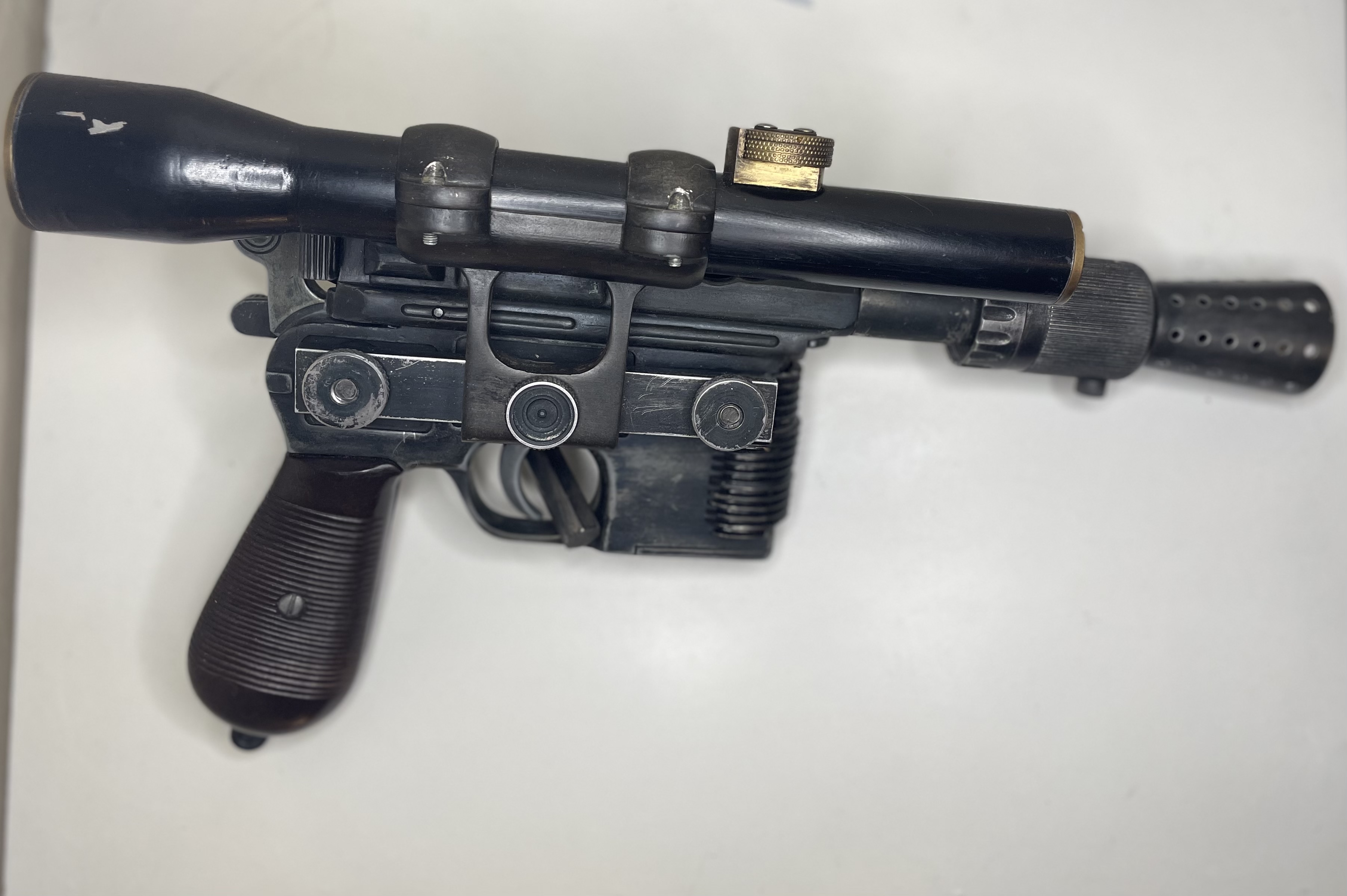

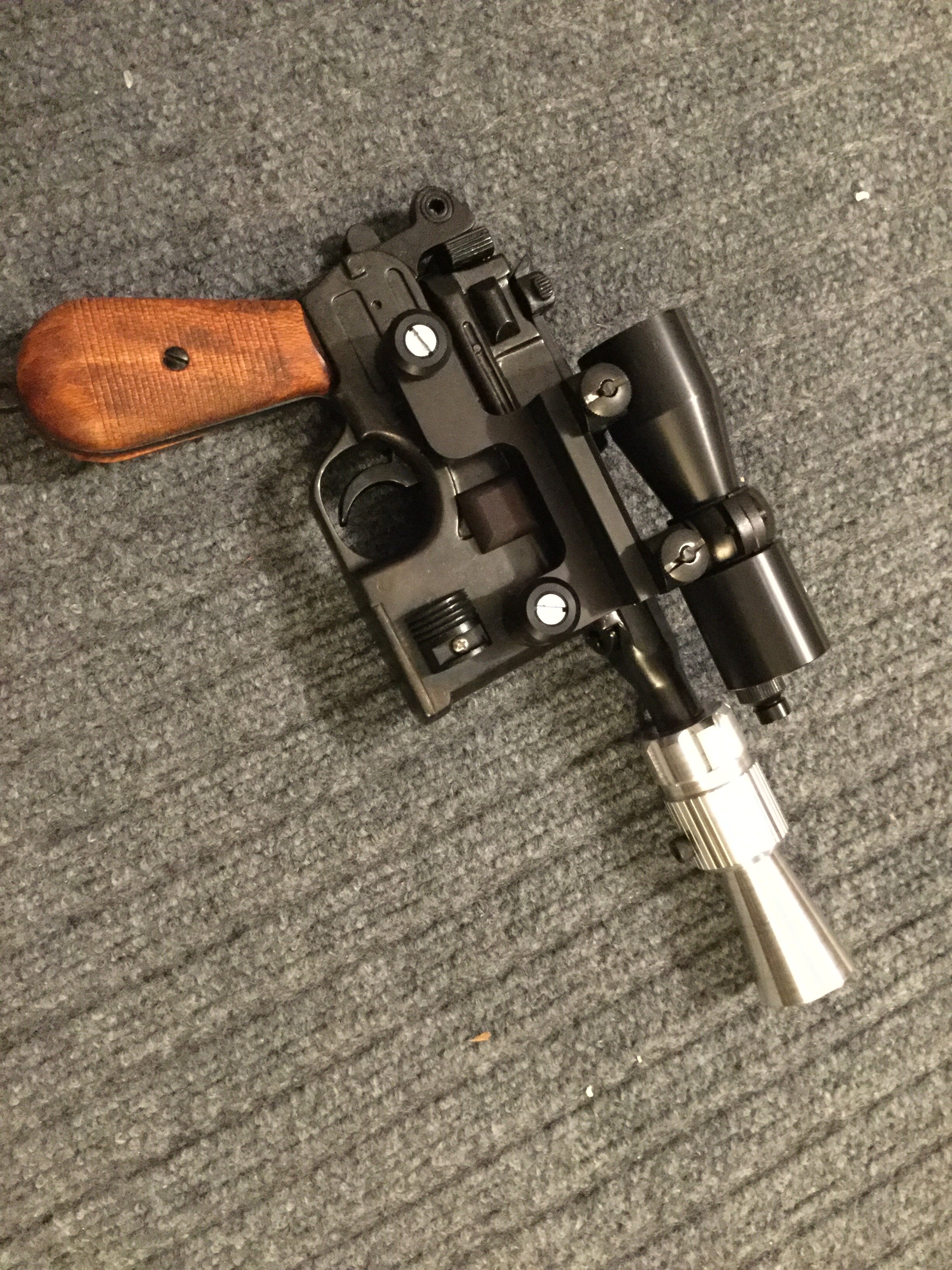

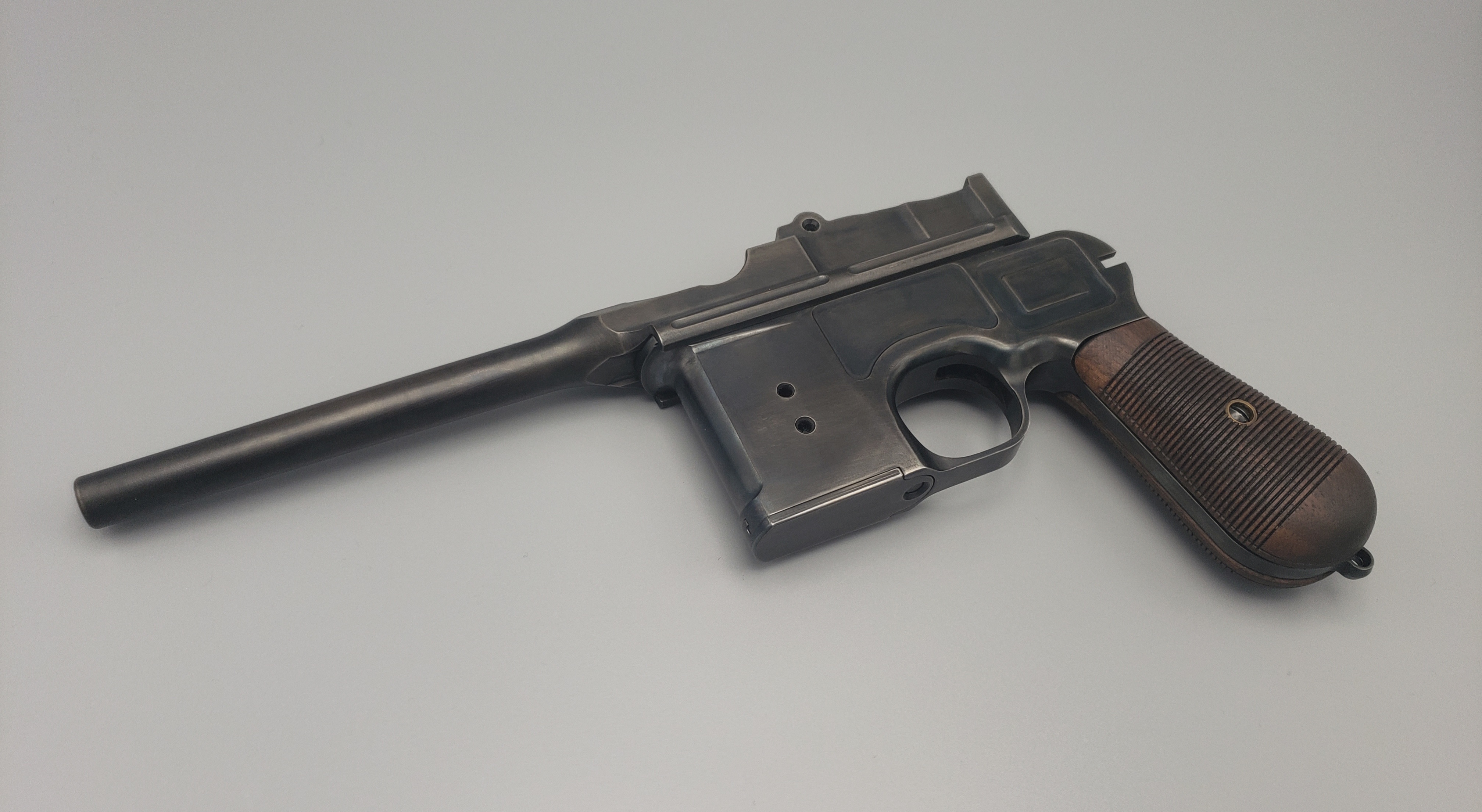

Here’s my First DL-44 build. Not hyper accurate per-say. I am also a fan of the Adam Savage method of making something that gets a clear message across but is also just a lot of fun. I really enjoyed the Solo movie, and am of course a huge original trilogy fan so my build was kind of geared to be somewhere in between both time frames. Next upgrade will be wood grips and a new bolt. I’d love to hear y’all’s thoughts.
Fantastic build Jonflake88!

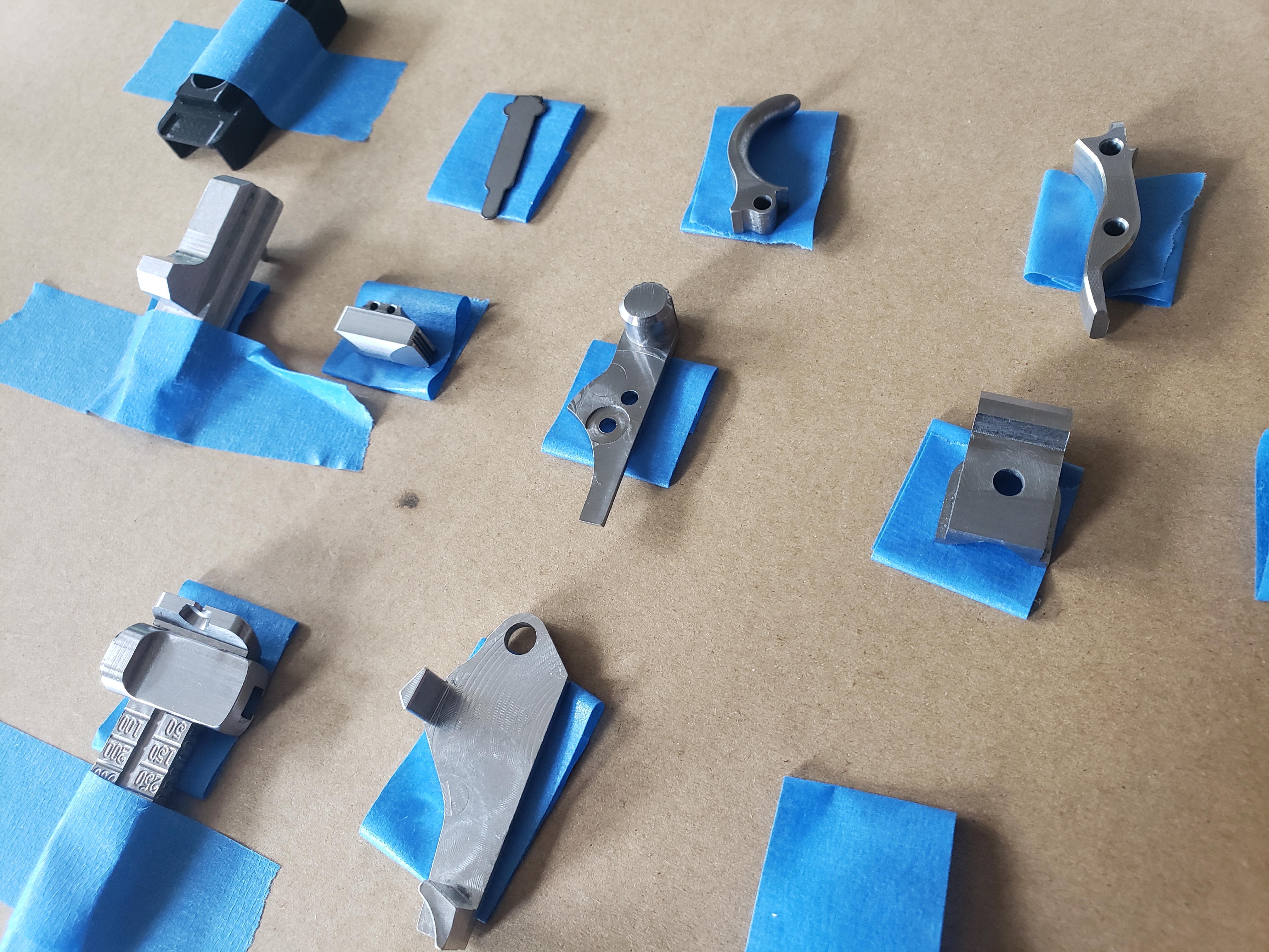

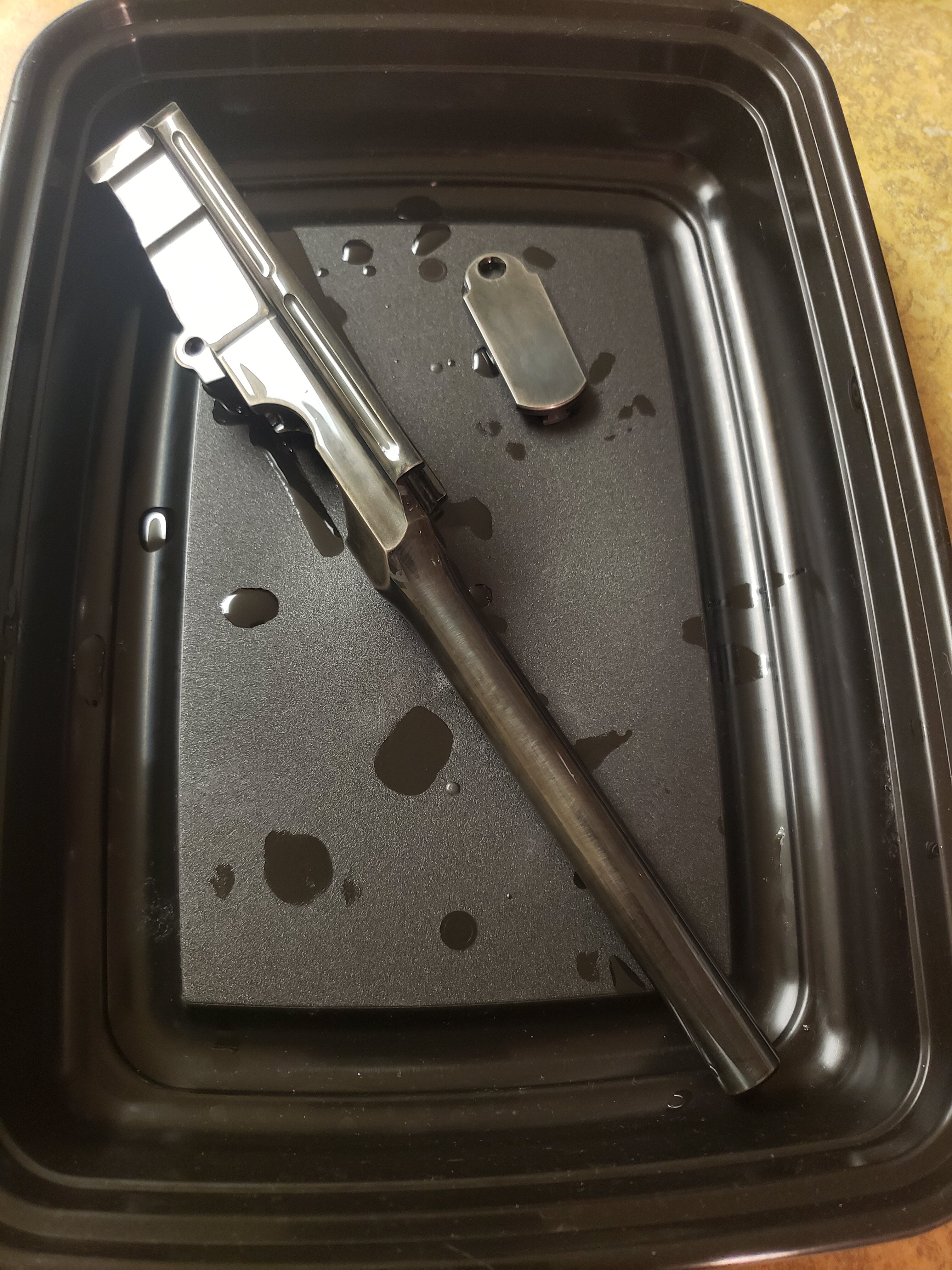

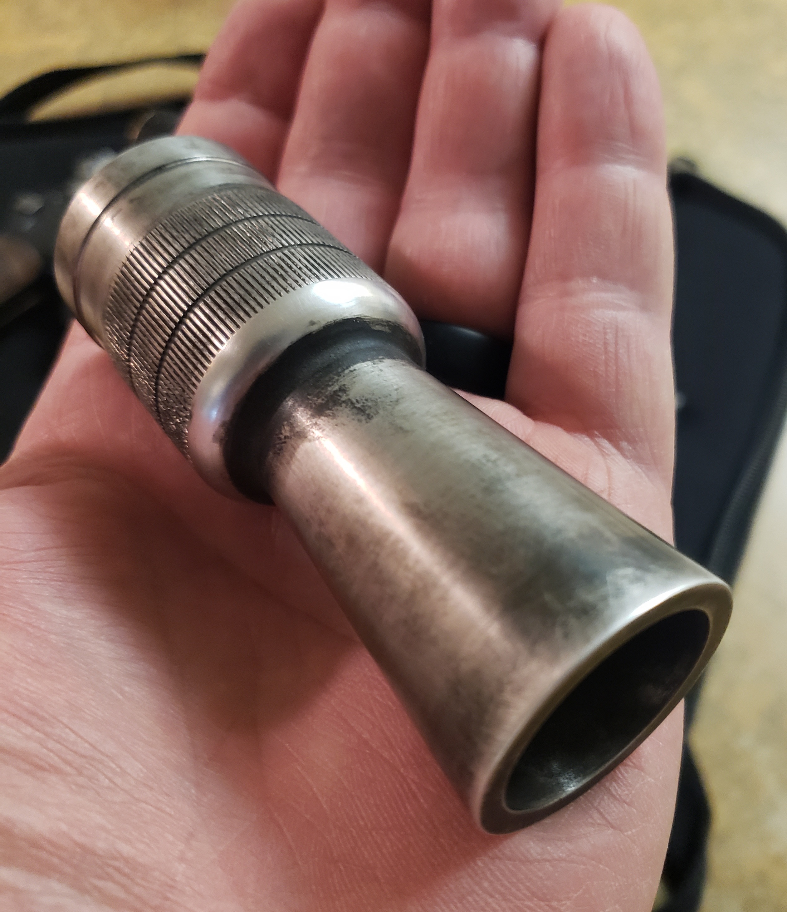

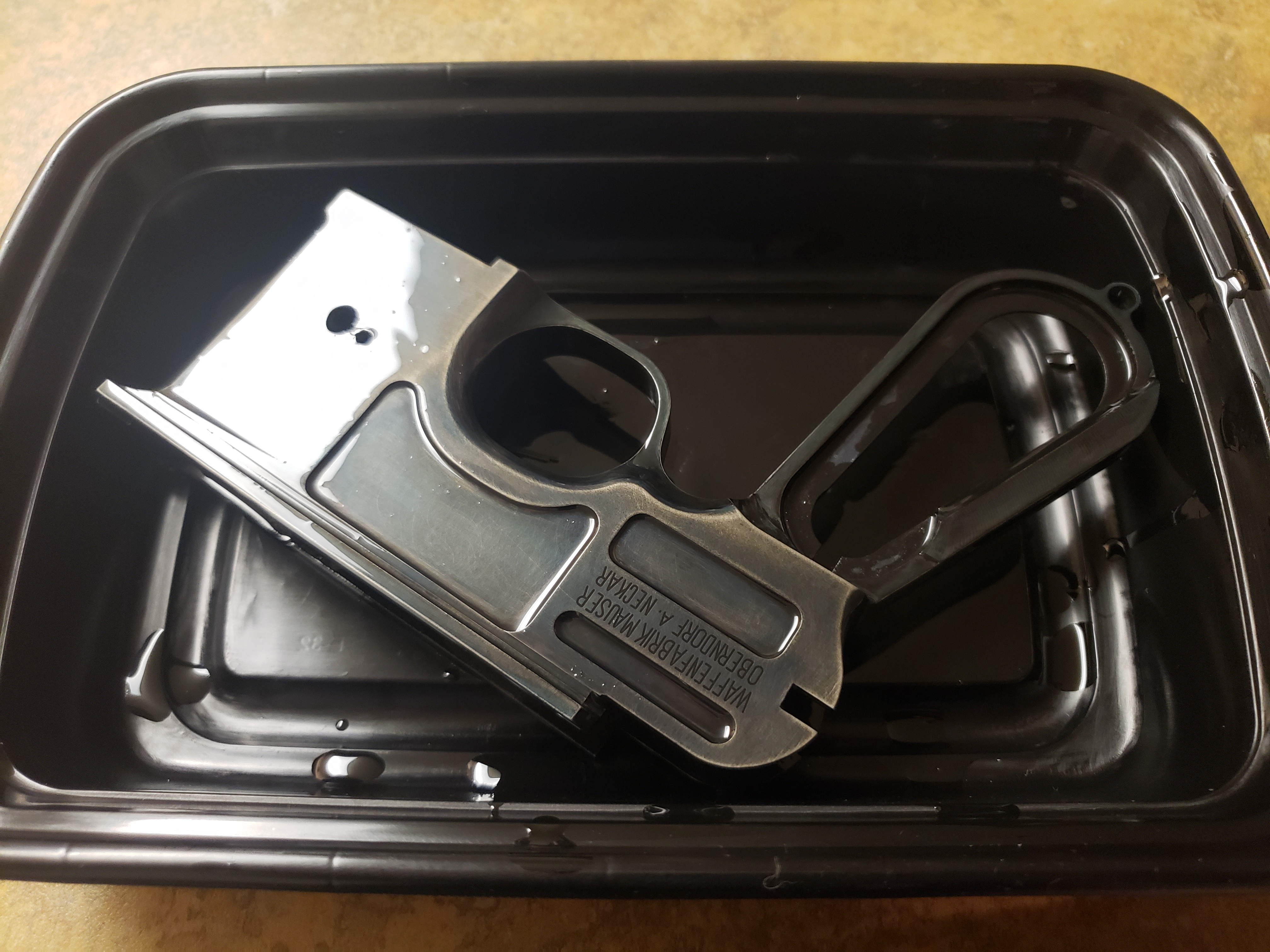

Just a question out of curiosity. What do you guys use to blue the metal parts? Same stuff as for real guns?
I also used Birchwood Casey Super Blue for all of the steel parts. I then clear coated with a matte or crystal enamel.
I really screwed it up the first time so make sure you stick to the process of cleaning the parts with acetone, bluing, and then coating in oil (I used a standard vegetable oil), and letting it sit for at least 24 hours. You might want to blue it a second time if you want a deeper finish but I found one coat was good enough for what I was going for, generally.

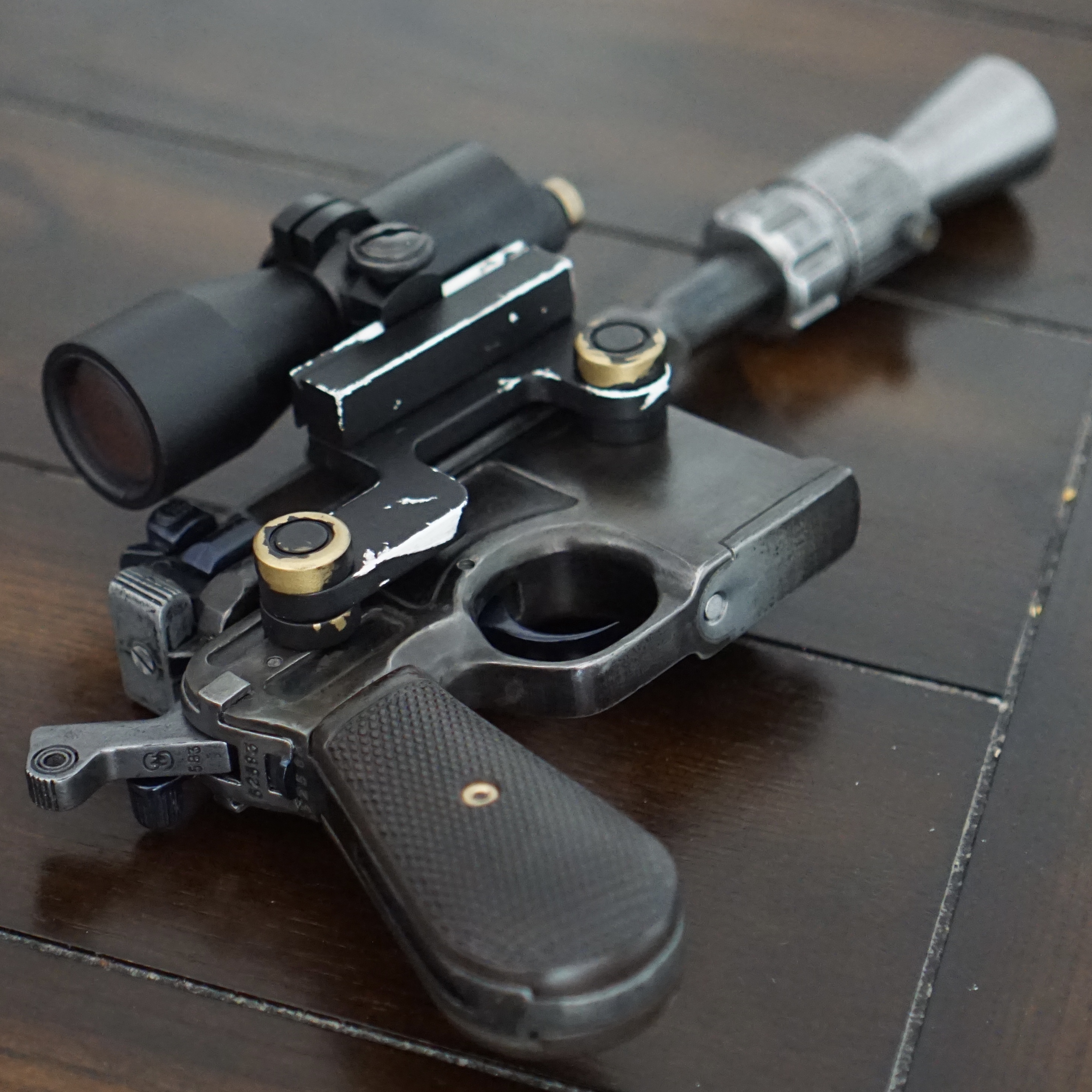

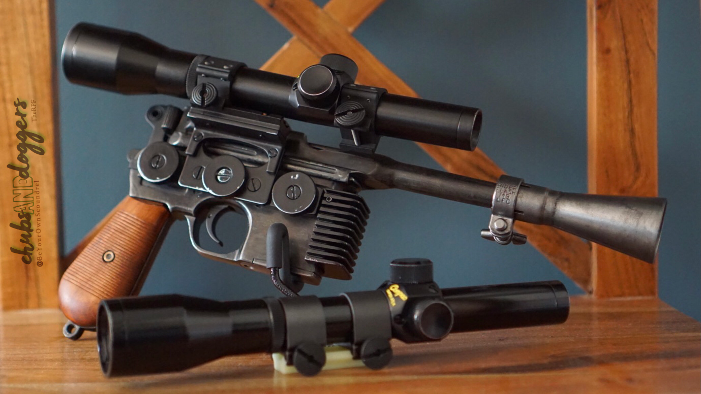

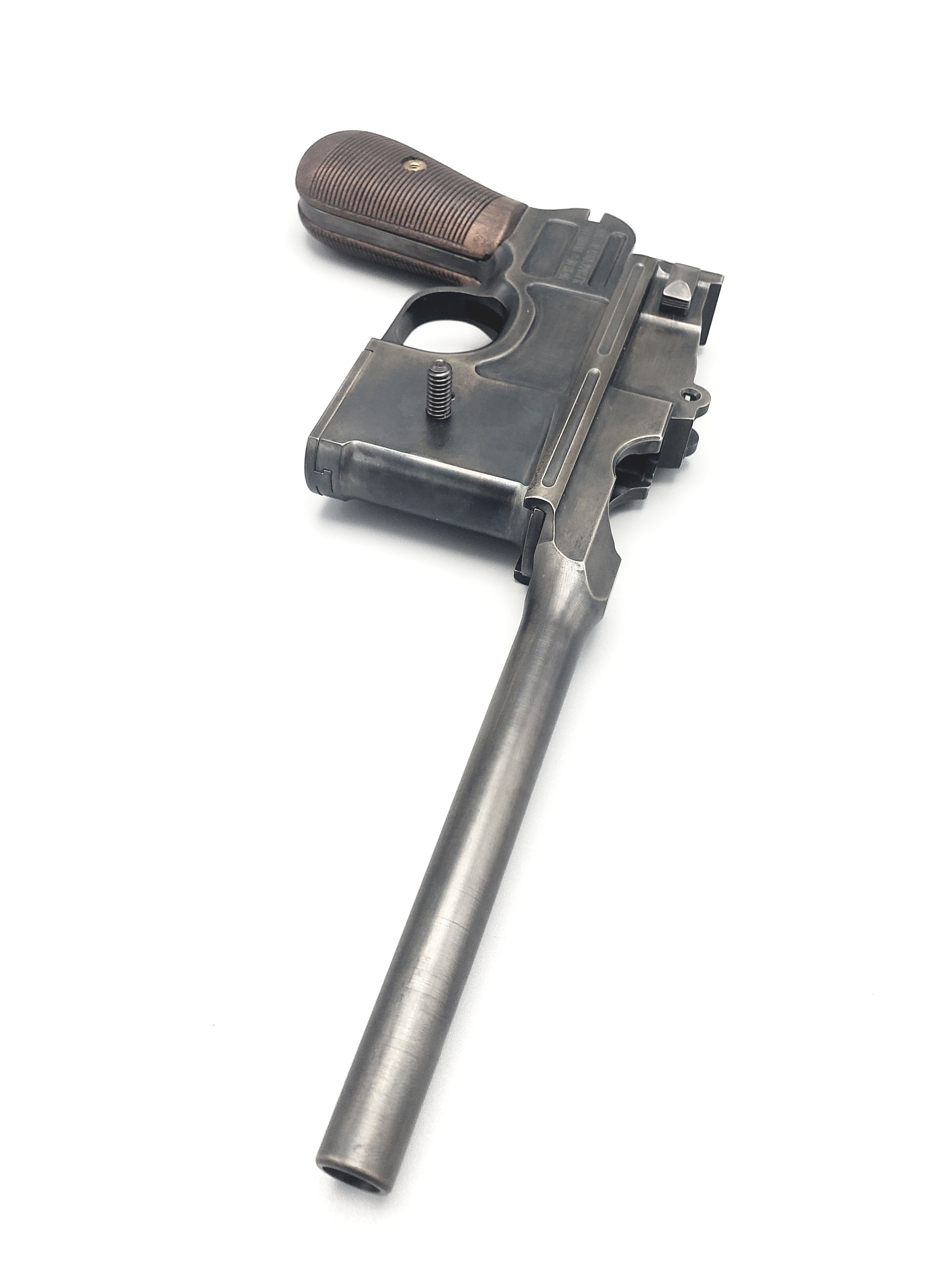

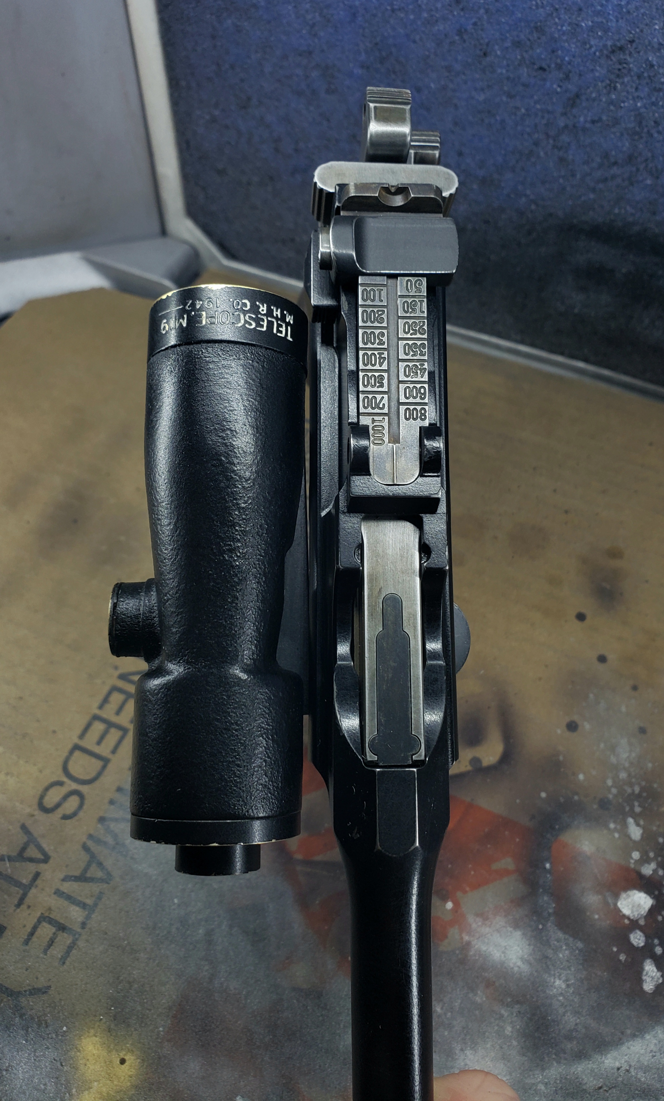

Some wonderful replicas everyone is recreating here! Beautiful work by all indeed. Here is my Stembridge and GK blaster I recently finished up to add to this great thread that’s starting to take a life of its own. These are denix based with my own designed parts. Always fun to see others enjoying these blaster builds..
Think your build is great! It has a really nice feel to it, and your weathering looks great. I think you struck a nice middle ground between the two looks. When you grab the wooden grips, scottjua has a great video about weathering on his patreon, I definitely recommend checking it out.

Some wonderful replicas everyone is recreating here! Beautiful work by all indeed. Here is my Stembridge and GK blaster I recently finished up to add to this great thread that’s starting to take a life of its own. These are denix based with my own designed parts. Always fun to see others enjoying these blaster builds.. View attachment 1517623 View attachment 1517622

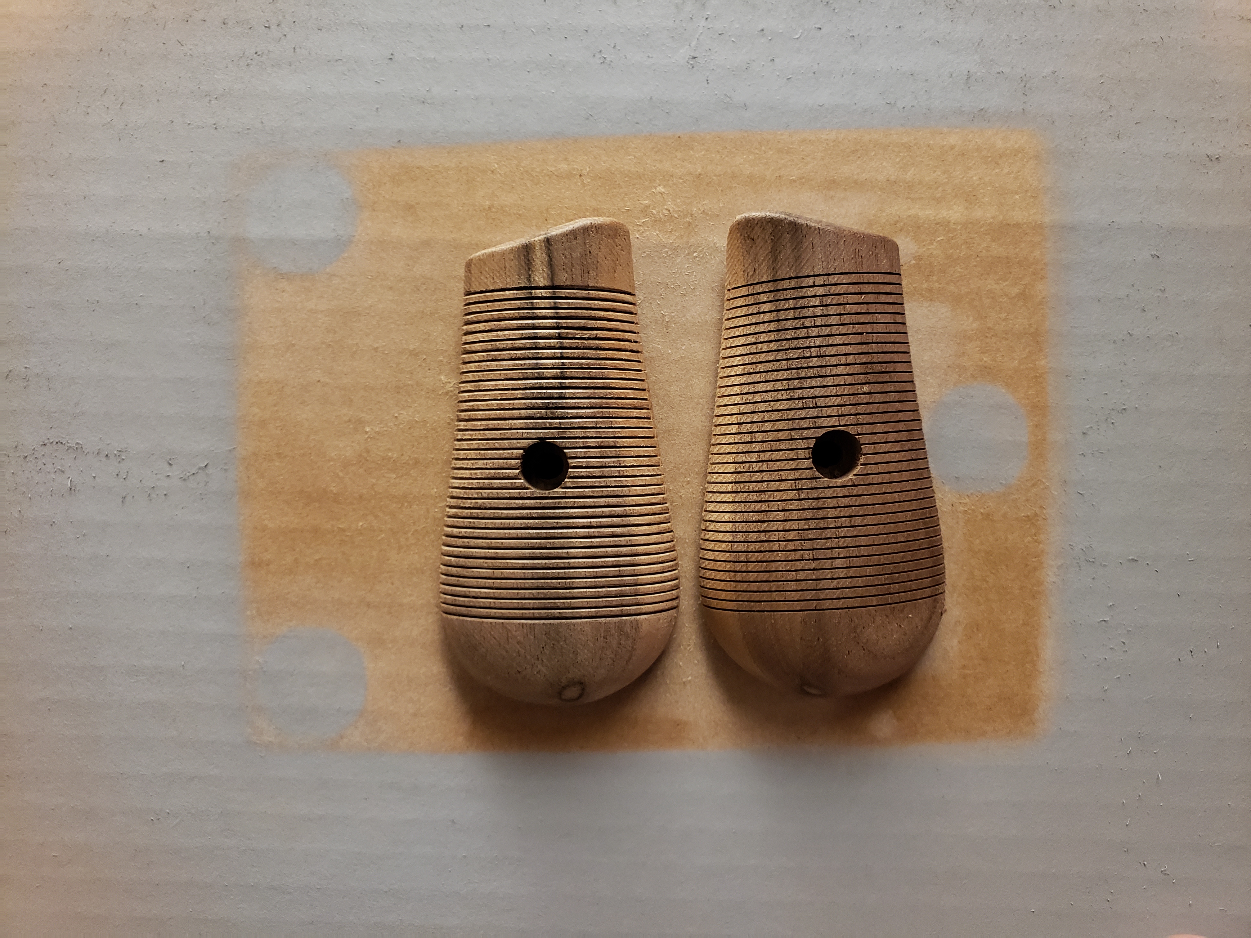

These are great! Im loving what my original build thread is turning into, like you said its taking an awesome life of its own! I want to build a stembridge at some point, have a few other blasters to knock off my list first though. I love the story behind the GK though. Are those how the grips are on the stembridge? I haven'd done any research on it, I really like the look of them though.
chubsANDdoggers
Jonflake88 Ya the grips on the Stembridge where checkered opposed to straight lines. Here a video that will definitely help speed up the research on the Stembridge if interested. Might be helpful in your quest. I also have video on that GK pictured as well. It’s a build thats both film accurate as well as LucasFilm archives accurate. (The scope rings is basically what it boils down to). It’s on the same YouTube page. Here the Stembridge..
