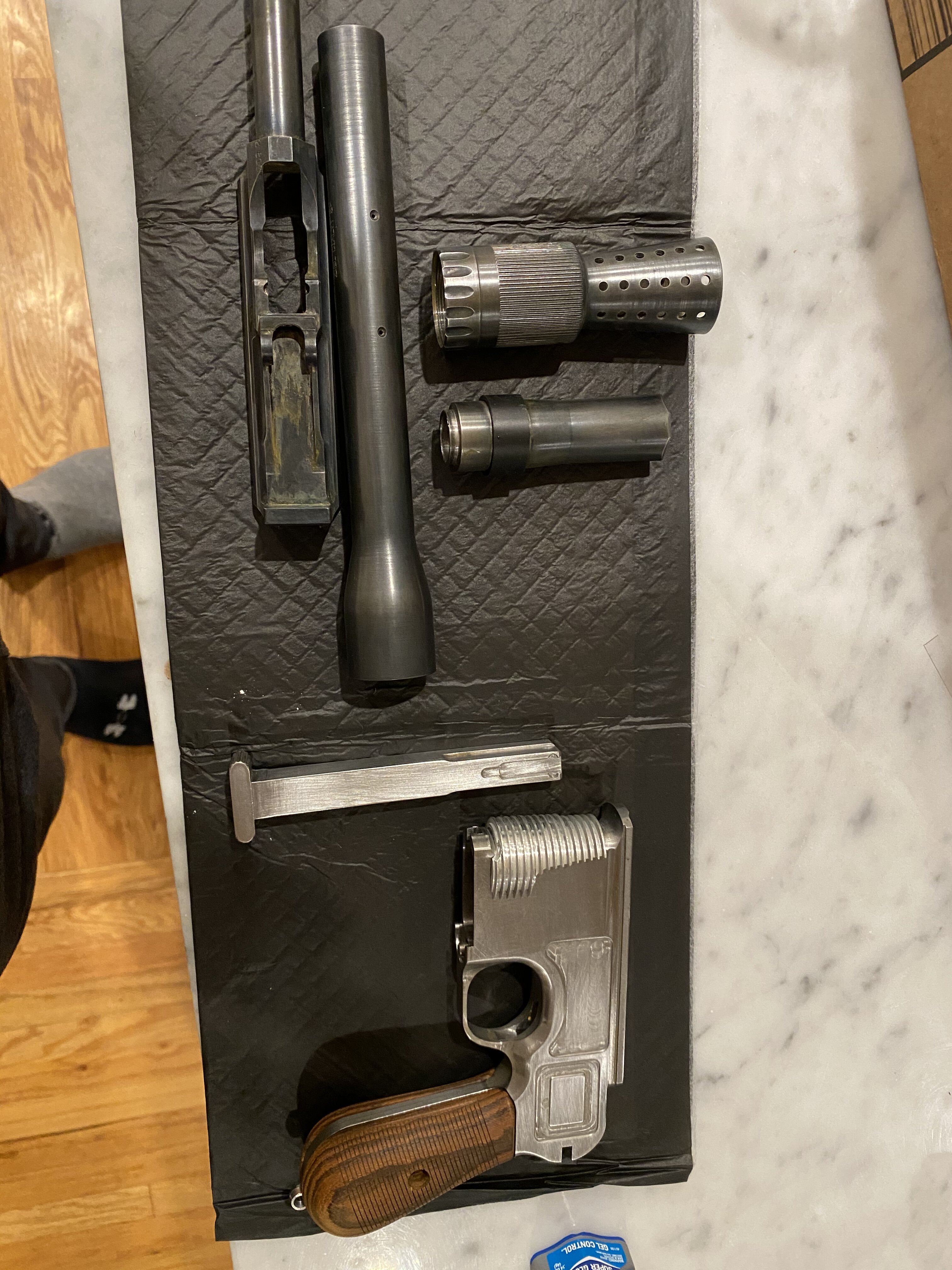

I was lucky enough to get a war machine (blaster factory) full steel DL44 replica for Christmas. This is a prop I’ve wanted since I was a kid, and will be a centerpiece of my collection. My goal is to make an accurate ANH Hero blaster. I take the Adam Savage approach to my props, the experience is most important to me, but I would like to get as many of the details as I can within reason.

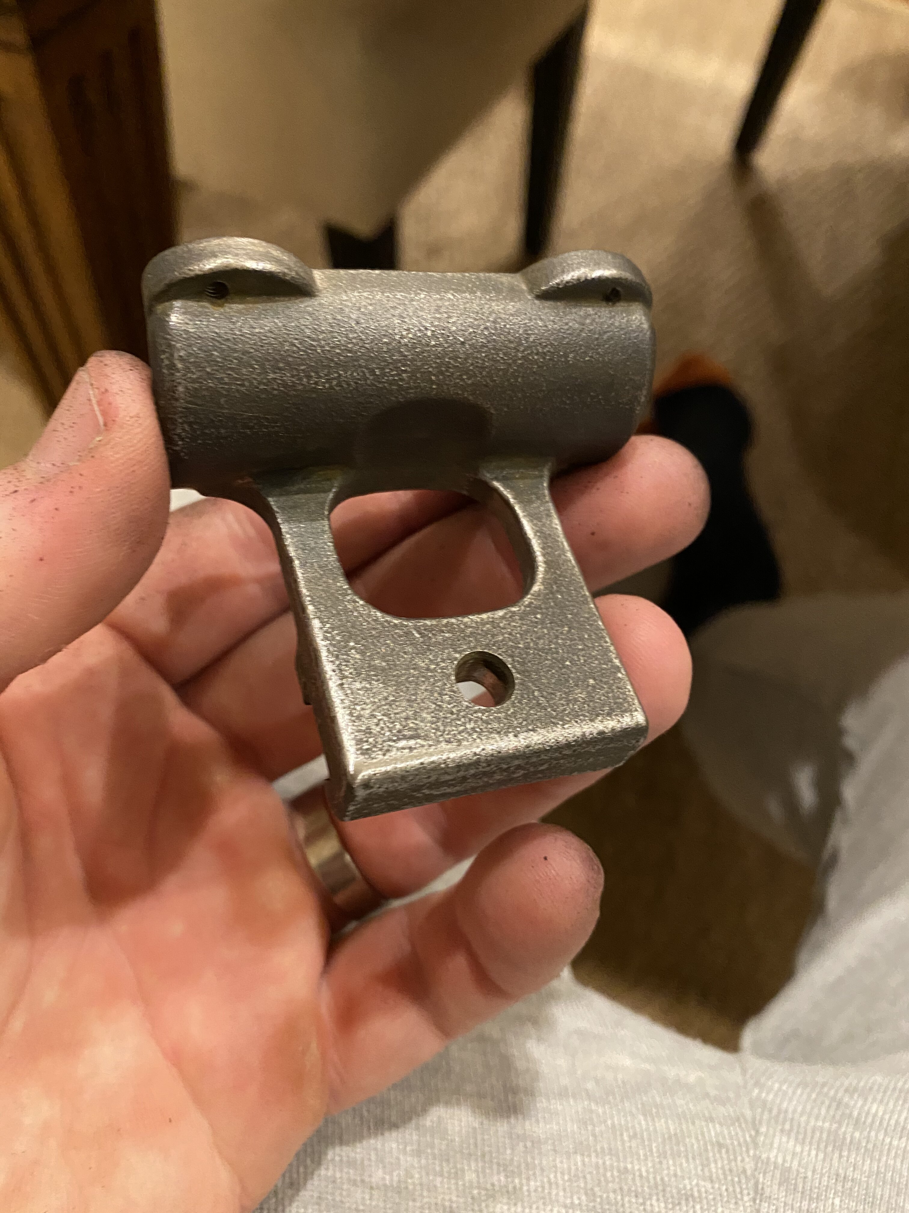

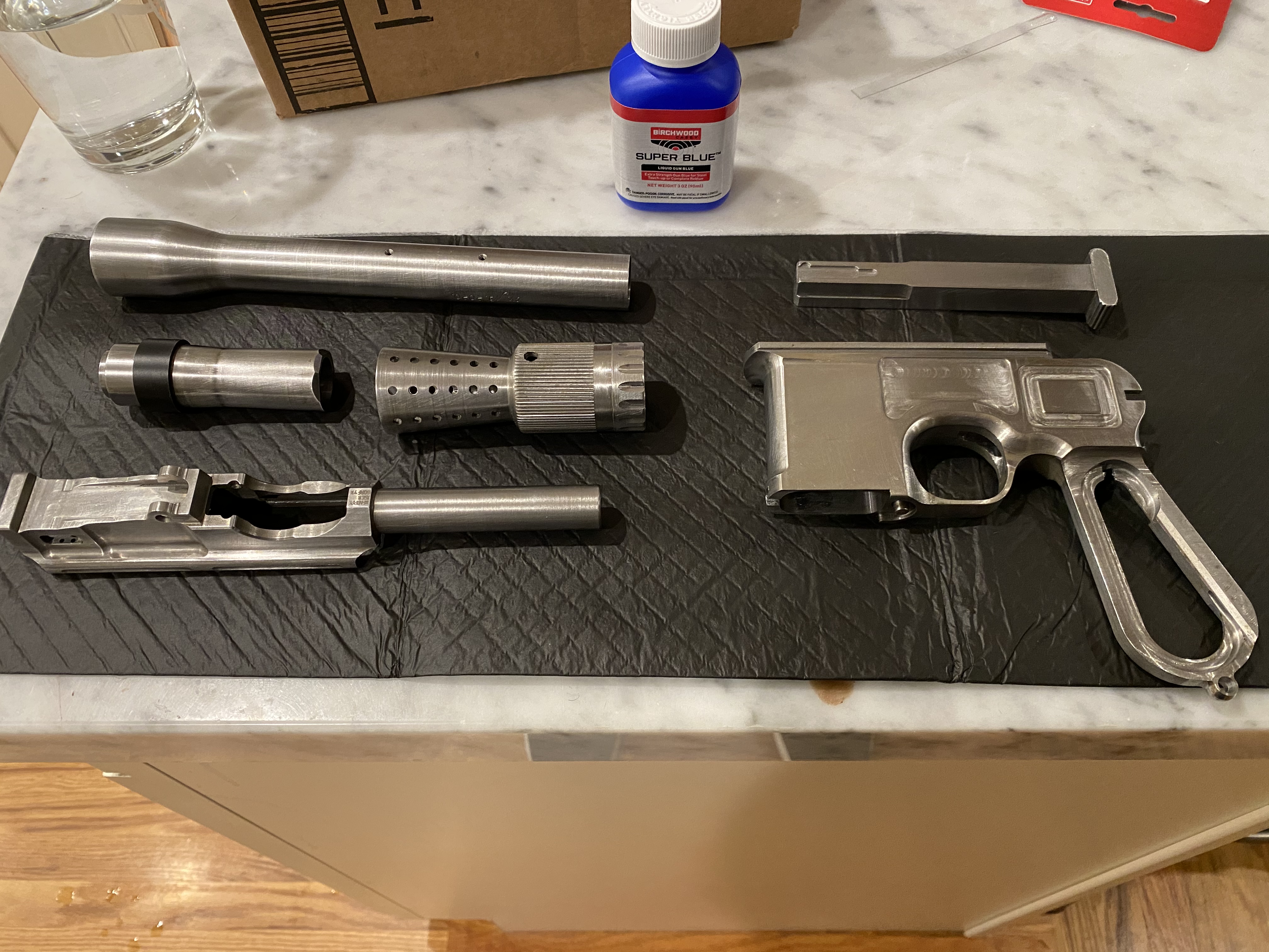

scottjua has been kind enough to answer my many questions (credit to him for many of these steps) and now begun the build has. After learning assembly of the kit, first step was sanding and prepping the steel parts for bluing. I used birchwood and casey super blue for the upper. Black paint (either archive x enamel or flat black rattle, undecided, opinions on this welcome) with scottjua stencil to come tomorrow. If anyone has any questions, by no means am I an expert, but I’m happy to try and answer!

Welcome to the world of checking your notifications!
Seriously, excited to see your work - you did a great blueing job on those parts. I see you're planning on painting your lower frame, YES!

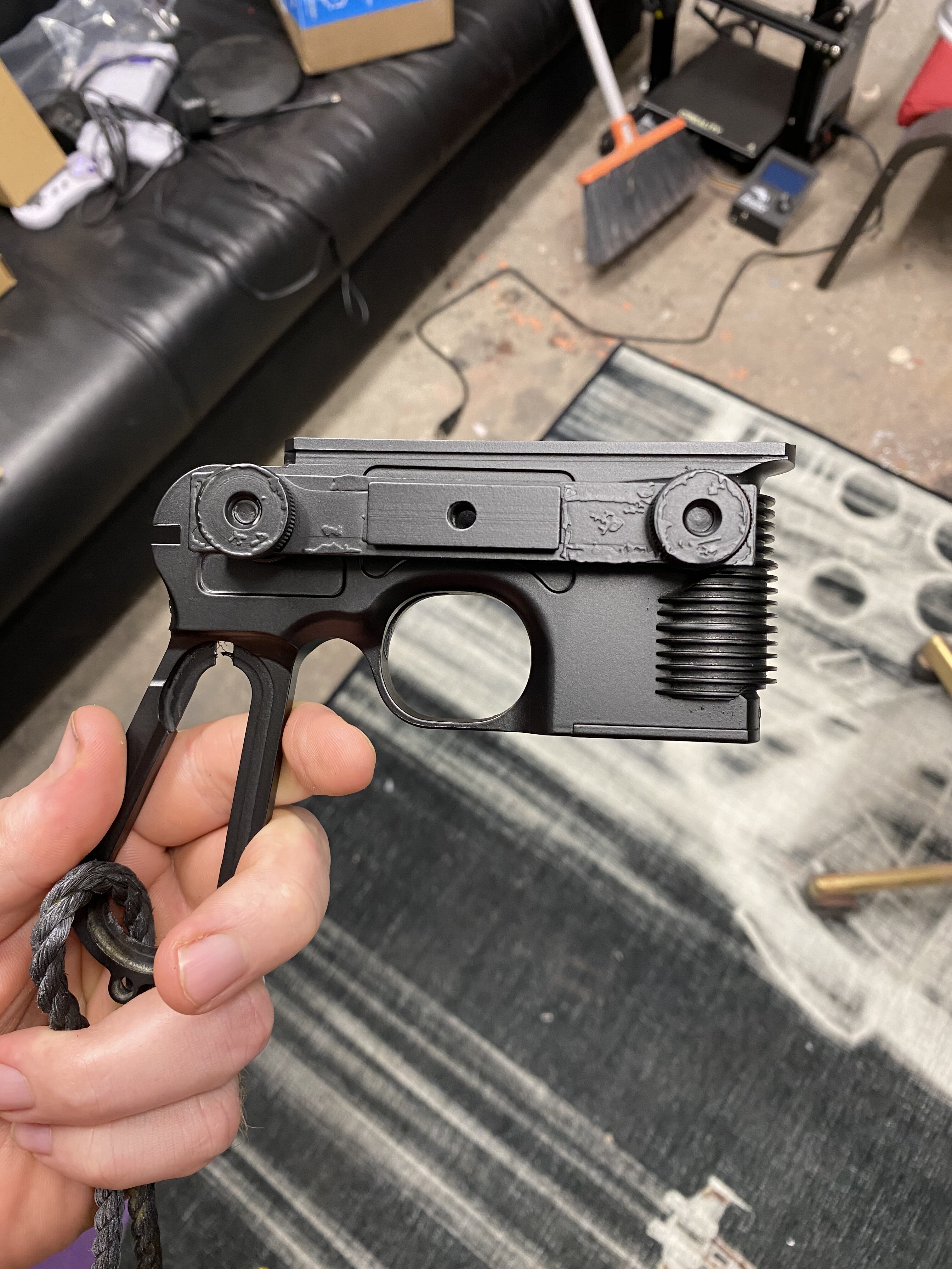

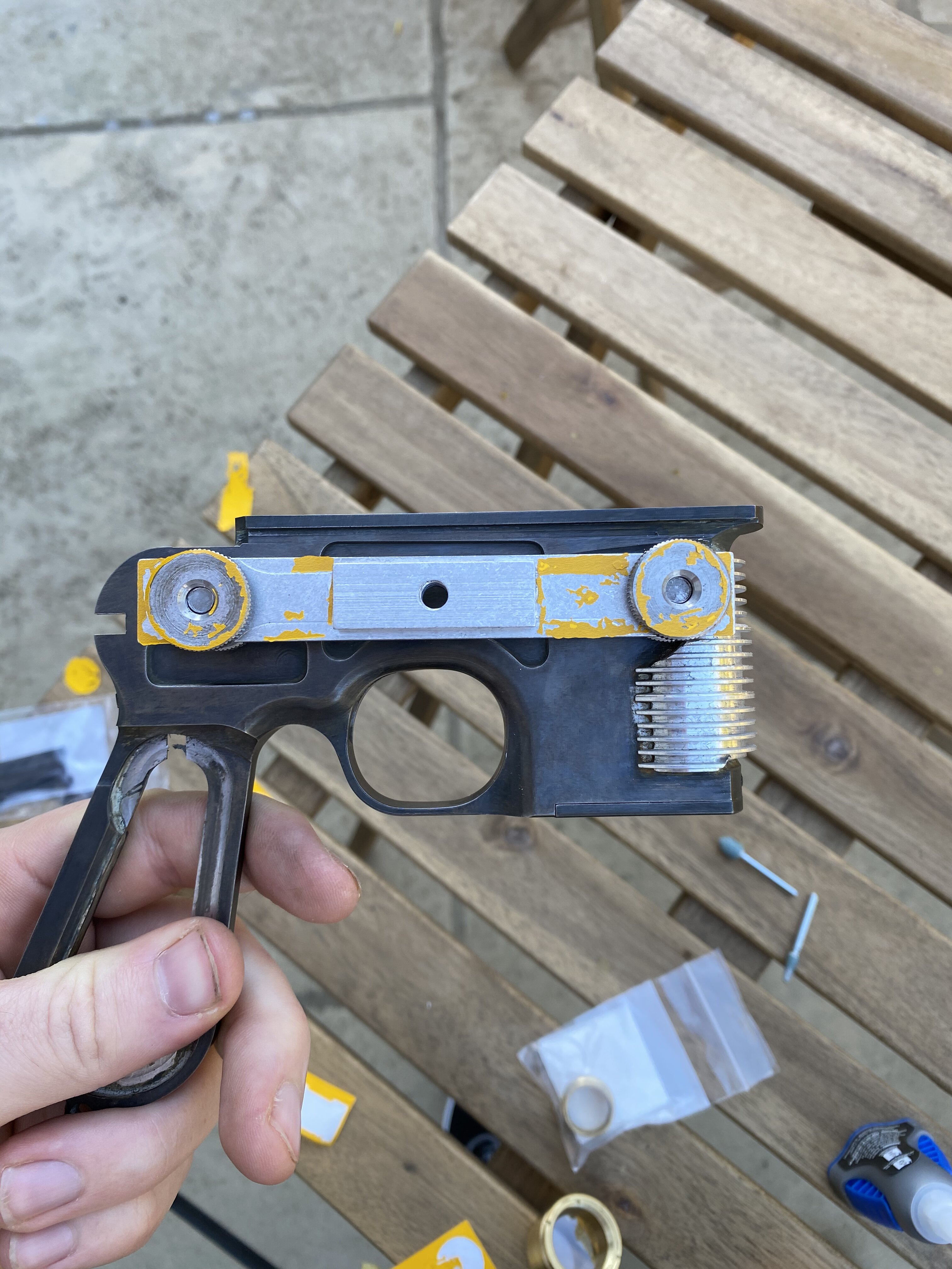

Build update:

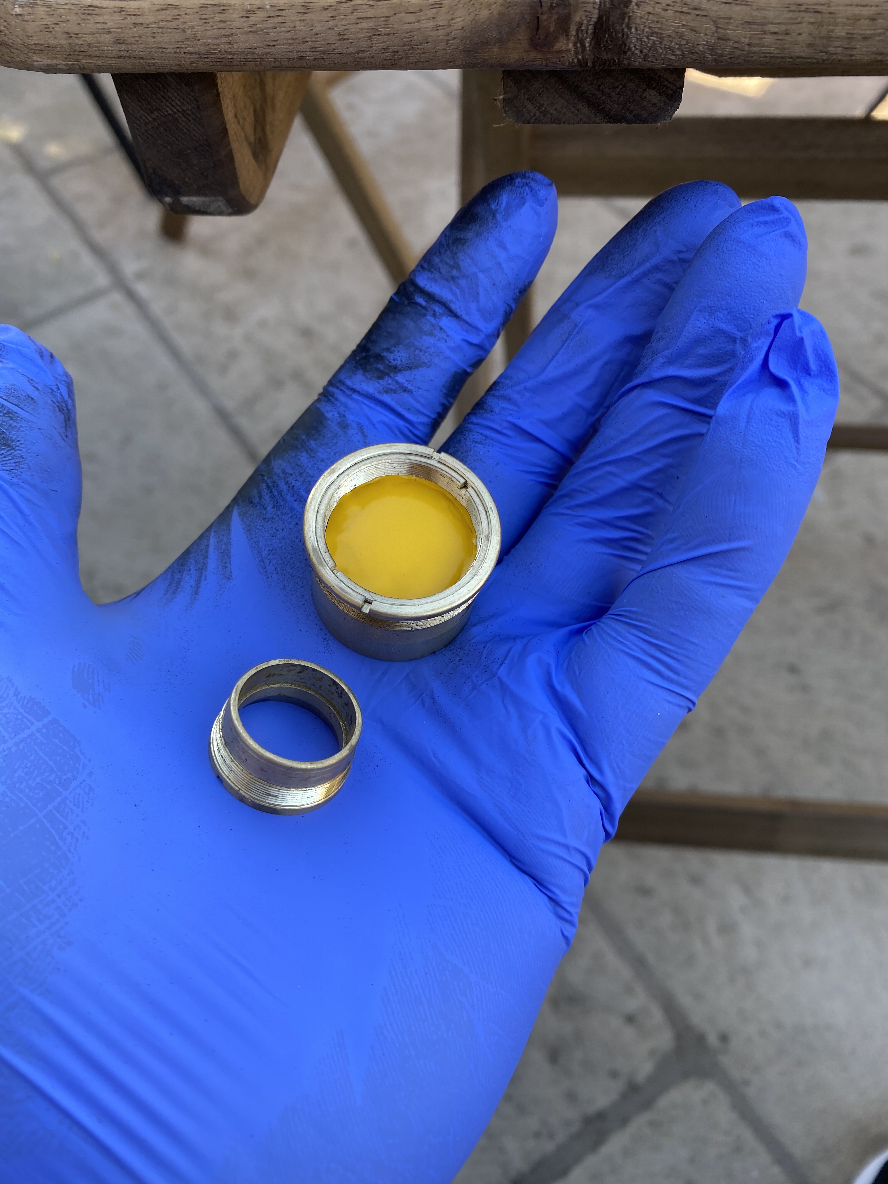

Went ahead and blued the lower as well before painting. Had to remove a bit of material from the heat sink greeblie for the mount screws to sit flush to the lower. Dremmel handled it easy enough. I actually kind of like the banged up look after.

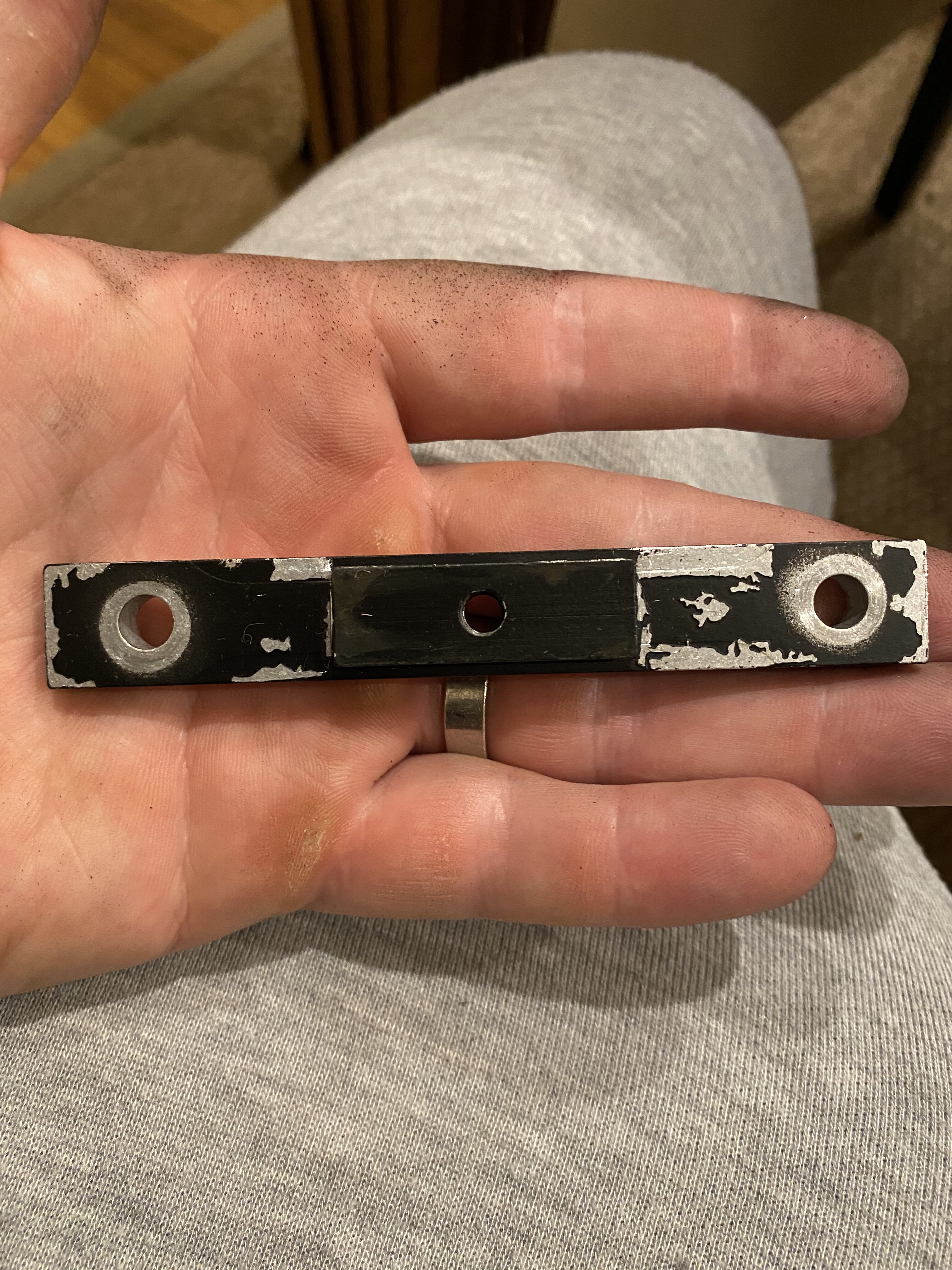

After that I added the scottjua stencil on the scope mount. I am truly awful at decals/stencils like this so it’s far from perfect application. I figure I will go back and scratch off anything else that needs it.
I decided to glue on (then mask off) the mystery disc greeblie, I’m not sure what’s considered accurate on this one as you could probably just mask off the area and leave it bright steel. To me it felt more “in universe” to have something be a separate piece and give it a bit of dimension.
Finally lower and mount get hit with a few passes of flat black. Along with the brass scope pieces.
Next step is weathering of the grips. I’m also still trying to figure out if the scope holder is blued or painted. Hard to tell from reference photos. If any one has thoughts on that they are more than welcome...

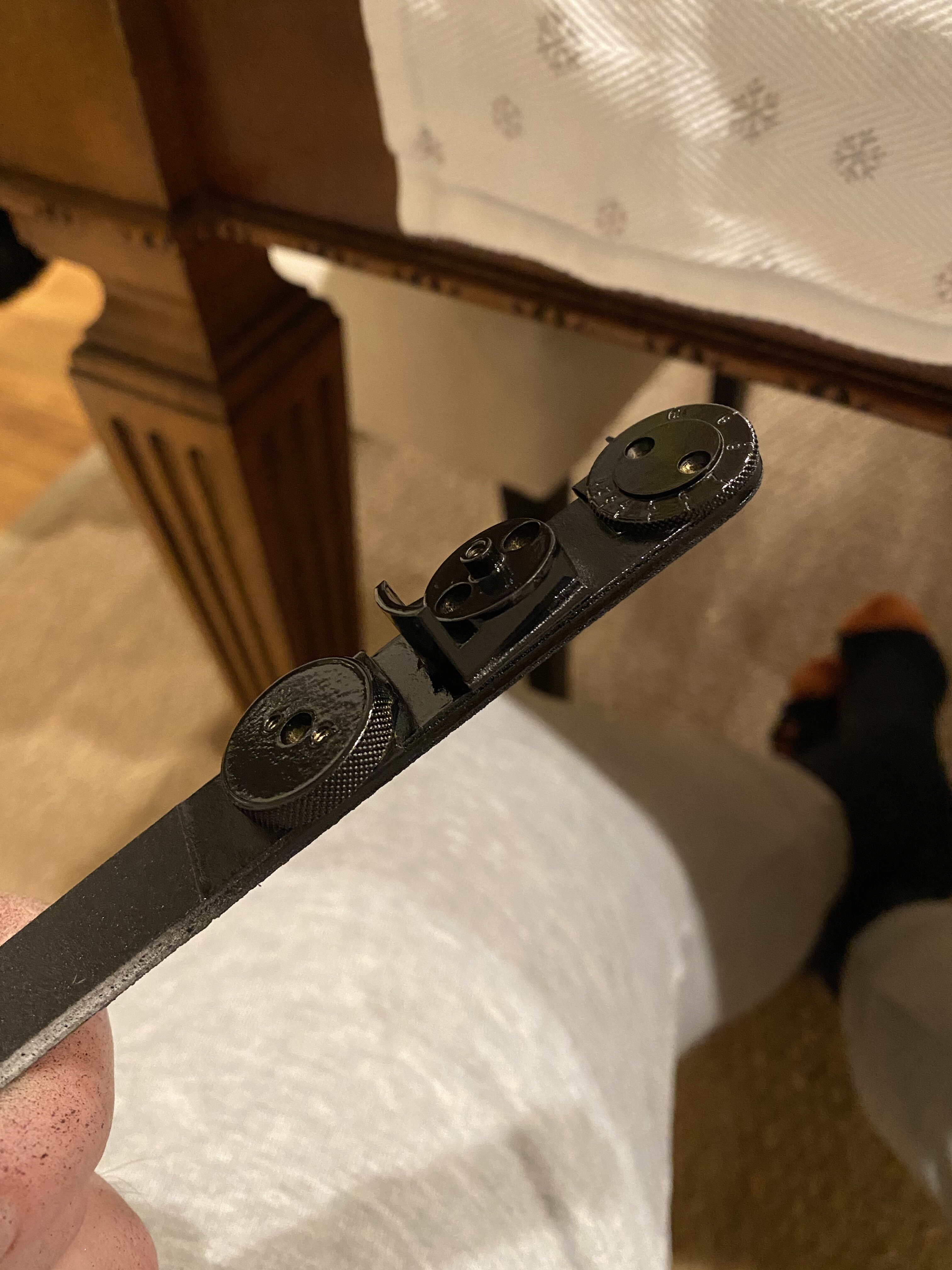

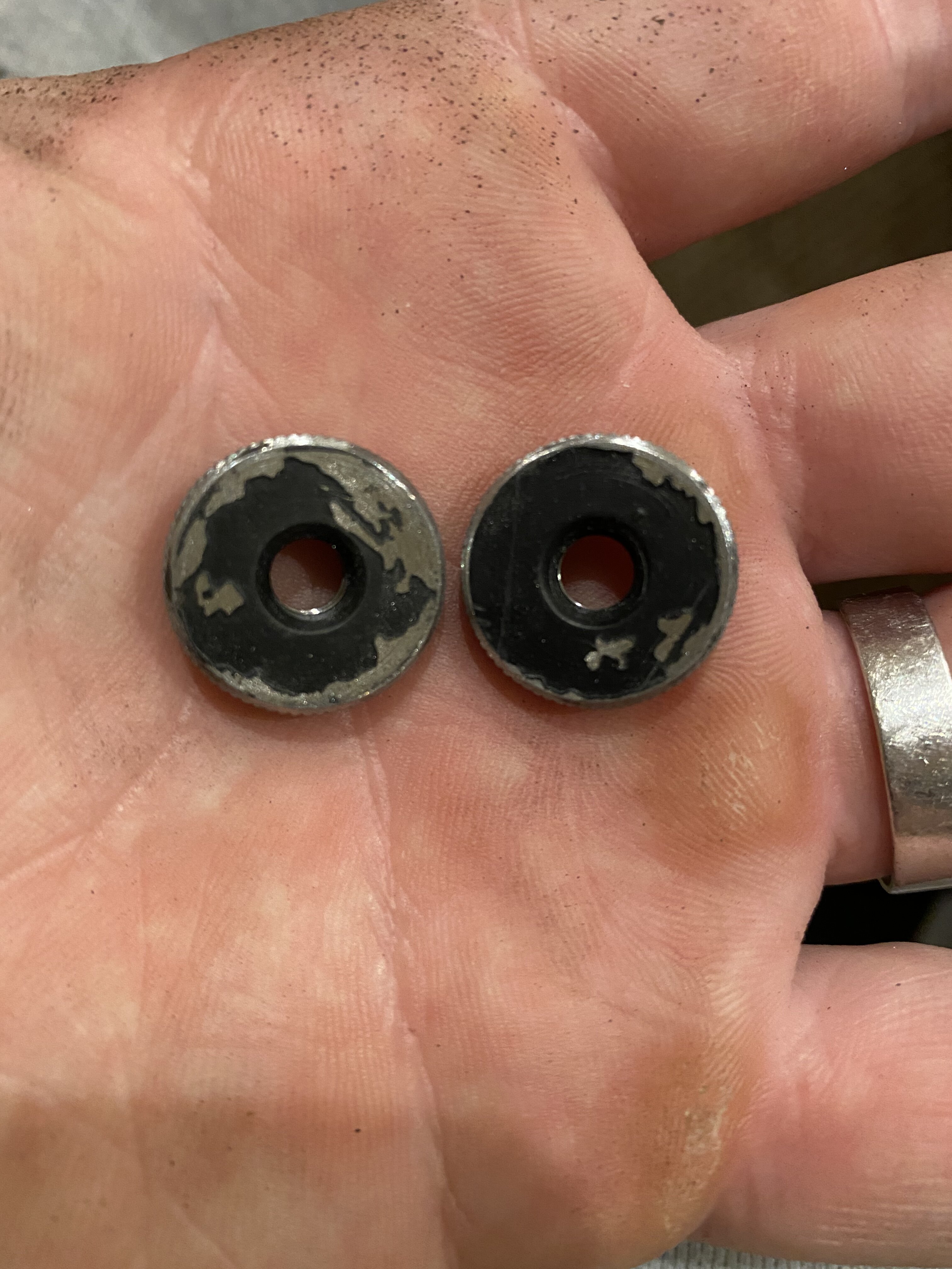

Some small build updates:
Started a bit of grip weathering, cutting in the scratches and just generally banging up the grips a bit. Definitely not exact to the scratches on the hero. But a solid a approximation I think.
Painted the scope dial pieces. Did a bit of weathering on the scope holder, mount and screws. Planning on heat bluing some of the small parts this weekend.

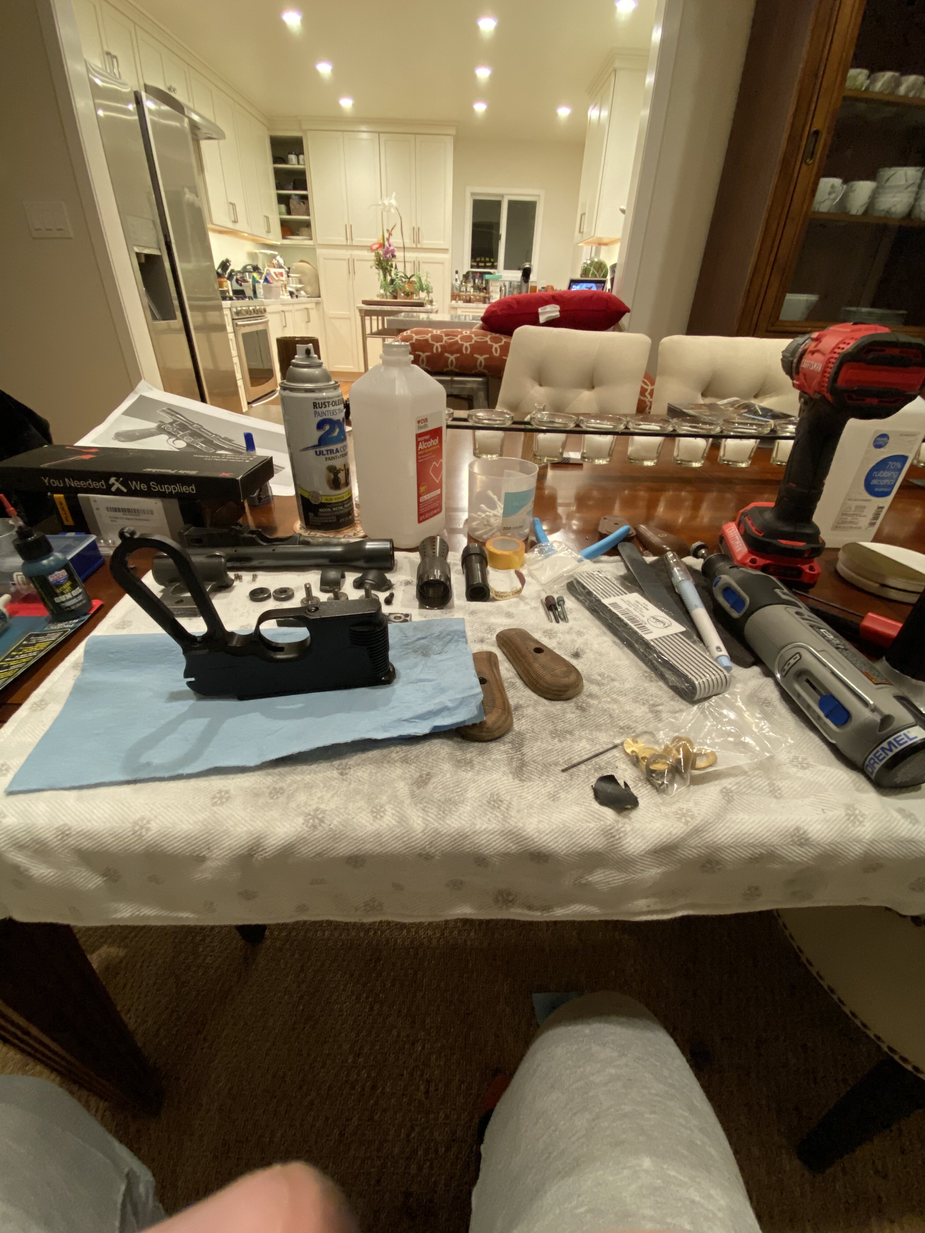

You’re a brave man for doing that work inside on the kitchen table...lol.

Haha Really just the light sanding, weathering, and assembly happens at the table so I can hang out with my wife while I do it. Everything else happens outside or in the shop downstairs. It is a steel barrel, Ive been asking around people I know for any connections on a drill press haha also exploring maybe getting one as it would be useful and Ive been making some shop upgrades. Youre right that it would need to be a pretty large press though.
