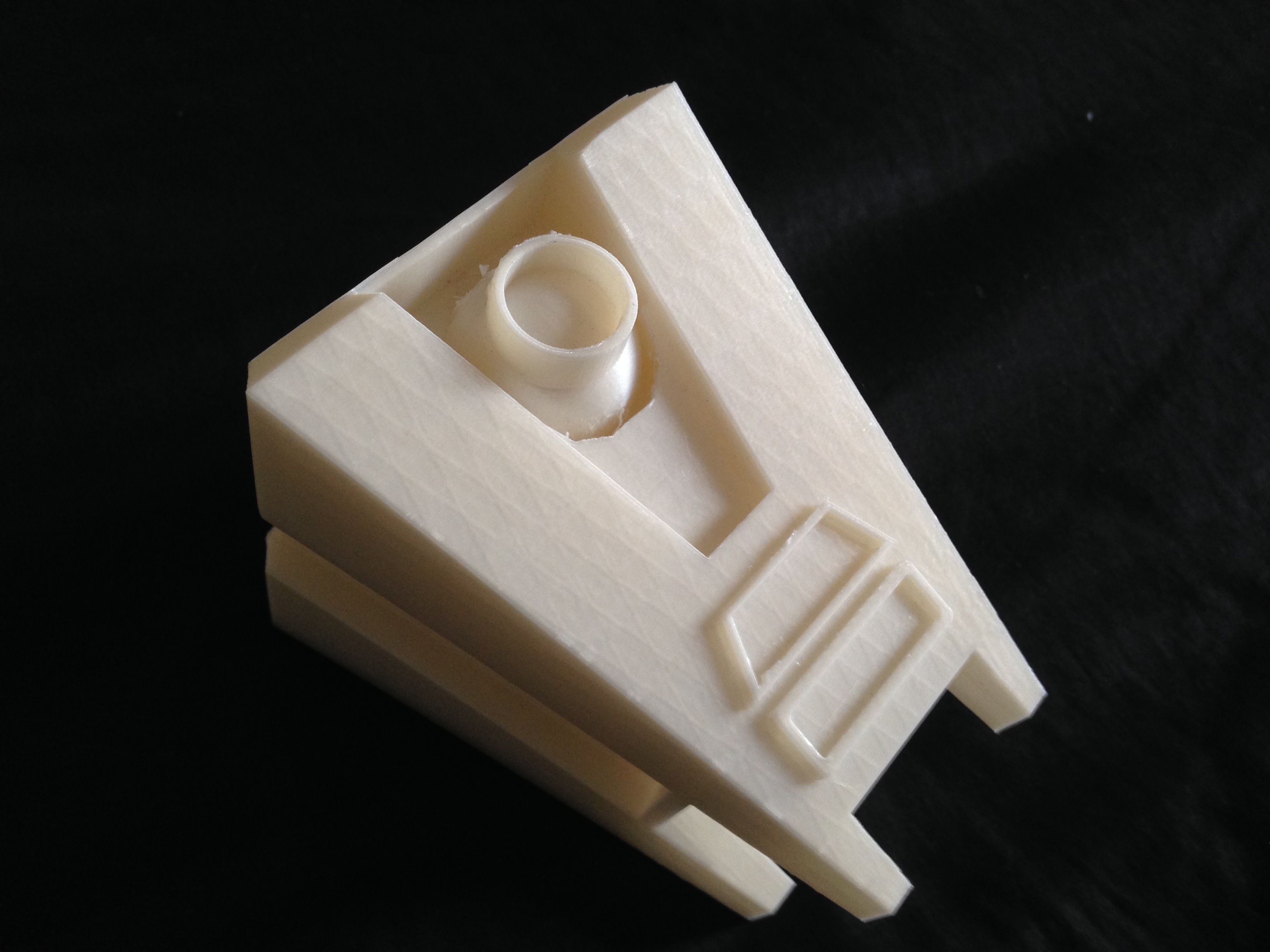

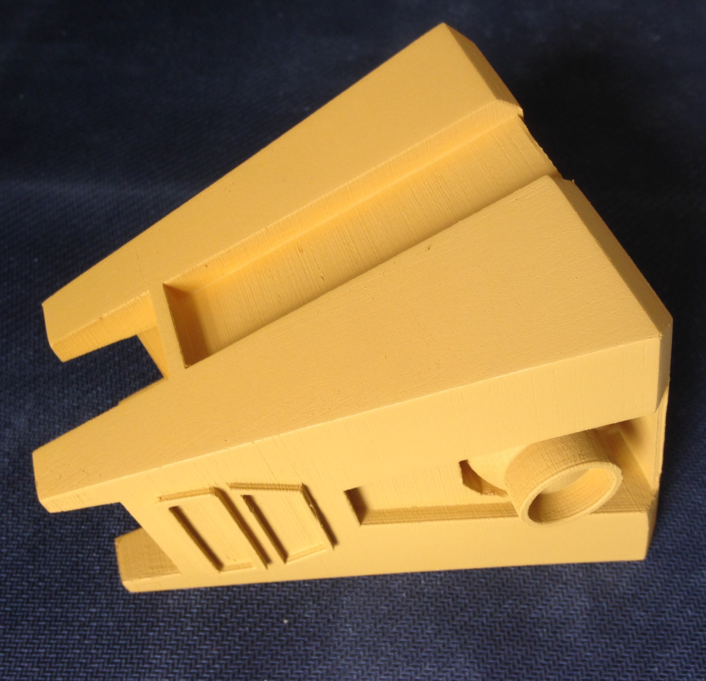

Here's the 3D print, untouched and only support structure has been cleaned up. He's missing a ton of parts (again, this was just a test model) but I can fabricate them well enough. He was printed at roughly 1/10 scale (I never quite nailed his 1:1 size) out of PLA.

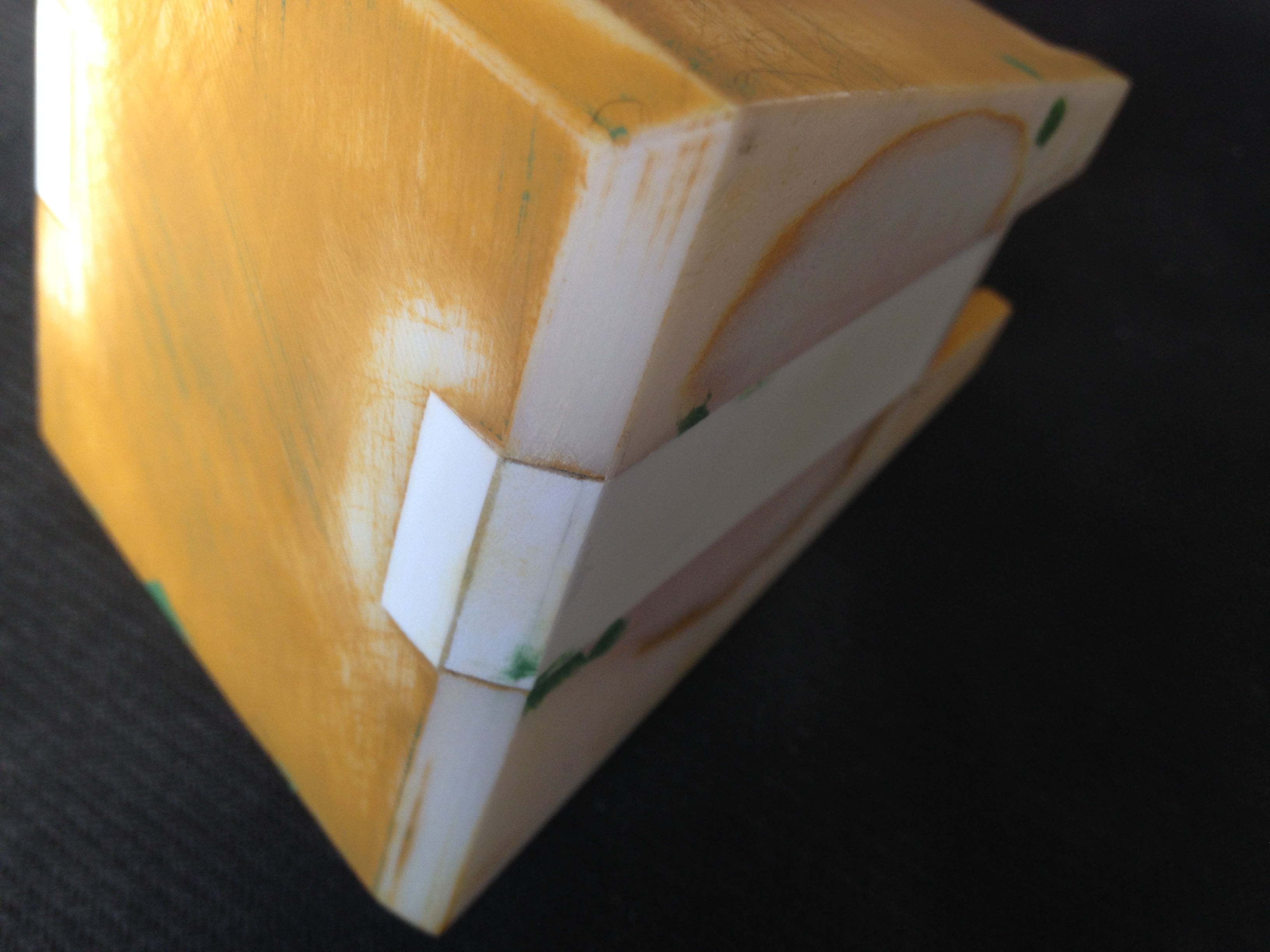

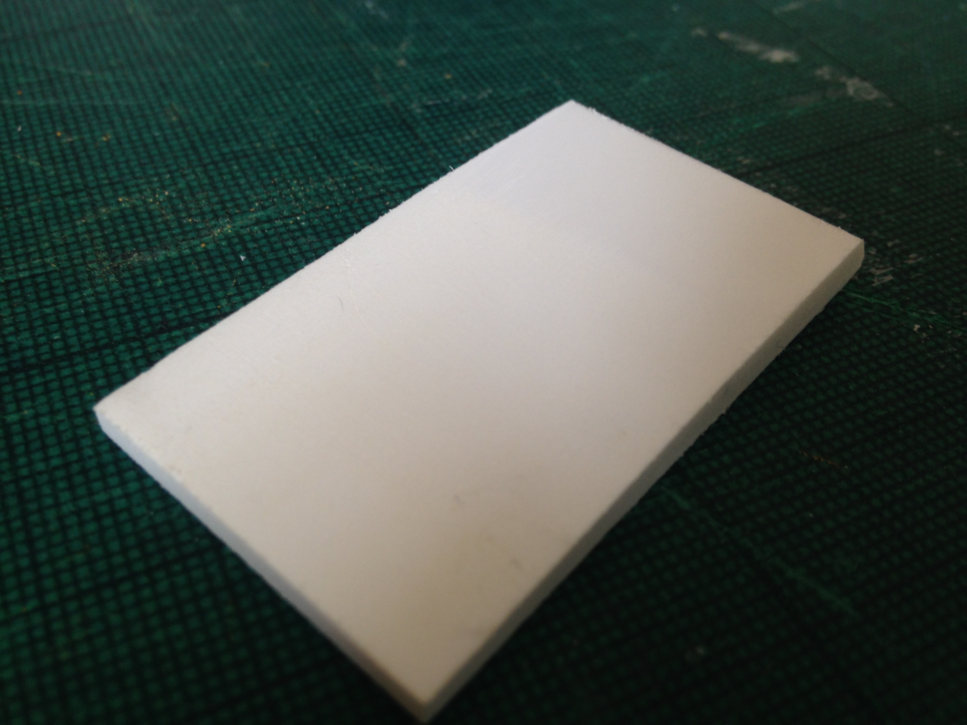

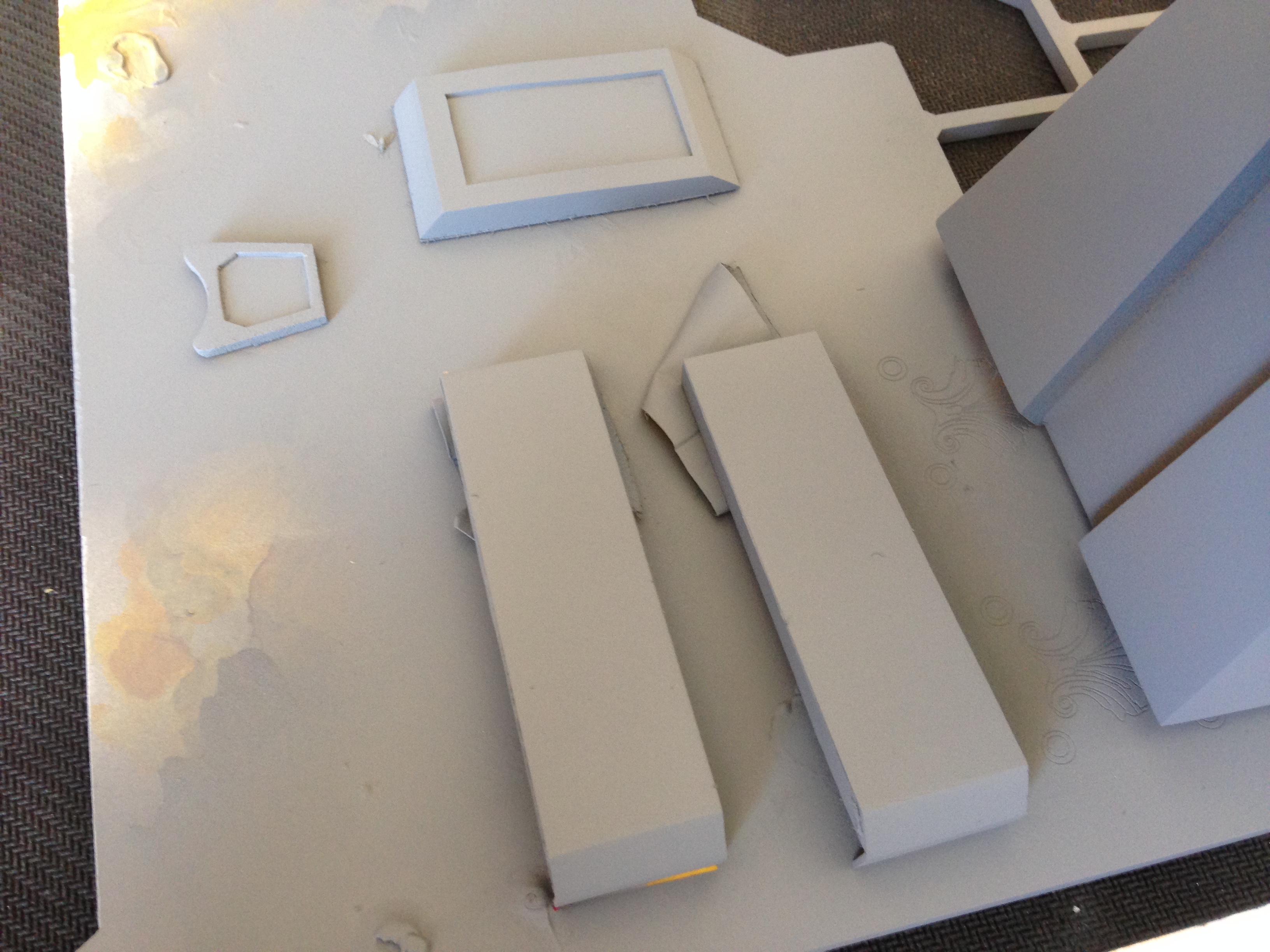

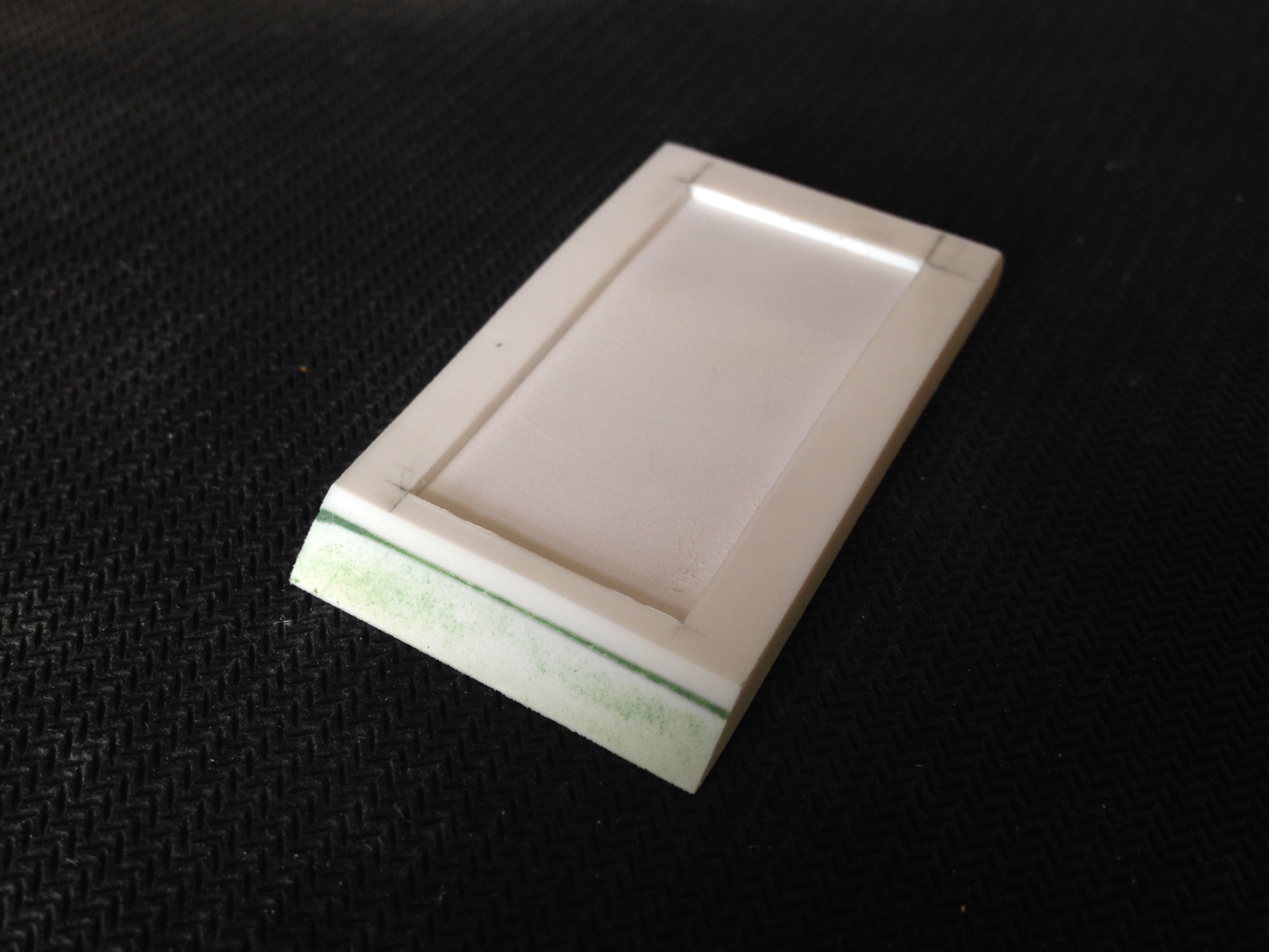

More stuff! The side skirts are made from 2mm SIntra. An advantage to using Sintra this thin is it carves away with no resistance, no need to score and snap like Styrene.

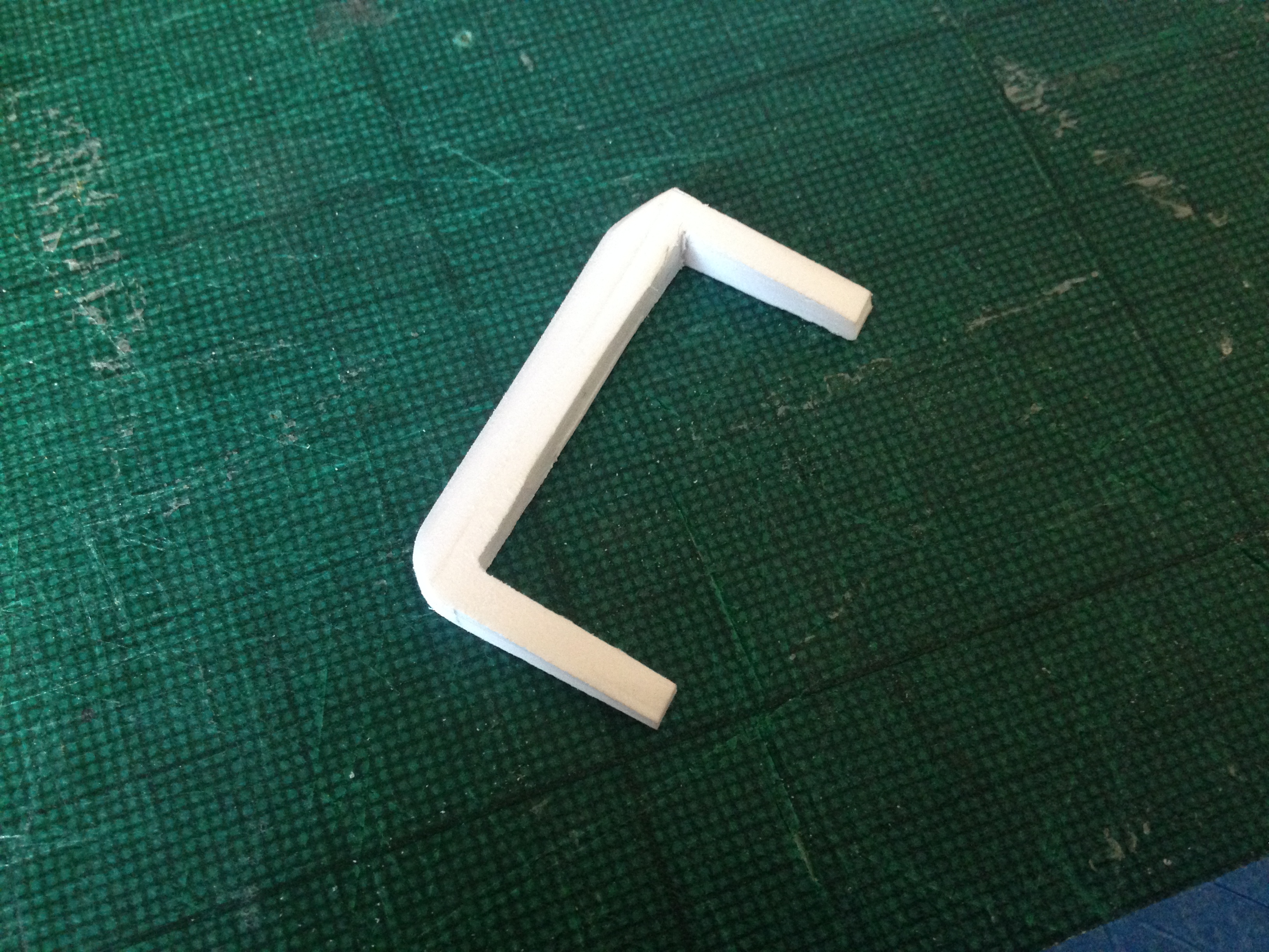

The top box/grill/vent thingy was made with more 5mm Sintra as a base. This piece has a gradual taper, so I carefully trimmed off as much as I can with a utility knife and cleaned up with sandpaper. On top of that I made a 1mm Styrene window thingy to add wall thickness to the top. This area has a row of vents but I'm skipping that; they are way too small to make well by hand :lol

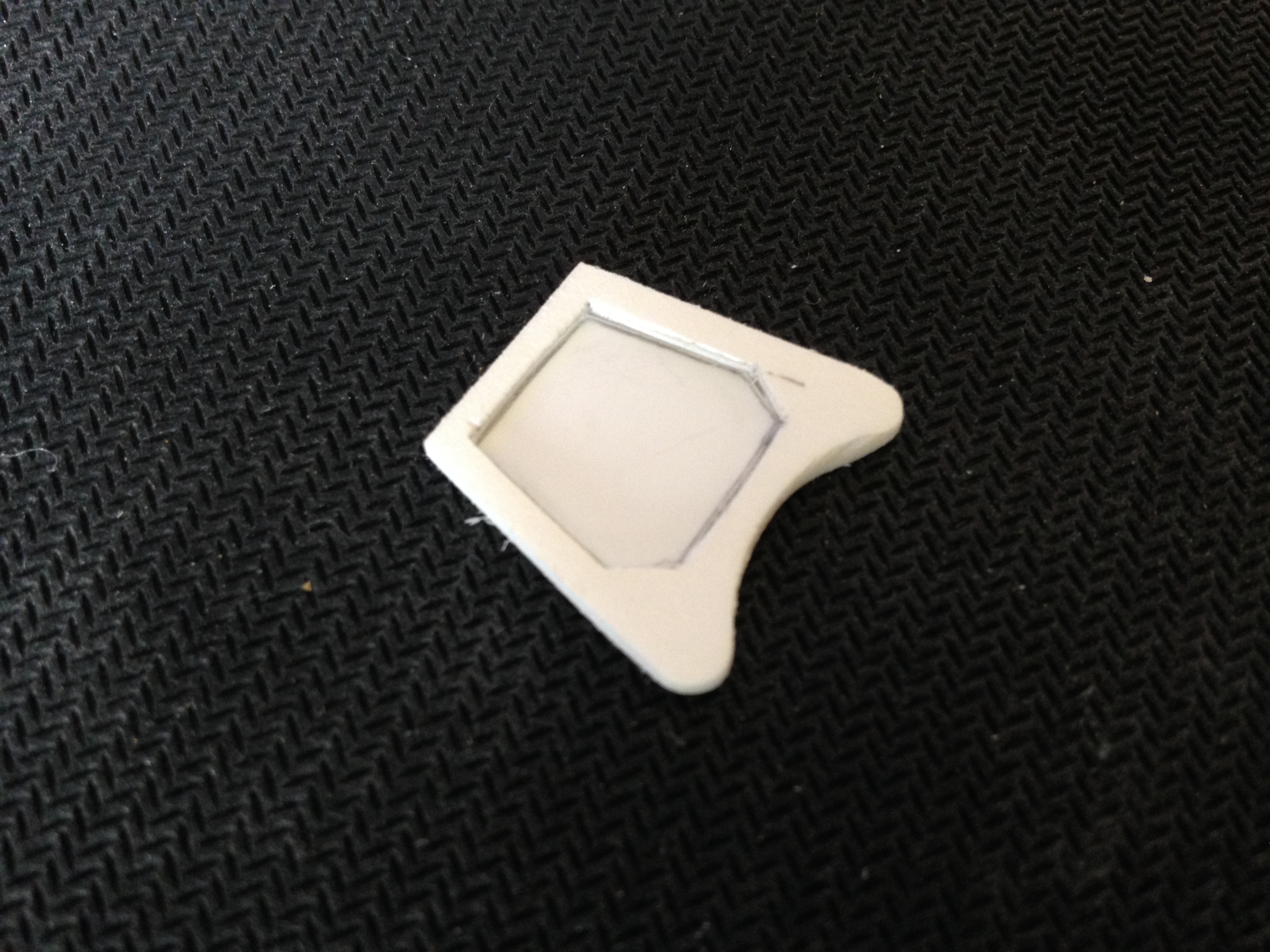

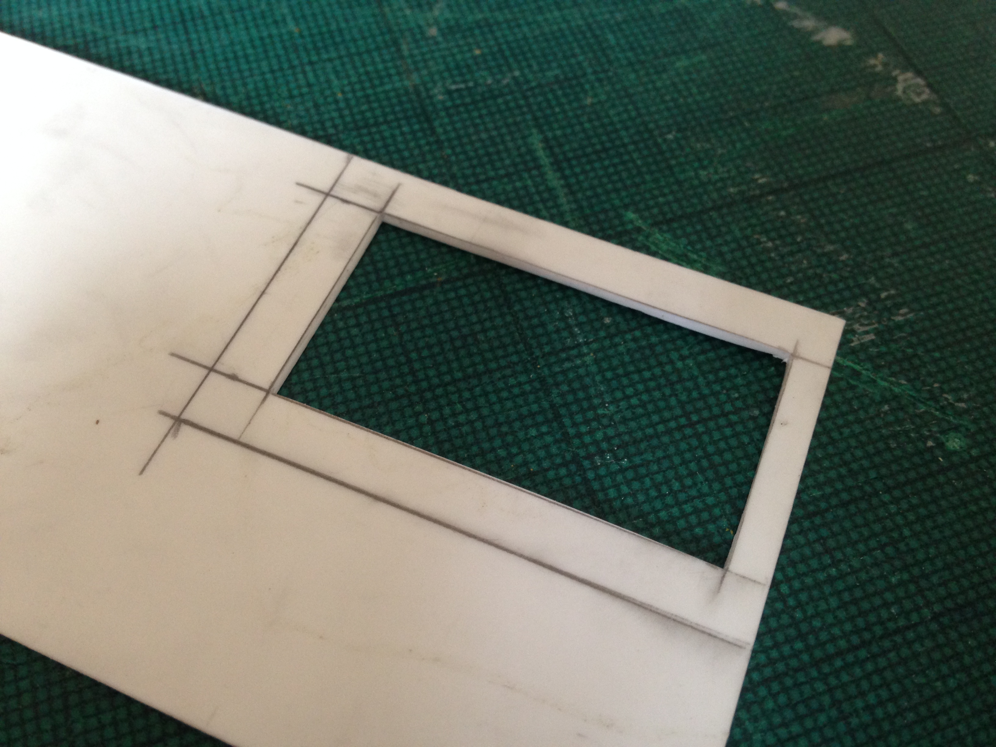

The next piece is a real pain at this size. I used more of that 2mm Sintra to cut a frame and wedged a piece of 1mm in the centre. Again, this insert has a row of vents but I'm skipping them.

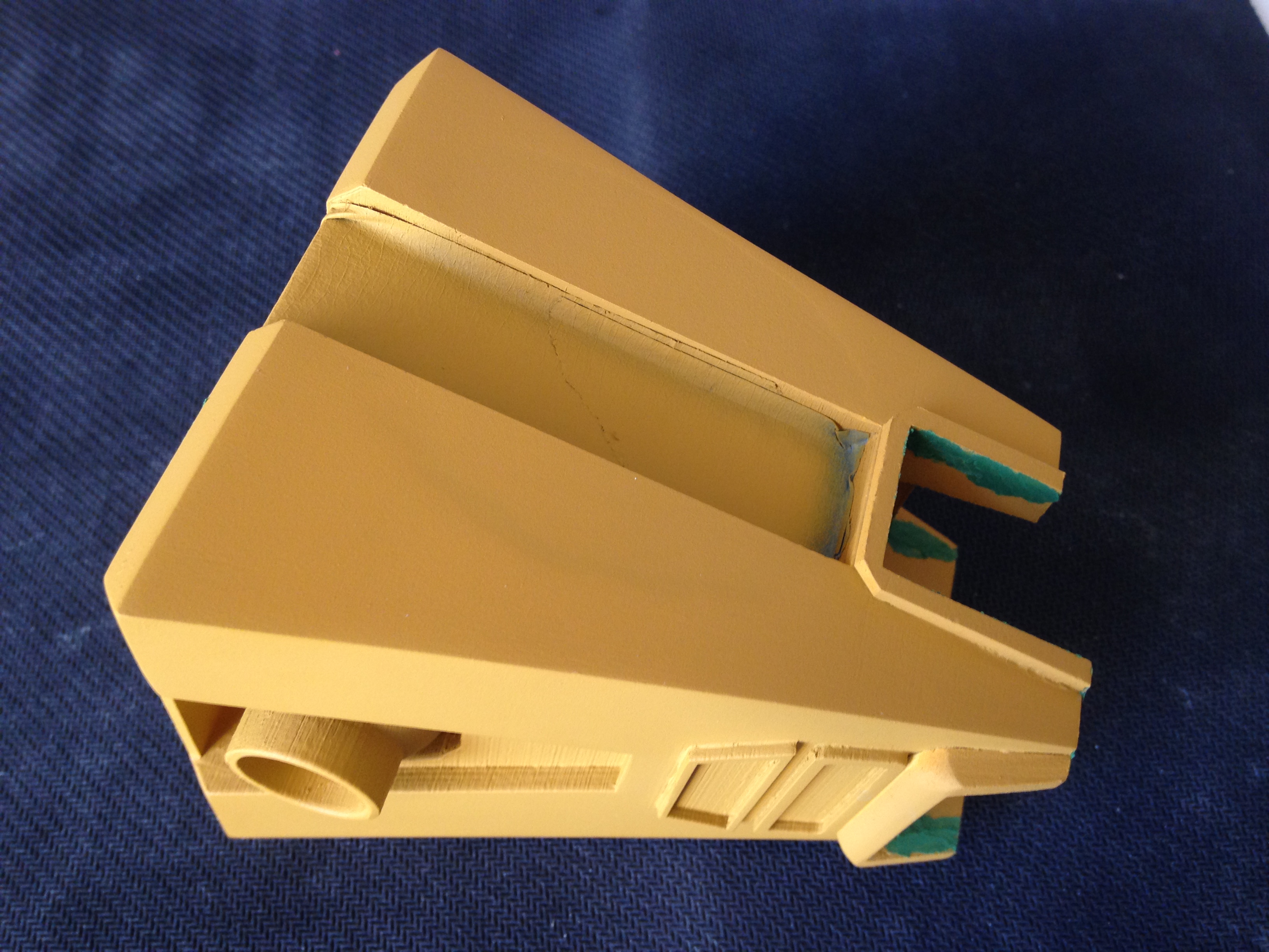

Same as the front mudguard, I made the back with once again, 5mm Sintra. Same procedure: Pre shaped, outline cut, glued on, further shaped, edges blended, bada boom.
That's almost all parts done! The front tab still needs making and I'm debating this piece on the lower back whether I should bother making it at this scale; tiny plastic parts are not fun to work with by hand!

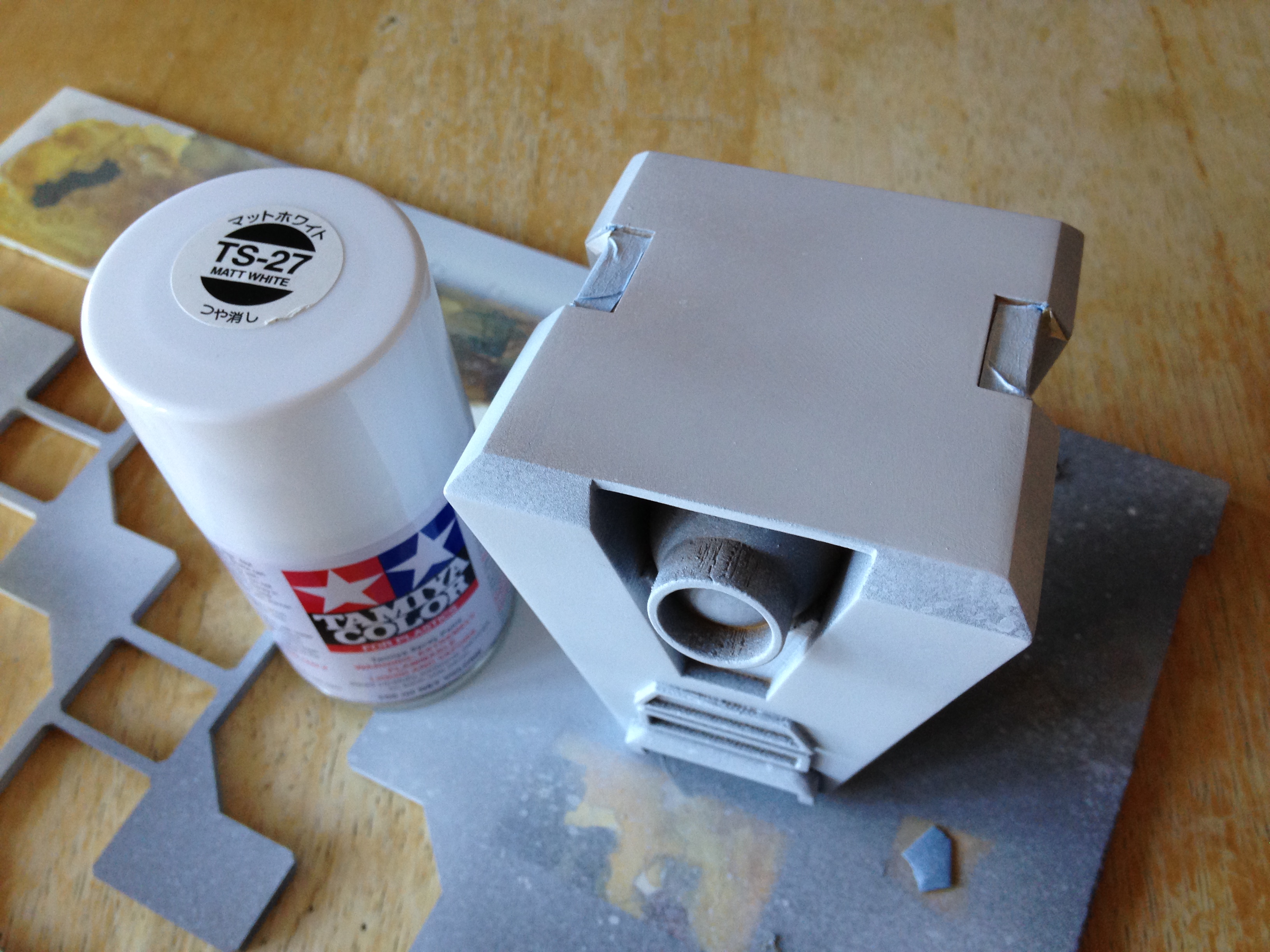

It's been hot as balls in England for the past couple days so I've been recharging in the sun and throwing paint here and there, but before I started on main paint he needed re-priming.

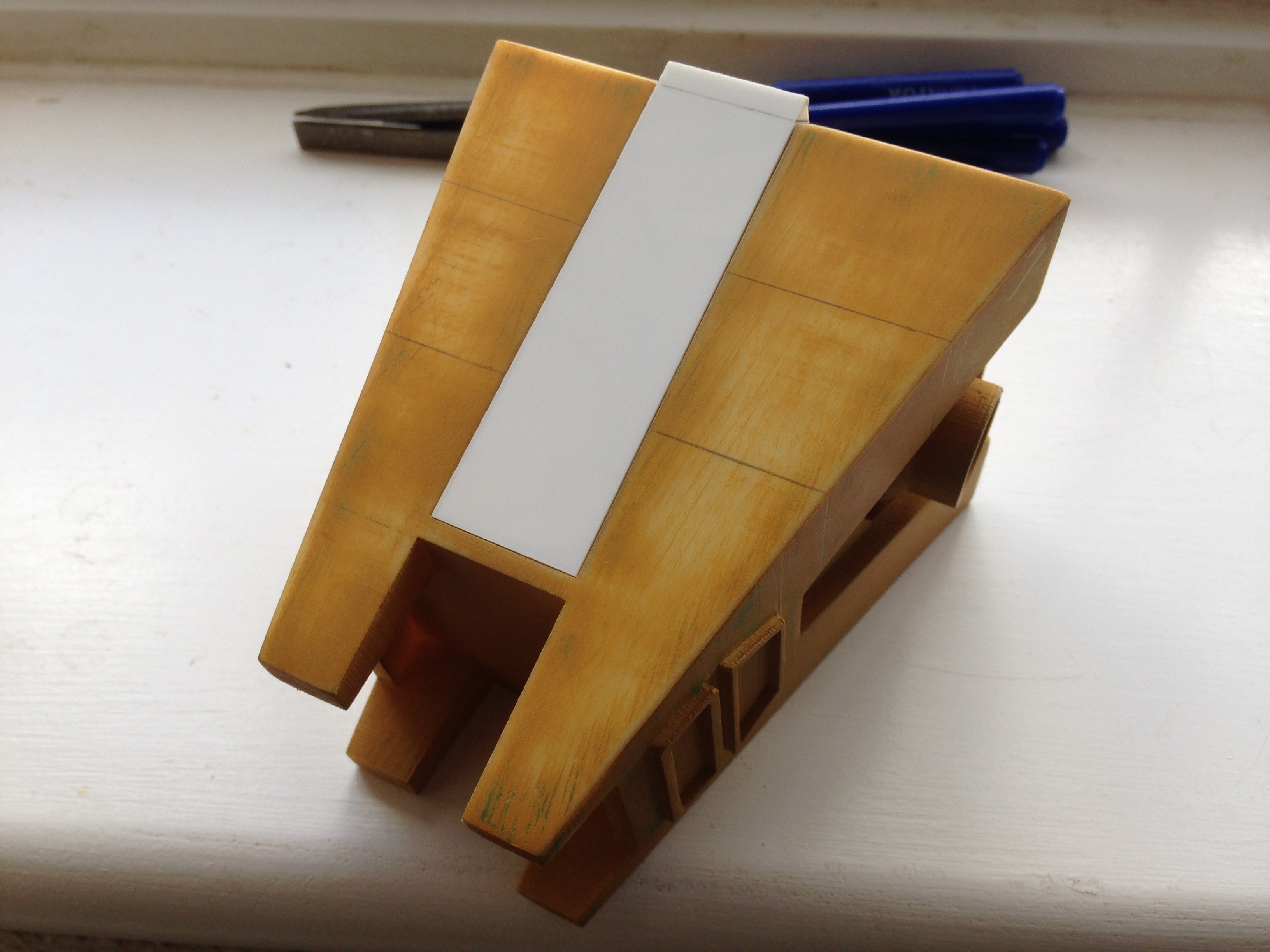

If you wanna paint anything yellow (and there's a lotta yellow here) a white base coat is your one stop shop. Lucky for me, I had some lovely Tamiya spray to base coat with. I intentionally under sprayed the white, leaving just some of the grey primer peeking through; this will leave a nice effect for the stripe.

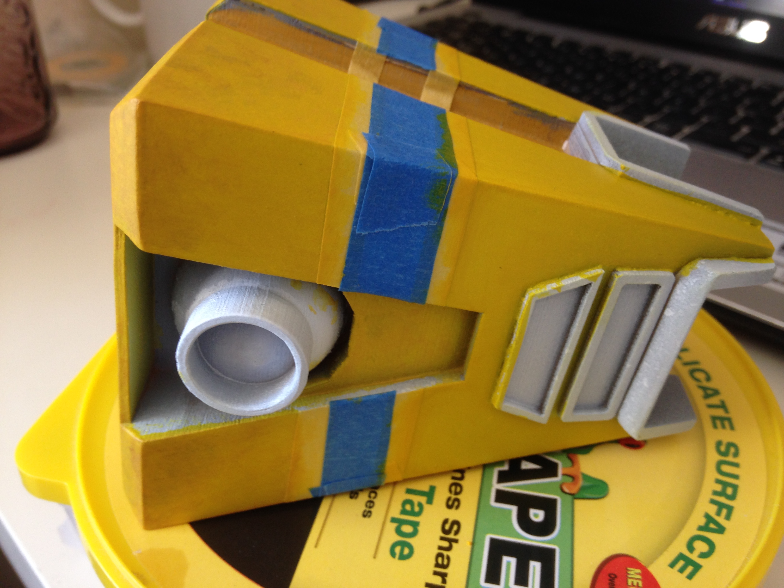

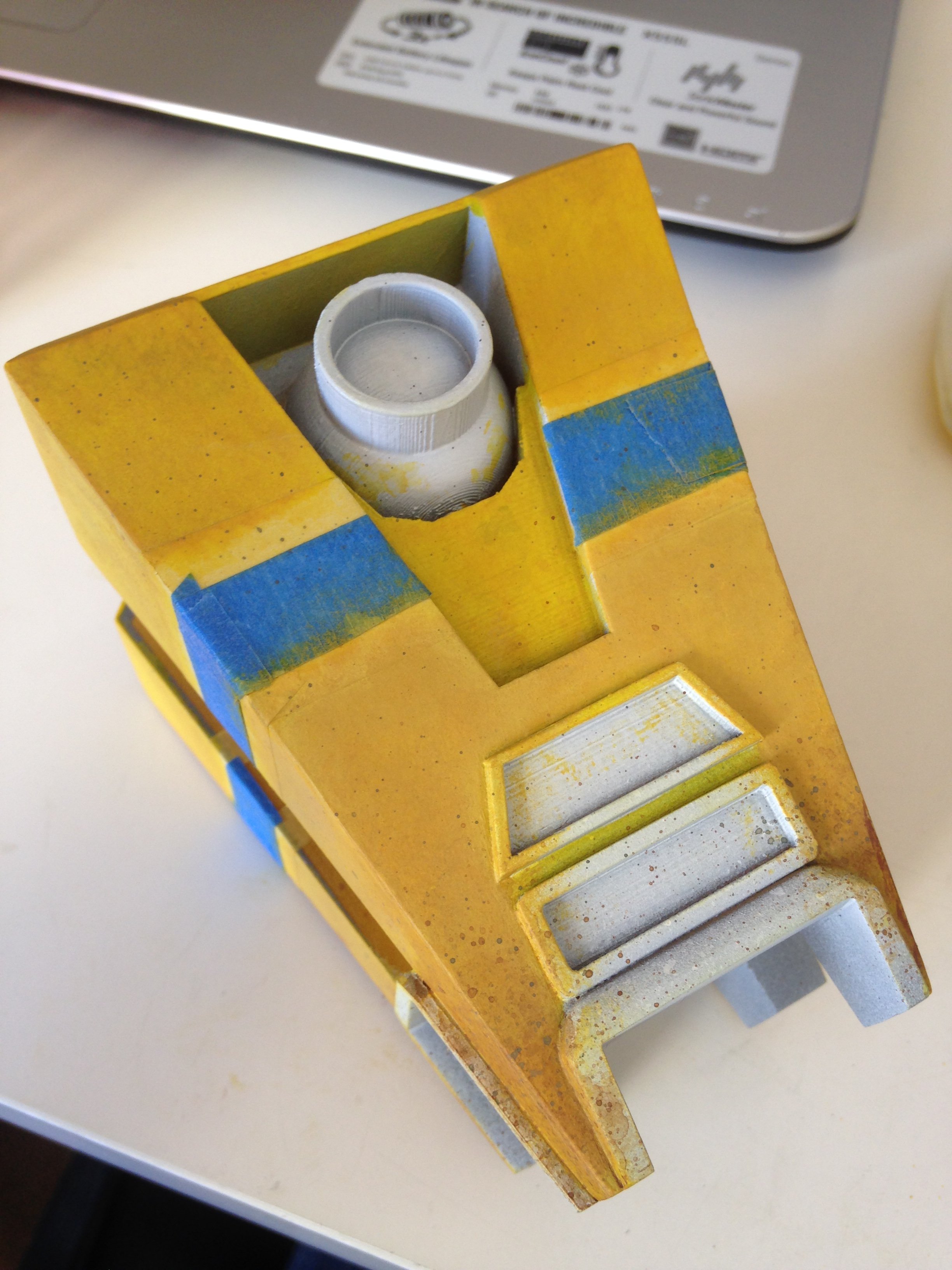

If you look carefully at Claptrap, he has tons of colour on him so my approach was to do lots of thin washes with slight variations of yellow. The stripe and the black outline were taped off.
For extra variation, I splattered light drops of brown, grey and white around Claptrap, focusing on the feet. Over time I built up the brown around the feet; he kicks up a lotta crap in the wastes of Pandora.

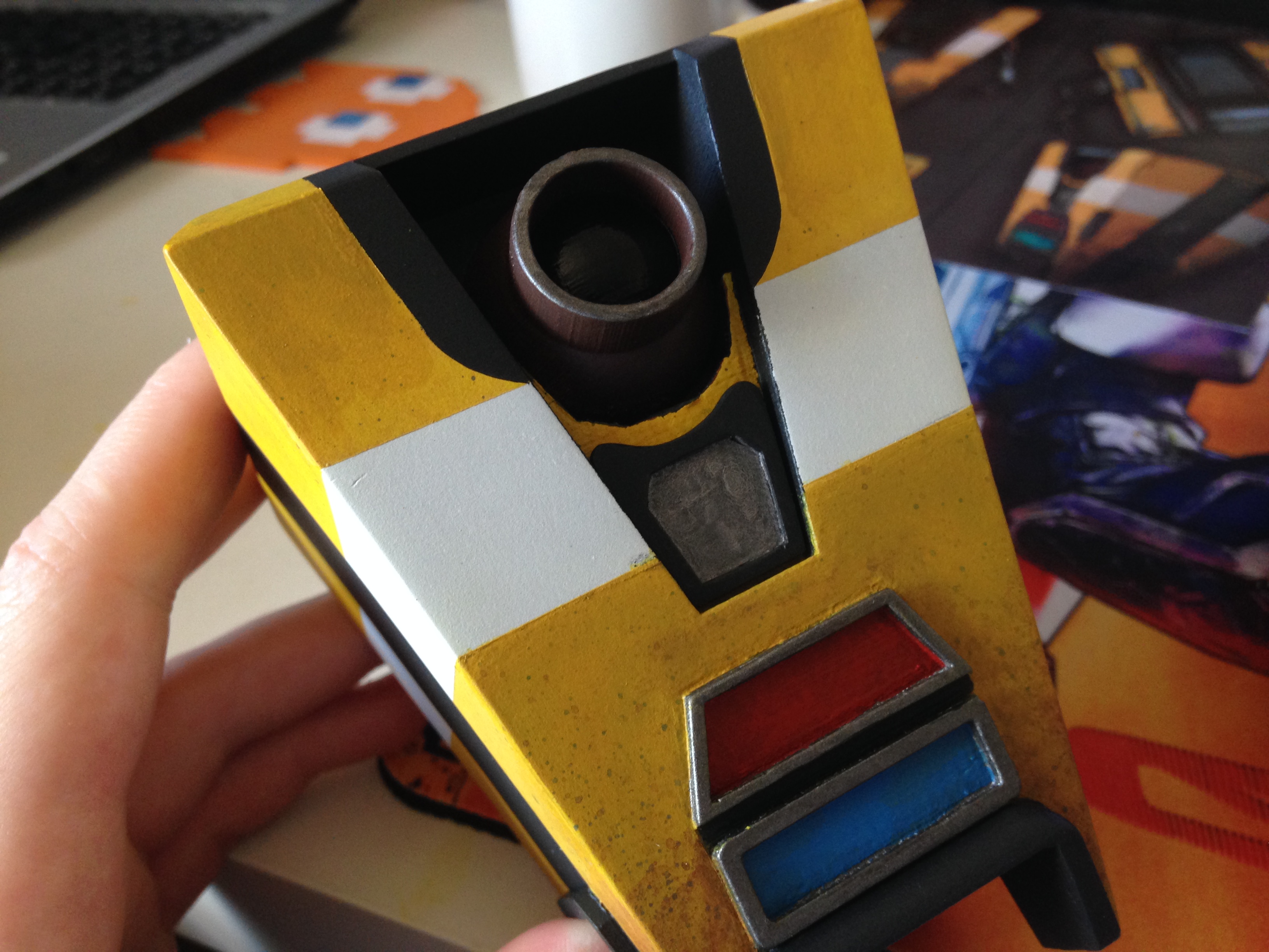

After painting the front of Claptrap, I kinda screwed up and the black paint seeped under the tape... It was a mess, so I had to repaint the bottom half of the front... again. It doesn't look that much different which is suppose to be a good thing, but man it took some time to get it right again. This is the reason why it's been 4 days instead of 1. :facepalm Oh yeah and I stuck all the odd bits on.
For the labels, I just went with a coat of blue and red. I may print the graphics at a tiny size and overlay them, but that's just something I'm not fussed with at this time. I painted the eye a glossy black, trying to emulate a reflective lens, though like the labels I may come back to it and tweak it; I'm not 100% on the final outcome.

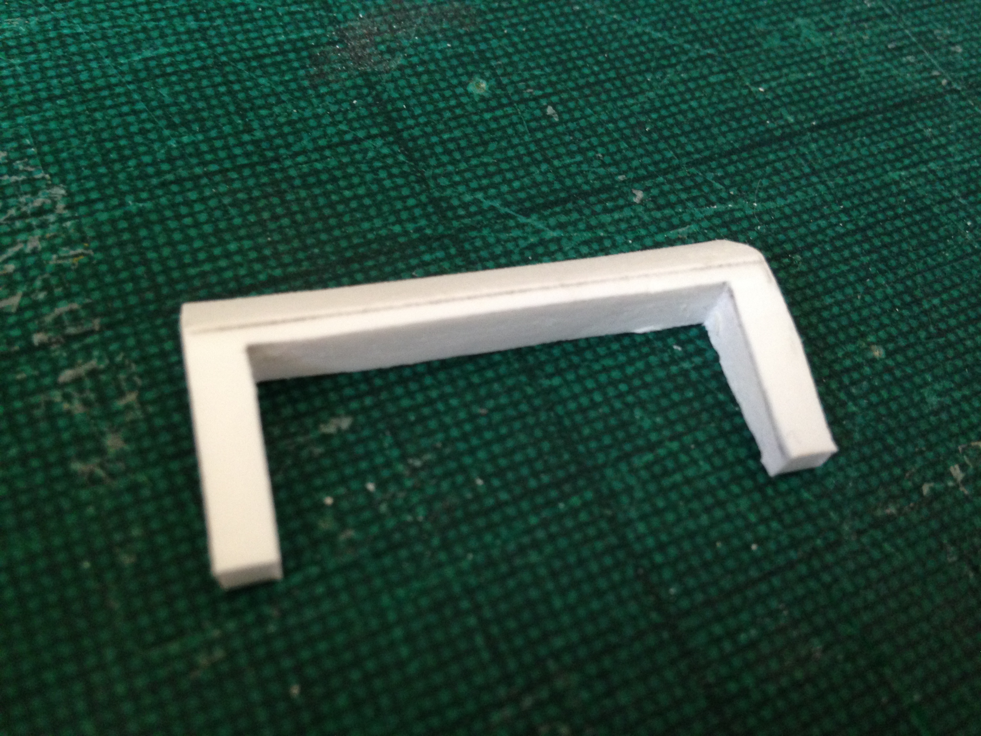

The last piece for this was the front tab. I had thought about adding it earlier before painting but I wanted that area open to paint around the base of the eye. I made the tab with good 'ol styrene, scraped the edge with a blade to get a bevel, glued it on, blended the seam with more paint and recoated with clear. Came out pretty decent.
And for kicks, here's a snazzy pic of Claptrap altogether.
