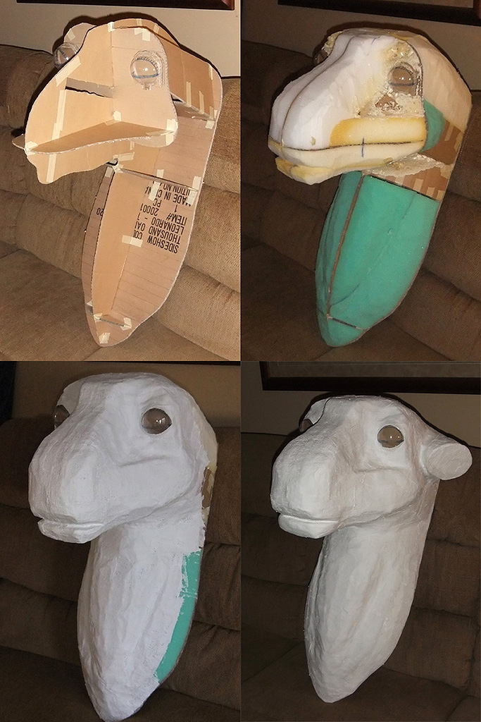

That would be awesome! Here is a link to my sculpting page that shows most of the steps I used to make my 1/4 sculptif that helps: The Dragons Den

Thanks, I've actually been using the first picture on your page the scaled drawing in photoshop to make a template for printing out and transferring onto card.
I did a search expecting it to be in vain as I didn't think anyone else would have tried a 1/4 Tauntaun but was pleasantly surprised that not only had you started one but it was also in scale for the exact figure I was using.
My plan is to make a rough figure copying your cardboard idea, the sculpt won't be anywhere near as detailed as yours it will be more like yours in the plaster/bandage stage but I will add the more prominent muscle shapes which will show through the faux fur but not tons of detailing. I'll be sure to post a thread on it if it actually works!
Glad my drawing is helpful. I combines features of both the stopmotion and full size prop to come up with that. The only difference i my finished sculpt is I shortened the feet and lowered the neck.
If you are going to use fake fur I would sugest trimming off an inch on all sides of teh cardbaord to allow for plaster bandage and fur otherwise he will end up looking way too fat/foofy.

Not sure how I'm going about it yet I've cut all the cardboard and losely tapes it together today will give it all a trim tomorrow. I was possibly thinking of doing what you did and building with the plaster bandages or bulking the cardboard frame out with just air dry clay or foil with air dry clay on top. As I say never tried sculpting anything before so looking into different methods and trying to see what would be easiest.
I was possibly thinking of doing what you did and building with the plaster bandages or bulking the cardboard frame out with just air dry clay or foil...
I do all my bulking with foam (you can buy chunks and sheets at Walmart). It's fast and easy and you can even sculpt the foam with a sharp knife or scisors:
that makes sense and i guess will also stop it being overly heavy. I'll see if I can find a similar type of foam in the UK.
