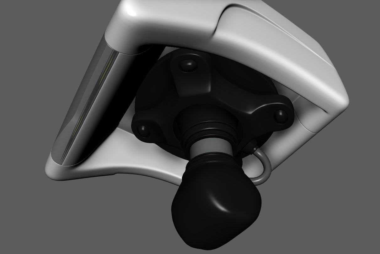

Not that you ever see the underside of the head, but this is what the attachment frame looks like for the head/Neck joint
cheers
Michael
Thanks thats really usefull. Quite a complicated shape for a part you don't see that much. Not sure if it's worth it to try and replicate that or not. But thanks anyway.

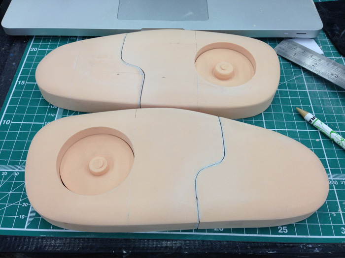

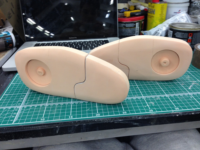

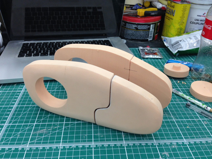

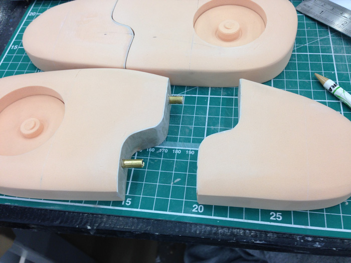

I've done some work on the arms. Went for the heavy orange chemiwood rather than the green like I did for the body.
Made them so it's two pieces. Later If want to build the bit which extends them I can.
attachment.php
attachment.php
attachment.php
attachment.php

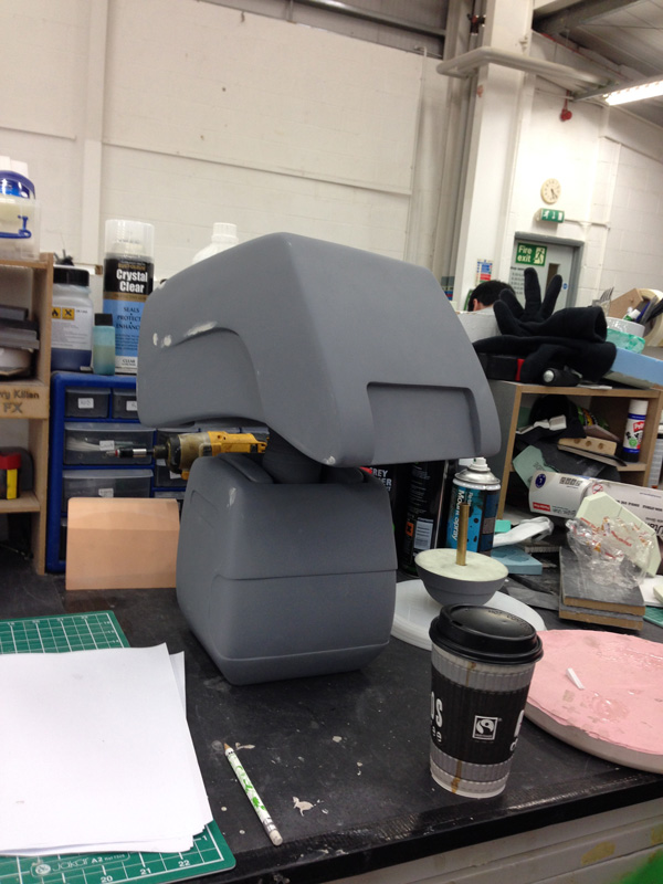

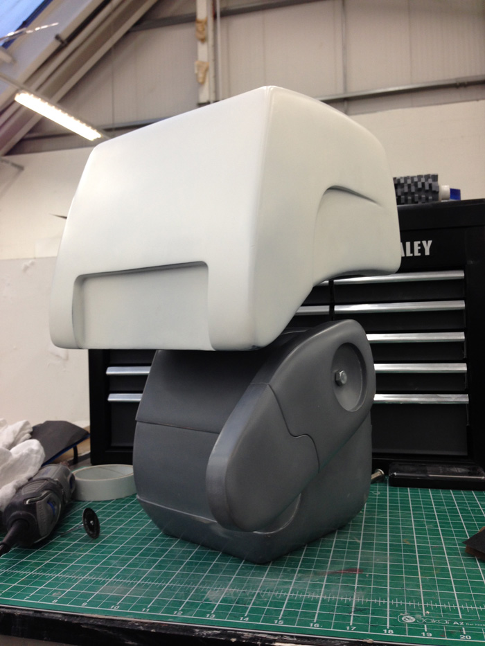

Been a while since I updated. I've made some good progress now. M-O now has a head, body and neck.
attachment.php
The designed a joint so the head can tilted and rotated, for posing and such.
attachment.php
attachment.php
Next up is to fix the arms on and figure a way to affix his watertank/backpack thing.

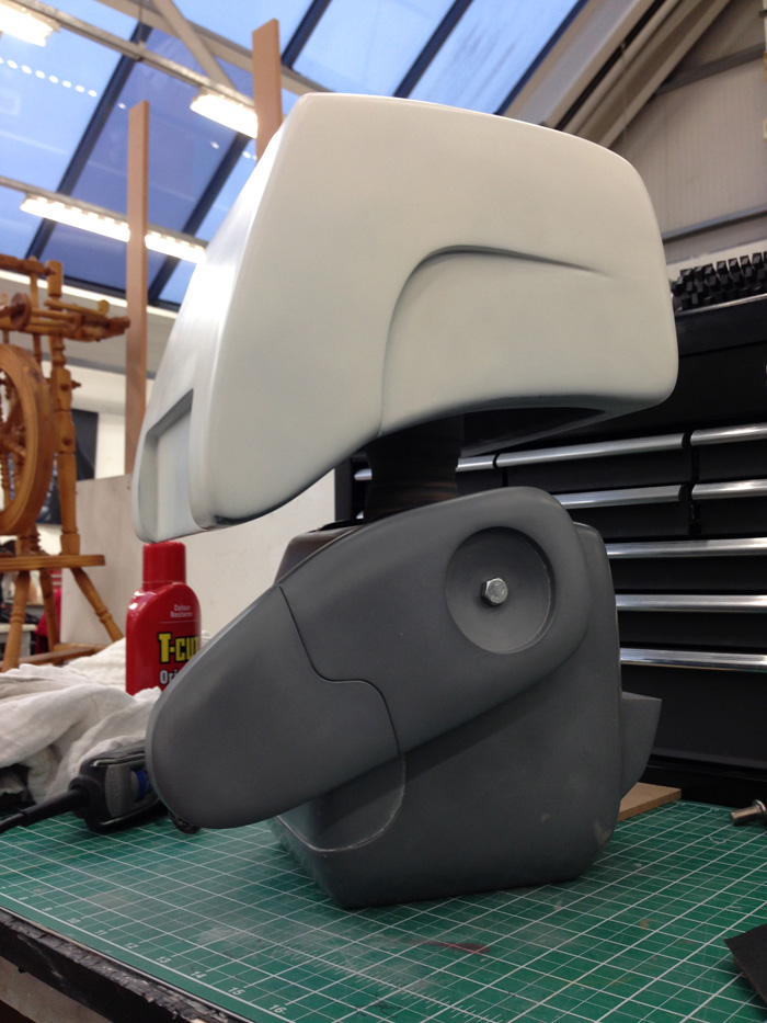

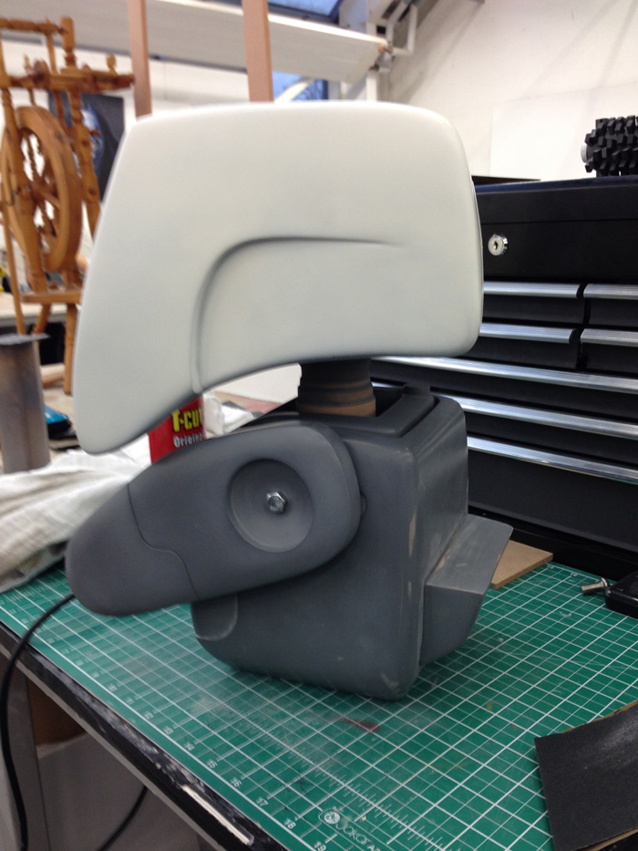

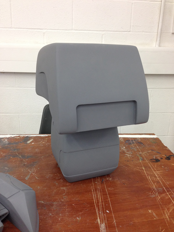

A little more progress. The head has had a coat of white primer and one of the arms has had it's final coat of grey. The other arm still needs quite a bit of work.
attachment.php
attachment.php
The little piece on his back here will be the water level in his backpack. So it will look about 35% full.
attachment.php
