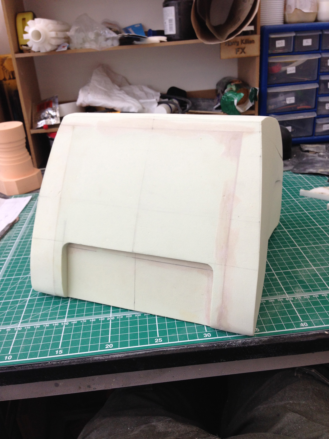

Ive been working the last few weeks on a 1:1 scale M-O(Microbe Obliterator). He's the little guy that chases wall-e around cleaning up after him.
attachment.php

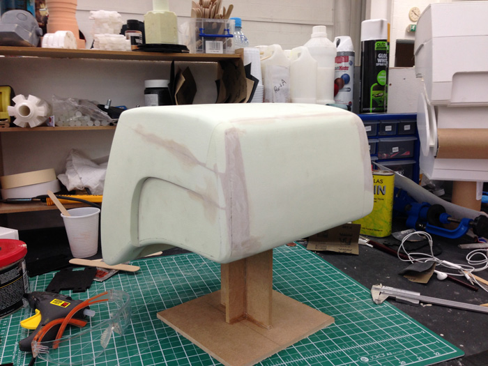

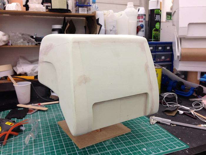

Ive done all the design work in autocad. I then split it into sections which I made individually with chemiwood and stuck them together.

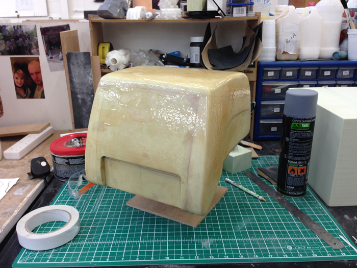

Then coated the chemiwood with polyurethane resin. Next is to sand this back so it's smooth.
