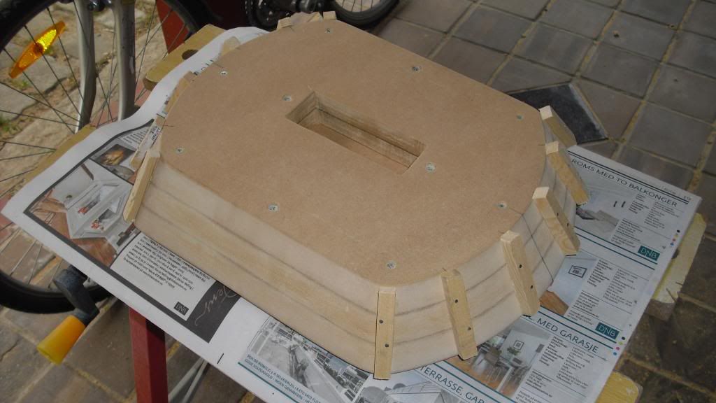

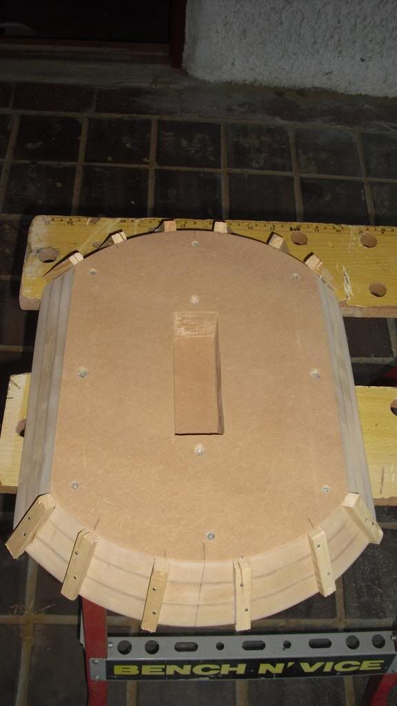

I ended up playing company of heroes 2 a couple of days instead of working on the R2, but the skirt is finally done! Painting can start tomorrow.
The pictures are dark because of the blitz, dunno why. The pictures get a better quality with the blitz, despite the suddenly occurring darkness.

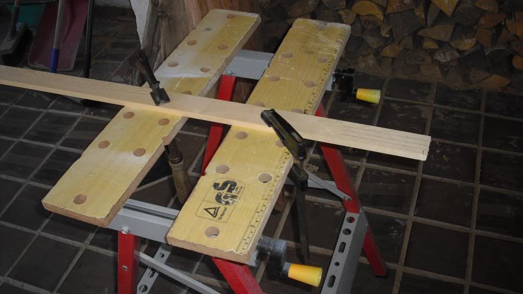

Half of them cracked before I found out how to no it without getting the cracks..
Looking good enough for me. :)
Re: 1:1 R2D2 homemade scratch build
Looks great so far - remember - pre-dill the holes to avoid cracking :)
Then again, wood glue w/o any nails or screws should be enough to keep them in place.
I will try to glue the worst cracks, but wasn't really a chance to pre-drill as the small planks where just half of an inch wide. Thanks for the tip anyways though ;)

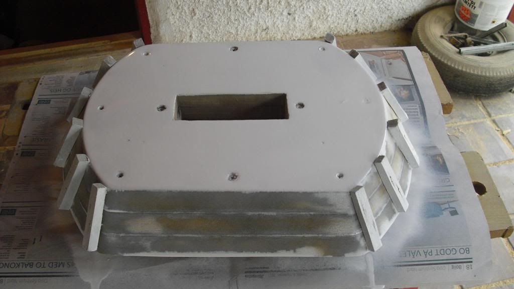

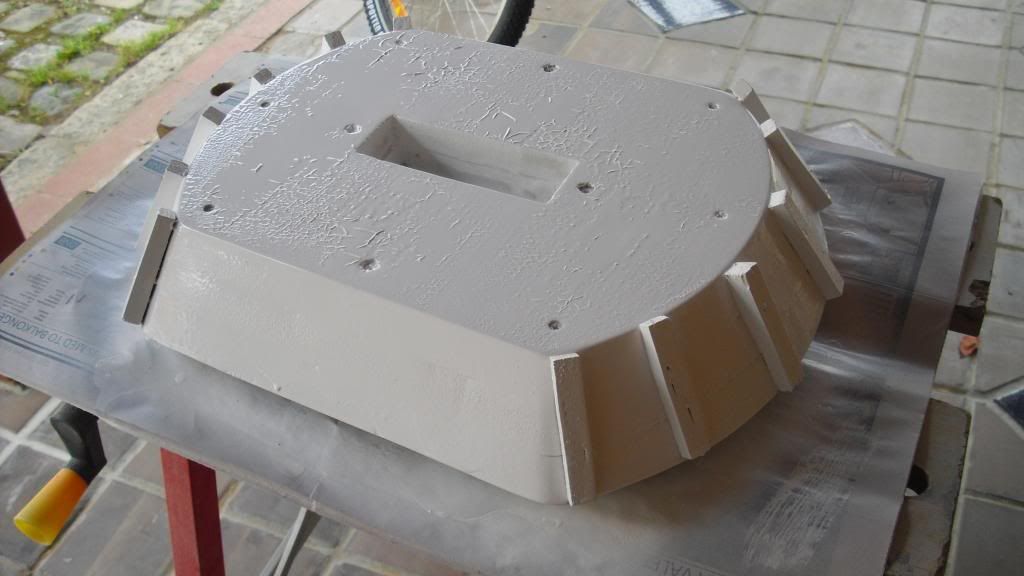

It sucks paint incredibly fast, the primer too. I think I'm going to paint it by hand some time. Will be away for almost a week now, without Internet access.

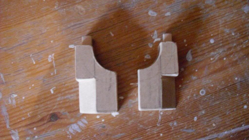

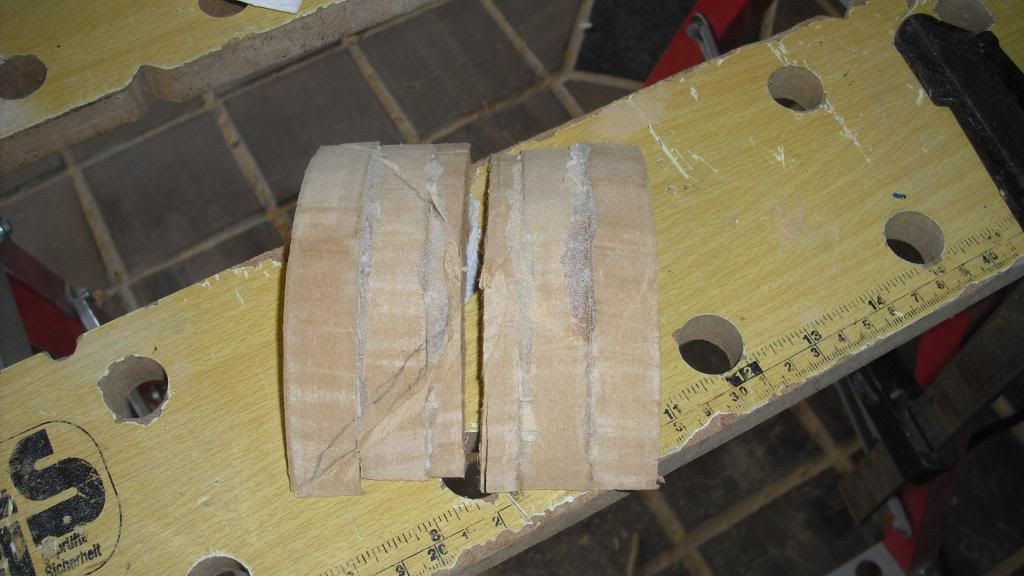

Yesterday I tried to very carefully cut the remaining two ankles, and both of the ankles cracked - one of them completely..Really frustrating!
2 layers of primer and 2 layers of paint, the MDF ate it as a light breakfast. Looked about the same on the top about 10 minutes later.

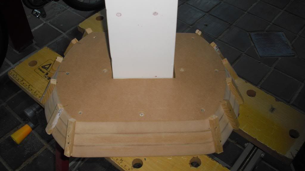

Cut out 1 layer of MDF in both of the shoulder flanges to get room for the bolts that will be placed there to connect the legs to the body.
The ankle which cracked apart very easily, forgot to take a picture of the other one, sorry.

I have been thinking about it, and instead of buying a tube or continue with the ankle trouble I'm really considering to just drop it and mount the center leg as it is (after the skirt has been painted of course).
This way the center leg will also be more stable with 3 layers of MDF to be glued to rather than 1 (if I'm going to screw the center leg into place from the bottom in the body it would guaranteed leave a huge crack).

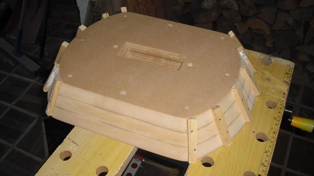

Isn't really much work left, in the weekend I will try to get all the remaining things done, like painting the bottom of the body + adjust it a bit and make a couple of small fixes on the shoulder hubs.

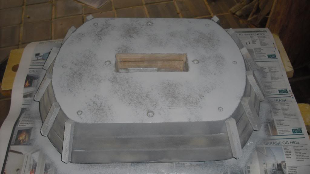

Primer + white spray paint + brush paint = don't.

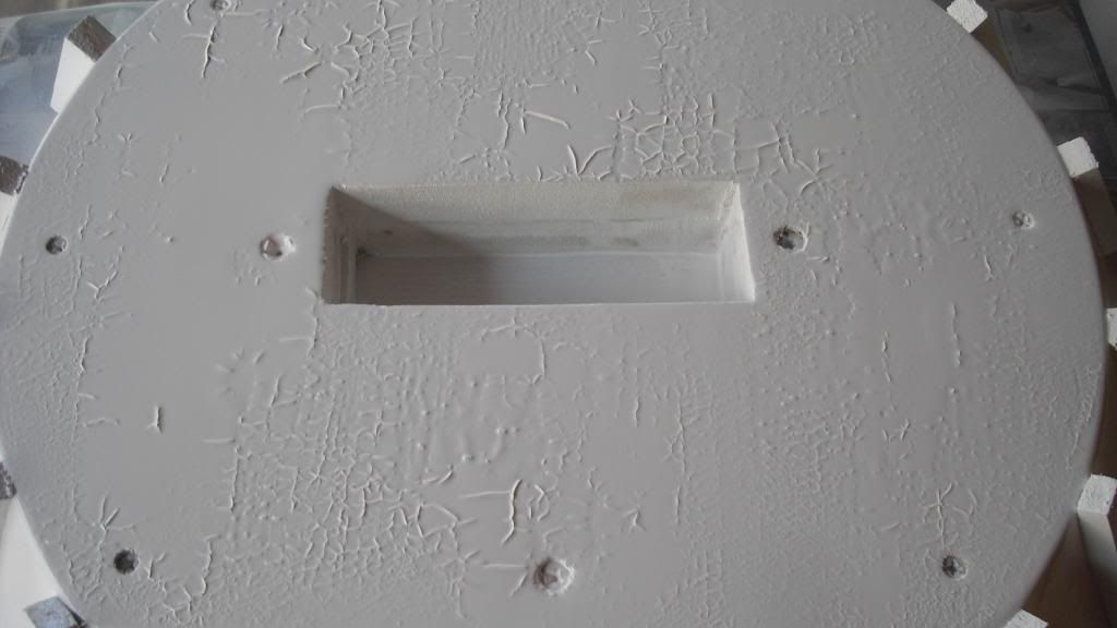

Cracked a lot at the top only, lucky for me that the top is a natural place for the used R2 to be dirty and heavily weathered.
The clear paint was added after the pictures, doesn't matter, wouldn't really have shown in the pictures anyways. :)
Still remains two shoulder details to be glued on, but just a minor thing.

I had the same problem with my Star Destroyer display table. Search for MDF undercoat in your hardware store. These are quite expensive but still cheaper than 1000 layers of paint (-;
You will need a barrier layer otherwise the soaked paint in the MDF won't dry in hundred years
I like to use Kilz2 latex primer for everything. It soaks into MDF and makes a good base for further paint. Good to see your progress.
Speaking of primer, a cheaper alternative is to paint all your MDF pieces with a 1:1 mix of PVA and water. It soaks in and makes it easily paintable, I usually give it about 2 or 3 coats of the PVA solution, then sand it smooth with a 150 grit before painting; works like a treat every time
You can also use cheap acrylic or latex based wall paint to seal the MDF.
The effect shown on your skirt is the result of mixing different types of paint like lacquer and enamel.

Thanks for the ideas everyone! On the sides where it sucks the most paint it's really just one layer of ordinary paint (from a box) and it's fixed. The top was replaced with new paint. Just the white spray fixed it fairly easily, probably the previous paint had made the wood full.
