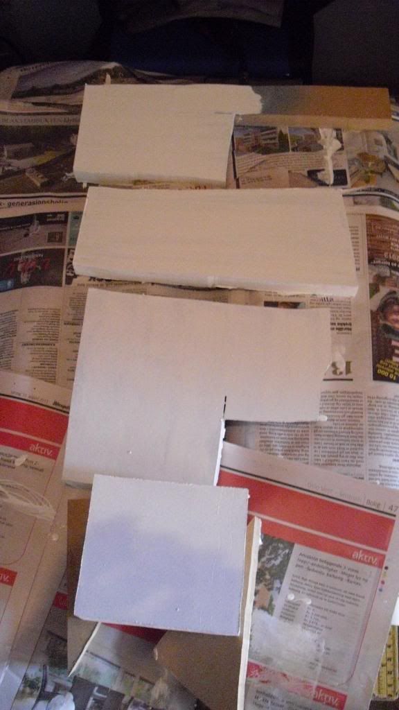

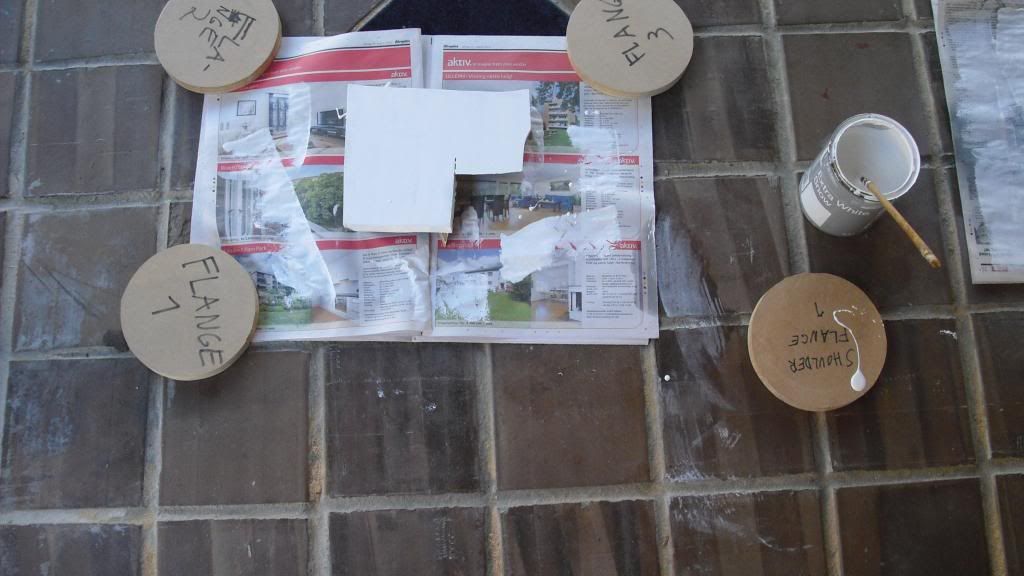

From top to bottom:
Brush with primer
Brush only
Roll with primer
Roll only
Very visible brush marks on the fist two, doesn't show in the picture, but the roll wasn't that good either.
Tried with spray today, a lot easier and without the mess.
I had a look at the blue paint today, I just though, no, no, no nooo!!
It's that bright in real life, maybe 10% darker.
Got some oil based black paint from a model shop laying around, I will try to mix it in the whole box. That color is the R2D2 color that I dislike :/

Spray makes all the difference in the world. So have you decided how you're moving forward?
Re: 1:1 R2D2 homemade scratch build
I looked at the parts that I did with the airbrush with the paint from the can, and it doesn't get sucked in nearly as much as the spray (on the sanded surface)
Compared to the easier version, the one with primer and white spray the result isn't as good as with the airbrush. On the side, even with 2 layers of full covering with primer and 2 layers of paint (spray) on the side it just got sucked in, and now it looks like priming/white paint is mixed on the sides, can take pictures tomorrow.
The conclusion is that with the spray can it's easier of course, but the result isn't nearly as good at all. So I think I will go with the airbrush although that too is a mess like the brush/roll.
Will try to get the dome rings equal tomorrow, and that's it I think. Need to relax a bit too :)

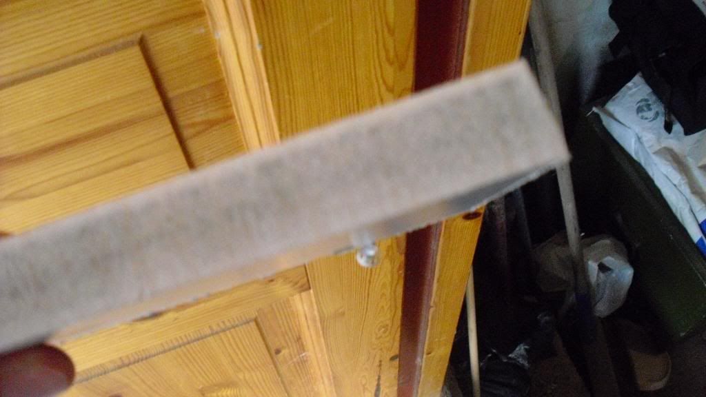

Sorry for bad pictures, but really bad result with the sprayer on the sides:
Only the primer and not paint is visible..
The best side (it it took a lot of paint, and it's still not full)
Done and sanded:
I know it has small scratches and stuff, but it feels really smooth.
Thats the progress today, but I will be more efficient the next days!

HMMMM... Wood filler might help with those edges? A little more work and a lot more sanding.
Appreciate the tip, but I think I will pass.
Only noticeable if you look for it and I think it won't be noticed at all with the paint on as it's so thick.
