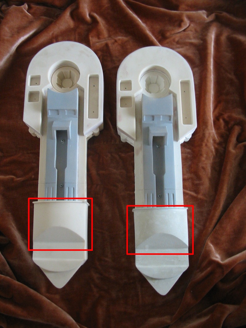

For the ankle, is it easier to make with HIPS than to sand down glued together pieces of MDF?
Ankle:

...For the ankle, is it easier to make with HIPS than to sand down glued together pieces of MDF?
Hi Kev,
I've ALWAYS wanted to build an R2... but I don't know what you're asking so I'm not sure what part you're refering? Can you be more specific? :)

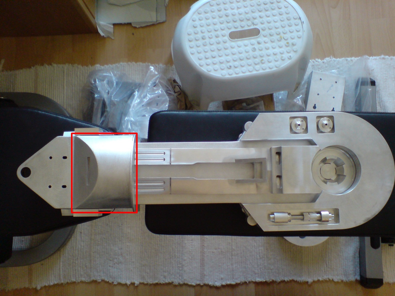

Sure, pictures of the R2D2 leg(s) with the ankle makred in red:

I started with piece of PVC pipe and cut it down to size then glued a piece of styrene to cover the angle. I then glued the entire piece to my wooden leg. Hope I've explained it clearly enough. Good luck with your project, it's looking good.
Re: 1:1 R2D2 homemade scratch build
Thanks! I will pick up some some inch of a PVC pipe on Monday! :D
