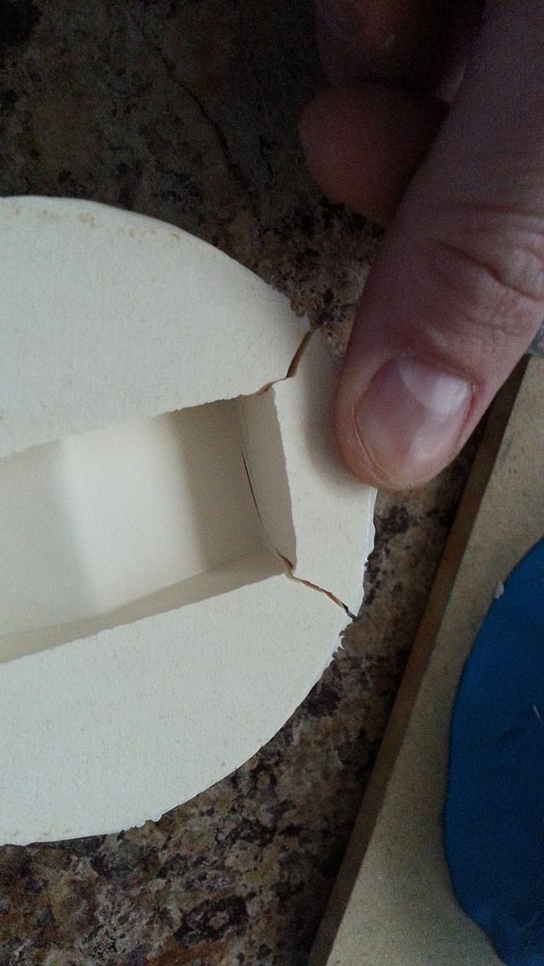

Hi Gang,
I created my first silicone mold! :) BUT... when I removed the mold it tore. Is this ok? Is there a way to fix?
Re: 1:1 Millennium Falcon Console Replica
Hi Gang,
I created my first silicone mold! :) BUT... when I removed the mold it tore. Is this ok? Is there a way to fix?]
Hi G
That's a good looking mould for your first one :thumbsup
Don't panic too much about the tear, it will help make it easier to get them out after. The solution when you want to cast is:
Split the jacket it was made in and put it back round the mould when casting, it'll reinforce the torn sections and should be resin tight (just make sure the torn areas are seated back in place nicely first before putting the jacket round it). A bit of electric tape put carefully around the outside of the jacket also helps.
A little release agent (I use a spray wax release, household spray wax doesn't work) will prolong the life of the mould too, not usually needed, but for rough/textured surfaces, silicone has a tendency to stick at times.
Hope that helps

Hi C,
THANK YOU!!!! Question! What type of spray wax should I use?

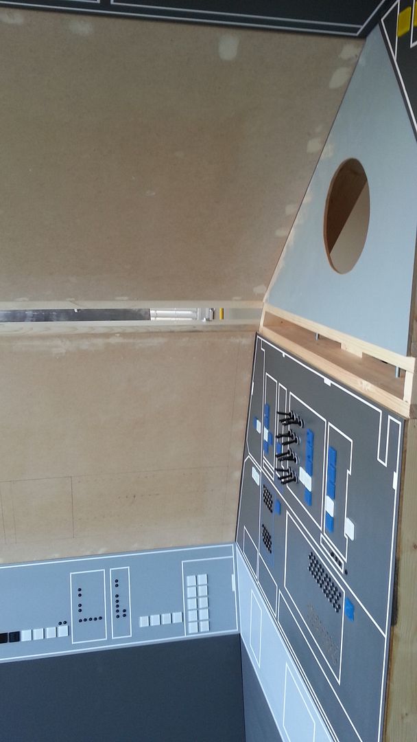

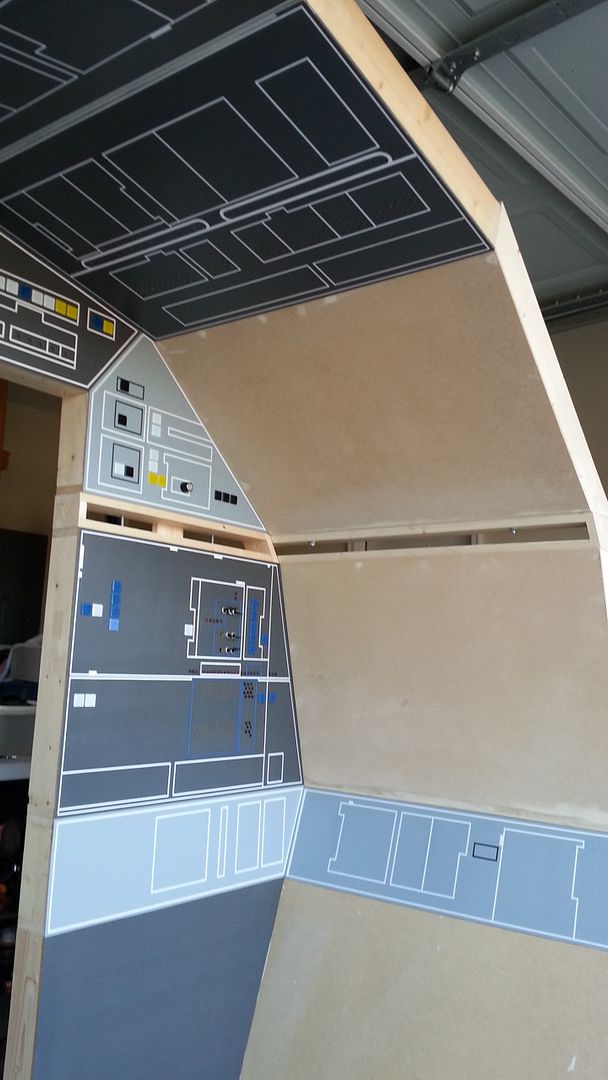

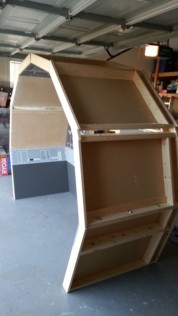

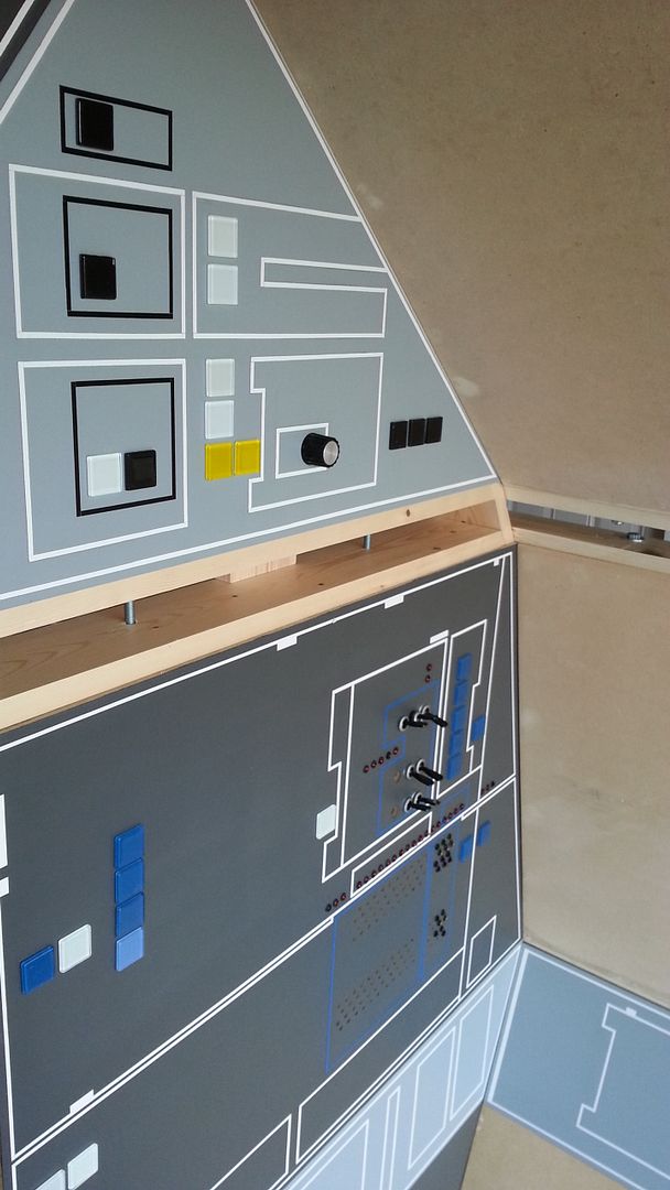

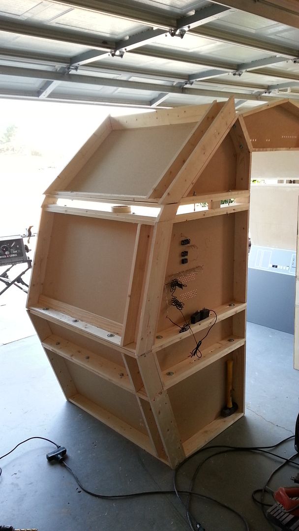

Hi Gang,

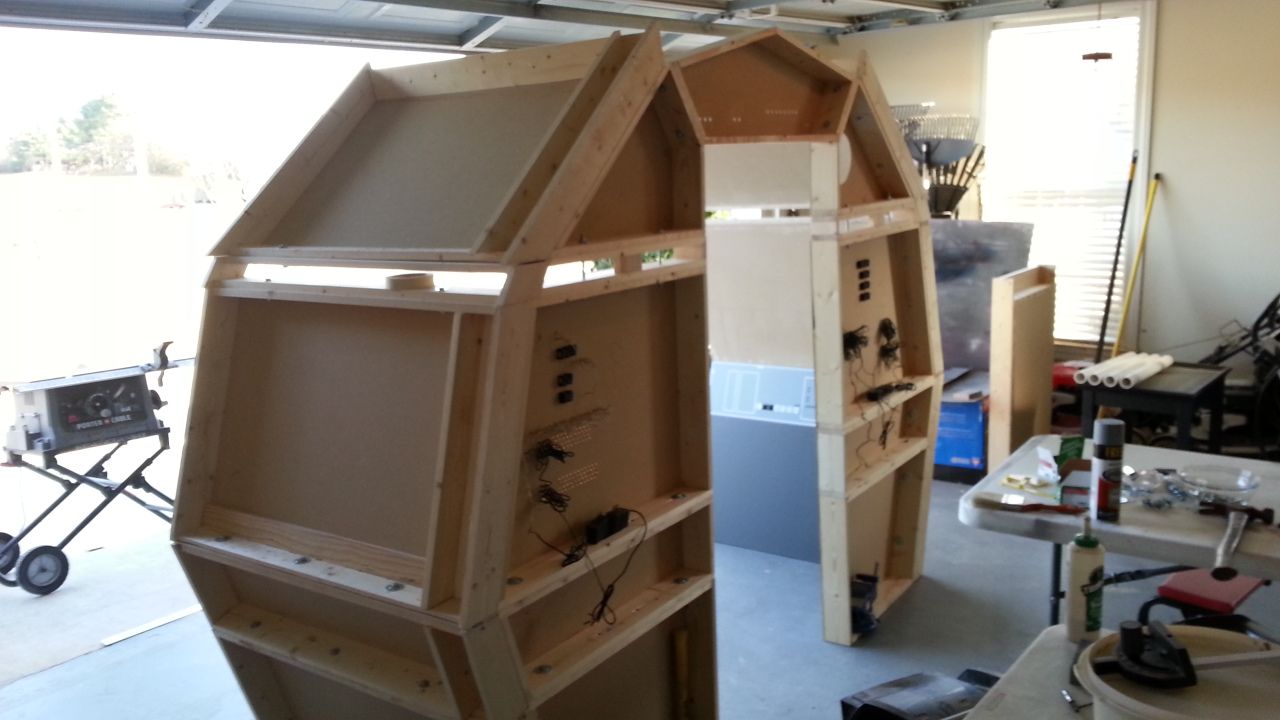

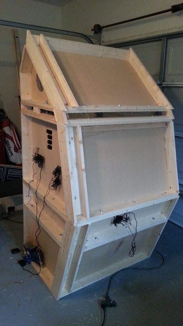

Quick update - no pics. I've sanded down the edges and filled in some holes. I'm waiting for the filler to dry before the last coat of sanding begins. After that I will begin the process of bolting everything together... if successfull (IF) I can unbolt and start drilling holes, painting then pin striping!
Hi C,
Well, I use two different types of release depending what I'm doing. The spray wax release I use for general casting is called MacWax and is designed for silicone moulds, not sure what brands there are over your side of the pond though, but a search for "silicone mould release agent" should produce results.
The other release I use is also a cheapie and I use it for multi part moulds to stop the silicone from sticking to itself, but it can be used generally as well. The only downside is the parts need a good clean after if they're destined for a paint job.
To make it, take a bottle of white spirits and drop a couple of teaspoons (not over heaped) into the bottle of spirits and shake/stir untill it's dissolved. Then take a new, or clean/dry hand sprayer (used to mist plants, I bought a small one) and pour an amount in, and your set :thumbsup
Any big bits left in the bottle after mixing/stirring will need breaking up, or sieving out as they clog the sprayer head.
Spray the mould with as fine a mist as poss (use a mask/goggles for this though, it tastes like c**p and stings your eyes), making sure you get into the corners of the mould, then let it sit for a while till the spirits evaporate, or use a hair dryer on low setting from about a 1 1/2' from the mould to speed up the process. There will be a fine film of vasaline left behind thats as good as a wax release.
For a finer layer of vasaline, use less of it in the mix :thumbsup

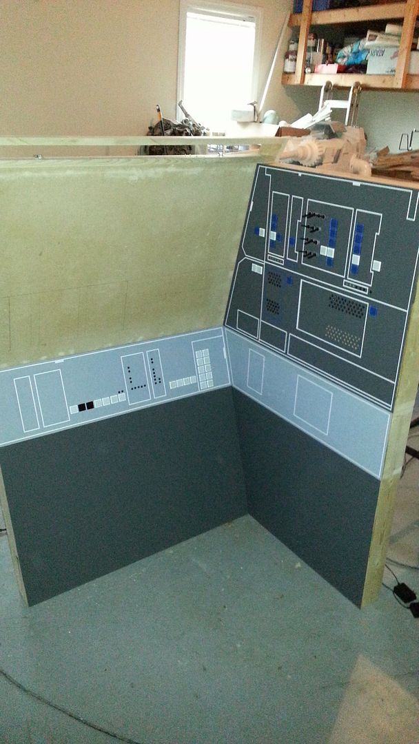

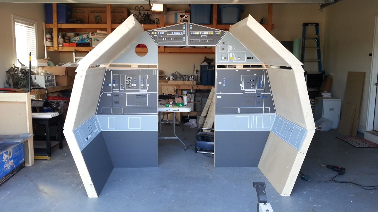

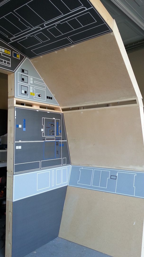

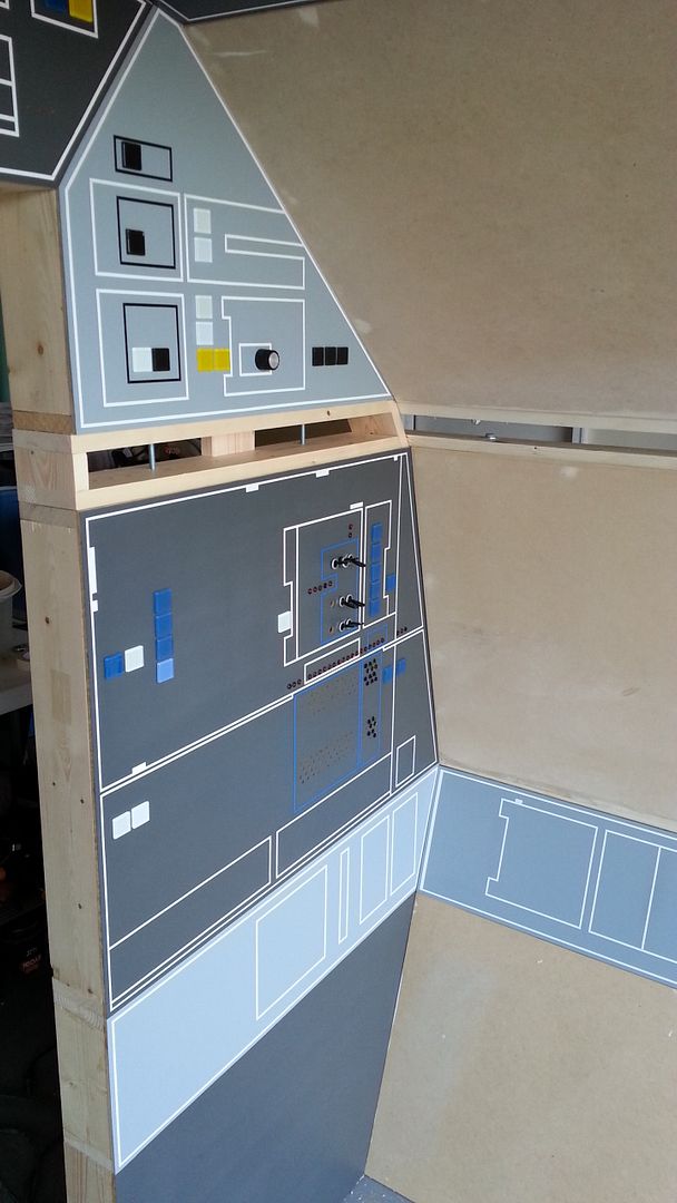

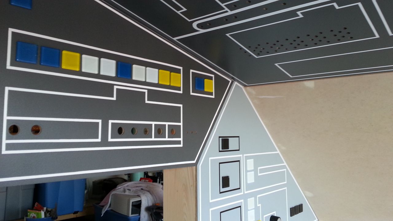

Hi Gang...
Ran into ONE little teeny tiny problem... The lower side panel on Han's side is 1/8 off an inch too high. I didn't notice it at first because I was putting all the panels together on the carpet... So... I have to make one more panel... But it's not a big deal because it's a lower panel with no details... oh well...
The good news!!! Check it out!
My work buddy!
More to Come!

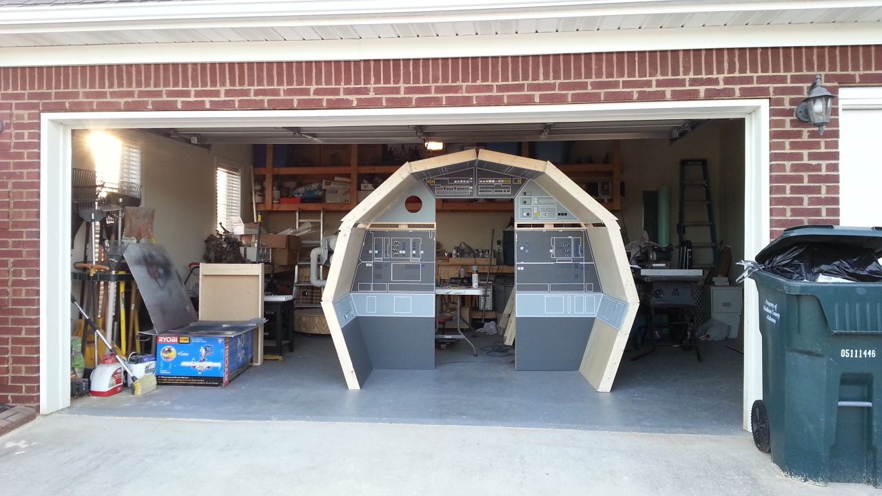

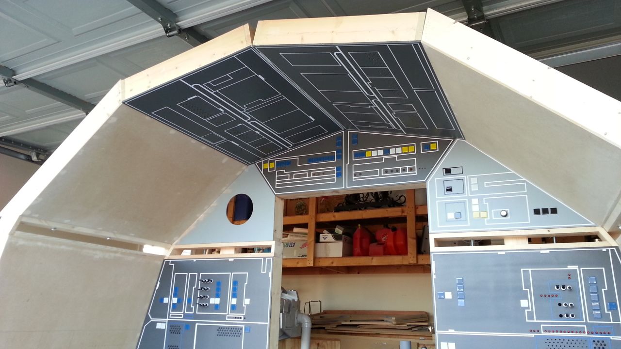

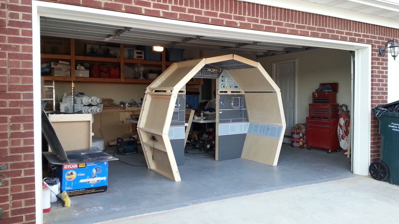

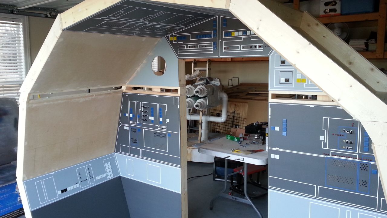

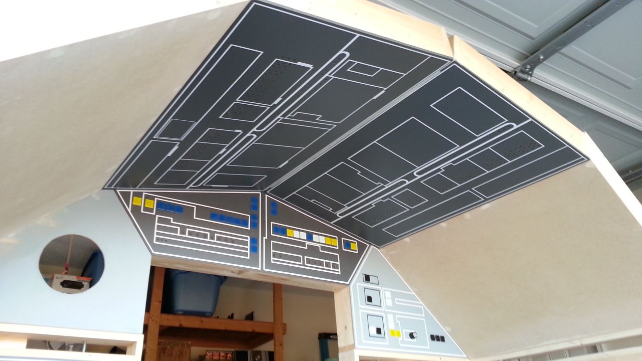

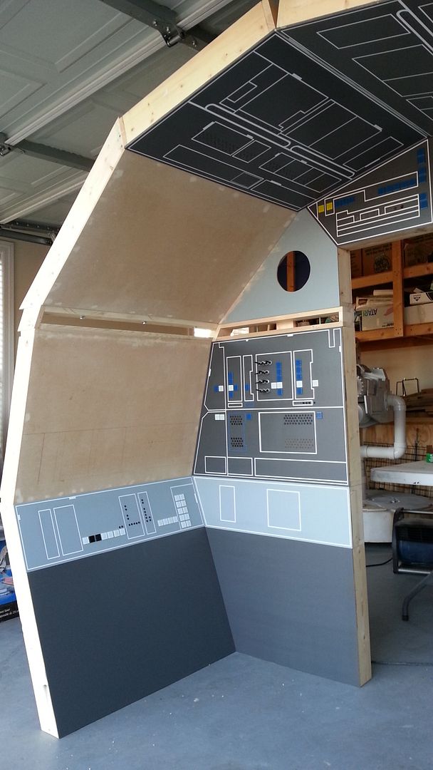

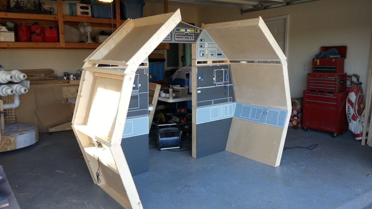

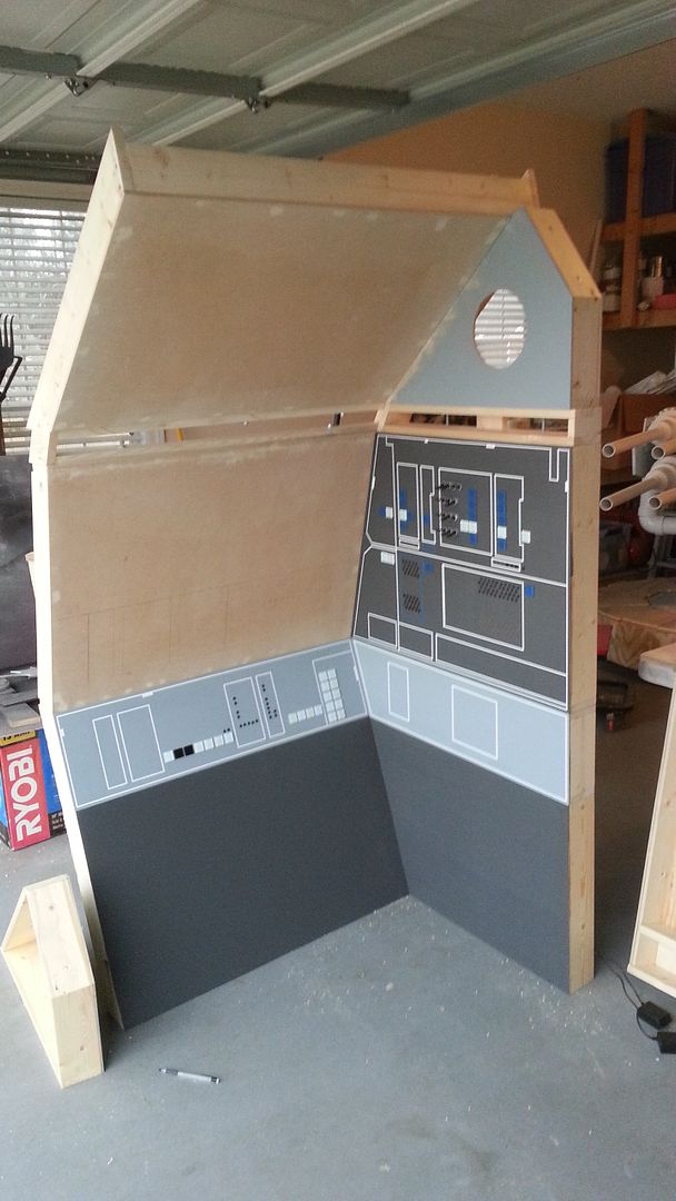

Hi Gang...
SHE'S ALL PUT TOGETHER! :)
Yes... It's VERY VERY BIG
I'd like to say "More to Come"... but I'm going to go collapse now... :)
I have to give ALL the credit to this build to Starkiller! His 3D build set everything in motion and his dimensions we're SPOT on. Thank you, my friend! :)
