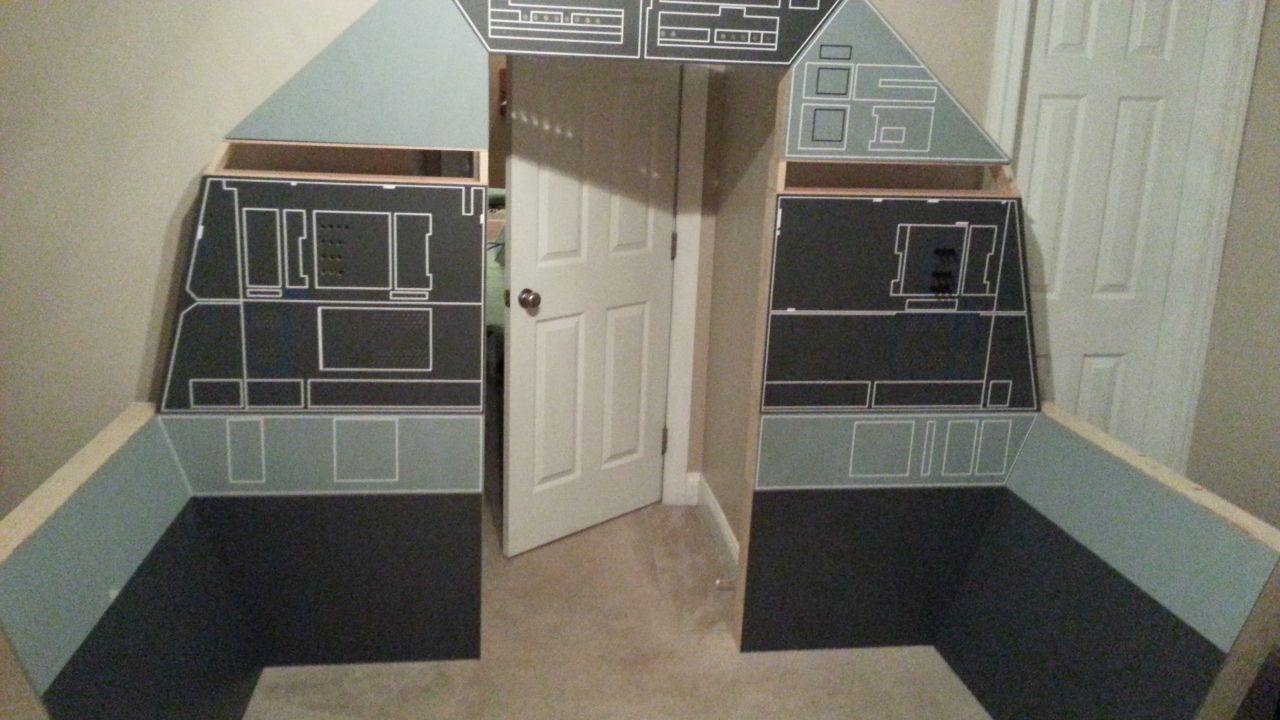

Re: 1:1 Millennium Falcon Console Replica
Hey Sofaking,
Those side panels are coming along fantastic!
you were wondering what dimensions to use for that circular rear-lit look on the buttons.
I've had some success here with 1/4" thickness to the buttons (made of a semi-opaque material, like "opal" perspex noted on the blueprints), a 3/4" diameter hole behind, and a light source about 3/4" behind the aperture. I realize this is just a computer model, but it is rendered with a program that makes all kinds of (potentially dubious) claims about how its algorithms imitate real light. Can't wait to see what you come up with on these!

Thank you my friend! WOW! The rendering looks awesome! The render engine seems to have nailed it. It looks like Perspex is the way to go.
