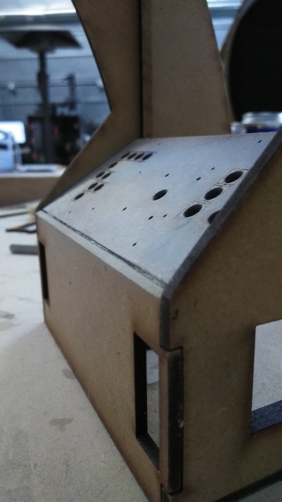

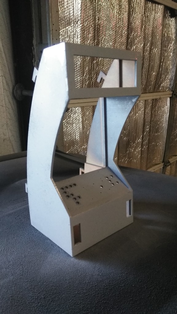

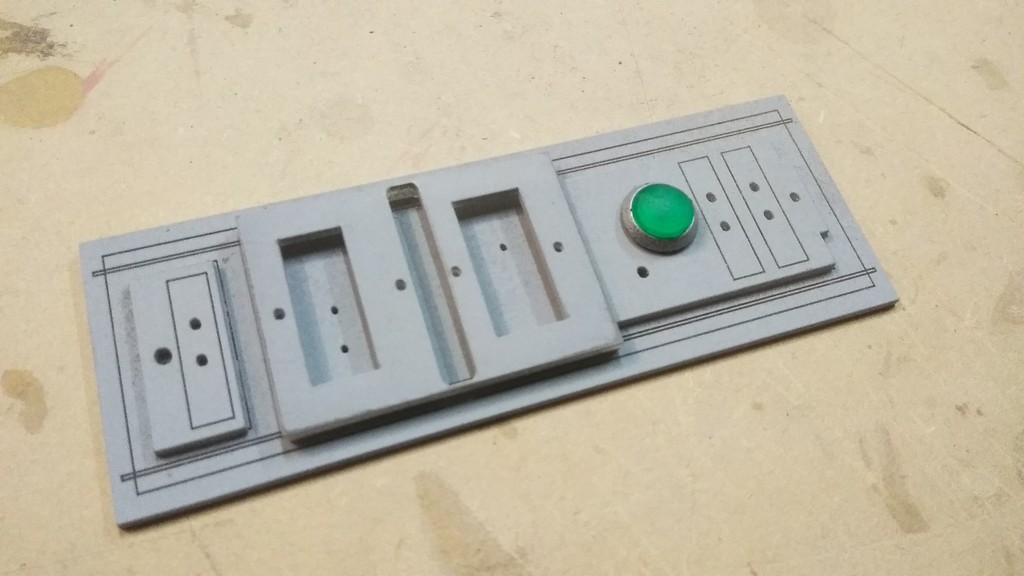

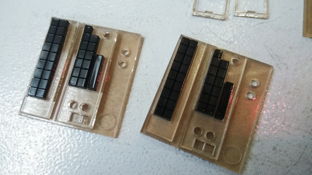

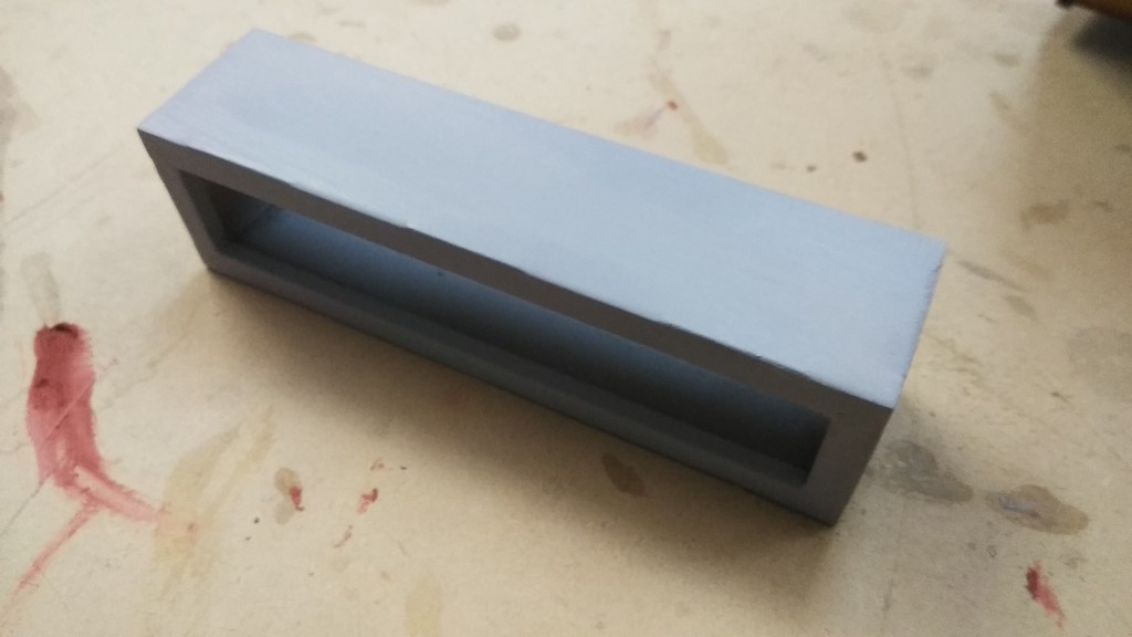

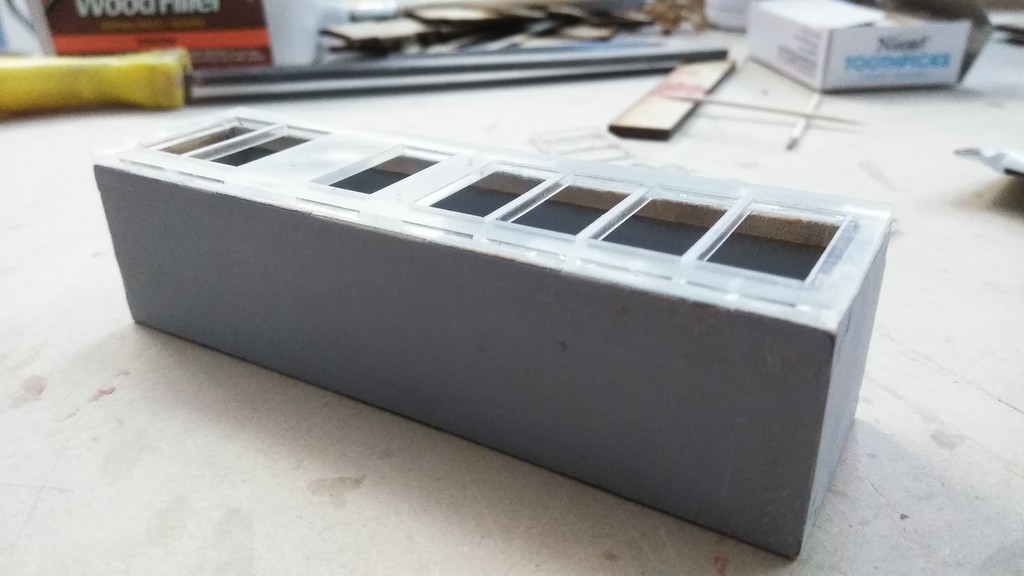

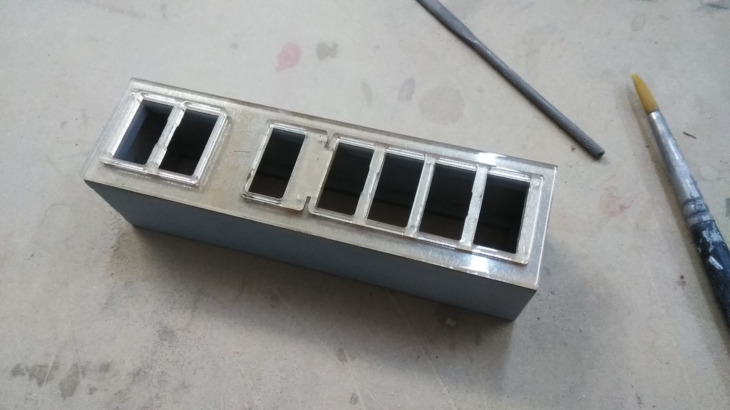

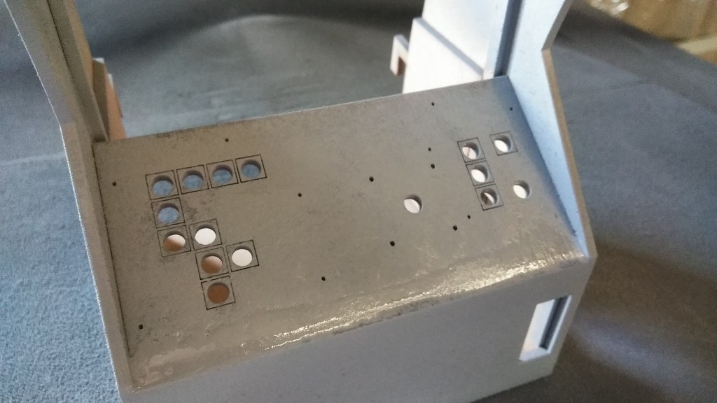

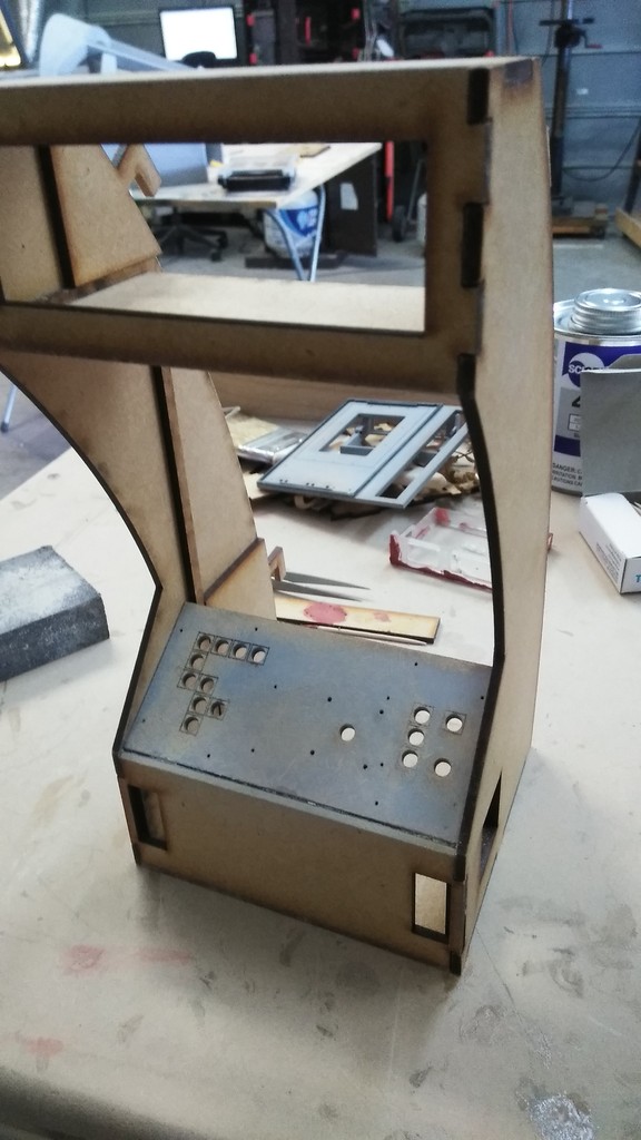

Upper console detail

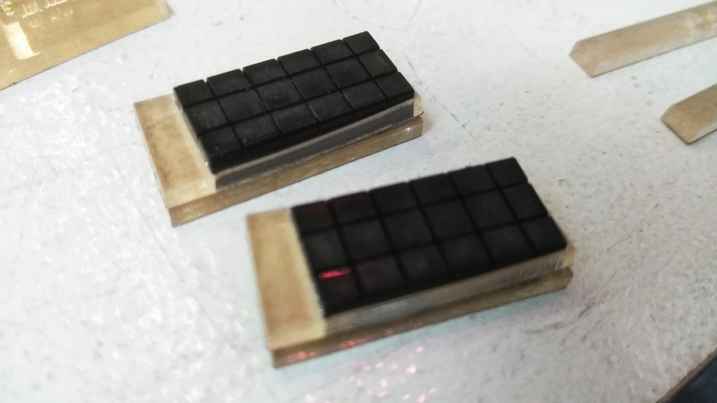

2 main button pads for the main console
Smaller button pad

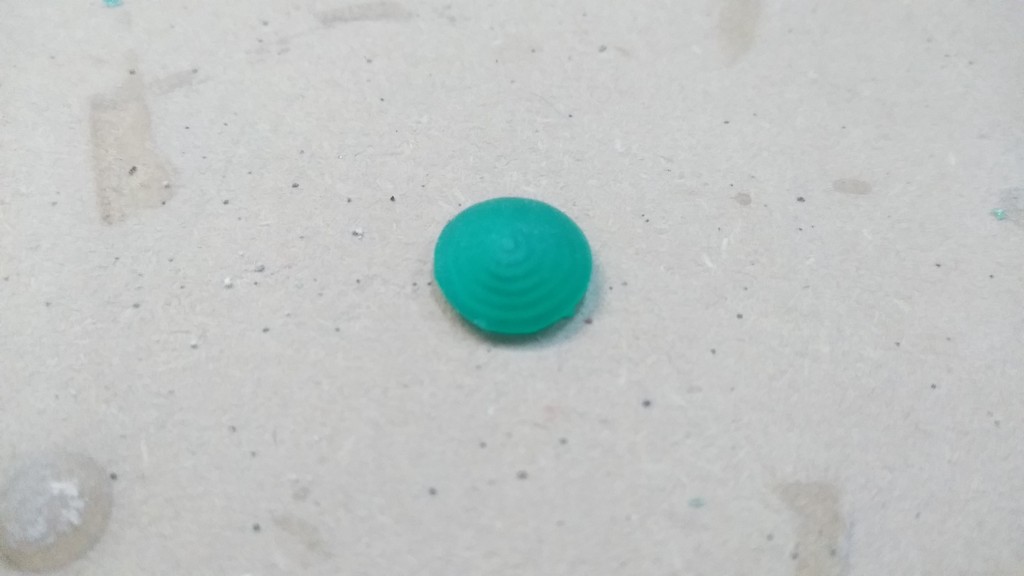

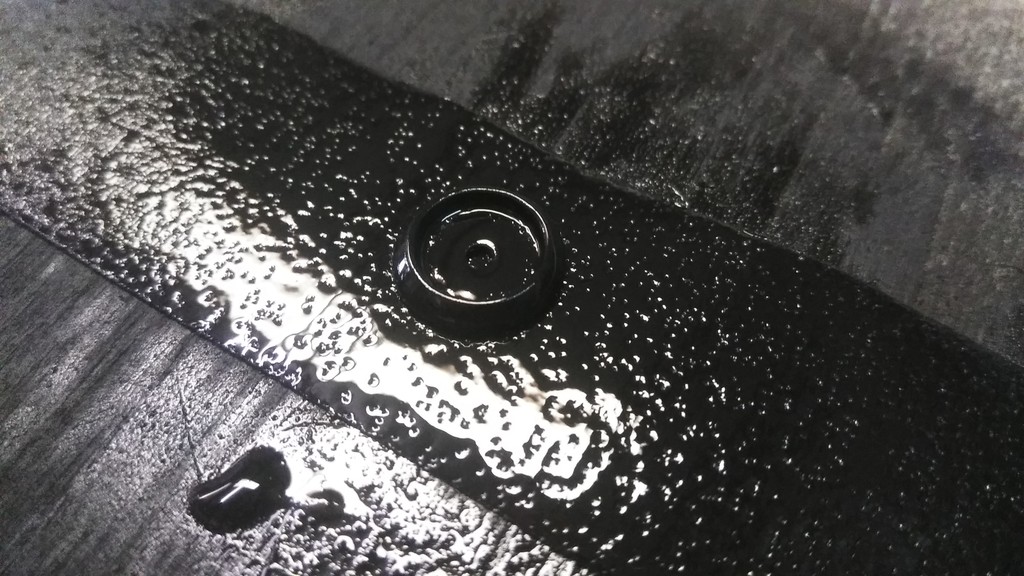

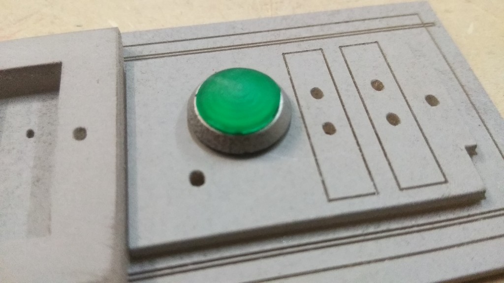

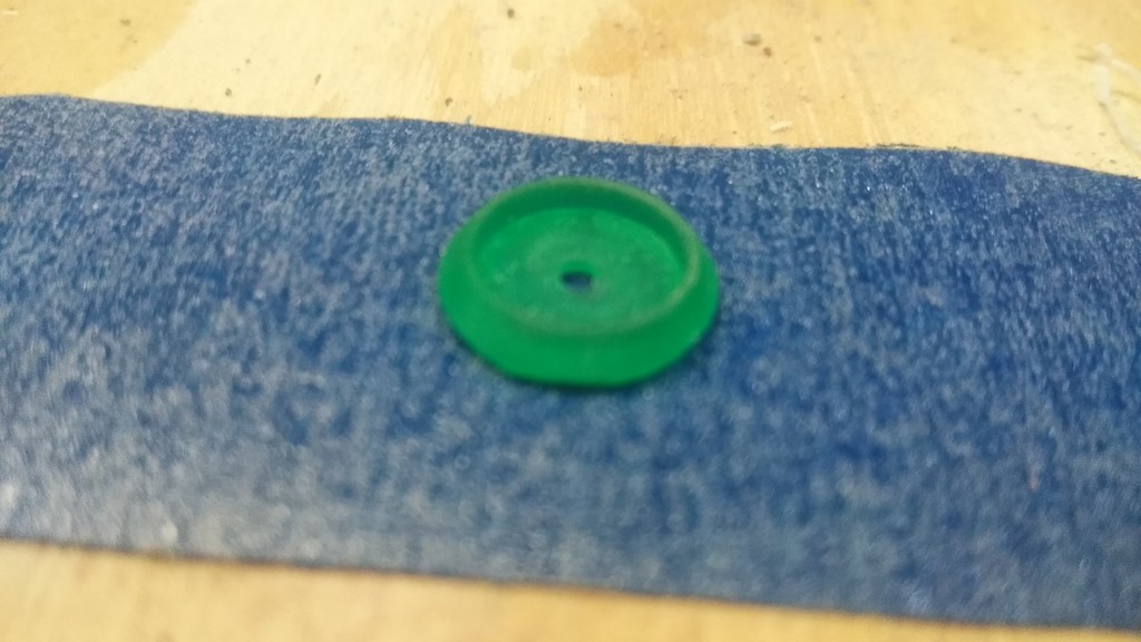

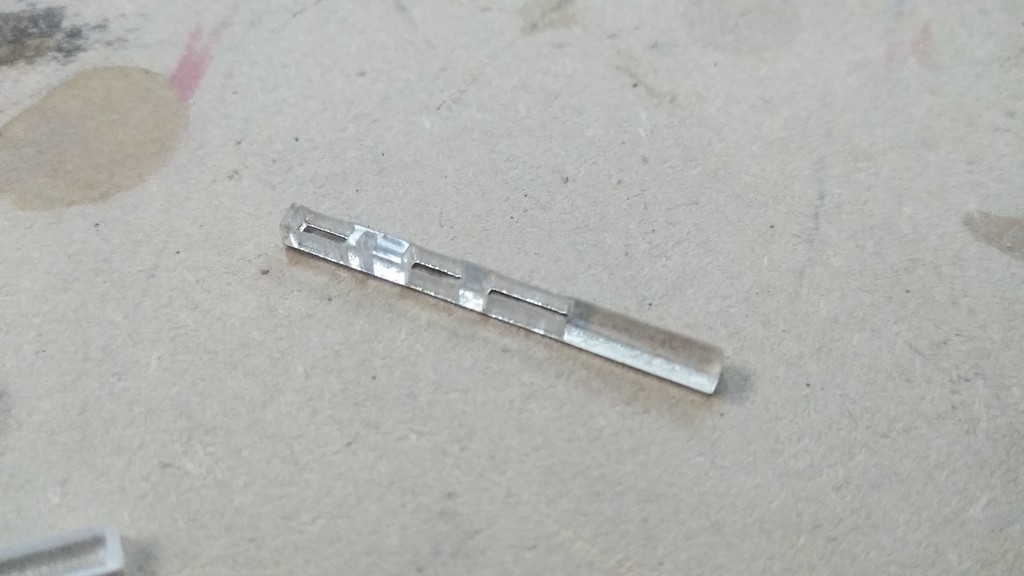

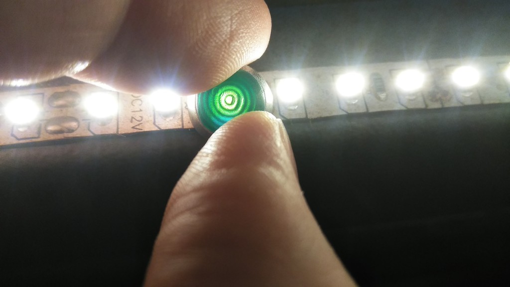

A package arrived for me in the mail... All of Izzy's 3D models to include these AWESOME and 1/4 scale Dome Panel Lights!
Lens
These are just test pieces but...
Painted the bezel silver
YES... the interior side of the lens shows the "Fresnel" effect! SO COOL!

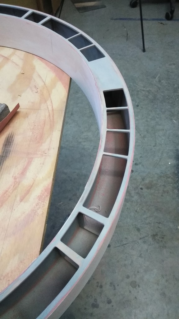

Part III - Fiberglass and Corridor Ring

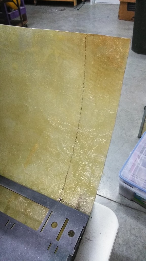

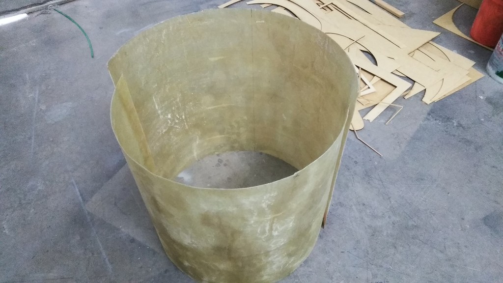

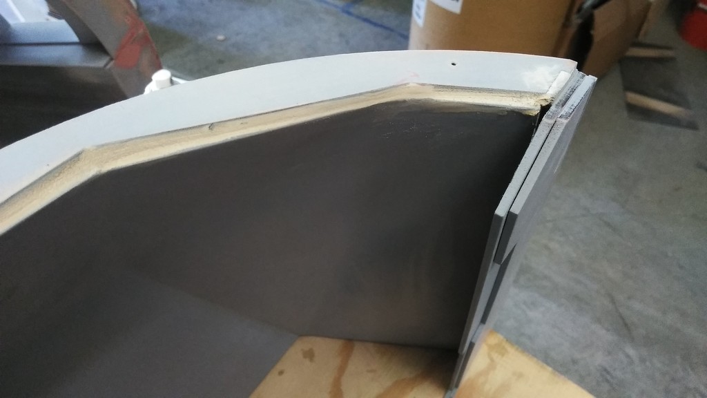

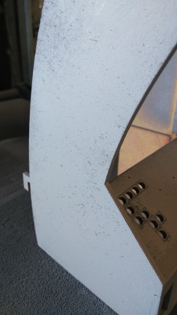

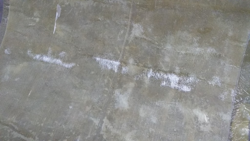

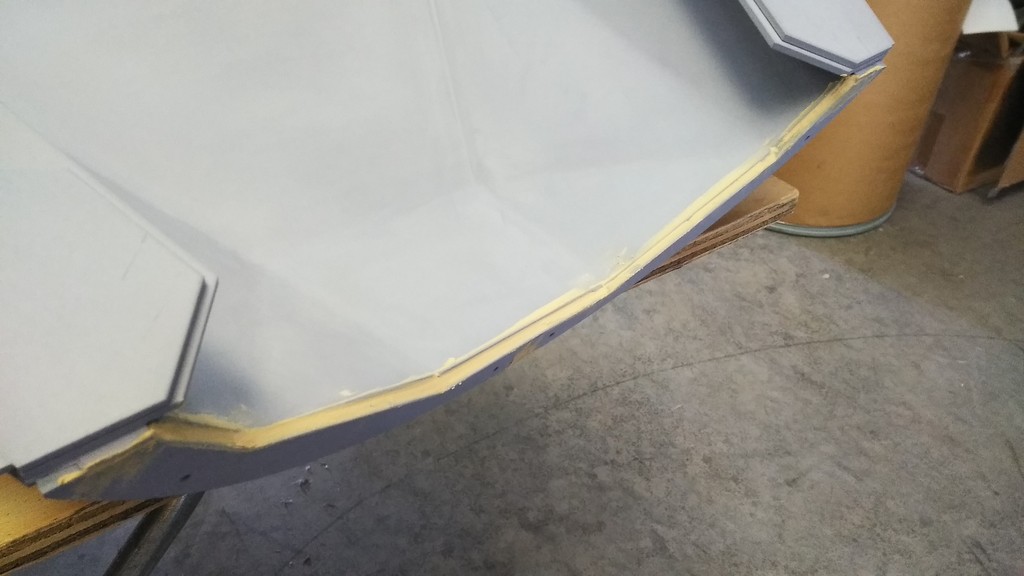

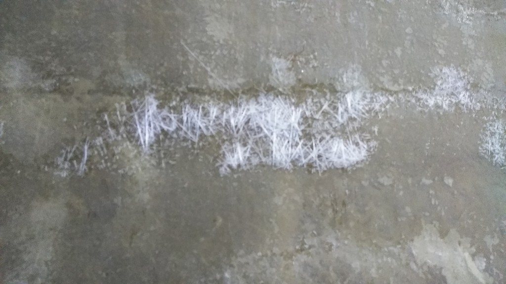

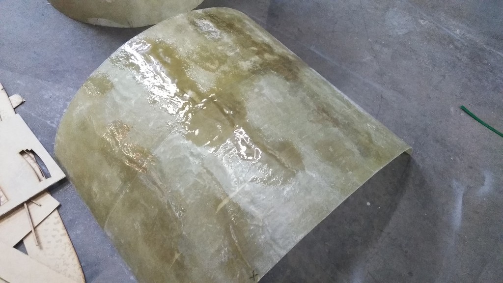

Back to the fiberglass body! I noticed a few areas of concern
Dry fiberglass - not good
I broke out some resin and covered the dry areas and filled in any other areas of concern

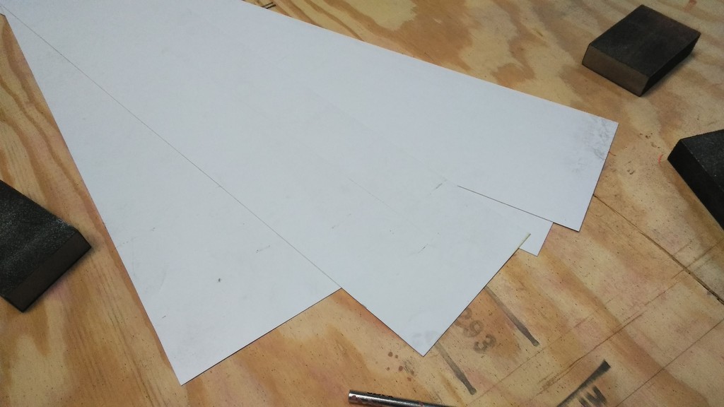

Cut some styrene pieces

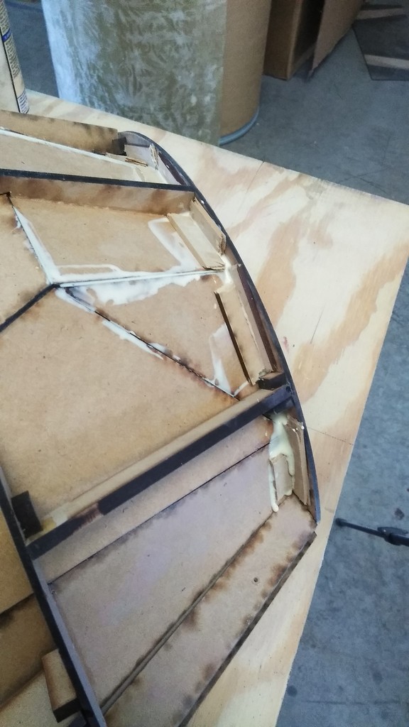

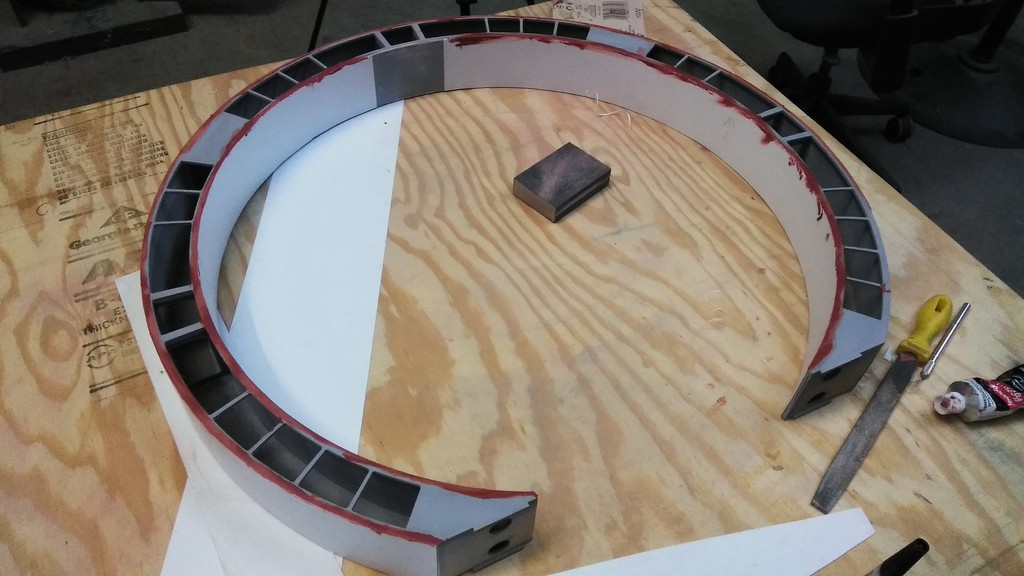

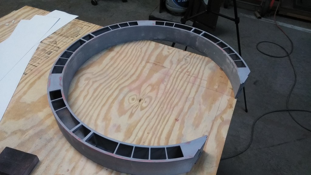

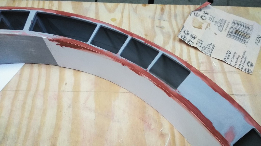

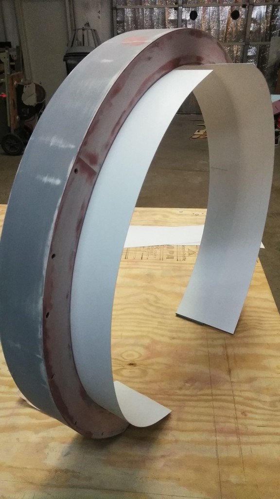

Time to add more layers to the outer & inner surfaces of the corridor ring

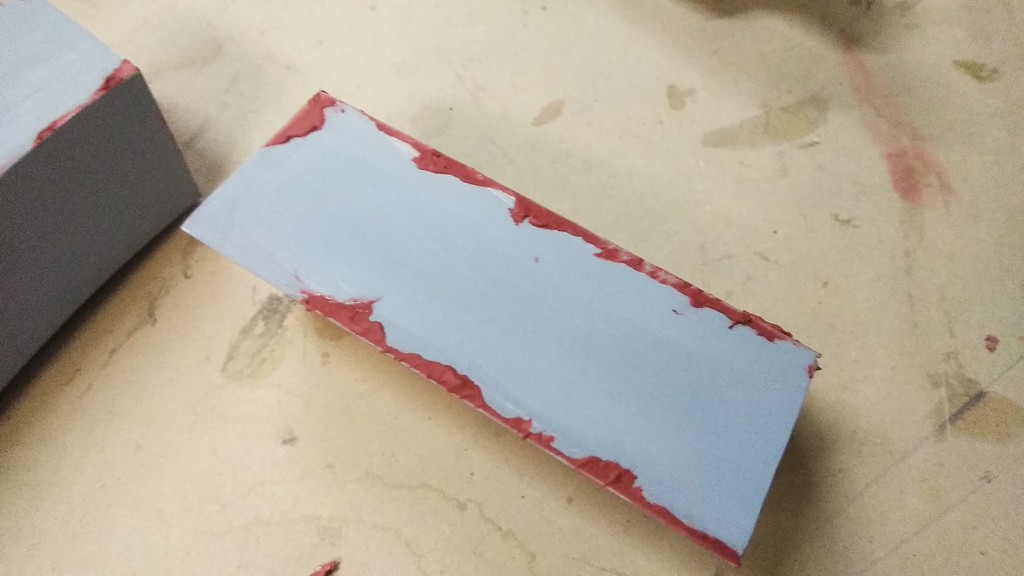

And of course more filler...
Honestly... this process never seems to end!

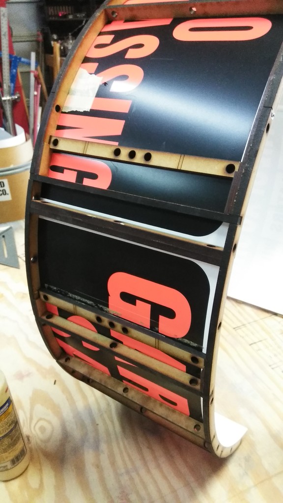

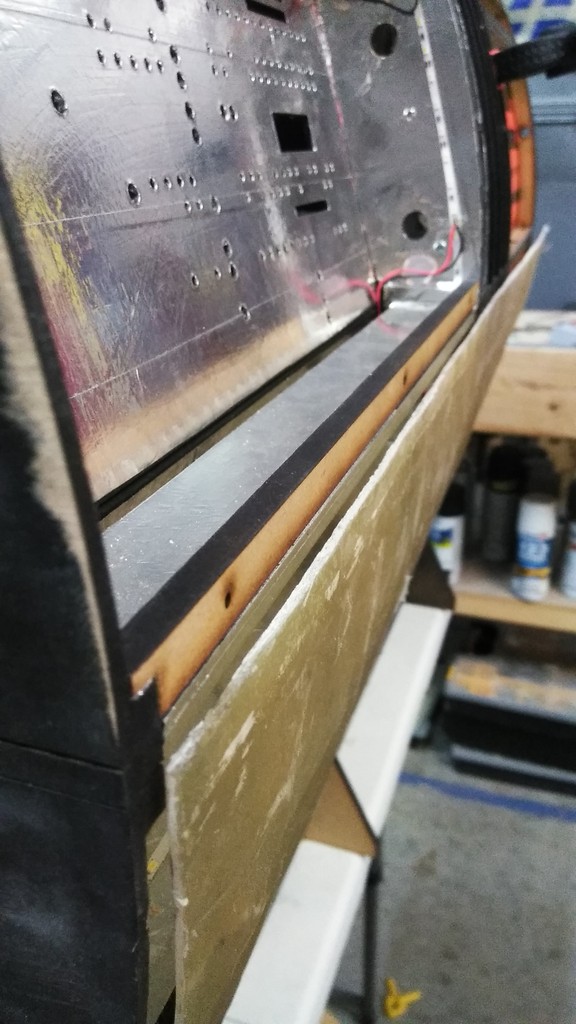

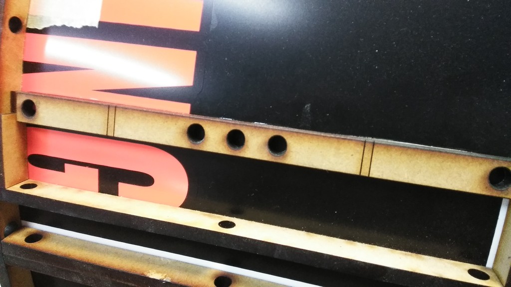

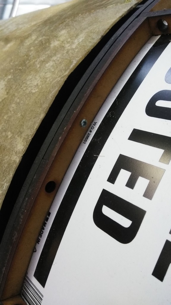

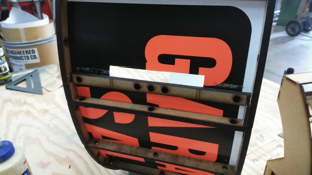

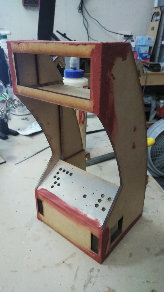

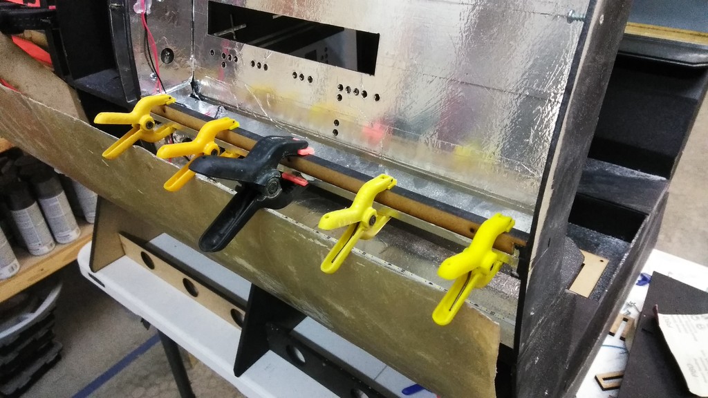

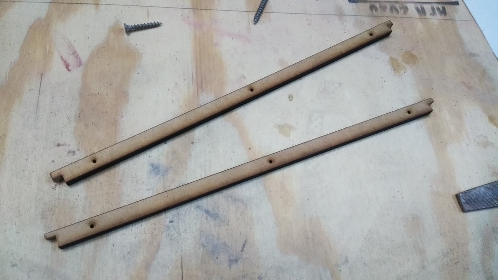

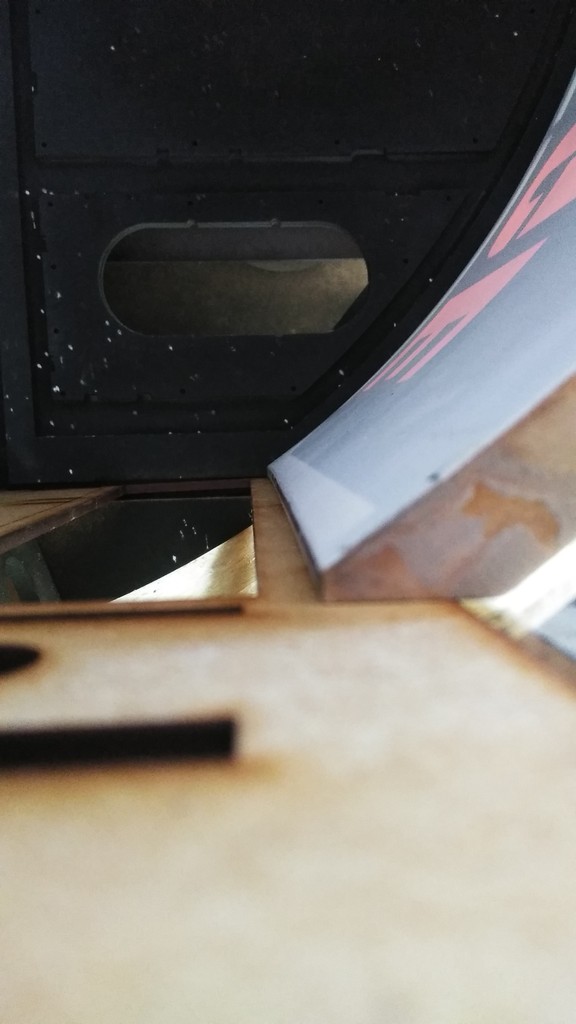

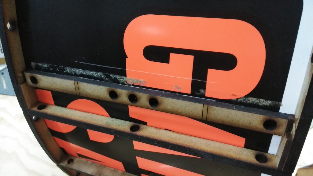

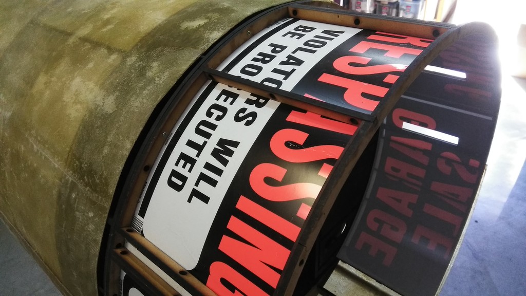

Another area of concern is how to mount the fiberglass halves to the main body - I designed and laser cut these beams
They will essentially mount here
The idea, if it works, after adhering the beams in place I will use flat head screws and simply screw the fiberglass to the beams

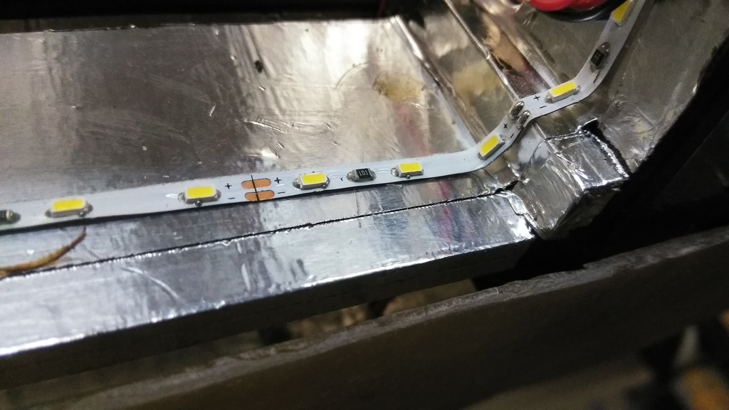

I have to remove some of the reflective HVAC tape
Other side

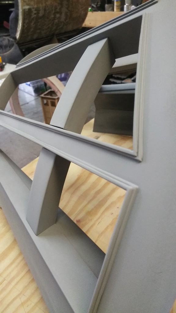

Part V: The Entrance Wall Cont'd

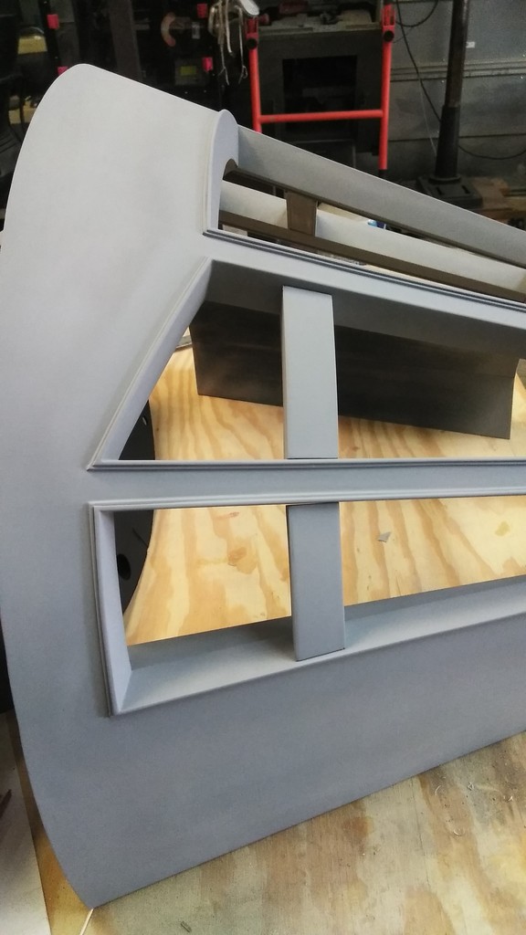

Now that I cut holes into the entrance wall it makes sense to make something to fill those holes? ;)

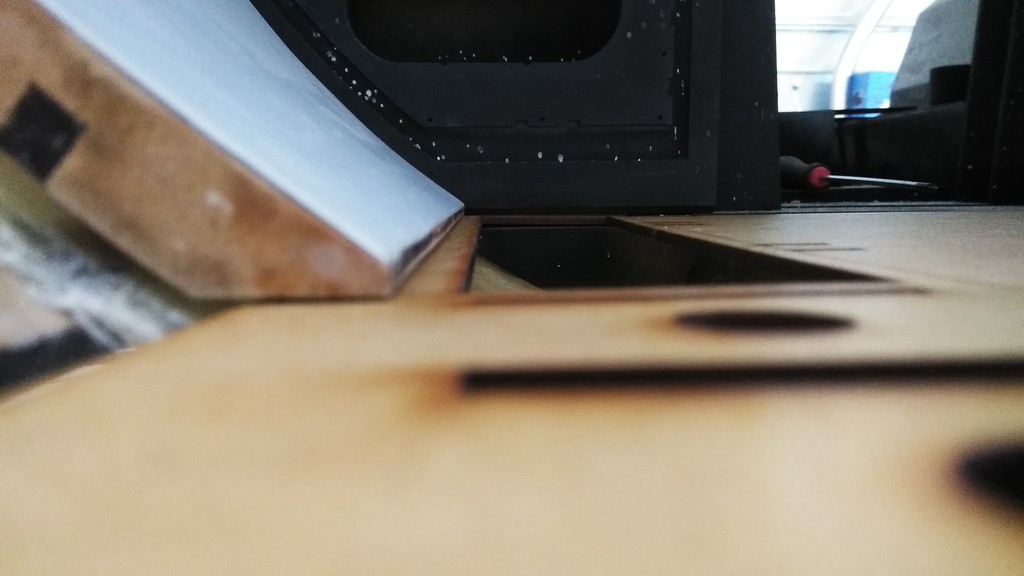

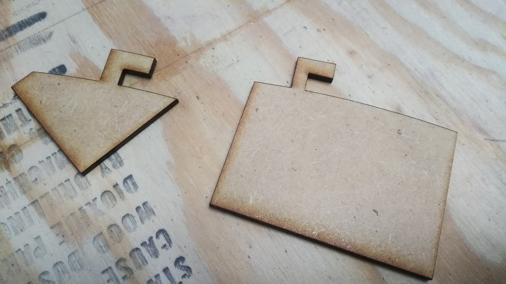

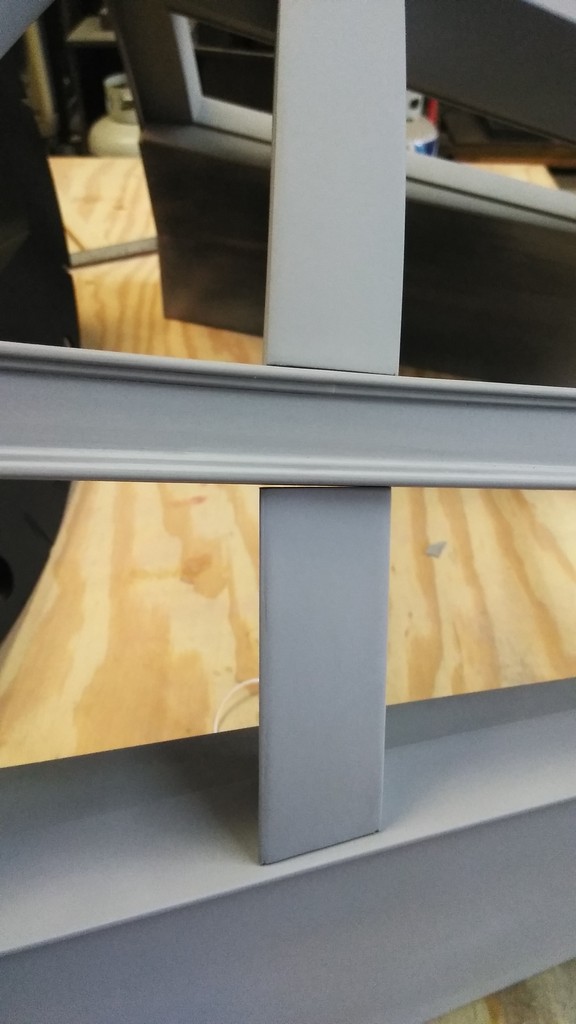

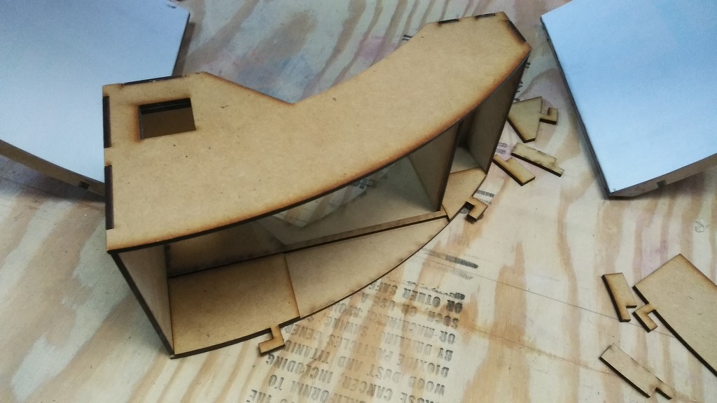

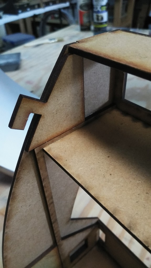

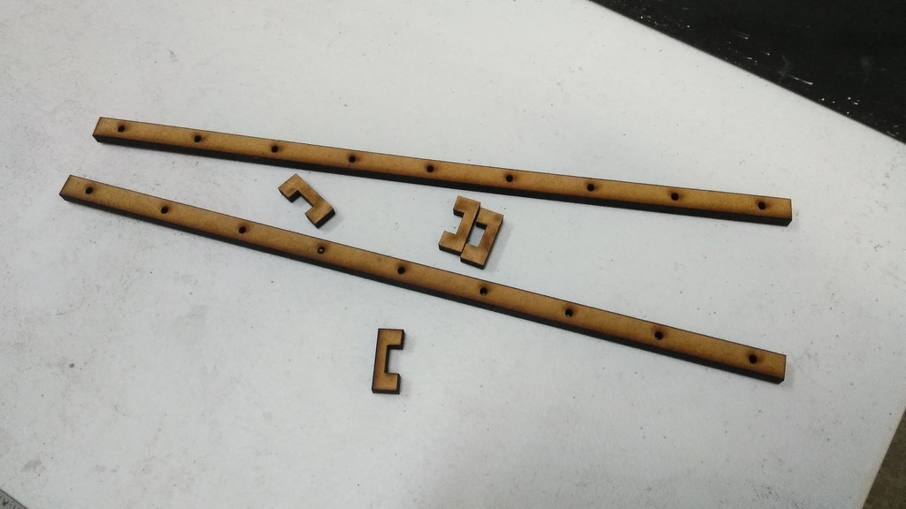

I laser cut these "hooks"
Mounted to the interior side of the maintenance panel
The hooks slip through the openings and simply "latch" to the cross beams
Temp added some beauty panels
And this...
Is where we "were"

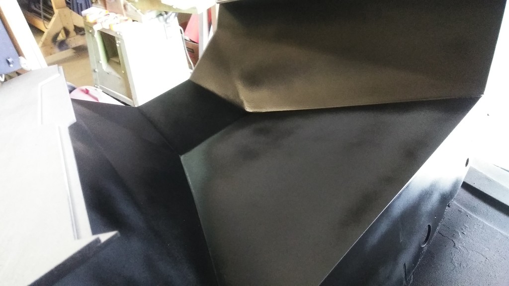

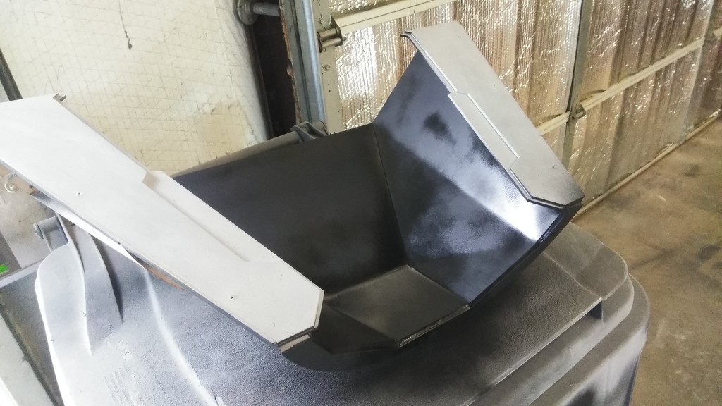

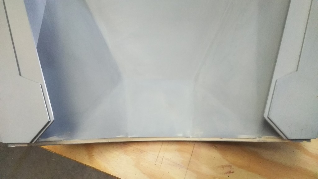

Part I: The Cockpit Nose

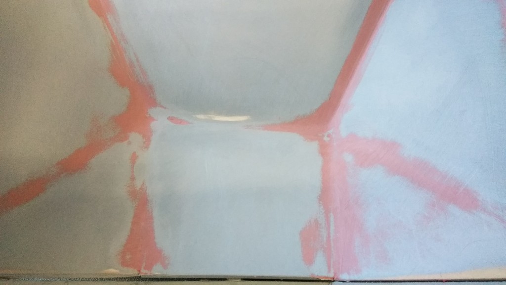

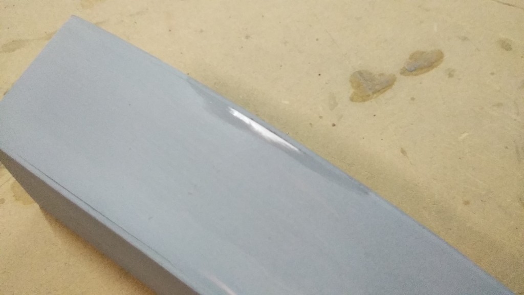

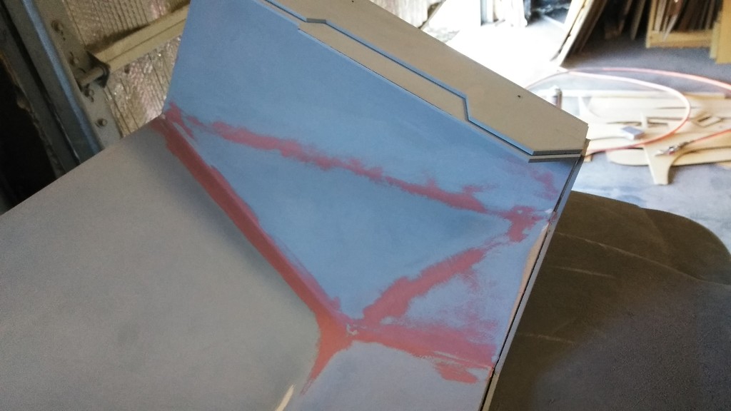

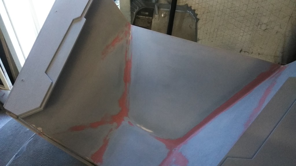

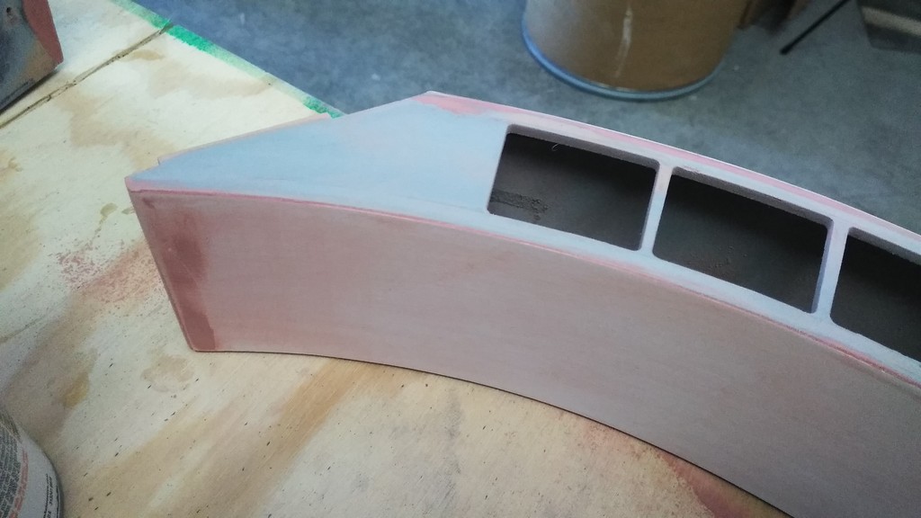

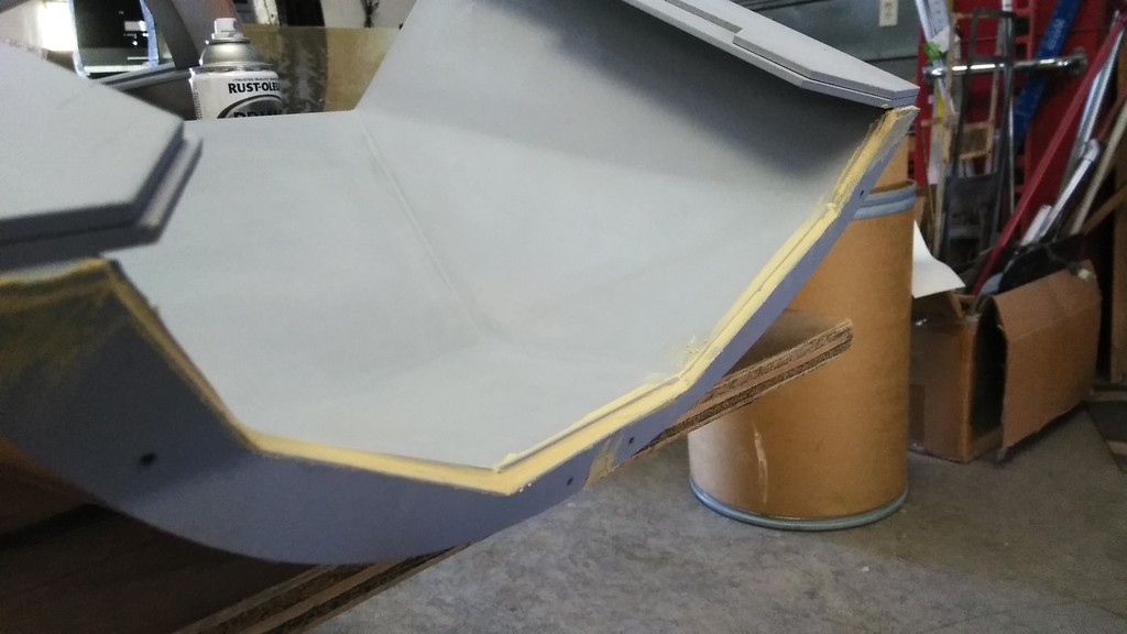

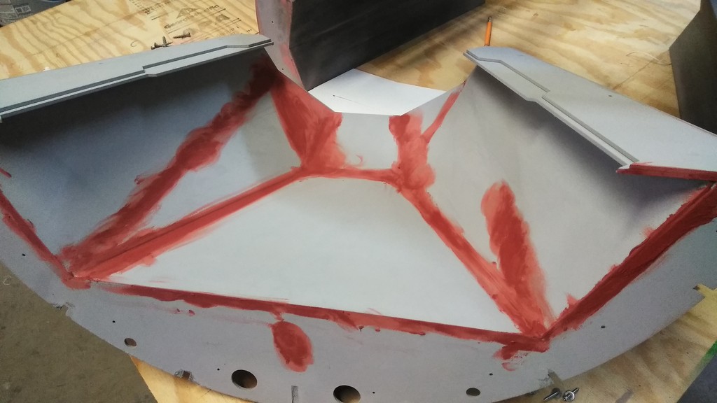

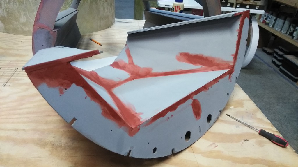

I spent a LOT of time trying to get the floor of the nose smooth
I spent a LOT of this weekend sanding...
I reinforced the underside of the nose - its ugly but it worked! ;)
Added some filler
Sanded the edges clean

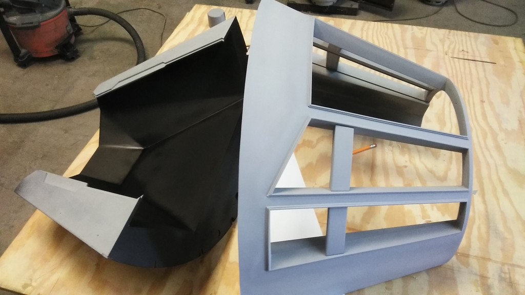

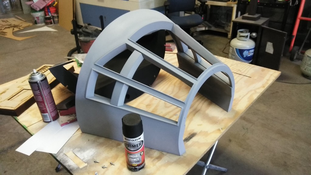

Then to change things up I sprayed black primer - I love the look! It's so close to final

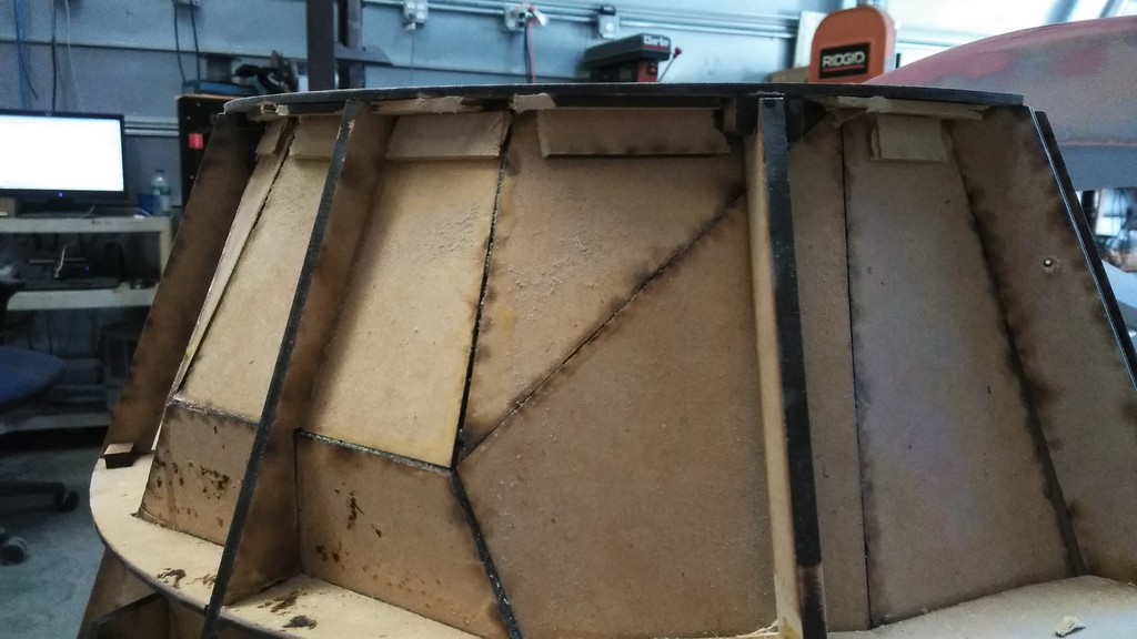

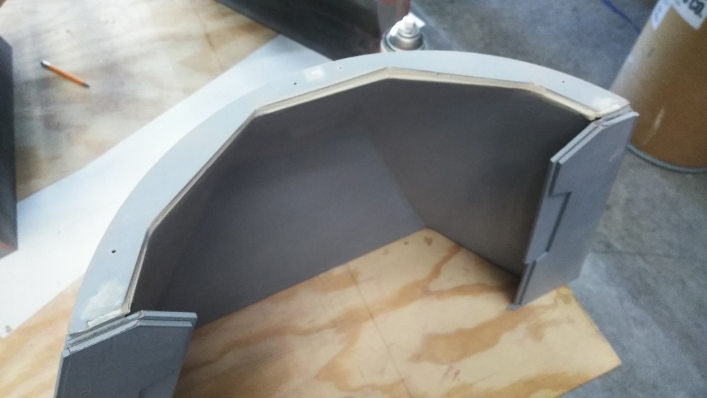

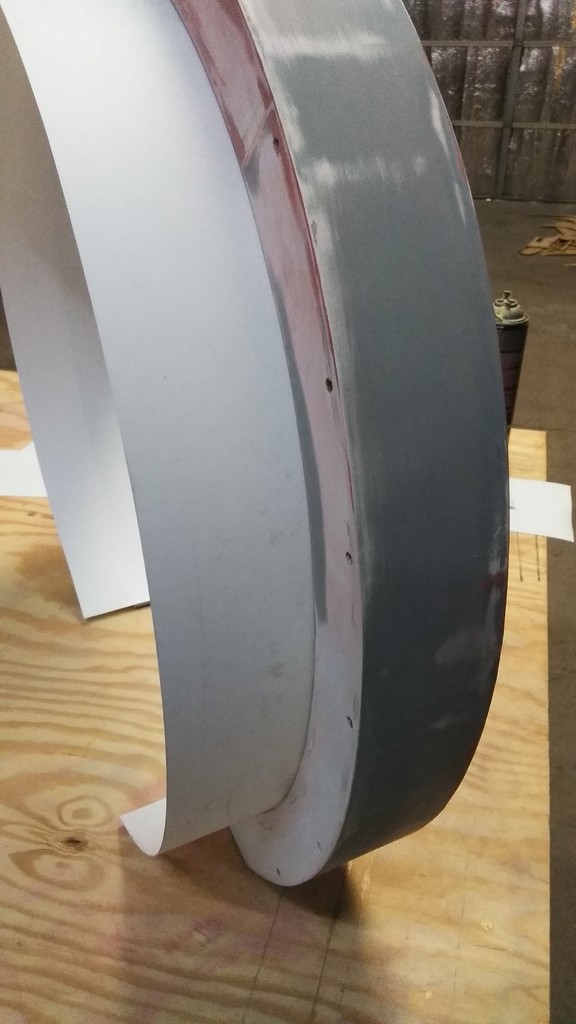

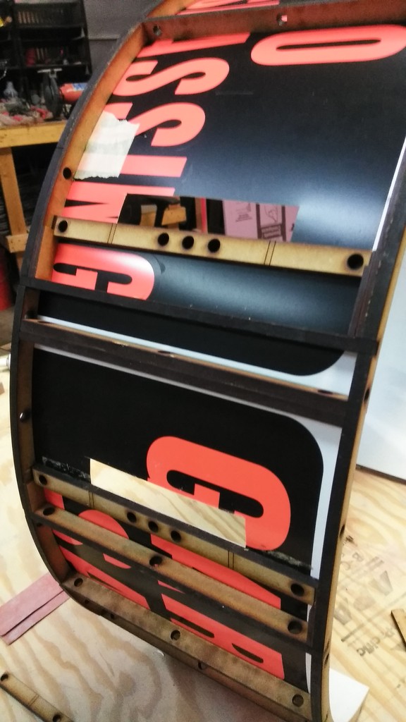

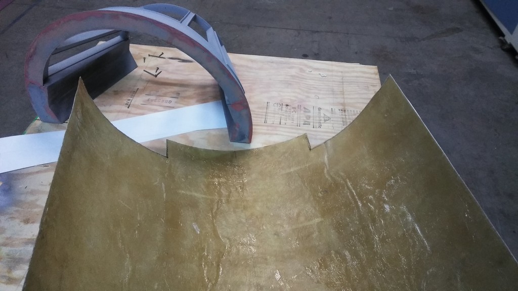

Part II: The Fiberglass Skin

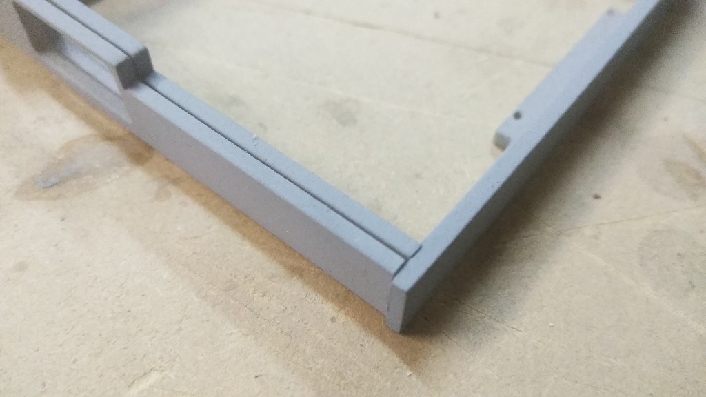

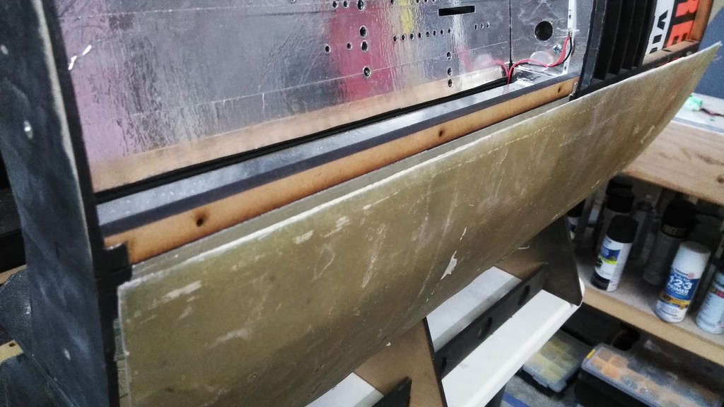

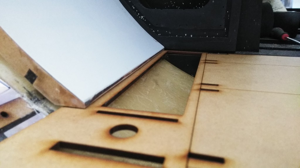

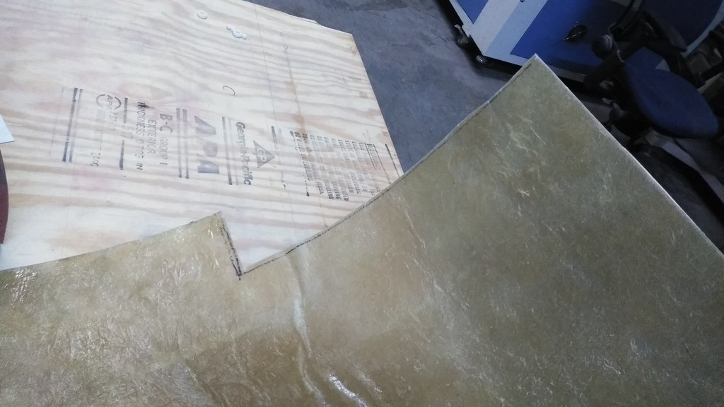

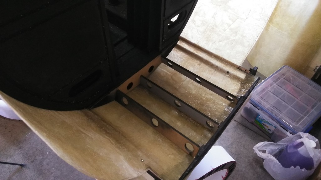

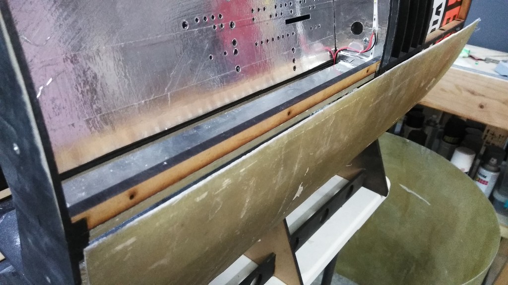

Just as I cut the upper skin I mod'd the lower fiberglass skin
I notched the sides leaving the bottom to cover the frame

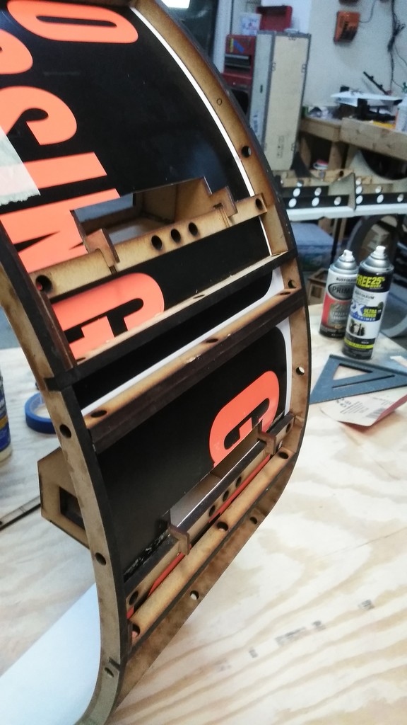

I laser cut these mounting strips
And adhered to the frame for the skin to mount
Part III - on the way!

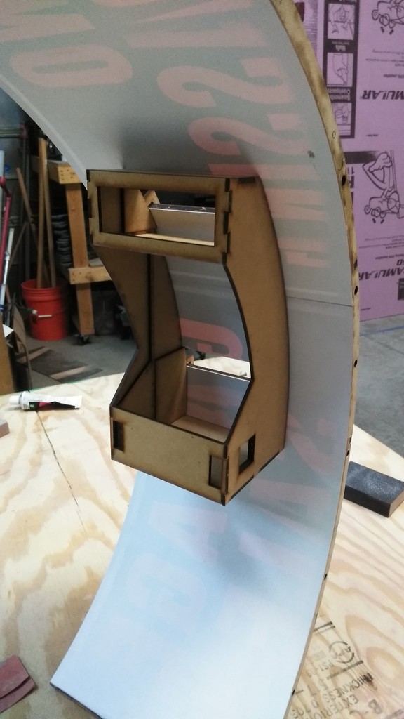

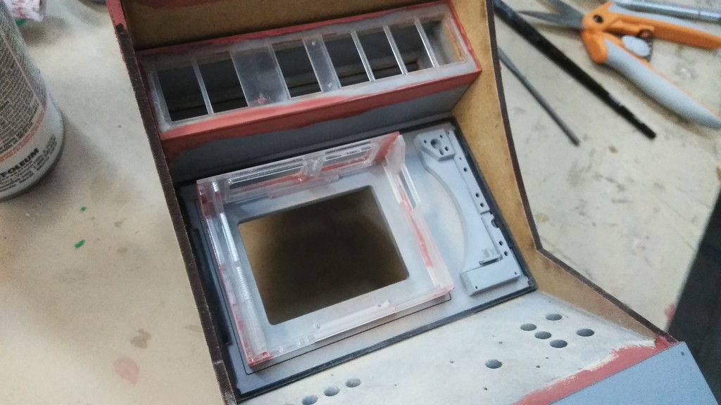

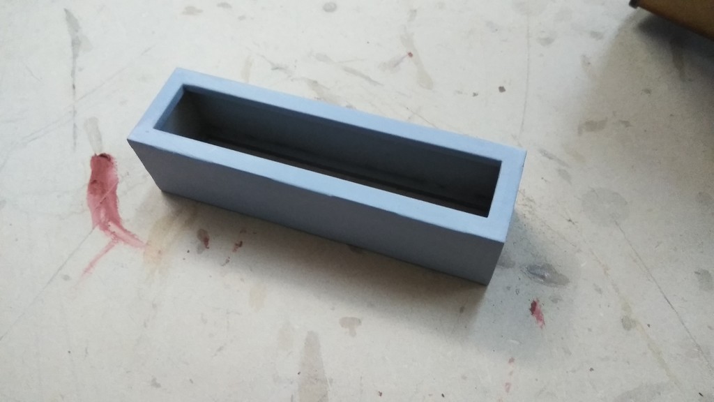

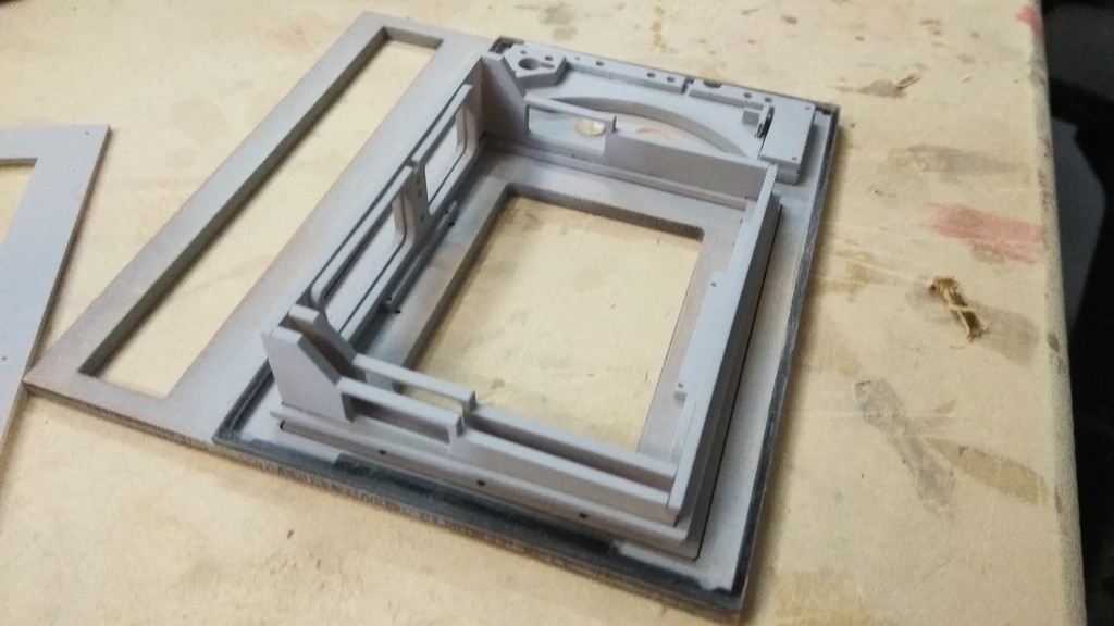

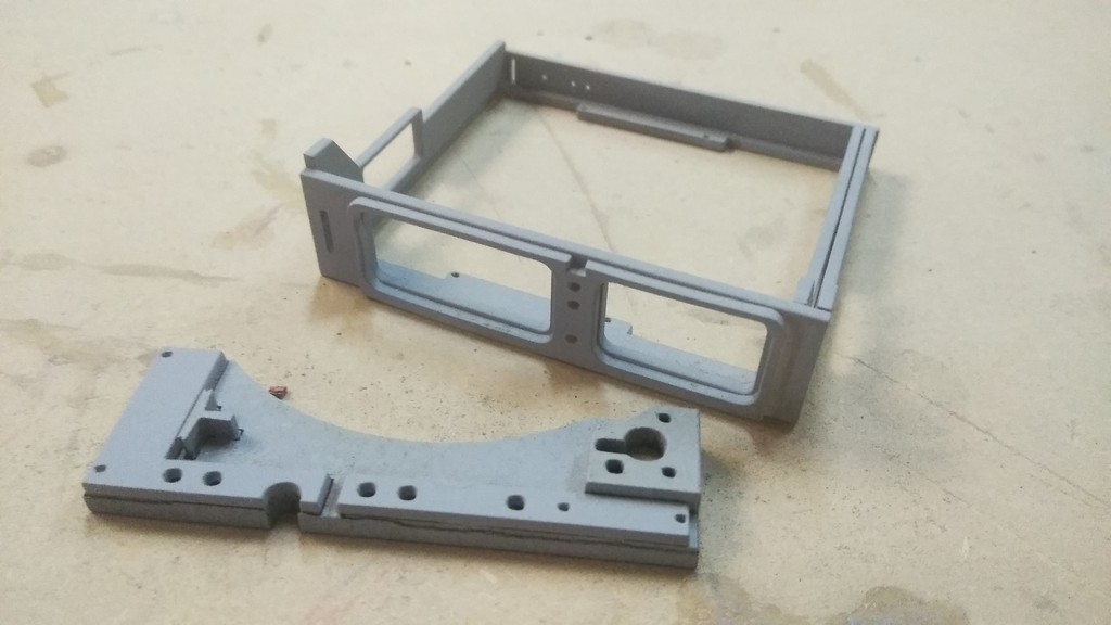

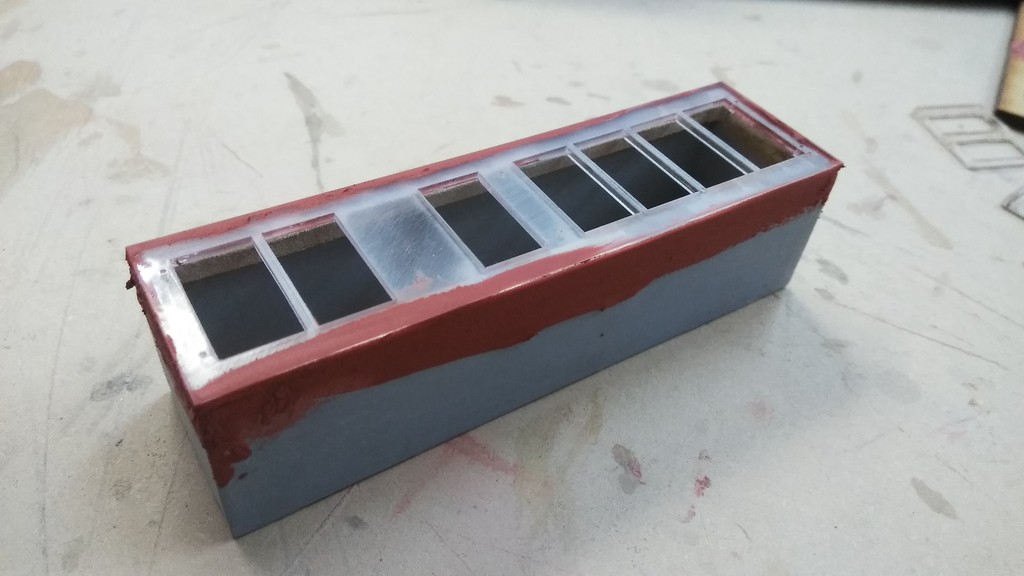

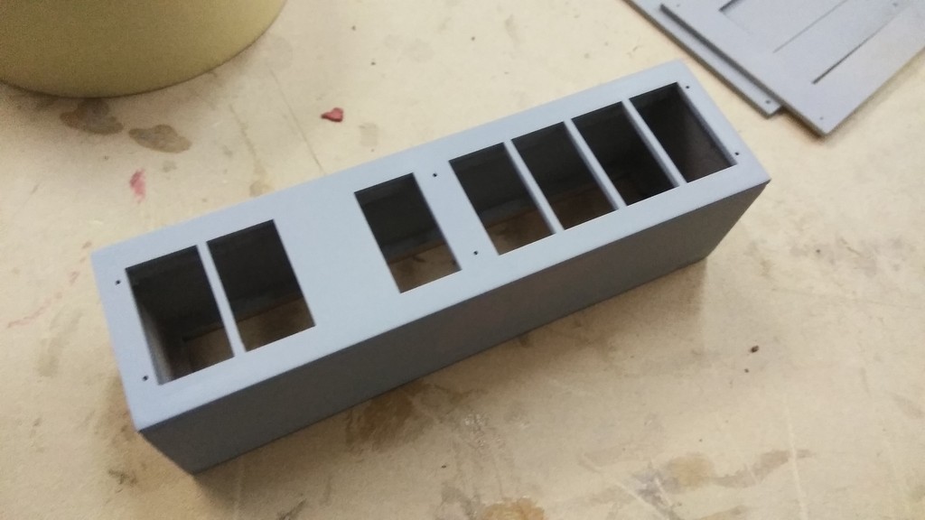

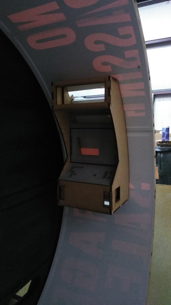

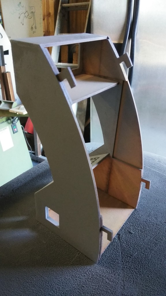

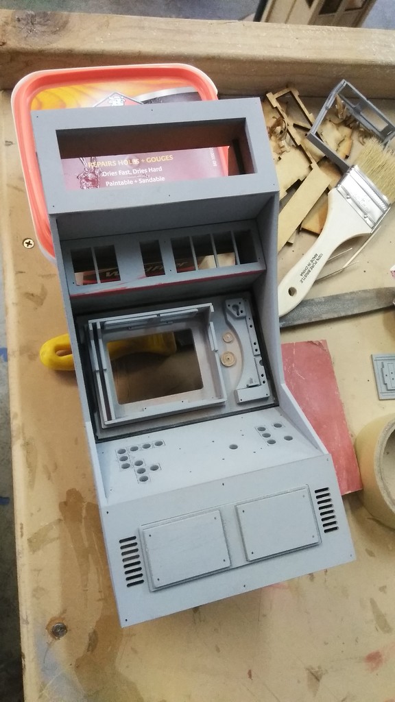

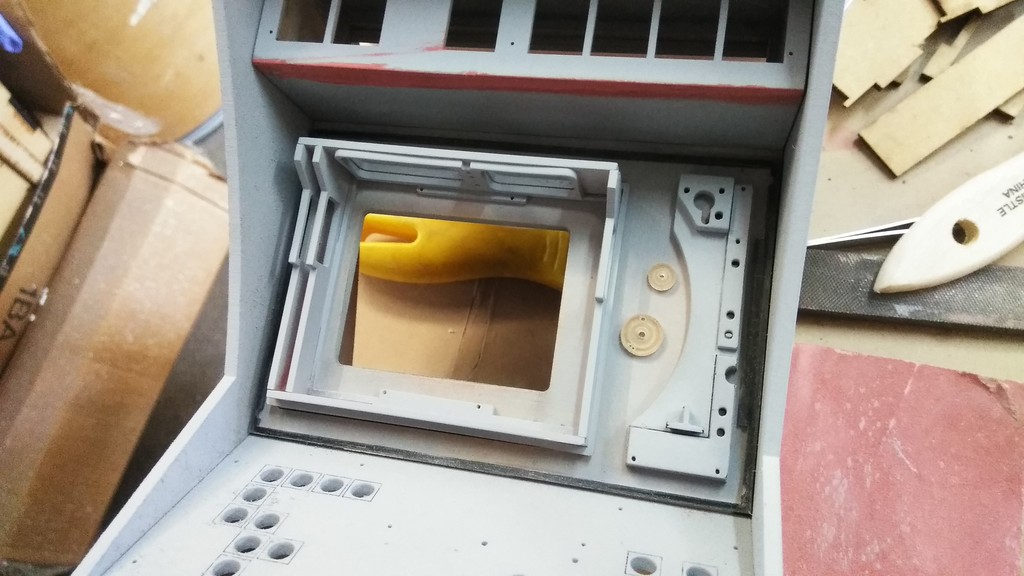

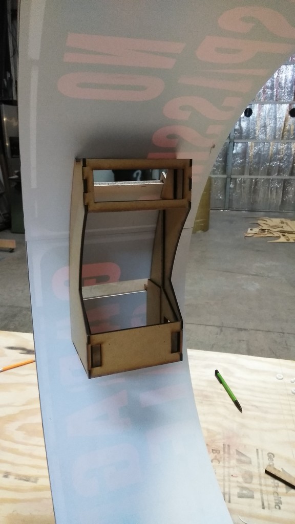

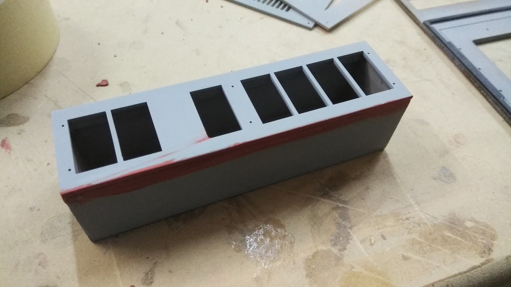

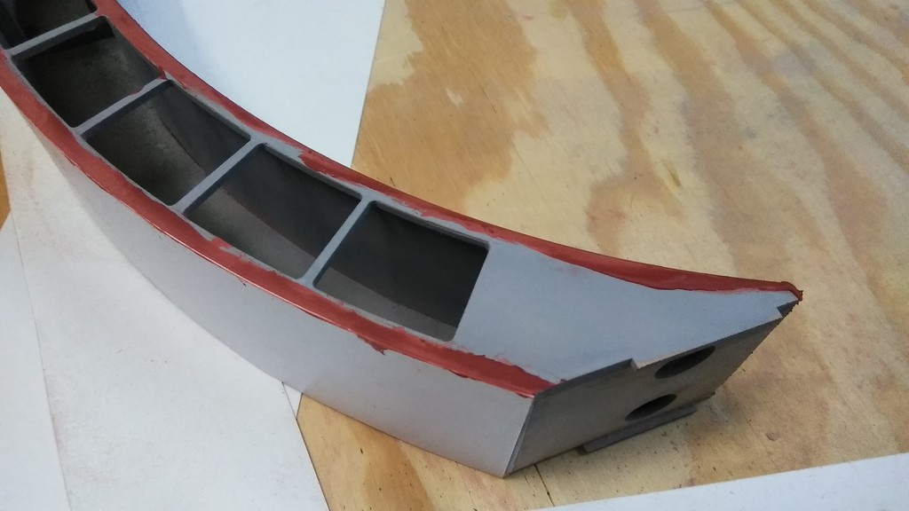

Part IV: The 1/4 Scale Maintenance Console Greeblies

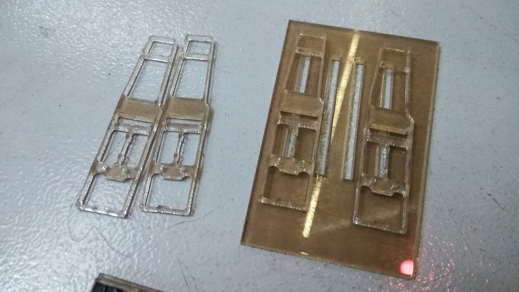

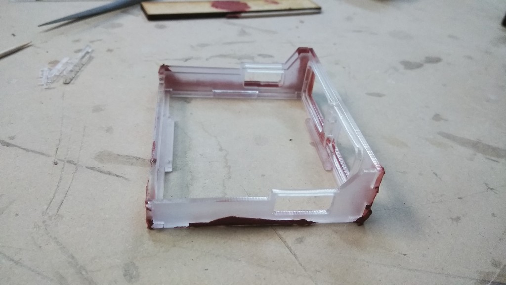

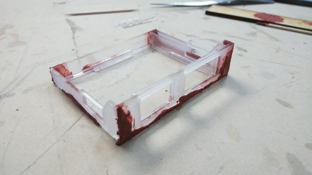

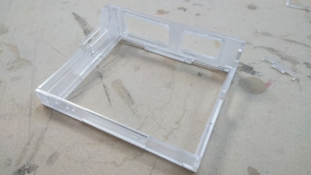

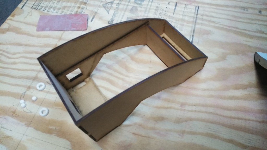

I redesigned this monitor surround with tabs for easier assembly

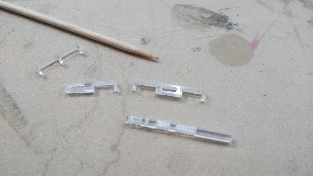

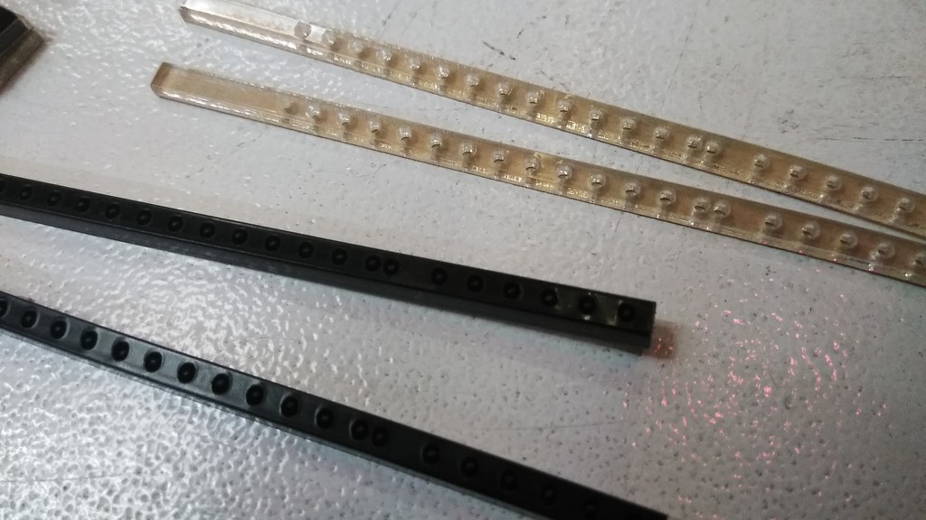

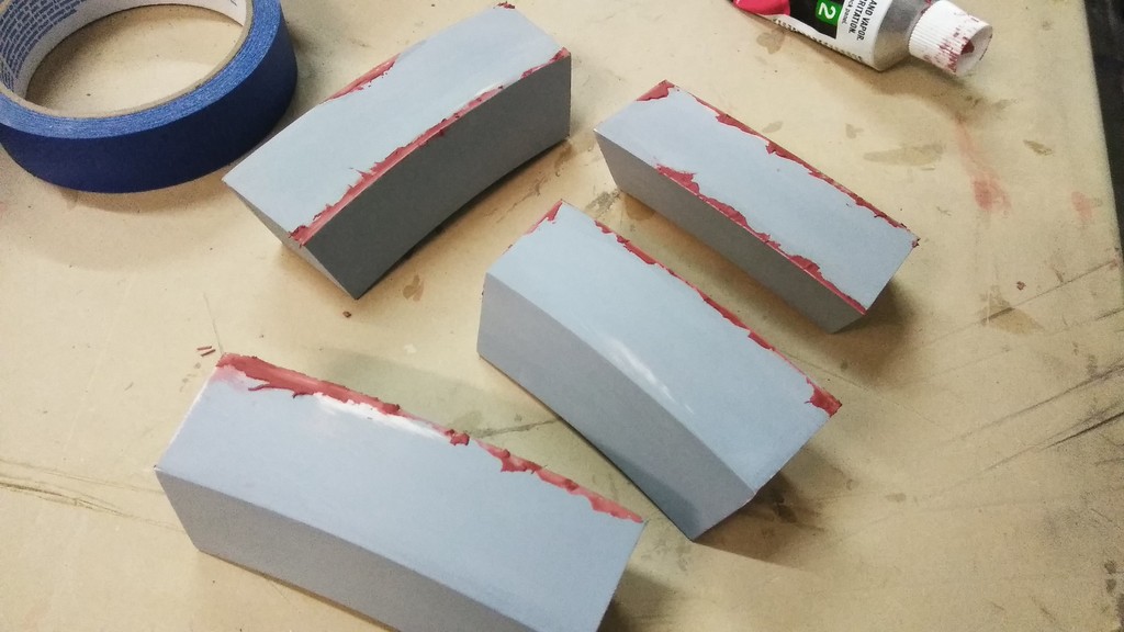

That's not a pencil... that's a toothpick! More little details laser cut and ready
Filler

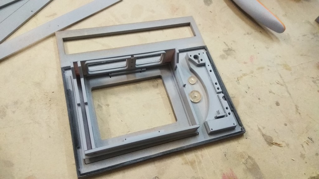

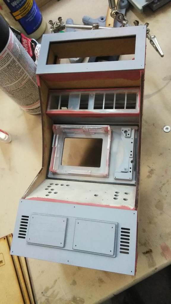

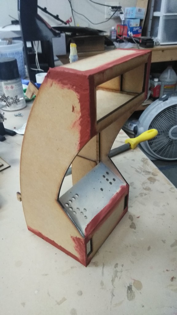

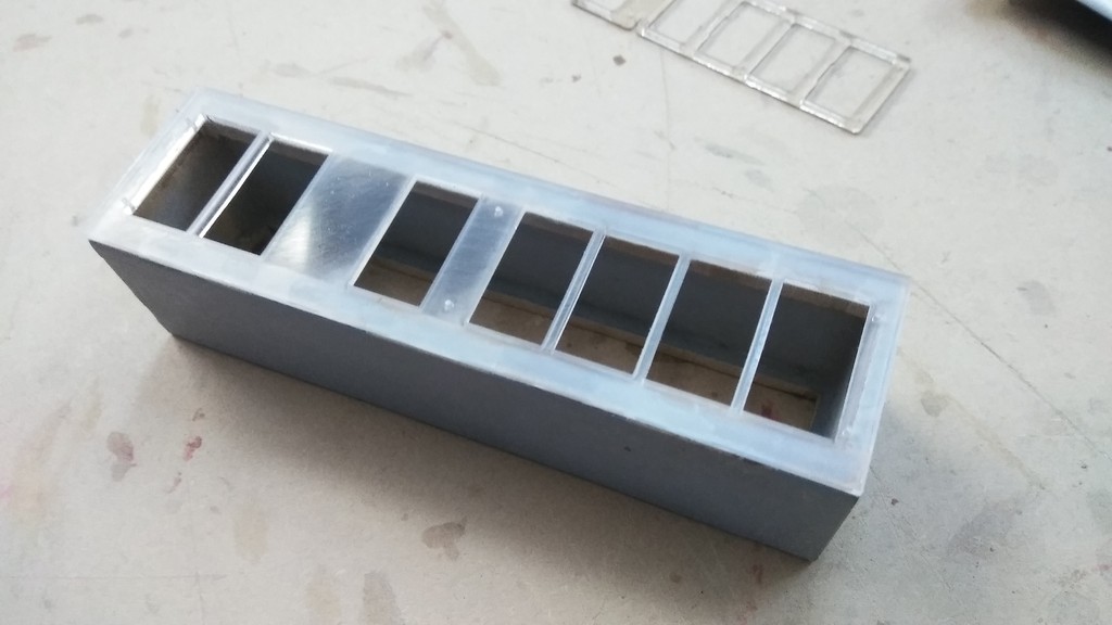

I fabricated a new "Gauge Cluster"
Cover & Trim Plate
Cover plate sanded and attached
Monitor panel with dry fitted parts
More to Follow!

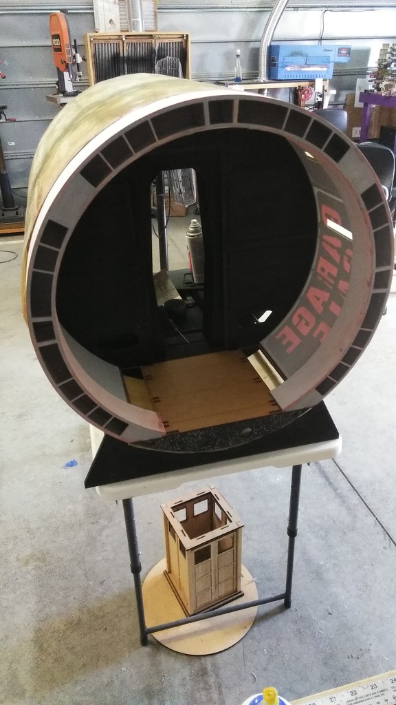

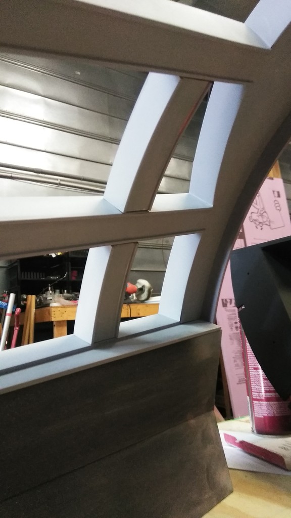

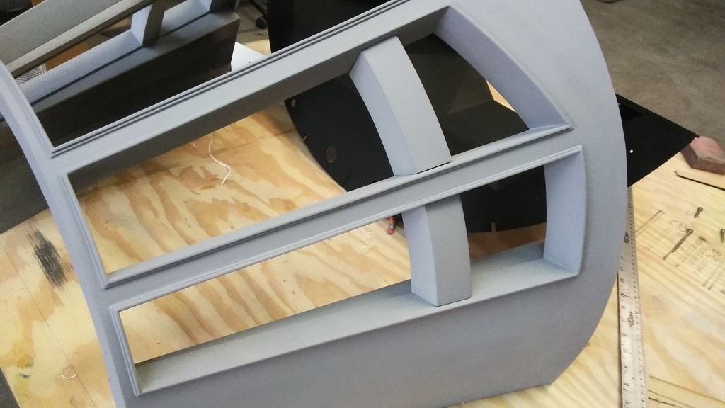

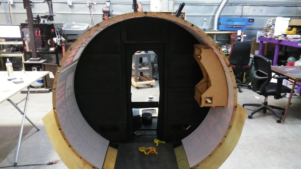

Hi Gang,

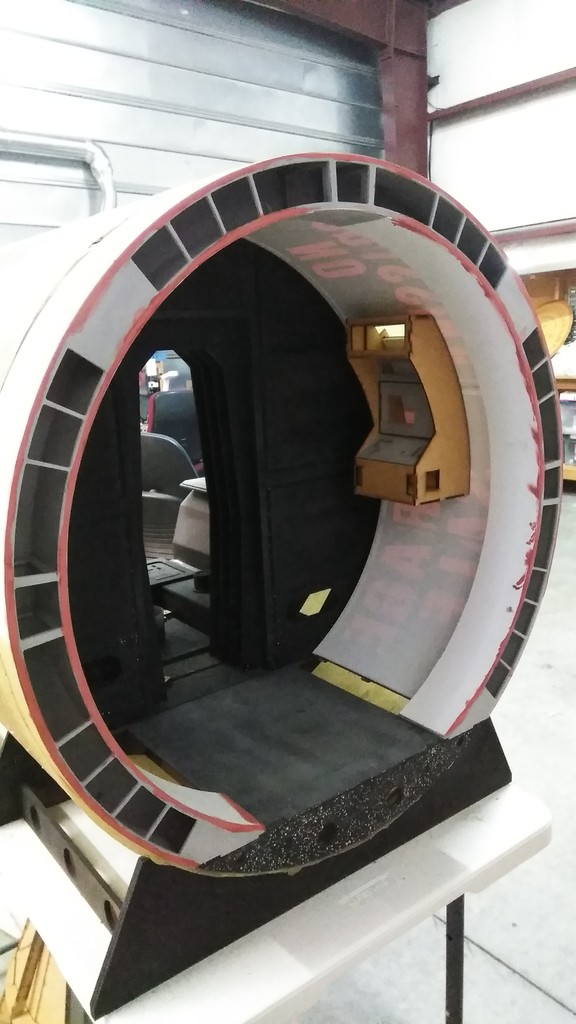

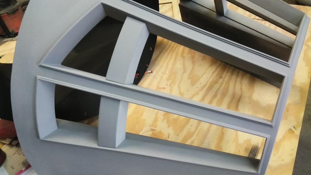

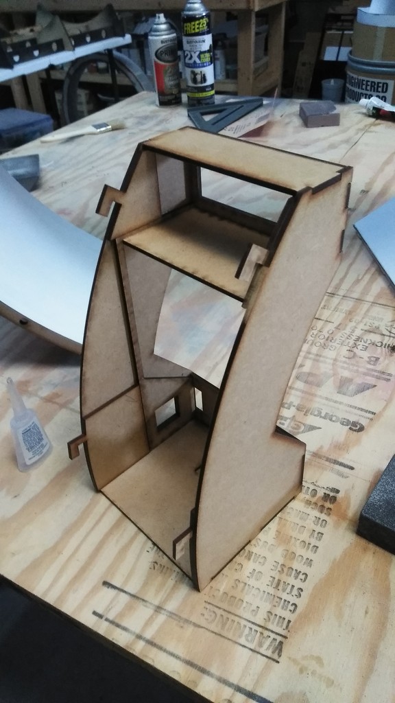

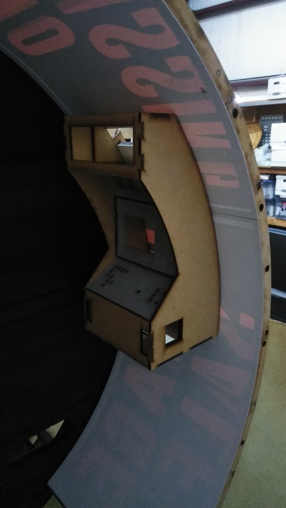

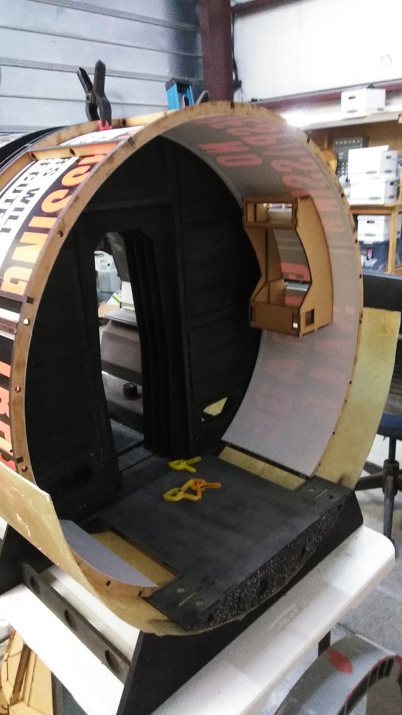

Part V: The Corridor Wall & Entrance
I drilled holes into the wall frame to help keep in place
More work on this guy...
Sanding NEVER ends

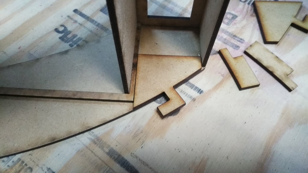

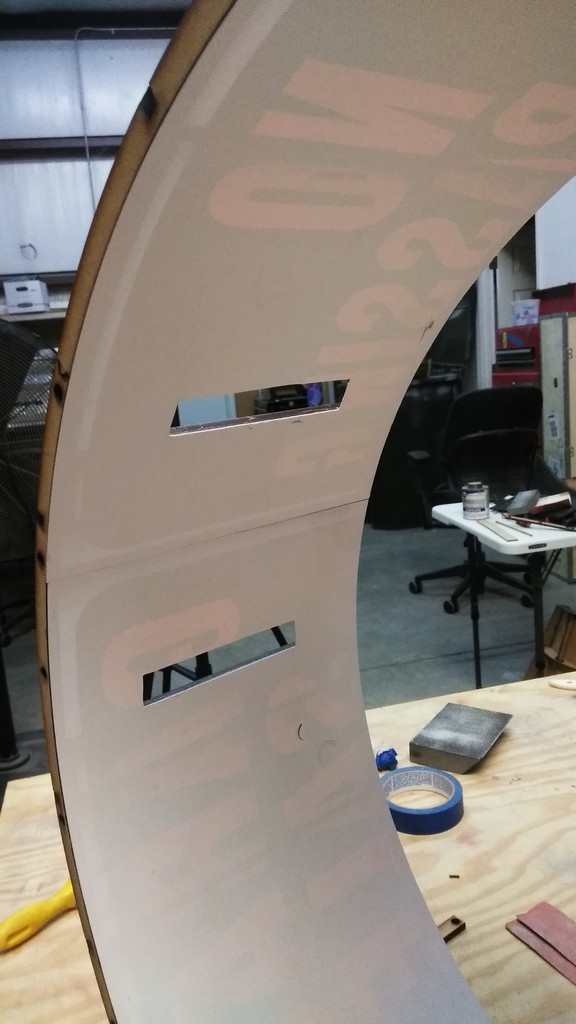

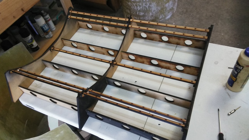

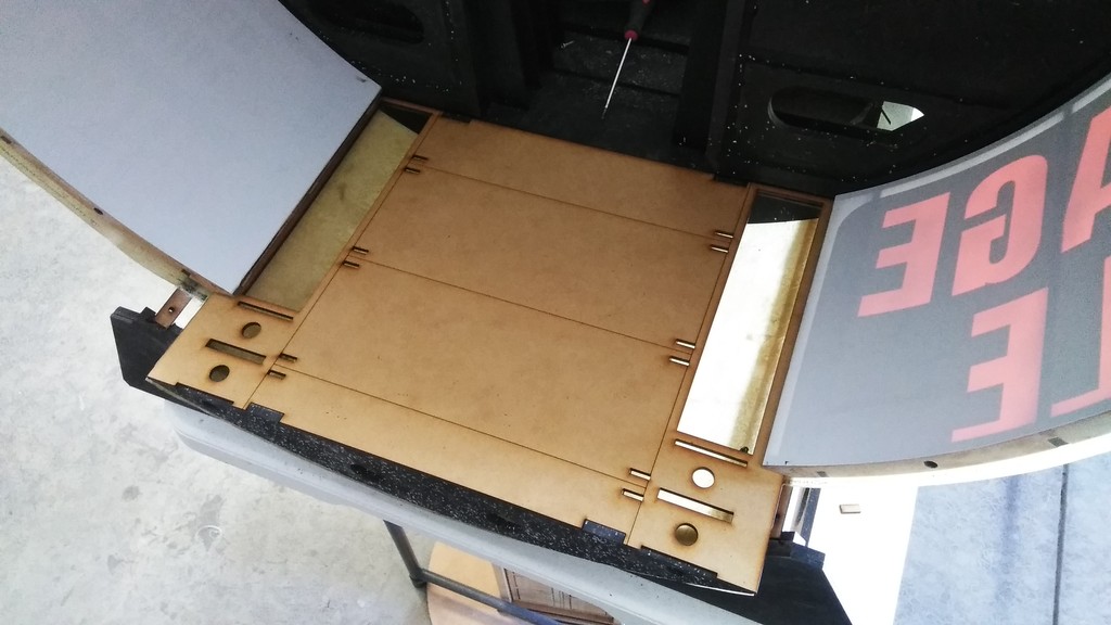

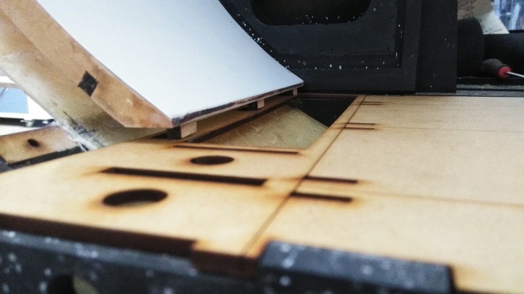

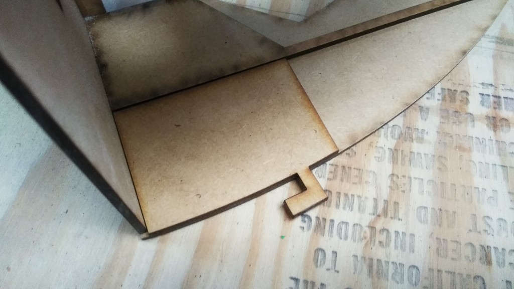

To help keep the walls in place I designed and laser cut a new floor with tabs cut
I added the tabs to the bottom of the frame and cut the holes in the floor
PERFECT!
Gee... a plan comes together?
And its still a circle!
Part VI Below!
