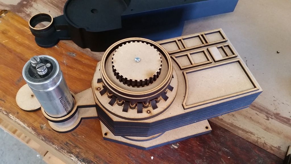

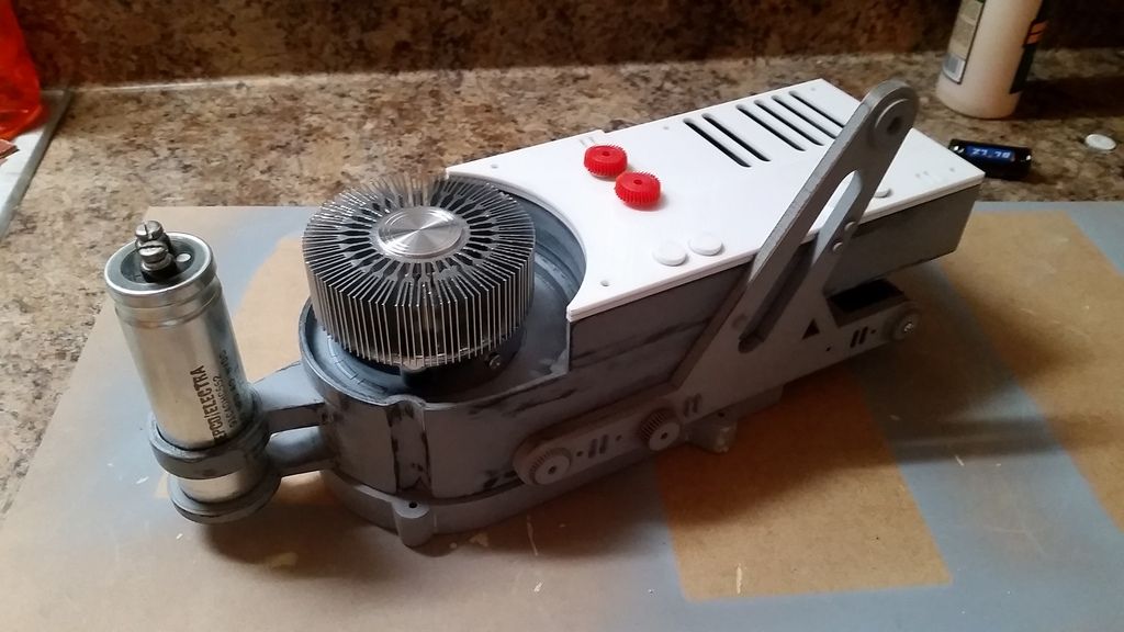

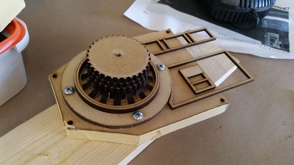

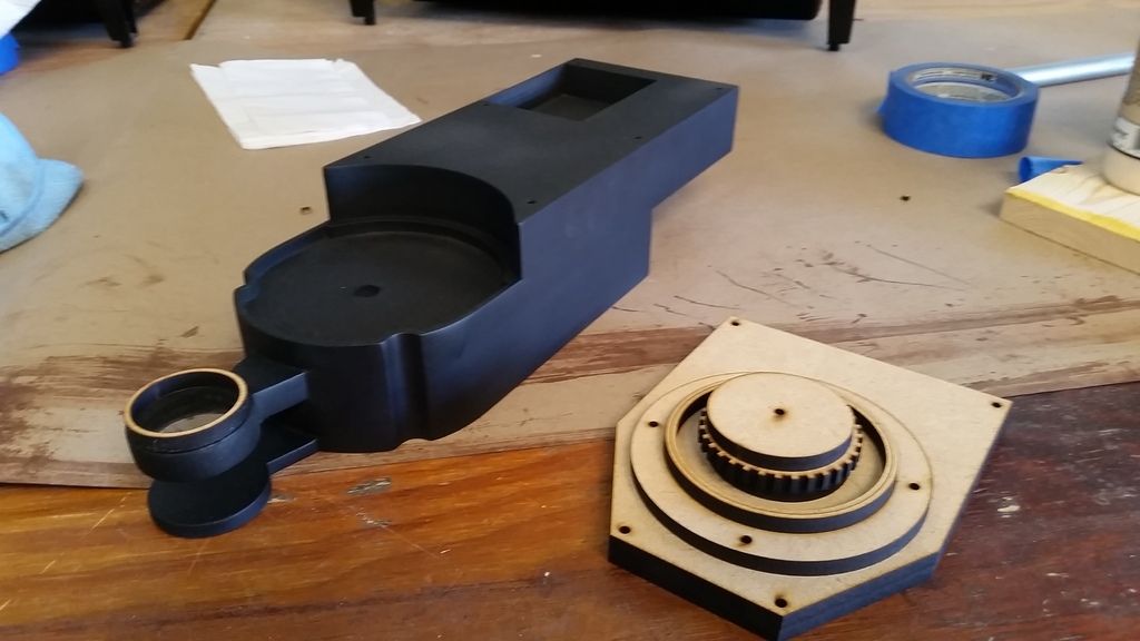

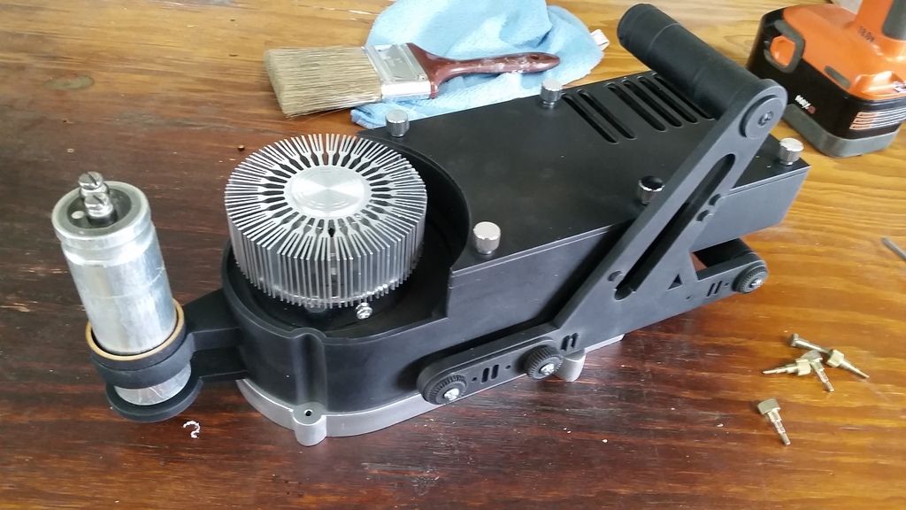

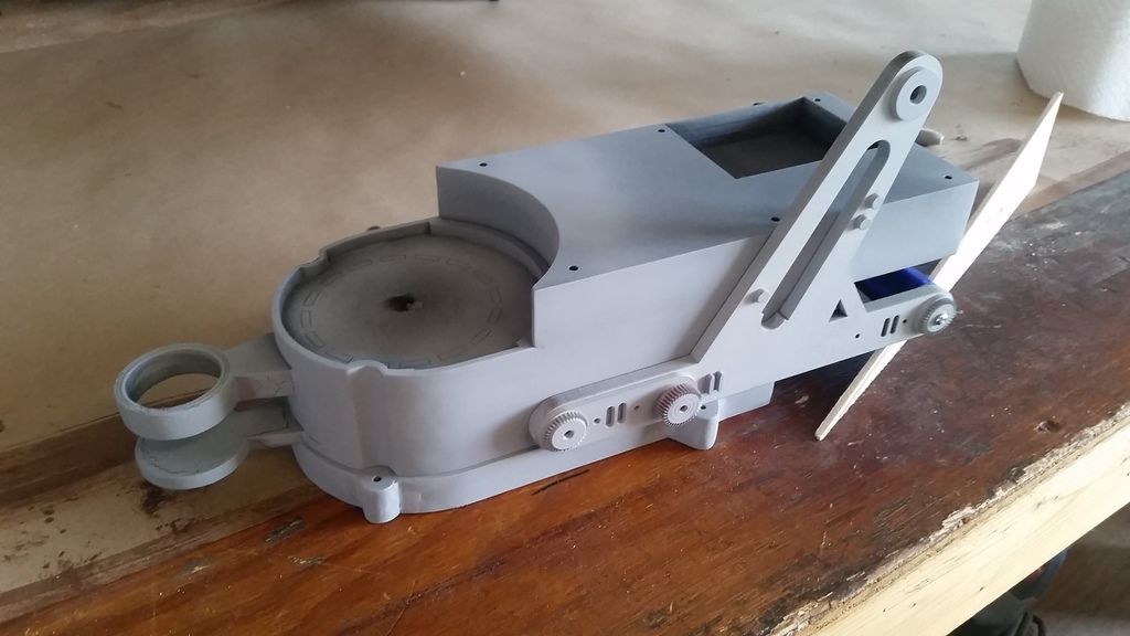

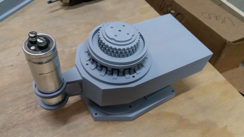

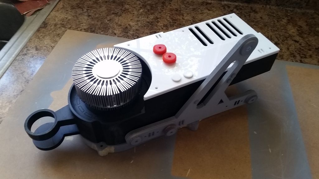

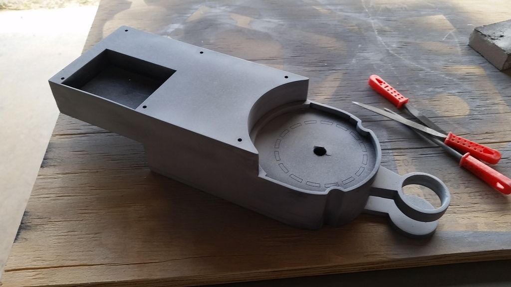

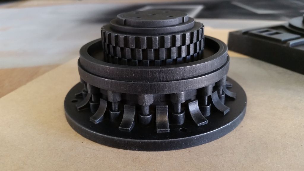

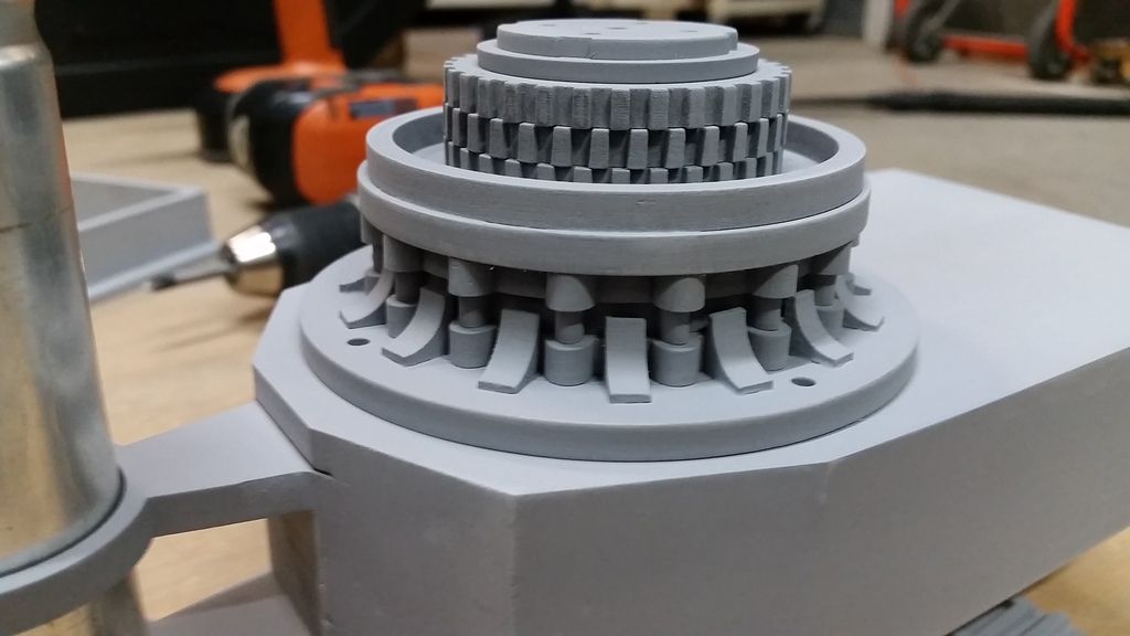

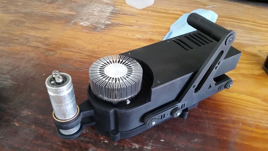

Quick morning update! Work continues on the foot well greeblie!
Still lots of sanding and minor filling to do

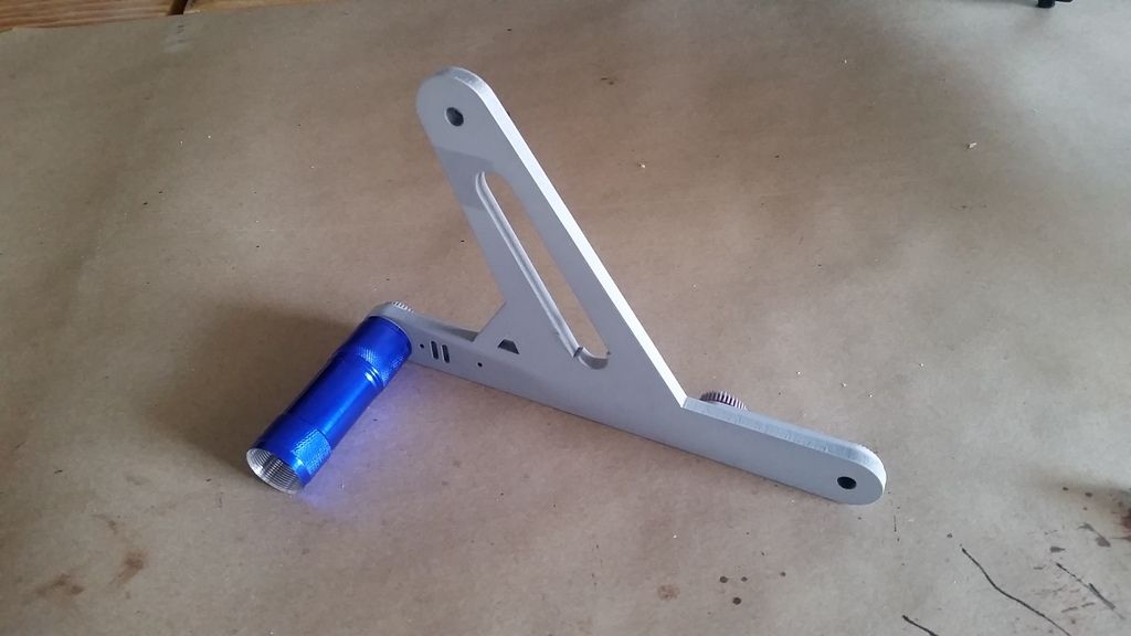

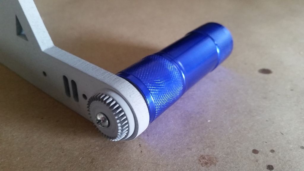

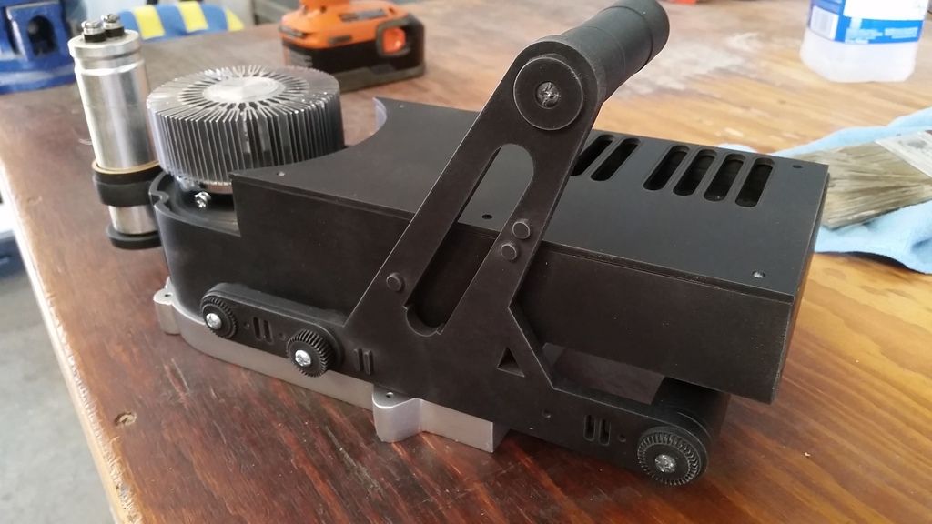

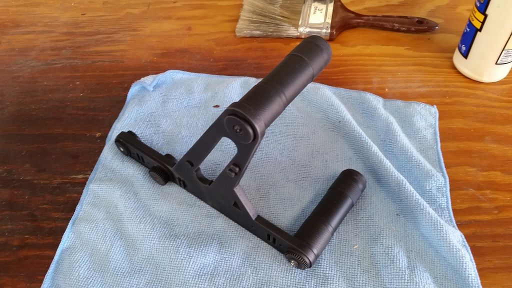

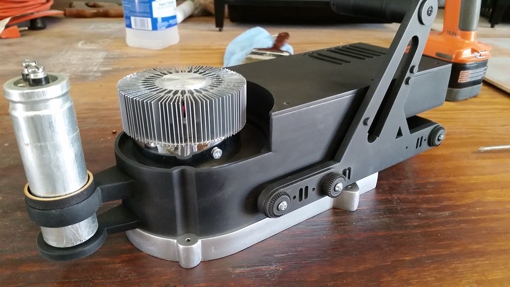

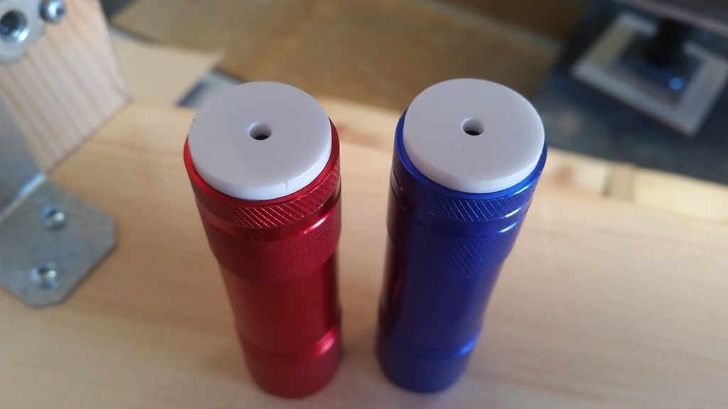

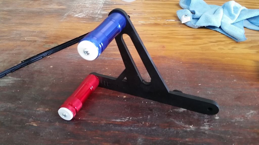

I found two old Harbor Freight LED flashlights to use as the handles. I like it!
More sanding
UGH
This is the basic look of the greeblie minus the second handle and paint
Stay Tuned! More to Follow!

It going to be mounted in the foot well area along side its little brother greeblie - need to finish up the design and then laser cut. The second one will be slightly smaller with some familiar greeblies attached.

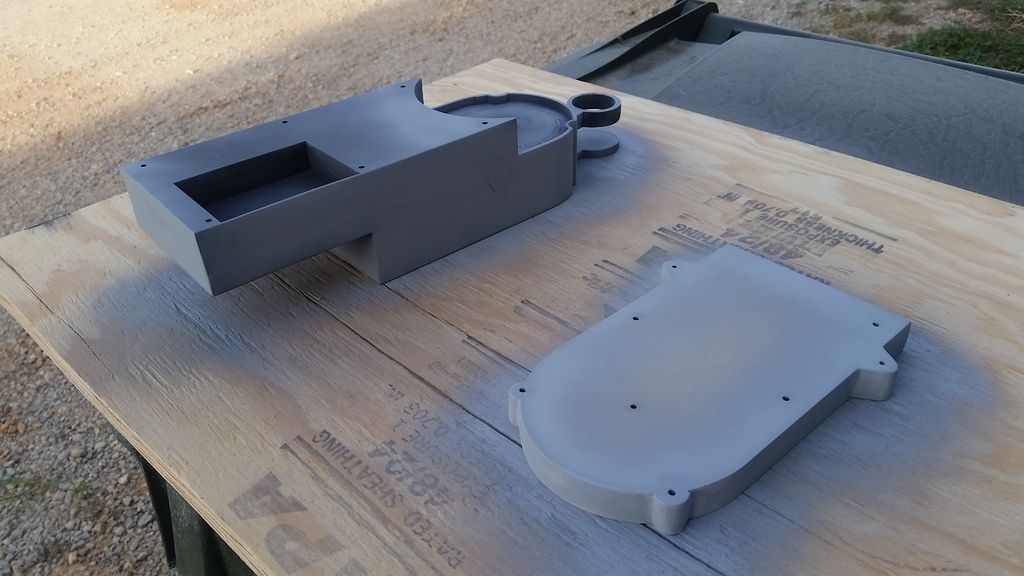

Hi Gang,

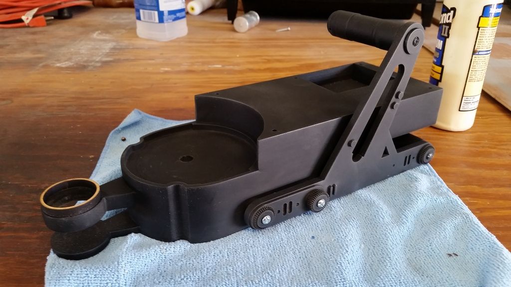

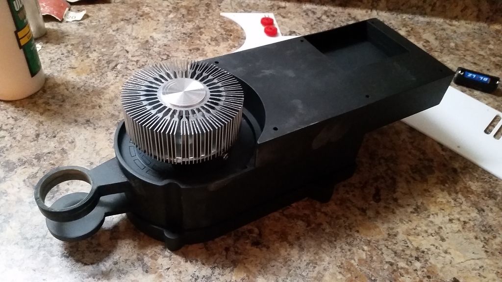

Small morning update! I managed to get a quick layer of paint on the foot well greeblie
I know that the main body will be painted black. But I'm not sure if the base, leg and top acrylic piece should also be painted black or silver to match the greeblies?
Decisions...

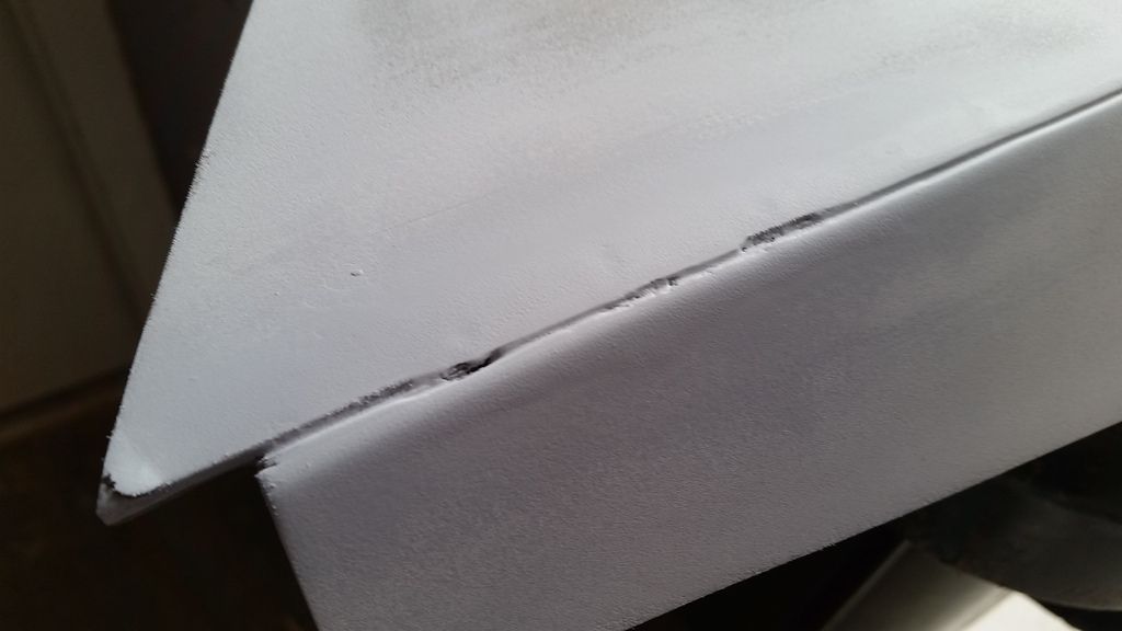

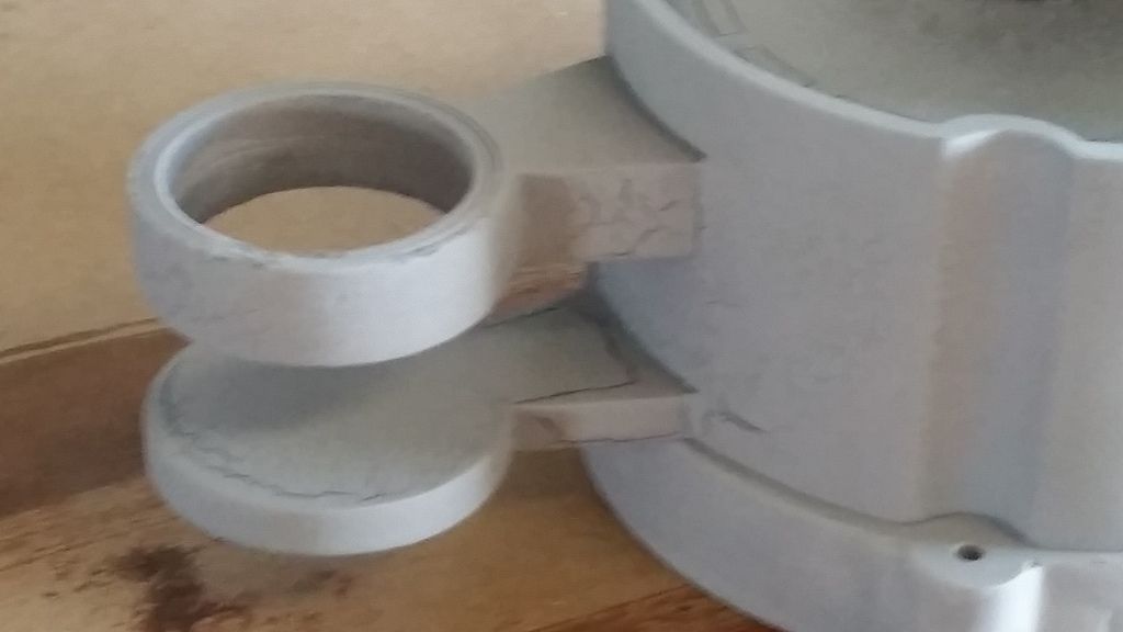

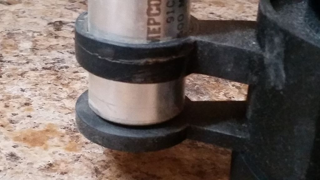

And then of course it wouldn't be right NOT to have a greeblie crack midway through the build...

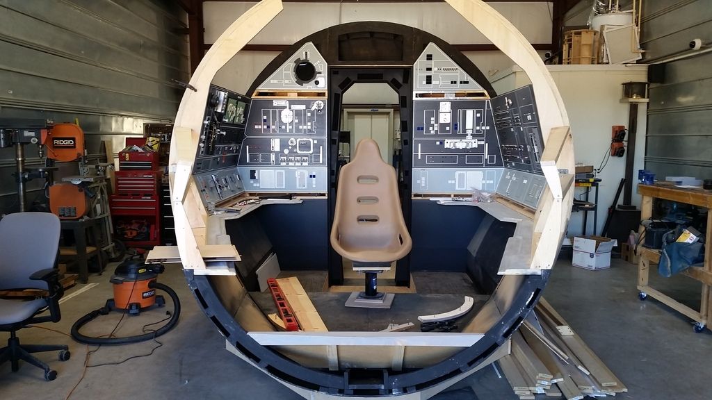

Hi Gang,

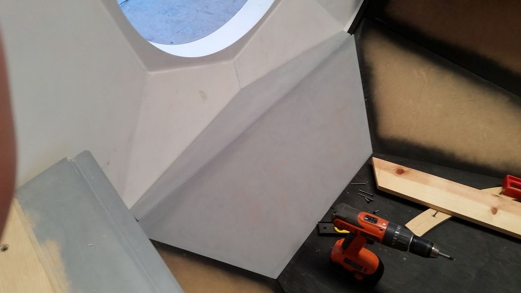

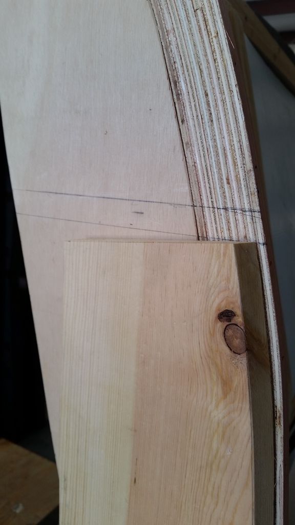

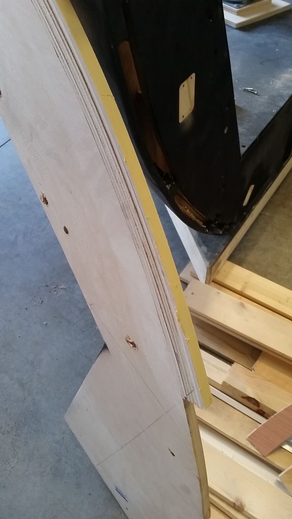

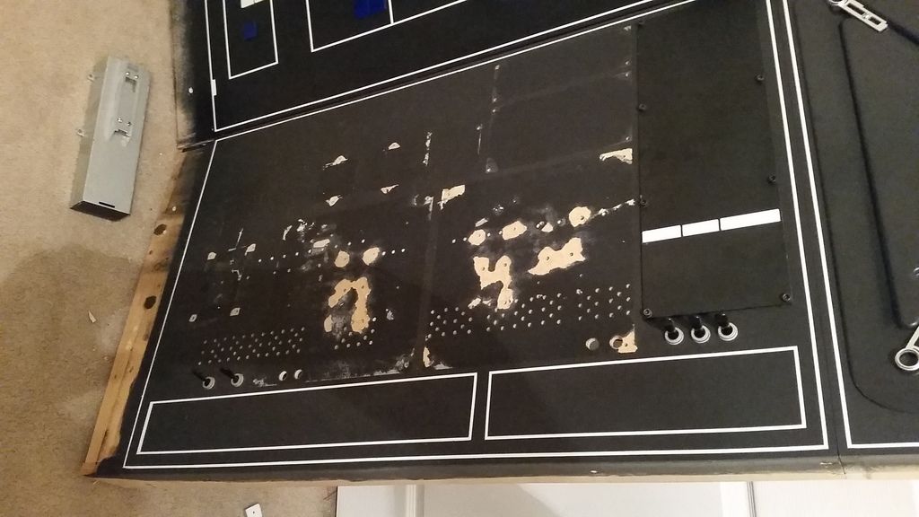

I HATE these dang Volvo Panels... With a Passion!

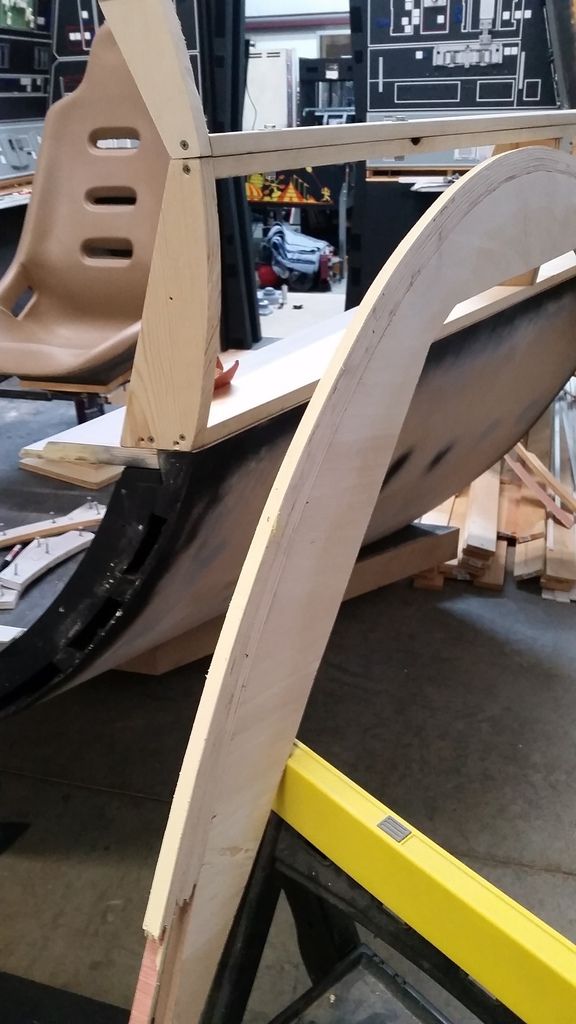

This shows 4 out of the 5 separate attempts to cut the FINAL upper board for the upper Volvo panel on Han's side
FINALLY! It fit! This panel took me 5 hours...

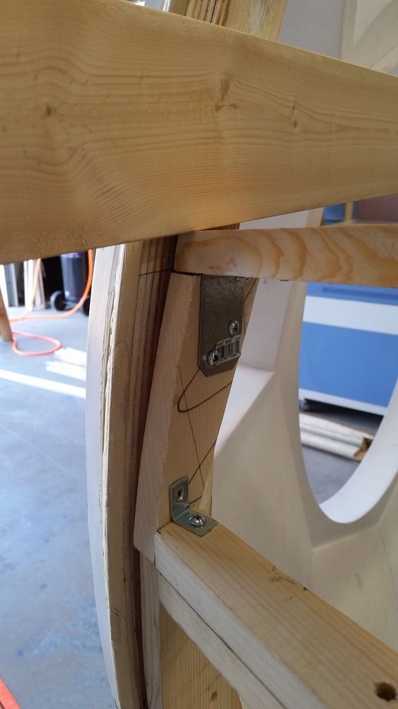

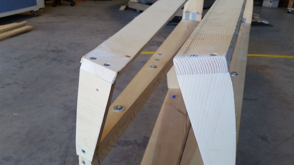

BUT!!!!!!! And this is WHY I hate the Volvo panels... Over the years the cockpit has seen flexing, warping, and so many changes that many of the panels don't match up to others anymore. The panels match to the ones they are immediately attached and associated with but... The cockpit had settled 3/4" too high on Han's side... So, once again I had to remove the upper panel and recut to find where everything finally aligned
The lower pencil line shows how much of the new Volvo panel had to be removed!
When compared to the other side

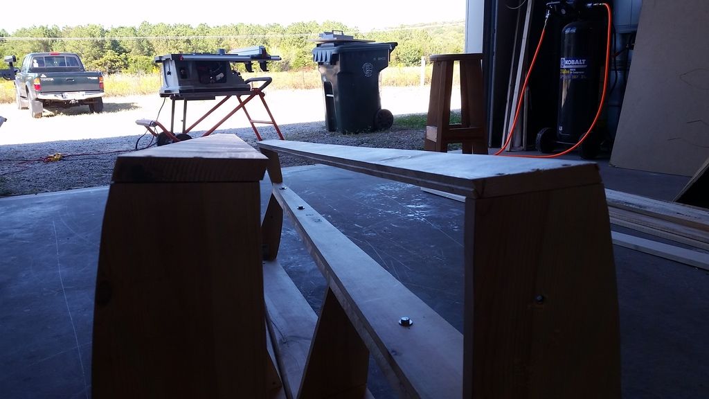

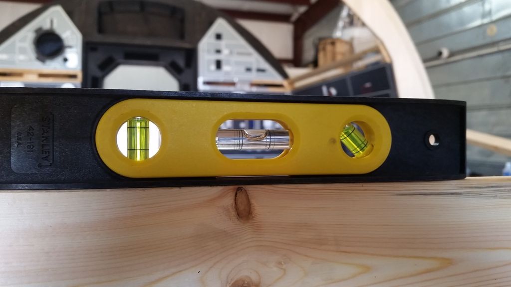

Once the the panel was cut to fit we used the straightest piece of 1x4 and used a level
UGH! Finally

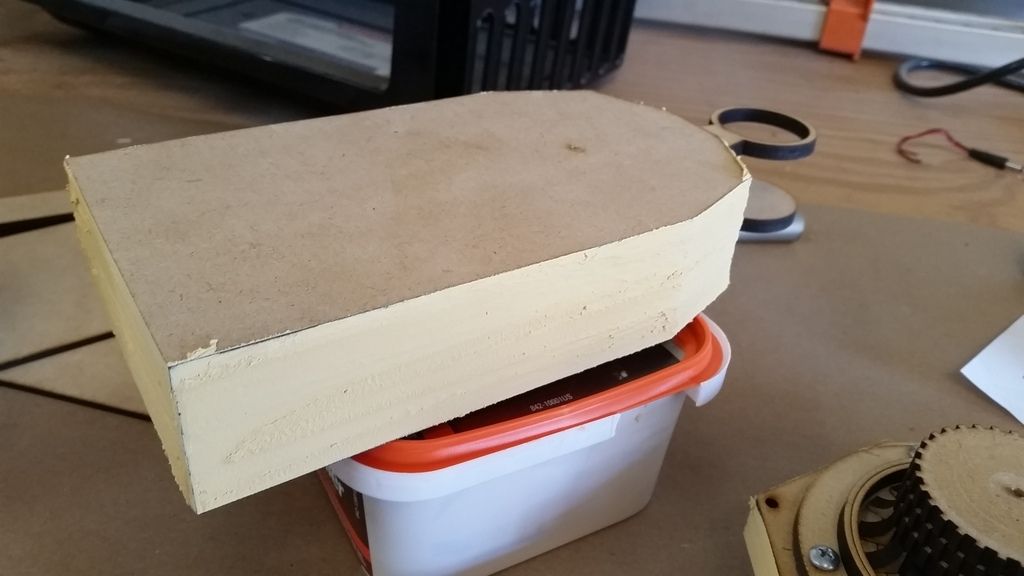

Basic shape
Glued together
Added primer... filler to come!

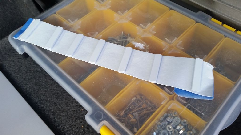

Work continues on the foot well panel - I scored a line in the filler to create a seem but also keep the filler from cracking
Nice
Need to do a little more work and then I can paint and add pinstripes

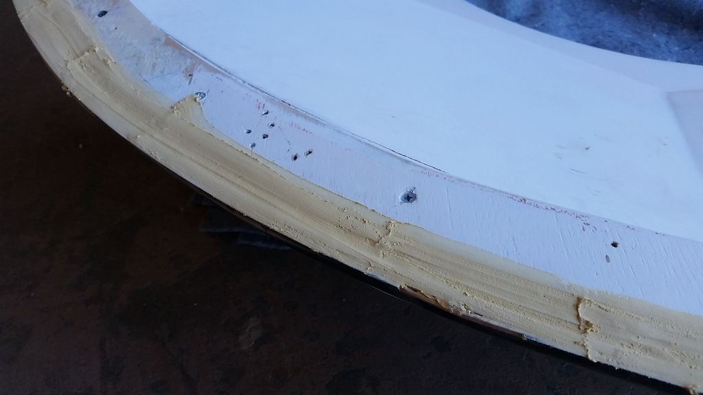

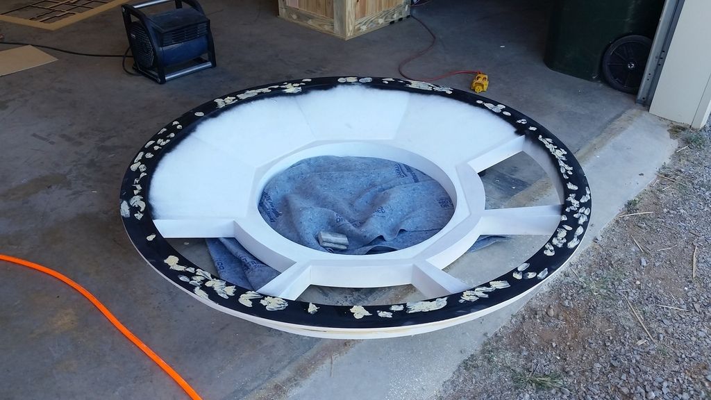

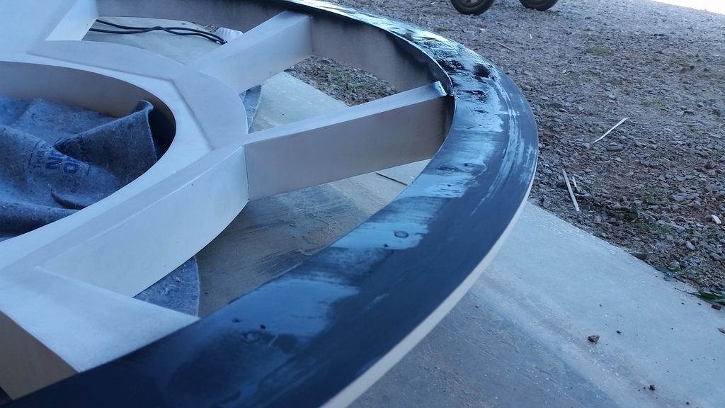

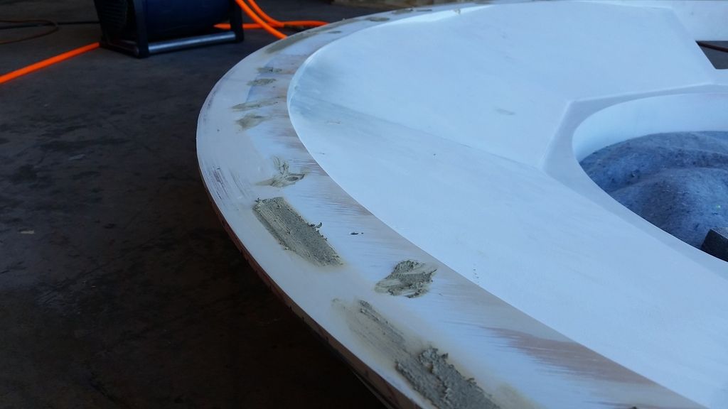

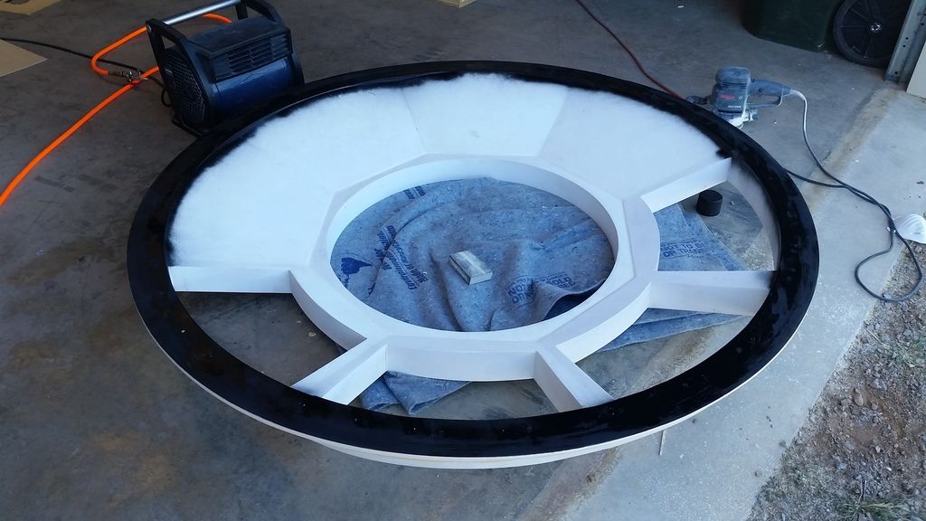

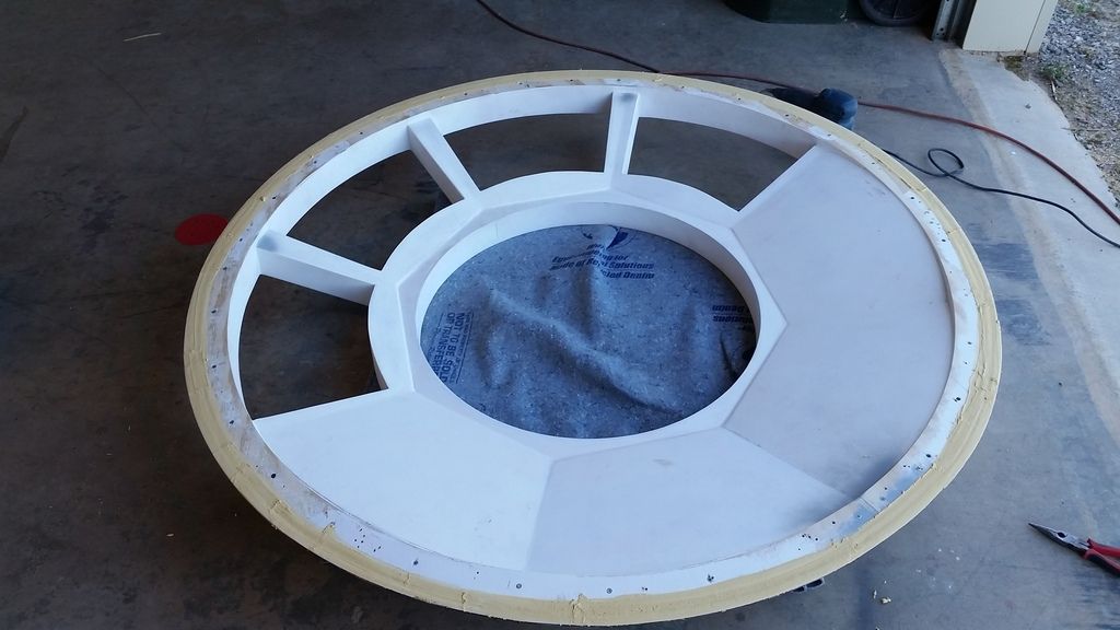

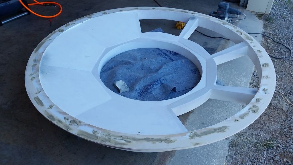

It was time to address the exposed wood on the window
Took the window off

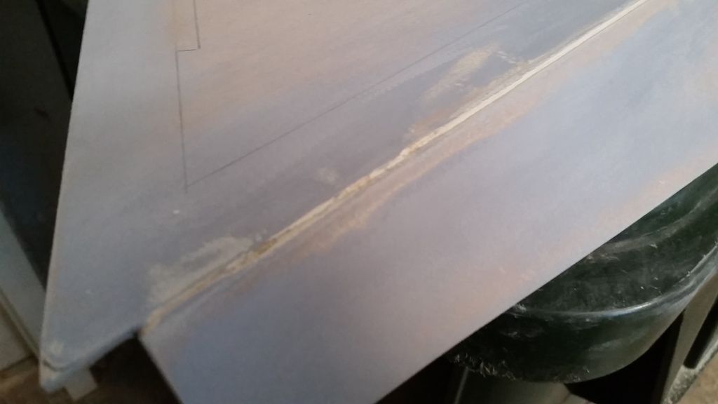

Added filler around the edges
First pass with the sander then added more filler

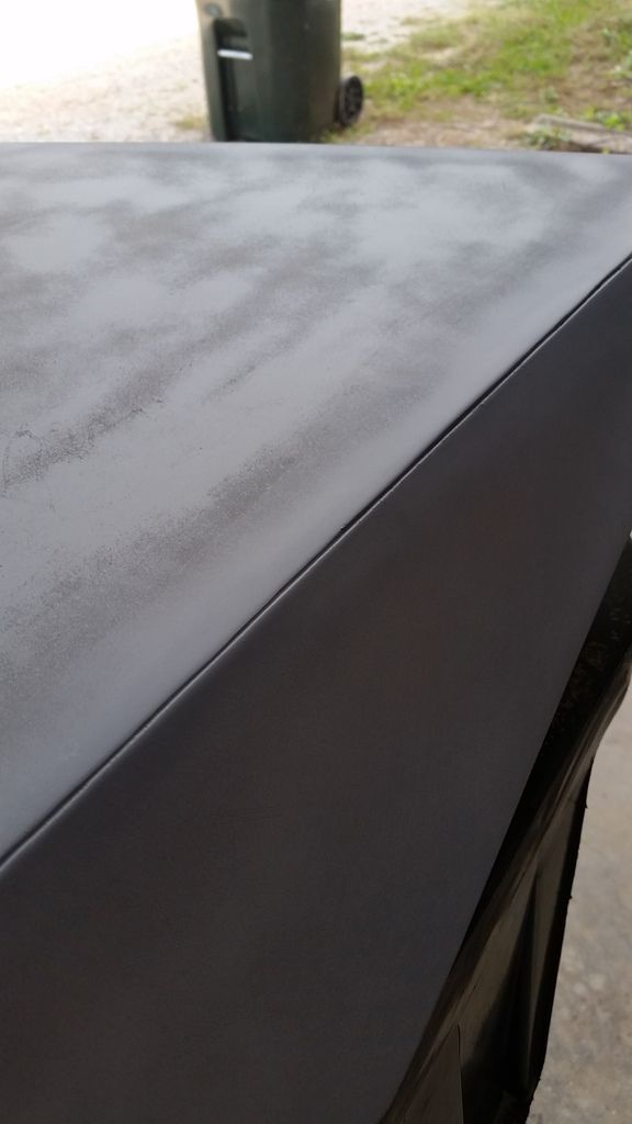

Added black - this allows me to see those few areas that need more attention.
Yeah... Just a few areas ;)

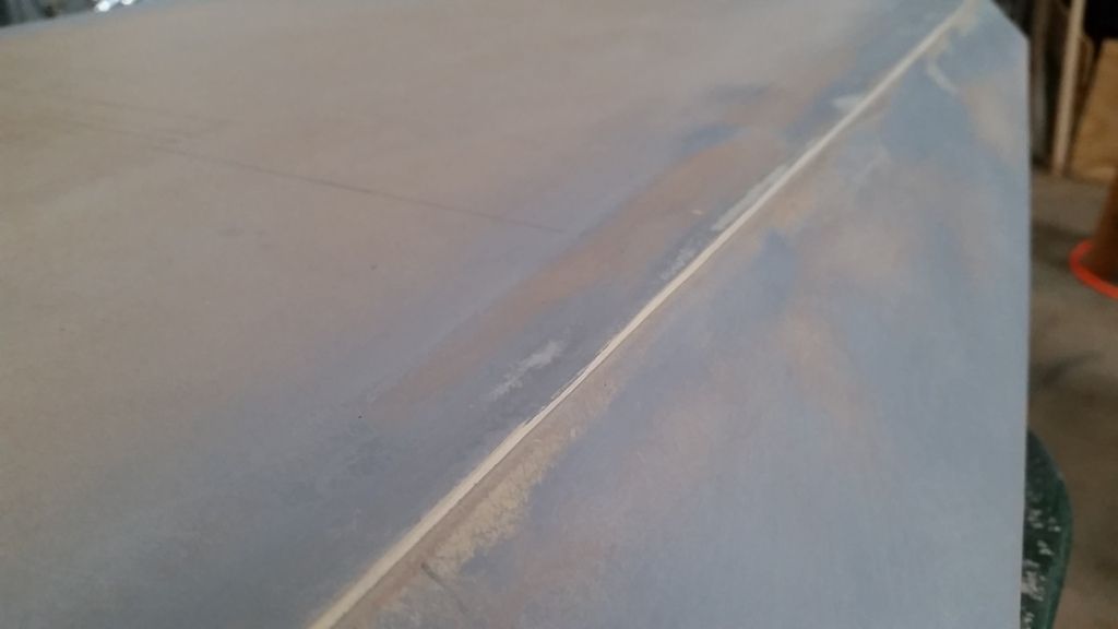

Sanded smooth and added another layer of black

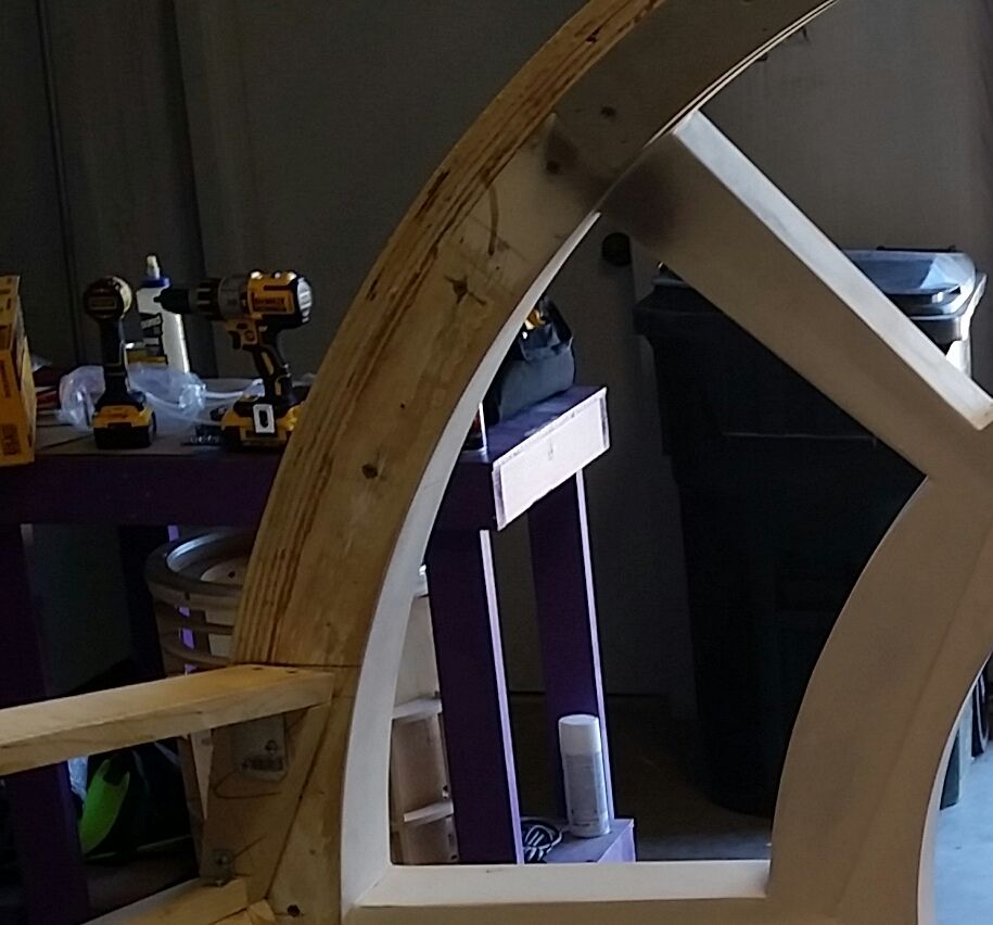

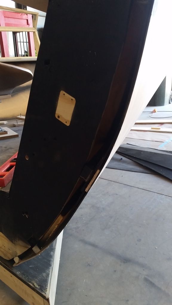

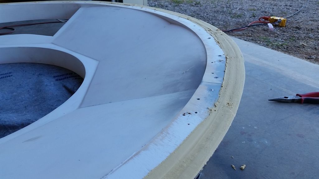

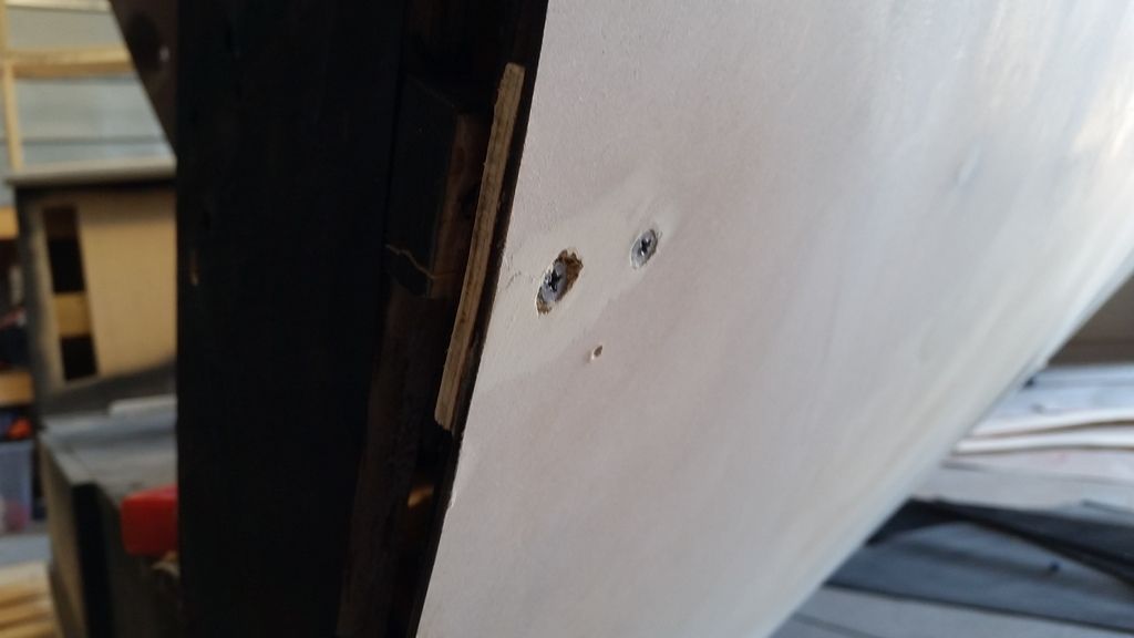

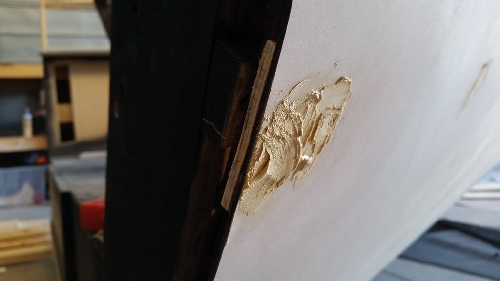

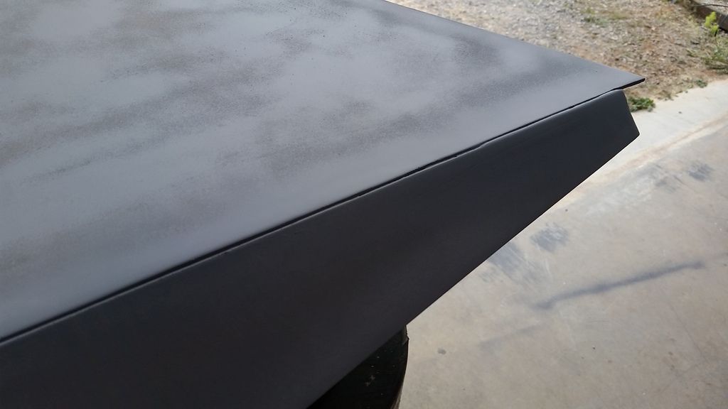

I then address this area of concern on the nose where the skin was warped - added spacer and counter sunk the screws
Then added filler and now waiting for it to dry
Samantha stopped by to help sand and paint a few pieces - the vertical supports that sit between the nose and body were removed and trimmed, sanded and filler added
Filler was added to the exposed wood and left to dry
This was the first time Samantha had added any filler and she did it better than I did! :)

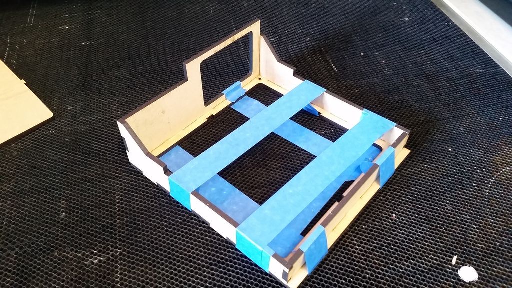

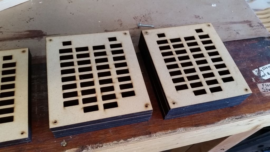

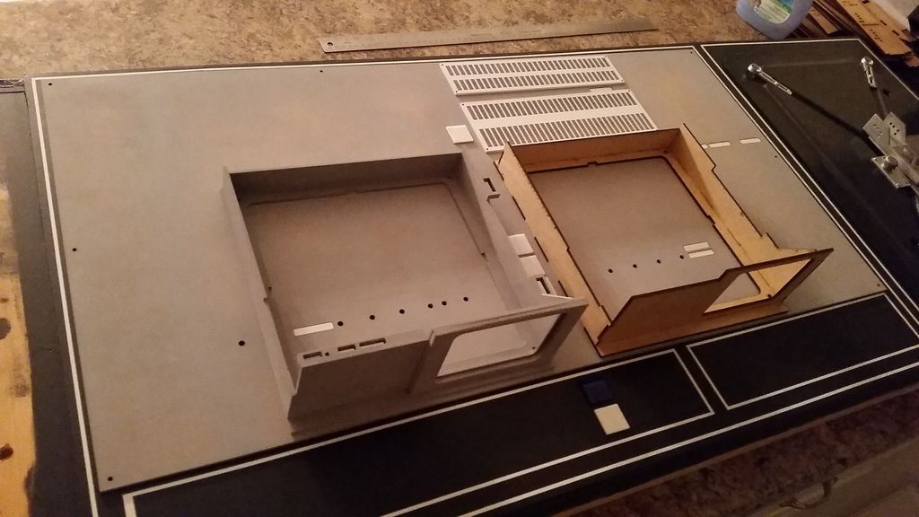

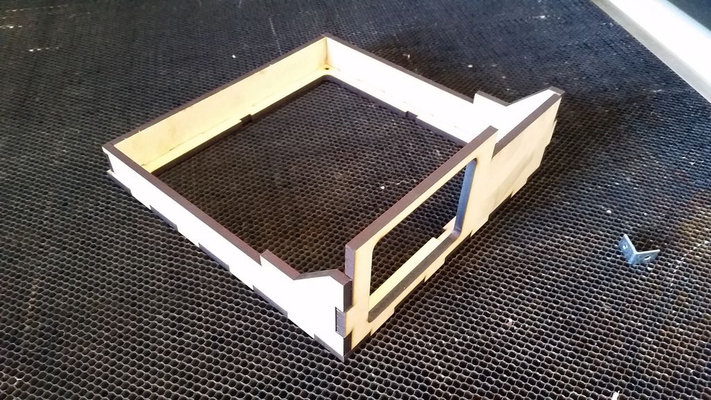

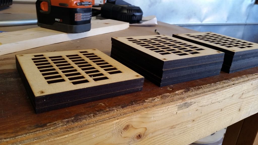

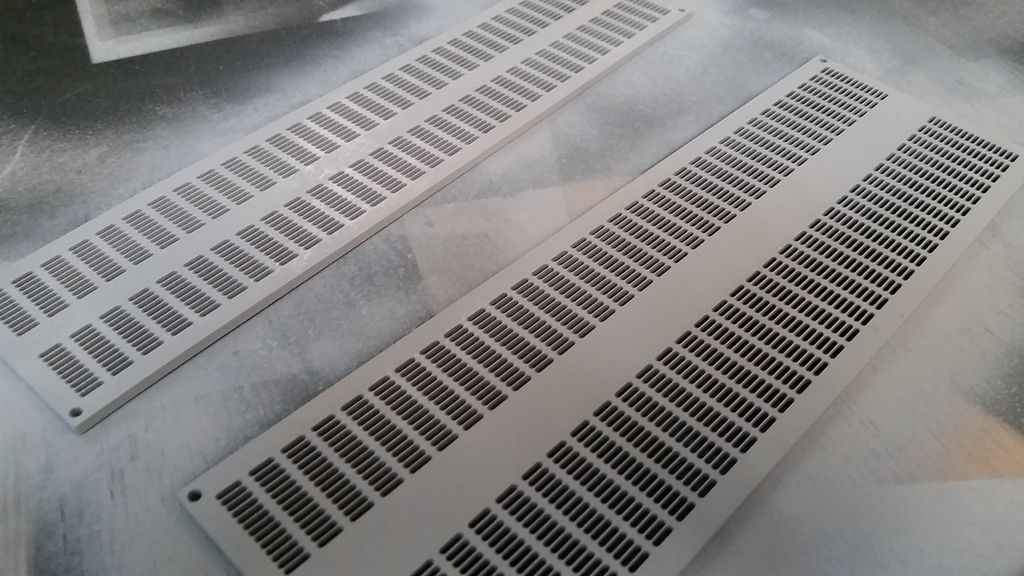

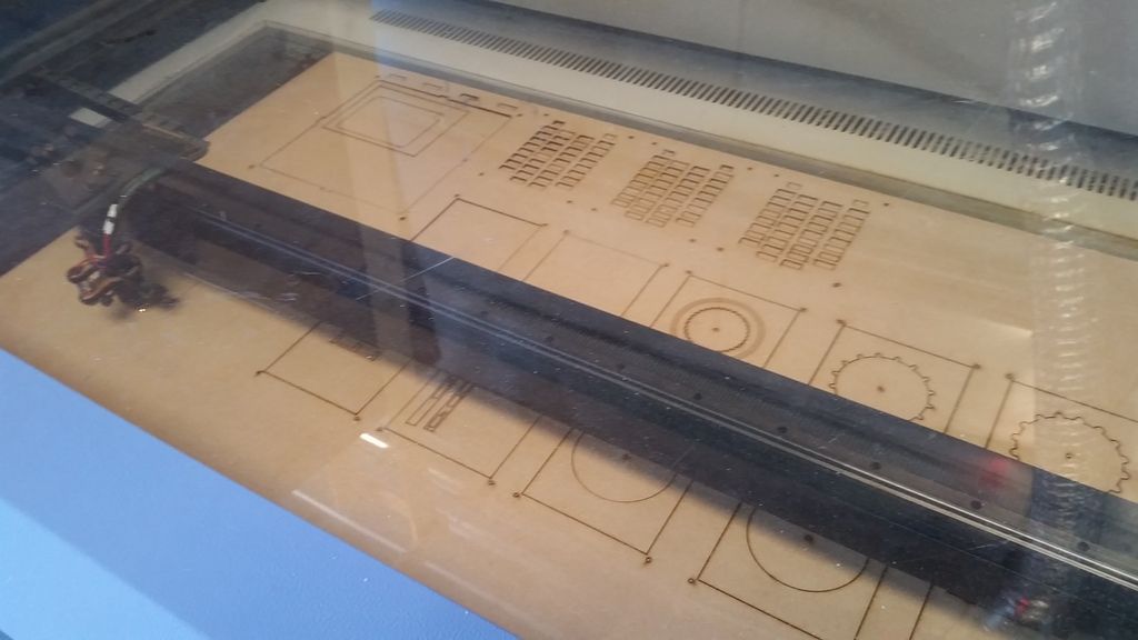

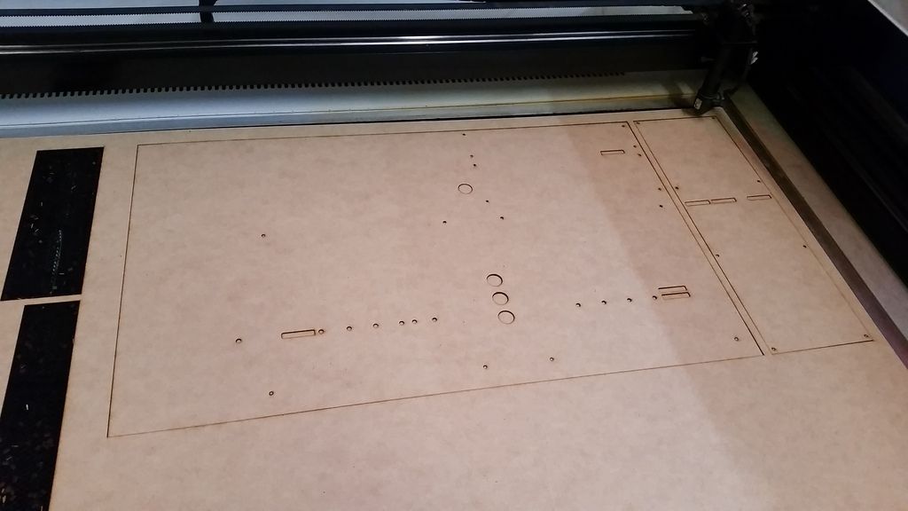

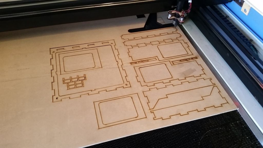

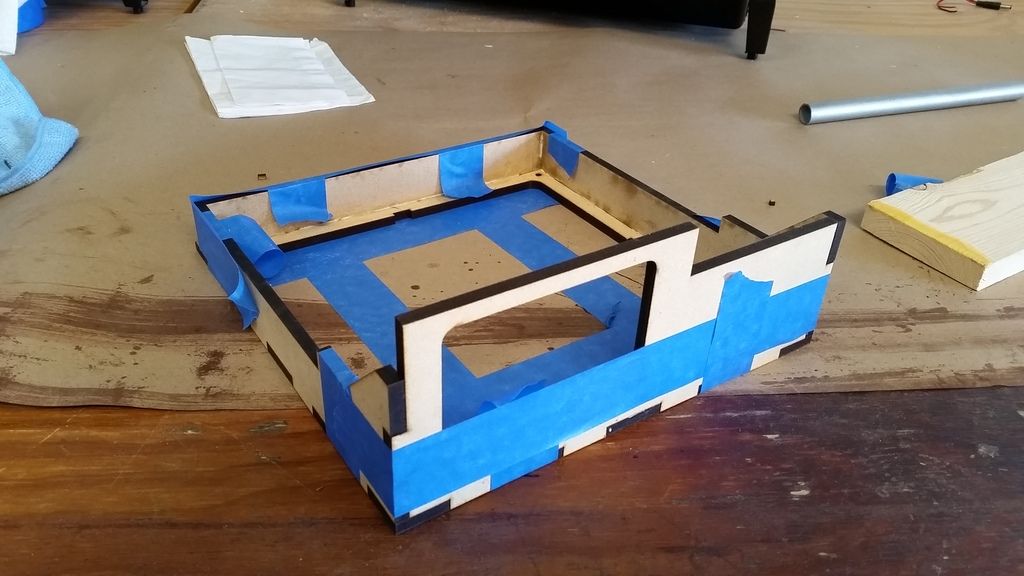

As I mentioned we were able to get the laser cutter limping back to life so I took advantage and cut a bunch of greeblies!

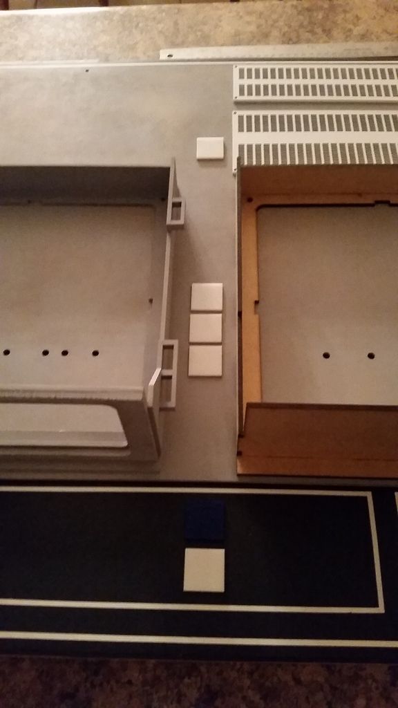

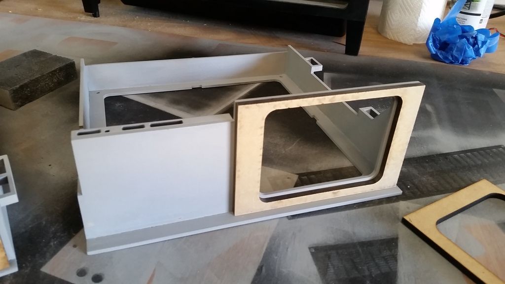

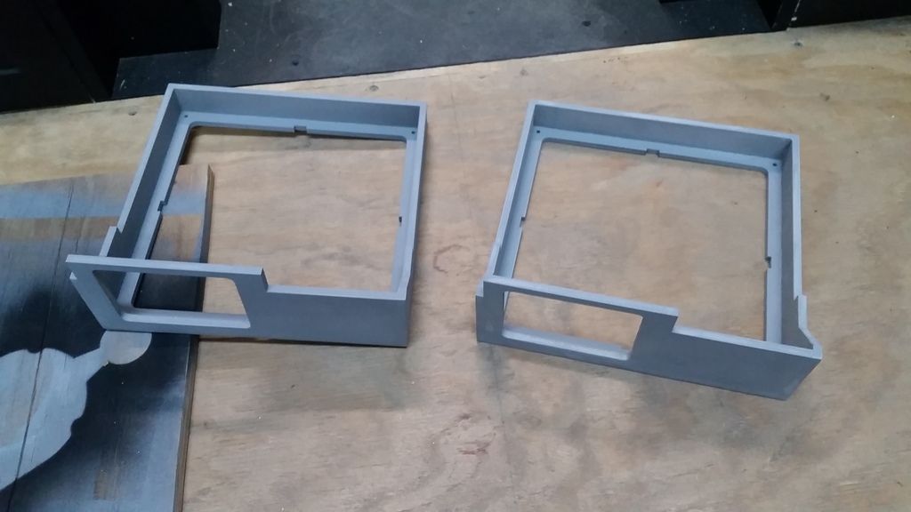

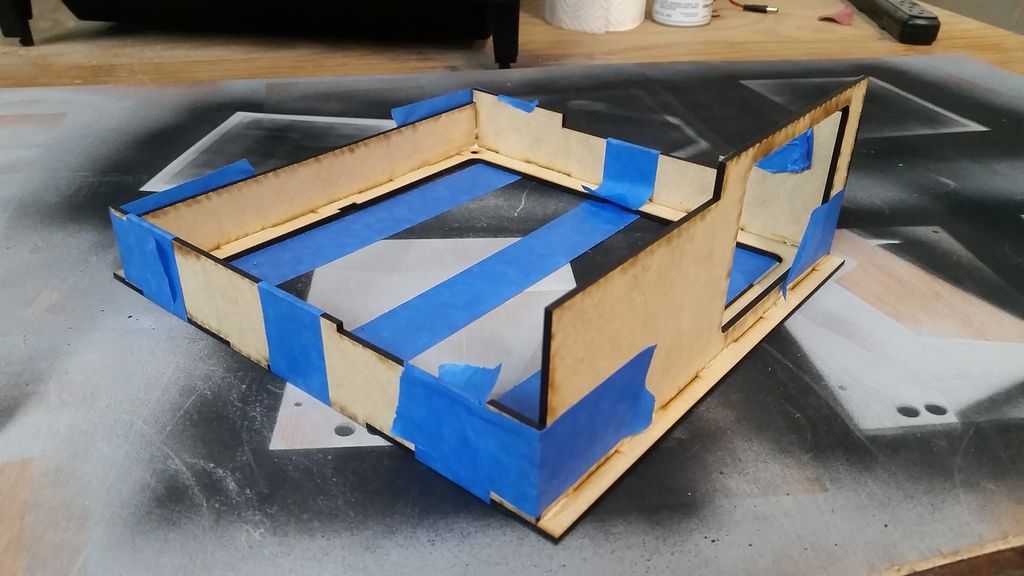

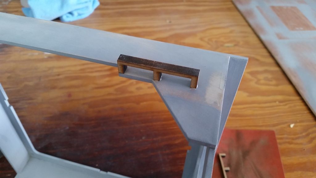

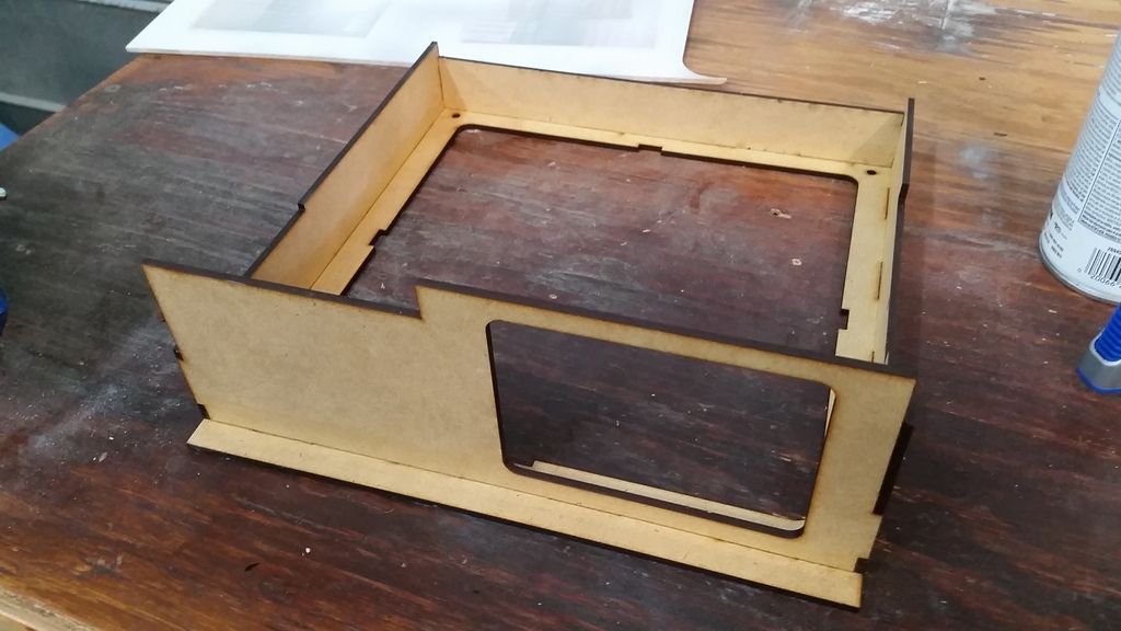

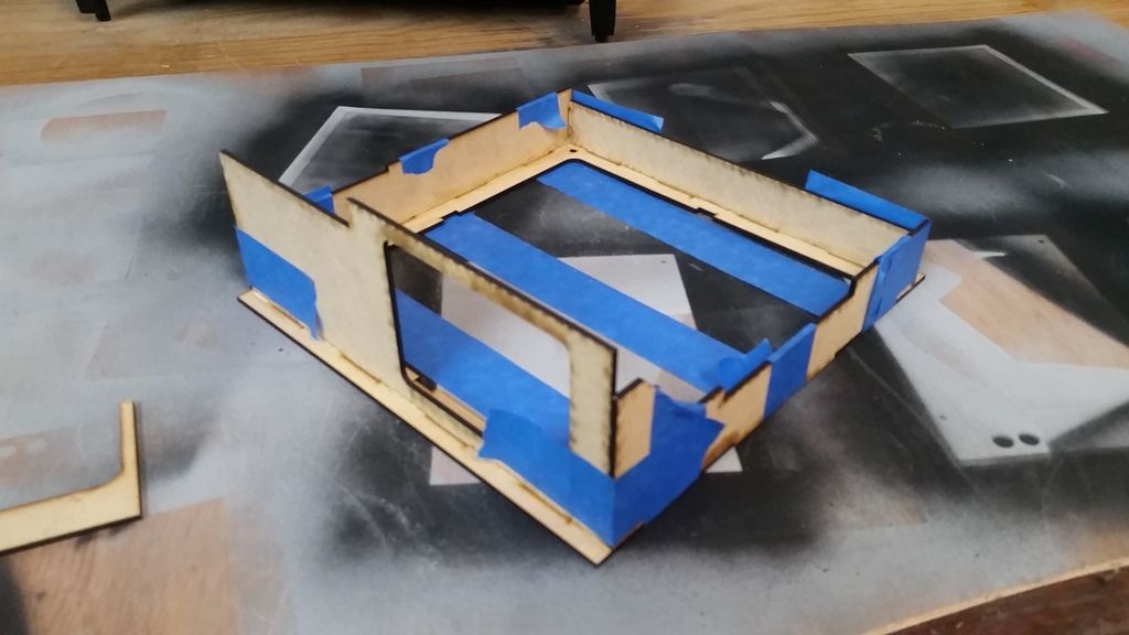

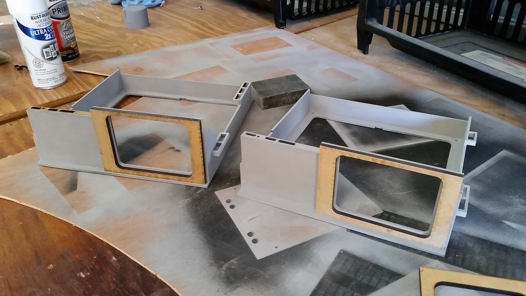

One of those greeblies was the second upper panel tray
Primer / Filler added
These two are close to paint and then mounting

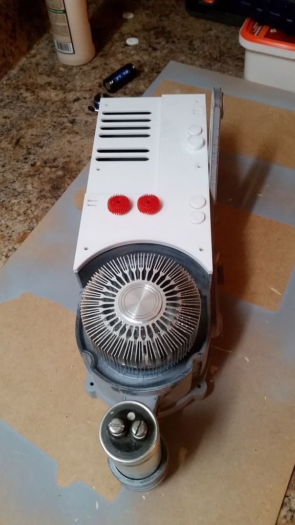

I jumped back and forth from greeblie to greeblie to include the foot well greeblies... This guy is almost finished

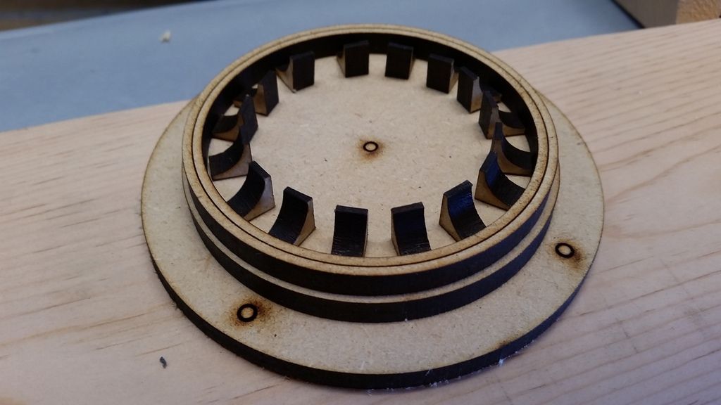

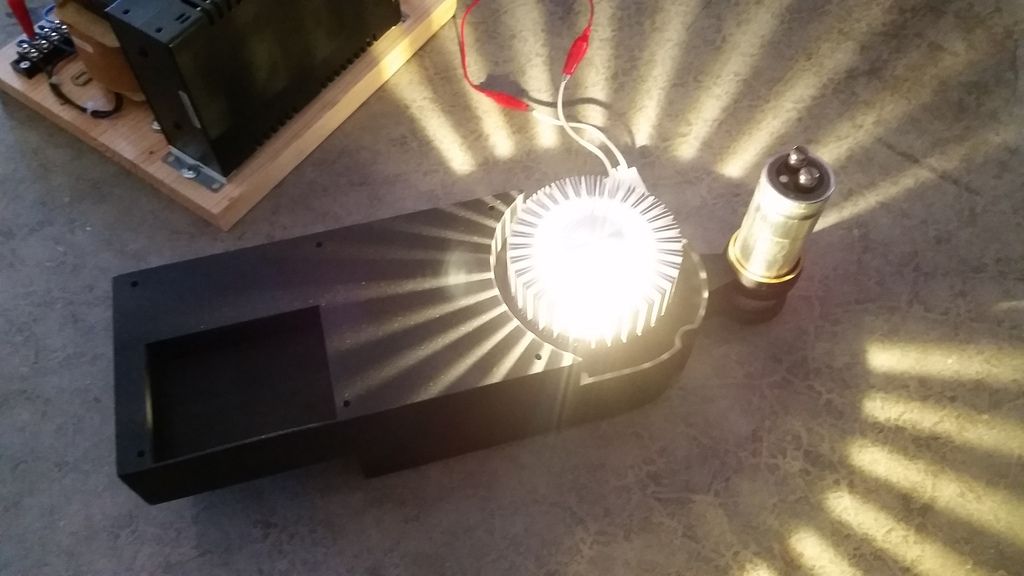

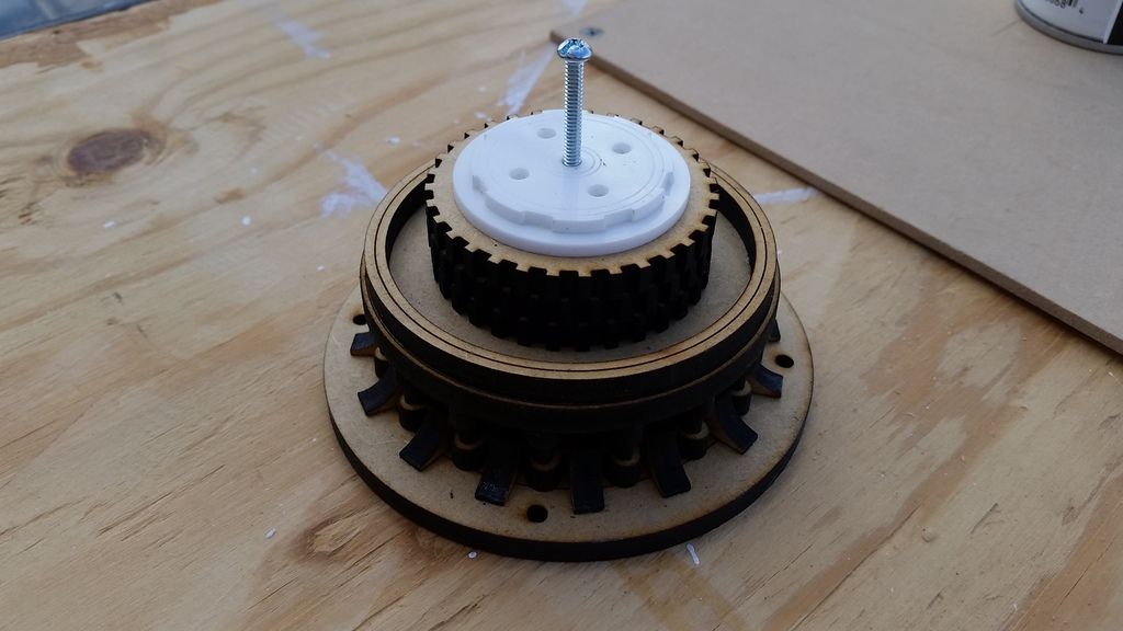

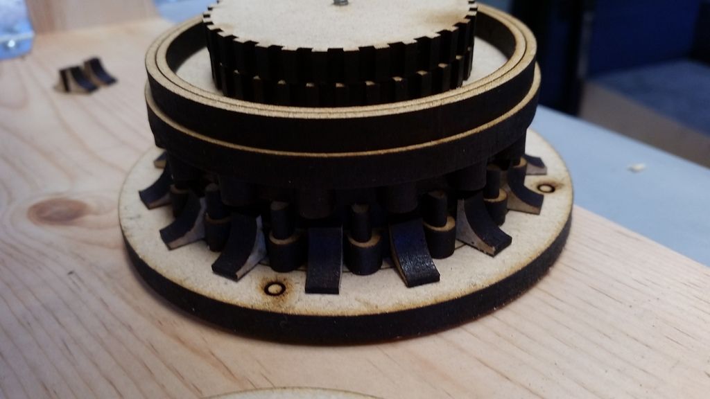

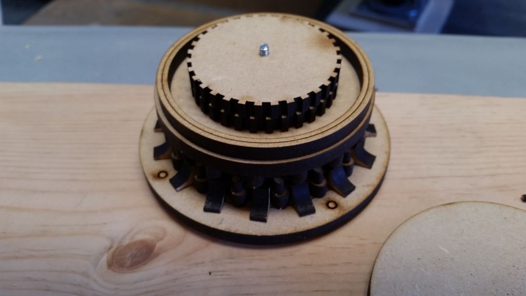

Laser cut a new detail ring

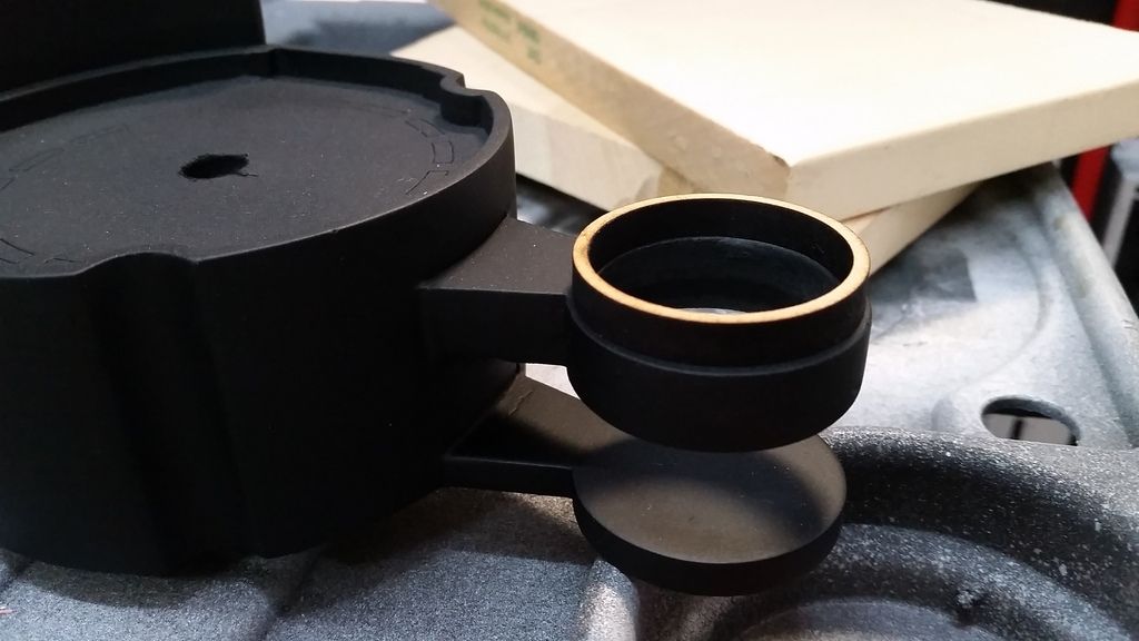

We then test the new lamp. It was a bit bright but I'm not sure if I like the effect
Time to add some color
There are a BUNCH of different color combinations I can do. Which do you guys like best? We're looking at a black or silver base, leg and top trim piece in diff configurations
Decisions Decisions

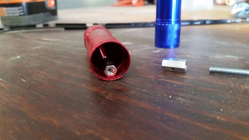

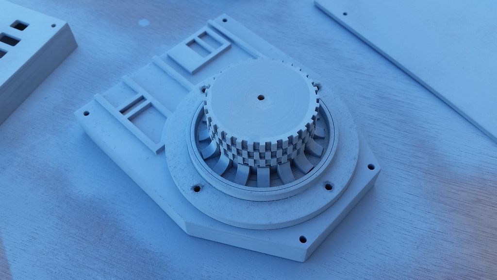

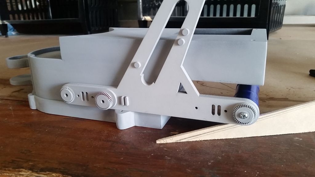

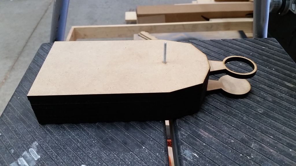

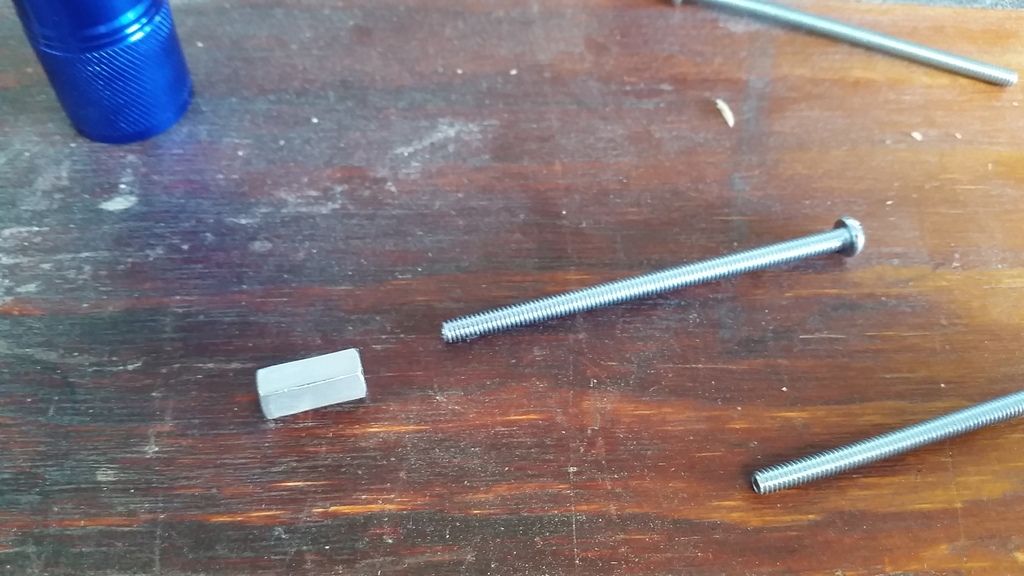

I took these flashlights and prepped them for mounting but I didn't have a long enough bolt - DANG!
Let's get back to more greeblies!

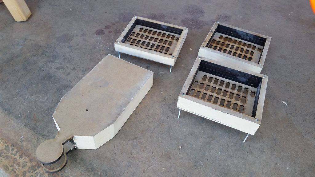

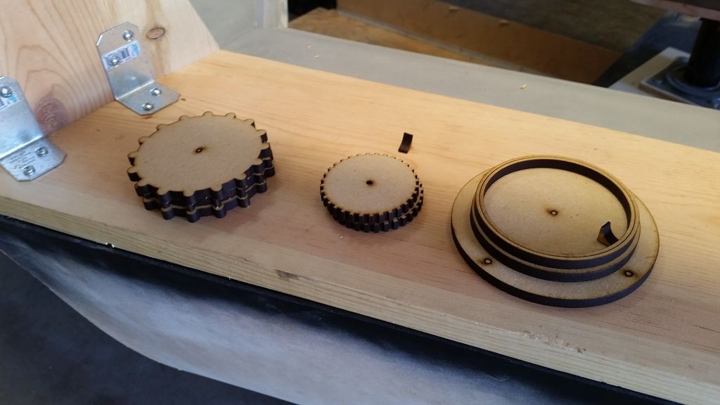

I cut these pieces
HMMMMM
What the heck is this thing?
The new foot well greeblie!
Side by side comparo
Not sure I like this
That has the look I'm going for!

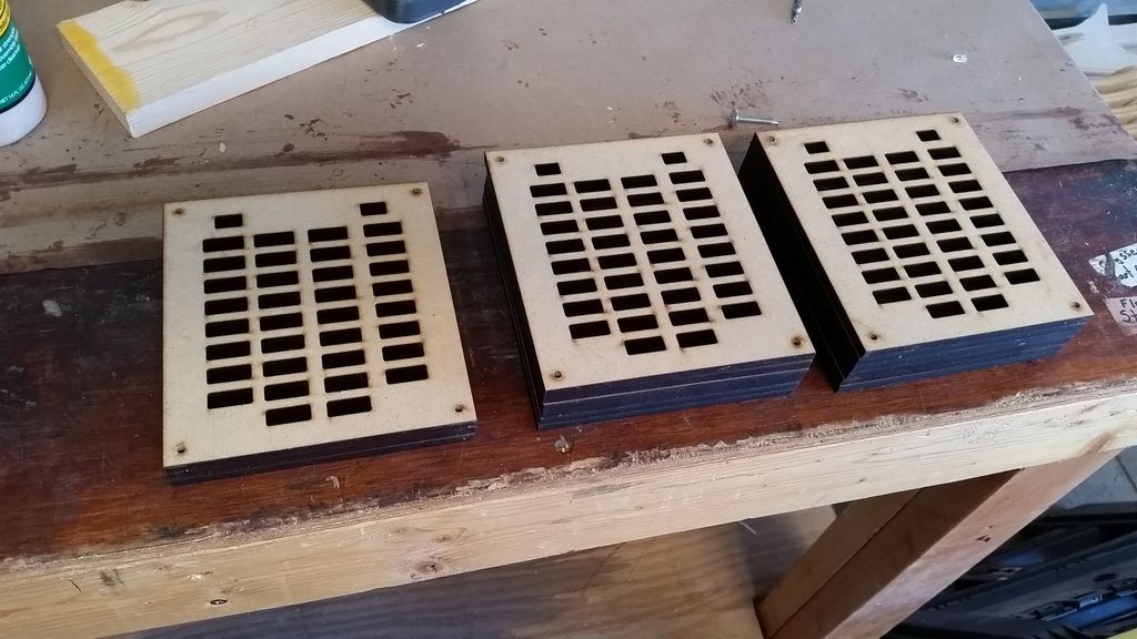

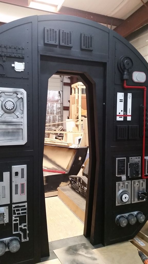

I also cut new black boxes for the cockpit entrance capstone panel
That's a lot of filler needed

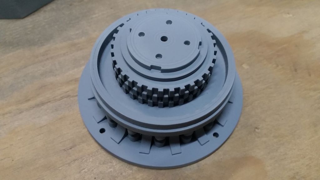

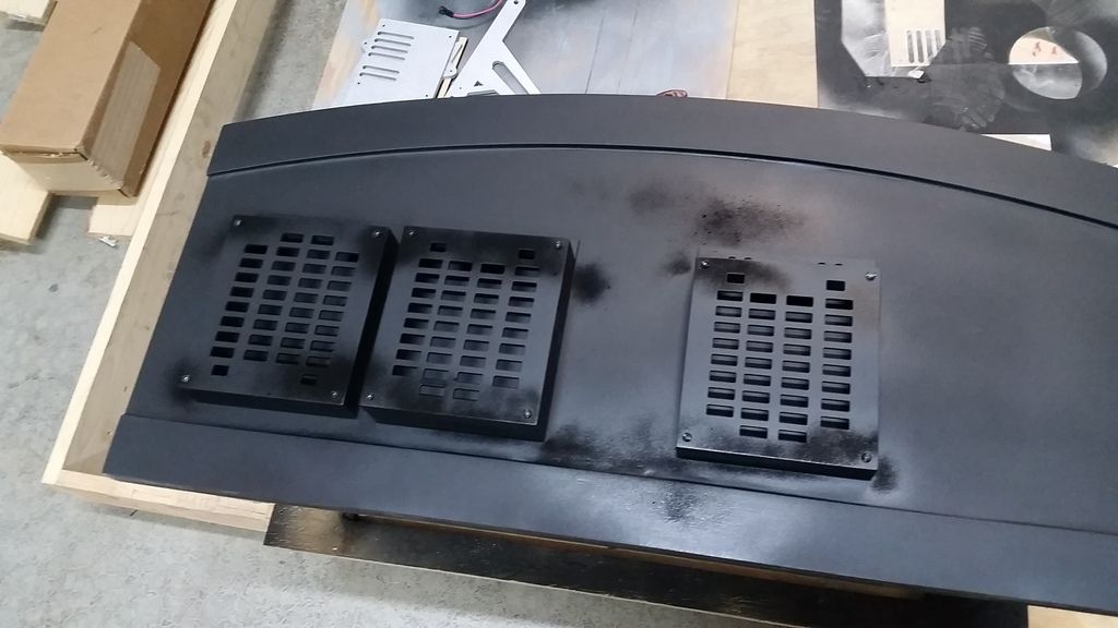

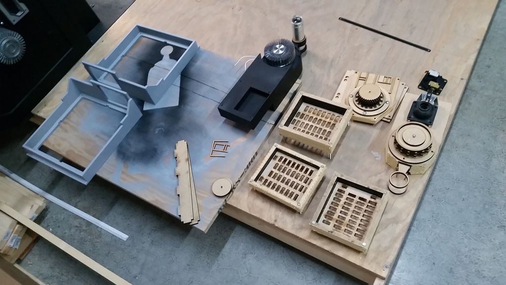

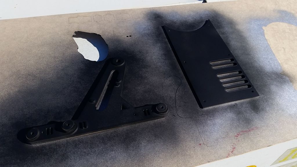

Time to adhere and add filler and primer to all these greeblies! From this point forward its going to be a bit random... Enjoy!
Samantha and I spent a good hour sanding and priming all these new greeblies
Still need to add filler to those little holes
And this is where we are!

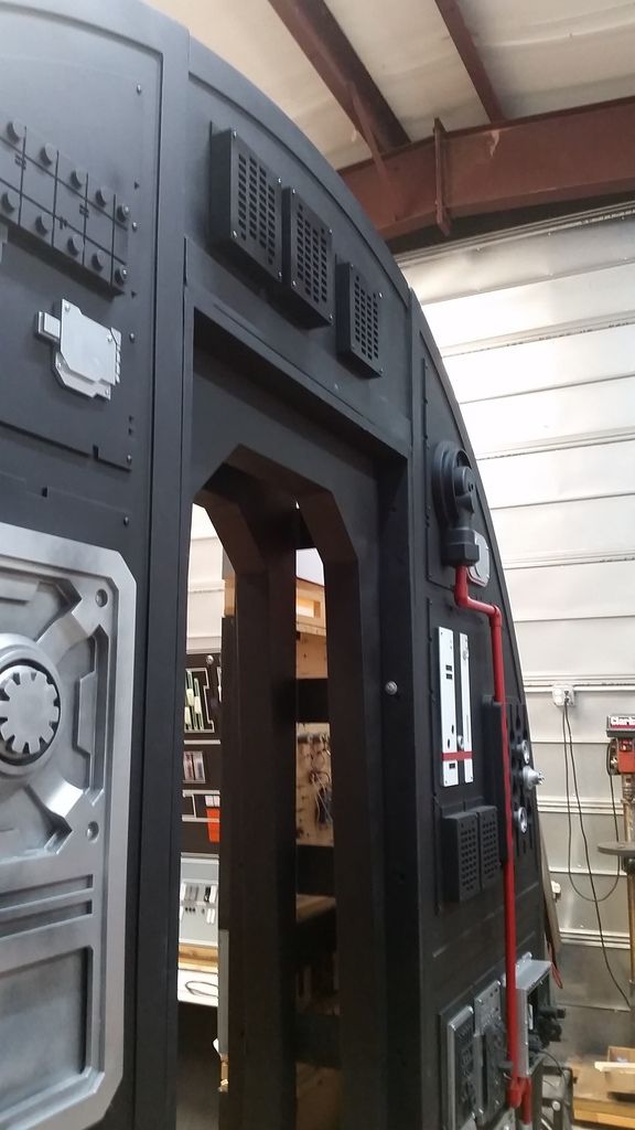

Hi Gang,
Time for an update... Didn't have much motivation this weekend but I did get somethings finished up and some much needed things started! And away we go...

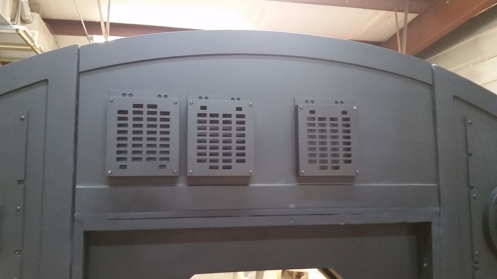

Finally finished up the new black boxes for the cockpit entrance capstone
Bolted in place and painted the bolt heads black
And done...
I like them!

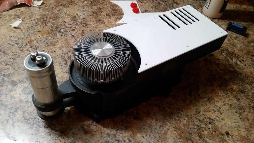

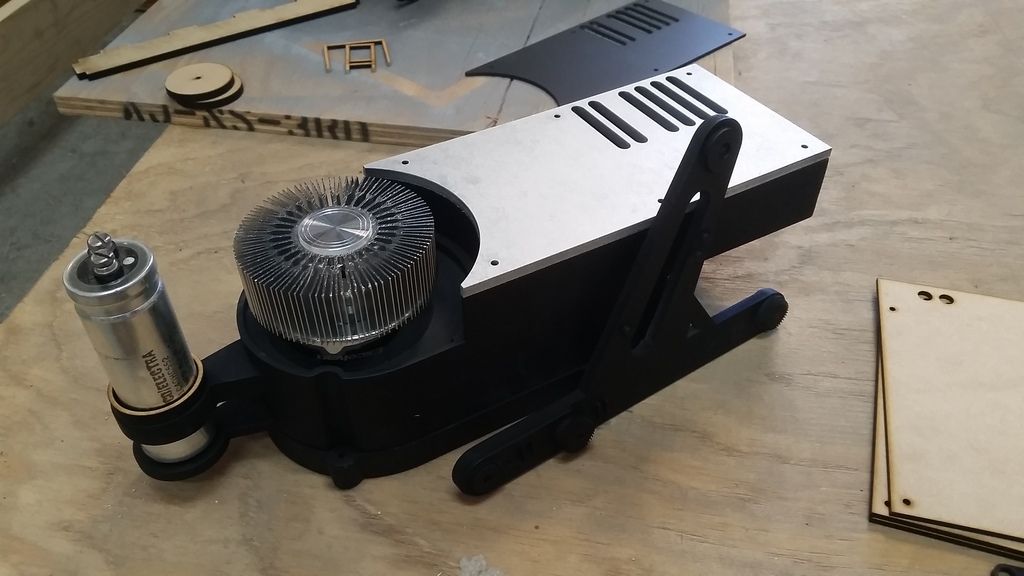

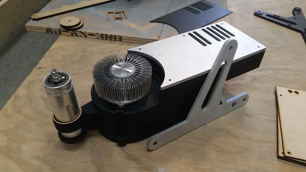

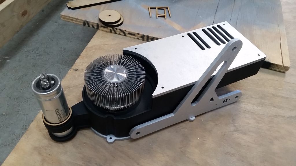

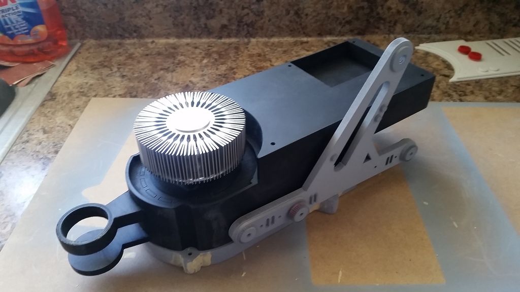

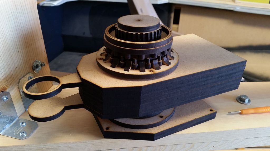

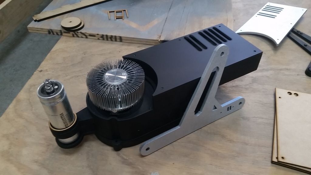

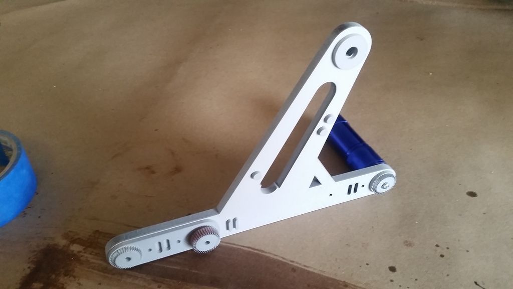

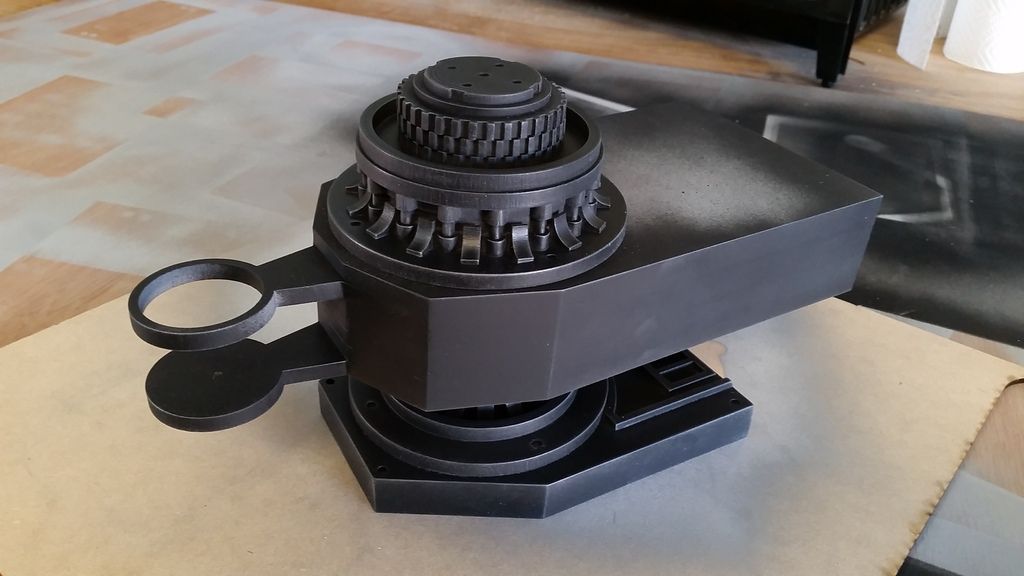

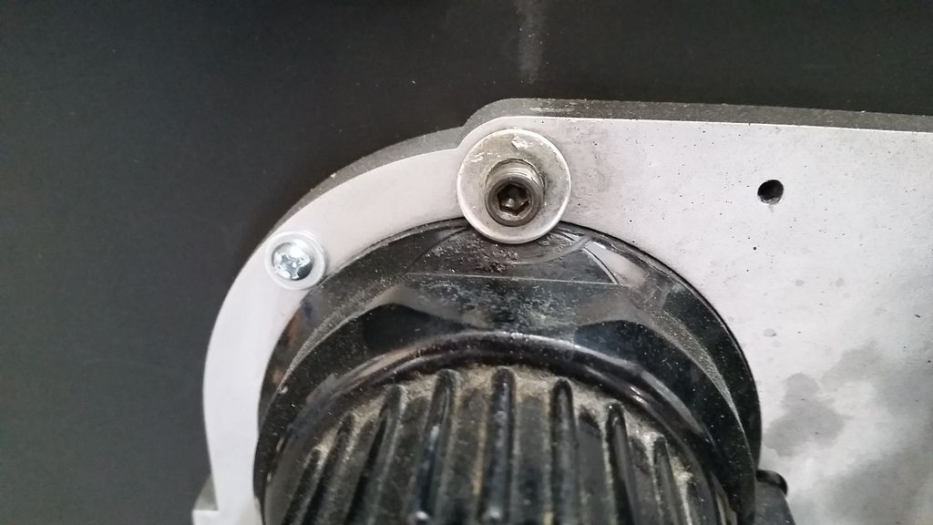

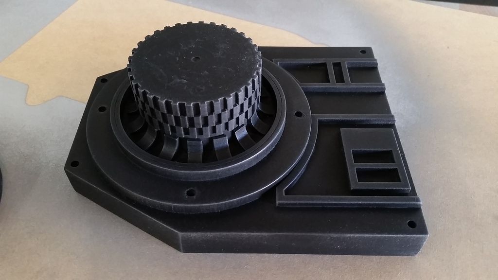

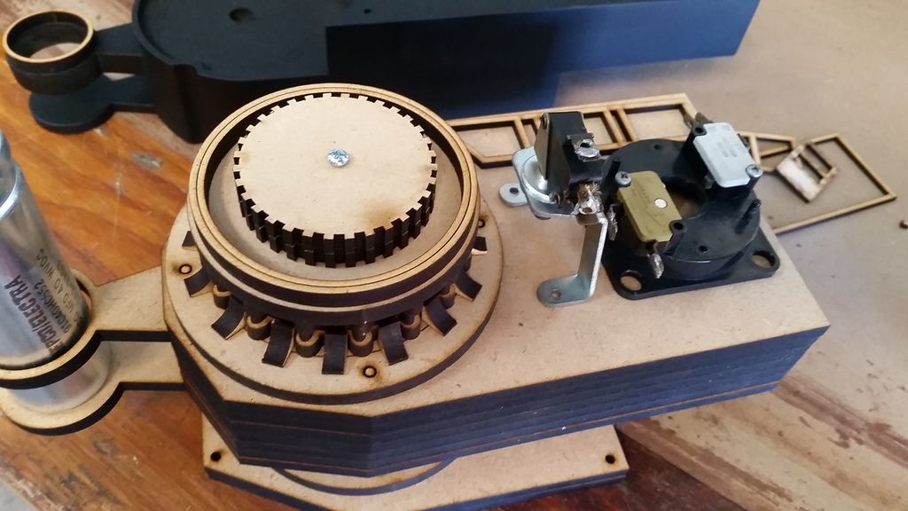

I was close to finishing up the new foot well greeblie. I like how it turned out but... Purchased a nut coupler for the handles
Finally bolted into place!
Slightly weathered with a dusty paint brush
MDF spacers on the backside
Bolted into place

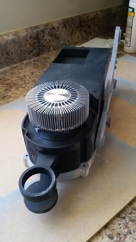

Time to mount the LED lamp
Closer
Painted the base silver

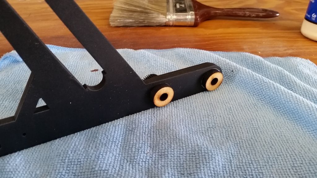

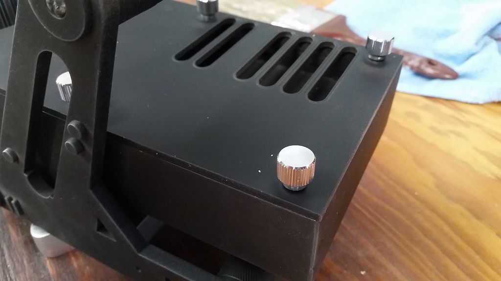

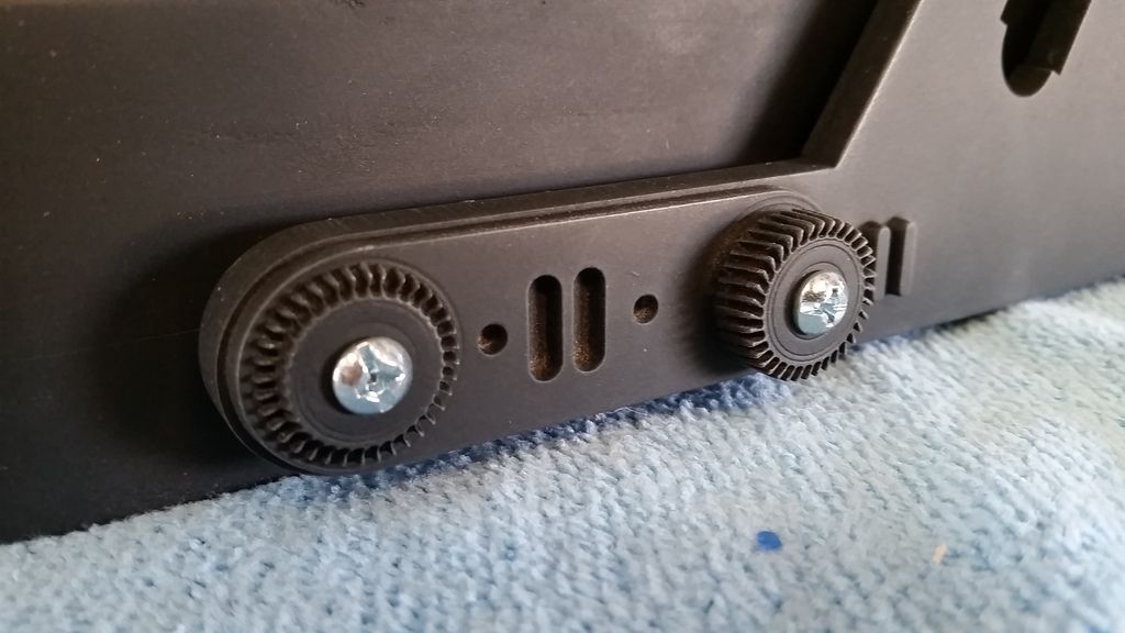

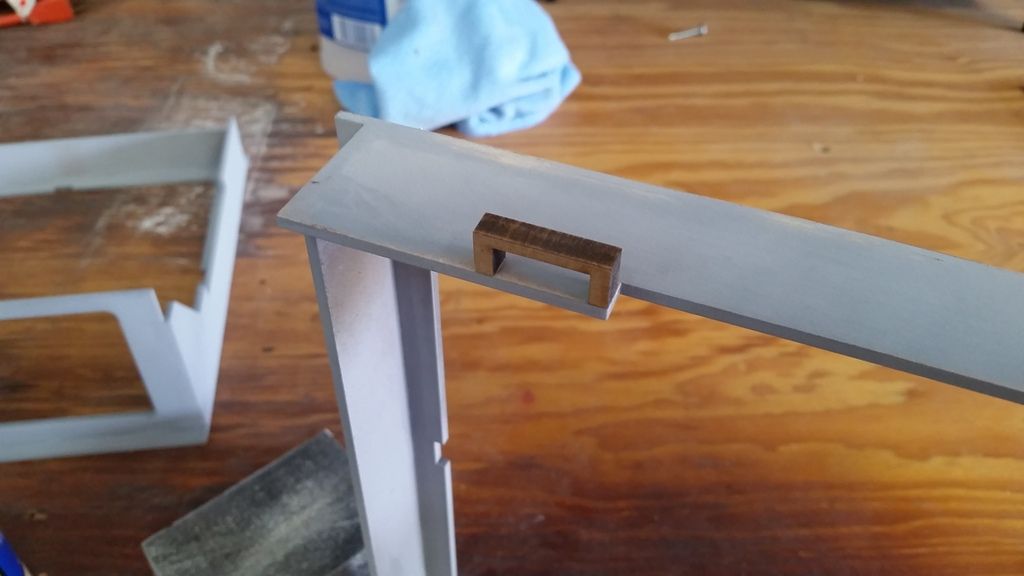

Thumb screws
I thought these would add some visual interest - they're just a bit too big
Plus it split the wood

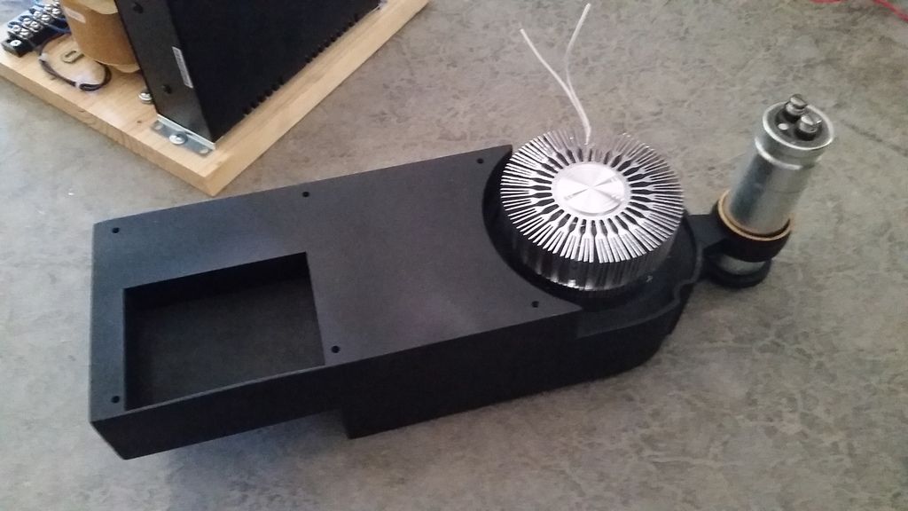

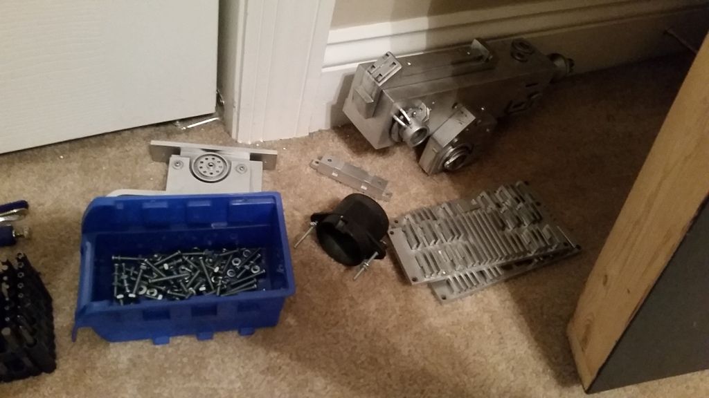

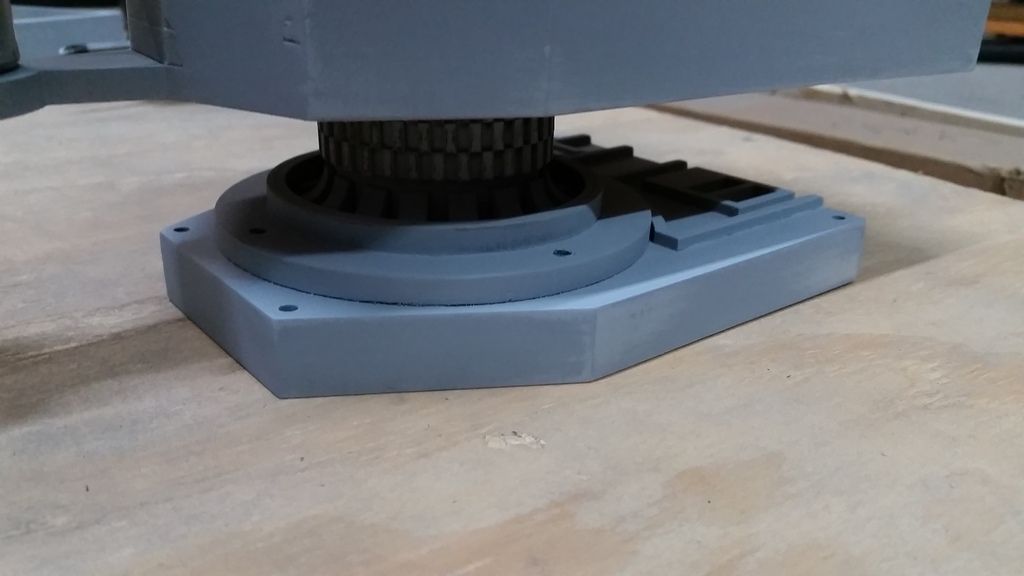

I've decided to move away from the two large foot well greeblies. As I mentioned, they are too big for the area so I'm focusing on something smaller and slightly resembles the coils that I created for the cockpit entrance.
The sister foot well greeblie base
In its basic configuration. I really like how they turned out but just too big...
I think I'm going to focus on this shape for the foot well area! I have a few ideas working in my head

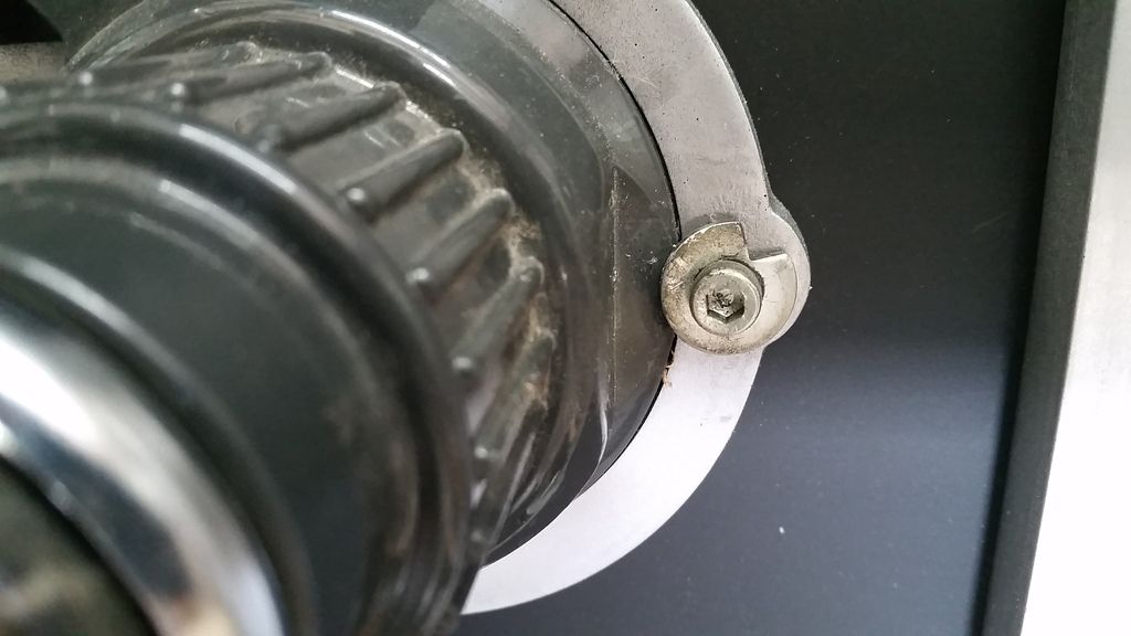

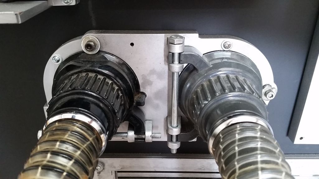

I then used a Allen bolt to keep the Kirby Hoses in place - sometimes you gotta keep it simple.

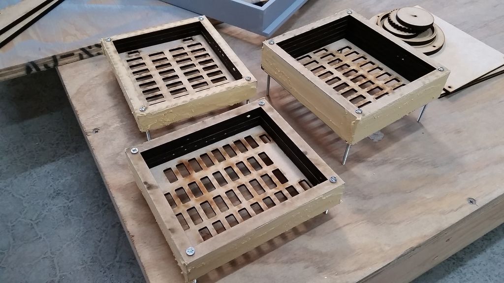

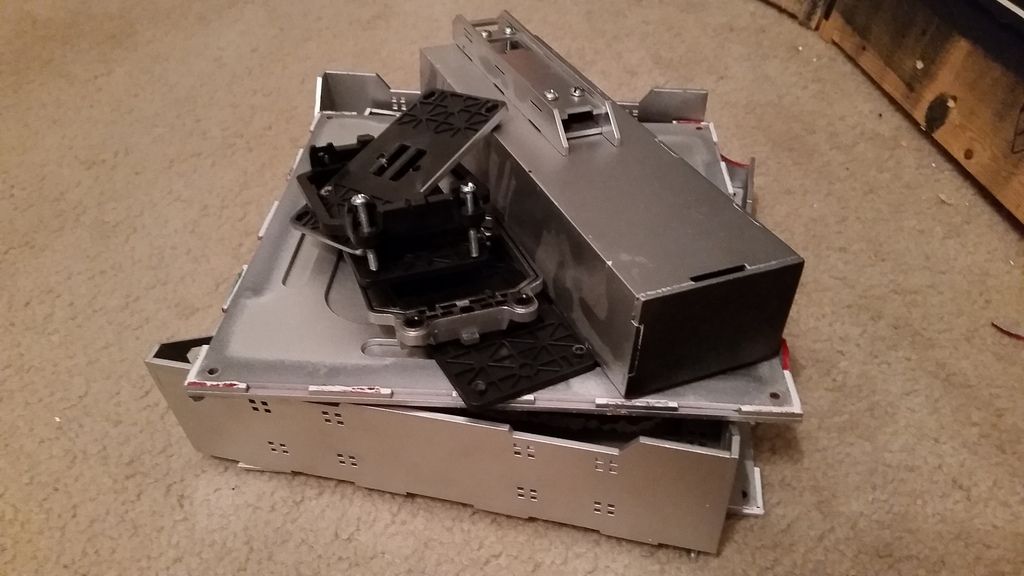

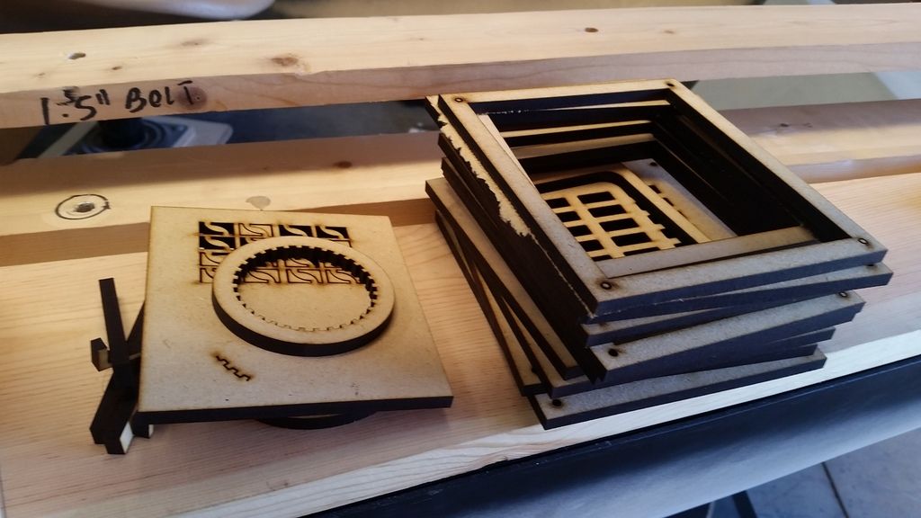

It was then time to tackle an area I was NEVER really satisfied with - the upper greeblie panel. There are so few images of this panel from ESB that I decided to take advantage of the TFA 360 Pano and use that for reference. So... I removed all the greeblies... YUCK!
Out to the trash! Most of these greeblies were broken from the dogs playing and jumping on the panel...

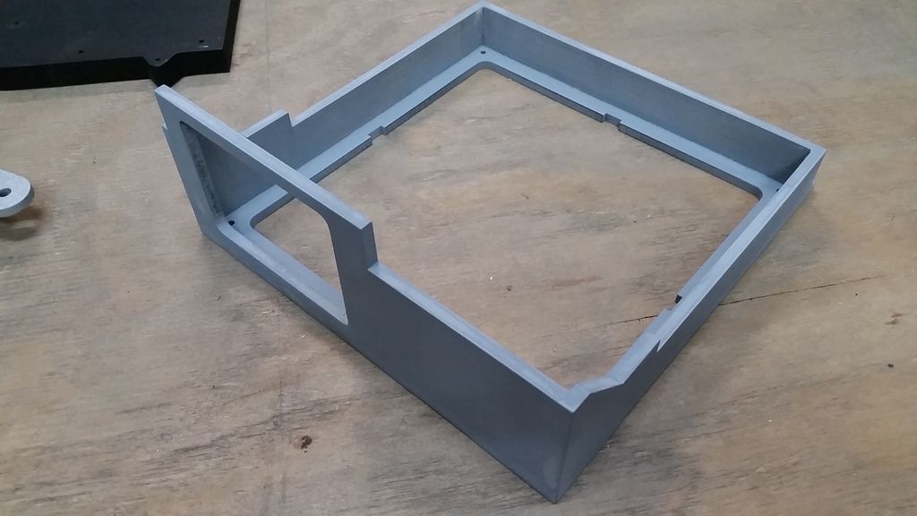

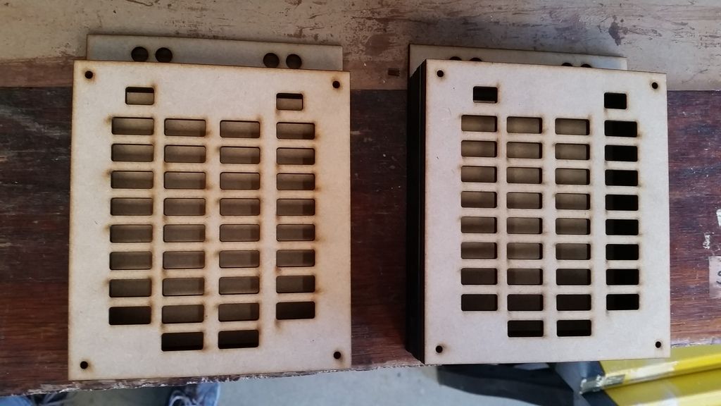

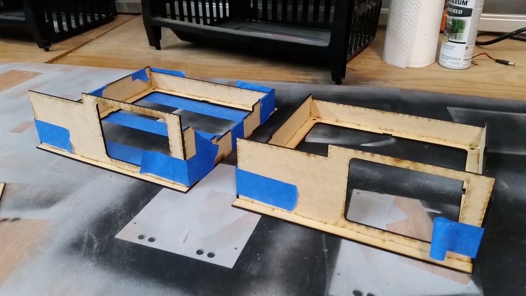

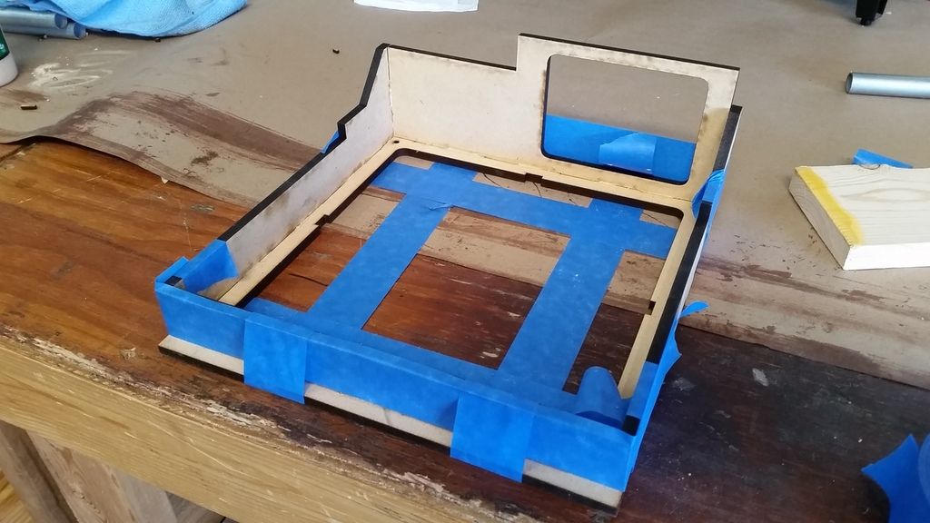

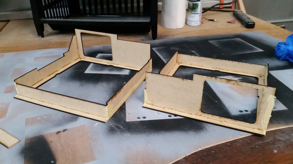

As I mentioned there has been a lack of motivation. As a result, the trays I made were slightly messed up so I made new ones using 1/8" MDF instead of the 1/4"
Filler
Primer
Its all in the details
I was just about to add paint when I realized... I messed up again! UGH... I have to redo one of the trays. However, the look of these trays got me thinking what the originals might have been. The hole looks VERY similar to a small TV tube and the basic shape reminds me of the old portable TV / Radio combos from the 70s. I wonder?

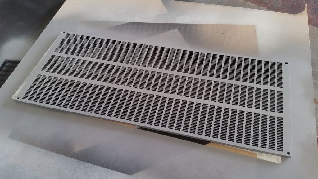

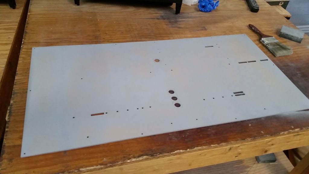

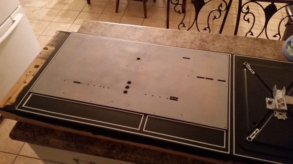

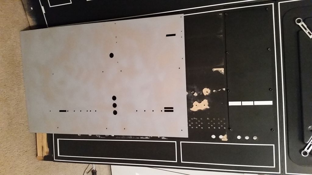

I cut 2 LARGE panels that will fit over the ugly looking upper panel. These panels also serves as practice - all the mounting holes are there for most of the new / existing greeblies and all the new LEDs
If I do this right... Cockpit Ver 2 will have everything done on the laser cutter (and CNC) and there is NO MORE guessing :) These screens are a perfect example. I laser cut these and the mounting holes are already cut not only in the screen but in the new main panel as well
When the laser cutter works... she works!
As you can see... no more guessing and everything aligned. However, I really should have made the two large panels into one... I'll take new measurements and recut

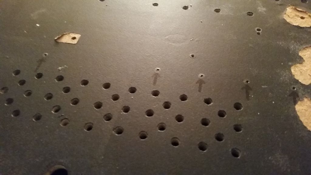

Holes for LEDs
More round 5mm LED holes
The panel will cover that mess! I'll sand, paint to match, drill the holes necessary for the LEDs in the old panel, add pin stripes, clear coat and then mount! Sounds easy, right?

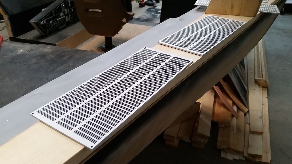

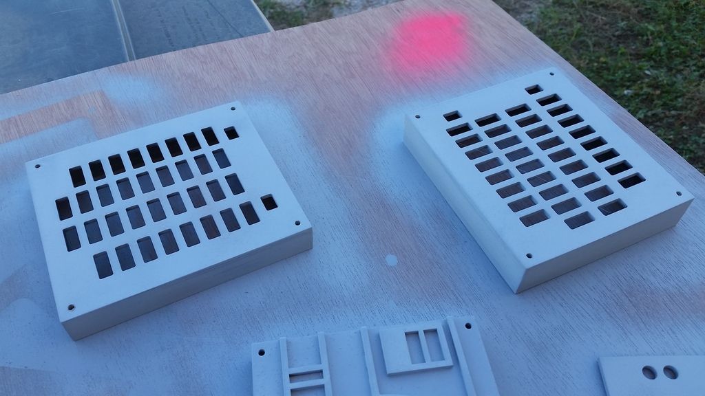

New screens getting primer and paint

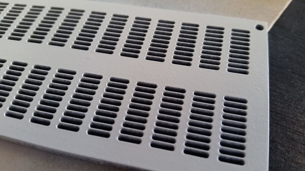

I really wasn't sure whether the laser cutter would cut all these holes without issue
Upper panel screens
Love the details!
I then cut 4 new Volvo panel screens (these screens took 1 hour and 10 min ea to cut on the laser cutter!)
Speaking of the laser cutter... We've realized that the laser cutter controller board memory is questionable (among many many thing). We can't cut simple files like a circle and square. The file has to be extremely large and complex enough to purge the controller board memory. It's really odd! But at least we found a work around until the new controller arrives.

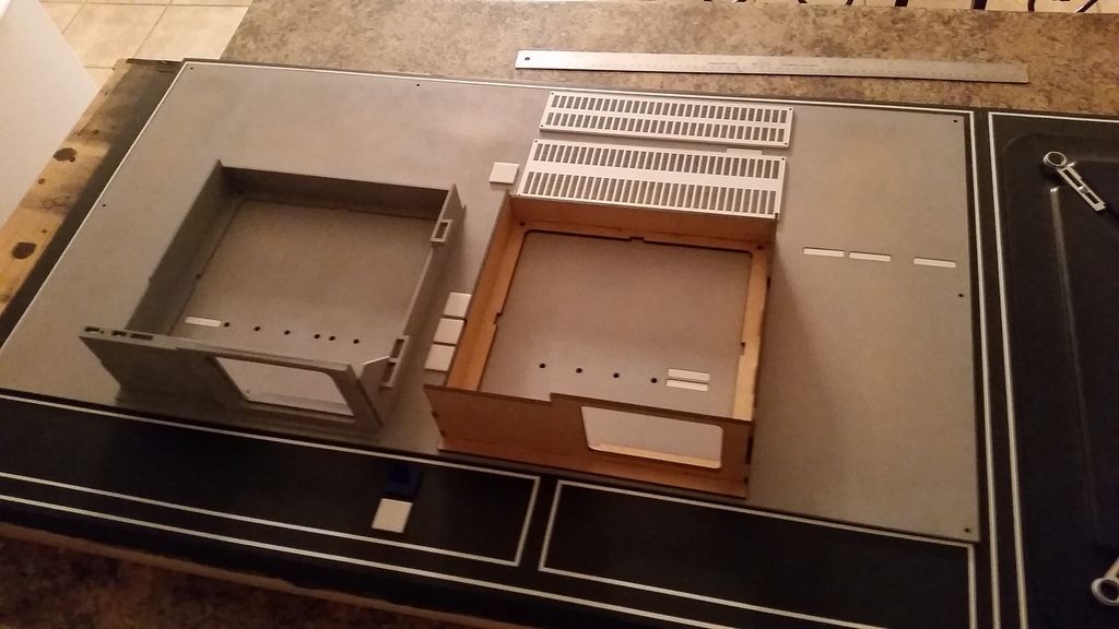

Hi Gang,
Quick morning update...

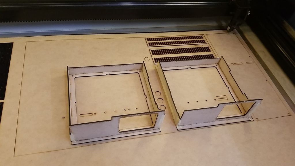

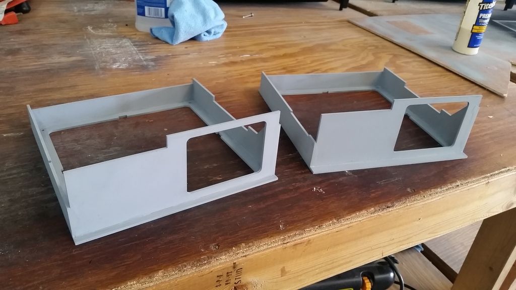

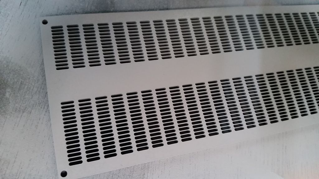

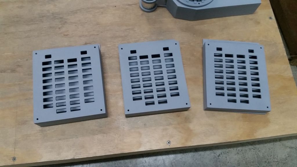

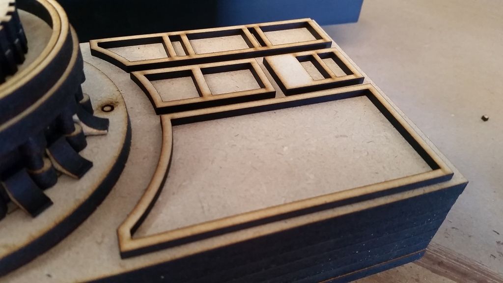

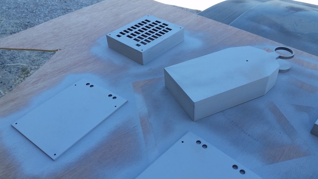

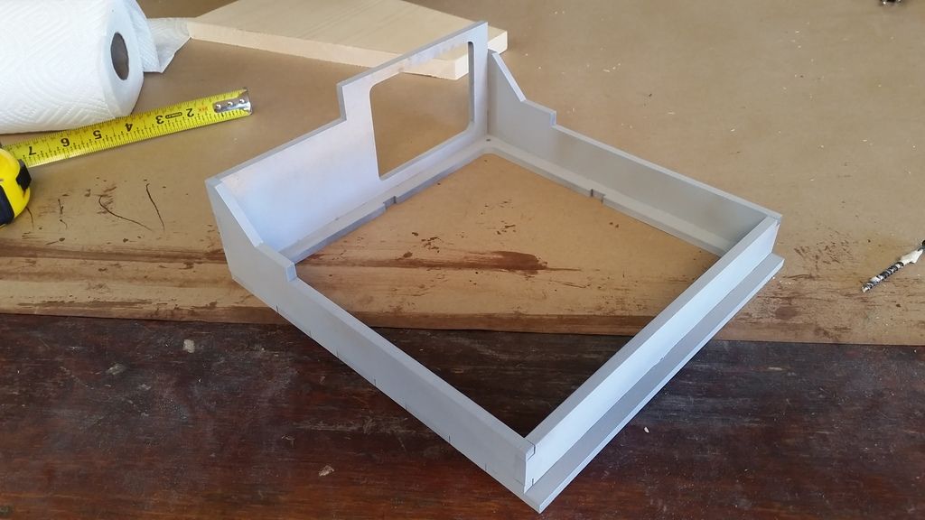

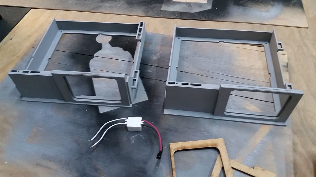

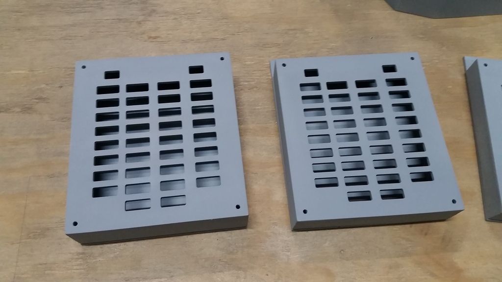

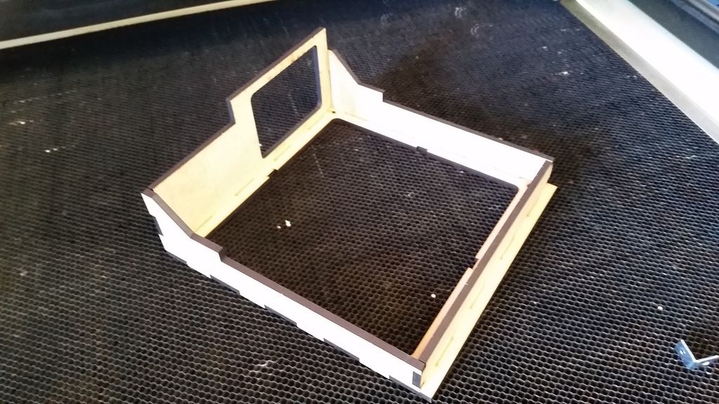

I laser cut a few new things after work to include a new upper panel tray
Larger upper panel cover
And a new foot well greeblie - similar to the other

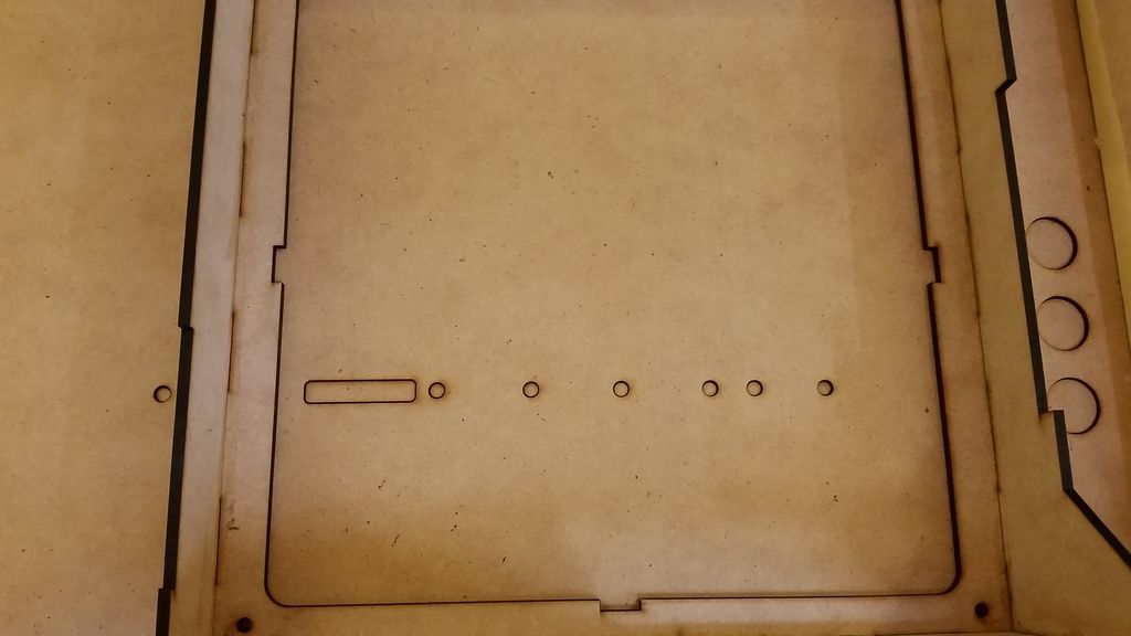

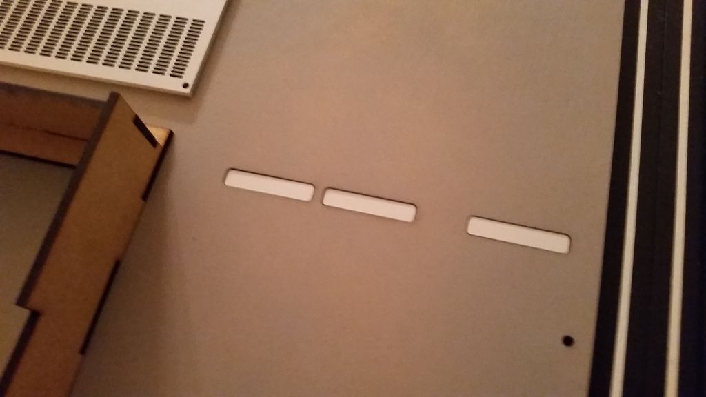

The upper panel cover has several of these round edged rectangles

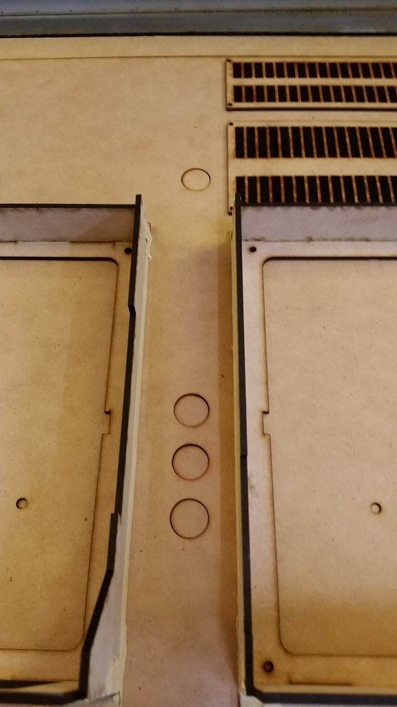

Does the upper panel cover fit? Nice

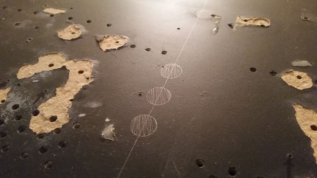

Marked out the holes that I'll cut this afternoon
More LED holes
I have a few more greeblies to fabricate...
Awesome! I'll try to add paint and pin stripes this evening...
More to Follow!
