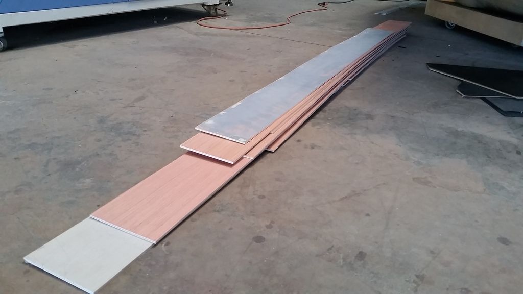

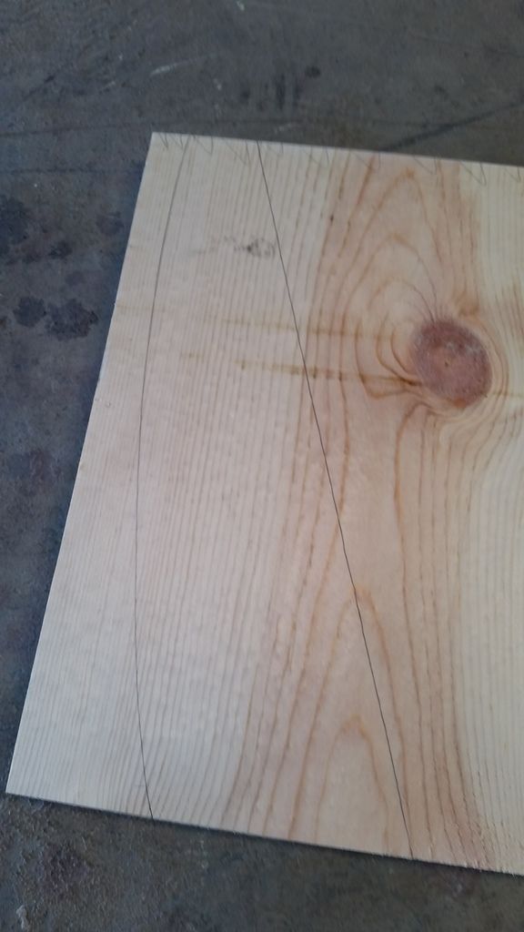

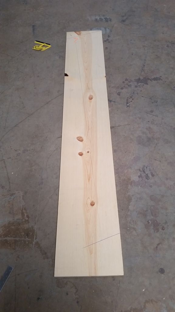

There's really only 2 ways to bend wood, both require clamping jigs to fix the curve.
Steam is good for many bends, especially if it's not a large profile. A steam setup isn't difficult or expensive to make really.
Cutting thin strips and laminating them into a single piece is often better, especially if you are painting it.
The clamping jig has to be built for the curve you need. With steam you have to allow some spring-back, not as much to none with lamination.
The main thing with lamination is you will need to choose a slow setting glue and you will need to be able to joint the edges to they are nice an flat when done.
Both of these processes are easy to look up with google.
You can also buy bendable wood, which is pretty easy to bend unless the curve needs to be very small. And I'm assuming you are aware of bendable plywood, which is very bendy and comes in sheets with the bend direction long ways or across.

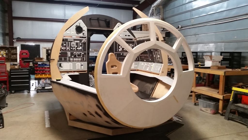

Started Saturday morning by adhering these MDF pieces together
Base
Basic Layout - next is filler.... lots and lots of filler

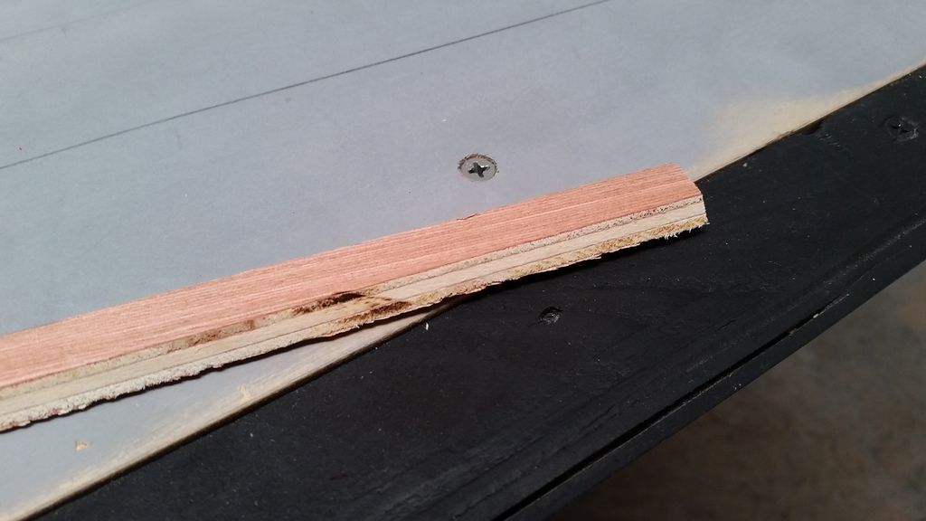

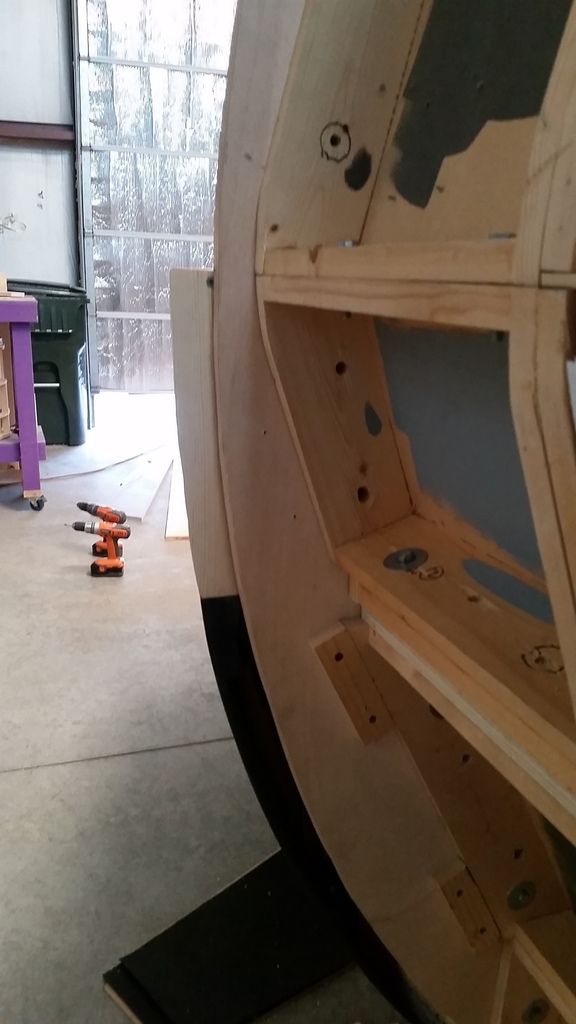

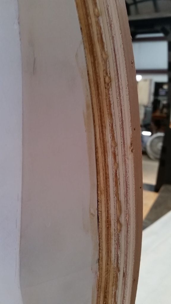

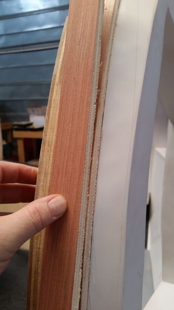

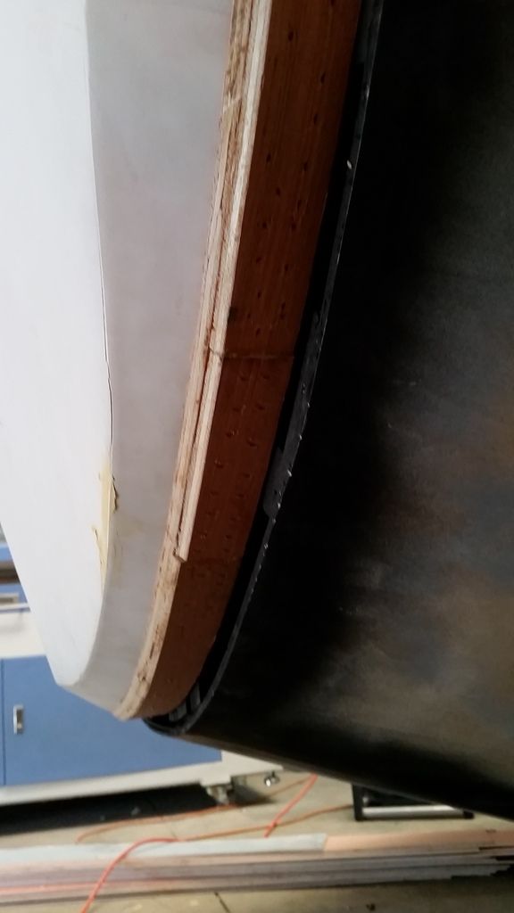

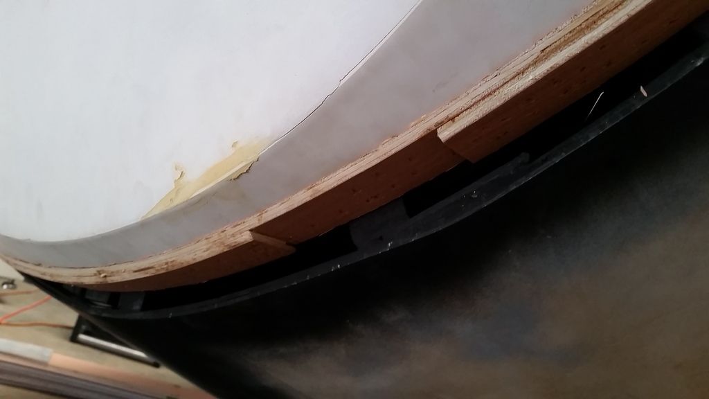

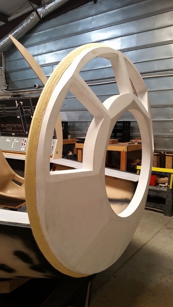

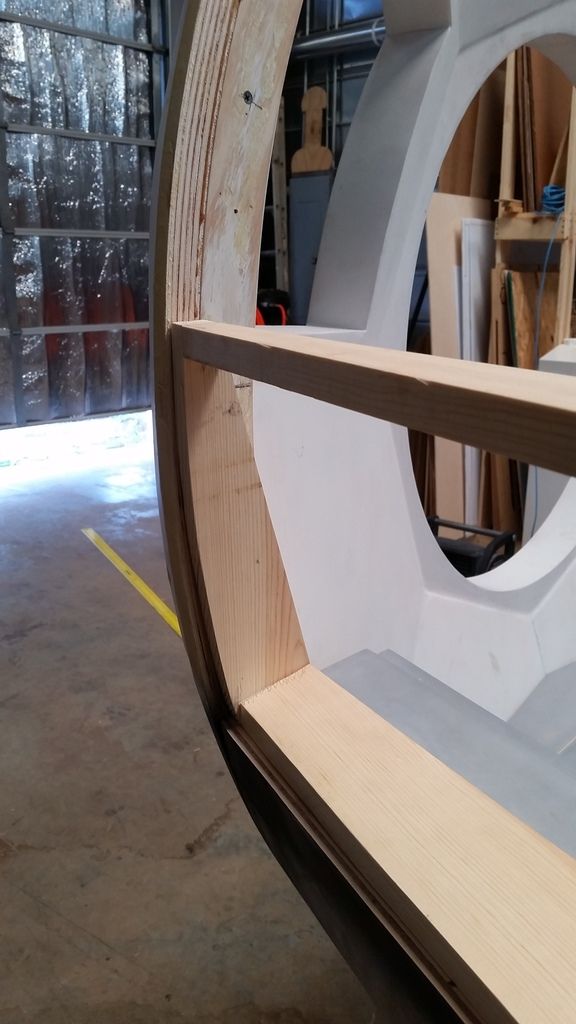

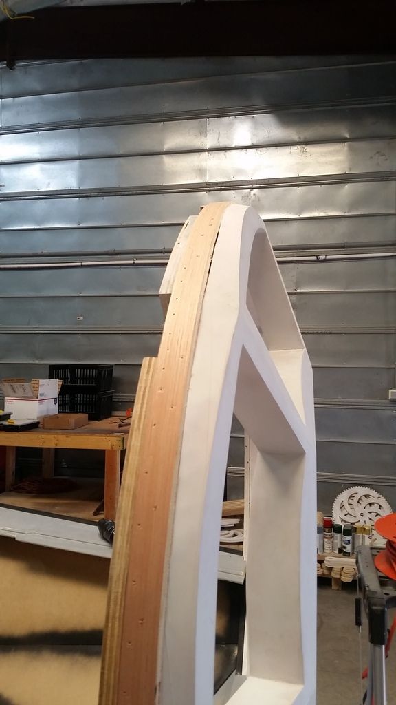

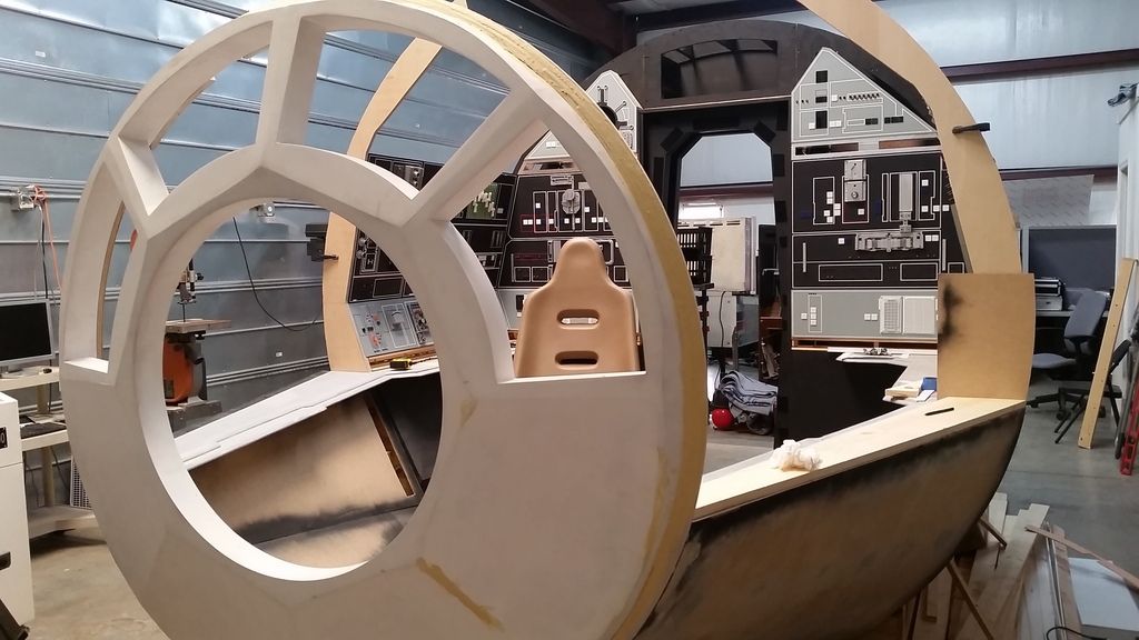

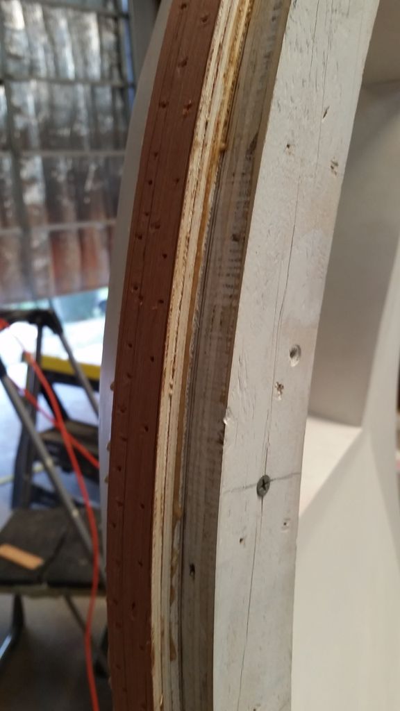

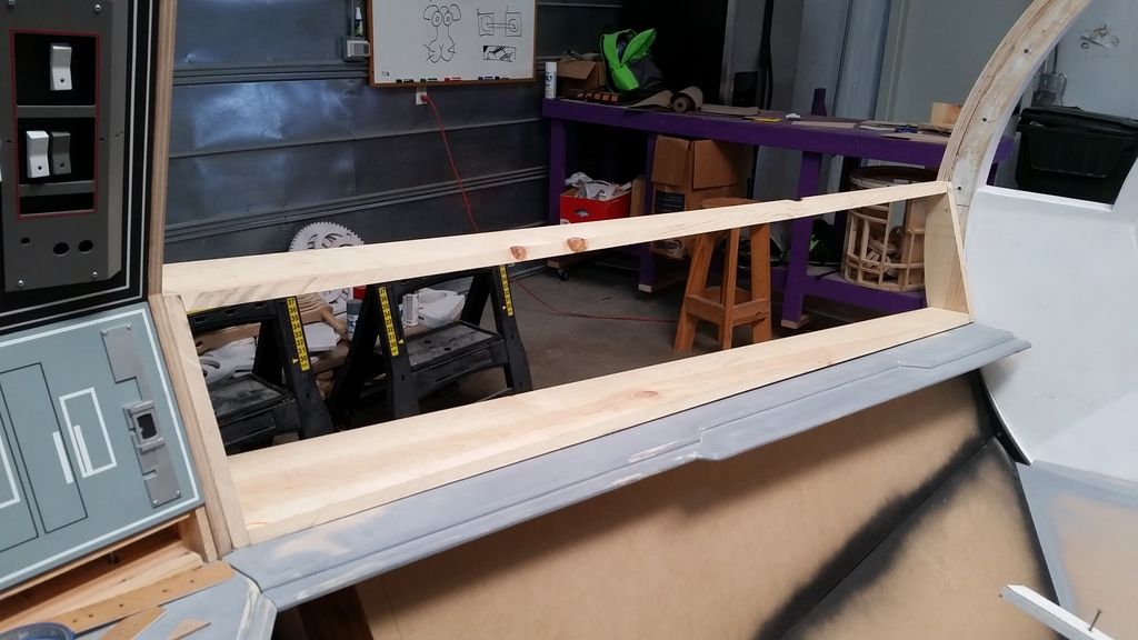

I then headed over to the warehouse where it was time to tackle the front window transition. This is what I have to add to the window

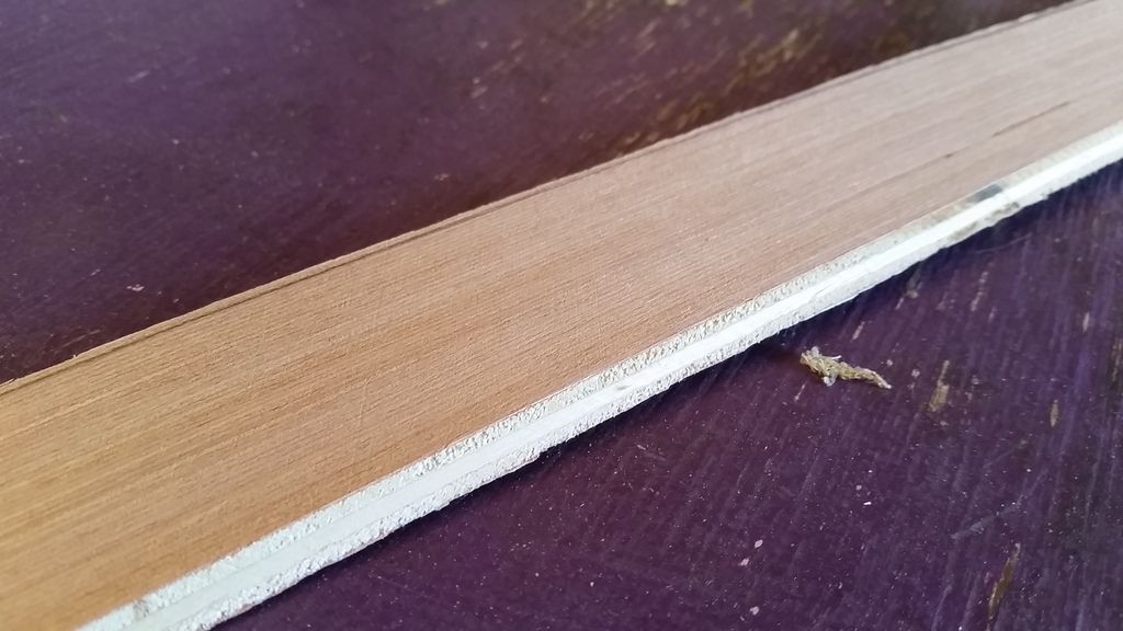

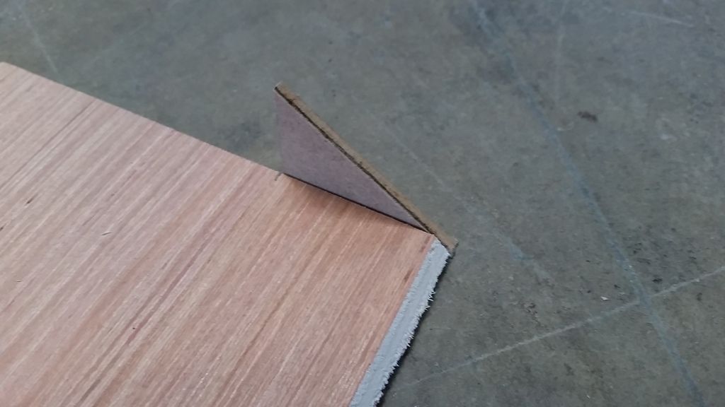

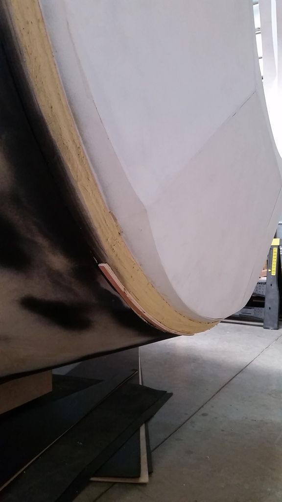

I ripped these 6" 1/4" pieces of ply
Cut ea one with a 45 degree angle
I have to build up this much material
Strip number 1
Test fit

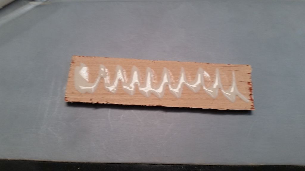

Glue and brad into place
Two ends meet

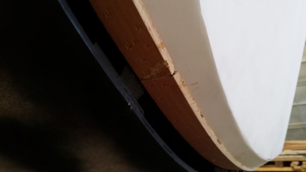

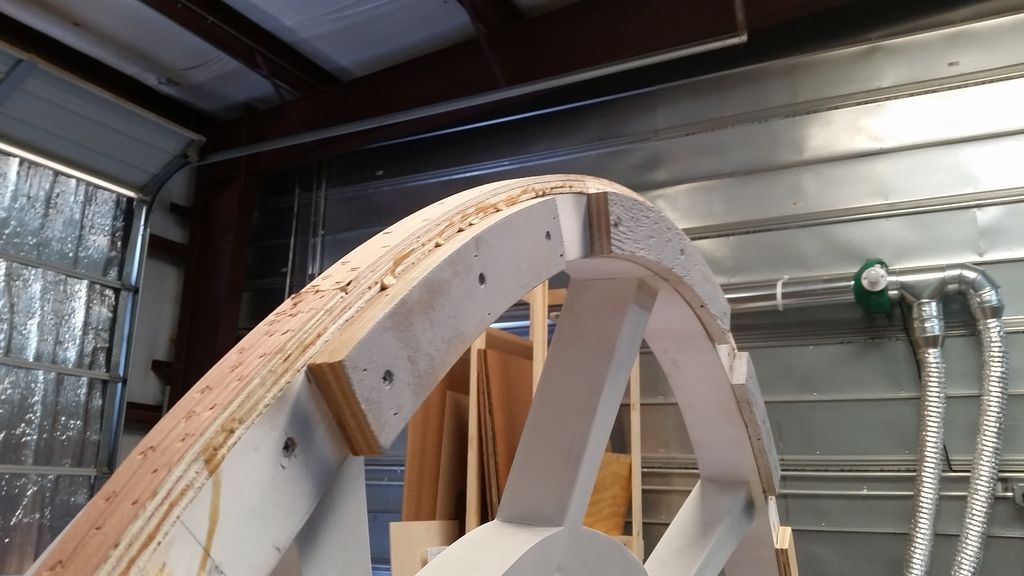

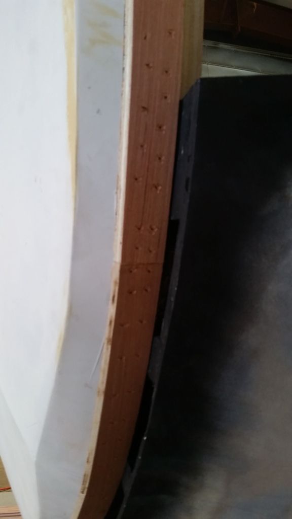

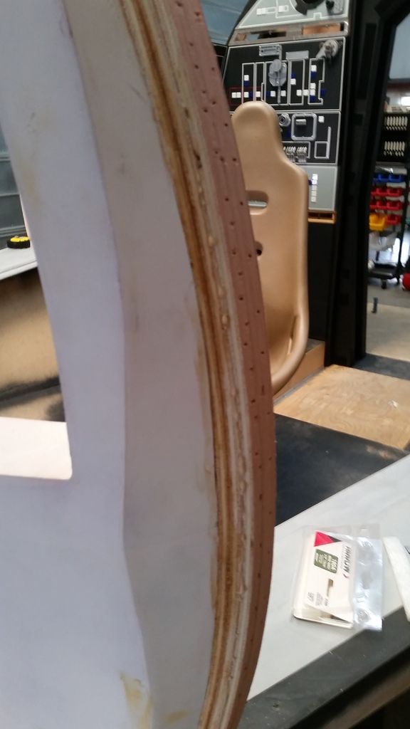

The diam took 3 separate strips. Now on to the second layer
EWE
Each new layer covered the joints from the previous layer making for a smoother transition
Han's side looking toward the front
Han's side looking in
The final strip

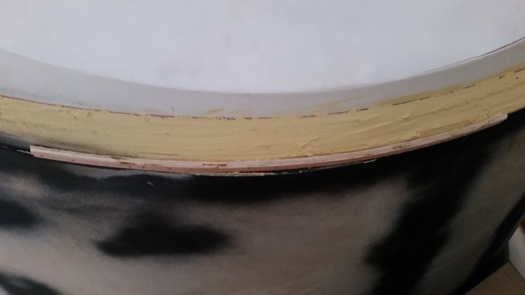

I then added some filler
I'm hoping to add another thin layer of styrene to help smooth out the actual transition. Should look near perfect when finished!

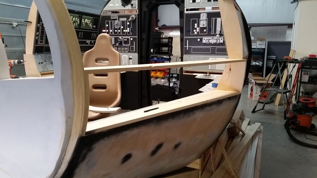

95 degrees... Still...

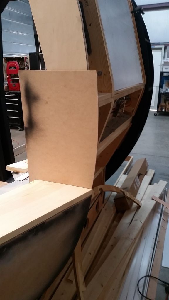

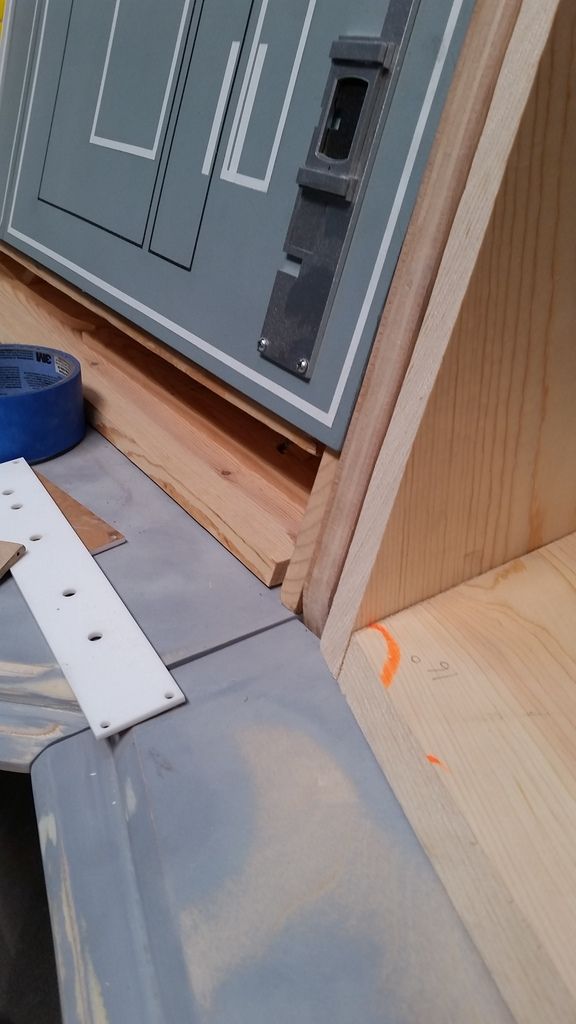

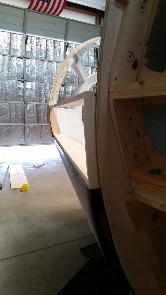

With the window done I could FINALLY move forward to the dreaded Volvo panels!

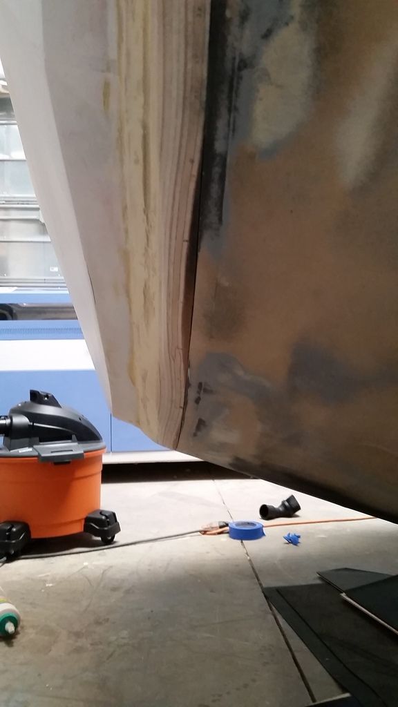

Before I made the cut I made sure the surface was level
A little more material to remove - it was REALLY bad before I sanded
Almost perfect!

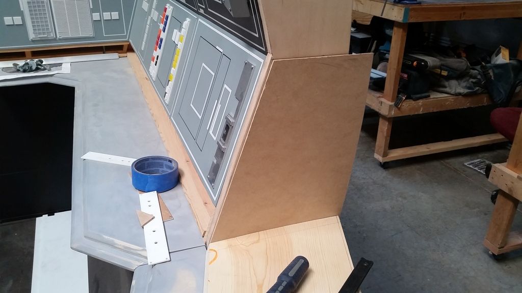

Volvo panel lower frame piece cut and in place
I also sanded down the window / nose transition. Awesome! I didn't go all the way around...
Finding the curve
And this is where we are...
The Volvo Panels are really tricky since adding the shelves! The lower Volvo panel MUST align with the edges of the shelf when going toward the front window. Seems easy right? I'm looking at several "Behind the Scene" images from ESB (feel free to use them) and I discovered a LOT of anomalies between the nose and main body transition. Note how the upper Volvo panel is actually angled away from the interior making it possible to see the actual side of the "Slider" panel. These are the little things I'm trying to figure out...
A few more
Why is it so confusing? The original ANH cockpit didn't have this issue
This one is VERY telling... Note how the hose, just above the Volvo dash cluster appears to be tucked behind the lower 15" extension panel

Cockpit is looking good Sofa and those strips of wood you've affixed on the main window will do the trick for sure. Keep up the great work!

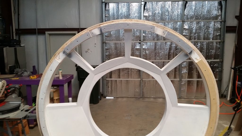

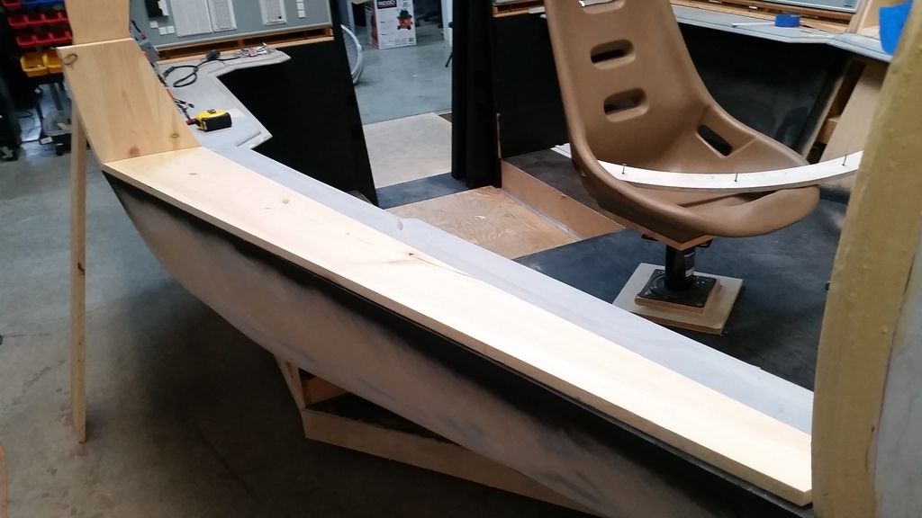

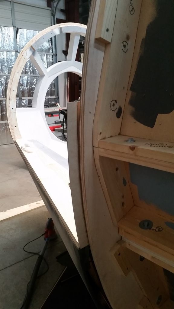

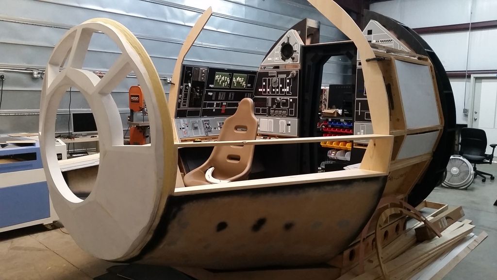

I did it! I made enough forward progress on the front nose where I could finally start work on those dreaded Volvo Panels!

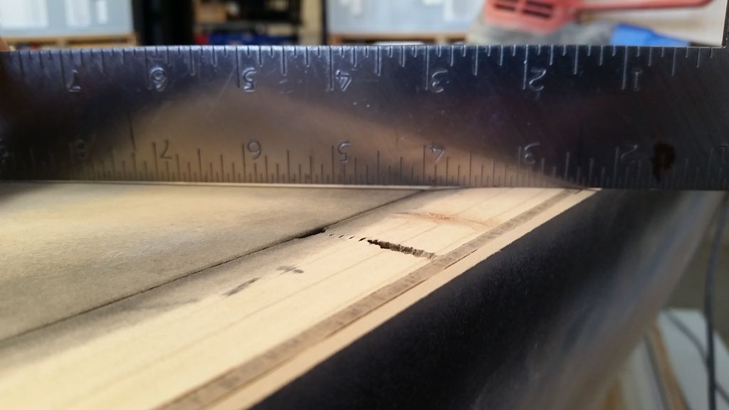

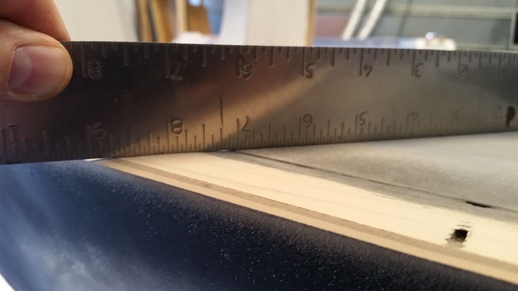

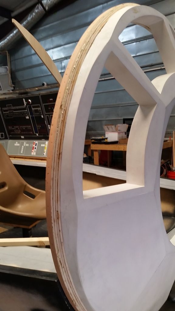

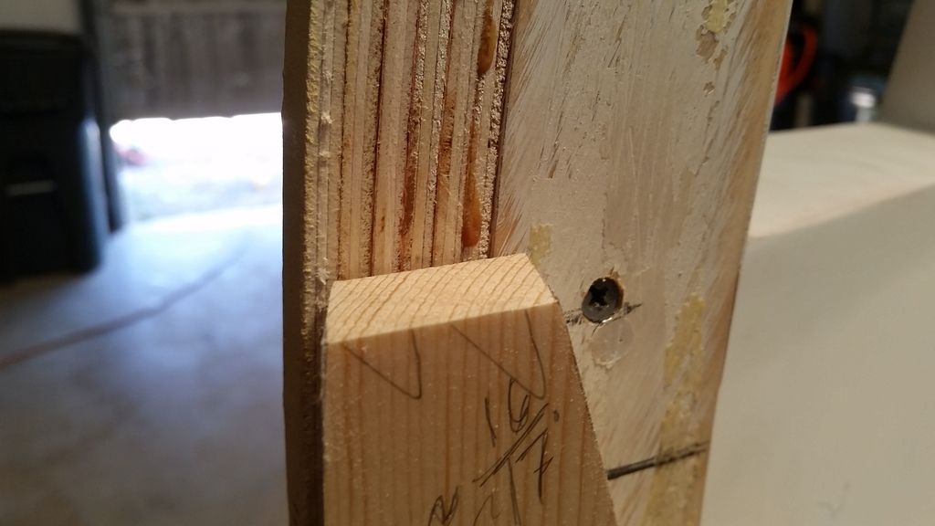

Filler strip added at the bottom of the window

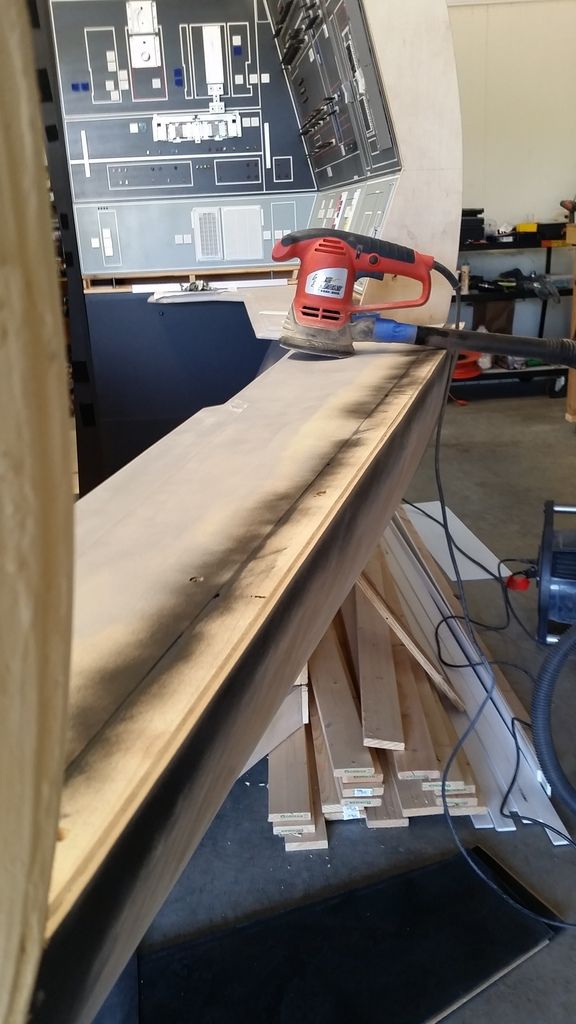

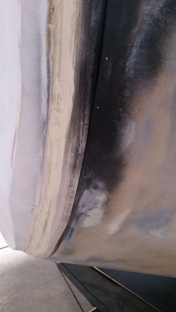

Broke out the trusty sander and evened out the plywood strips to the nose!

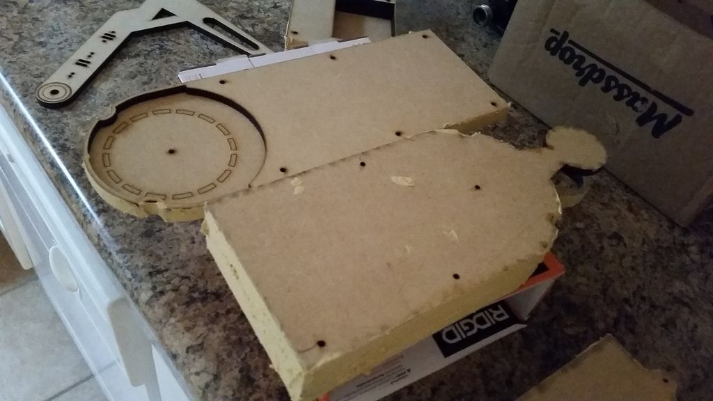

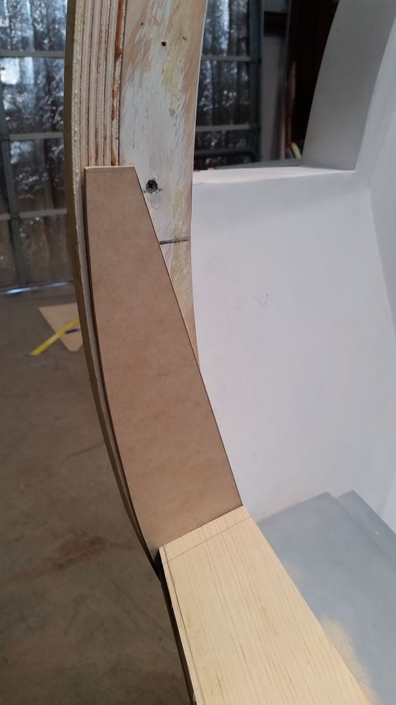

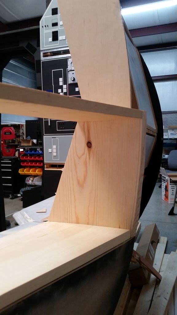

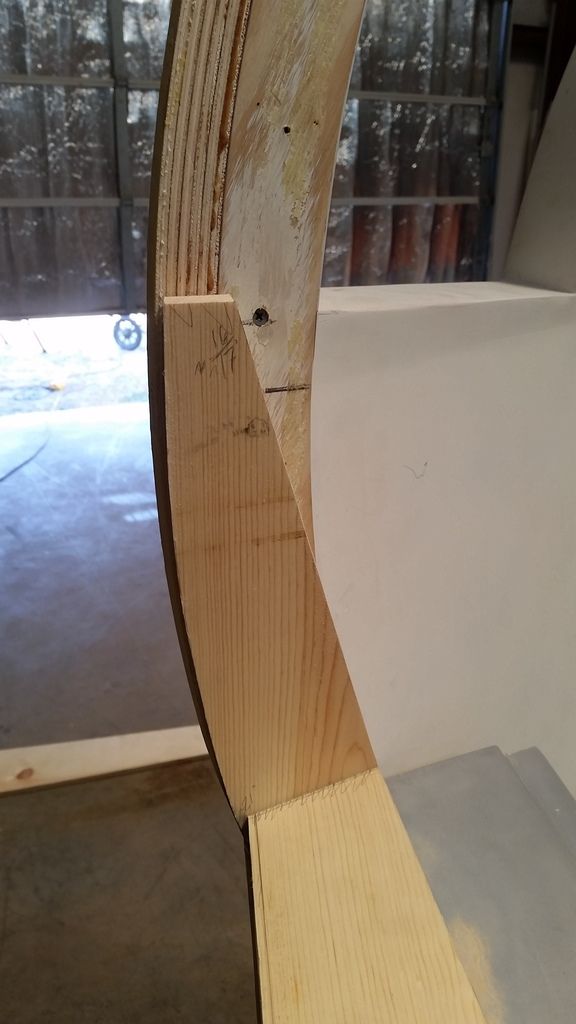

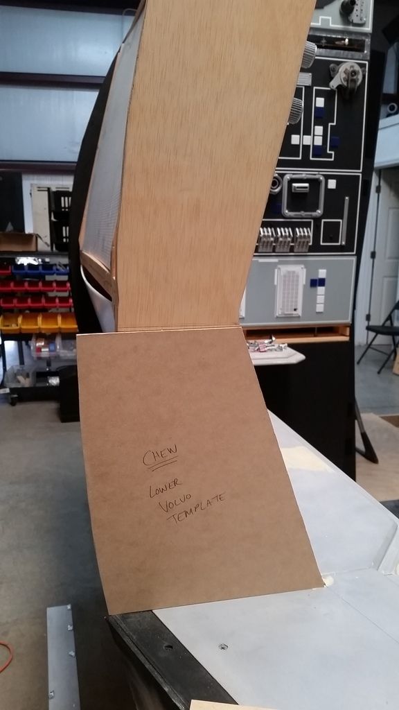

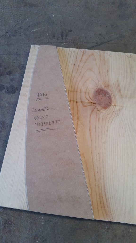

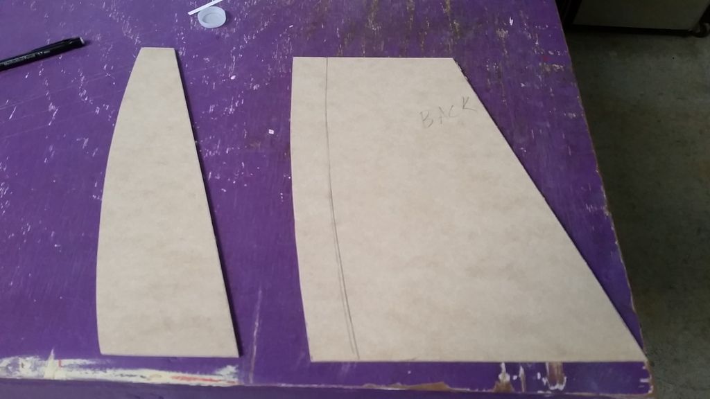

I already cut Han's lower frame panel so now it was time to build the rest of the frame! I used the scrap MDF to create templates
Looks uneven but it's just tilted wrong
These are really tough pieces to cut!

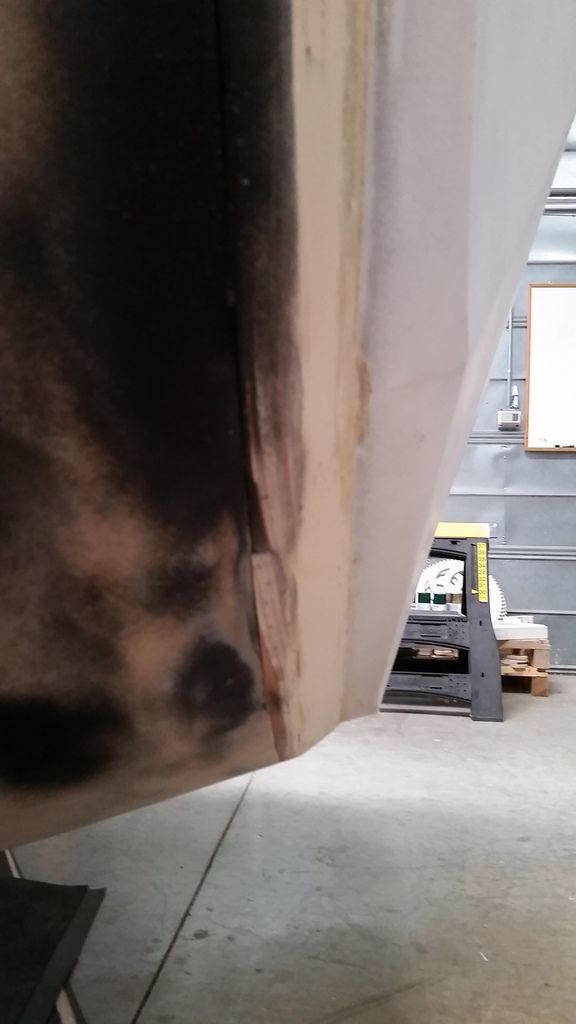

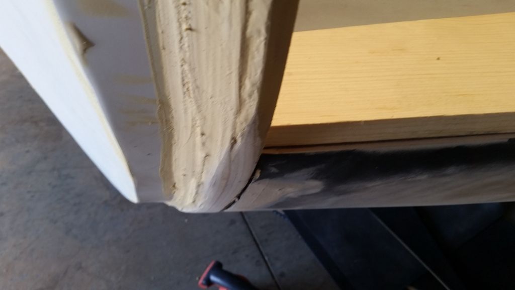

I might have to redo this panel - I sanded a bit too much off the exterior side
And now for the front...

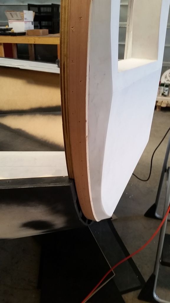

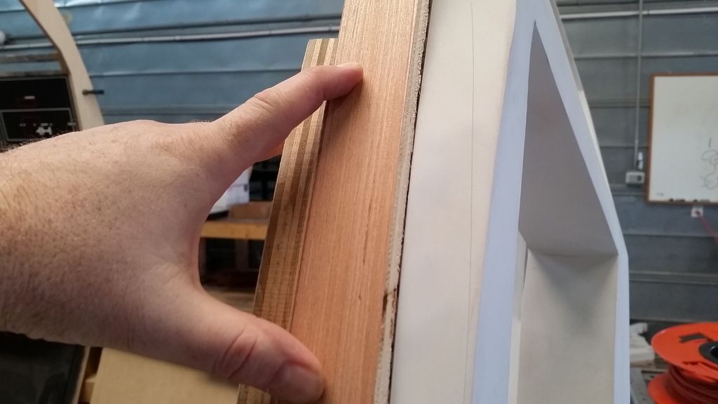

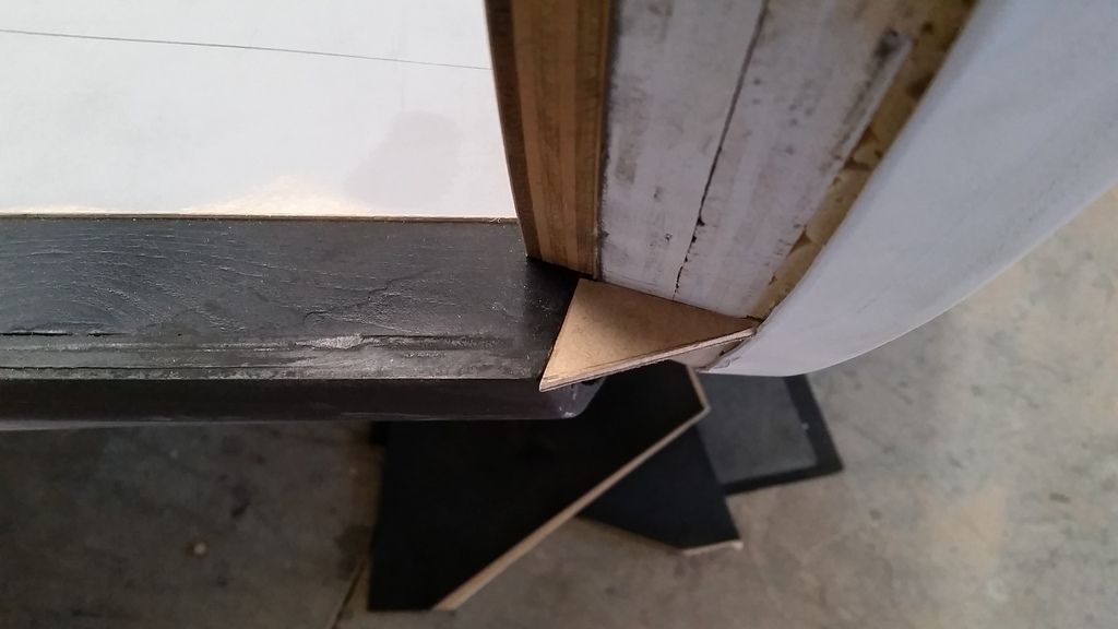

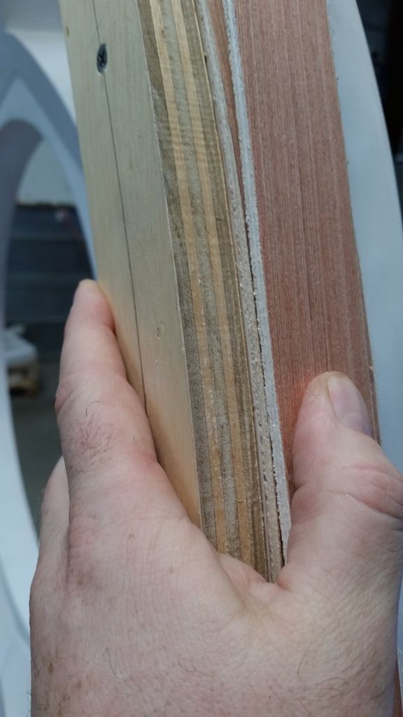

This pic shows WHY I had to add so much material to the front nose. Note the difference between the solid piece of wood and the strips of ply on the window. I think there was 1/4" of wood to play with! The added ply gave me a little more surface area

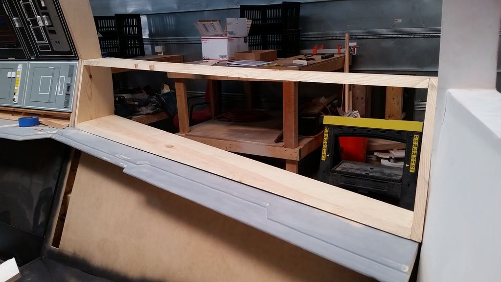

Prepping for the top piece of the frame
And Done!
Near perfect fit!
I cannot wait to get the exterior skin added!

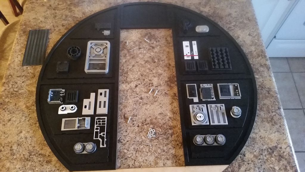

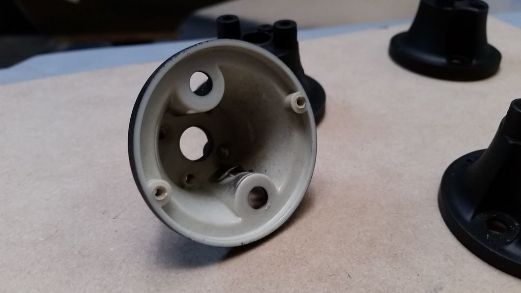

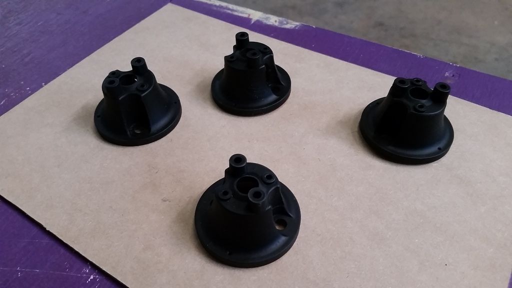

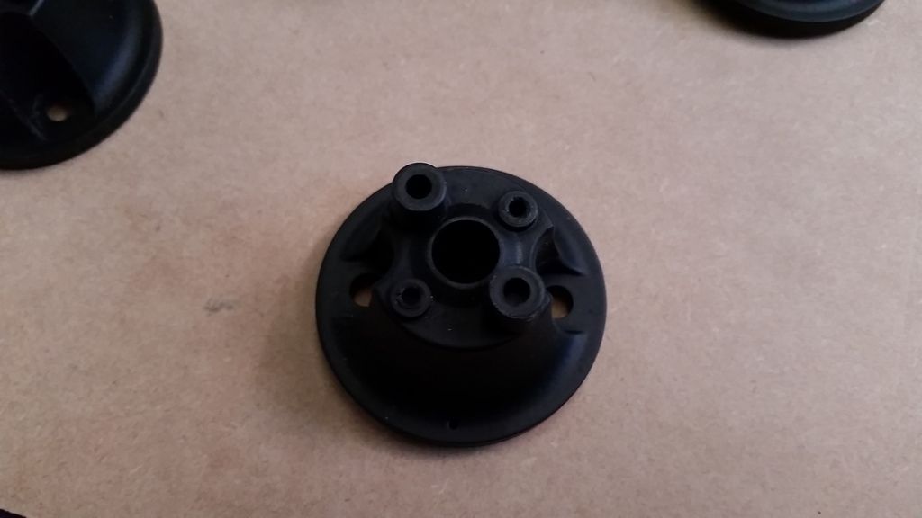

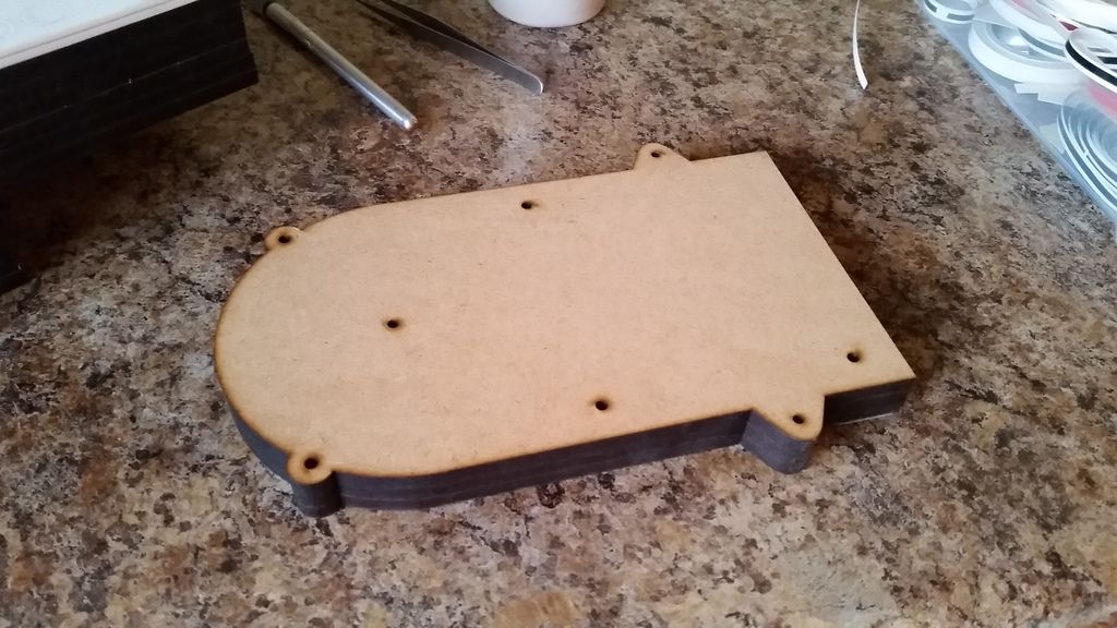

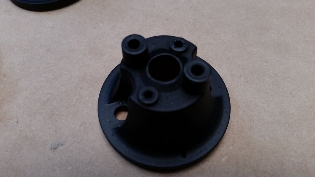

During all this my buddy Scott gave me some old Pinball parts and all I saw were greeblies! So... added some black paint :)
Still need to paint the inside
I'm going to paint them silver and add to this greeblie to give them a bit more life

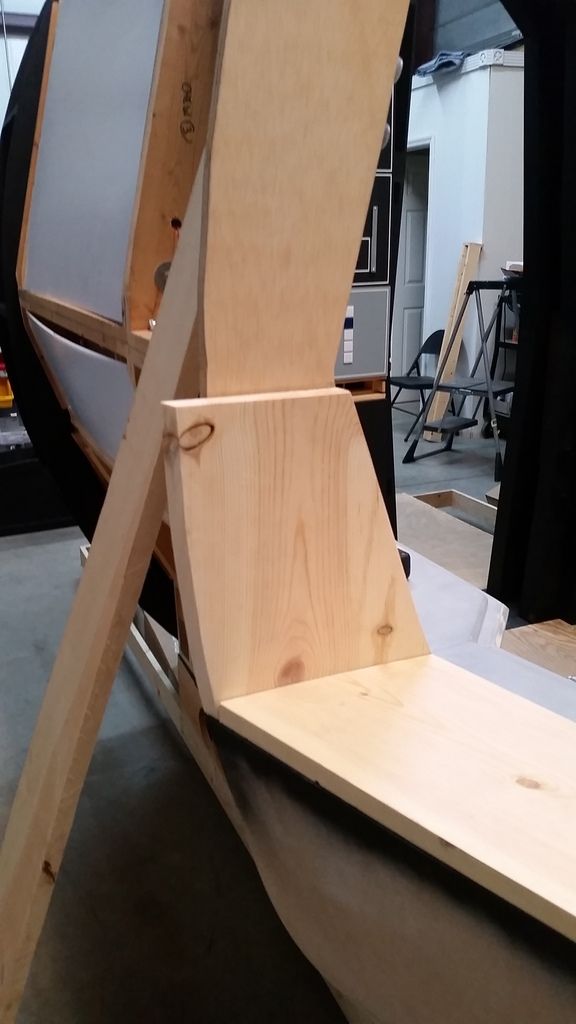

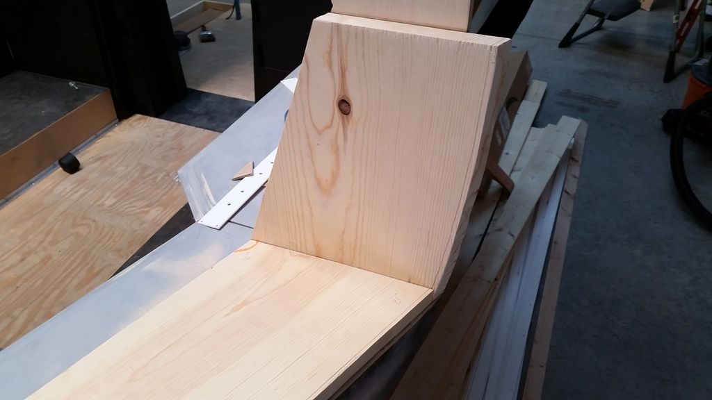

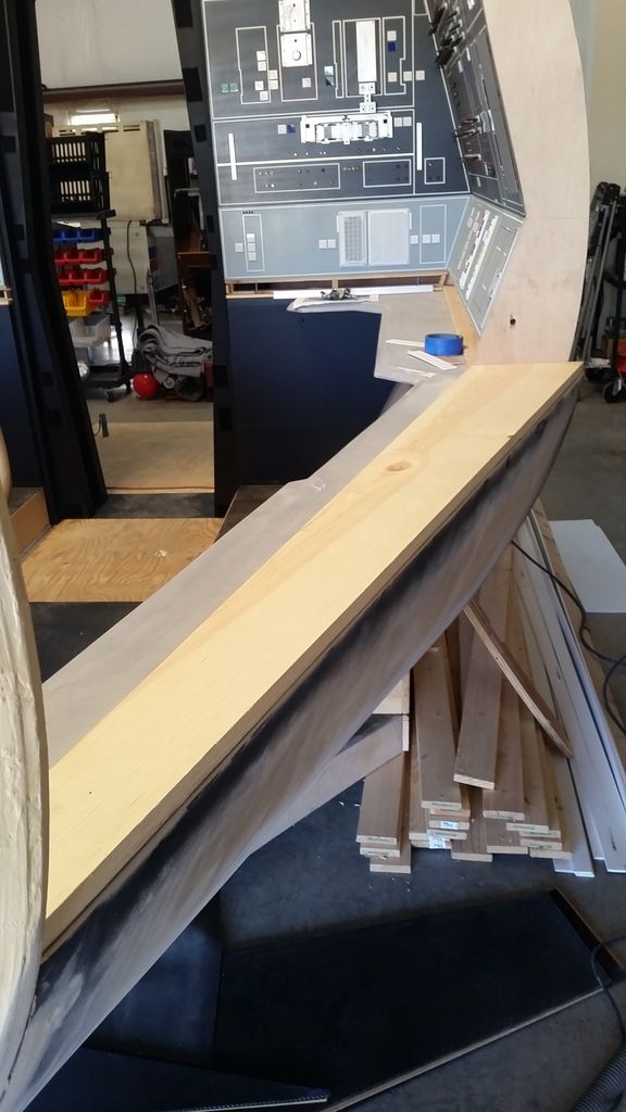

I'm afraid nothing less than steam will help you.The idea is to loosen the lignin fibres relative to each other, allowing them to slide and set in new places when it cools. For that it needs to be above the boiling point. Hot water simply isn't hot enough, you would need at least a pressure cooker, and likely hooter than that.
Hey FF,
That's what I was afraid of. After 4 days of soaking I knew the pine wasn't going to behave the way I hoped. That's why I went with the 3 ply strips to get the shape I needed and it worked really well. :)

Thanks for the input! I was doing a lot of research on YouTube and that's how I found the laminate approach. Layering up the ply was the easiest and least resistant path to take. I like how everything is turning out so far!

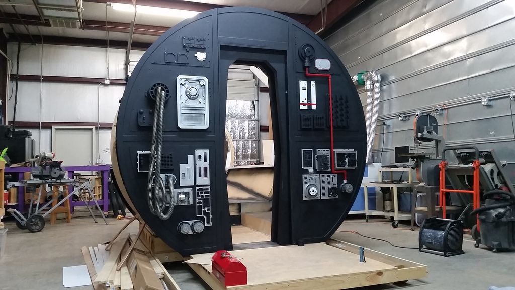

Hi Gang,

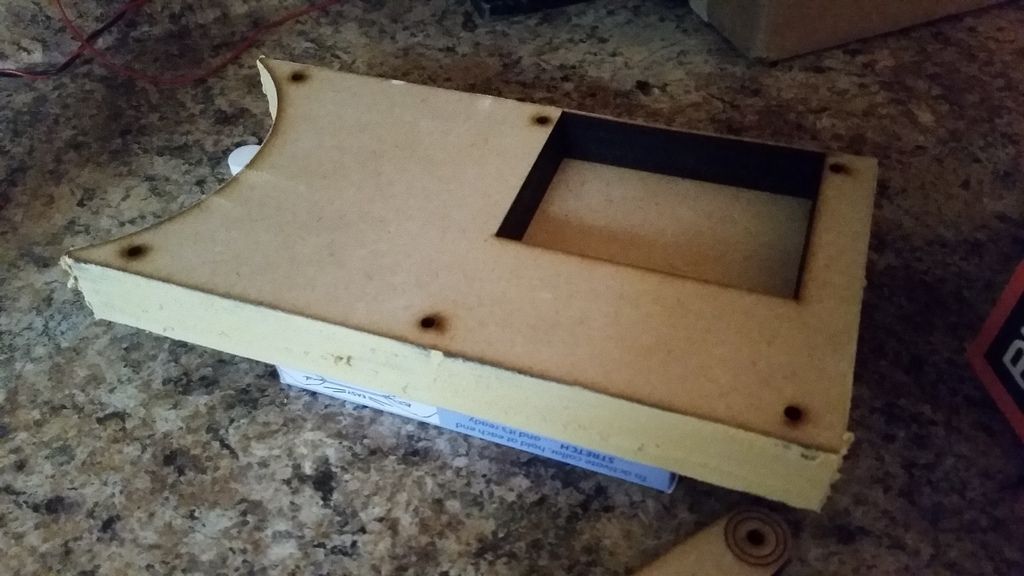

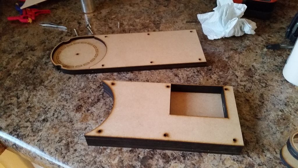

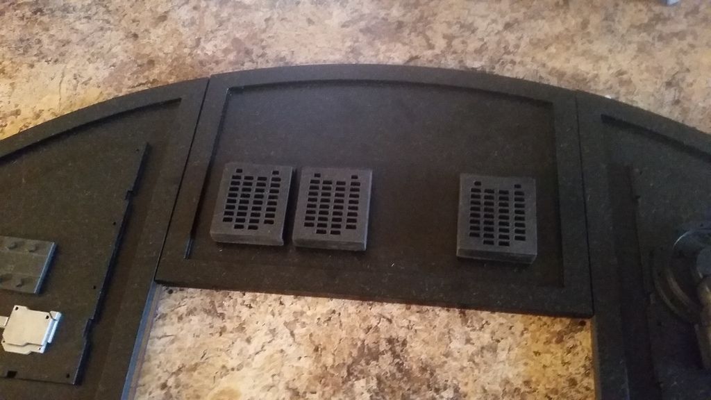

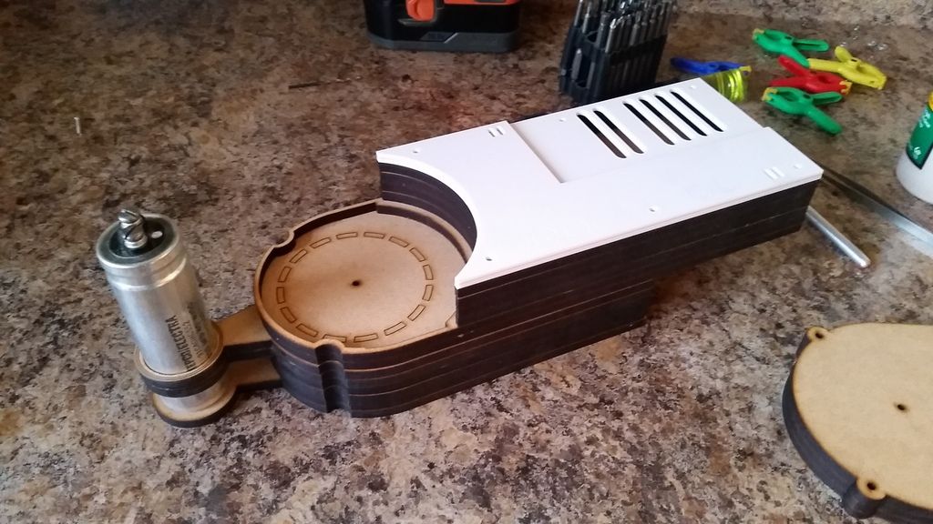

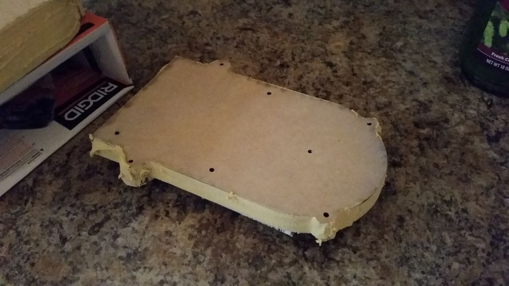

Early morning update! I added filler to the foot well greeblie! I'll be sanding and adding primer tonight. The base

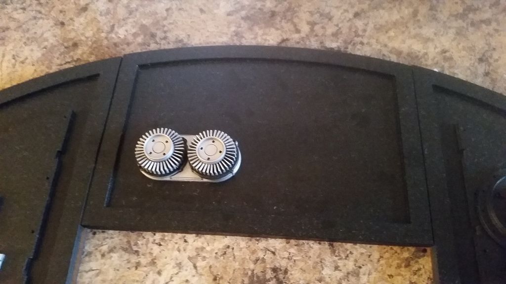

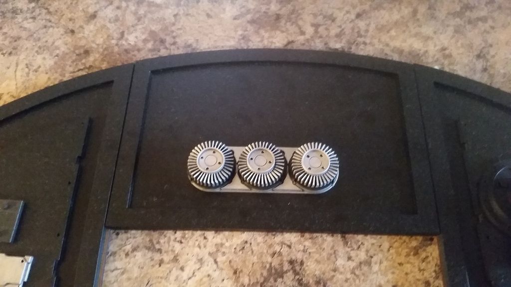

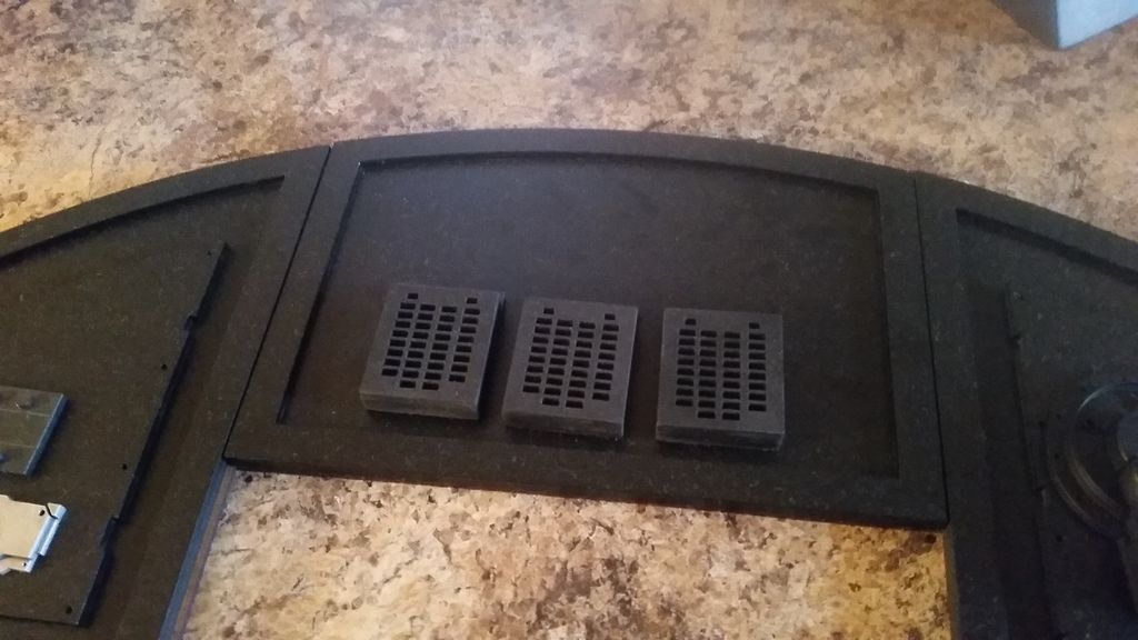

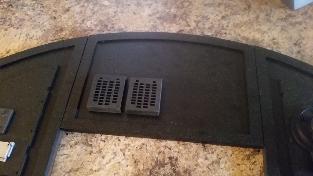

Changing gears... as you can see from this image there are no greeblies mounted to the panel above the door... I'm not sure if I should leave it as is or add some greeblies, hoses, etc...
Using the 1/4 scale...
What do you guys think?
Or something completely different or nothing at all? :)
More to Follow!
Hey Y & BBD,
Thanks for the input! :)
What do you guys think of an open panel with lots of greeblies in the back?
