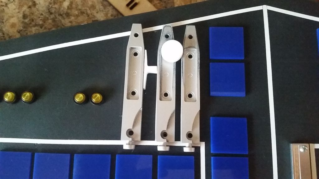

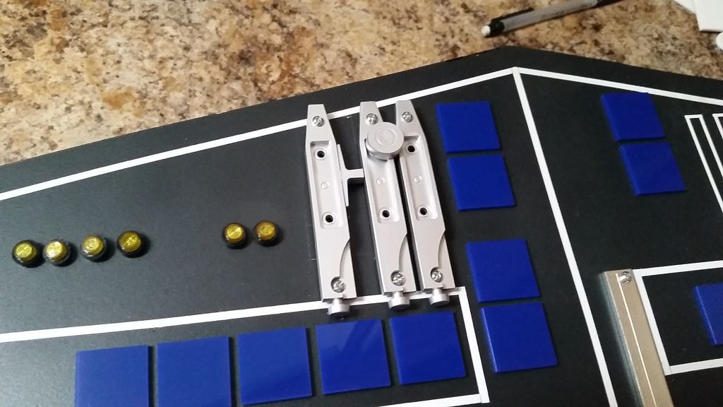

Try rotating the loops and, if you have them, add additional caps. Add a cross bar between the "legs" and it would look like a breaker handle. Looking good!
I love looking at things and thinking "greeblie!"
Hey H,
I planned on adding dowels in between the two arms to give it that "handle" look - great minds! :) I'm going to go back, take a look at it and see if it can't be salvaged. A buddy of mine, Scott, has some great looking real world mechanical greeblies that I might use instead.
Stand by!

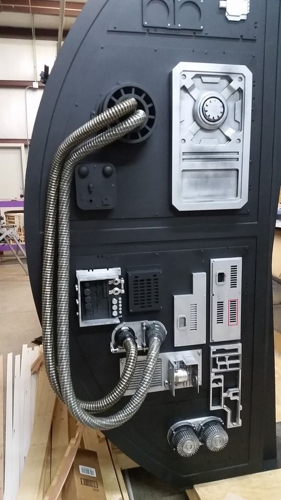

In the hall, we see the seldom-seen Falcon bathroom door, three tanks of hyperdrive fluid, and a naughty chair for Threepio... :p
Sofa, that greeblie looks like a grasshopper on...grass:D The middle part is great, but those side "things" are a bit off (my two cents, of course). Besides that, looking good and thanks to the Laser cutter (finally).

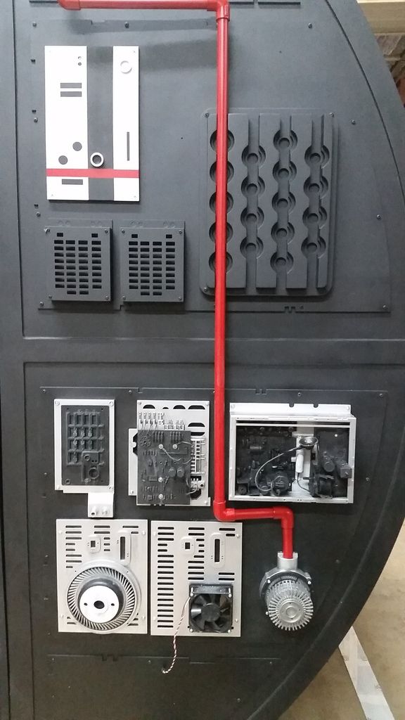

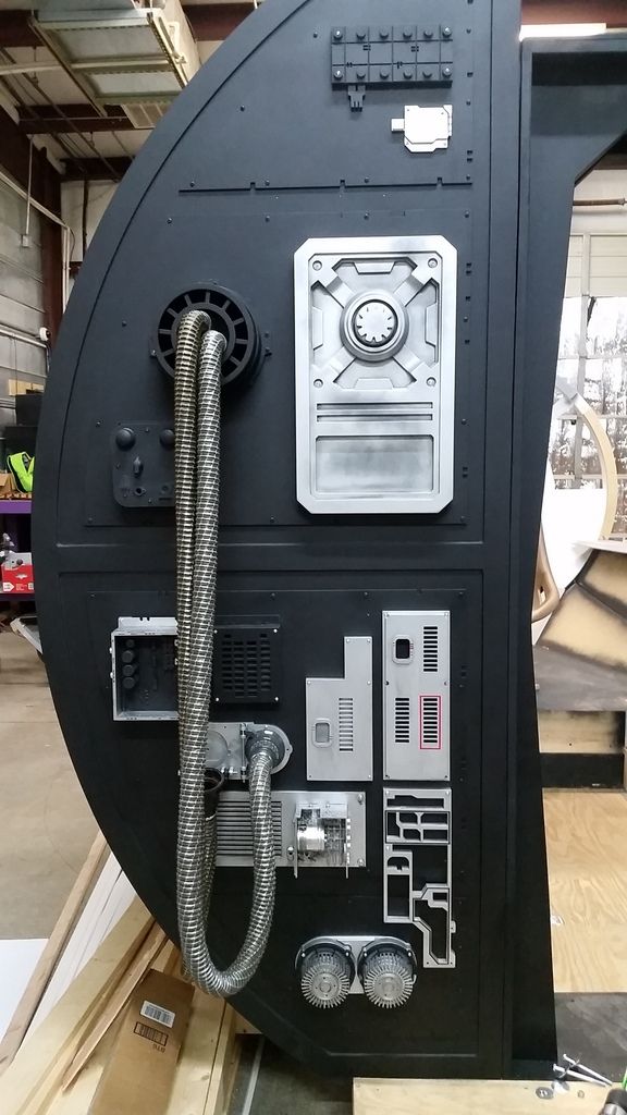

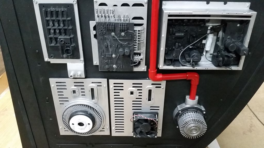

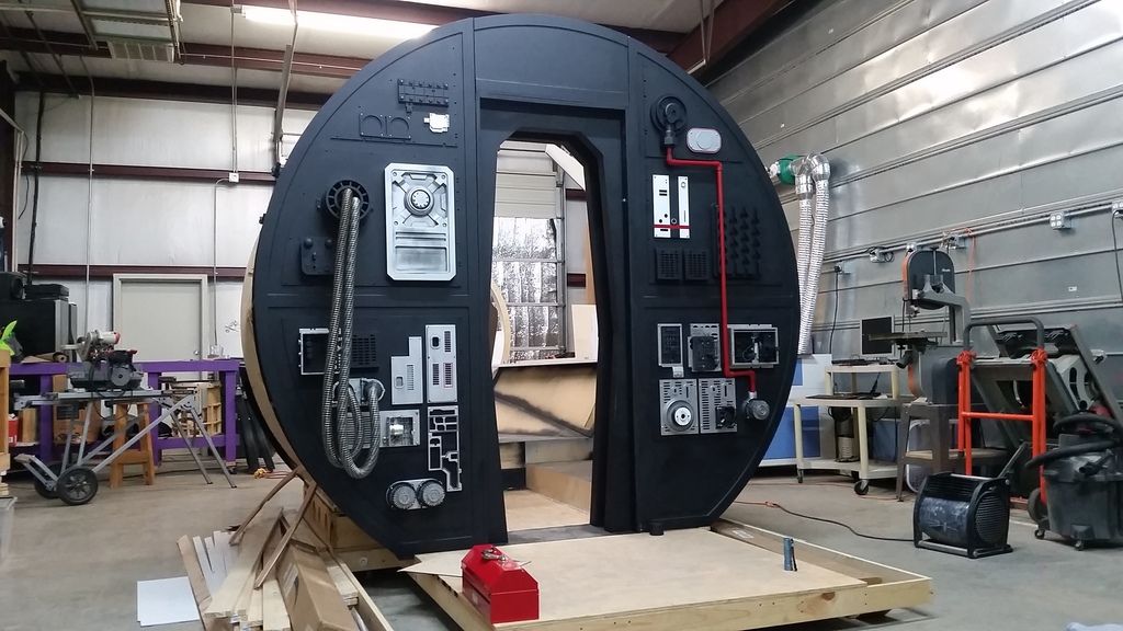

Rain Rain Rain... The rain prevented me from moving very far this weekend but there were a few breaks in the clouds that allowed me to do some things... Not much...

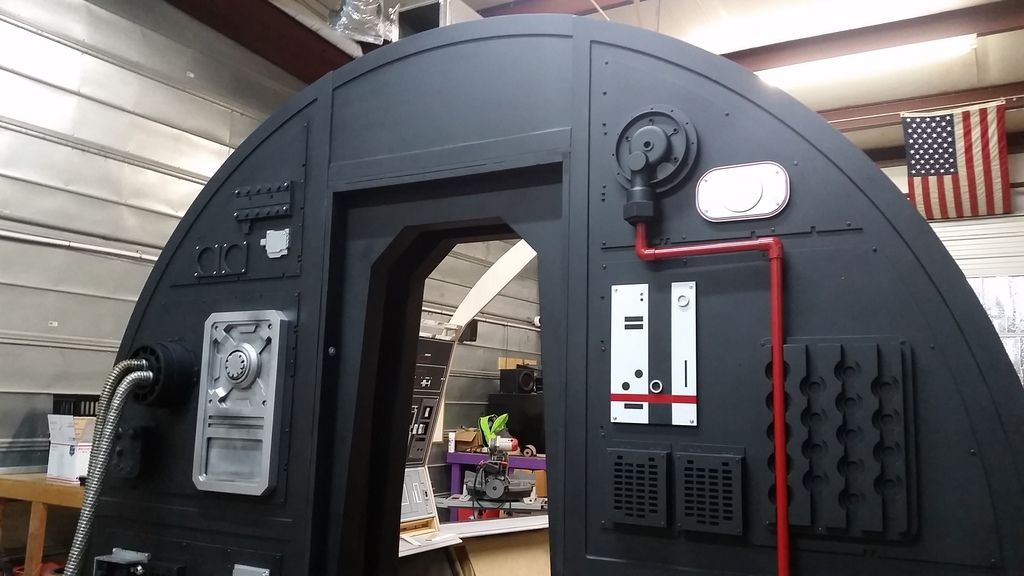

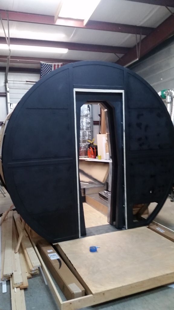

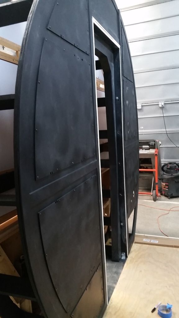

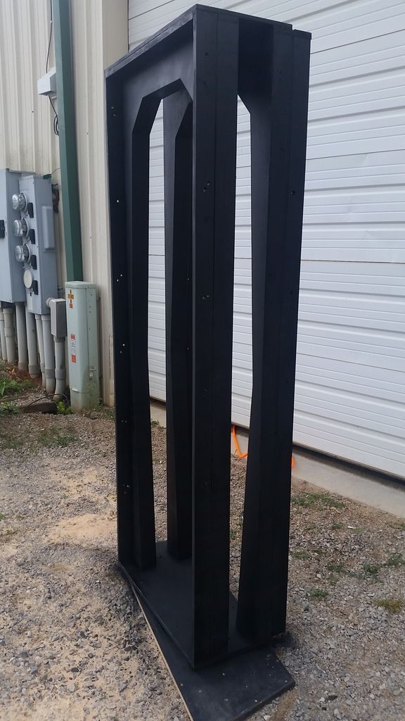

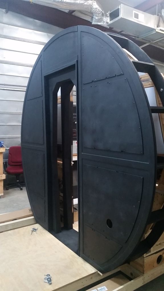

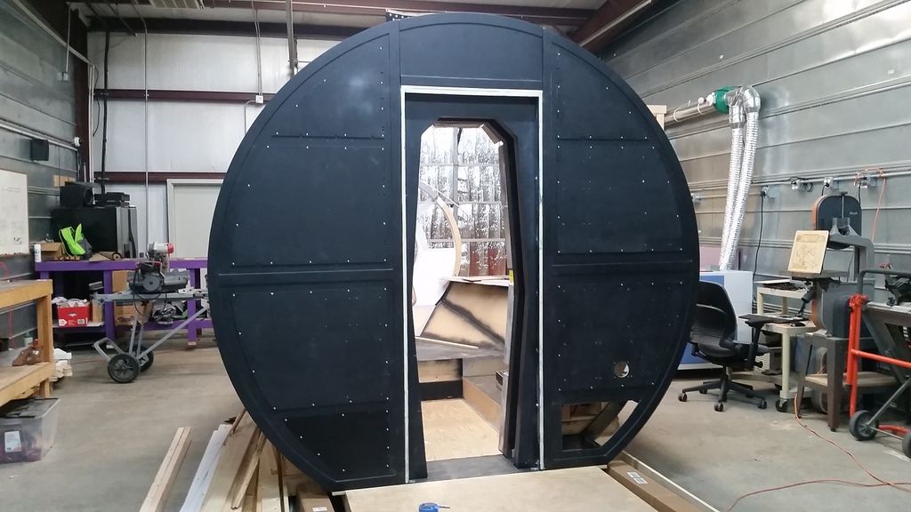

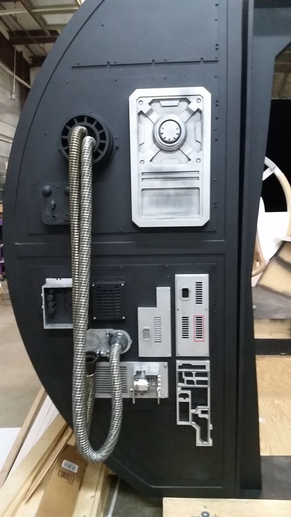

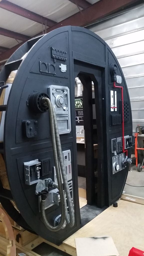

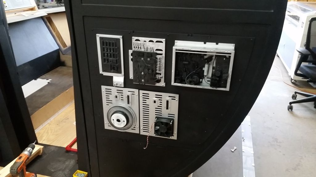

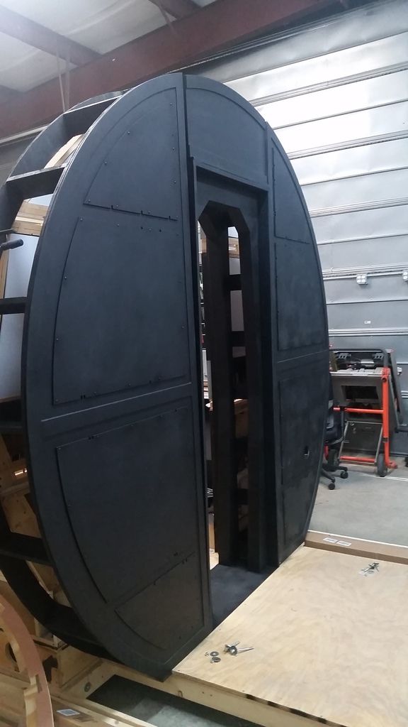

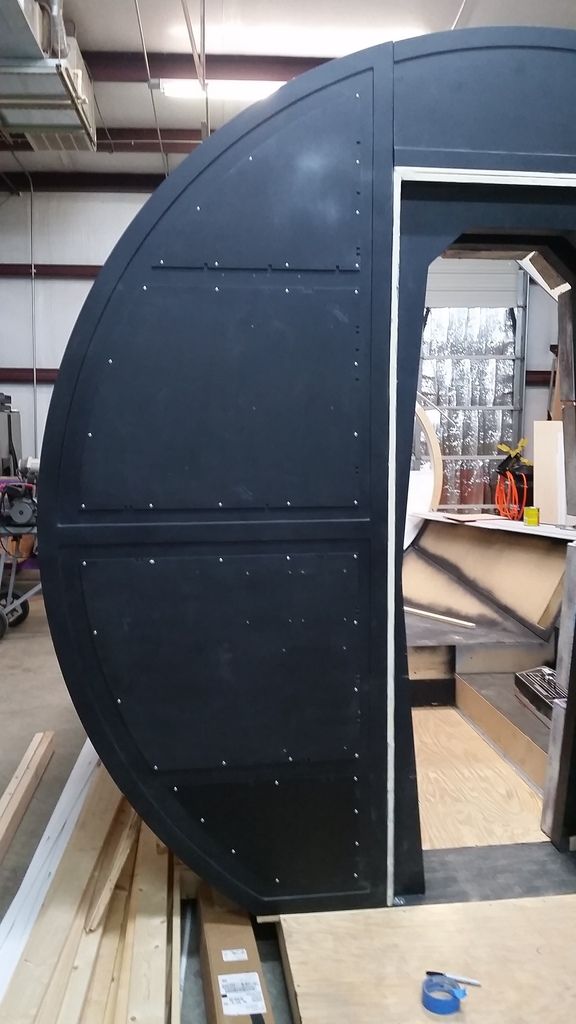

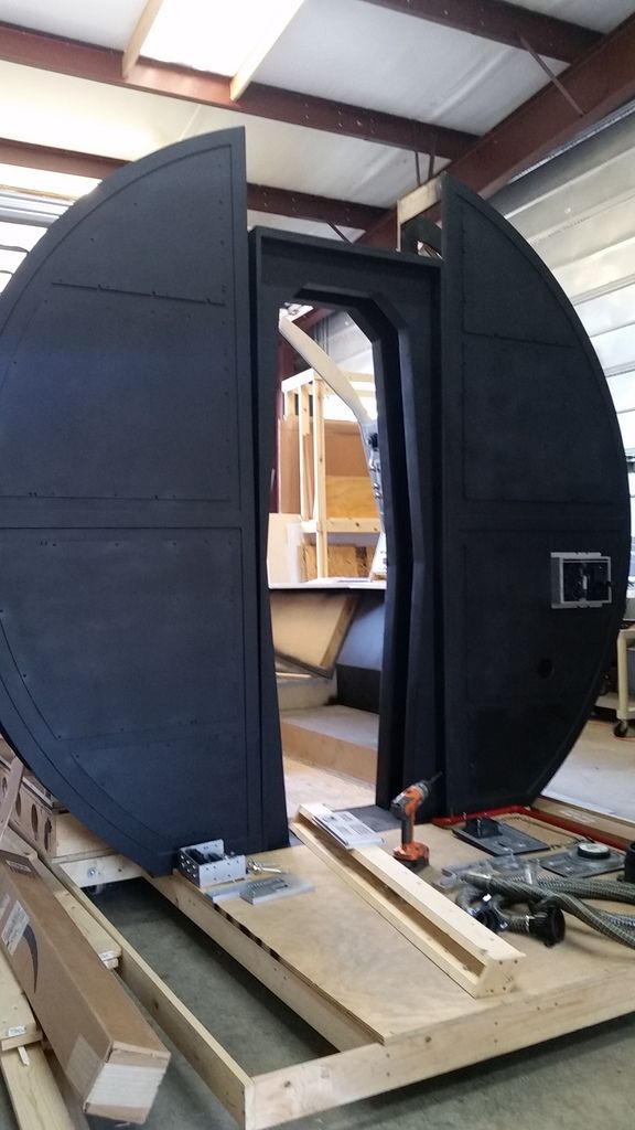

I mounted the cockpit entrance panels to the frame
Painted the screws the black
Completely repainted the panels (rain prevented me from painting Chewie's side). I was going to leave them but there was a lot of over spray and exposed wood...
It does look cool!

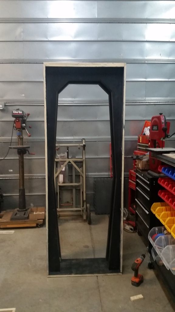

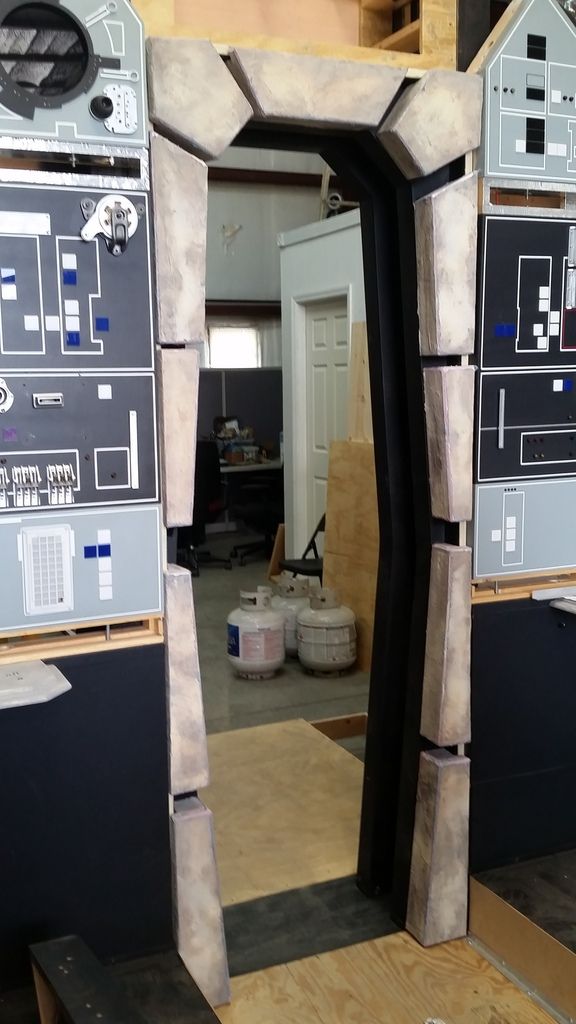

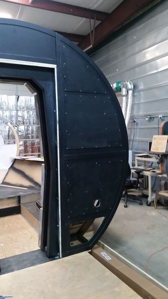

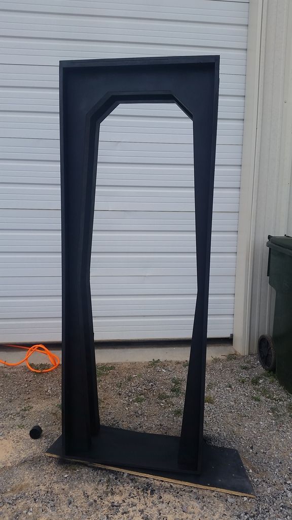

Finished up mod'ing / sanding / painting the door frame

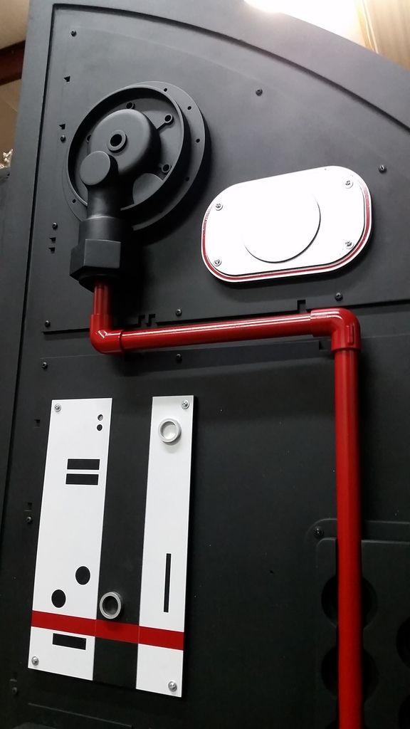

Painted this back wall greeblie
I cannot remember which side goes up...

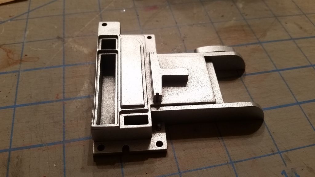

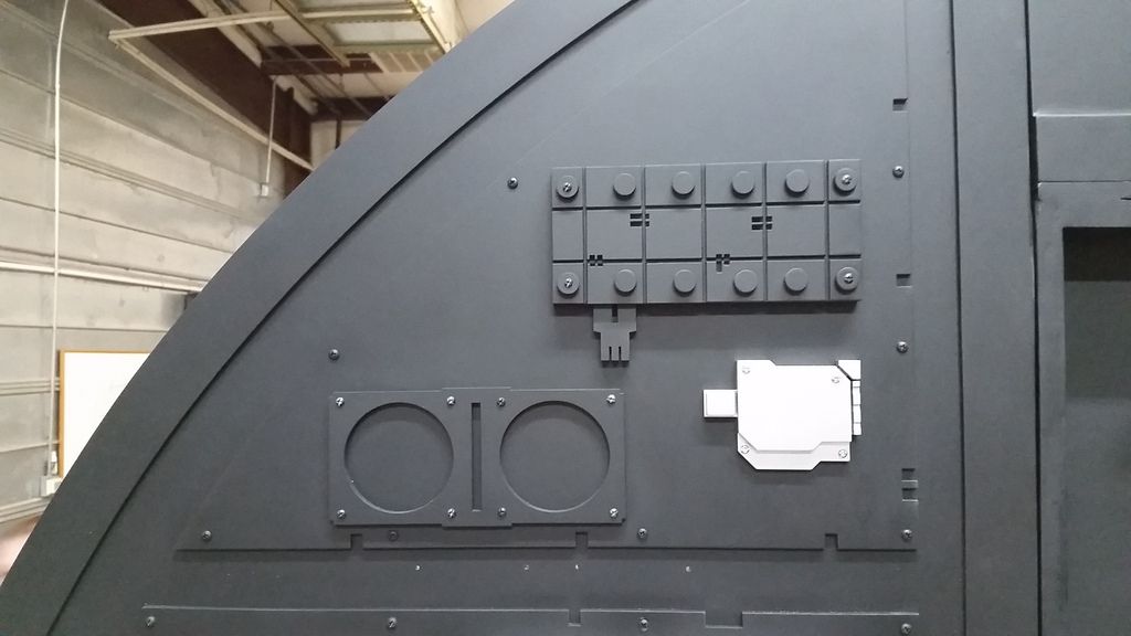

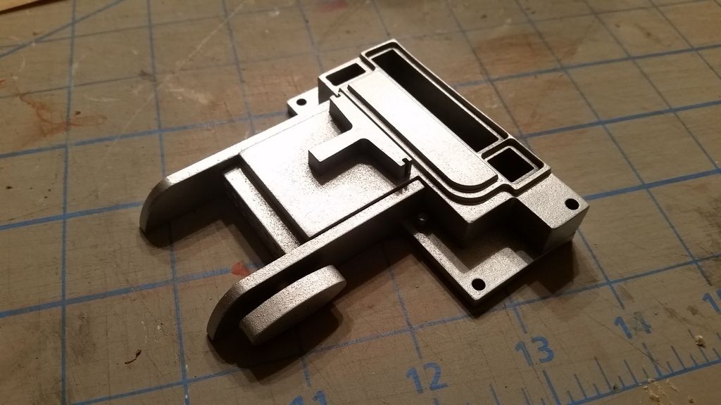

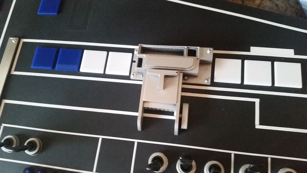

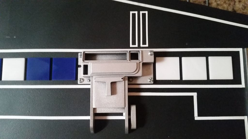

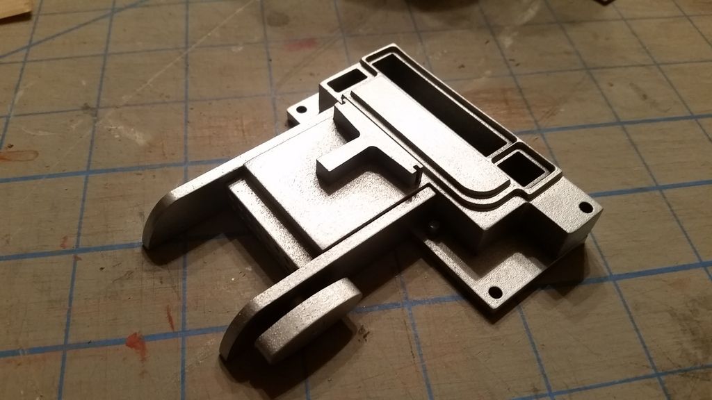

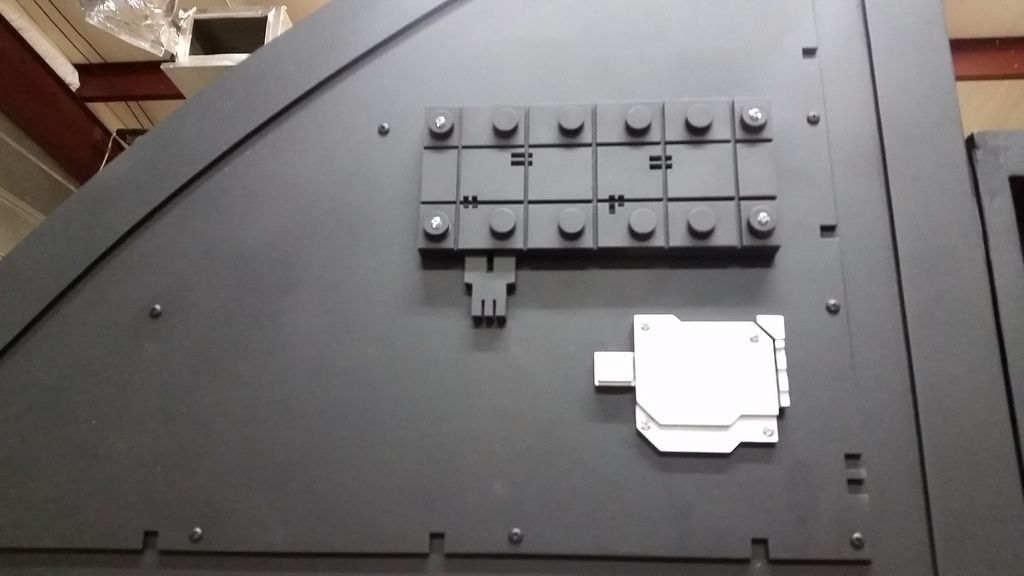

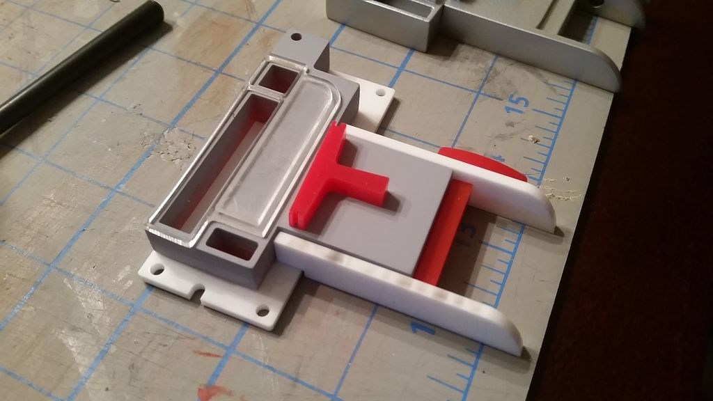

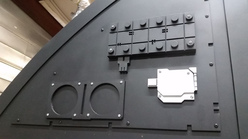

I was able to cut the new cassette greeblie for the capstone panel
I've designed/redesigned and cut this particular greeblie 7+ times
Details
Adding filler

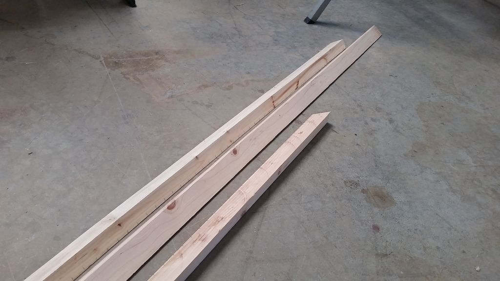

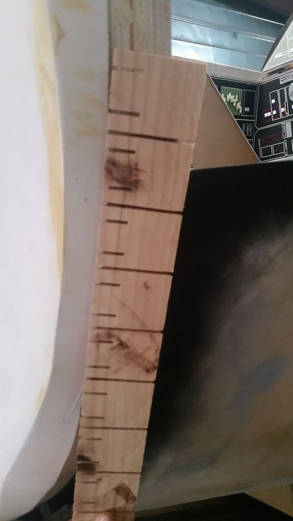

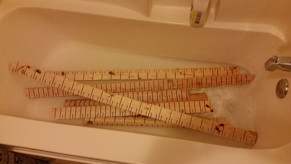

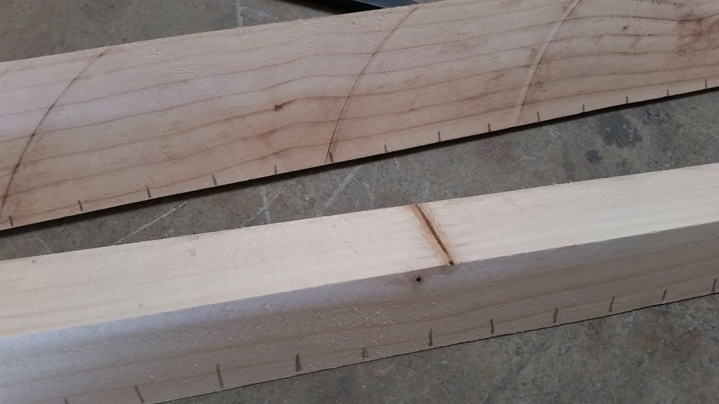

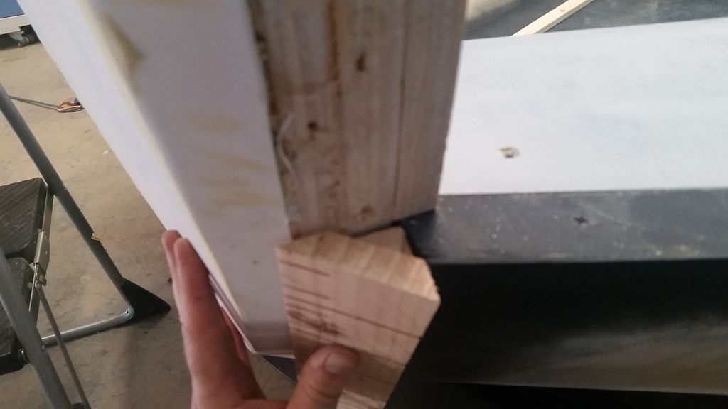

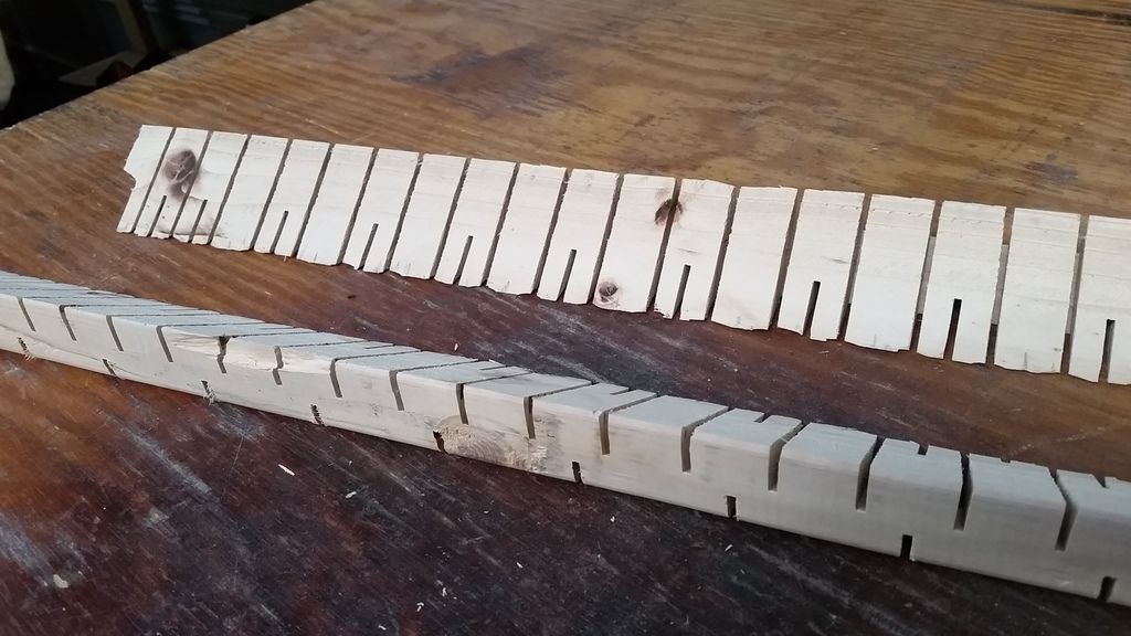

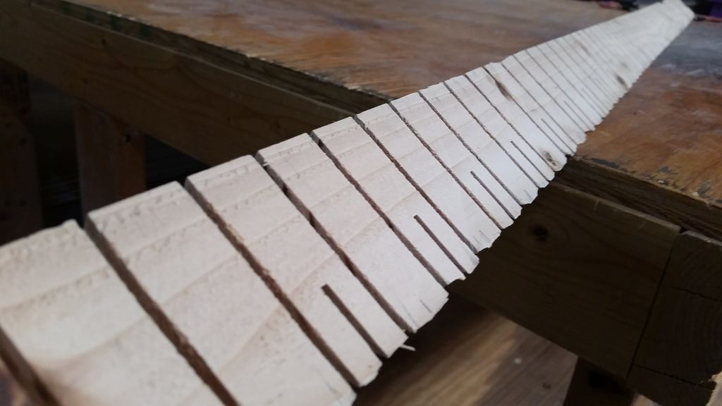

On to the front window... Well... those white PVC strips didn't work so I decided to use good old fashioned wood. I ripped these pieces from a pine 2x4
1" marks

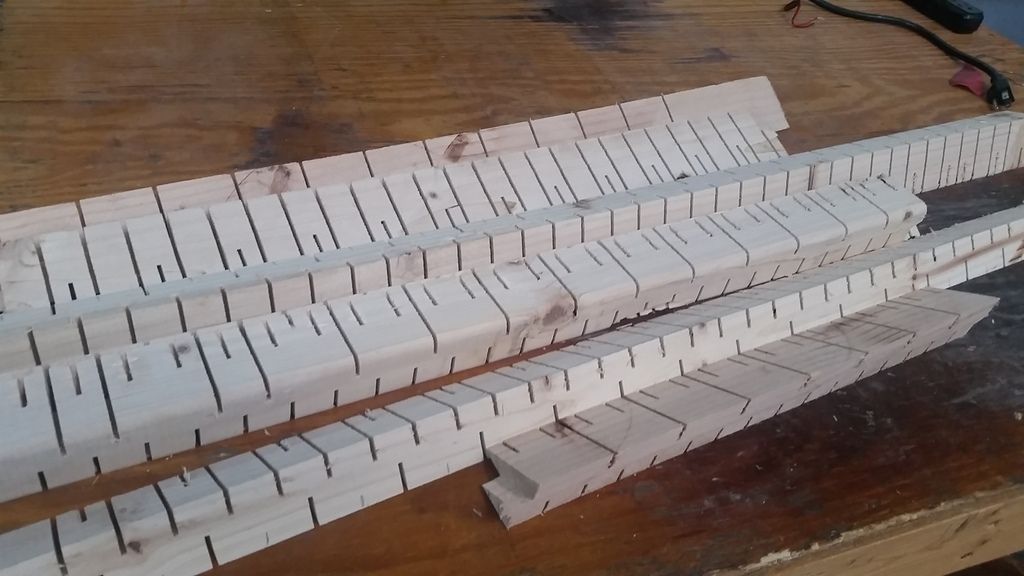

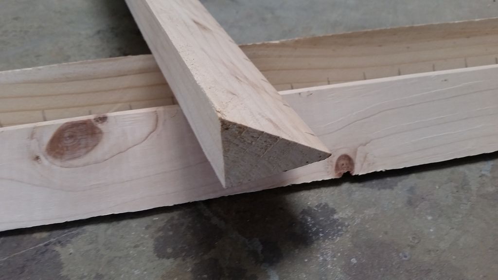

Using the table saw I ripped, but didn't cut all the way through, the piece
They are SO fragile
The idea is the notches cut into the wood should allow me to carefully bend the shape around the window creating the form I need
Got some trimming to do...
The wood is SO fragile and dry I need to soak the pieces in the tub for several days before I attempt to curve around window. Hopefully the water will penetrate the pine and allow enough flexibility. Fingers crossed!

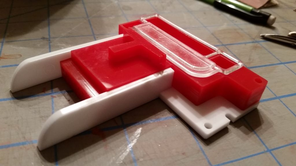

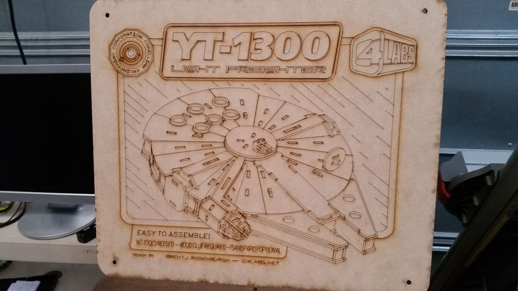

And Finally... Don't You Just Love when the Laser Cutter Works! ;)
Hey J,
Thanks! Yipee for the laser cutter! Yeah... the grasshopper greeblie is going to have to be reworked. The two side arms need a bit of a redesign. I have an idea... I might try to get to it this evening.

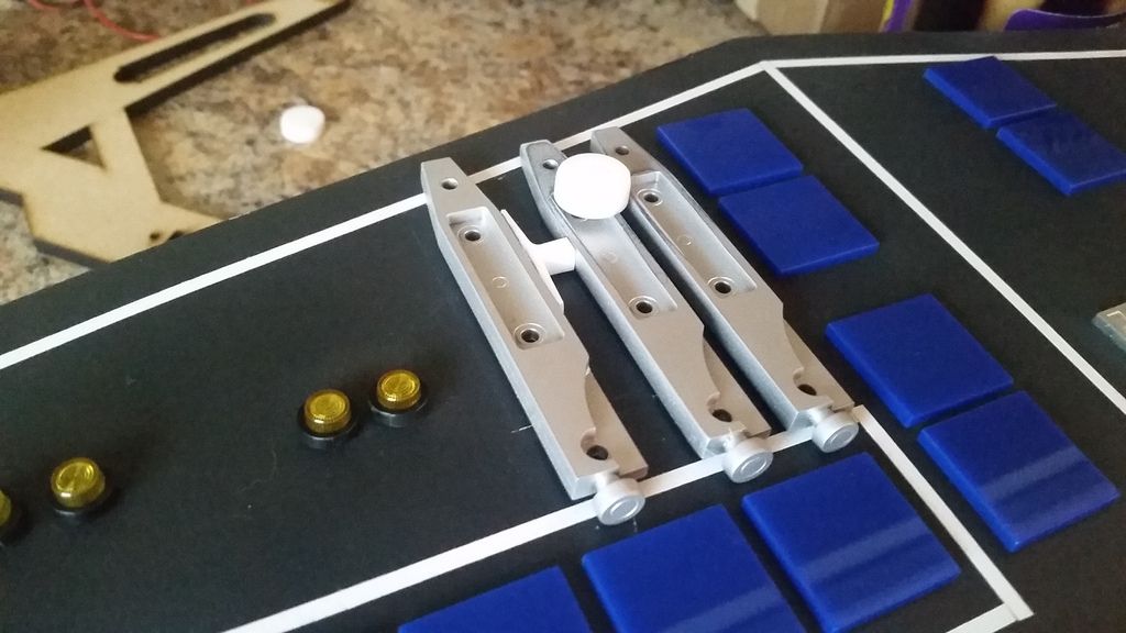

Finally updated and cut this greeblie

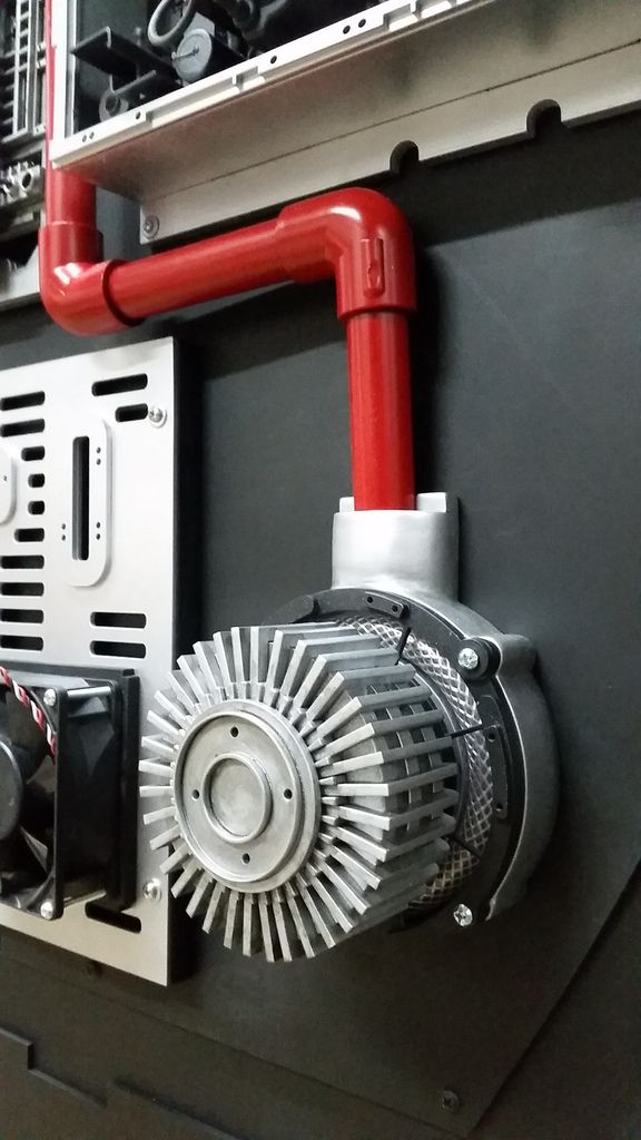

Those standoffs I mentioned last week
http://i778.photobucket.com/albums/...n Build 01108/20160917_061842_zps82bqhilf.jpg
These look much better than the pile of nuts I put in place. Just need to paint silver

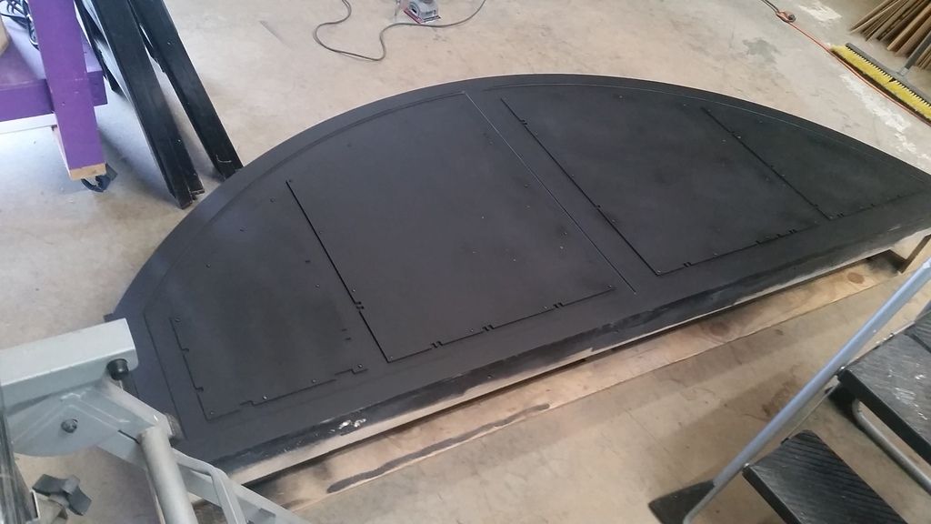

More work on the foot well panel
http://i778.photobucket.com/albums/...n Build 01108/20160917_075741_zpssd5wymdr.jpg
After painting I think I'm going to add some pinstripes
http://i778.photobucket.com/albums/...n Build 01108/20160917_094510_zpssxeyexth.jpg
http://i778.photobucket.com/albums/...n Build 01108/20160917_094524_zpslbfmqg0w.jpg

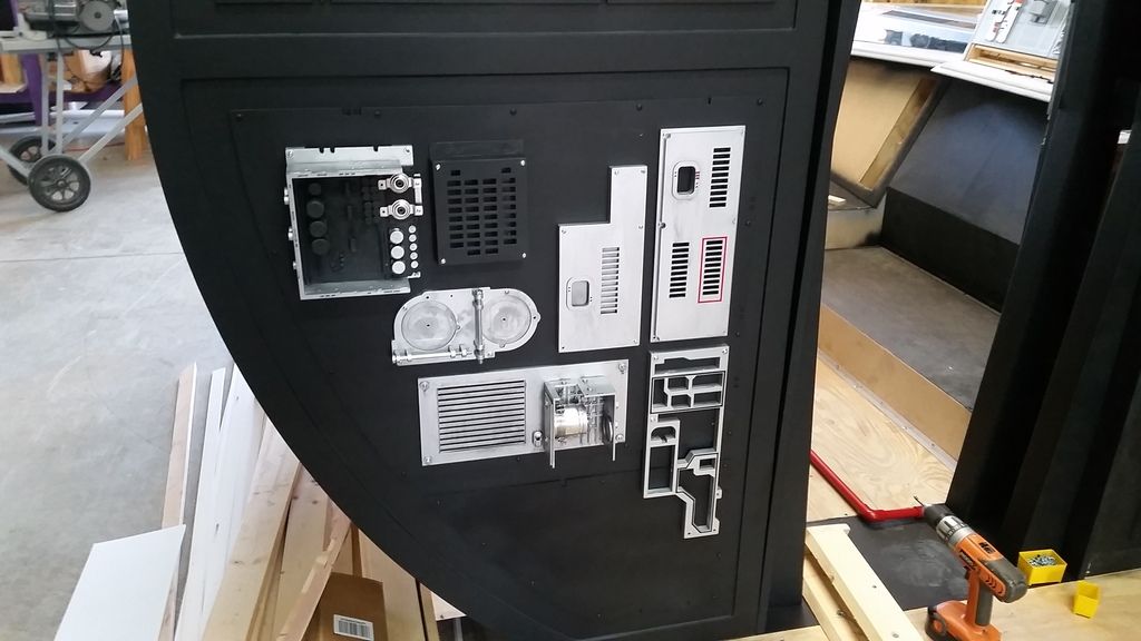

The foot well panel will have a few greeblies mounted to include this one I designed... Laser Cutter Works!

I don't think I like it... What do you guys think?

LOVE the 3D models you created! The coil I added is actually one I pulled from the cockpit entrance greeblie pack and is used for visual reference only. The actual one will have a MUCH lower profile similar to your model. :)
I think I'll go back to my original idea and have just the one "grasshopper" leg and see how it looks. I still need to get some dowels for the horizontal posts.
OK... I'll finish it up and see how it turns out. ;)

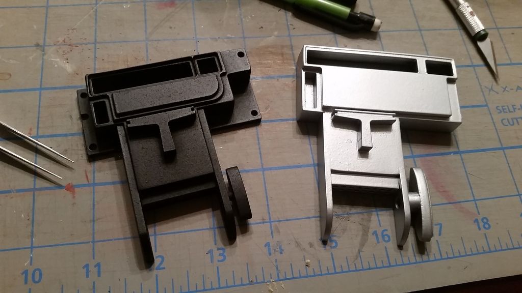

Hi Gang,

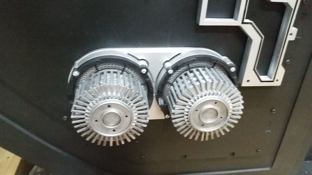

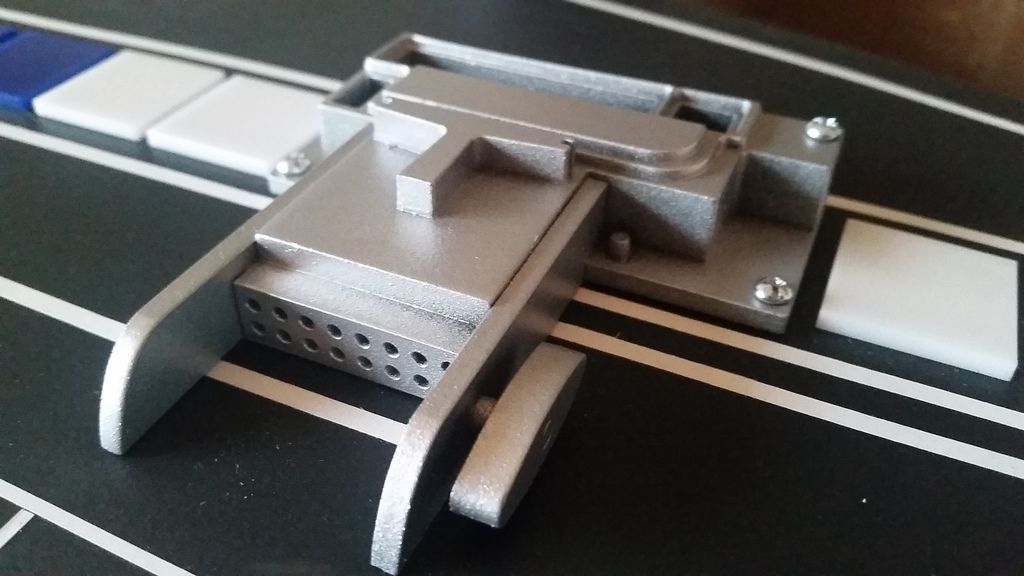

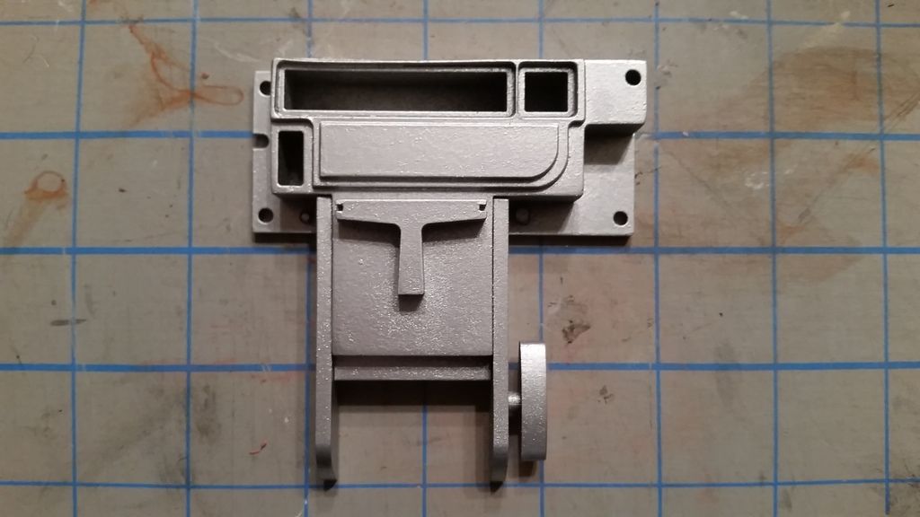

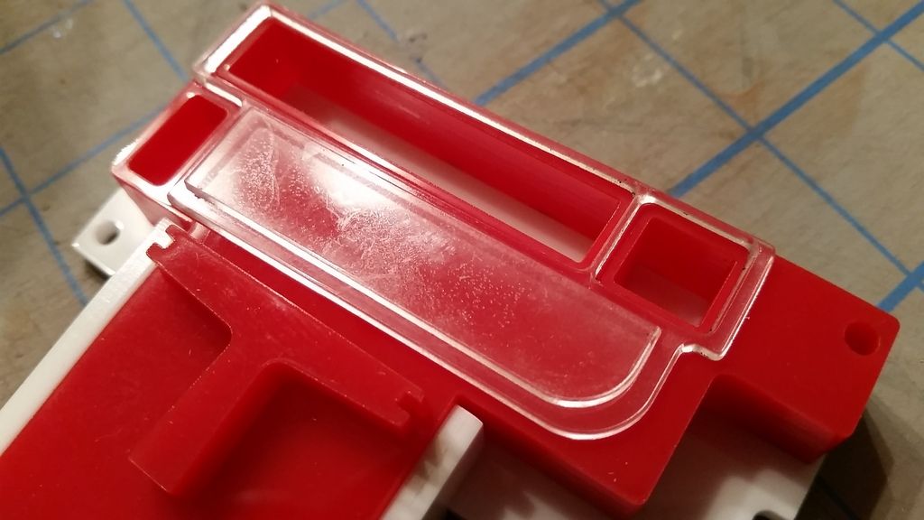

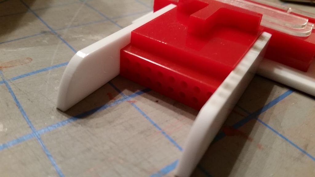

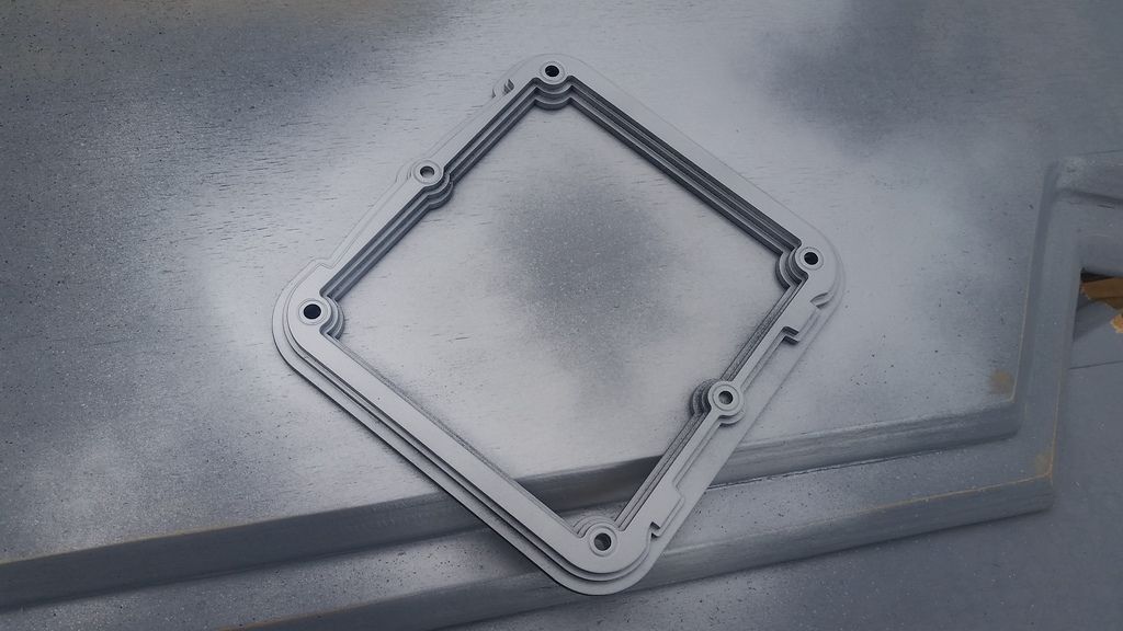

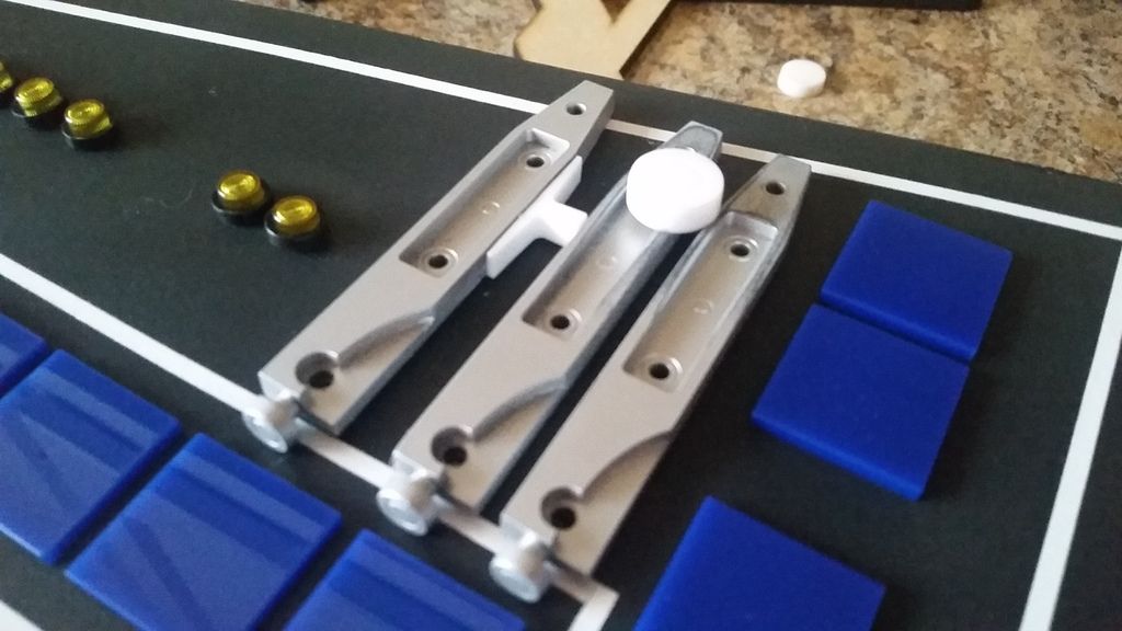

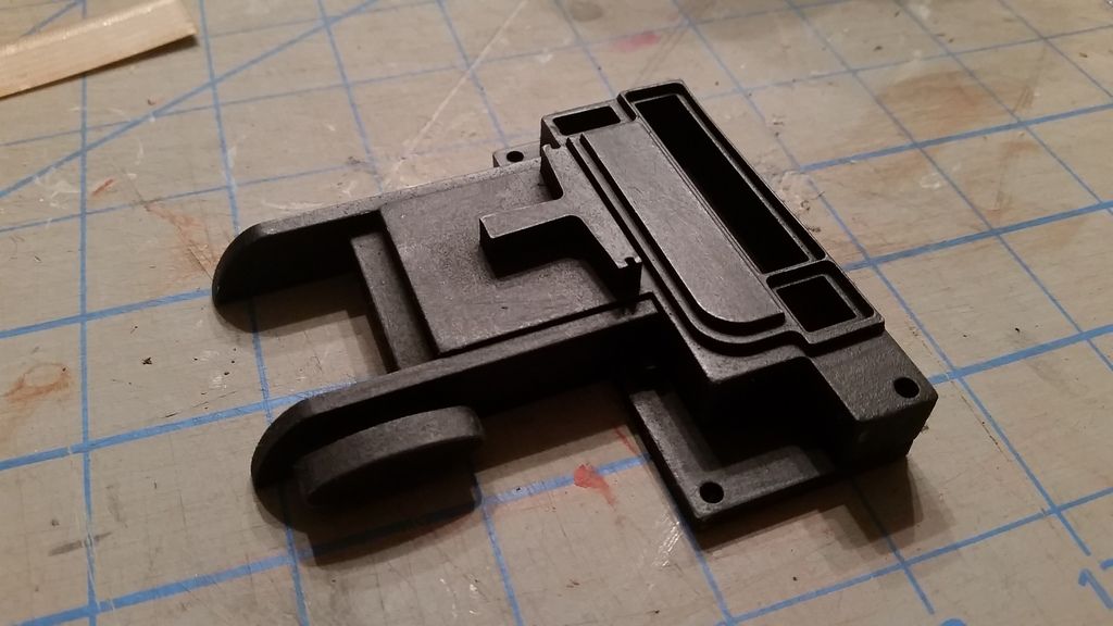

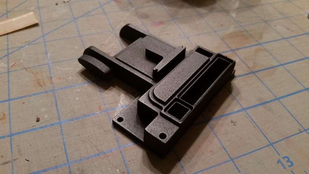

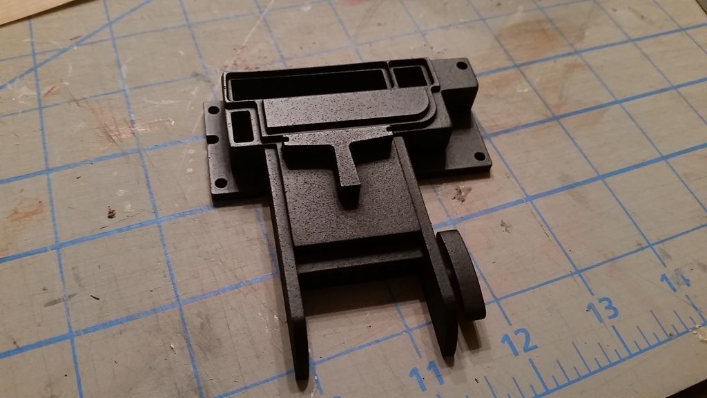

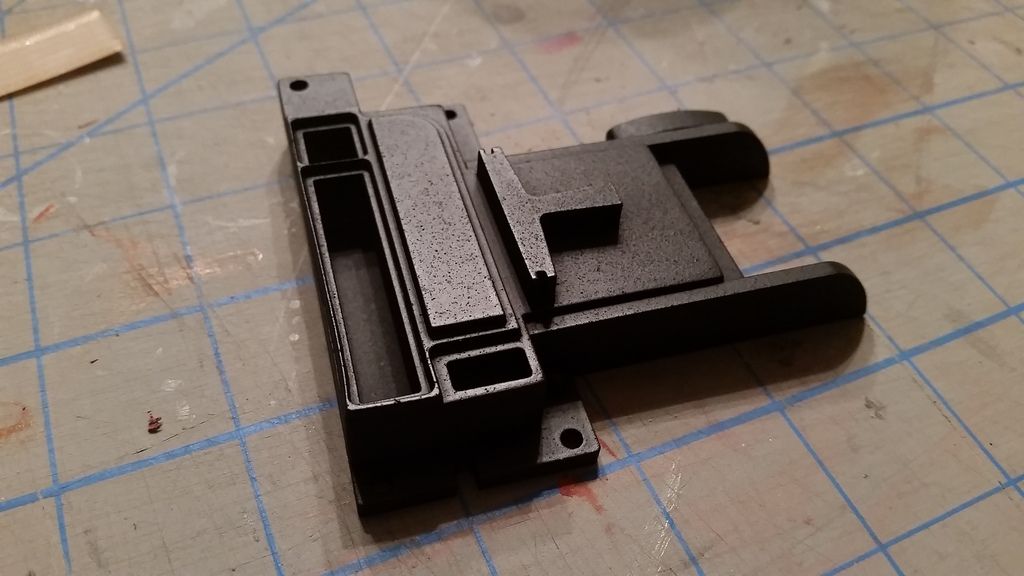

Quick early morning update! Another cockpit greeblie finished up and ready to mount!

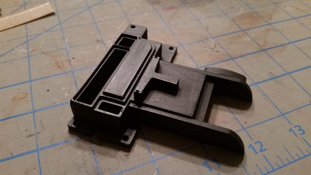

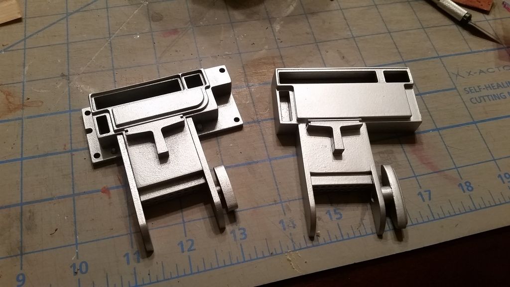

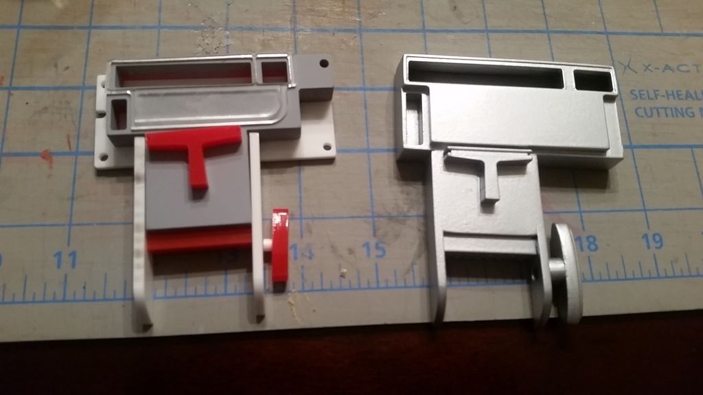

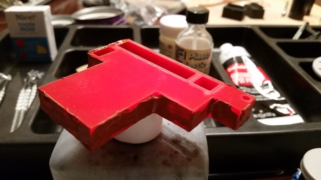

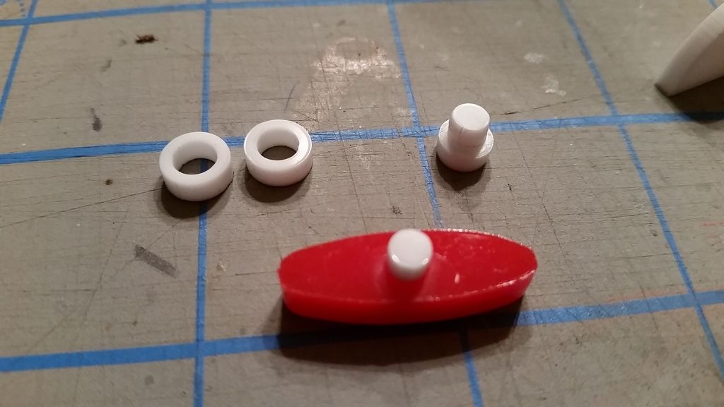

New vs Old - not much of a difference but I had to redesign so I could use the existing mounting holes (the right didn't have any holes)
Let's put this thing together and get it finished!
Primed and painted
After a light sanding to take down the high points
Silver!
I don't think I'm going to add any weathering. I'll see how it looks when I mount to the panel
Time to mount!
Stay Tuned for More!

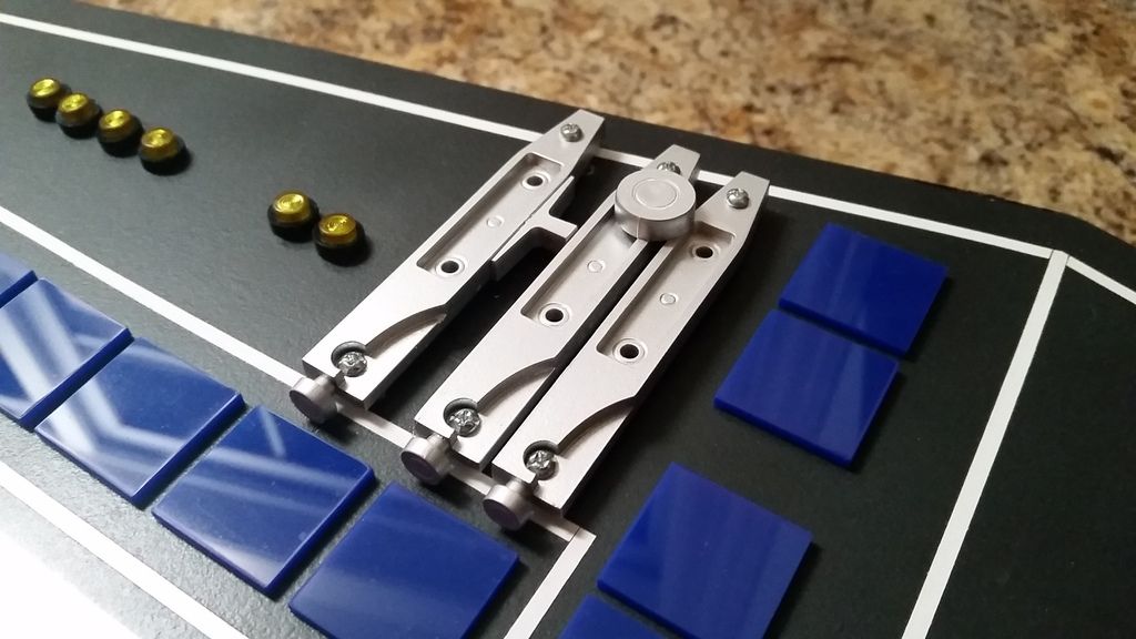

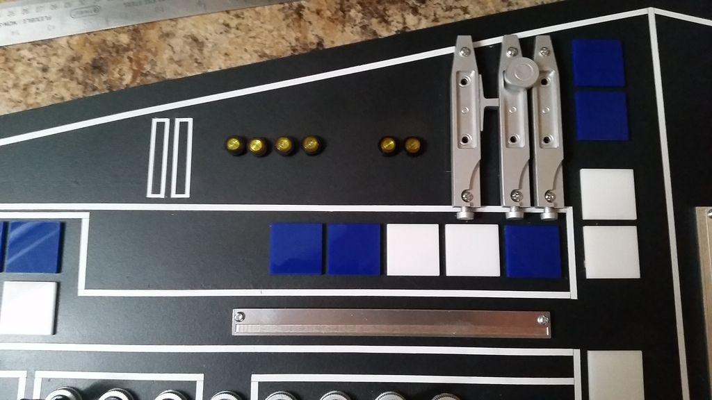

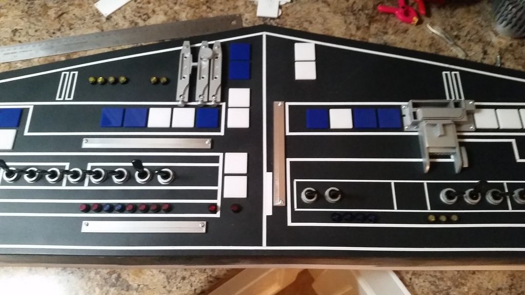

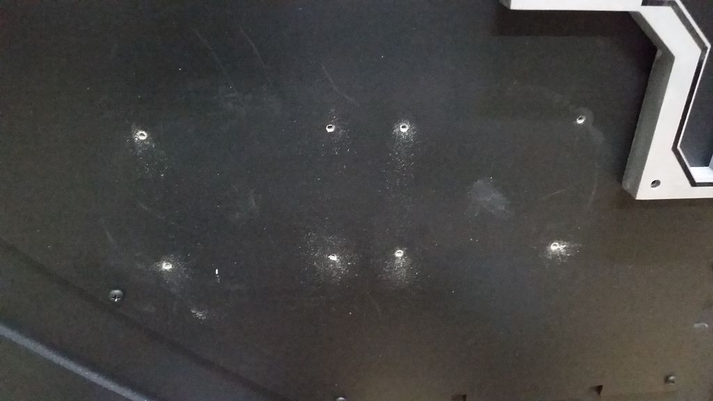

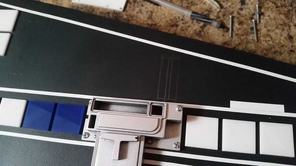

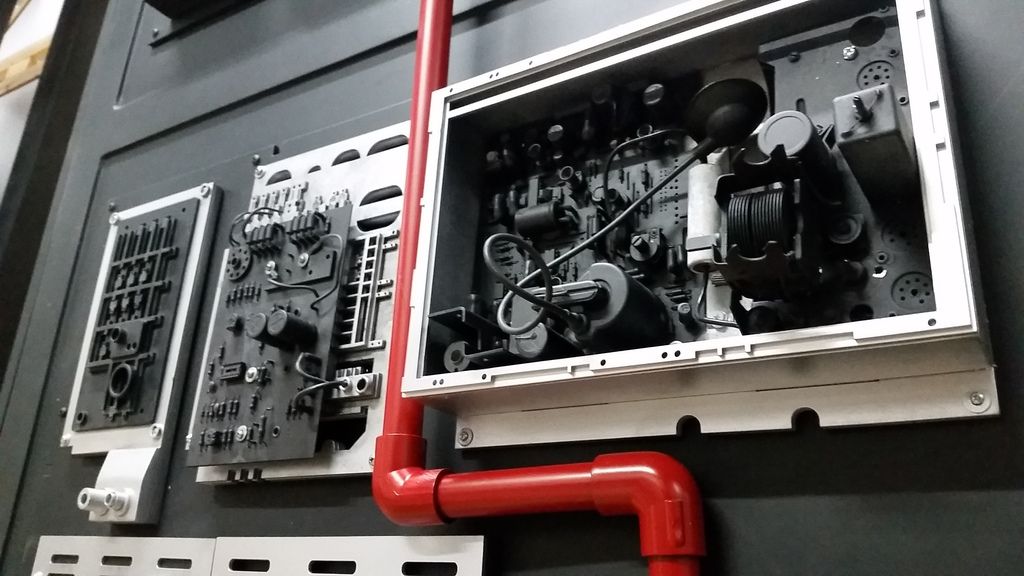

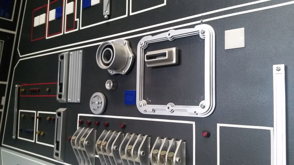

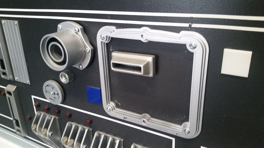

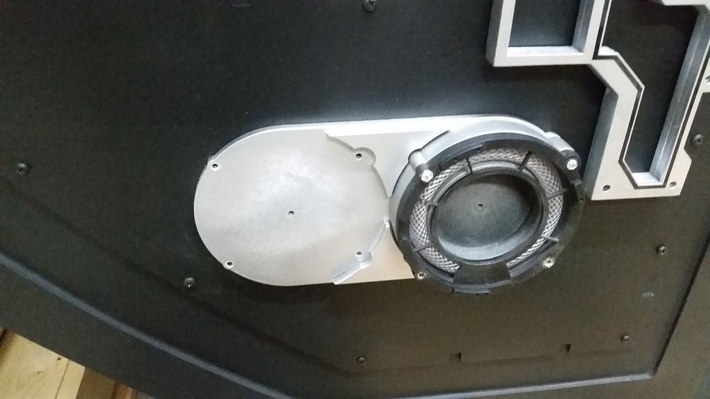

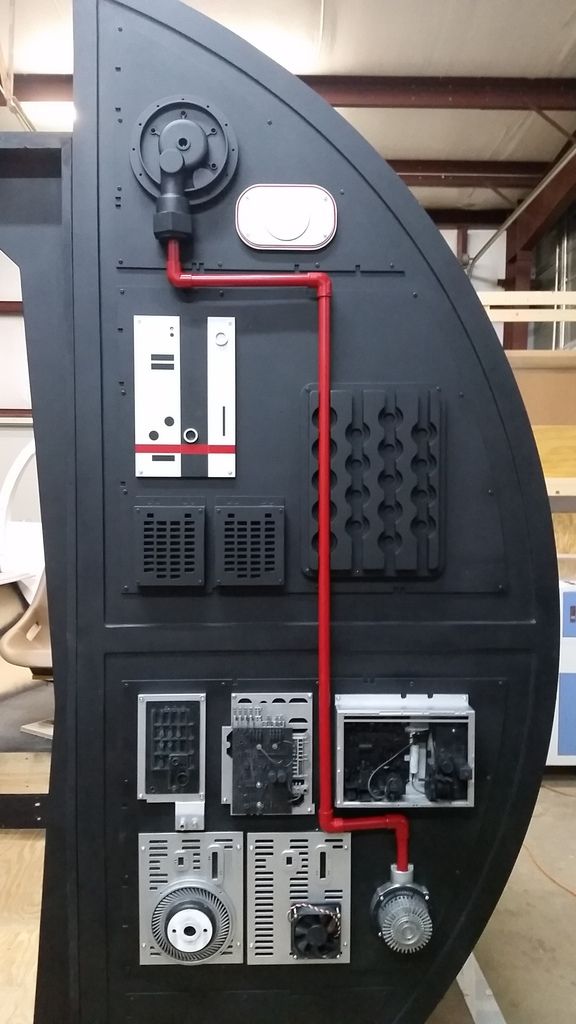

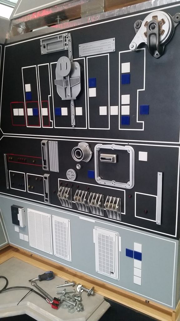

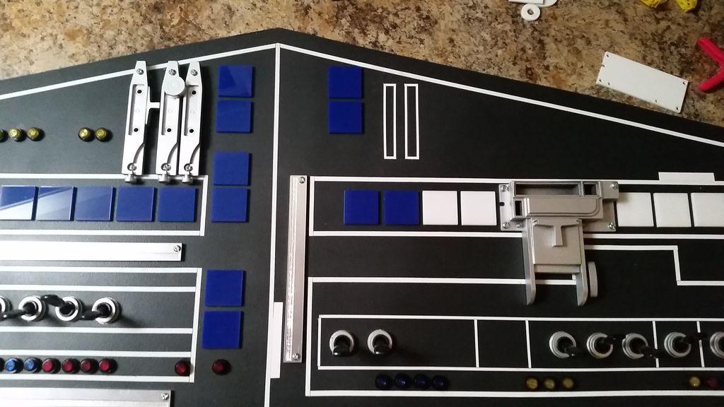

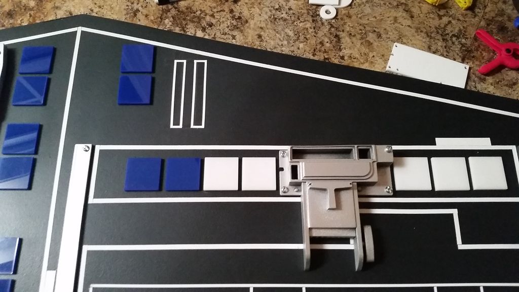

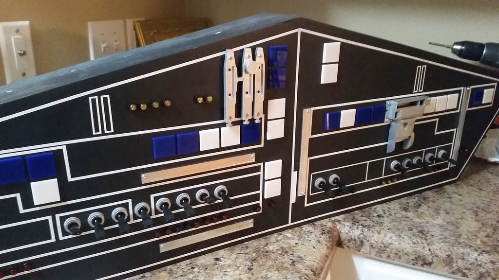

Worked on the capstone panel last night! Mounted the new cassette greeblie

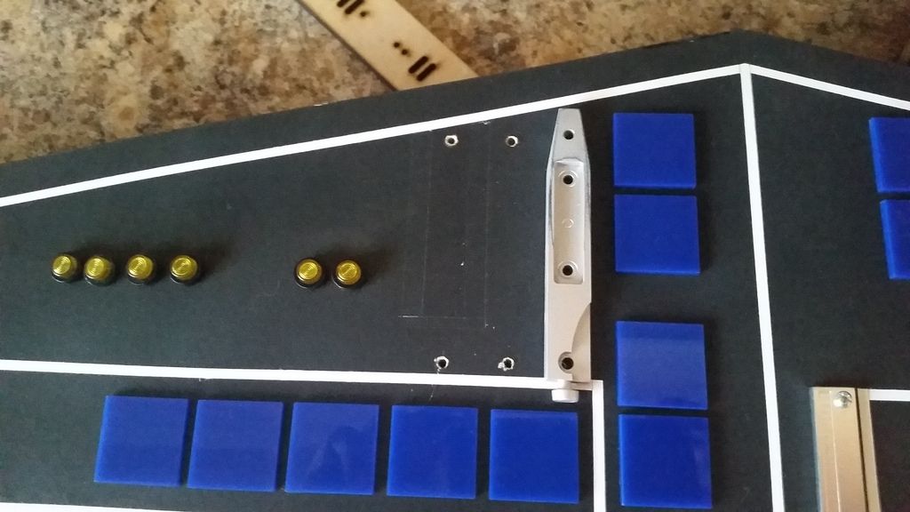

I also worked on getting the "Eye Bolt" cluster finished up. I removed the pin striping underneath and added a few little details to make it more screen accurate
Added details
Painted and mounted

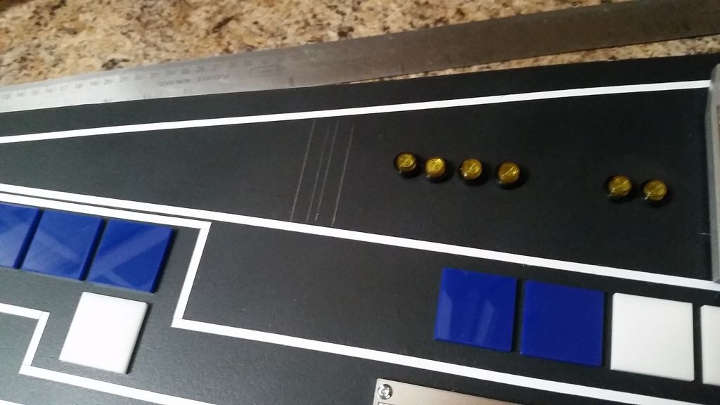

Time to remove and replace many of the blue tiles and misc pin striping - not sure how I got so many wrong?????
New pin stripe placement
One down
The other plus new tiles added
MUCH BETTER! This panel had been bothering me for a LONG time!
Next up... Remove all the switches and design a cover plate
Tonight... Drilling LED holes into an existing panel and a few other surprises! :)

Hi Gang!
Well... Soaking the wood for these last few days has done nothing to help make the pine more flexible. I don't know if I need to leave the pine in the water longer or rip new strips with deeper cuts allowing for more flexibility... I have a few more options. Maybe pressure treated wood? It's already soaked in chemicals and is somewhat flexible?
Does anybody have any ideas?
Also, some personal things came up last night and I was unable to get to the shop. But it's the weekend so lots of time for some forward progress!
EDIT: I think I figured it out! :)
Stay Tuned!
Why not do it same way they make archways make a rack size and shape needed then wrap one thin strip around get then fixed in place then add next one gluing together keep repeating to you get the size needed. To get it so is angled either cut after dry or cut edge of wood to angle and size before fitting together. I know this be bit fiddly and time consuming but when done be neat finish and strong and good thing is technically you can make it as big or as small as needs so could do whole ring in one go if you want simply join multiple sections together as you go round.
Hey LB,
I'm going back to the idea I originally had for the PVC strips. I'm going to cut several strips of 3 ply and screw them together and rip the angle I need, remove the screws then rip the width required. I'll then lay each strip of ply one at a time around the window layering up the strips and recreating the angle I originally cut.
I hope that makes sense? :)
STEAM is the answer you are looking for with wood. On canal boats that have 1ft square oak beams (least I think it's oak) as edge protection, I saw a programme once about one being restored and the put the beam into a steam over for a few hours, then clamped it into place and it curved around the front of the barge and stayed there with fixings etc.
Hey R,
That would have been my preferred choice but I don't have a steamer. That's why I used water hoping to get the "same" affect. I think I've once again over thought the process...
But I think I've figured it out using the layered up ply. I'll be sure to take detailed images of the process. :)
I'm afraid nothing less than steam will help you.The idea is to loosen the lignin fibres relative to each other, allowing them to slide and set in new places when it cools. For that it needs to be above the boiling point. Hot water simply isn't hot enough, you would need at least a pressure cooker, and likely hooter than that.
