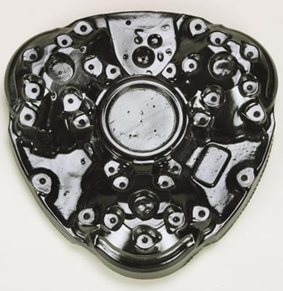

I'm hoping that the search might also turn up the part (or parts) that make up this piece.

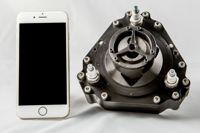

That looks like some kind of plate from a Wankel-style rotary engine. This is obviously new, but:

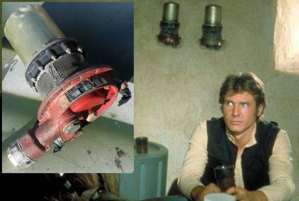

Well... it could be FROM anything, but it can't BE anything... it's not a paper plate... or a pie tin... or a bag of feathers..
It has a rimmed backplate that can be bolted onto a solid surface.
It has a lid that fastens with a central screw/shaft
With the lid open, it shows a snail-shell-like trough centred around the shaft, opening to the major outlet/inlet
It has one other major outlet/inlet, entering through the top of the lid rather than through the sides.
It has a smaller opening (to the top the way Sofaking has mounted it).
My guess is this is a pump. I think some sort of impeller have been spinning around the central axis, pumping fuel out the larger outlet (the one Sofaking has fastened the hoses on his version). One of the two remaining apertures must be an inlet, the other an opening for an electric wire. My guess is the one entering through top of the lid is the electric wire.

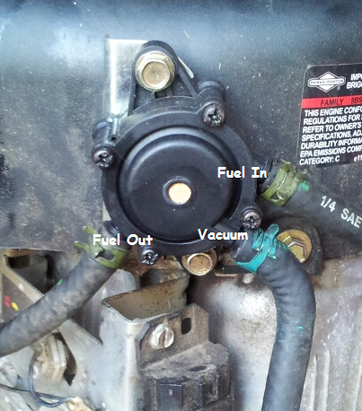

Just to illustrate where my head is, this is a good, simple view of a vacuum pump, and I should clarify that this vacuum pump is "a pump driven by a vacuum" vs. the thing with the exact same name that creates a vacuum.:
And from Wavey's post t'other day:
I think based on the view on the right, that's the input on the lower left, the output on the upper right, and the vacuum on the upper left. The different sizes of the hoses means they're changing the velocity and pressure of the fluid. Anyway... I say all that just in the hopes ANY of that can jog someone's brain in the correct direction.
Excellent reasonings gentlemen.
'SPE Fuel Booster Pumps'. There's dozens of types and possibly a half dozen variations per type, so that's where the homework is at. Going by the amount of other set dressings in ANH and ESB that can be related to a single aircraft (though some parts are interchangable to some degree with other aircraft or display engines) the silver pump prop maybe from a Canberra's fuel system, feeding the Avon engine at start-up/take-off/landing, etc, but I don't have a part number for that one. The pump could also be used in other aircraft, such as Concorde - there's a lot to learn here lol.
