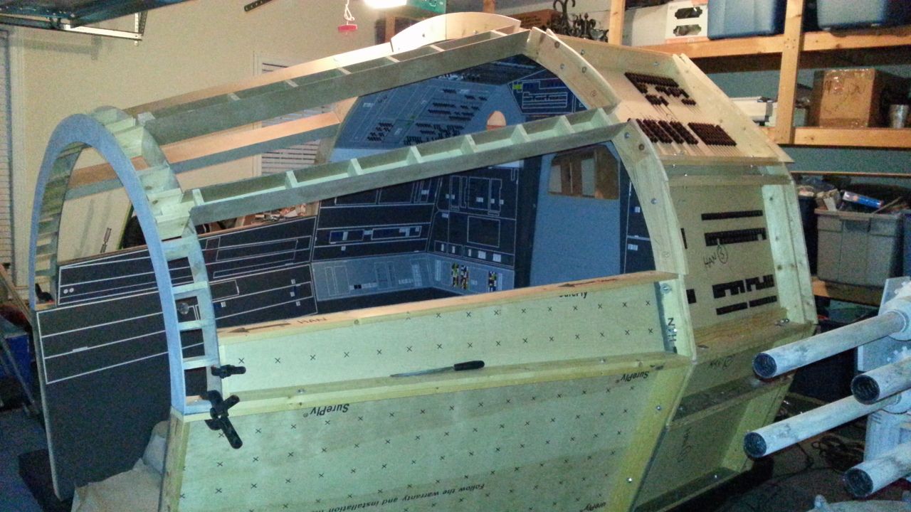

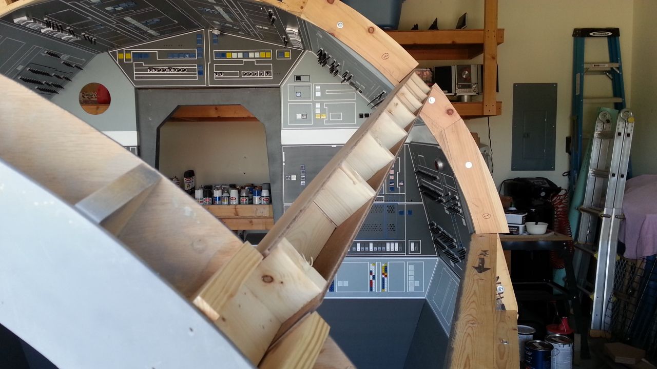

Closer and closer...
Unfortunately, I won't be able to get to the bulk of the canopy. I want to at least have the 4 beams in place before the show...

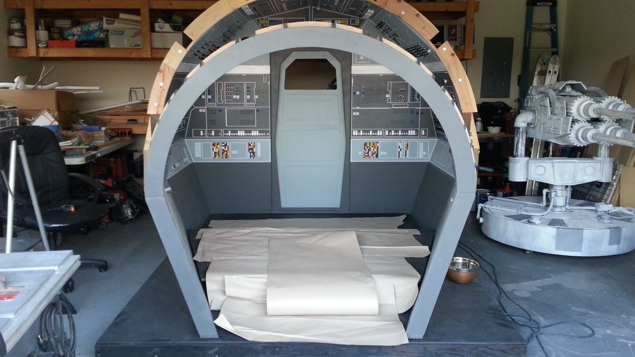

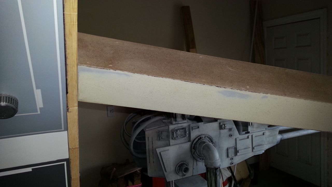

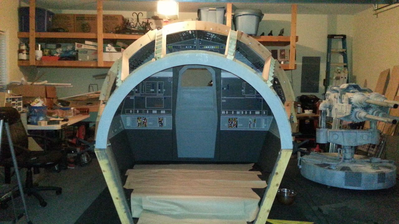

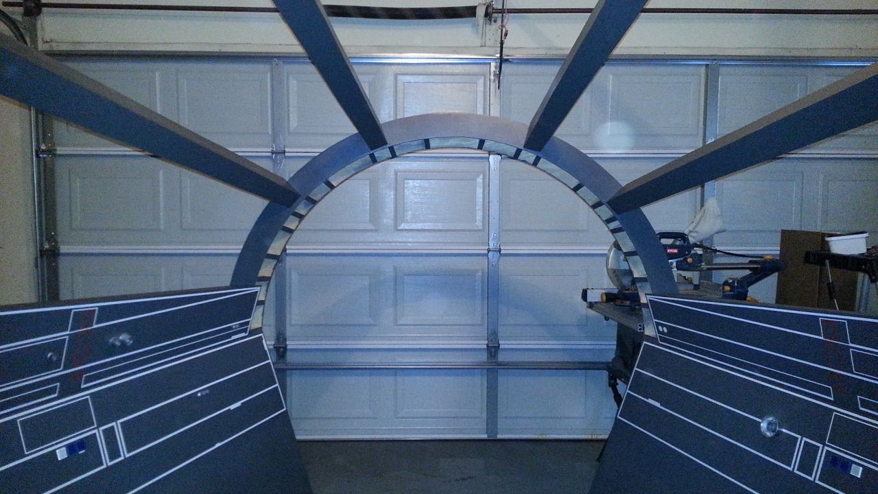

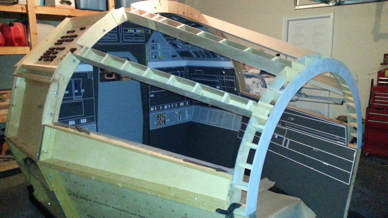

Hi Gang,
I am sprinting toward the finish...

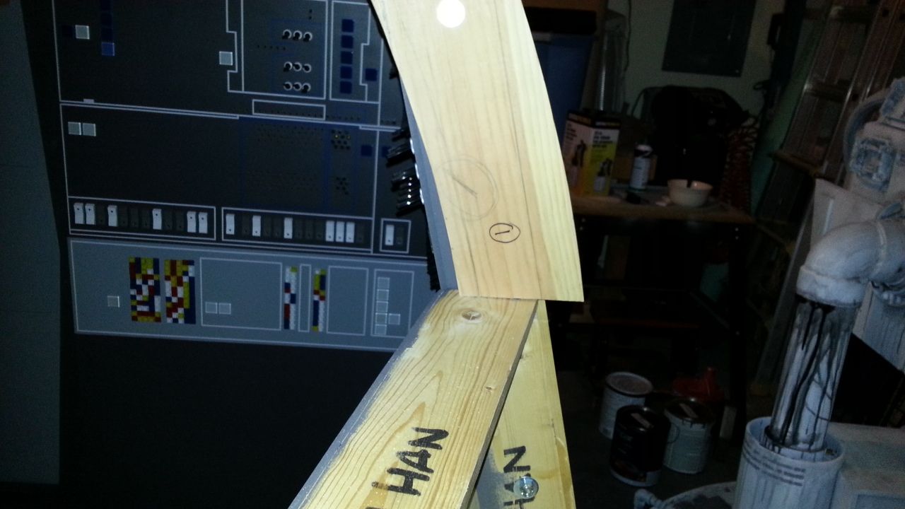

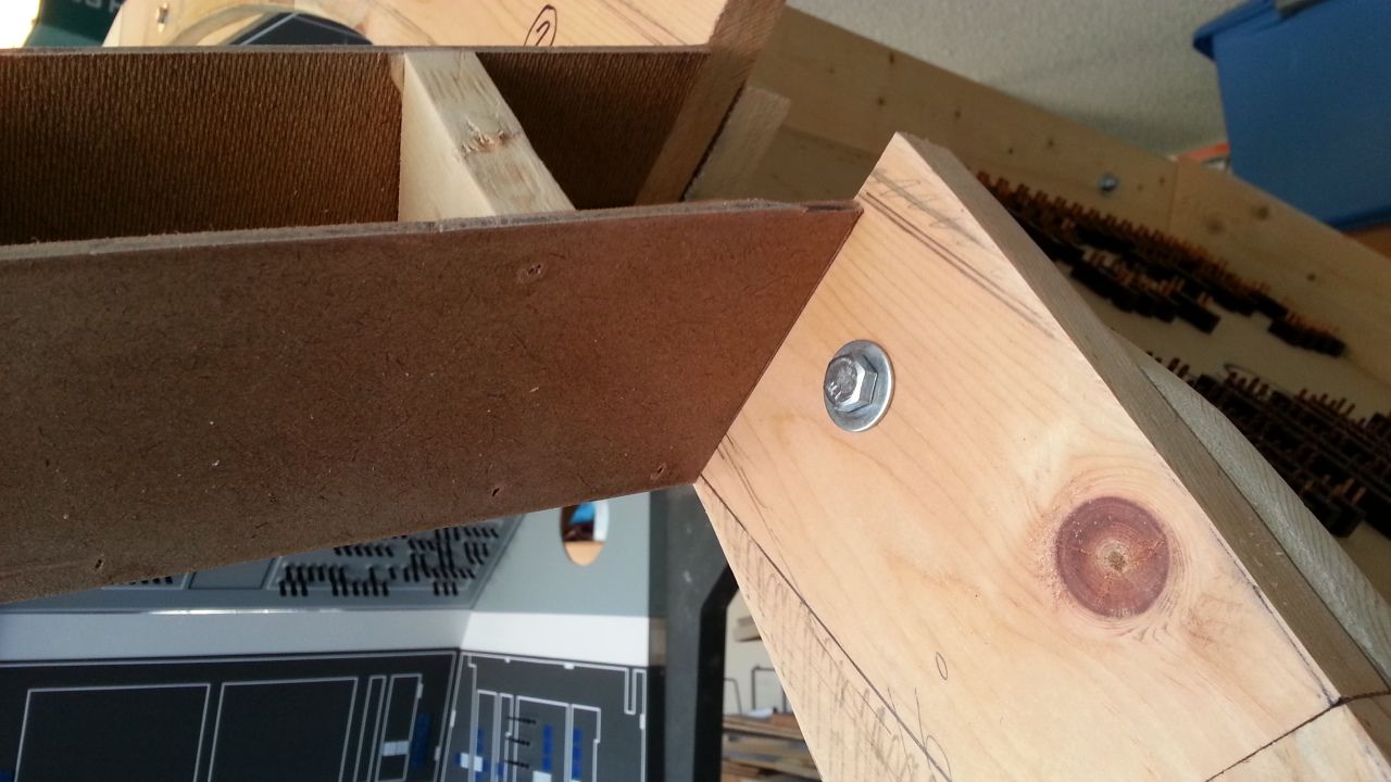

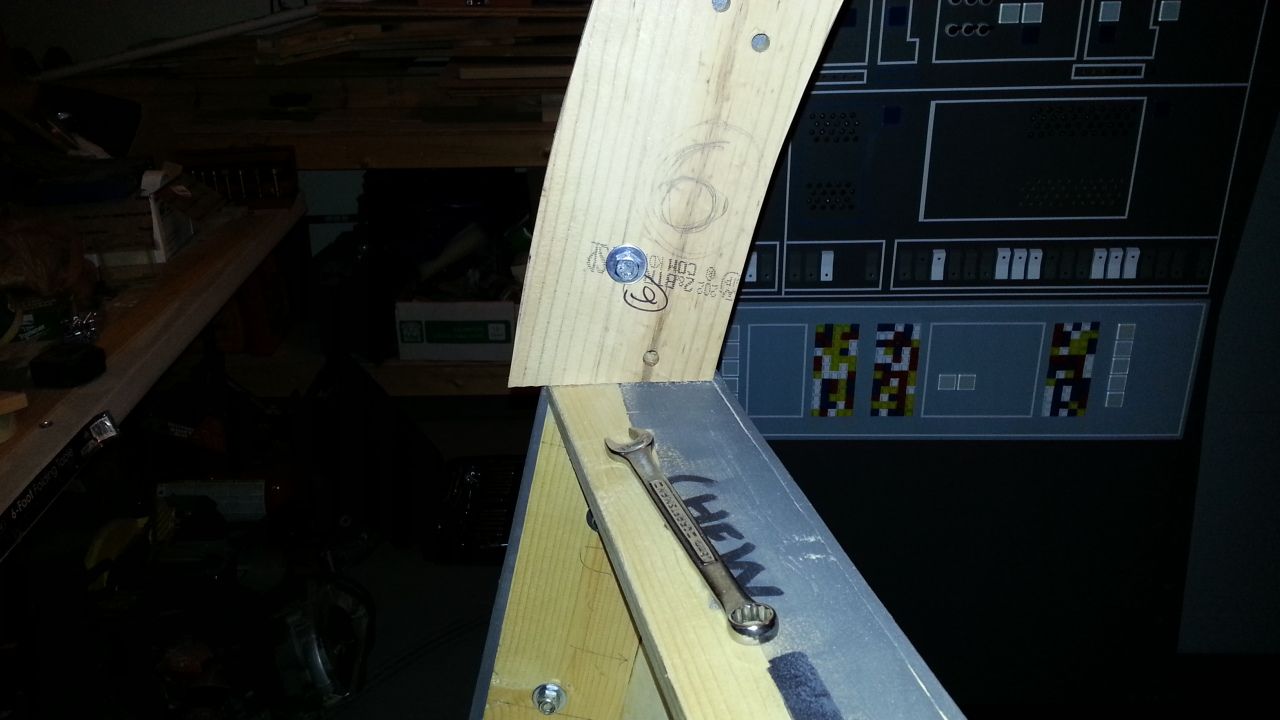

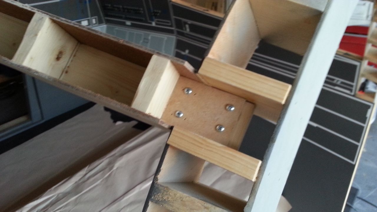

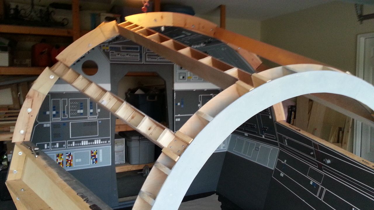

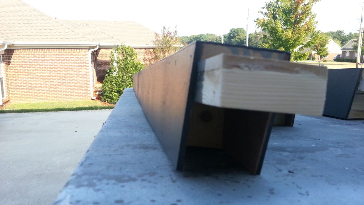

I created the spacer for the beams so they are slightly elevated from the window arch
Front

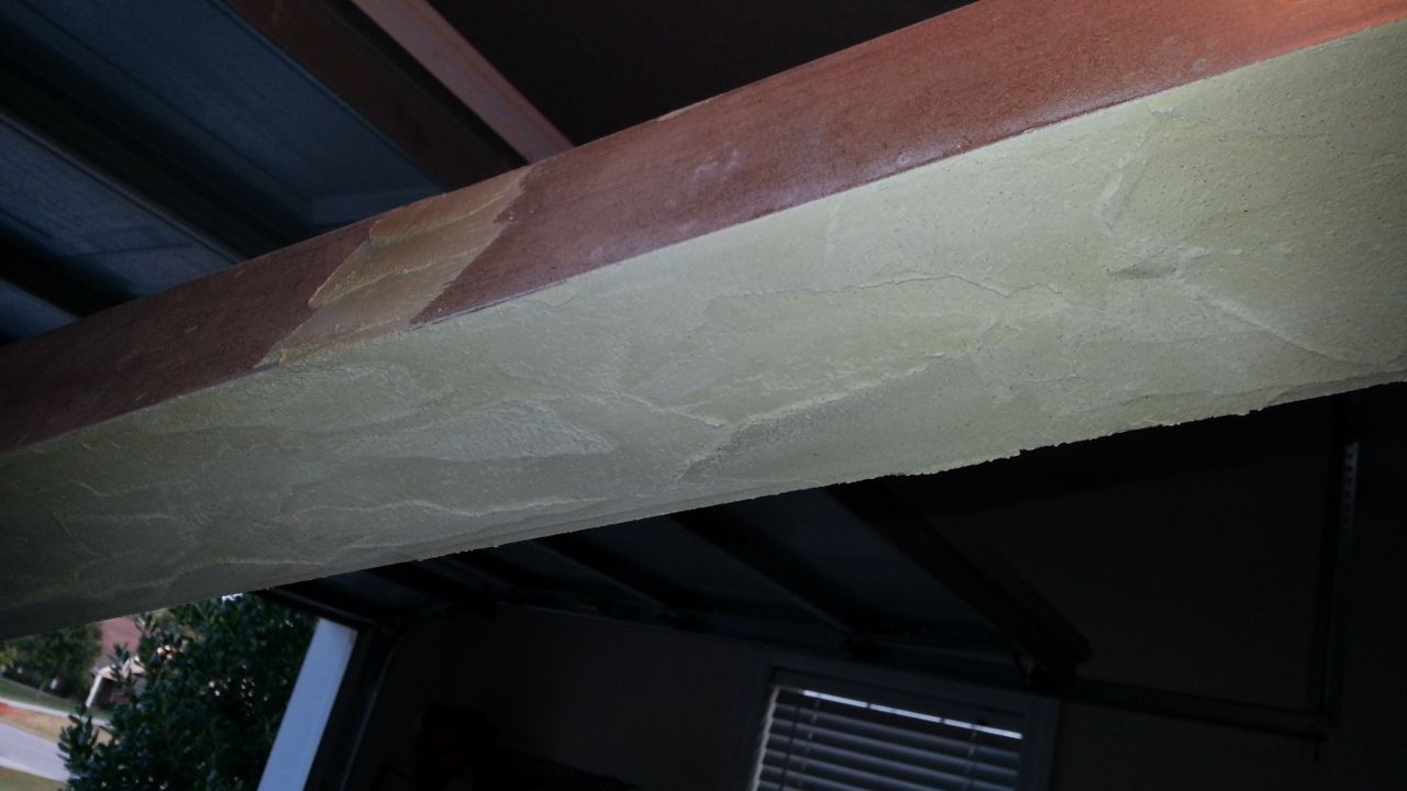

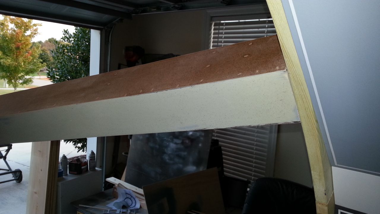

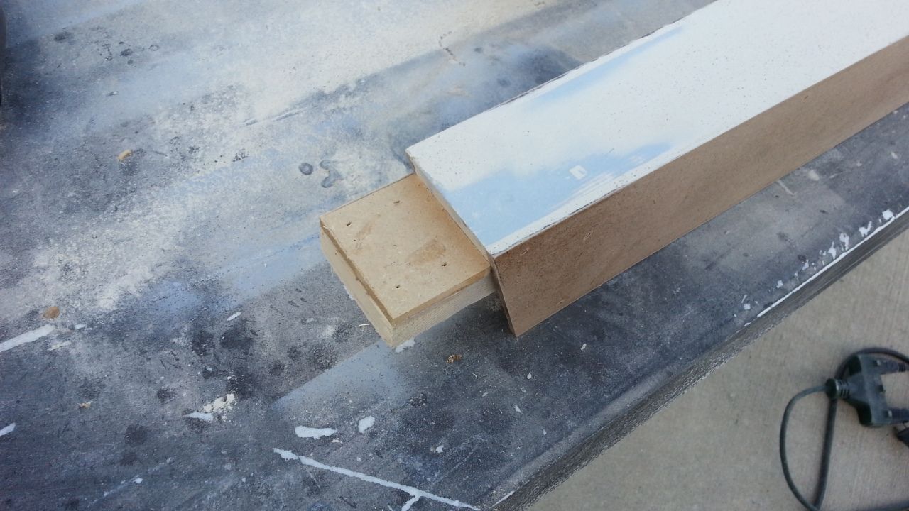

Had a slight misstep... I pressed a little hard when nailing the braids and the wood split - my fault - I didn't work with the grain
After applying filler to all four beams I was only able to sand 3 - the 4th hadn't dried yet
Nice and smooth - I still need to add some filler to the sides to take care of all the braid holes
You can see all the holes that need filling

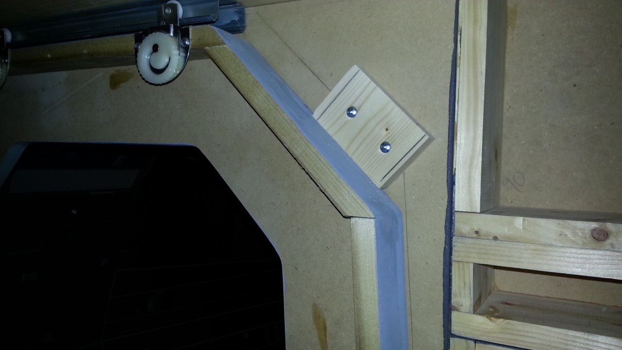

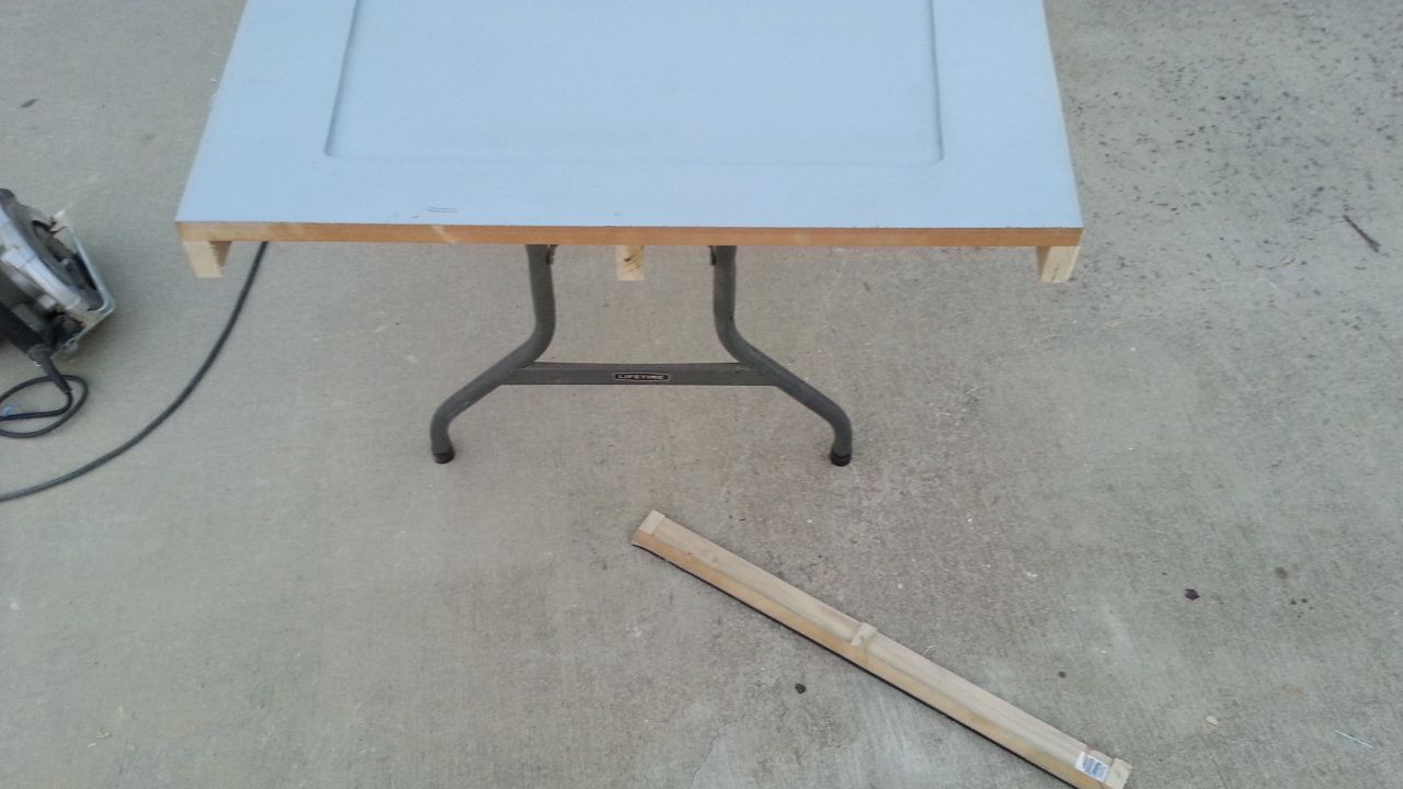

I then removed 1/2" from the bottom of the door to reflect to mod I did on the door frame
Away with you!

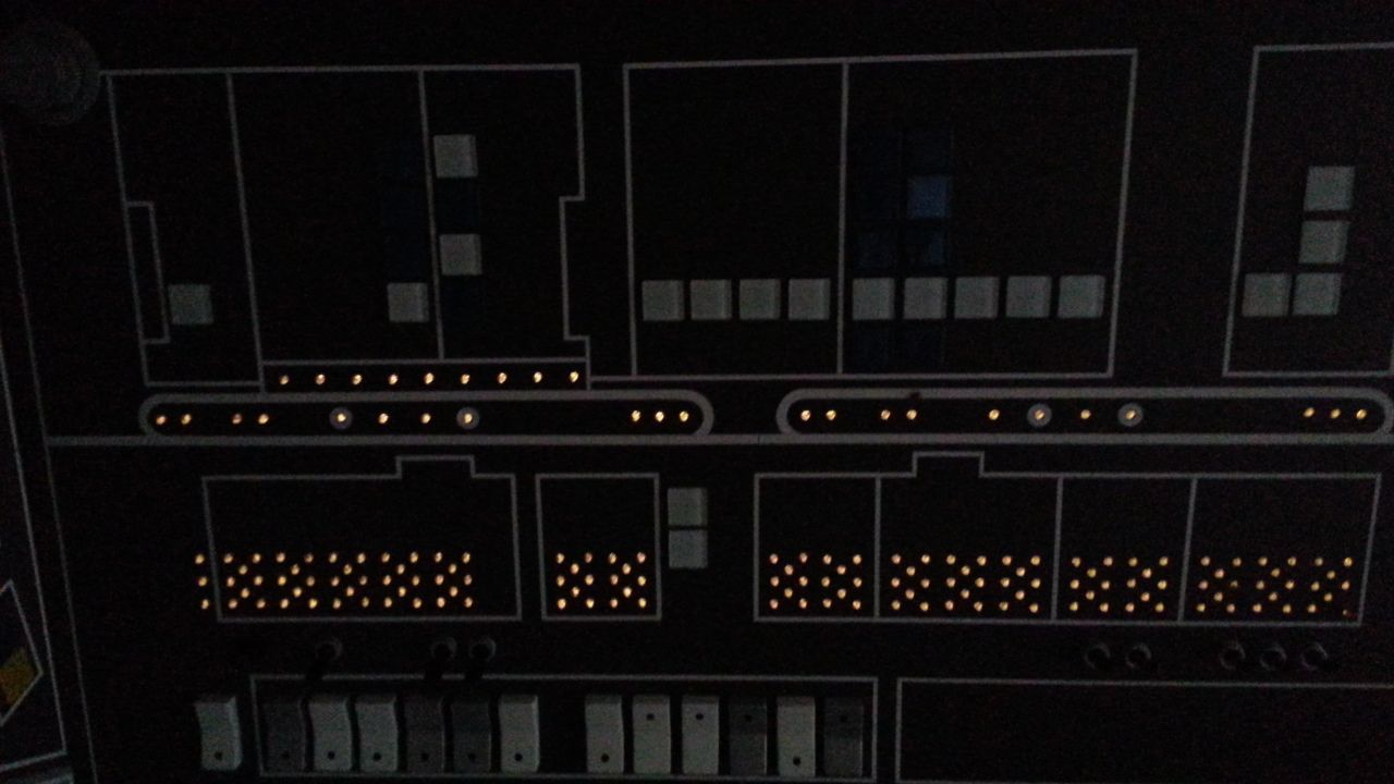

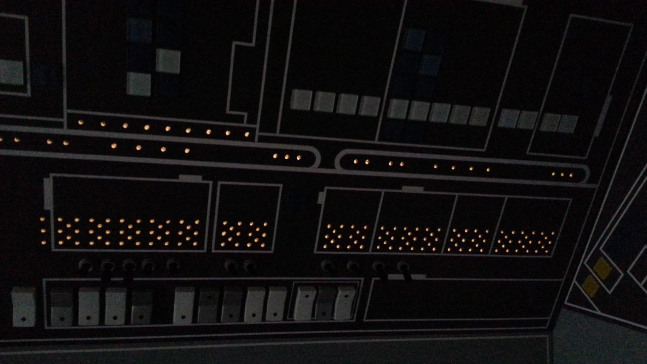

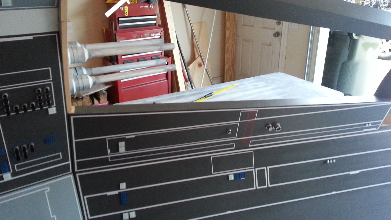

I thought this was cool - the garage light shining through all the empty LED holes
Door Stopper - simple yet effective

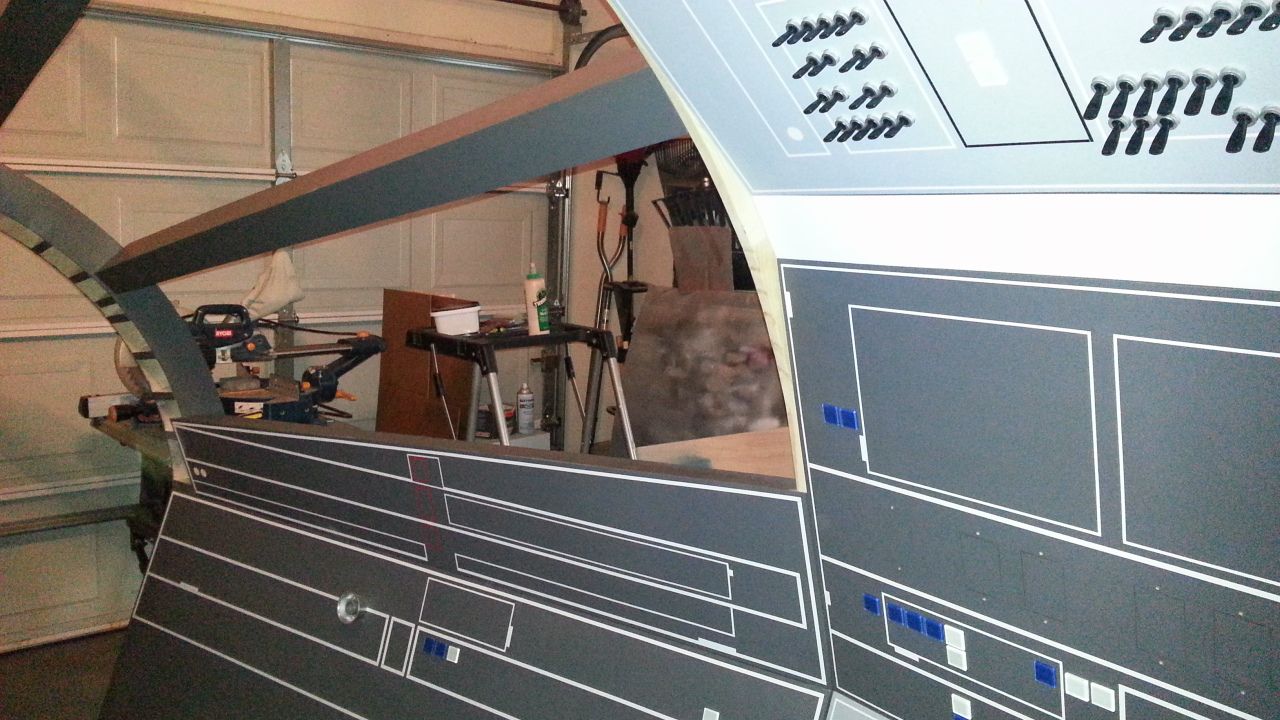

Overview
This thing is MASSIVE! I really need to do the Coke Can size compare
Sorry for the bad pics - it was getting dark

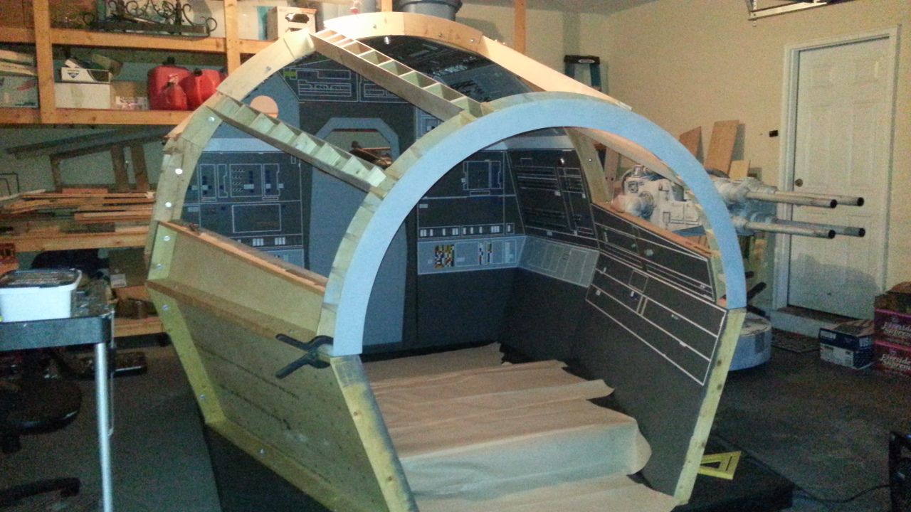

Had to show her some love

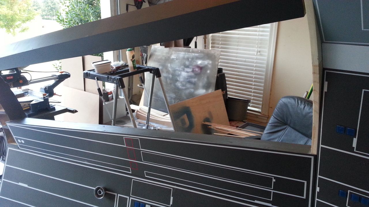

The arch on Chewie's side - lined up perfect

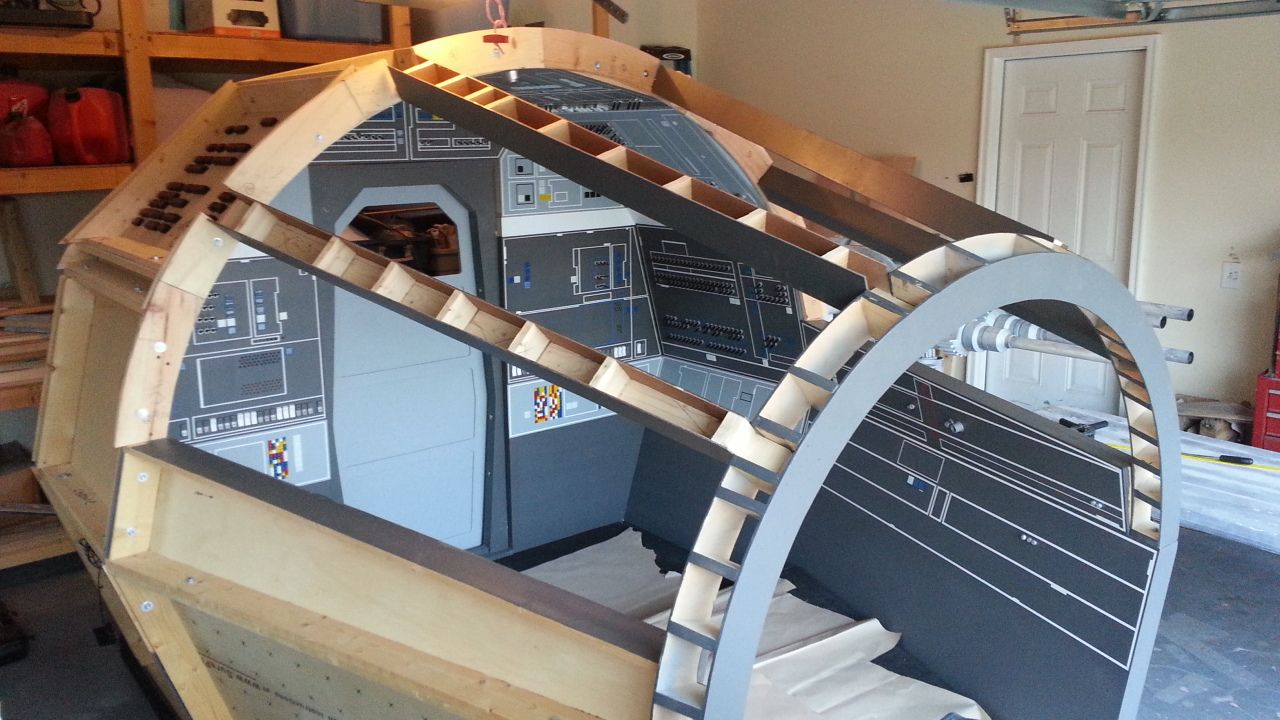

Need to do a little rework on this piece
There she is... ewe... gotta fix those sagging barrels...

Small update on the electronics.
I was able to get most of the slider door lights finished. I just need to go to the local sign shop and get some smoke plexiglass and build the housing. My light flash program I use for the carbonite panel will need to be modified a bit, to be a more accurate flash pattern. Hope to ship it off the SK soon.
I also did a mock up test panel for the radar scope. This is the ANH version. I used two clear plexiglass panels etched the graphics on them using a bead blaster and edge lit them with green and red LED's. Not terribly accurate but, I was just testing the effect. It turned out fairly well. I think the panel glows red a bit to much but on the full scale version the panels will be wider and the LED's will be further away from the center. Looks promising anyway.

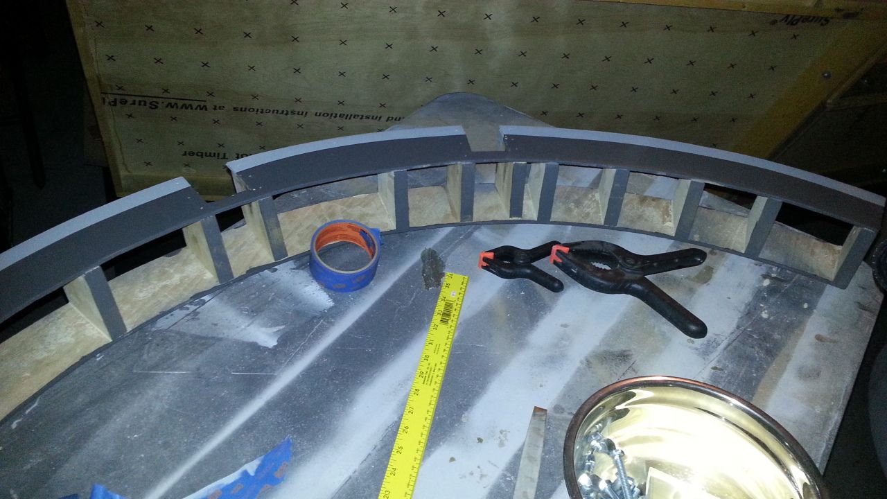

Hi Gang,
I have a question: Does anybody know the mathematical equation or "process" it takes to correctly measure and cut the material so I can "skin" both the "top" and "bottom" of the window arch? If it were a simple arch there would be no issue but since there is a beveled edge - I just don't know how to properly cut/align/measure...

1:1 Millennium Falcon Console Replica
Looking great! I'm no math expert either, but I think the simplest solution to skinning the beveled edge would be to make a template out of poster board or even Christmas wrapping paper.
Count on making two halves.
Start in the middle and let the paper follow the contour.
Staple it LIGHTLY every few inches.
Once it is covered, go back from underneath and use a sharp blade to trim the edge.
The end result "should" be a nice curved template.
Make sense??

I'm knocking myself in the head... That makes all the sense in the world! THANK YOU! I have some scrap foam core and a roll of painters paper lying around - I can use that! Thank You!

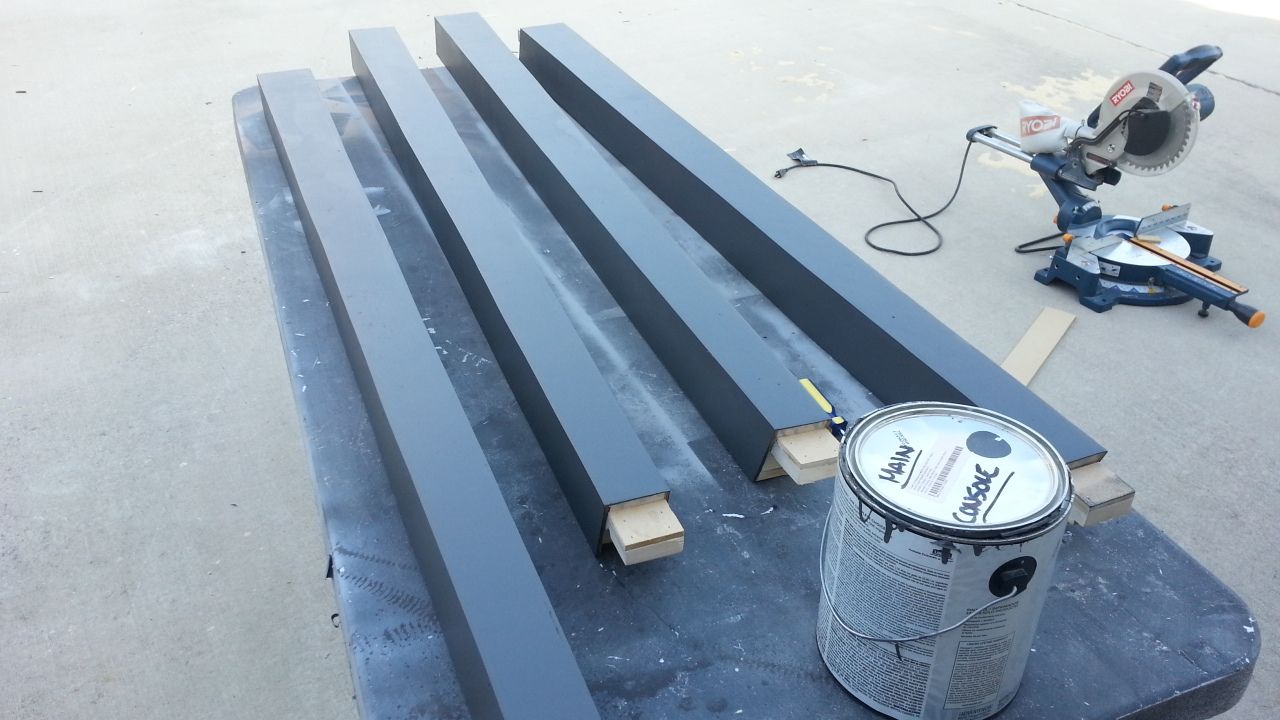

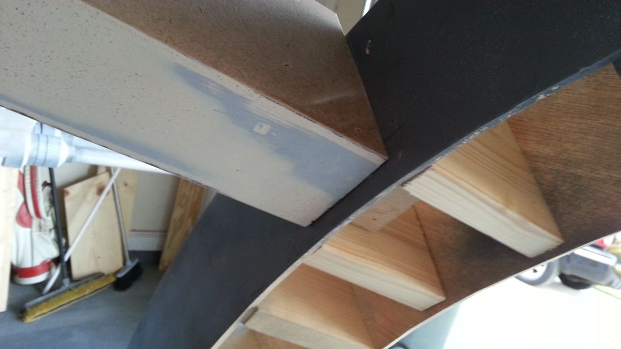

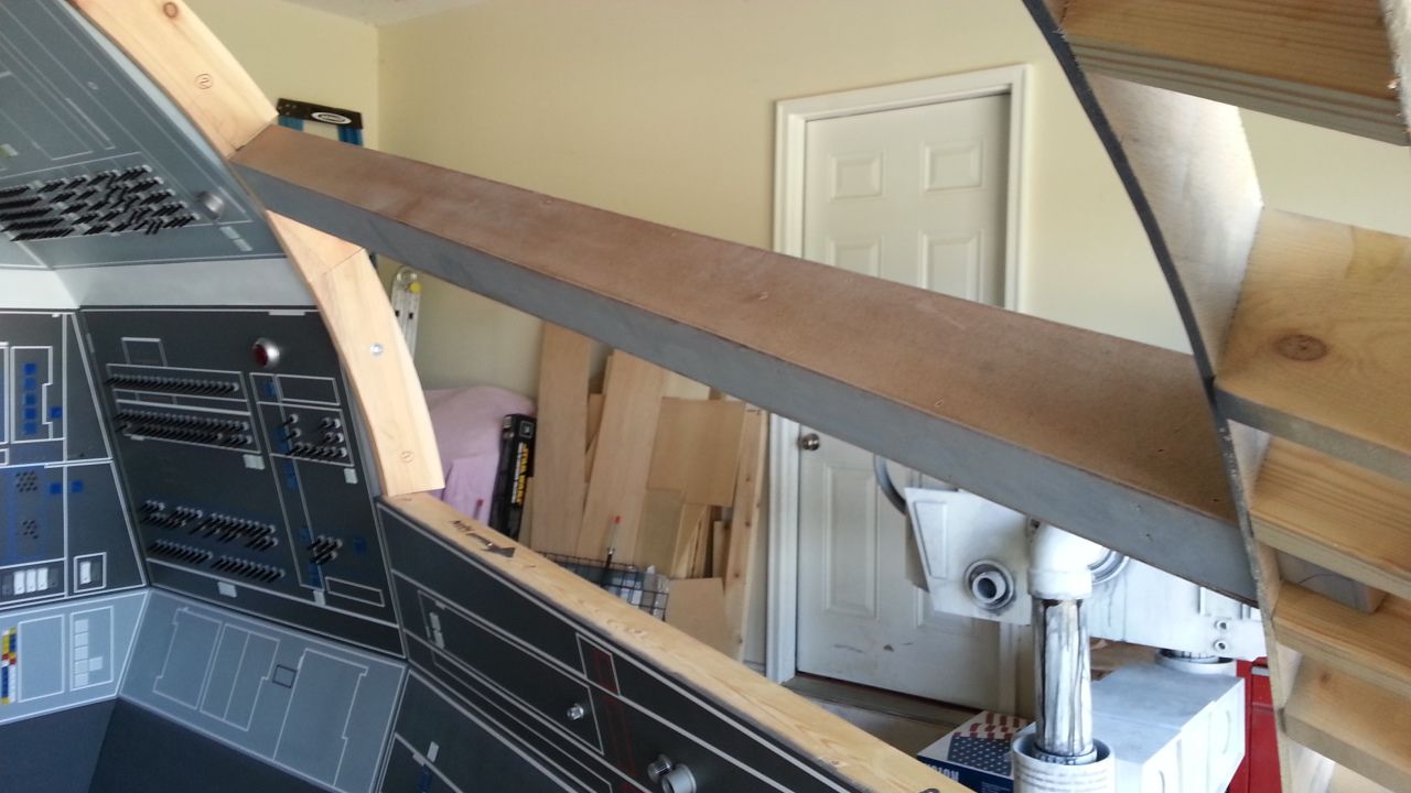

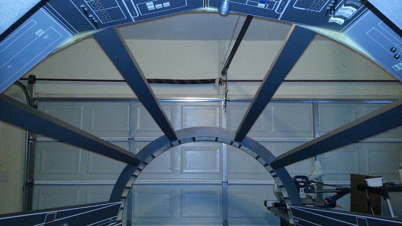

Hi Gang,

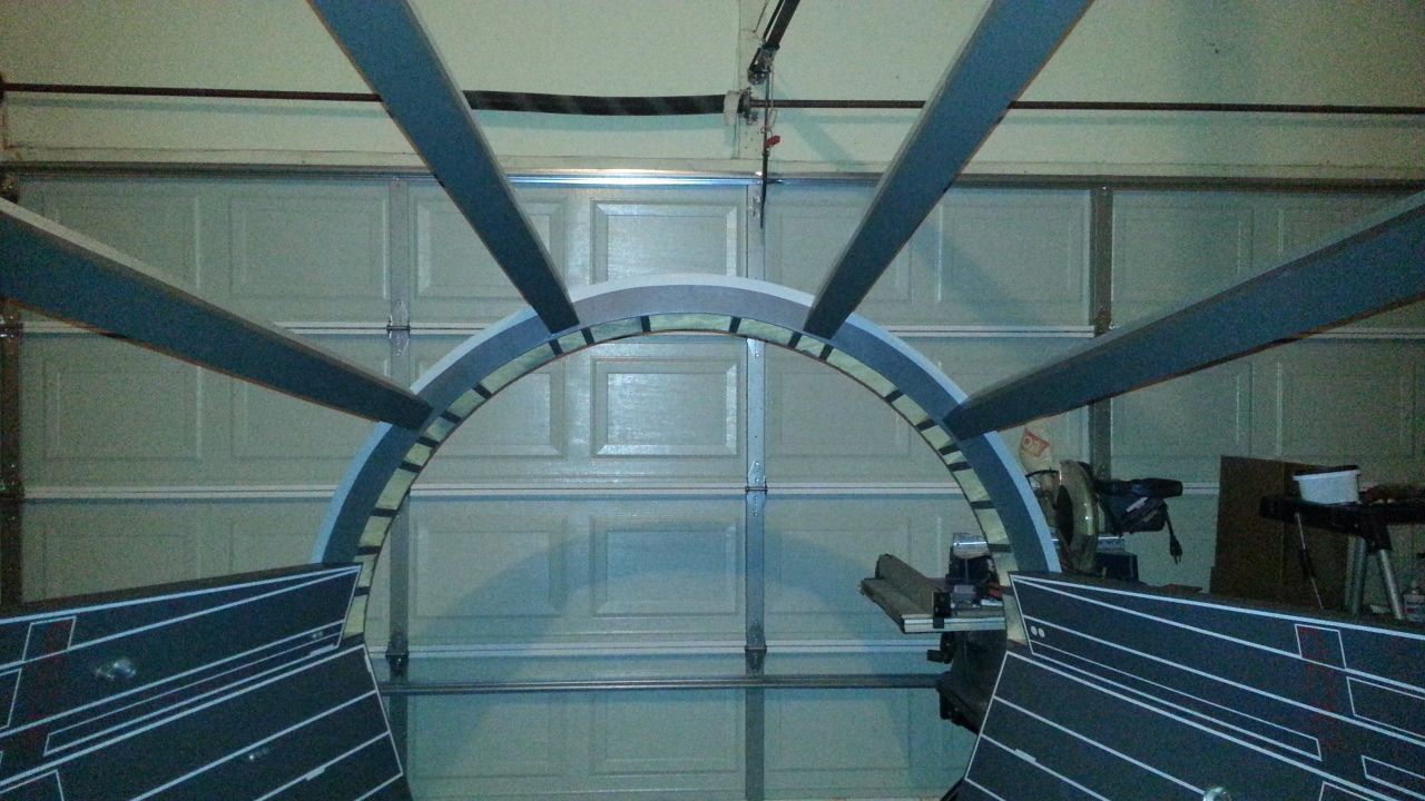

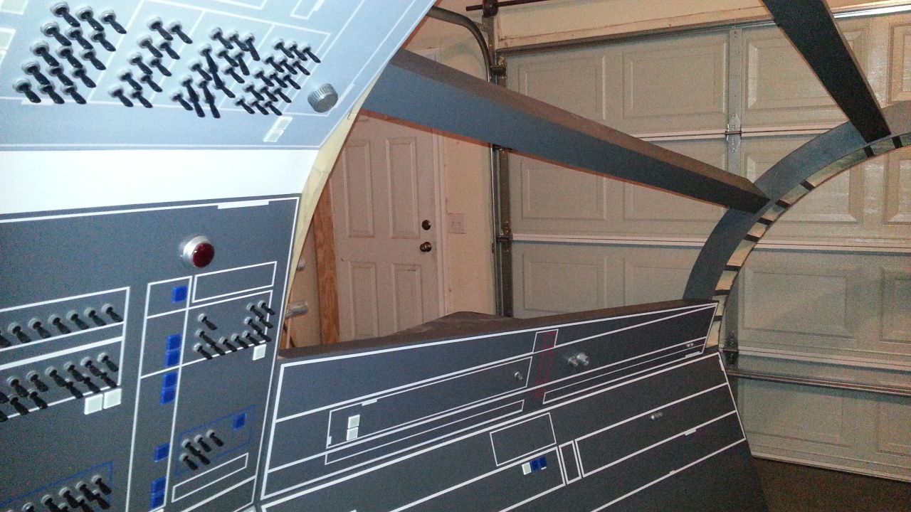

Well... I painted a lot of the cockpit edges to include the beams. When that dries I'm going to add the lighter color - probably tomorrow.
Beams painted
Don't you just love it when things warp? UGH
I sanded down the window arch, trimmed a lot of the excess inner supports and then painted to match
I'm going to try to paint the rear arch and panel edges tomorrow
Through the door
Amazing what a little paint does
More Tomorrow...

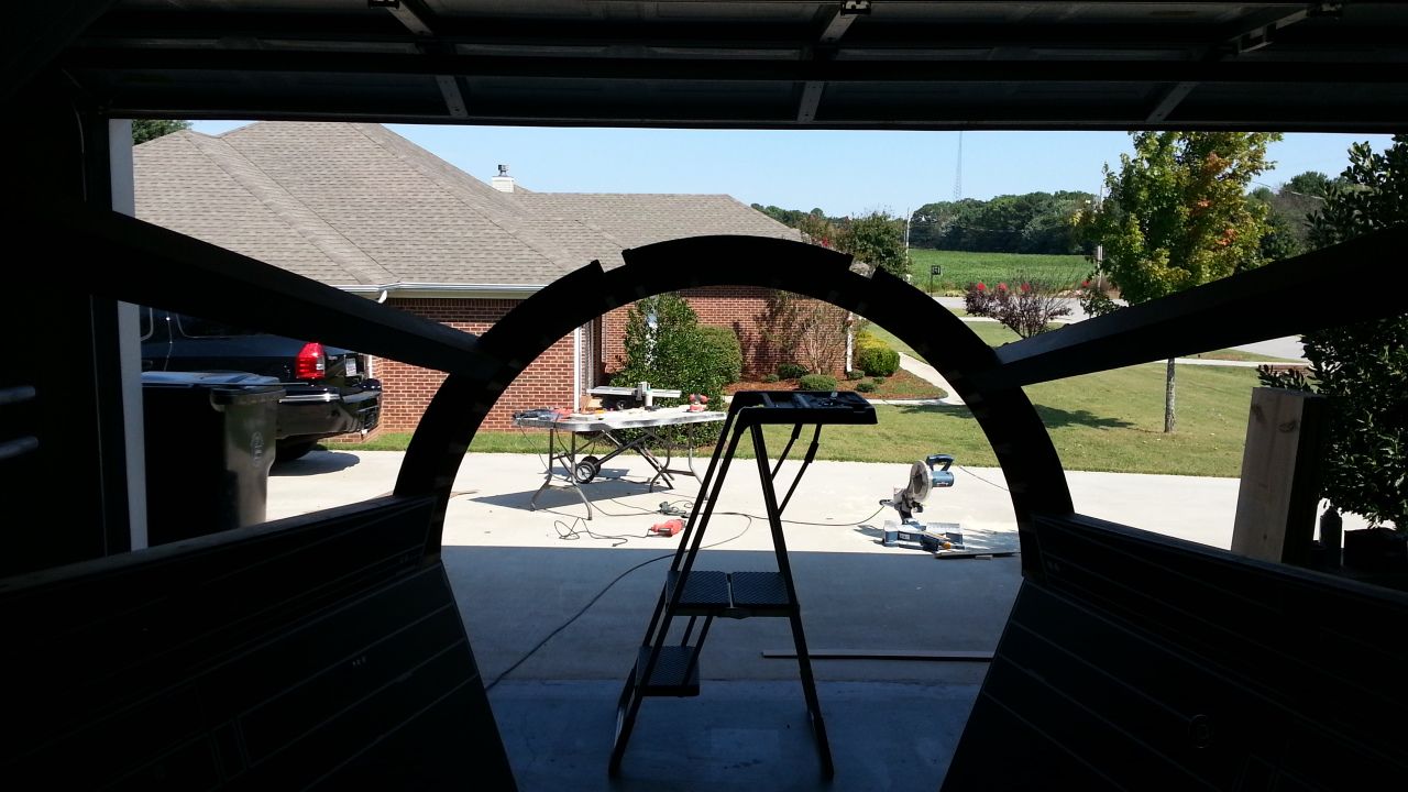

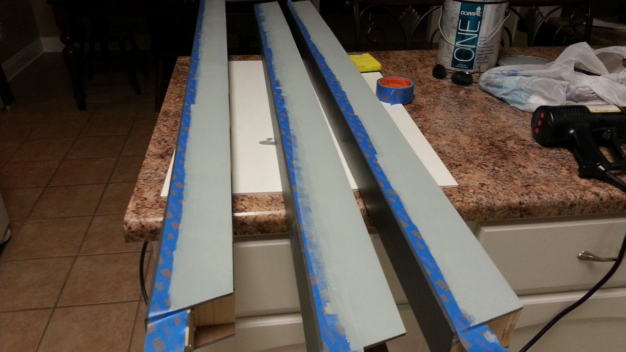

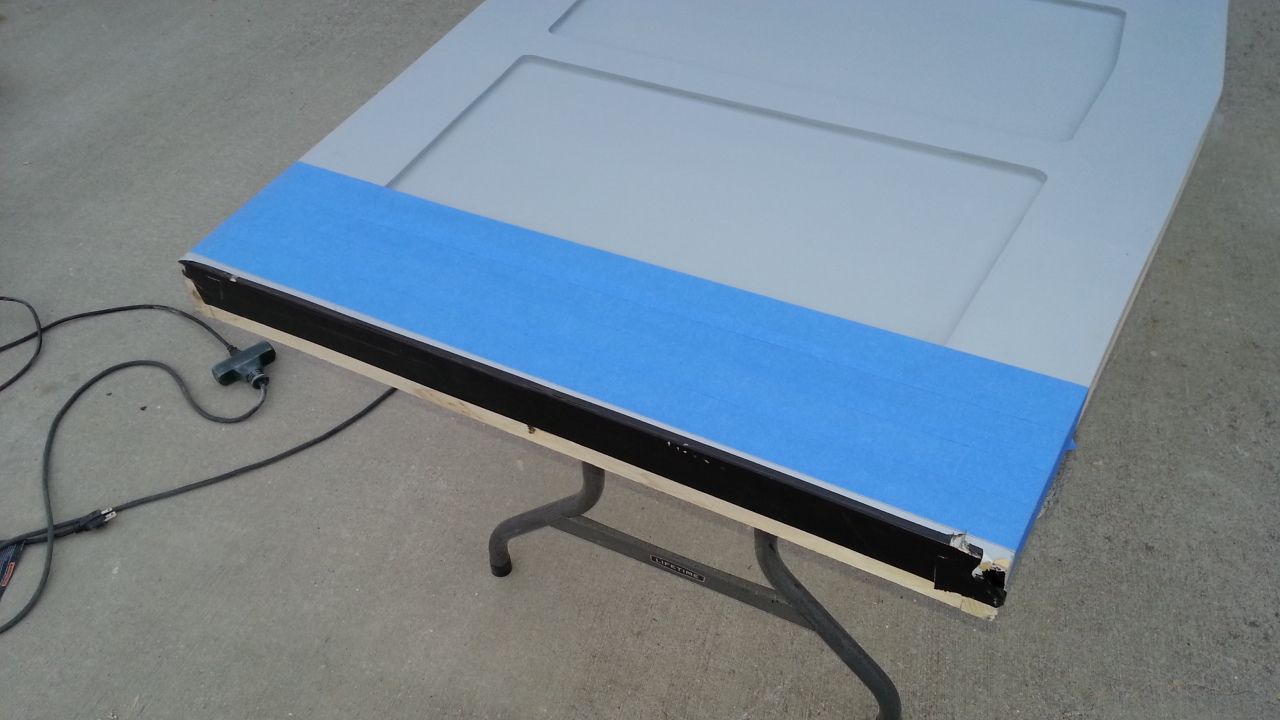

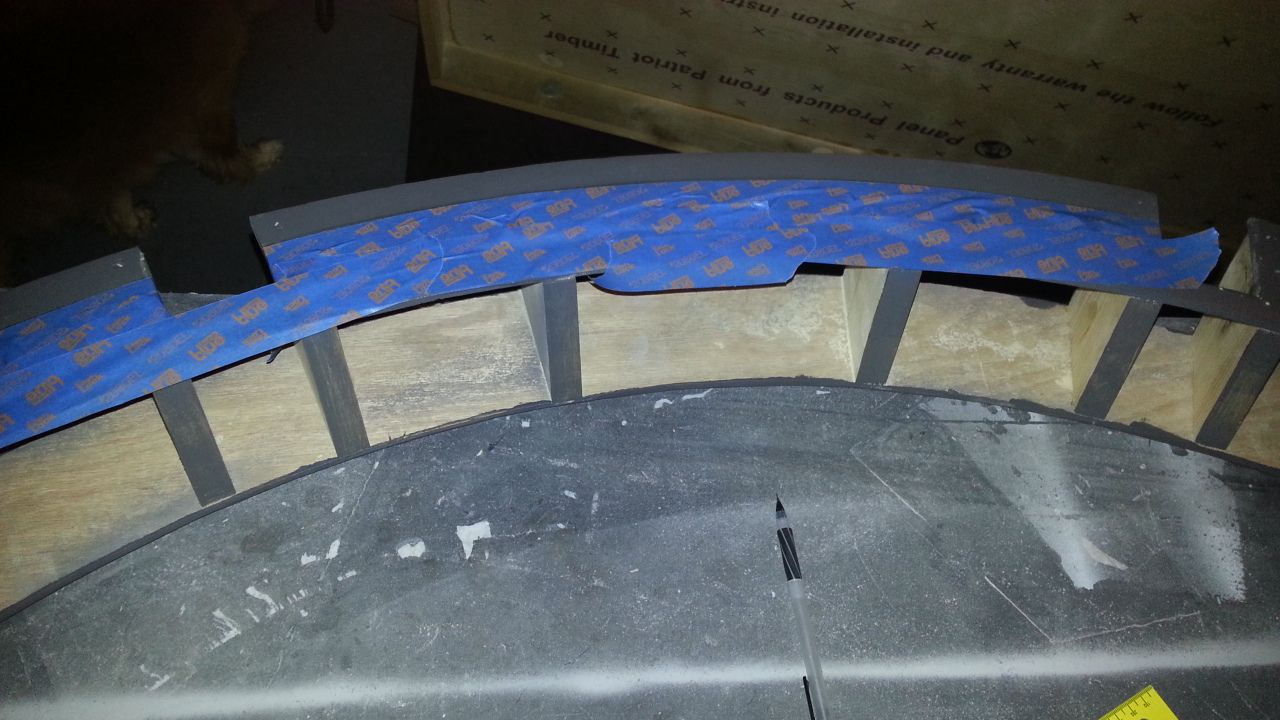

Hi Gang,

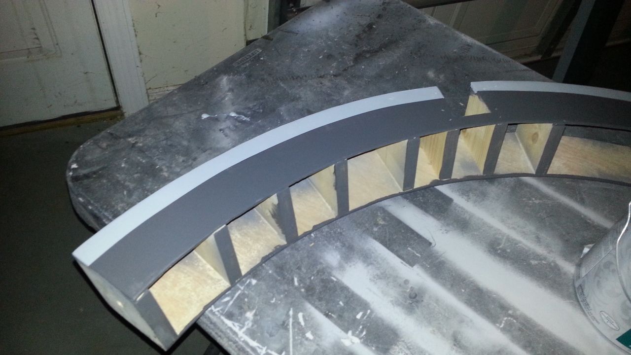

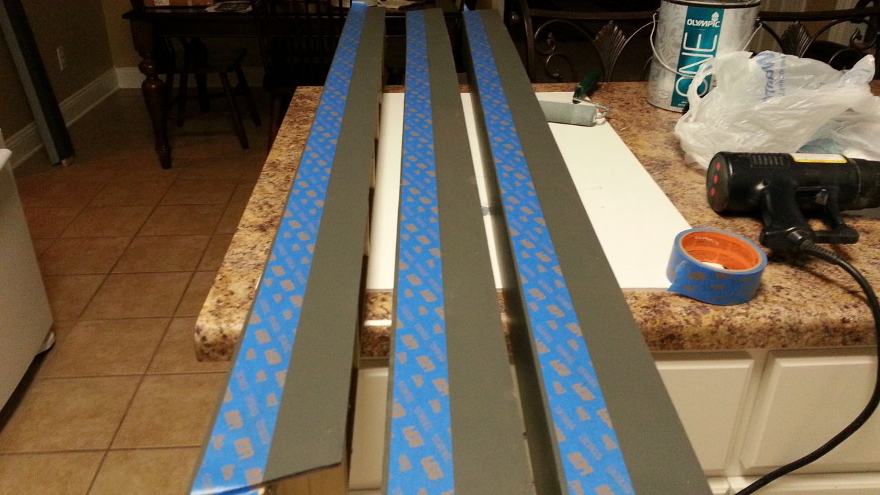

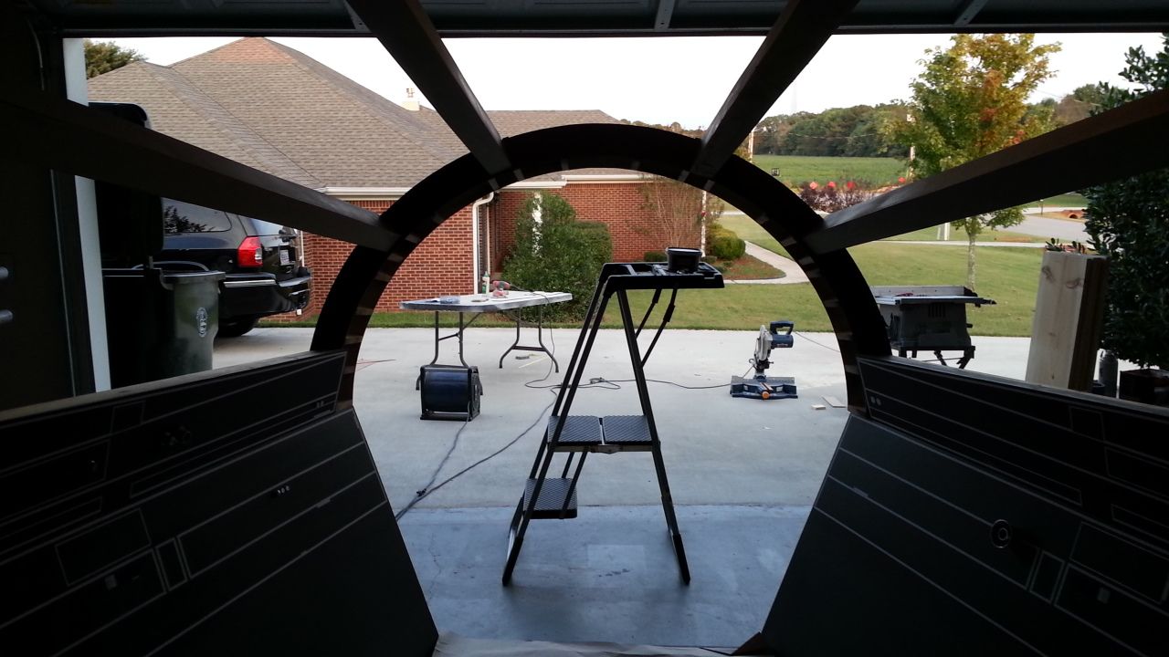

If you know me by now... I can't just sit for a few hours and do nothing...

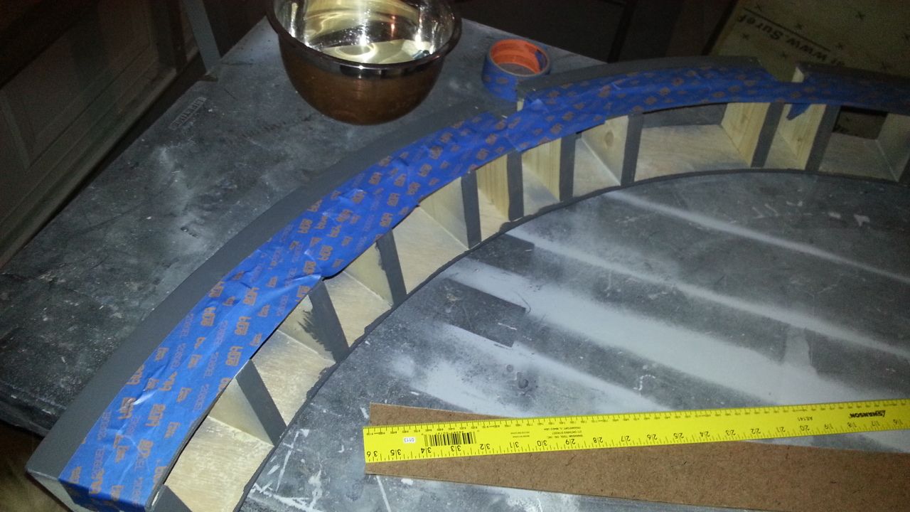

I masked off half of the beam to paint the light grey color
Did the same to the front arch
Painted and removed tape
There will be a black line going down the center of the two colors
Terrible photo! I'll get a better shot tomorrow in the sunshine :)
