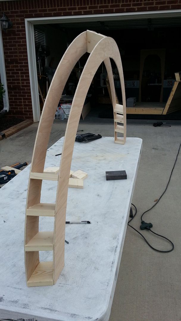

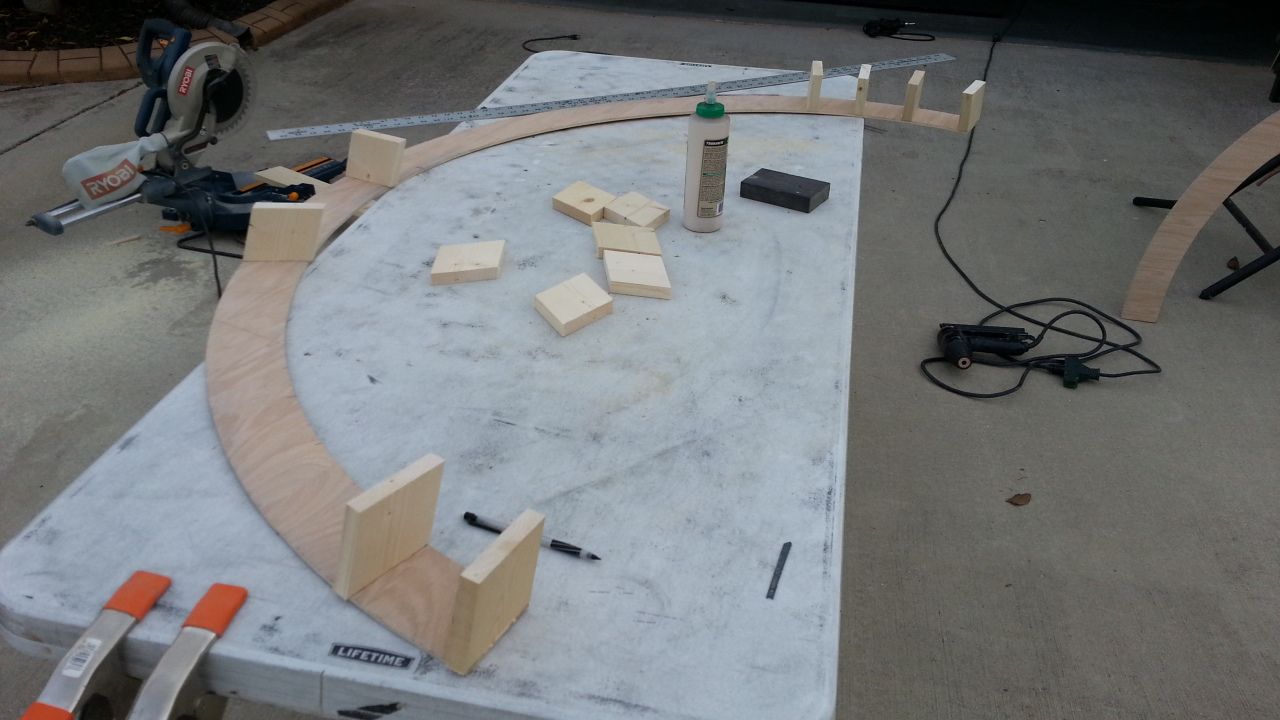

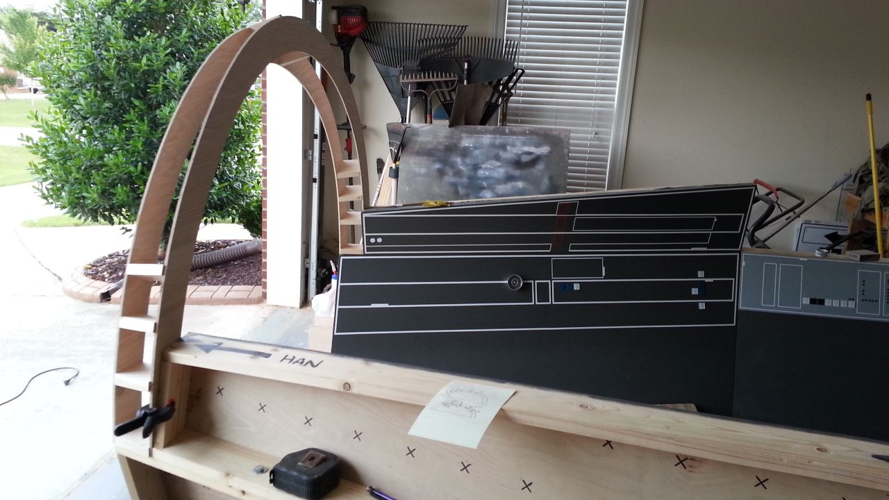

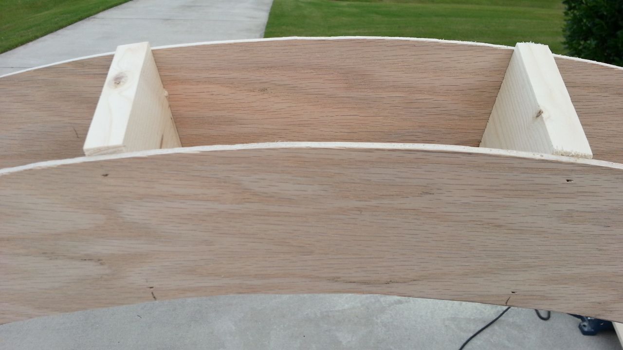

After hours of measuring and pouring over screen grabs... I jumped in and started the front window/canopy!
First of two cuts
I didn't realize how big the window actually was/is!

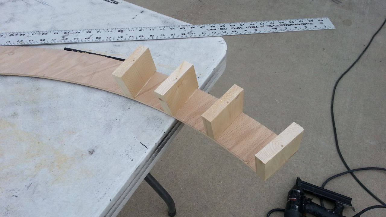

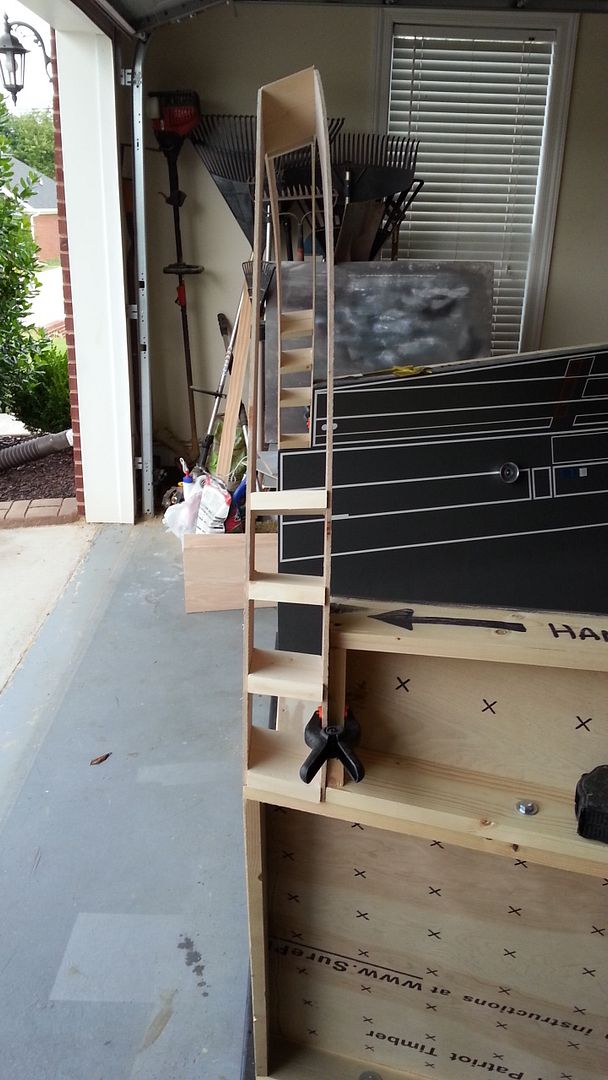

I took the same dimensions as the side panel and cut several supports to sandwich in between each panel
Adding more supports...
Notice the angle. I then have to skin this bad boy! I used 1/4 ply - very light and easy to move around

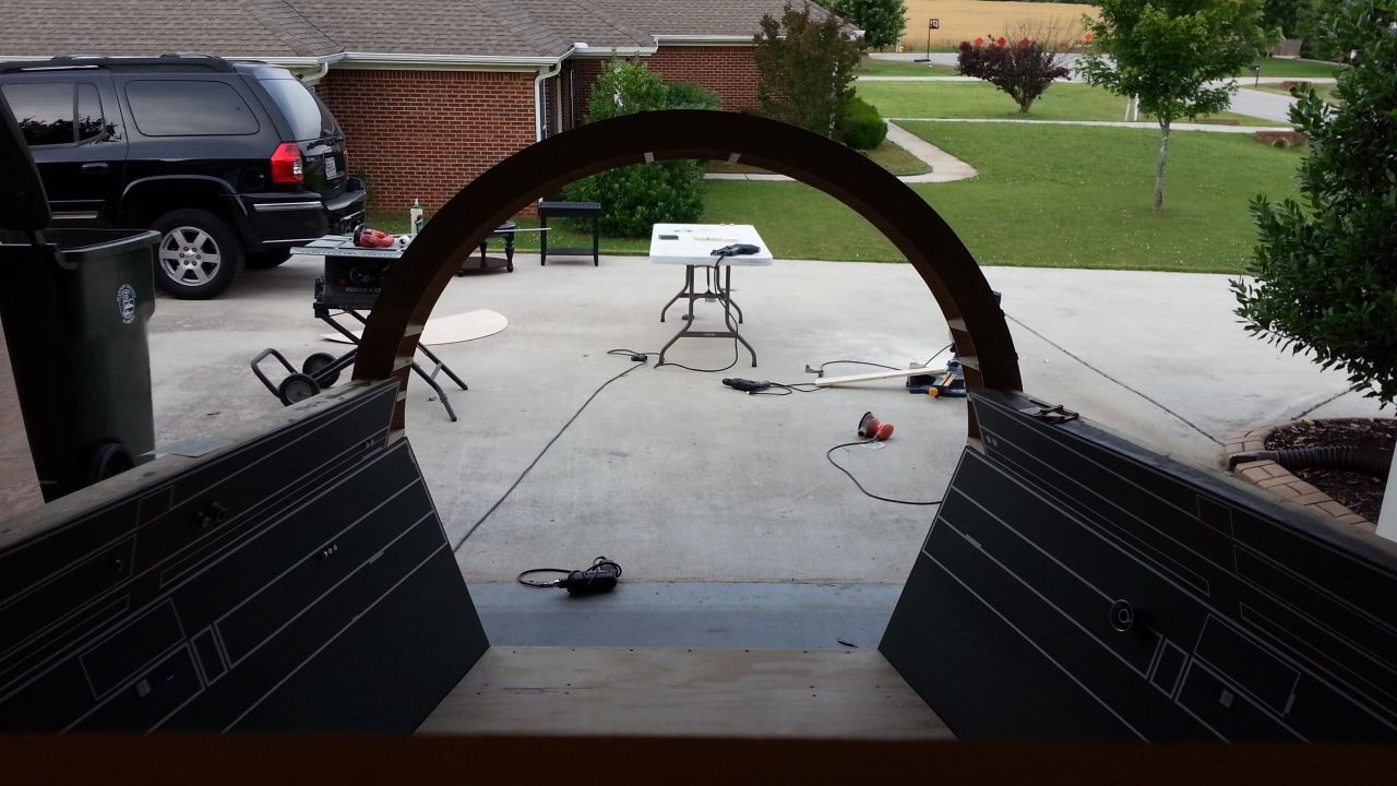

Top Dead Center

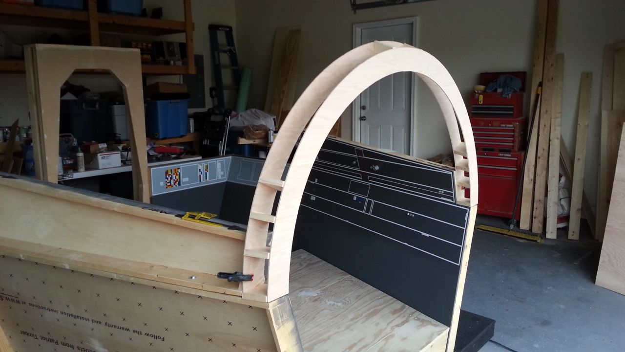

Hey! That's the beginning of a window!
So far so good!
Handy clamps make it easy! :)

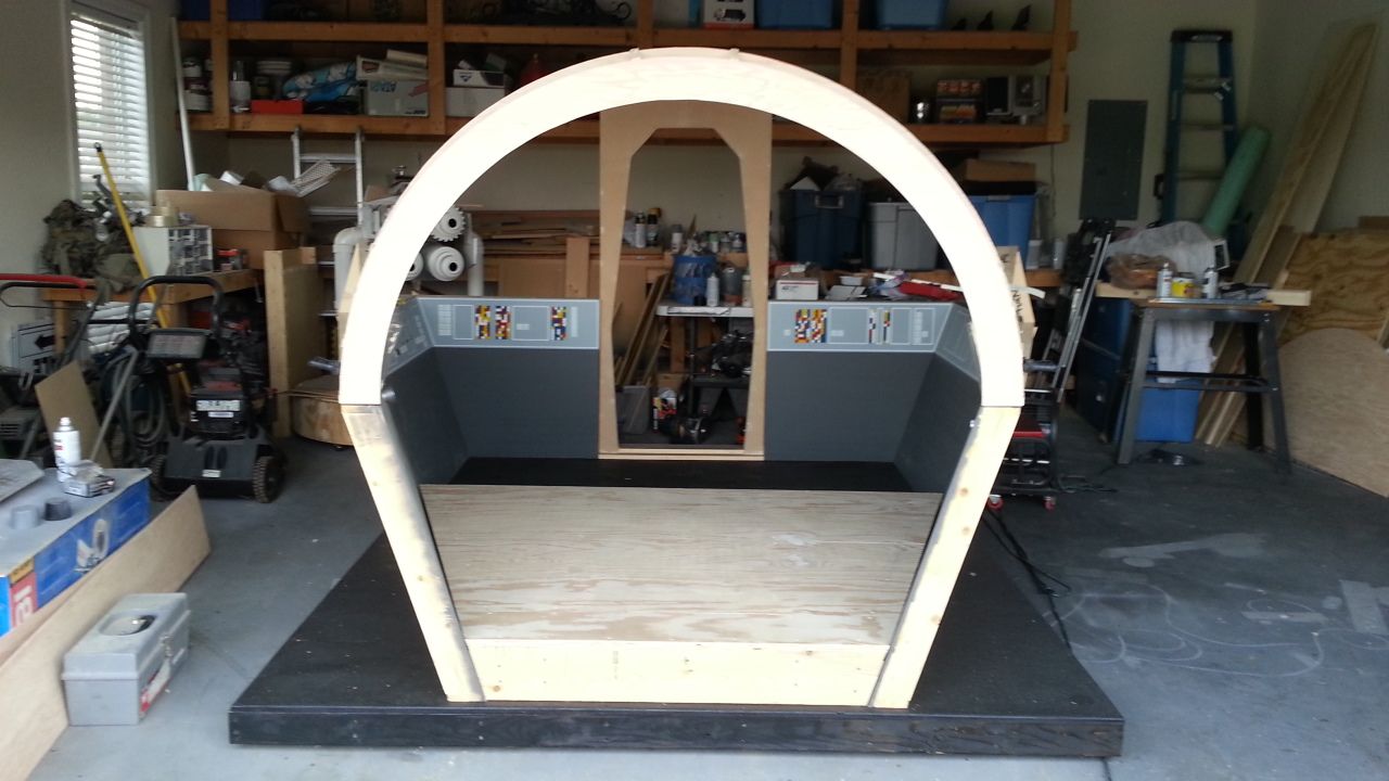

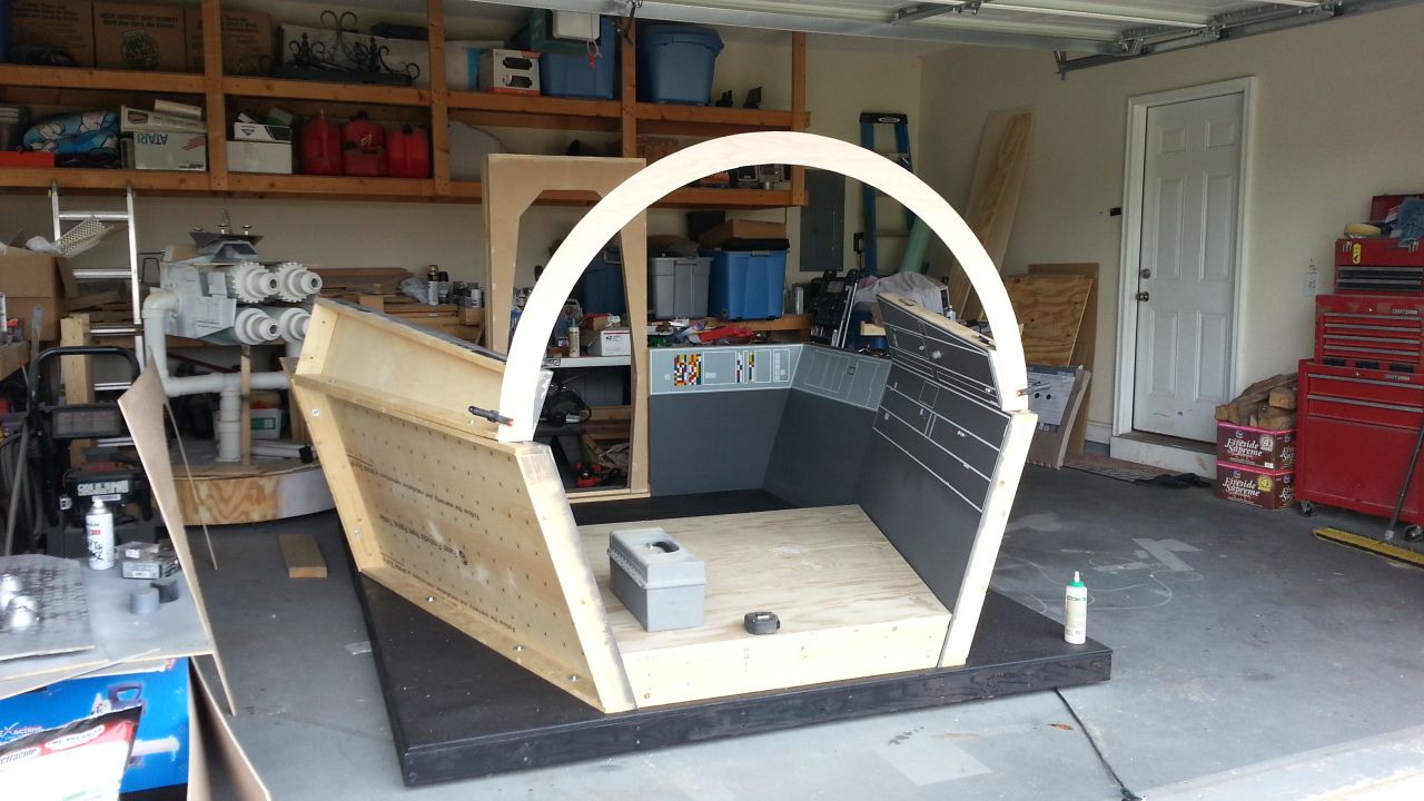

Side View
Side Rear
Looking from rear
Tomorrow - who knows... Platform? Window? ;)
Stay Tuned!

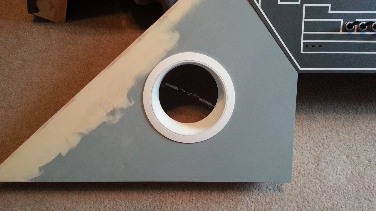

It looks like rain will be here all day... UGH... But, I did pick up a few goodies for the back panel behind Chewie. I've been thinking how I'm going to go about recreating the F4 Phantom targeting screen...
I picked up a recessed light for a few bucks. The hole is 6.5 inches and the light 6 inches.
The radial design would fit over top and hide the trim piece
And if all else fails... I'll just do this... ;)

It's the angle that will make it tough. Unless you're good at math. ;)
Re: 1:1 Millennium Falcon Console Replica

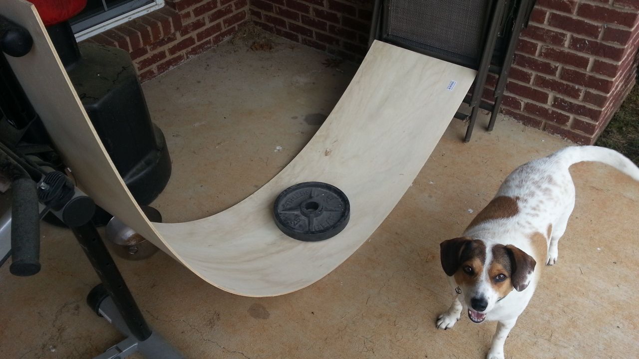

OH I see what you're saying... This is the approach I'm taking. I'm going to "roll" the frame across a thin sheet of ply and take very rough measurements leaving 2-3 inches of play on each side and at the ends. I'll then cut the ply, adhere to the frame and then trim the excess... Again... I say that now... :)
And I'm not good at math...
EDIT: Taking into consideration what you just mentioned... :) I got my supervisor with me...
