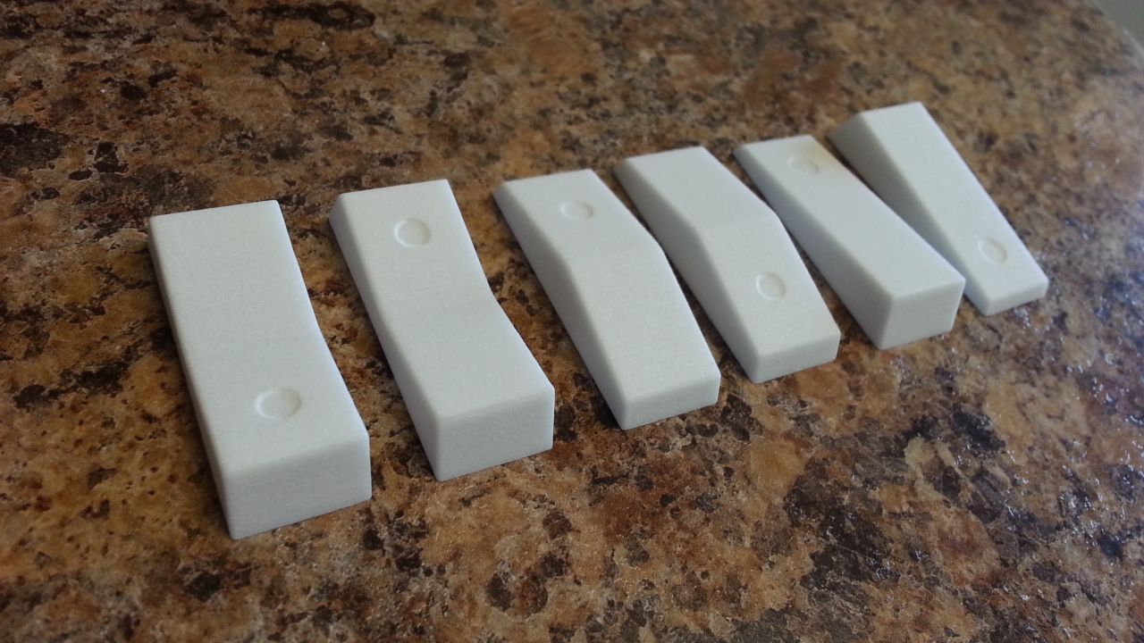

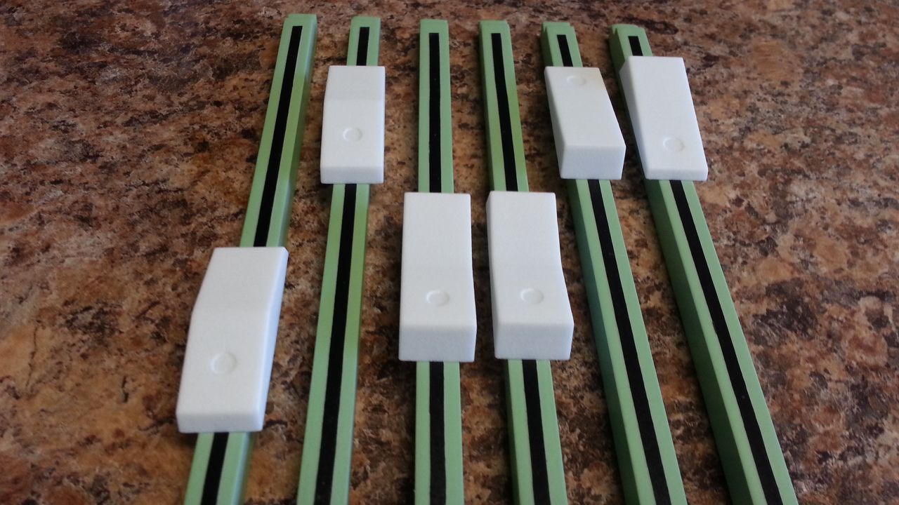

Hi Gang,
Starkiller's 3D printed slider / panel knobs arrived! Starkiller had Shapeways "polish" them - something we didn't do on the other 3D printed parts. While the edges are very smooth the tops are not. I have a lot of sanding to do on the tops before casting...
As you can see, Starkiller even added the indent for the black dot! :)
You can see how rough the tops are...
If I can't find any of the 120 PIN edge connectors, I'll ask Starkiller to make a quick 3D object for printing
The black line (pin striping) is actually hollowed out in the edge connector - that allowed for a backlight. YES... I would really like to backlight these as well!
This is a 56 PIN connector, but this gives you an idea of what the original looks like - and they were green
Stay Tuned!

Hi Gang,
Hi SofaKing,
There is a neat little trick around to smooth out your 3D prints:
https://www.youtube.com/watch?v=r3nJbU9OInk
One of my friends tried it and it works really great, timing is everything btw. Don't keep it in to long.
Cheers, Michel

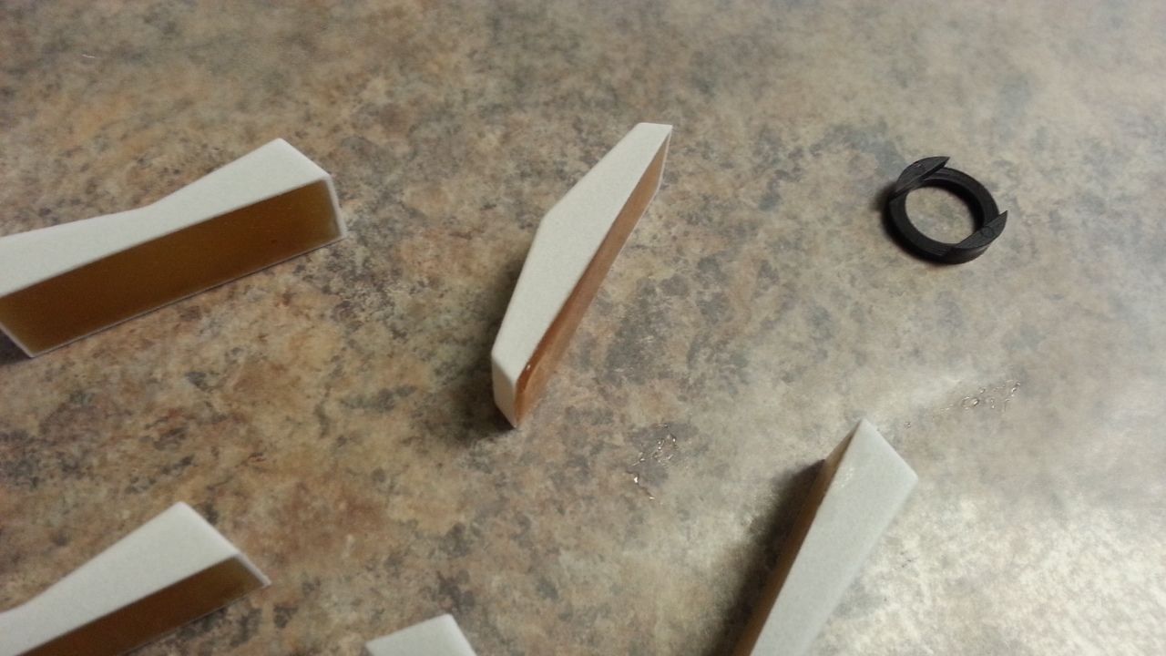

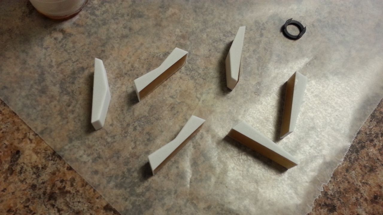

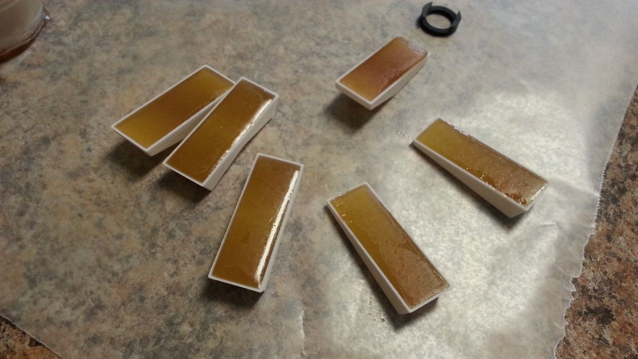

Hi Gang,
Woke up a little early this morning and had some time to fill the slider/console knobs with resin. As with the throttle greeblies, this will make them more solid and allow me to make molds. :)
I mixed up a little fiberglass resin and filled away...
As the resin began to cure I was able to see how much I needed to shave off to make the bottoms smooth
A little too much resin here
As the resin cured I was able to use a knife a shave off the excess (you don't have a whole of time with resin) - this makes it a little easier to sand smooth (less work is always better ;)
More to Follow!

Hi M,
Thanks for the great tip! Will this work with the powder printed objects?
Re: 1:1 Millennium Falcon Console Replica
Probably not.. normally they only use it on the in plastic printed objects. I could ask if something can be done to powder printed objects. We have a printer at the fablab over here. I'll let you know :)
UPDATE:
I just asked: Unfortunately you can't do that to powder printed objects.. Only thing you can do is bondo and sanding.. Sorry to get your hopes up.
UPDATE:
