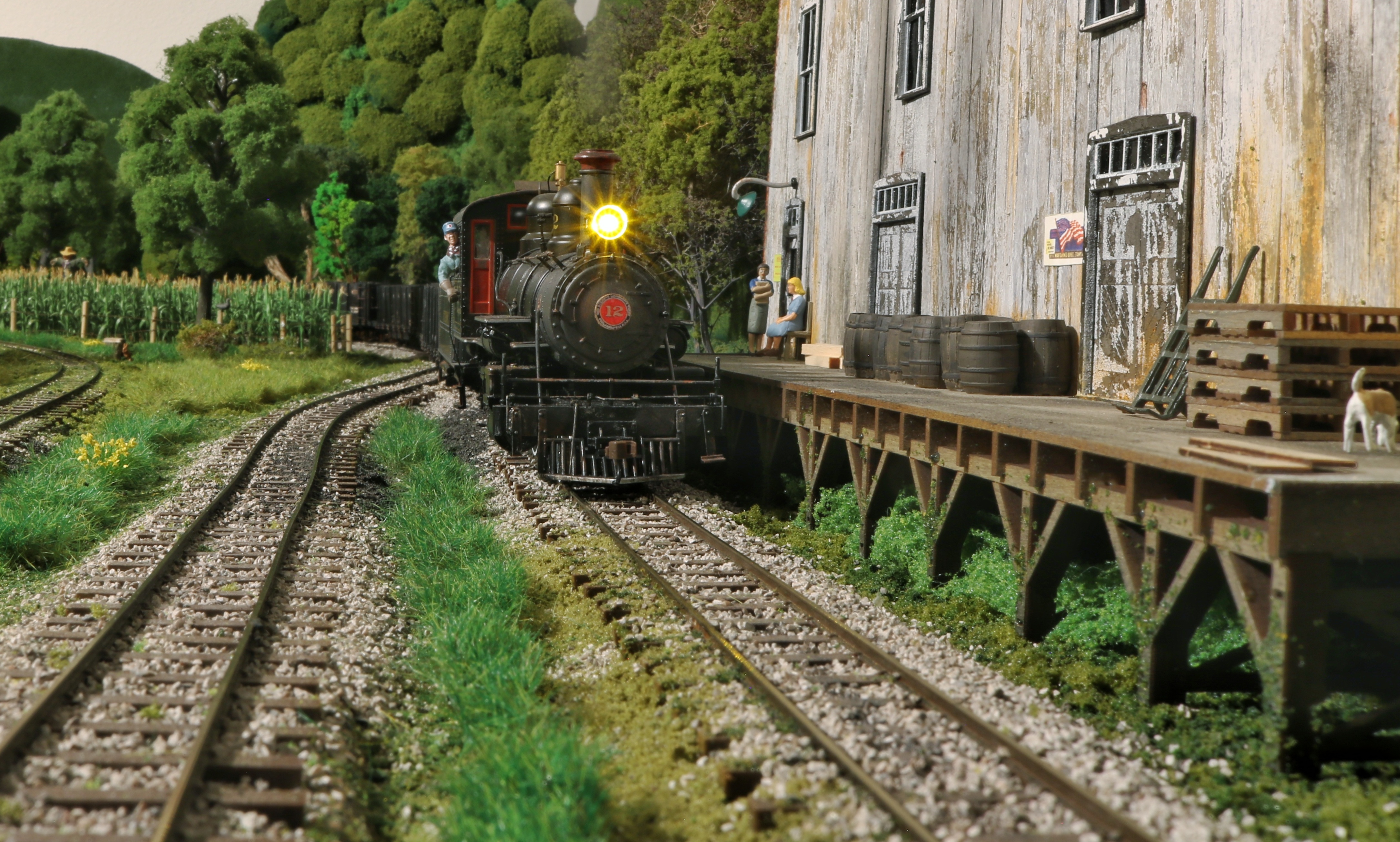

Coffee stirrers make for great scale wood boards for scale structures.
I bought a box of 1000 of them on Amazon for less than ten bucks. After building the structure to the right in this shot with a bunch of them, the box still looks full. It's the best hobby value purchase I've ever made.
Great photo of your model railroad skill p51. Used to do some of this in my early days with American Flyer. Love your realistic detail work.
Used to live behind the RR tracks as a kid. Lots of steam engines in the switch yard. My brother and I collected coal as a 5 year olds that fell off of tenders. Father used to send the dog out to bring us back.

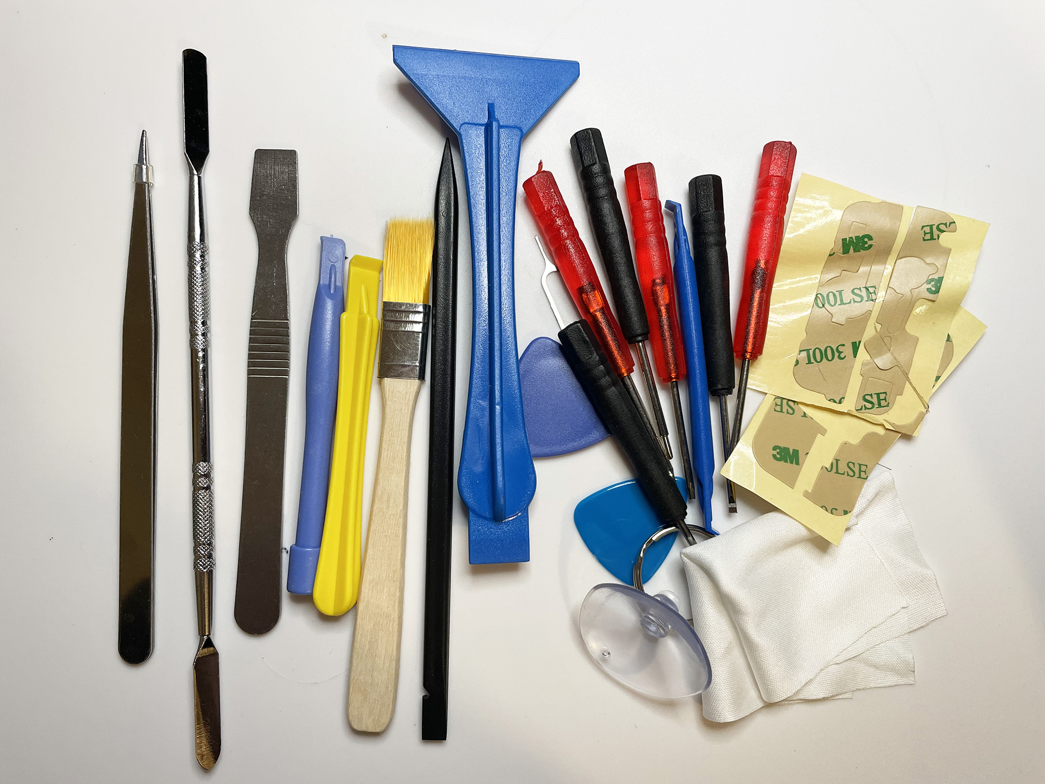

Sculpting - scraping - shaping tools:
A set with several such metal and plastic tools, plus tweezers and some mediocre or special form screwdrivers & other oddments.
Look for "Mobile phone tool kit" on ebay - I got some sets as in the photo a couple of years ago, but checking again they are presently listed as "23 Piece" or "23 in 1" kits, for typically £3.25 UK. Some places want twice or more that for just one of the metal sculpting tools!
The contents seem a bit mixed, another set had four or five of the metal tools.

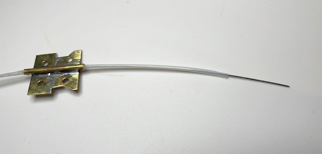

Another one that may be useful to some people - "micro size" bowden cable for remote actuation or linking moving parts:
Small PTFE electrical sleeving, plus a thick non-wound guitar string, such as a bass guitar string.
You need either Loctite "All plastics" superglue, for the fibre tip pen of primer/activator, or some SF770 primer - the bulk liquid industrial version.
That stuff allows superglue to bond with PTFE as well as polyethylene etc., so you can glue the ends of the PTFE sleeving in place. I use bits if small brass tube and offcuts to make brackets, to suite where the outer will be attached, then glue it in those,
The sleeving in the photo is 2mm outside diameter and 1mm inside.
For pull-only linkages I've also used similar sleeving with high tensile braided fishing line threaded through it.

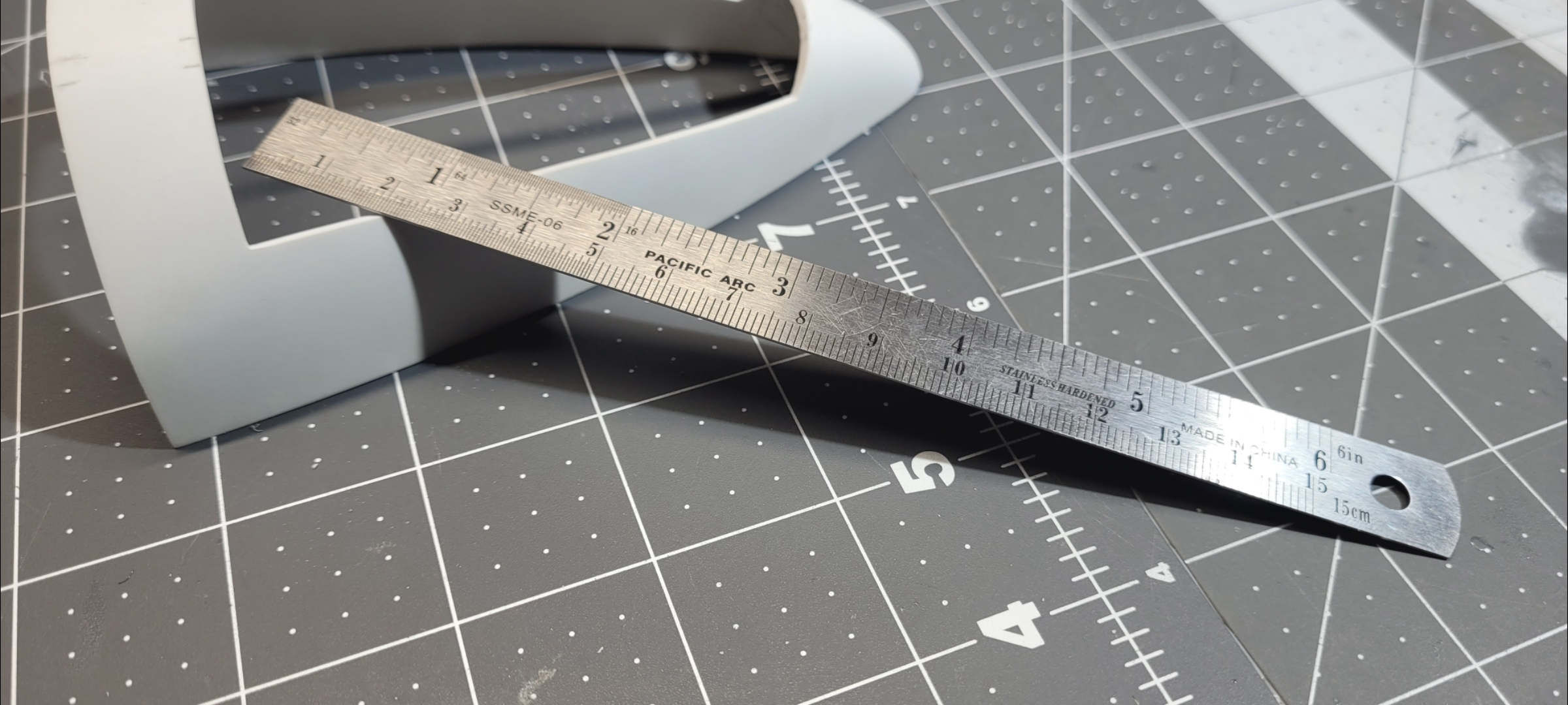

This small metal Ruler. I use the edge of it to just carve styrene. It shapes things like a mini-Rasp. No need to sand. It has the added bonus of leaving a smooth surface. Also, very handy for adding panel lines.

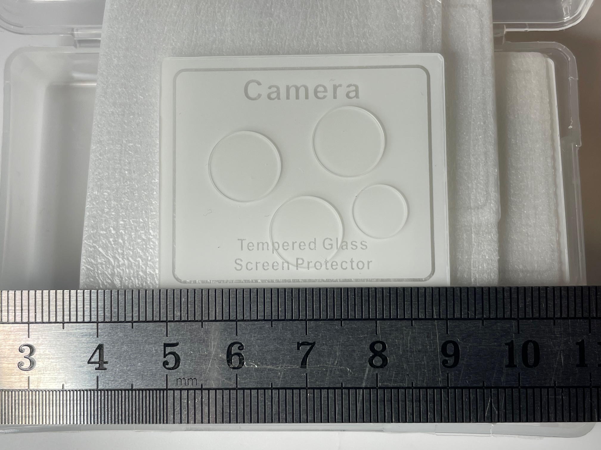

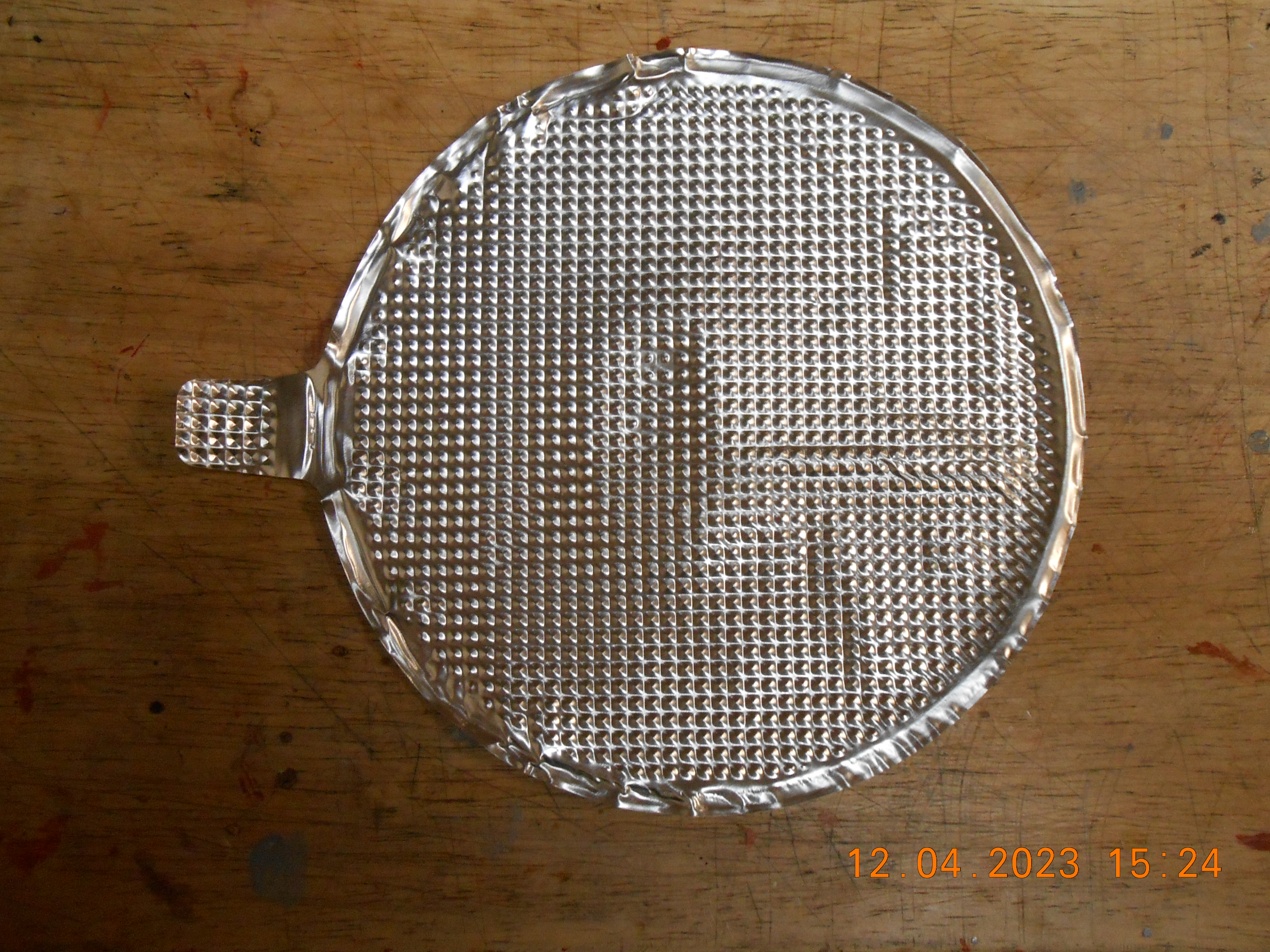

Windows - Portholes - Lenses etc: Phone camera lens protectors!
These are available in various styles and sizes, with the commonest having an array for the whole camera, but if you search through on eg. Amazon, there are also sets with individual round protectors for each lens.
Some have an outer ring, while others as in the photo below are completely clear - and of course they are optically perfect, unlike moulded windows or lenses.
The listings do not give sizes, but you can look up the size of the phone they are for on eg. gsmarena, and work out the lens size in proportion to the phone width.
The set in the photo have three at around 9.5 - 10mm and one at just under 8mm, with four sets of those as one purchase.

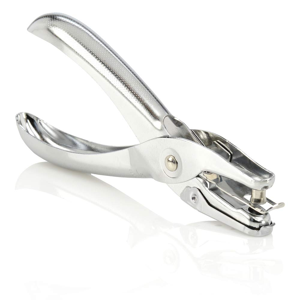

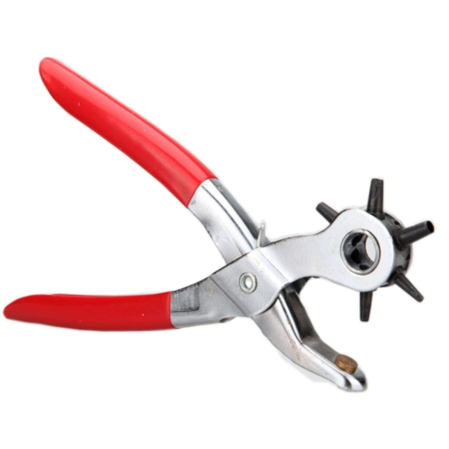

Hollow hole punches for leather can be used to punch holes in styrene and also make discs. Punch sets go from 0.5mm upwards. Just put the styrene sheet on a flat piece of wood and use a small hammer to tap the punch.
Same way people use these, but more versatile, because you can place them anywhere and don't need to change or rotate the tip to switch between sizes
People also use the pliers-type to quickly pump out "rivets" for Steampunk projects.
