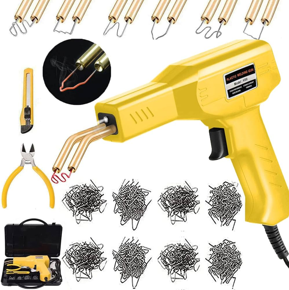

That and melting in plastic staples with one of these guys:

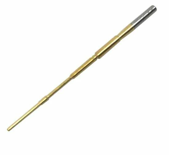

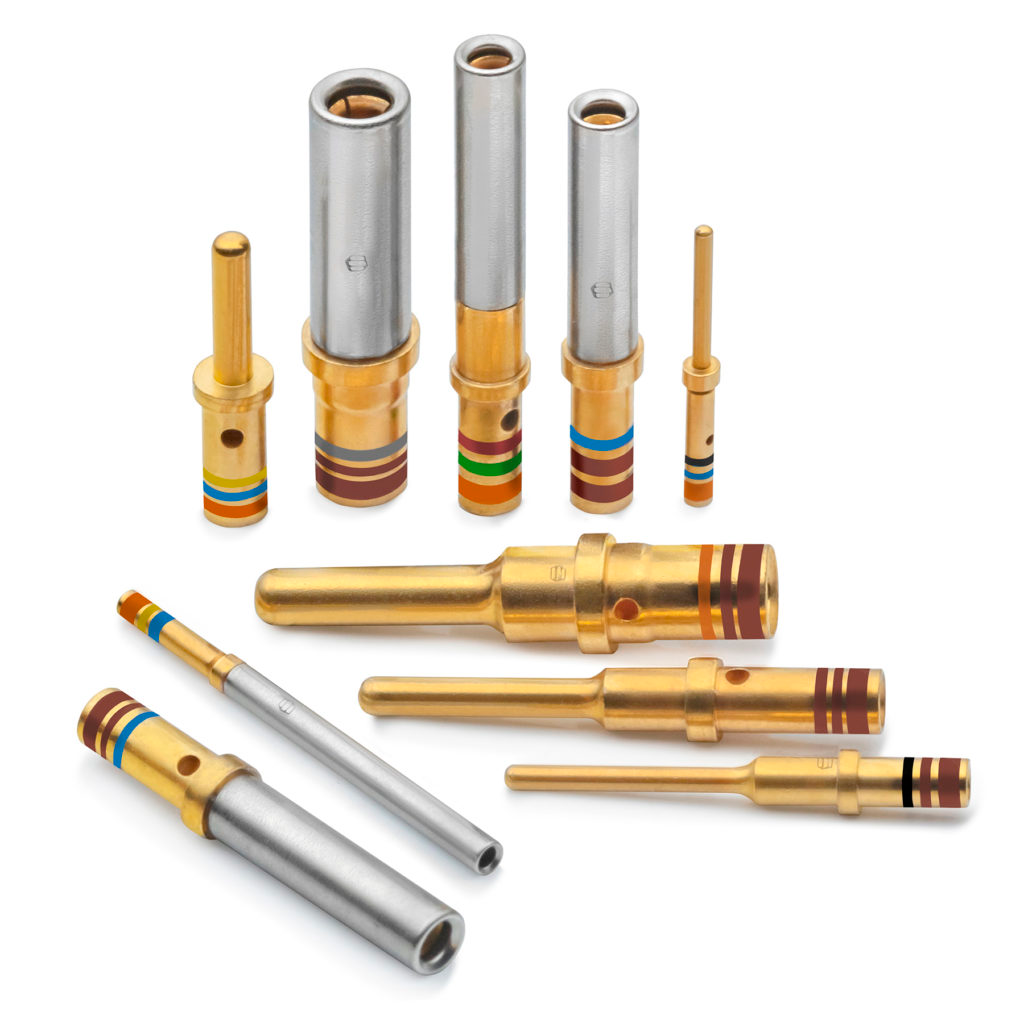

If you want some very tiny gun barrels, cable connectors, antennas, etc. and you can get them cheap, I highly recommend milspec contacts:
They are tiny, with extremely fine holes that can work very well for very tiny guns and such, if you get the smallest sizes. They can be pretty expensive, but lucky for me I work in the aerospace industry and we throw out broken ones all the time, plus all the extra ones the connectors come with that 'accidentally' make their way into my pockets when I clean up after my shift. ;)
Here's a set of AMT/Ertl TIE Interceptor guns I made using these:

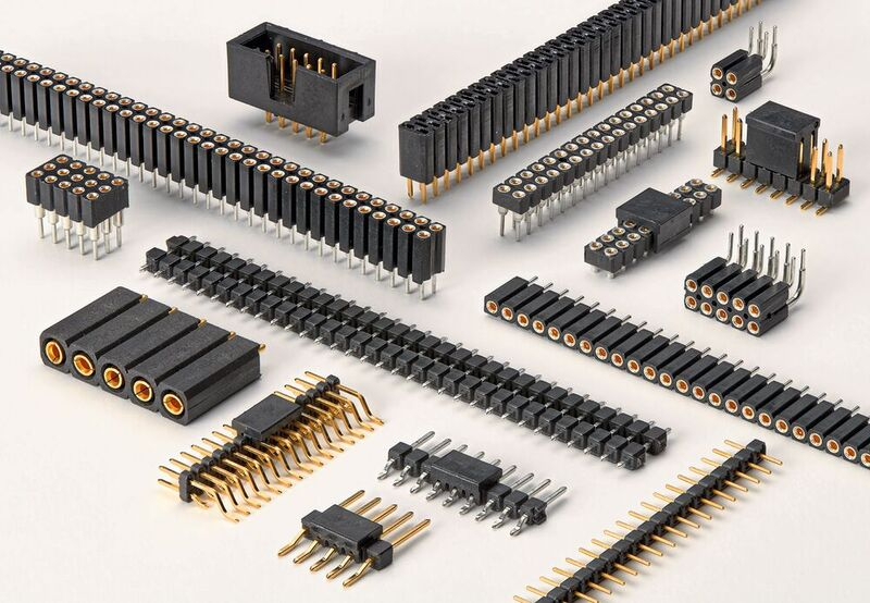

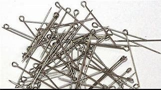

Years ago, I found out that you can buy those PCB connector sleeves in bulk without the plastic bits. They're perfect for stuff like RCS thrusters on spaceship models.
Sadly, I don't remember the technical name for them so others can easily order a bag as well. Anyone else know?
