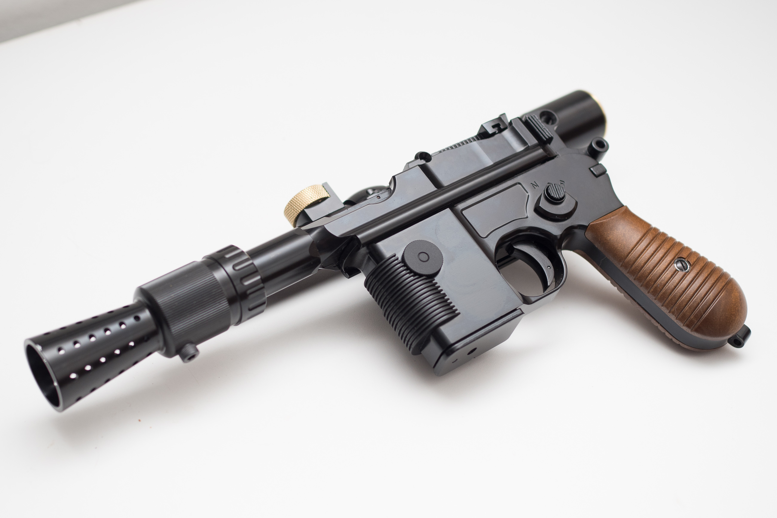

Finished the blueing and re-assembled the whole thing. I thought I'd put together the pictures of all four stages of finishing. Here's the brand-new factory finish first, all glossy, even, smooth black.

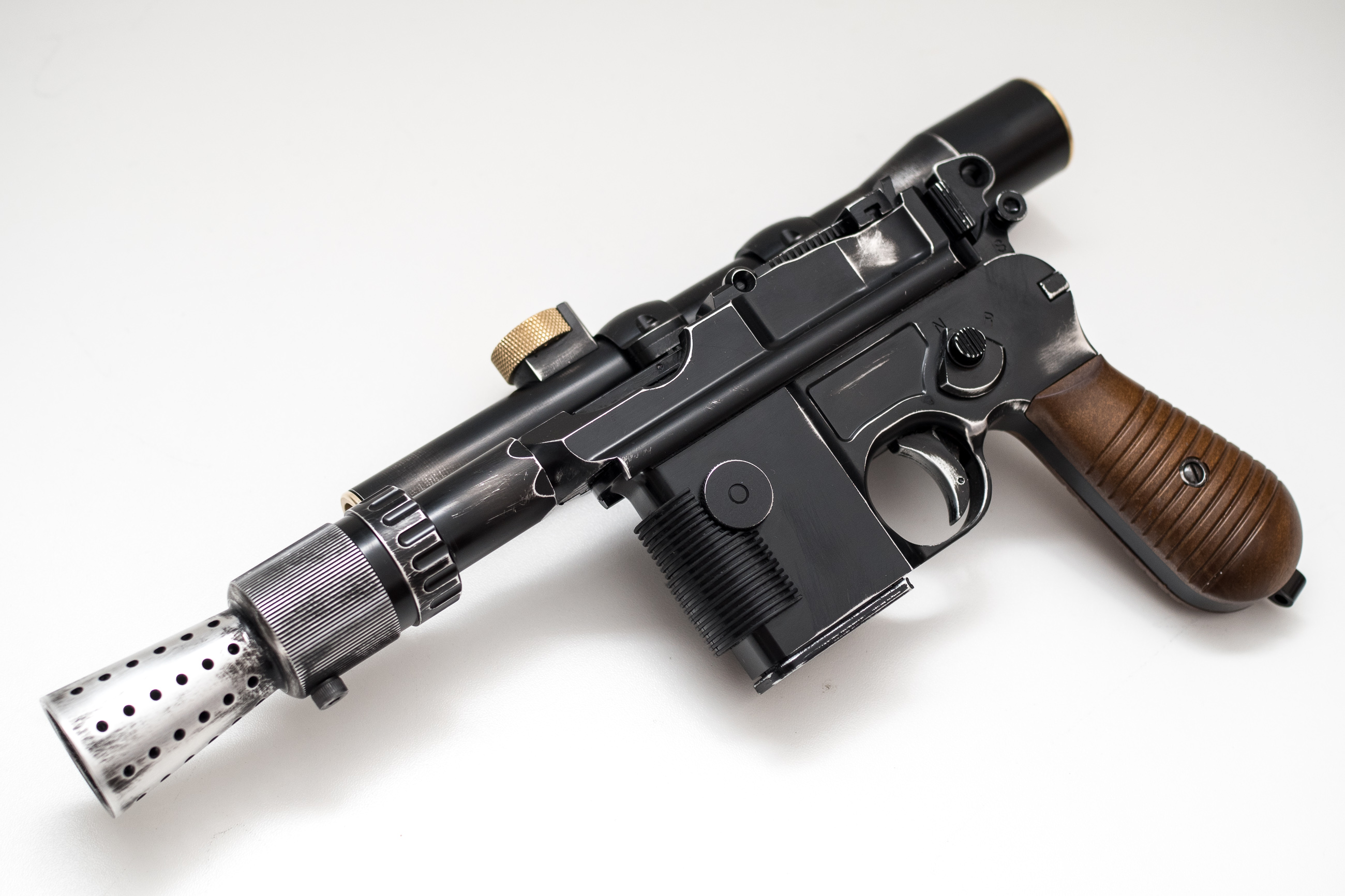

First weathering pass, just some wearing away of the factory paint with sandpaper and steel wool. A definite improvement, imo, but the unworn bits are still glossy, and it just doesn't look....old.

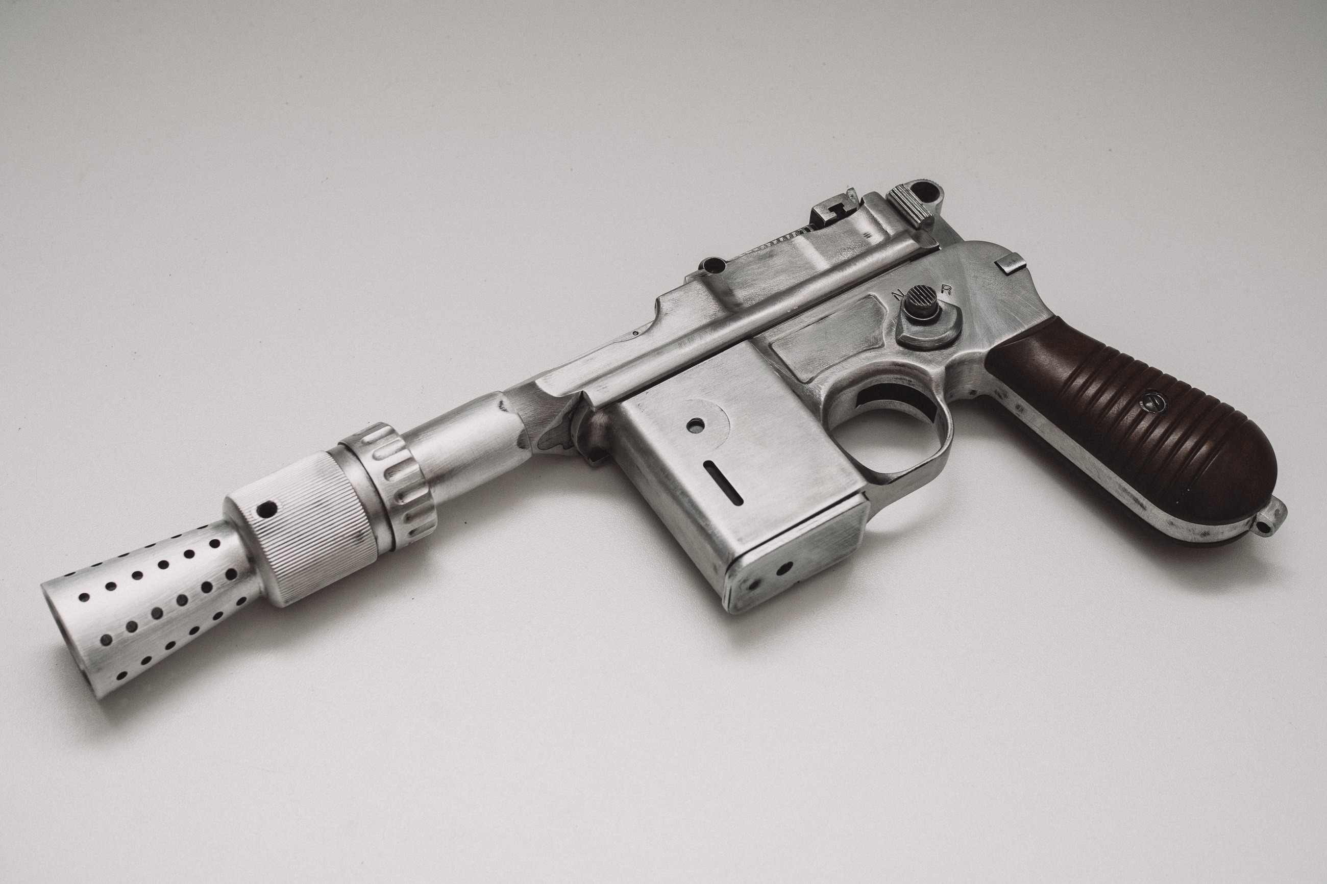

Fully stripped of paint. I actually quite like this. I never put the scope back on like this due to impatience :)

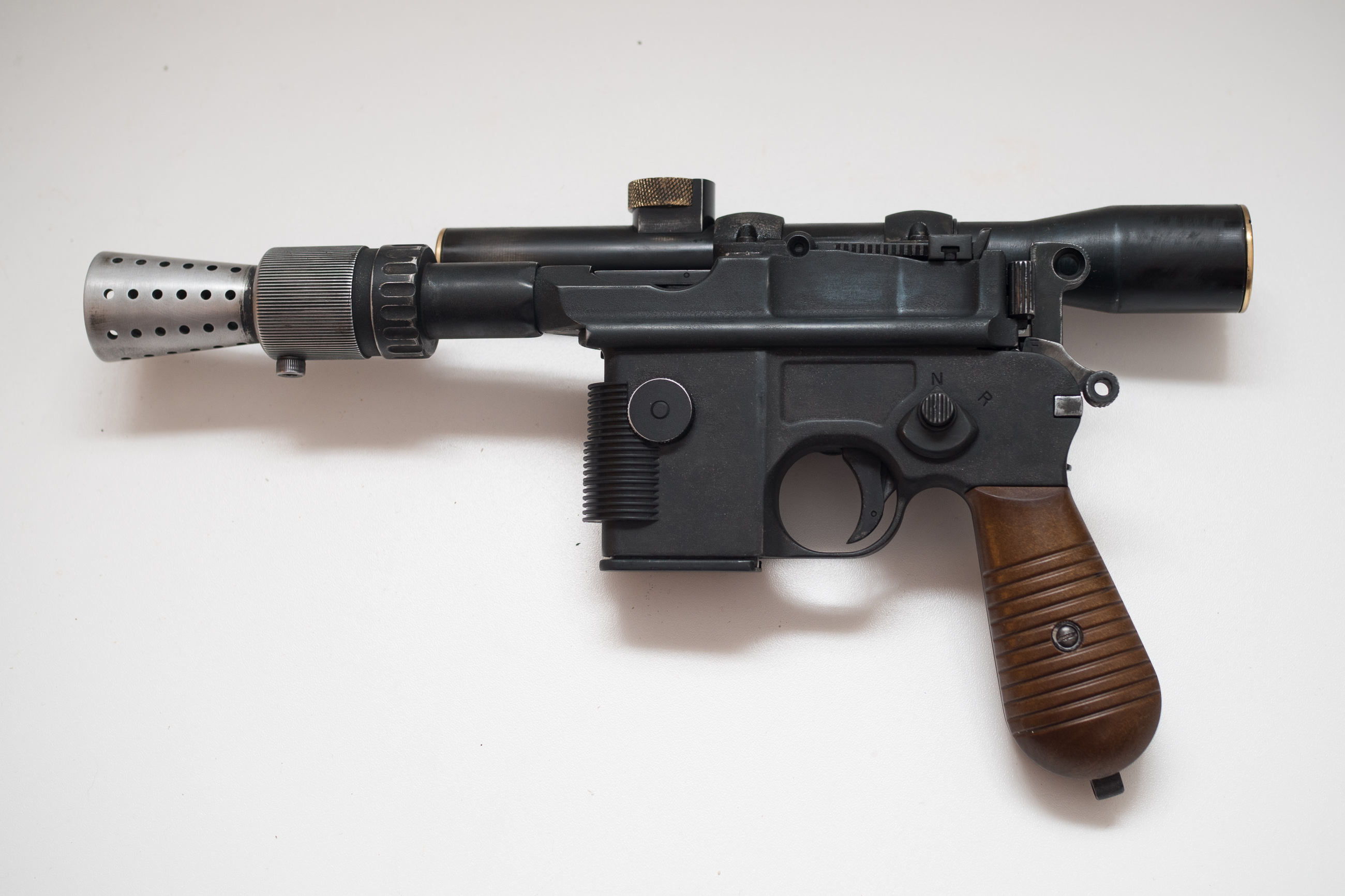

And finally all blued. I sanded the final aluminum black finish with a bit of 1500 grit sandpaper to remove some of the buildup, then treated with a bit of 3-in-1 oil. I think it looks a lot more....like metal now, at a glance, without the rather plastic-y original paint. I'll do a bit more re-weathering on this, but I quite like how it turned out as is.

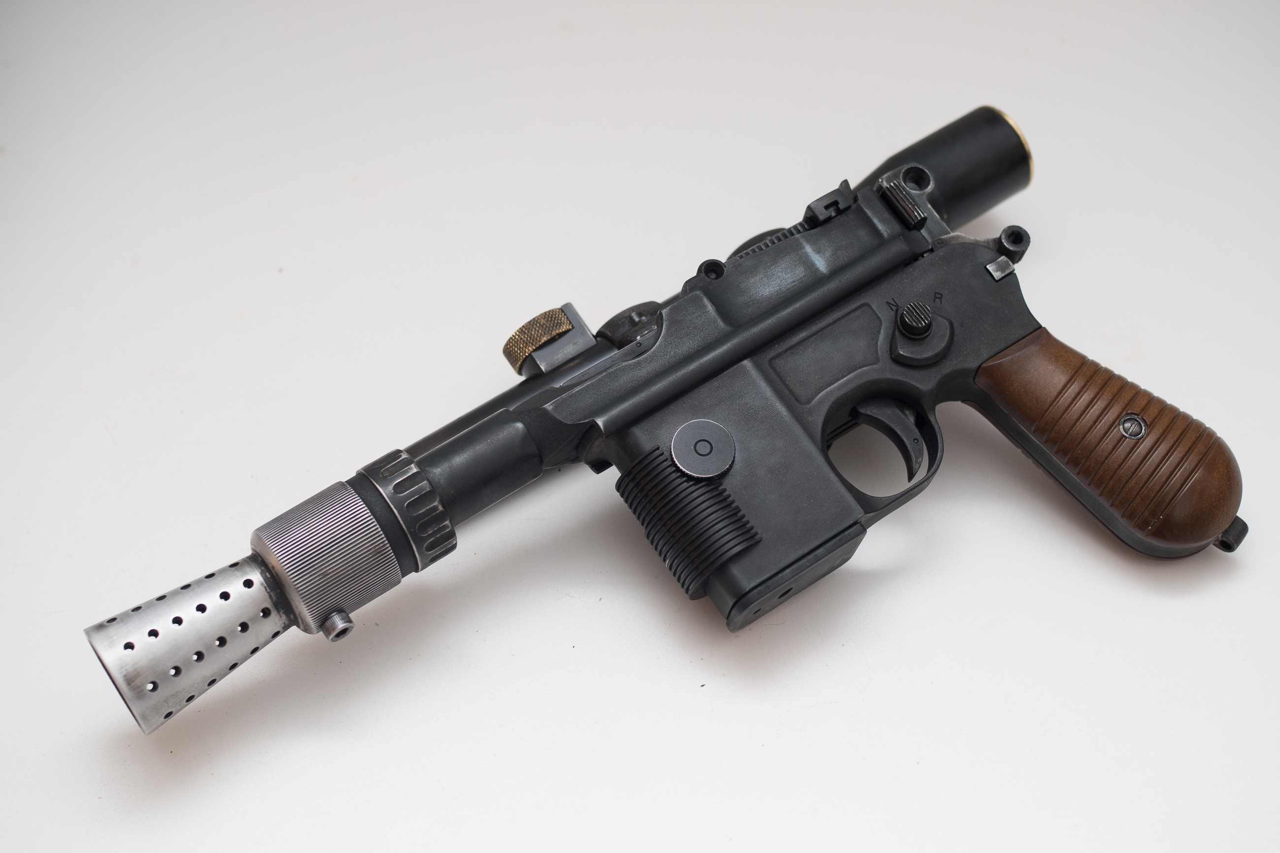

Can someone post a pic of one of these and an accurate Solo blaster side by side? This one looks amazing :)
You can find some good pics to compare it to in the TFA blaster thread. This is closest to the TFA version, with the biggest difference being the mode selector on the left side.
I've been meaning to weigh mine, so that's helpful. It's definitely lighter than my Denix-based blasters. It seems like a very nice mid-weight blaster, for it's size. Not light and cheap feeling, but not the brick that is the Denix, either.

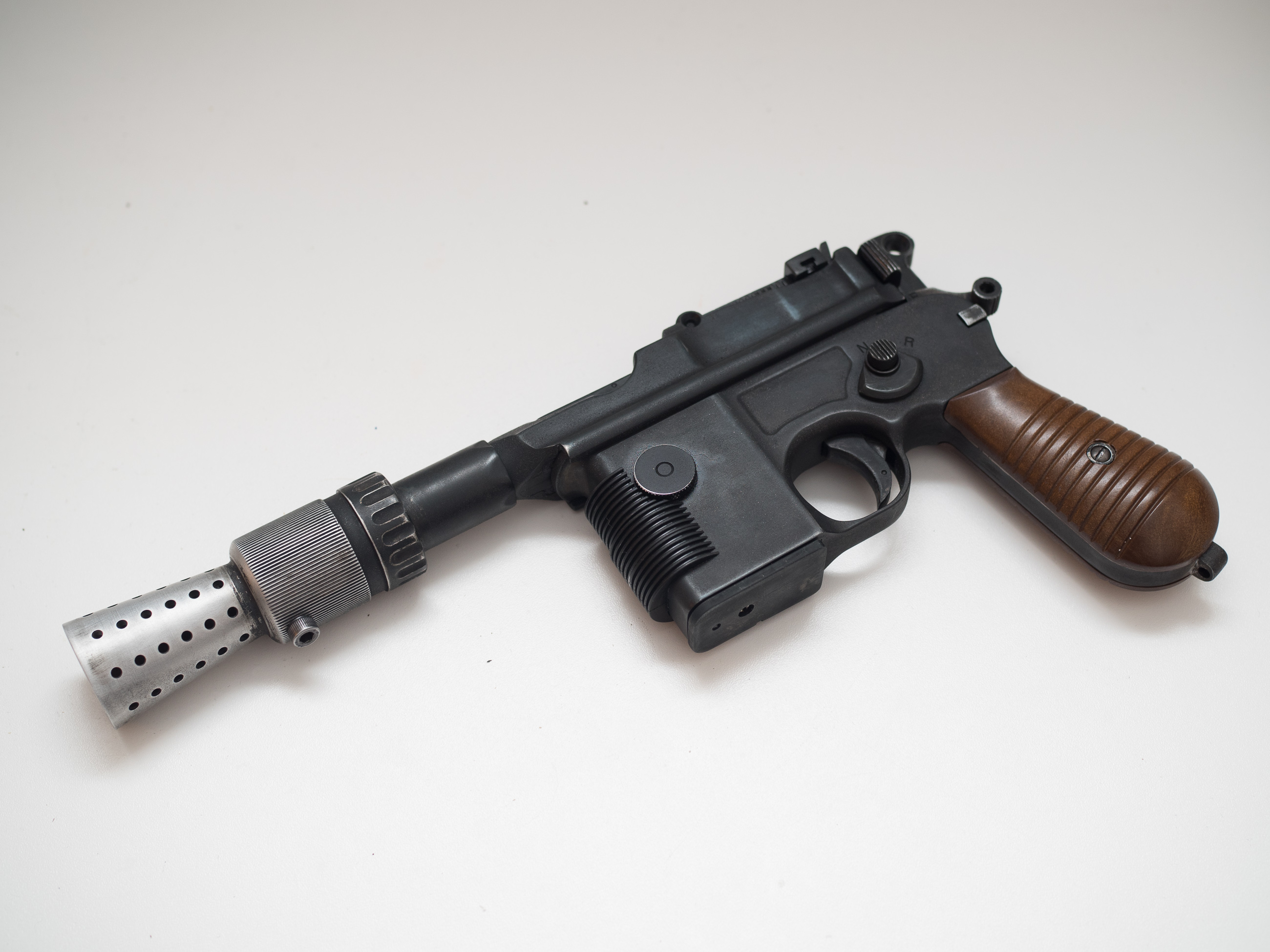

Some progress - I've stripped most of the main body components. Still have a few small pieces and the scope and mount to do. My order of Aluminum Black should be arriving today, so I can start seeing how it works pretty soon.
