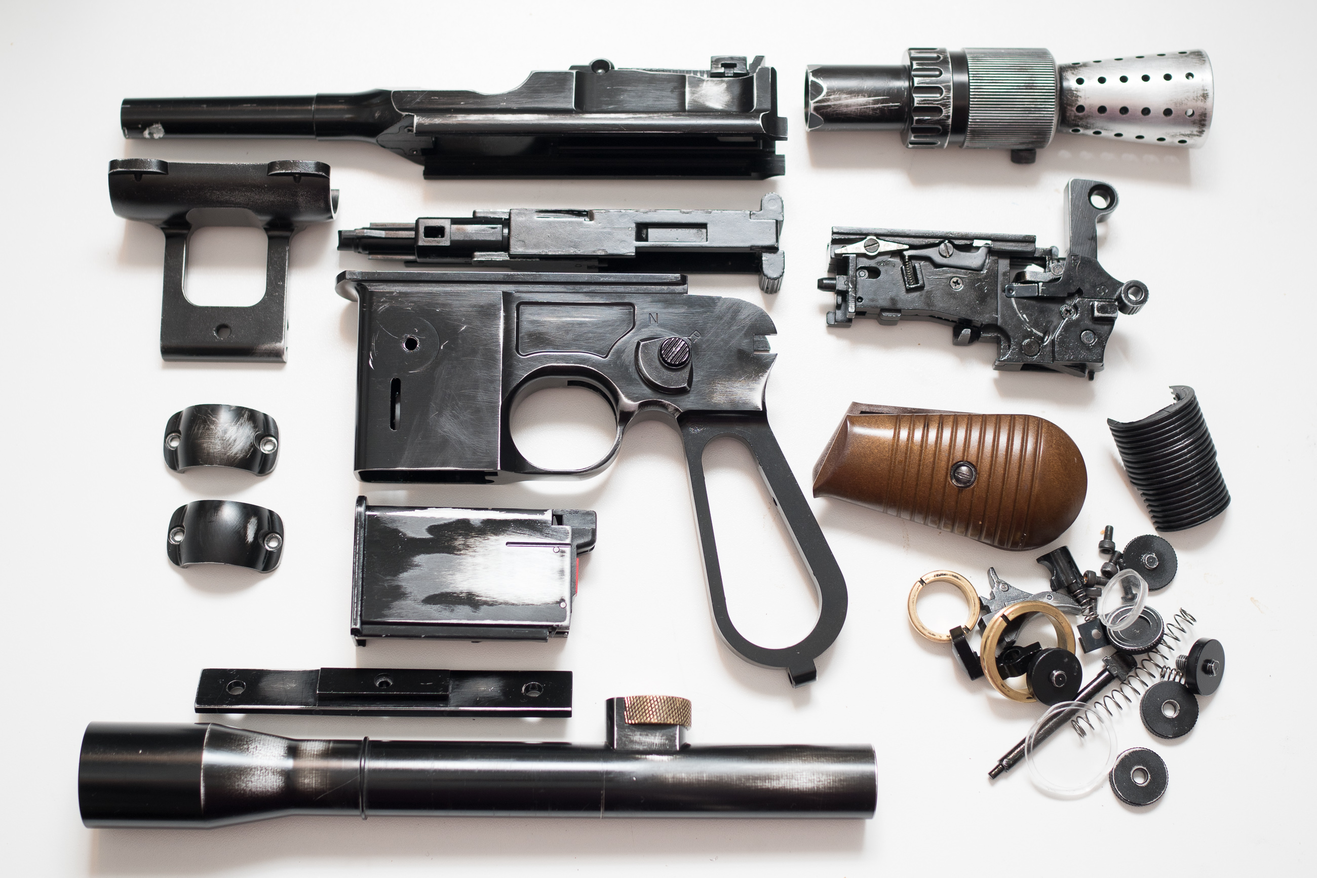

Welp, I bit the bullet (so to speak) and completely disassembled mine. Actually, I stripped and put it back together a couple of times to make sure I could put it back in working order. I'm not planning to fire it, but the working slide makes such a satisfying sound.
Now that Halloween's past, I want to go from the quick weathering job I did on the factory paint to a proper blued and weathered finish. Here's the parts as they are today.
One thing I can't figure out is how to remove the knob from the scope. The two screws on top seem to have absolutely nothing to do with holding it on. They seem to be cosmetic.
Remove the two screws, and the center piece comes off (it is a thin plate). Under that is a phillips screw that holds the actual dial on. Be carful when removing the dial as there is a spring loaded detent bearing underneath.
