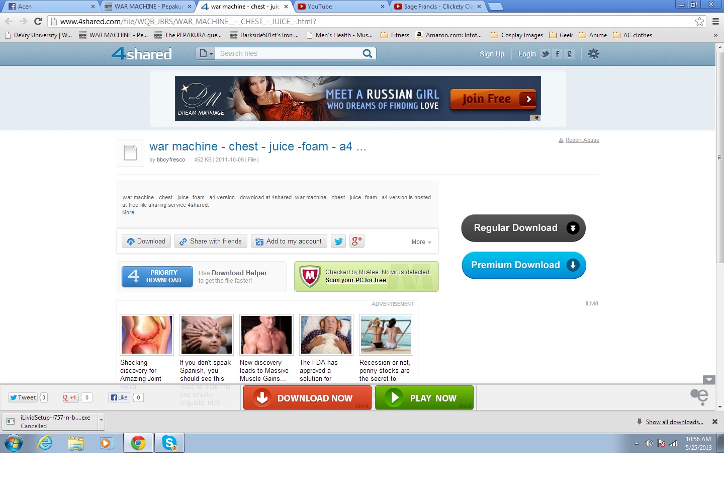

Hey guys I have worked with Pepakura before but now im coming across this problem. I am Trying to download the files for a warmachine and I have found a few but when I click to download it takes me to this site (in picture) and I dont know what to do. Anyone who knows how to fix this or knows what I am doing wrong please let me know. It would be greatly appreciated. wrong page.jpg

Hey guys I have worked with Pepakura before but now im coming across this problem. I am Trying to download the files for a warmachine and I have found a few but when I click to download it takes me to this site (in picture) and I dont know what to do. Anyone who knows how to fix this or knows what I am doing wrong please let me know. It would be greatly appreciated. View attachment 188964
Well, outside of 4shared's tacky advertising, everything looks fine. 4shared (I believe still) requires you to sign up first to download from their site, so you'll have to do that. As much as I don't like 4shared anymore, it is free to sign up, and they don't spam or pop-up the heck out of your computer. Now that I said that, they will probably start. ANYWAYS....
Sign up for 4 shared if you haven't yet. On the screen you posted up, you would click on the download box next to the share with friends and add to my account boxes. You will then be taken over to another screen to download. On this second screen, there is a box on the right that says something like waiting time:20 seconds with a Free Download box below it. Click on the free download box. When the 20 second counter reaches 0, the download will begin automatically. When it's finished, your computer should ask you whether to open the file or save it. I just save all of my part files into one folder to keep them organized, such as 'War Machine' or 'Mark 1' or whatever.
Just a heads up too, 4shared doesn't really tell you download progress, so after you click free download and the countdown finishes up, it can take 5 seconds or 5 minutes depending on connection speed and file size. .PDO filles usually download pretty fast though. Good luck!

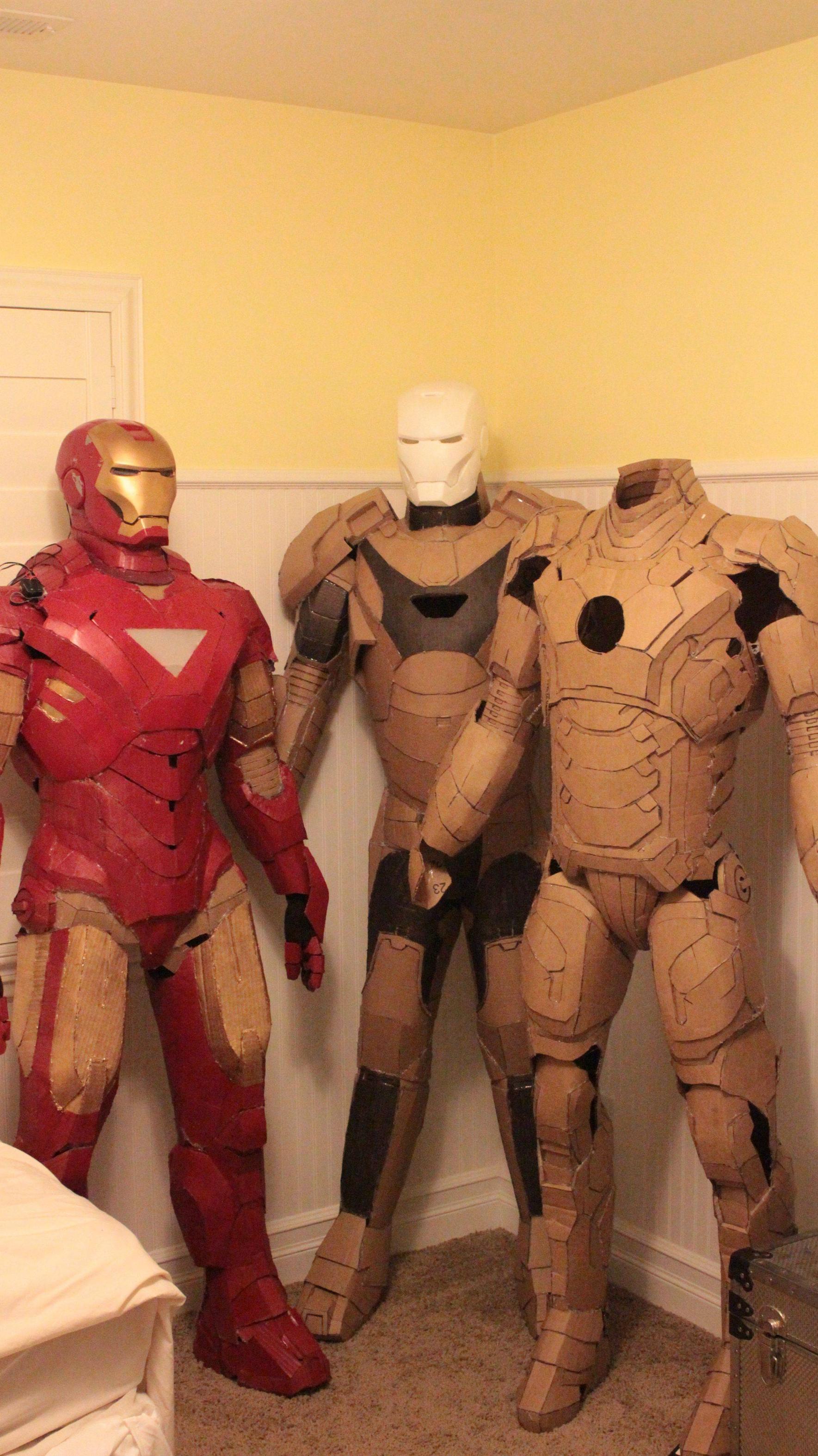

I want to use cardboard for a speed build display suit - This picture best describes what want to go for - Would I use the "Foam" Templates for this?
Also is this just casual corrugated cardboard or a special kind of cardboard?
I don't use 'special' cardboard, per se, but I try and pick stuff that has a 'tighter' corrugation to it. Some packing boxes have thicker walls, but the corrugating in between the sheets is really loose and separates pretty easily. The best cardboard I've found is from packaging for small appliances and such, where it's got a shiny full-color printed side. The stuff is usually thinner than packing boxes, more durable, and the shiny side doesn't absorb paint like raw cardboard.
You can use foam templates, and glue end-to-end with hot glue, but you'll likely want to add little 'bridge' pieces on the back side to reinforce the joint. Once it's fiberglassed, the pieces will be fine, but those seams suck up a lot of glue to hold until then.
