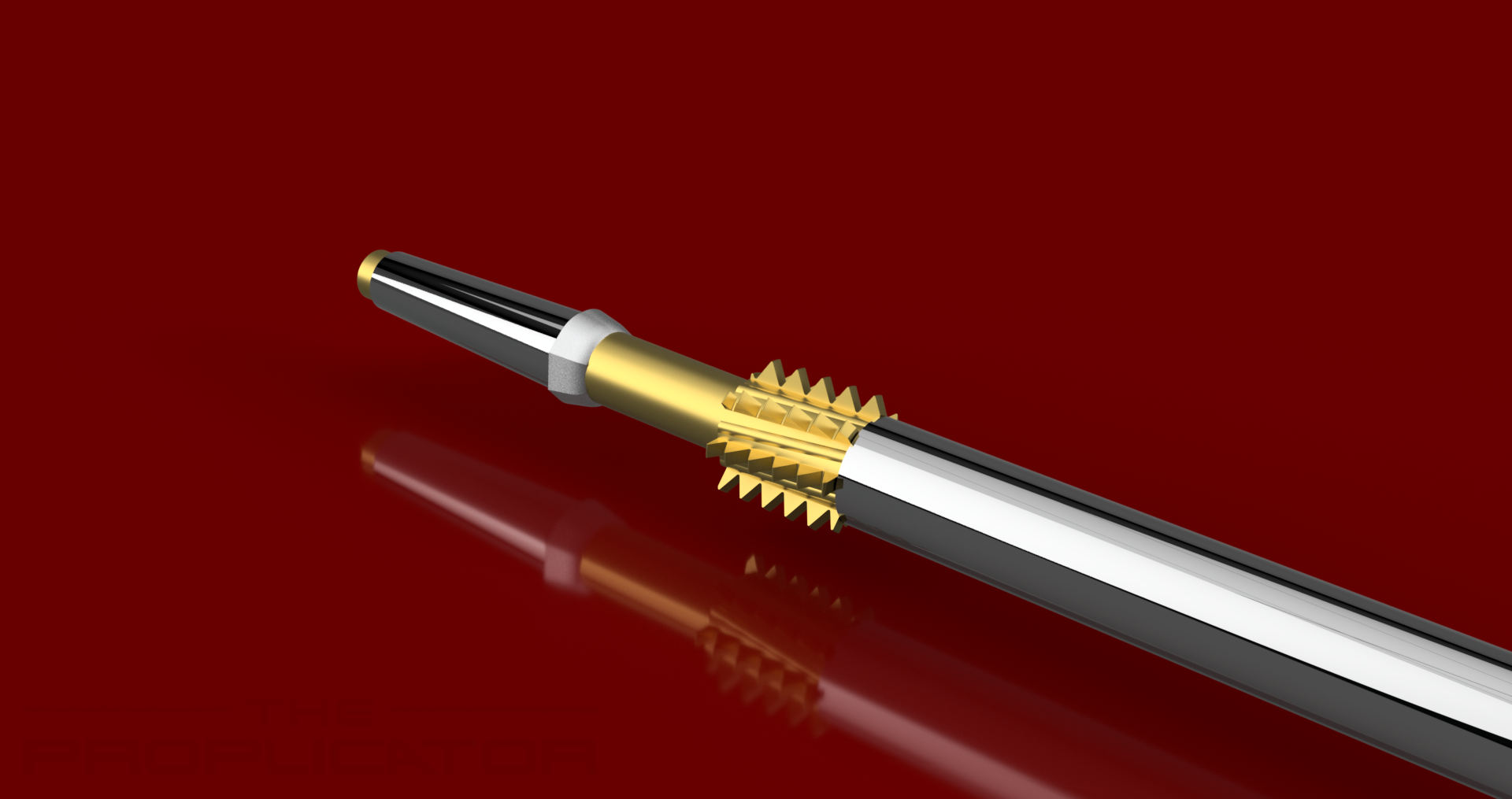

and here is a render of my model from these prints:
Looks reasonably close to me, although there is some evidence that the pommel and one of the wedge sections aren't cylindrical but faceted with flat sections.

Well, turns out I was able to get hold of a much higher res version of those blueprints so I've redrawn the pike with them to be a little more accurate. The higher res prints also confirmed the facets on the pommel and one of the grip pieces so that's been added in too :) Here are the new renders:
I've spoken to a machinist who has showed an interest in doing a small run of these so I'm looking into the possibility of that, although I'd like to see if I can track down the appropriate worm gear hob to get some measurements, so far I'm just approximating it from reference photos...
An interesting piece of extra info I got from the hi-res prints; most of the grip was bored out to accomodate "EMA TUBE (FOR BATTERIES+LIGHT)" which leads me to believe that the clear/frosted pommel end seen in the reference pics was originally intended to light up, although I'm pretty sure this wasn't seen on screen. Prequel versions of this prop have a button near the pommel and a couple of RotJ reference pictures have something in the same area which could possibly be a button or just a shadow or reflection. If there is a button I guess it would make sense if the prop was designed with a light...

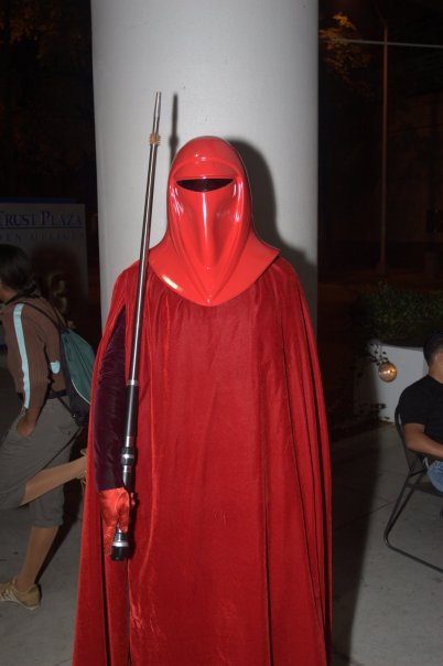

And I used the lower two segments of a now-discontinued floor lamp from target as the base for mine. It had a tapering shaft, and everything fit brilliantly -- plus, I can unscrew it in the middle for easier packing. *heh* This means mine is ultimately a couple inches too long, but no one really notices (except us who study it so obsessively) and I like the heft of it. My emitter end is just a bit of 5/8" stainless steel tubing, a machined aluminum tip to match photoscaling, and a quick-and-dirty hob made out of styrene strip, craft foam triangles (so it doesn't actually damage anything those spikes hit), and antique-gold Rub'n'Buff.

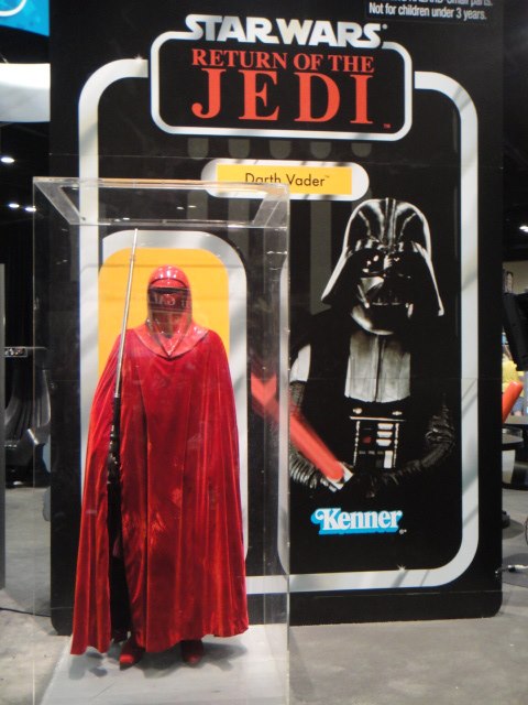

Here are a couple from the original costume test:
And here's mine, in context (as I said, I'll need to find my close-ups tonight):
1616_40809269797_326_n.jpg337770_10151117052839798_1168175456_o.jpg562815_3682015938071_1522005994_n.jpg
Nice costume! You got a pic with mr palpatine too!
That's a life highlight. They cycle people through the photo ops quickly, to try to get as many as possible done before the celeb needs to go back to their signing table or wherever. So they pointed me to cross behind him to the far side as he was still good-by-ing the last person. So I was just passing behind him as he was turning to see who was next... And no one was walking toward him. Took him just a mere moment to see that the people over there were looking past him and he realized the next person was probably already in position. He turned back, saw me, rocked back slightly, looked me up and down and, as he turned to the camera with that look on his face, said "Ah... I see you're dressed properly."

3d printed prototype was a success! The two halves of the grip section thread together and the fishing pole threads into the top :) It's smaller than I expected but I believe the size is accurate (it's just hard to judge size when you're working in 3d without much scale reference :lol)
roygilsing is currently working on some perspective matching against the reference photos to see what tweaks I need to make to the model, preliminary results suggest the main tapered length needs to be longer and thinner which is what I suspected but generally it's lining up pretty well :D
