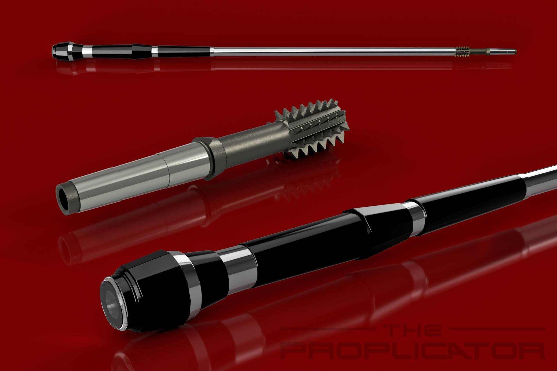

This is likely the final design and render I'll do of this unless I or someone who wants to help physically gets hold of the prop, so here we go in all it's newly redesigned glory:
Some of the more eagle eyed might notice some tiny changes I'll be making before this actually goes off to the machine shop but the final version should look pretty much exactly like this :)

It'll be in three main pieces, the gear hob tip will be one piece, the tapered shaft will be one piece, joining the grip section at that collar, and then the grip section. The large pommel piece will screw off the grip section and obviously the acrylic piece will be seperate, otherwise it's one hollow piece :) It will all be CNC machined (mostly aluminium, anodized where it should be black, steel for the gear hob and acrylic for the clear pommel cap)
Having the grip section split into the various parts was considered for ease of finishing, along with machining the black parts from delrin but ultimately I felt it would add too much complication/cost and therefore be less likely to actually get made :)

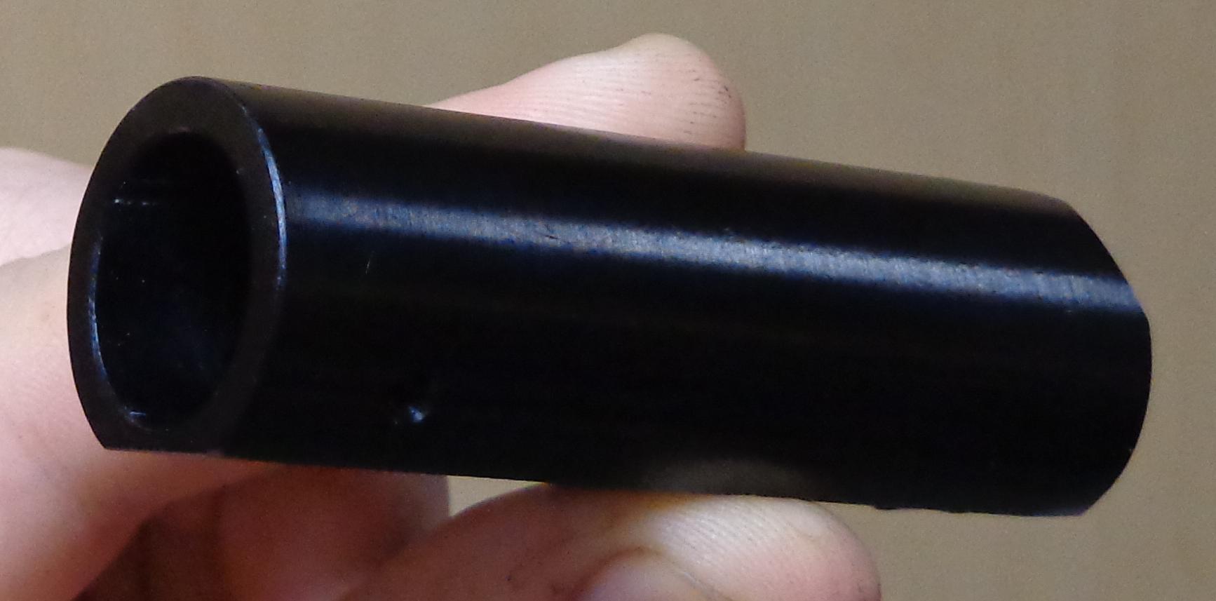

You'd want some large capacitors for that ;) If it helps I can tell you that the internal space in the grip is rougly 22.22mm or 7/8" in diameter by over 200mm or 8" and a further section 19mm or 0.75" in diameter by over 60mm or 2.5". The grip section is pretty much as hollow as it can be without compromising strength, I don't expect people will full strength sword fight with these but I'd like them to stand up to the rigours of costumed trooping etc.
An interesting piece of extra info I got from the hi-res prints; most of the grip was bored out to accomodate "EMA TUBE (FOR BATTERIES+LIGHT)" which leads me to believe that the clear/frosted pommel end seen in the reference pics was originally intended to light up, although I'm pretty sure this wasn't seen on screen.

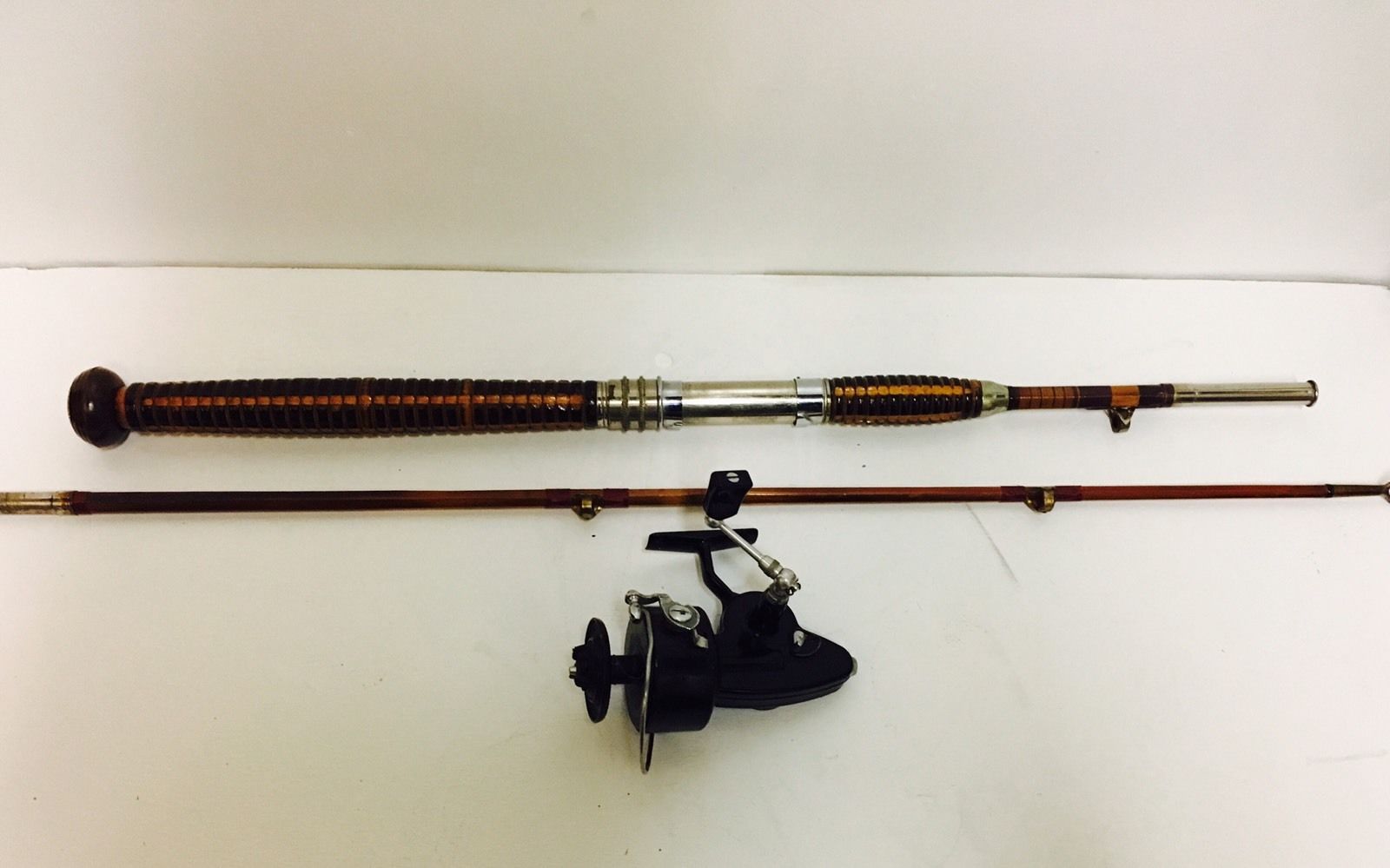

Also, the lore I've run across is that they used the same deep-sea fishing poles as were used for the rods lining the walls of the Death Star II's reactor chamber miniature. Dunno how accurate that might be, as the props and costumes were largely done in the UK, and the models and miniatures were done at ILM.
Aaahhh so it’s more of a fishing spear then rod
When everyone was talking about fishing rods I keep thinking of a flimsy pole
Like the lightning hook on the back of the delorean, which was a fishing pole
Now a deep sea fishing spear. I totally see it

Not a spear. Deep sea fishing poles are thicker and sturdier than lake and fly fishing sorts of gear. Look at a marlin or a swordfish. One needs something that can handle that. Most deep sea poles are segmented or telescoping. The pike could have been made from the handle end, with the open end where the rest of the pole was supposed to be fitted being where the hob gear cutter went. Something like this vintage bamboo piece -- only newer (and, hopefully obviously, not identical):
