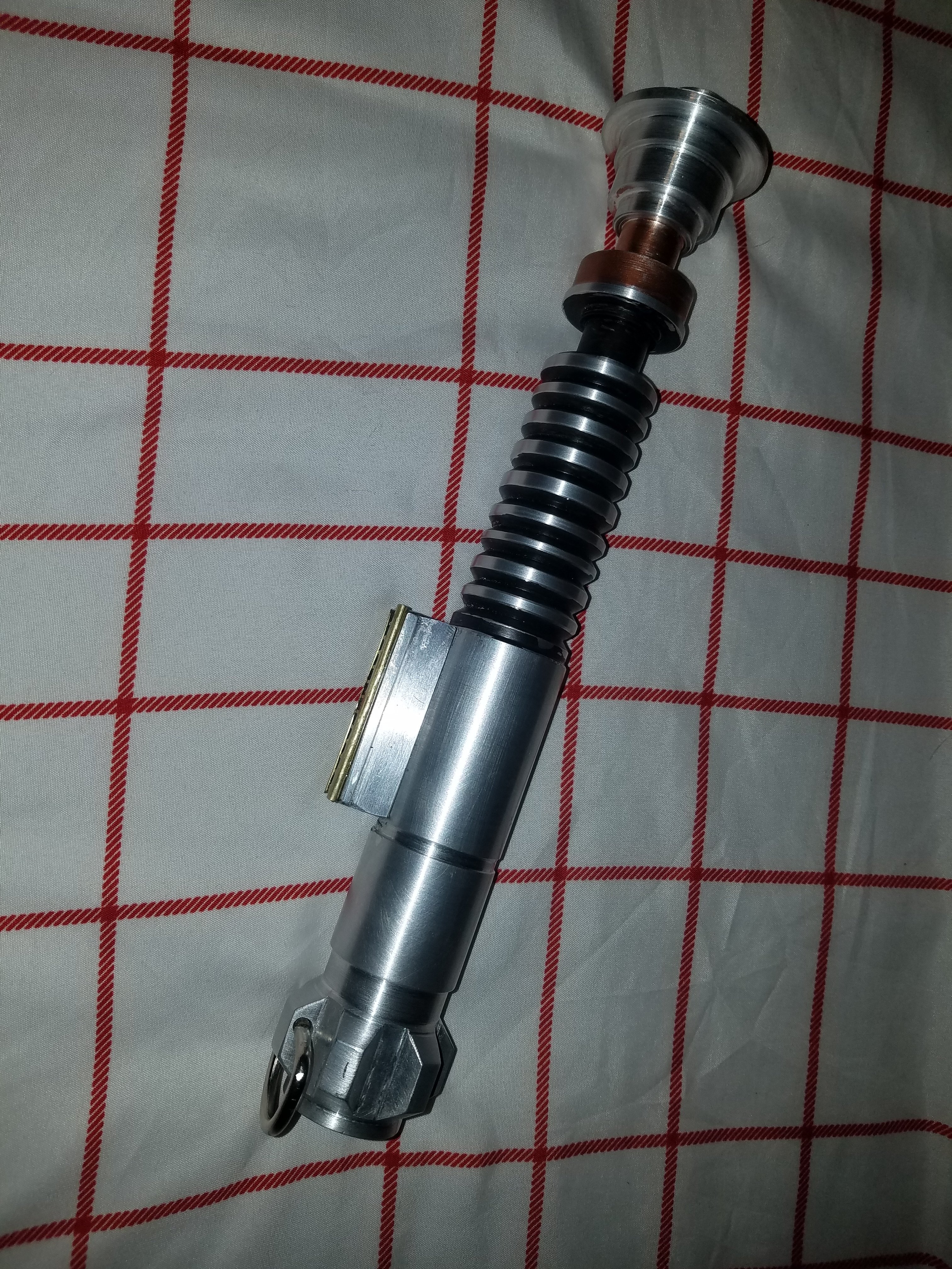

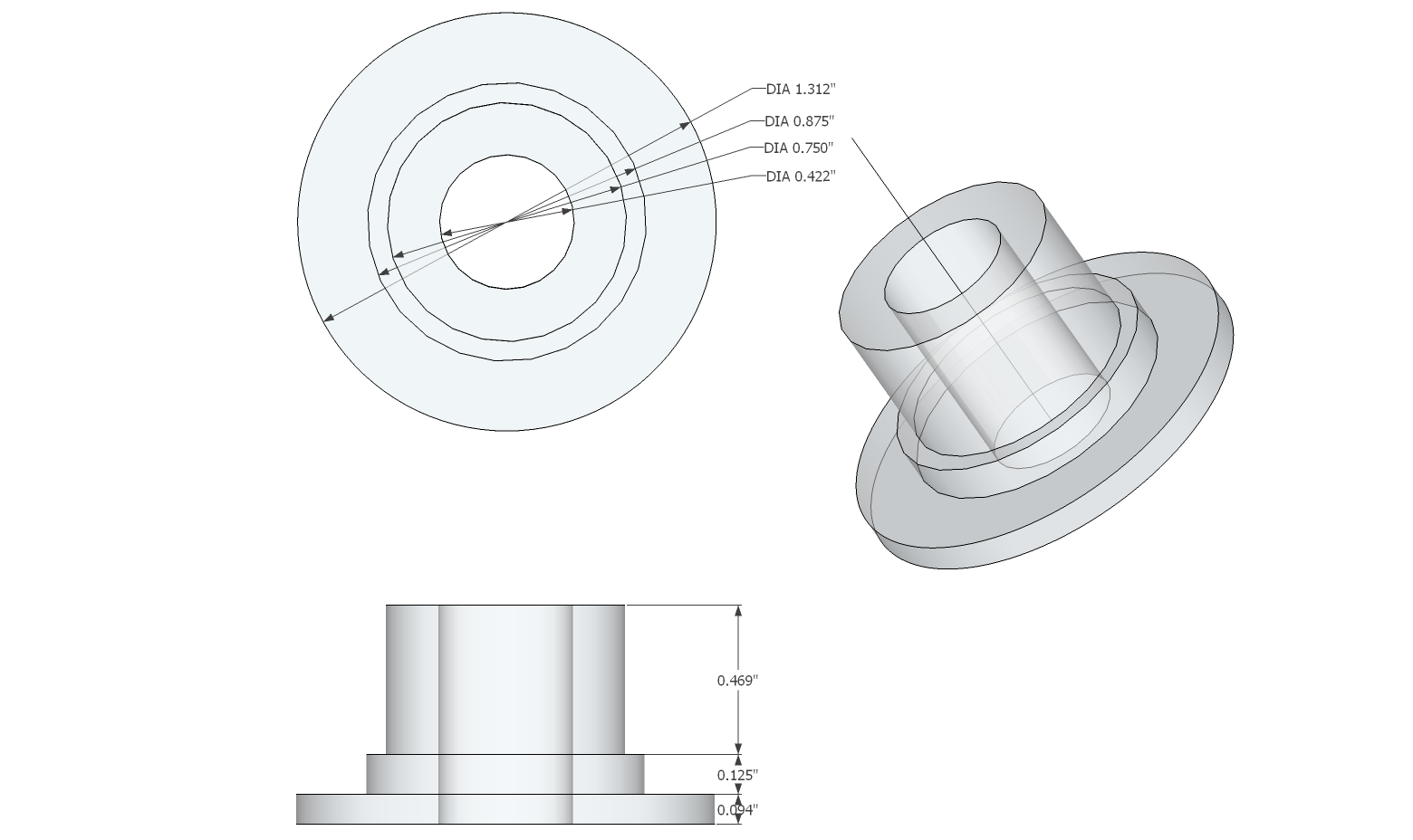

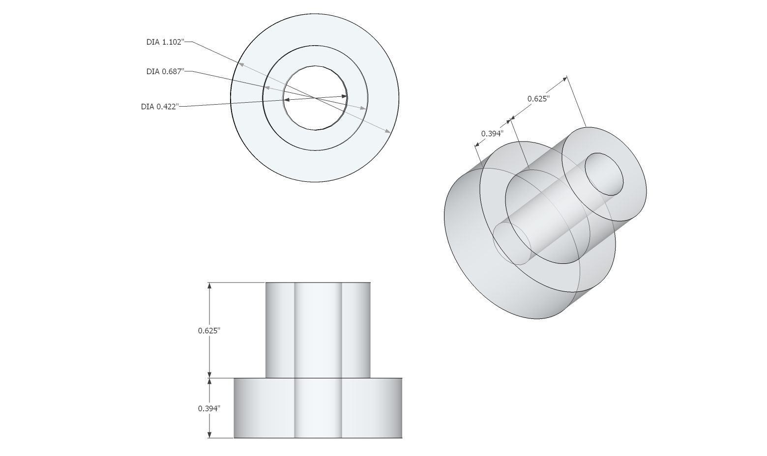

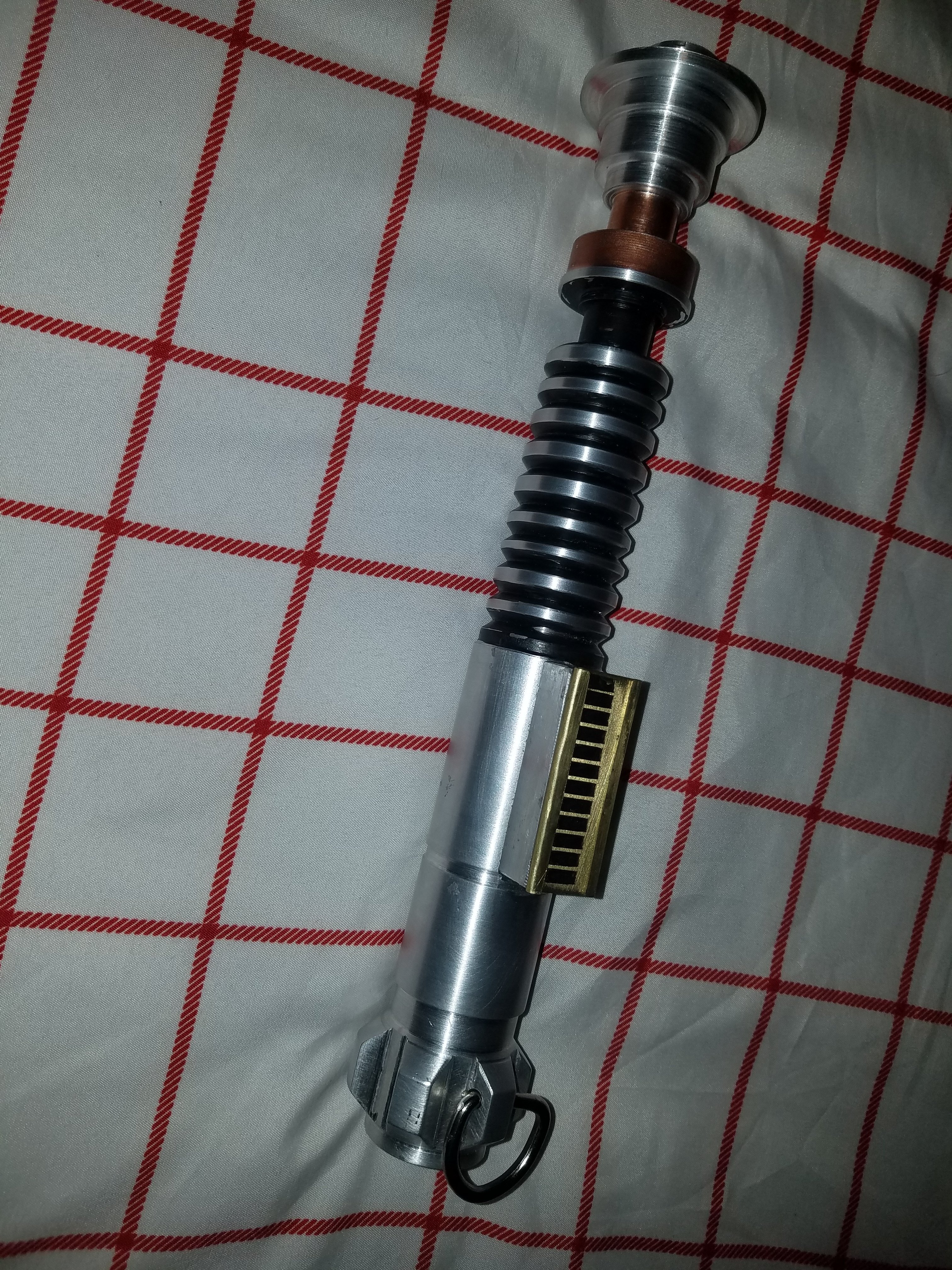

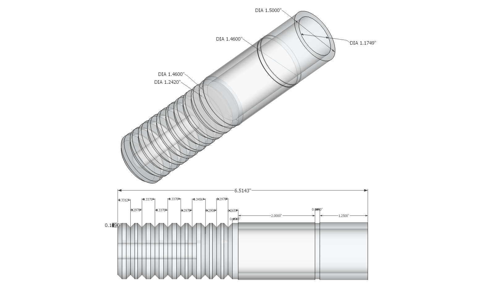

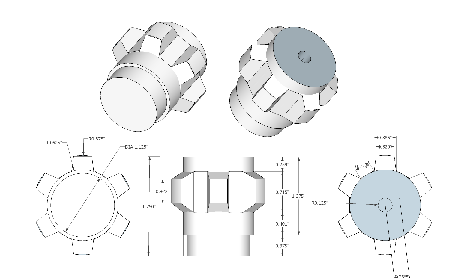

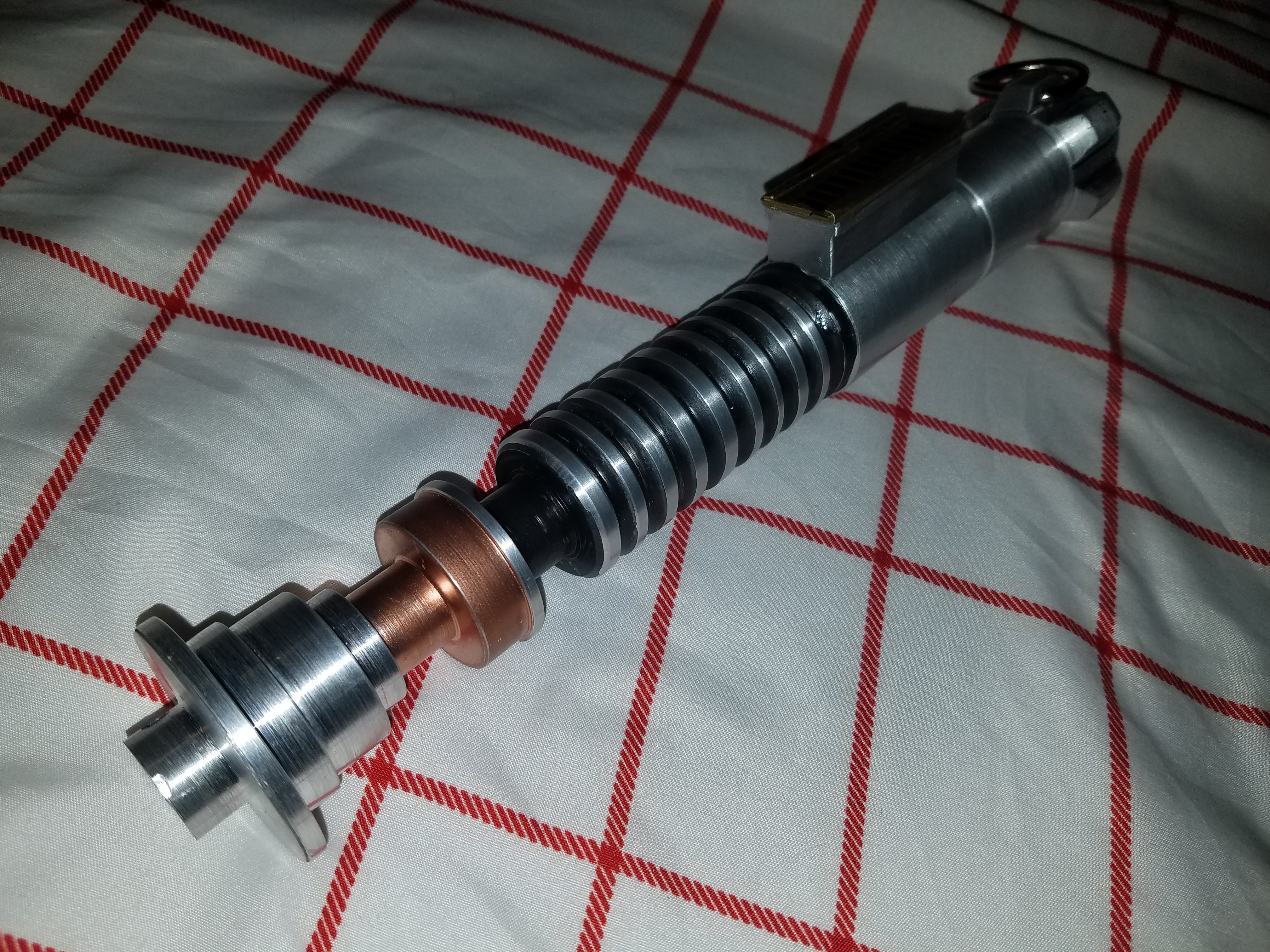

I have started making a ROTJ Luke Lightsaber, for a near future run.
This is 100% manually machined out of Aluminum brass and steel. I am doing full detailed build videos so you can see how they were made.
Primary goals:
1. Complete video log of the entire process
2. Accuiracy
3. Durability and everything being positively affixed (ie no glue)
4. Additional features like room for electronics

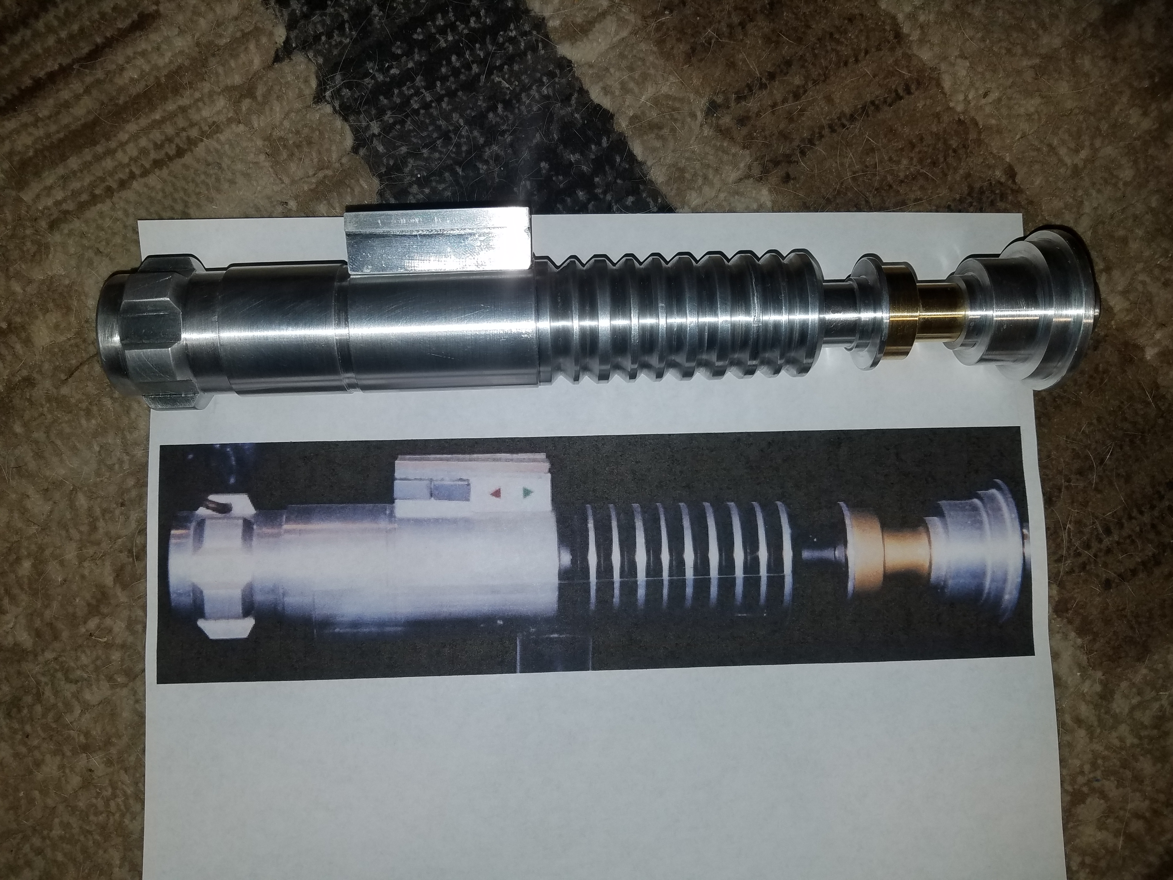

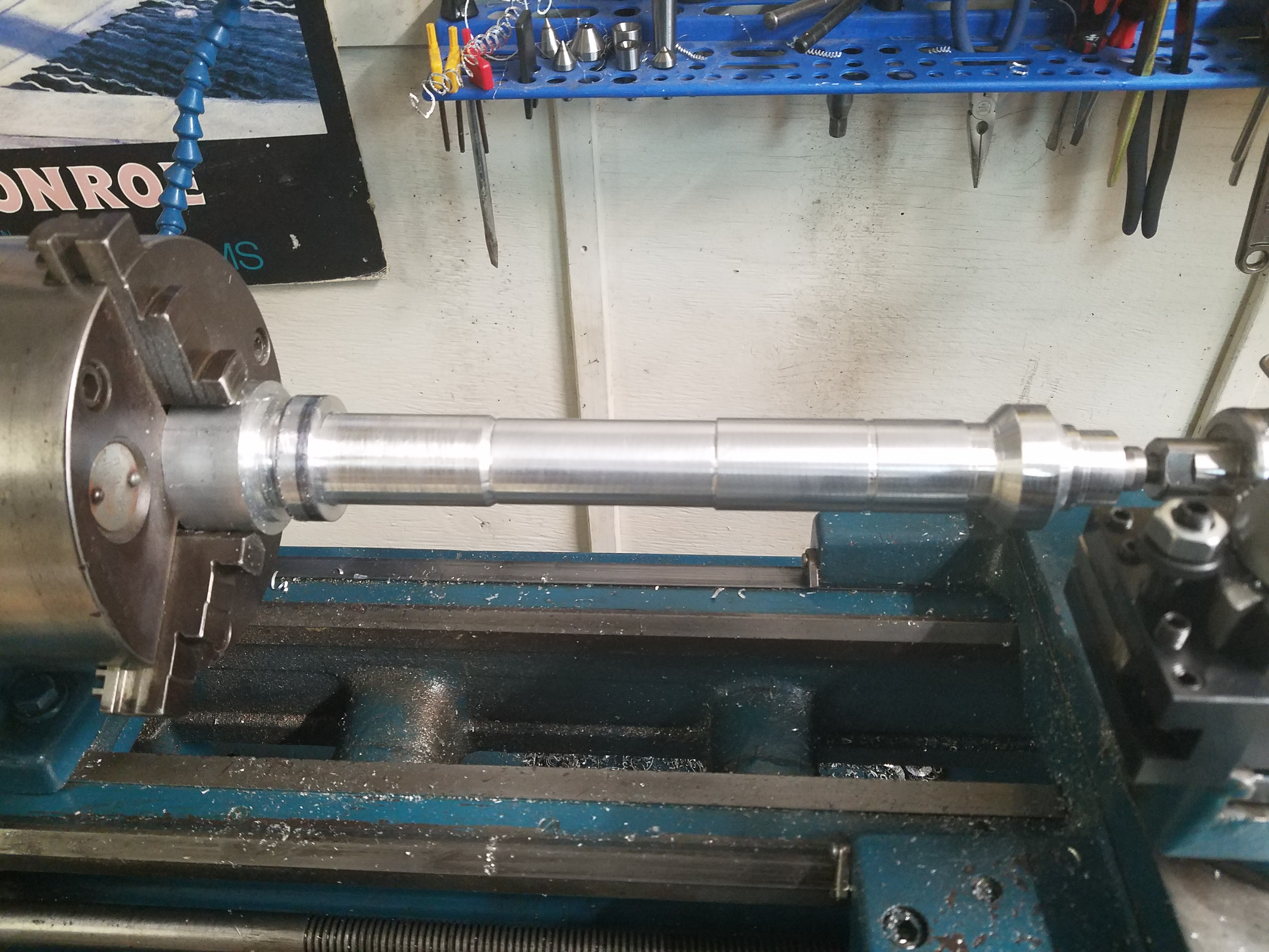

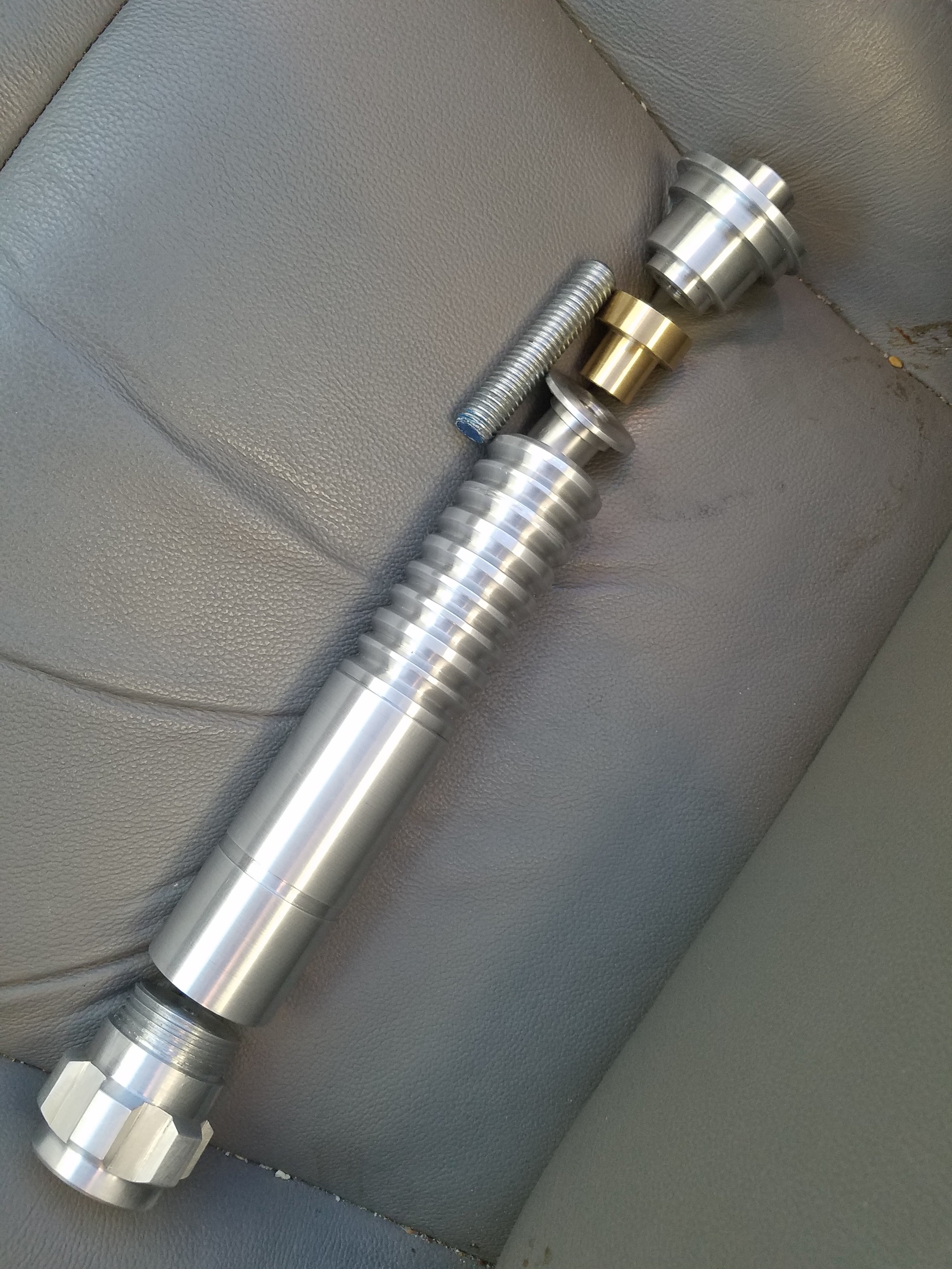

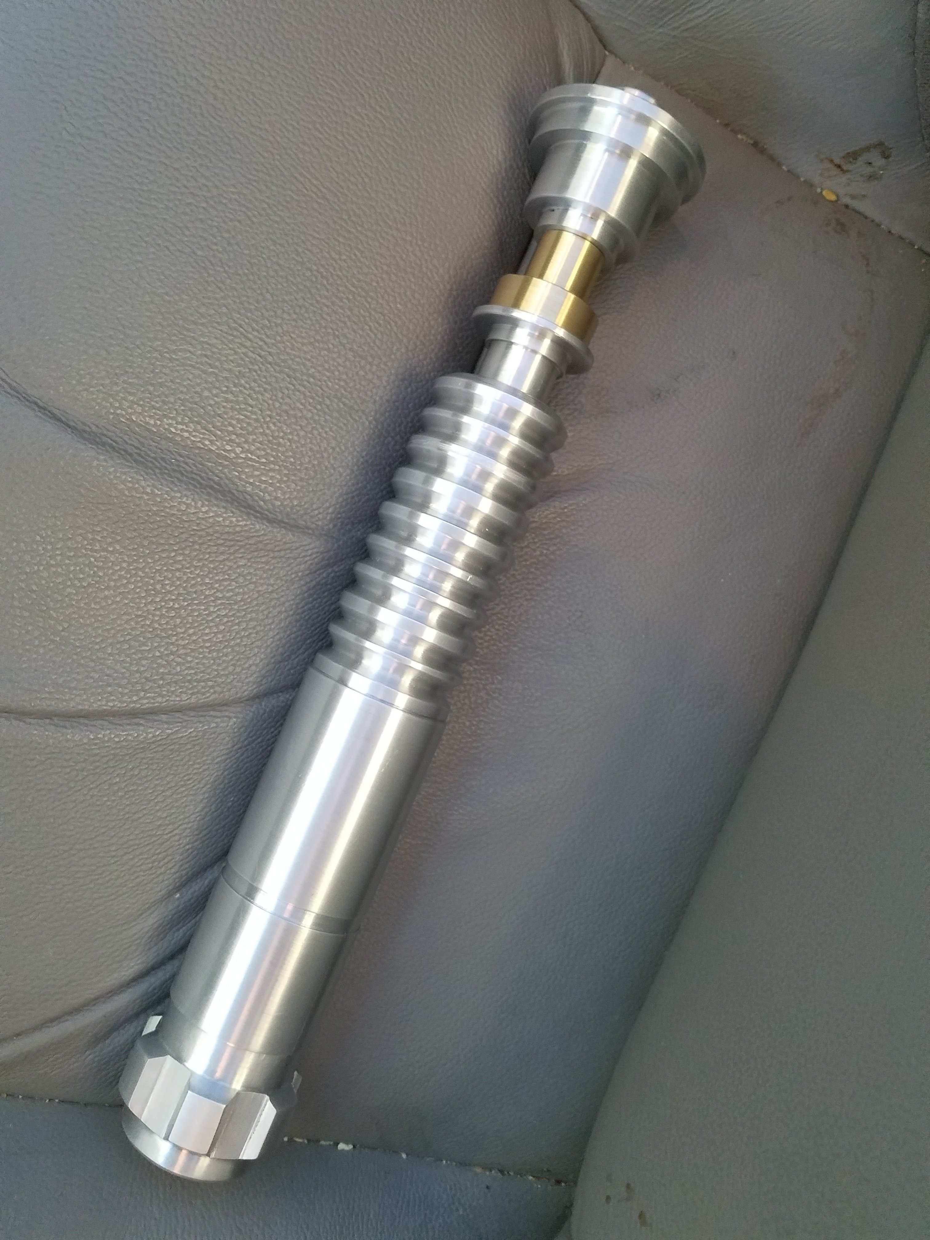

Here are some images of the first prototype being machined and completed.
This one was done as a single 12" piece of aluminum. This was difficult to machine due to the plunge cuts and the fact that any mistake ruined the entire piece. In the end it was still pretty nice.

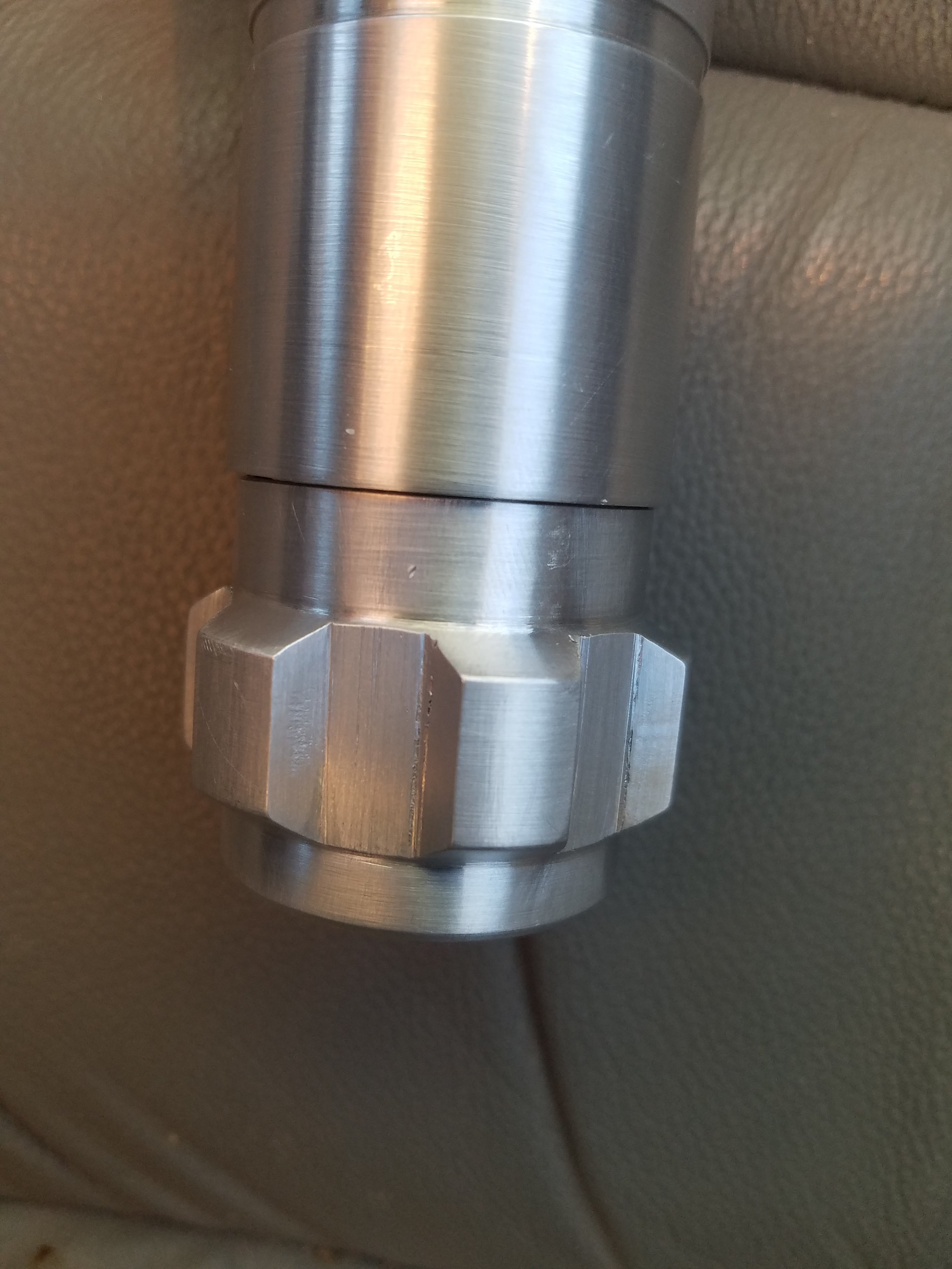

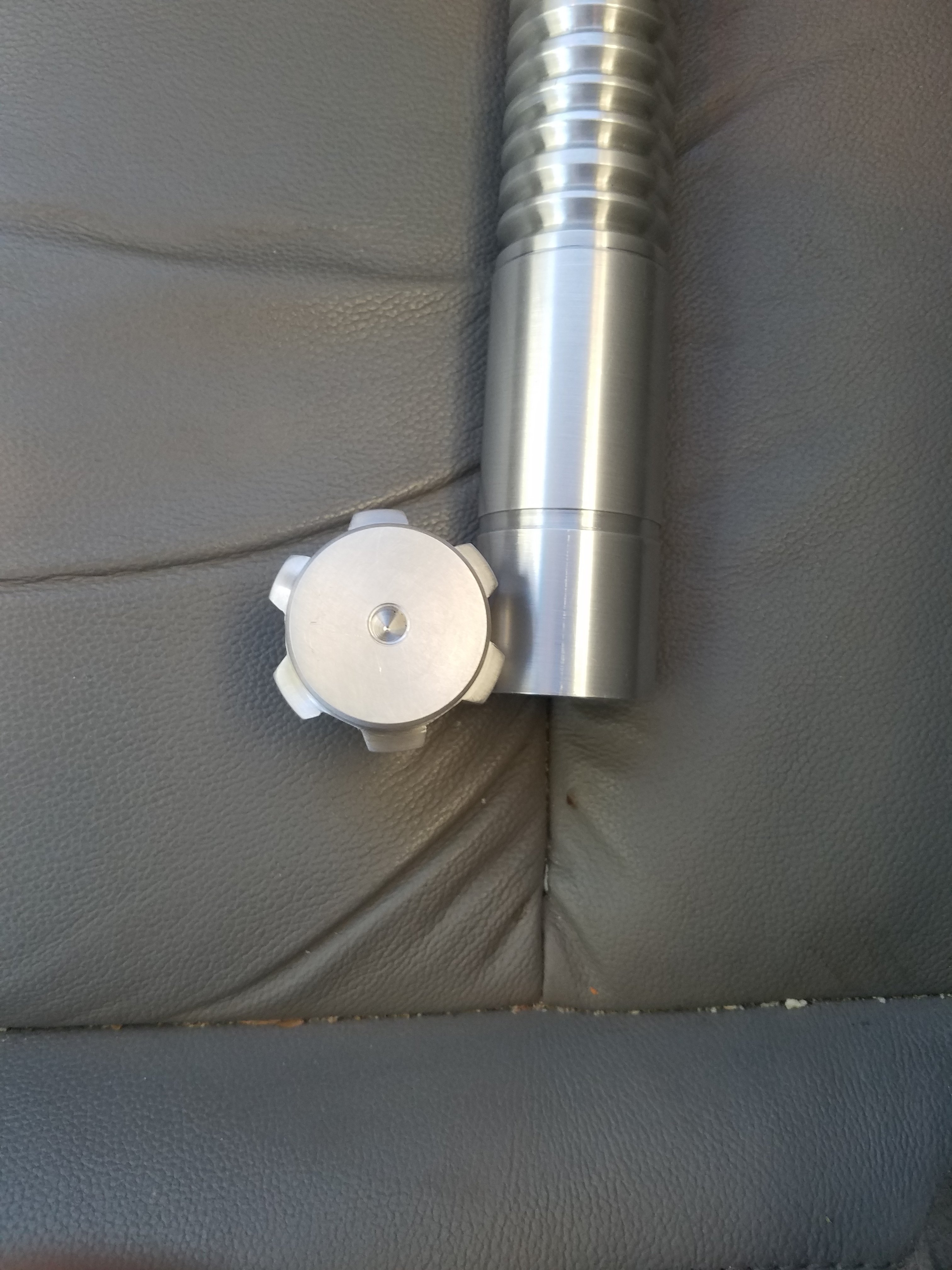

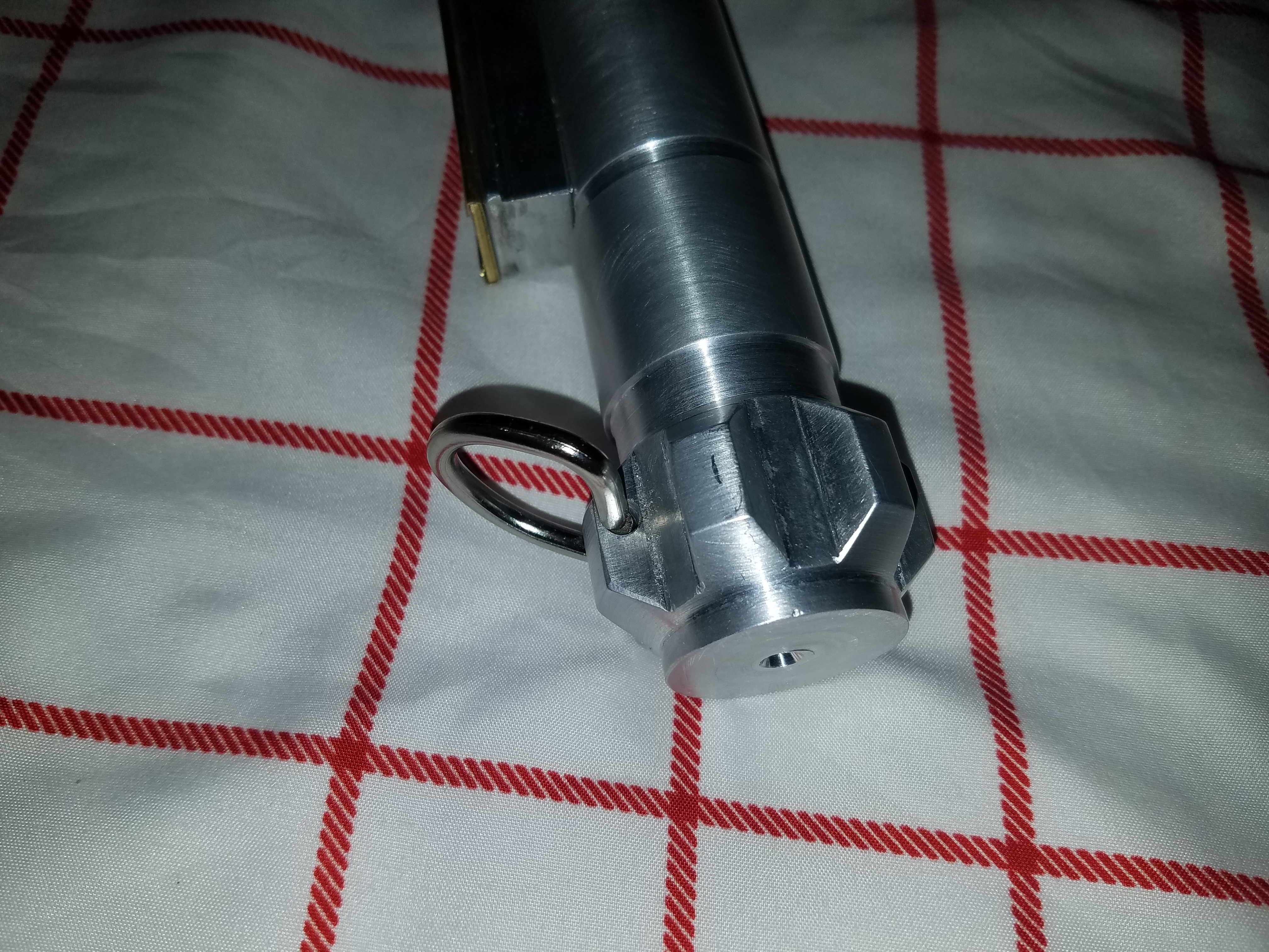

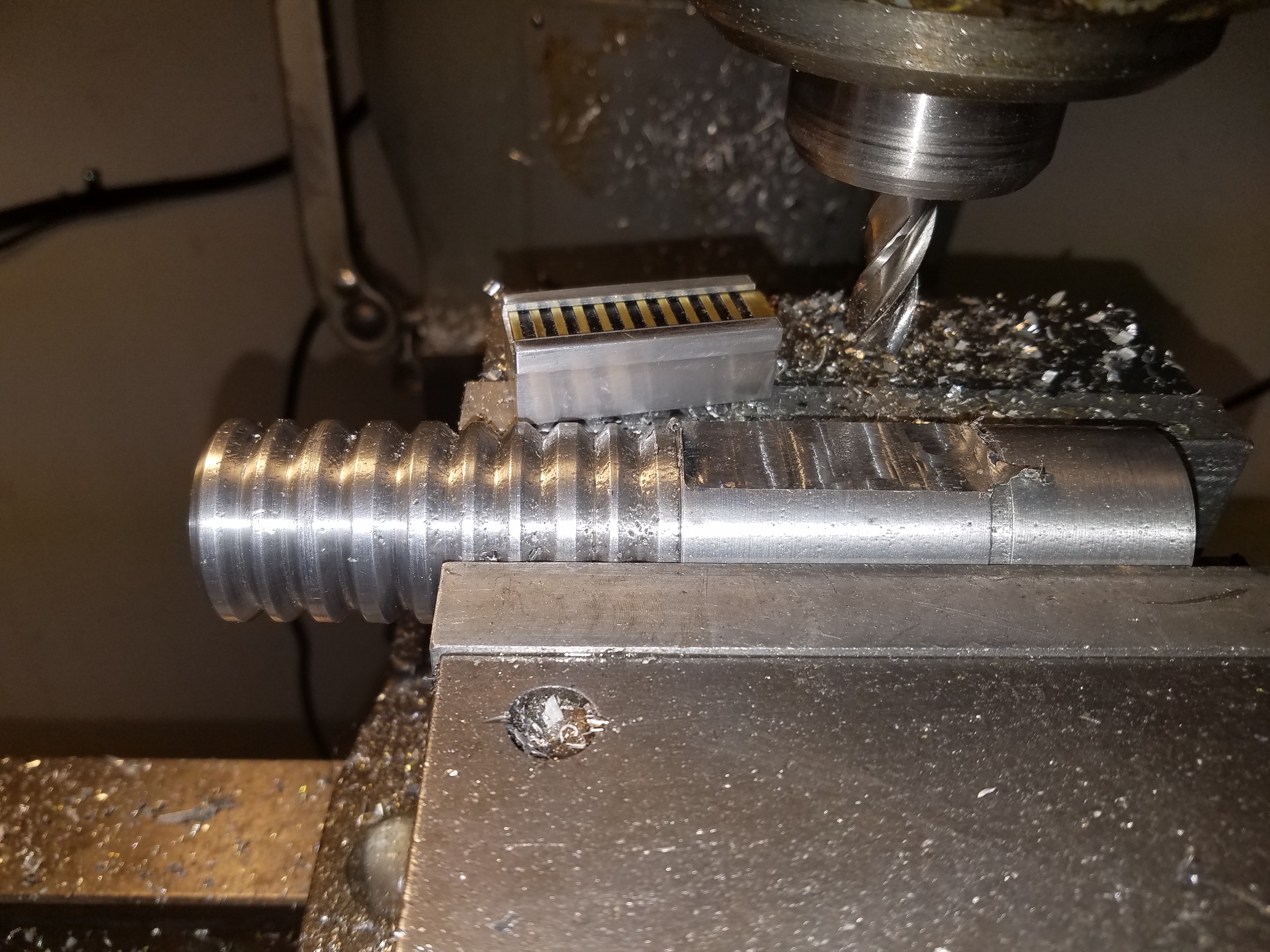

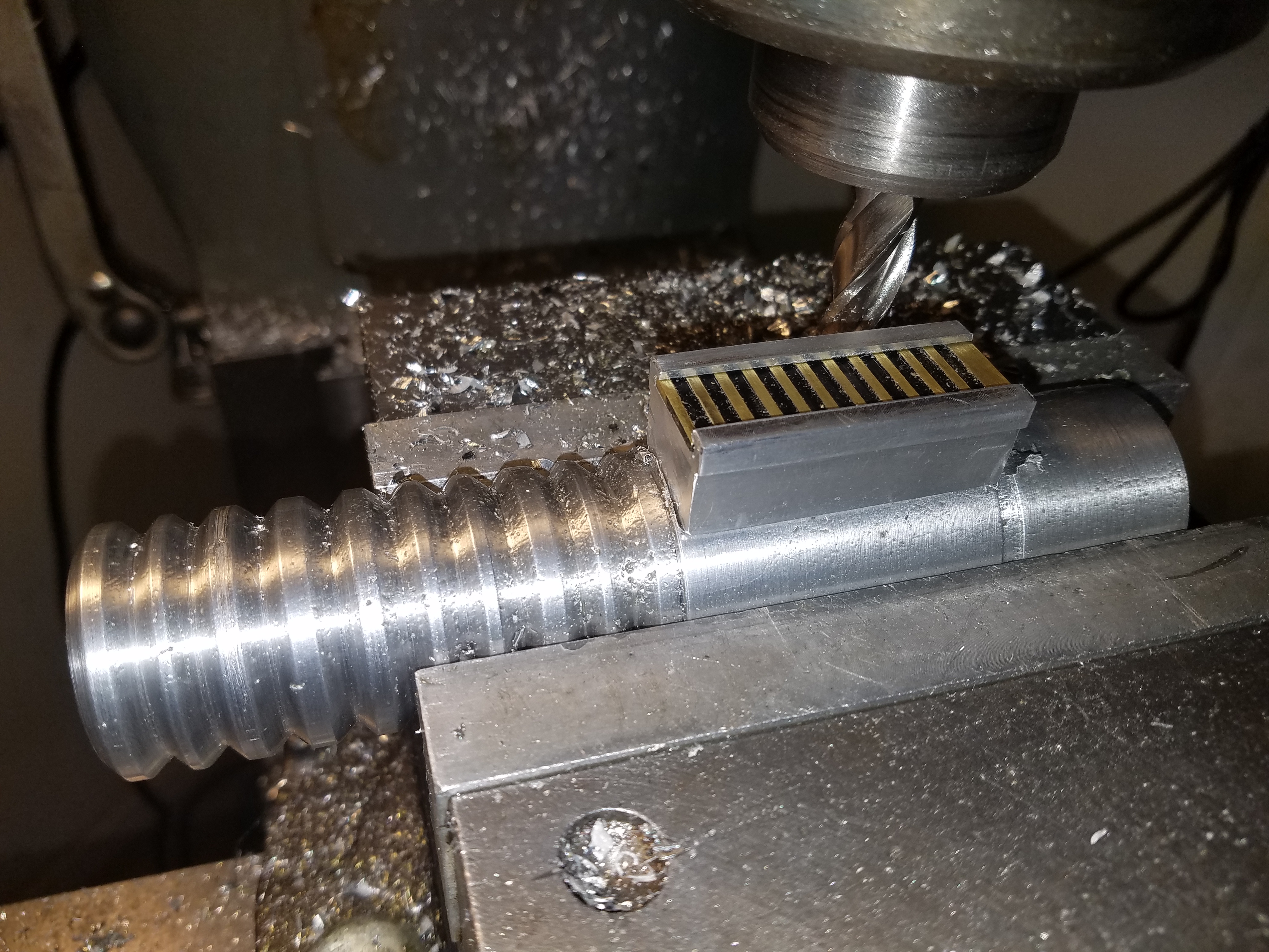

This is nuts!! I always wondered how the pommel cubes are cut
Any chance could you make me a short video of how you actually cut the cubes?
Ask and you shall receive:
The index head in the mill is normally used for cutting gears, it has been an experiment for me as I am not an experienced machinist. This project as a whole has been a self training exercise.

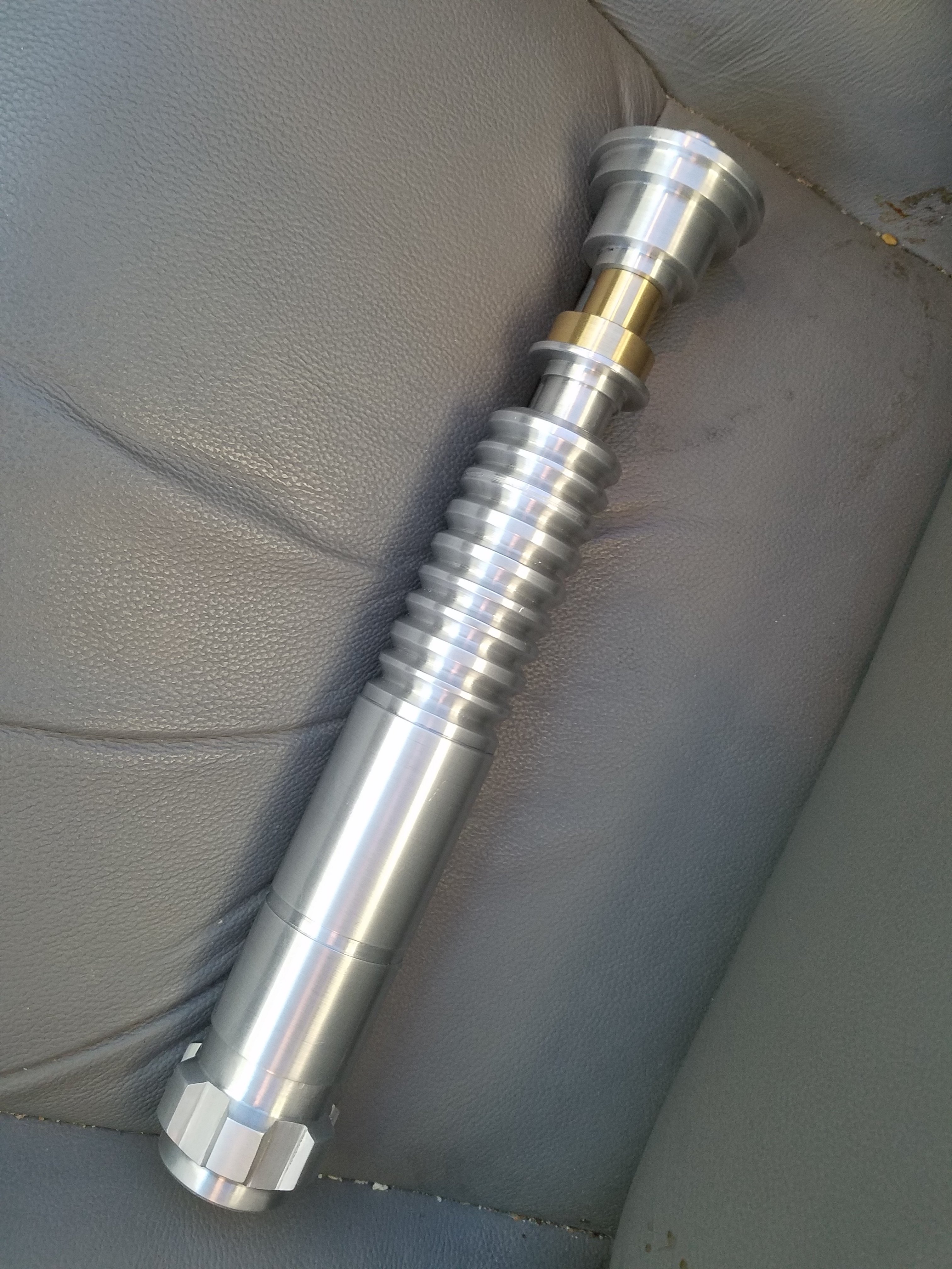

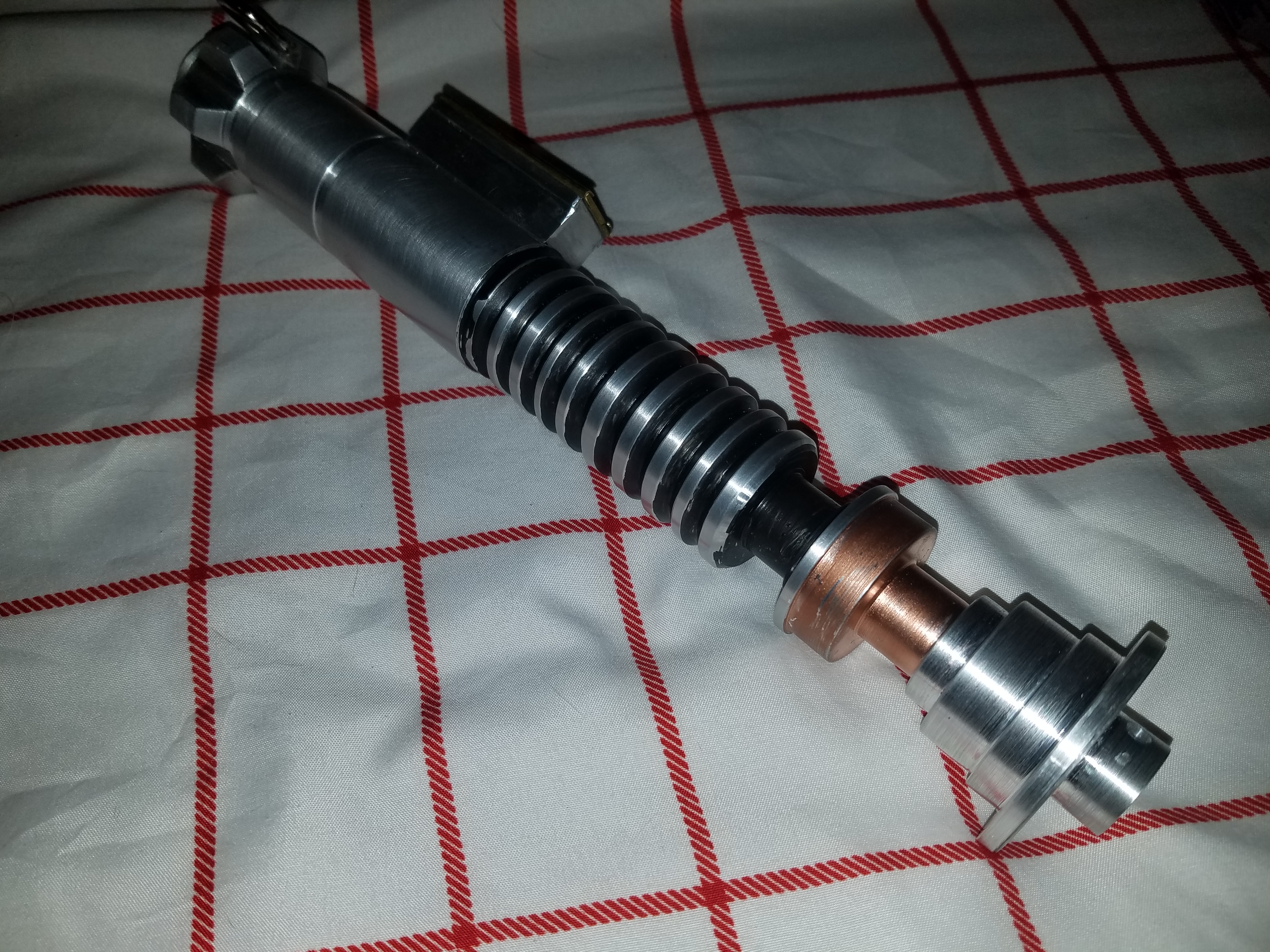

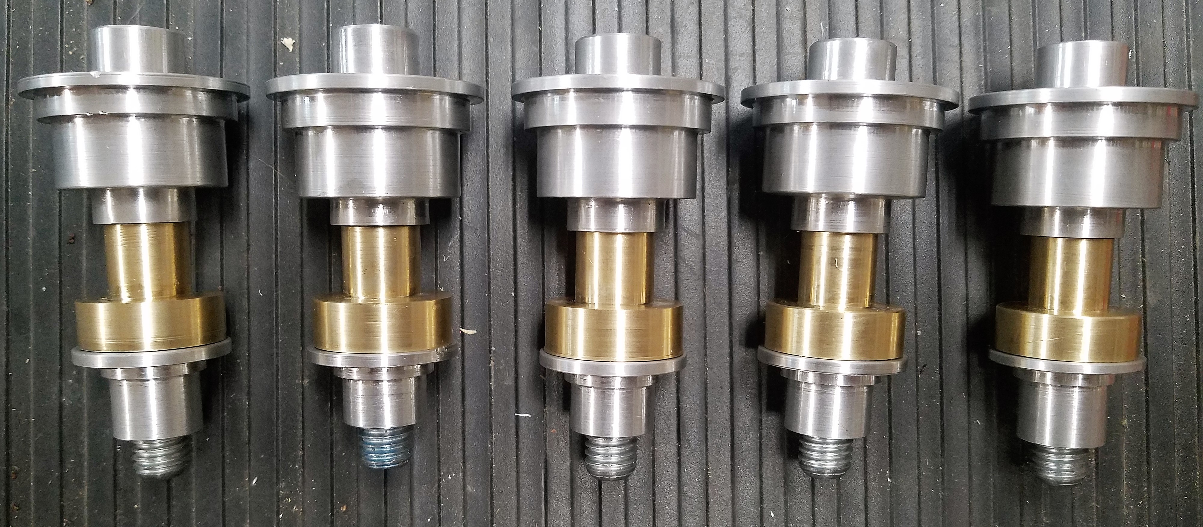

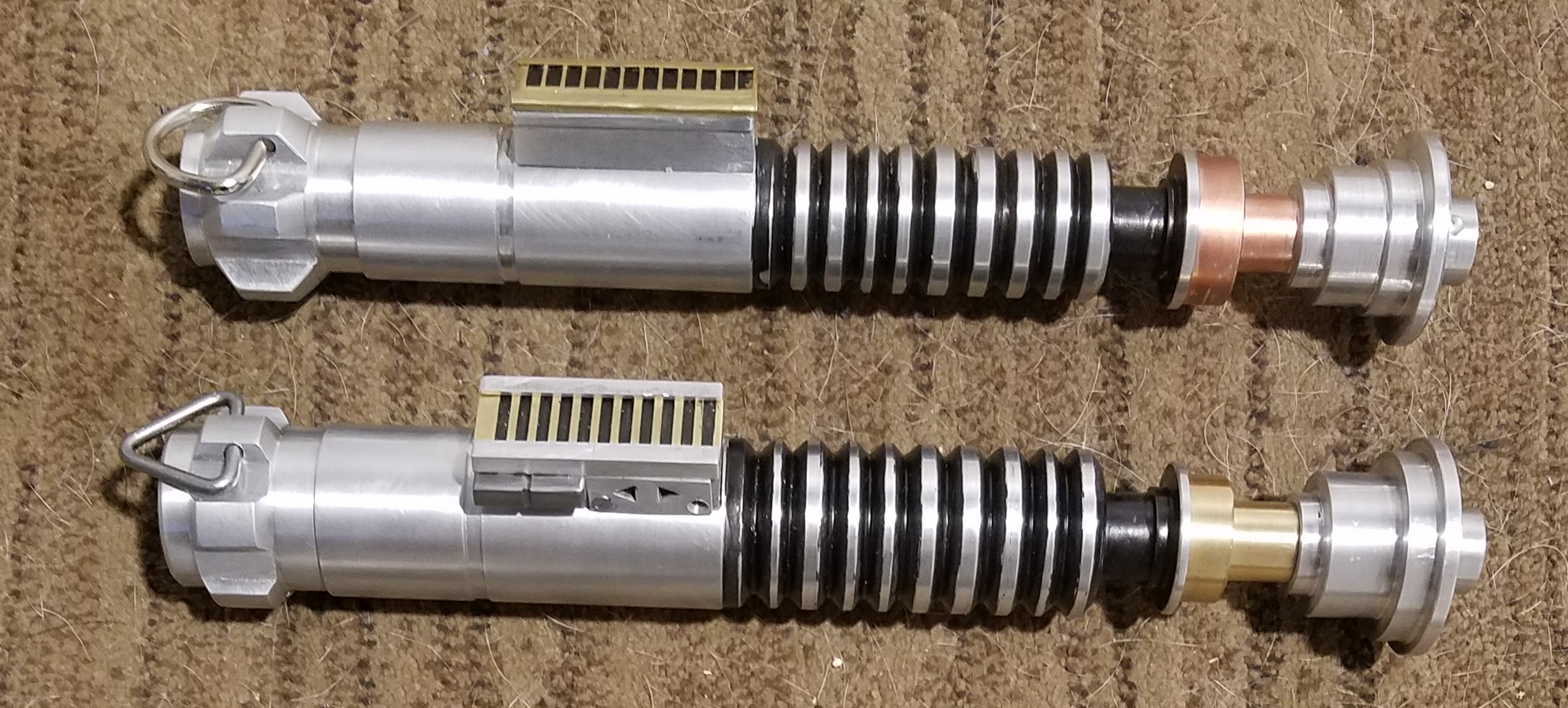

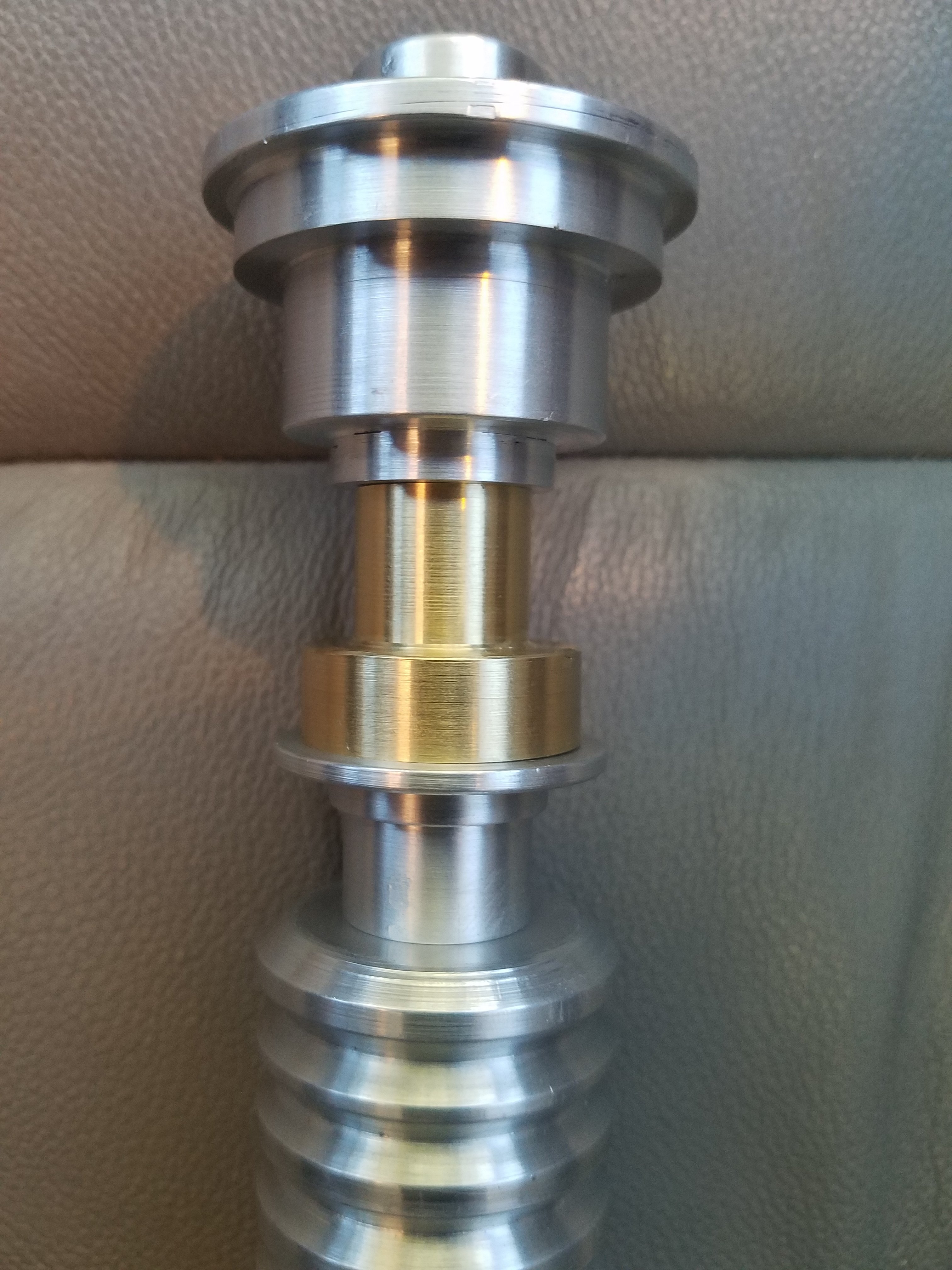

Some pictures of second prototype with individual components.

Yes of course, I was actually planning to do a full machining video of making all the parts.

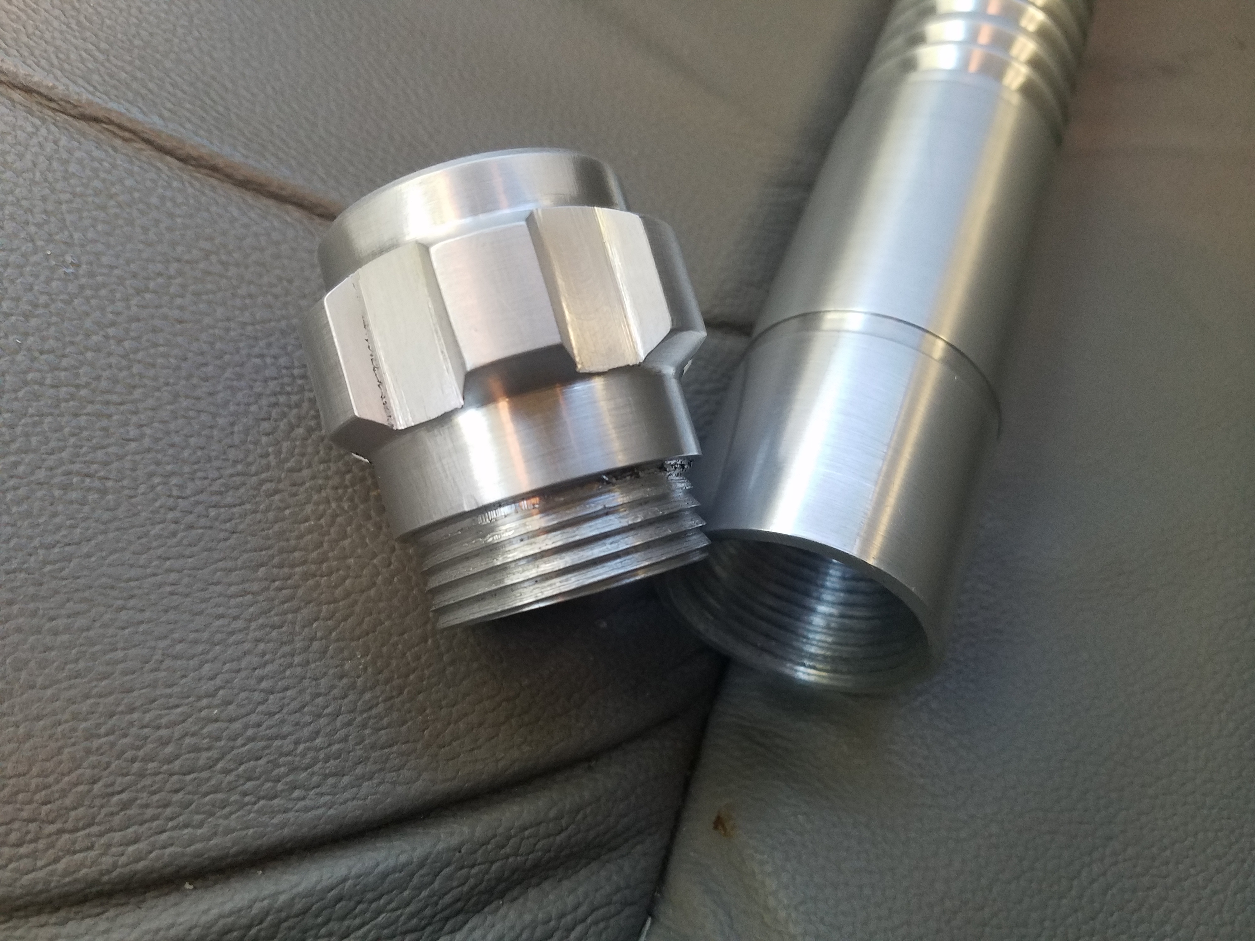

A little out of order, but here is the First prototype I did out of a solid piece of aluminum. The in progress pics of it were in the first post, these are the finished version.

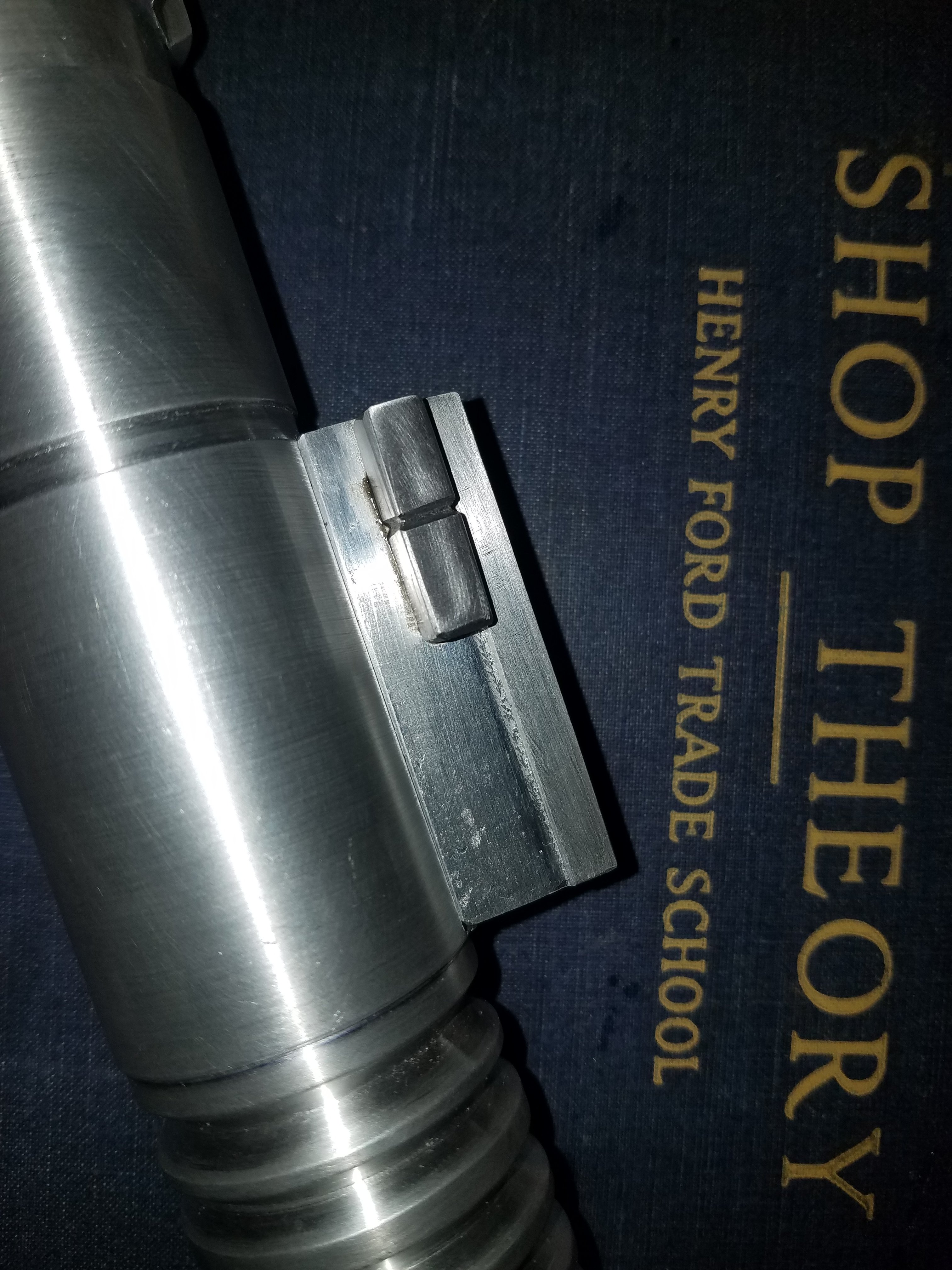

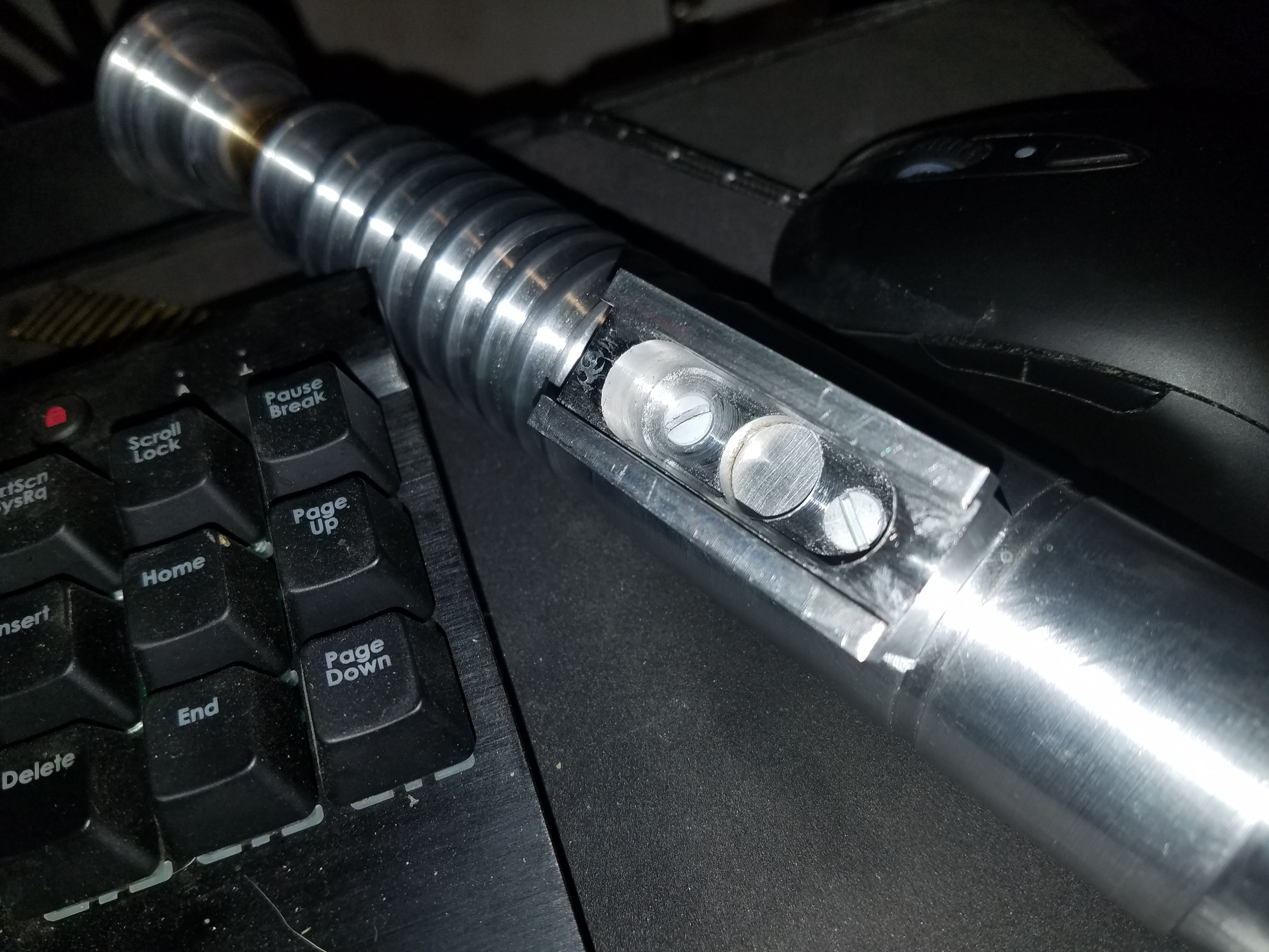

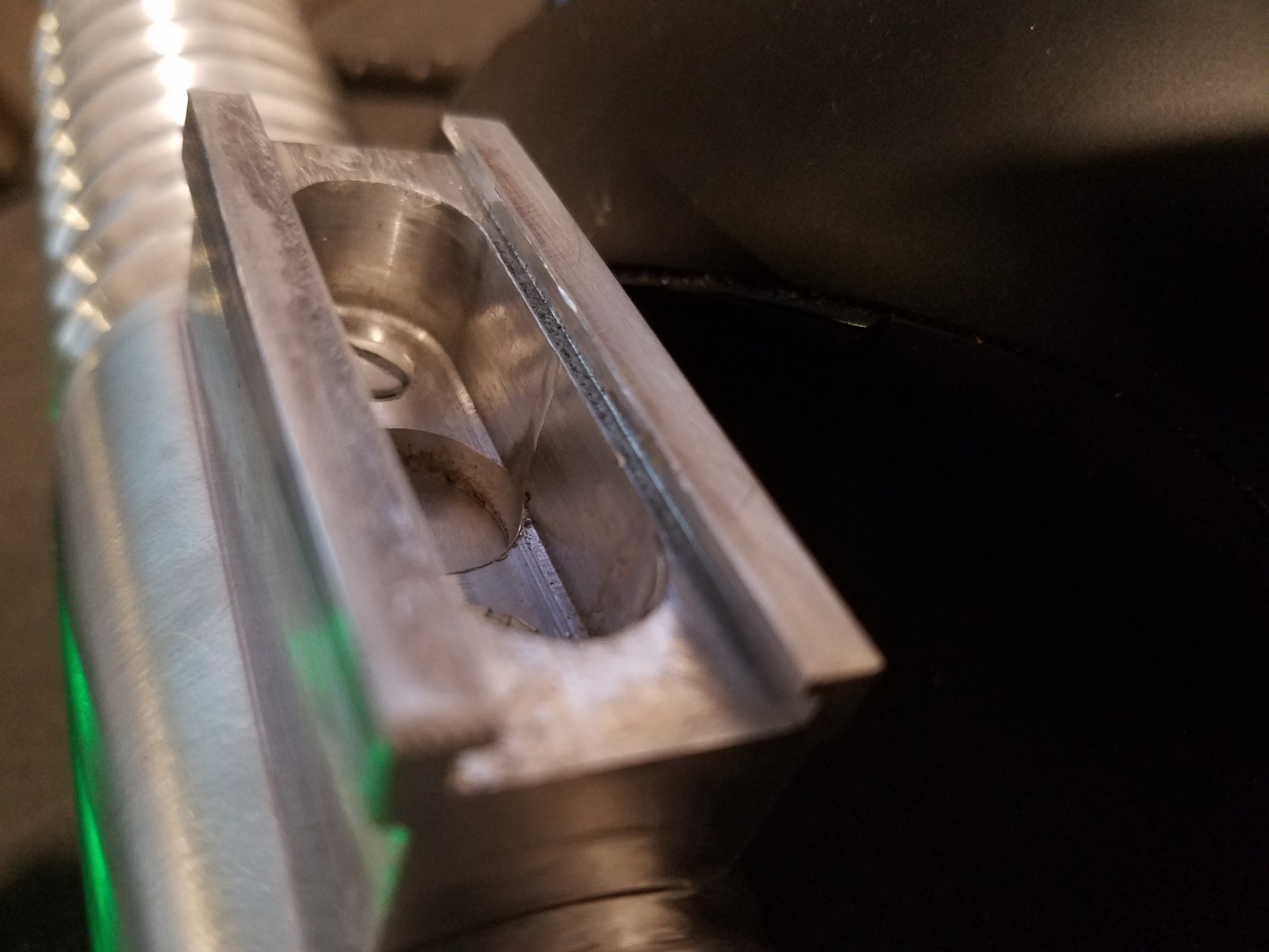

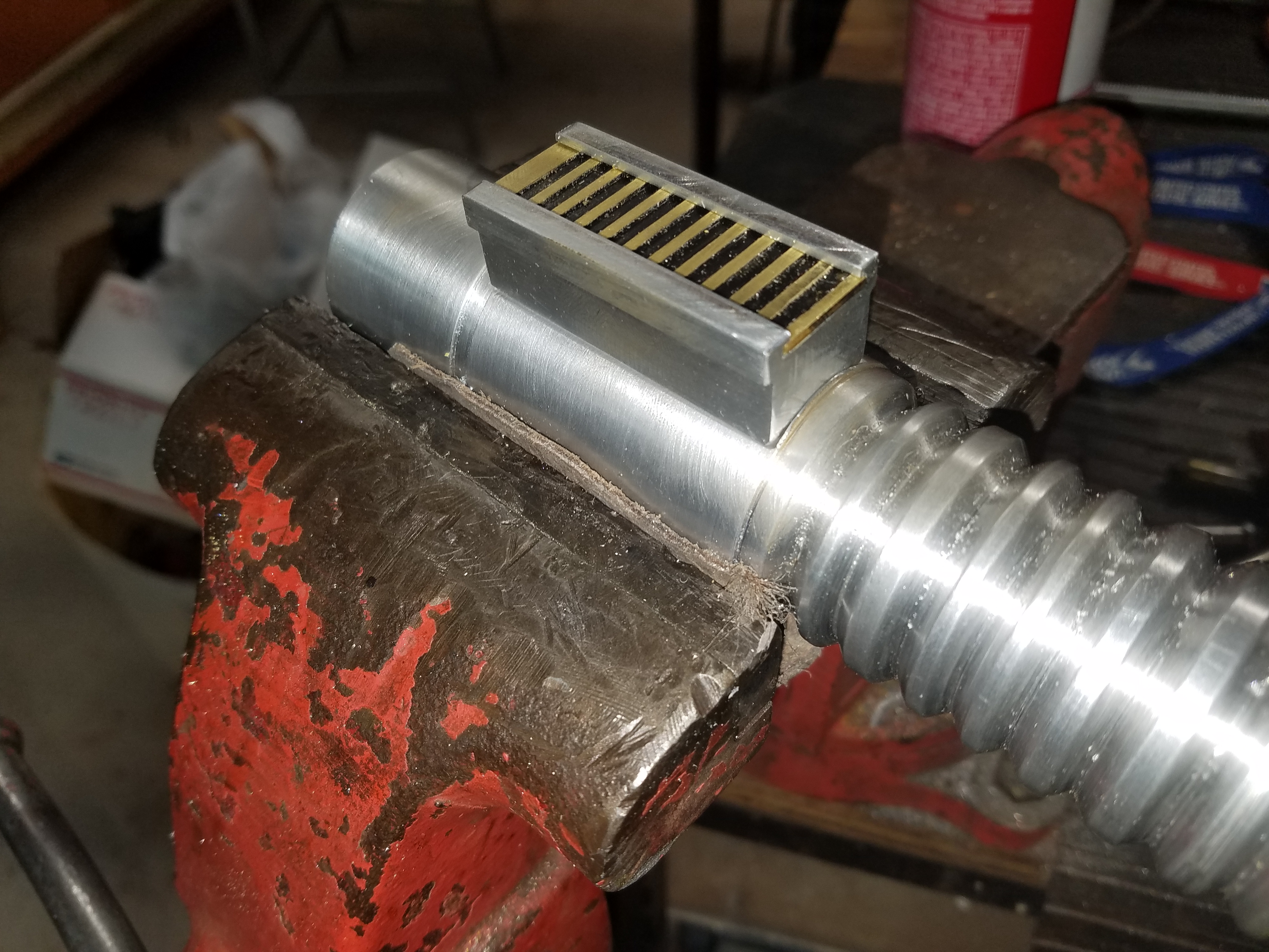

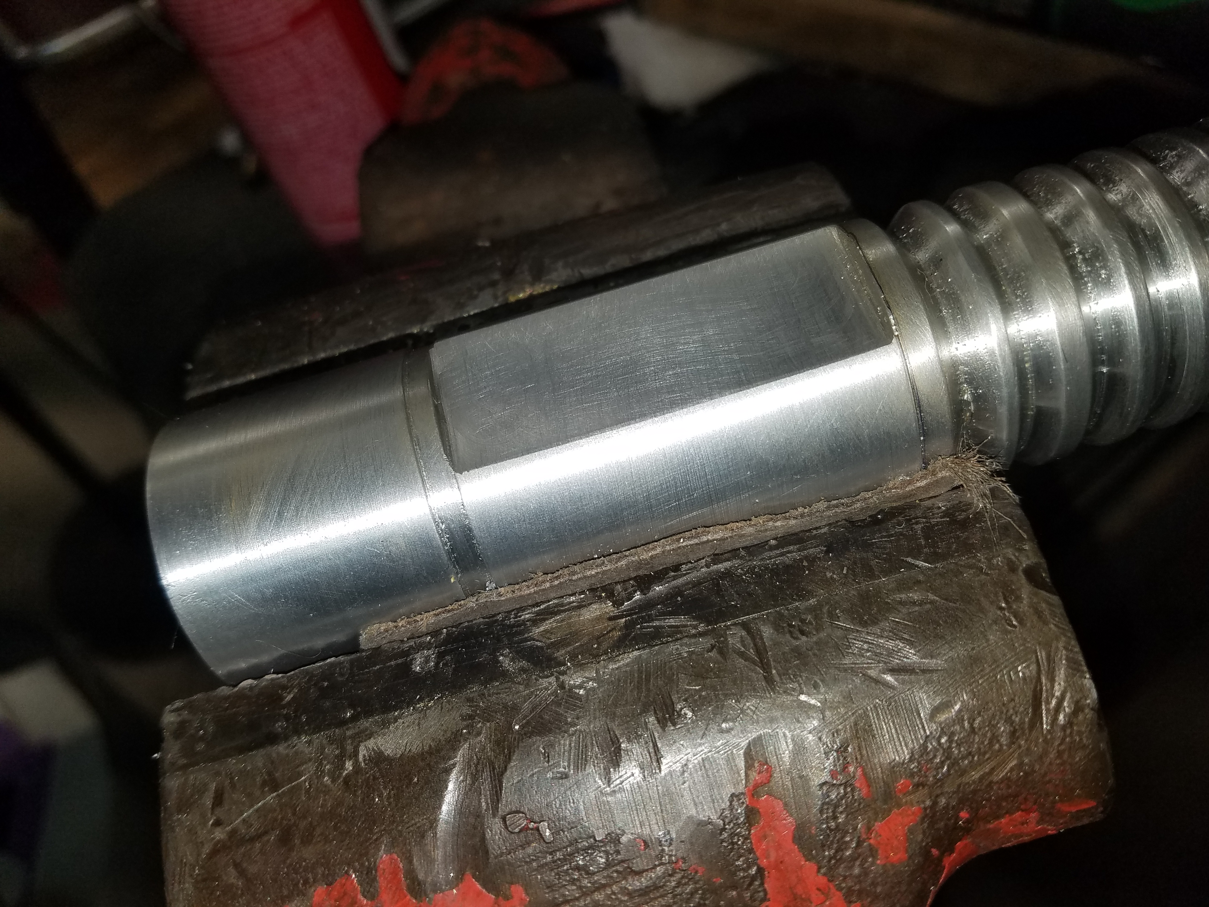

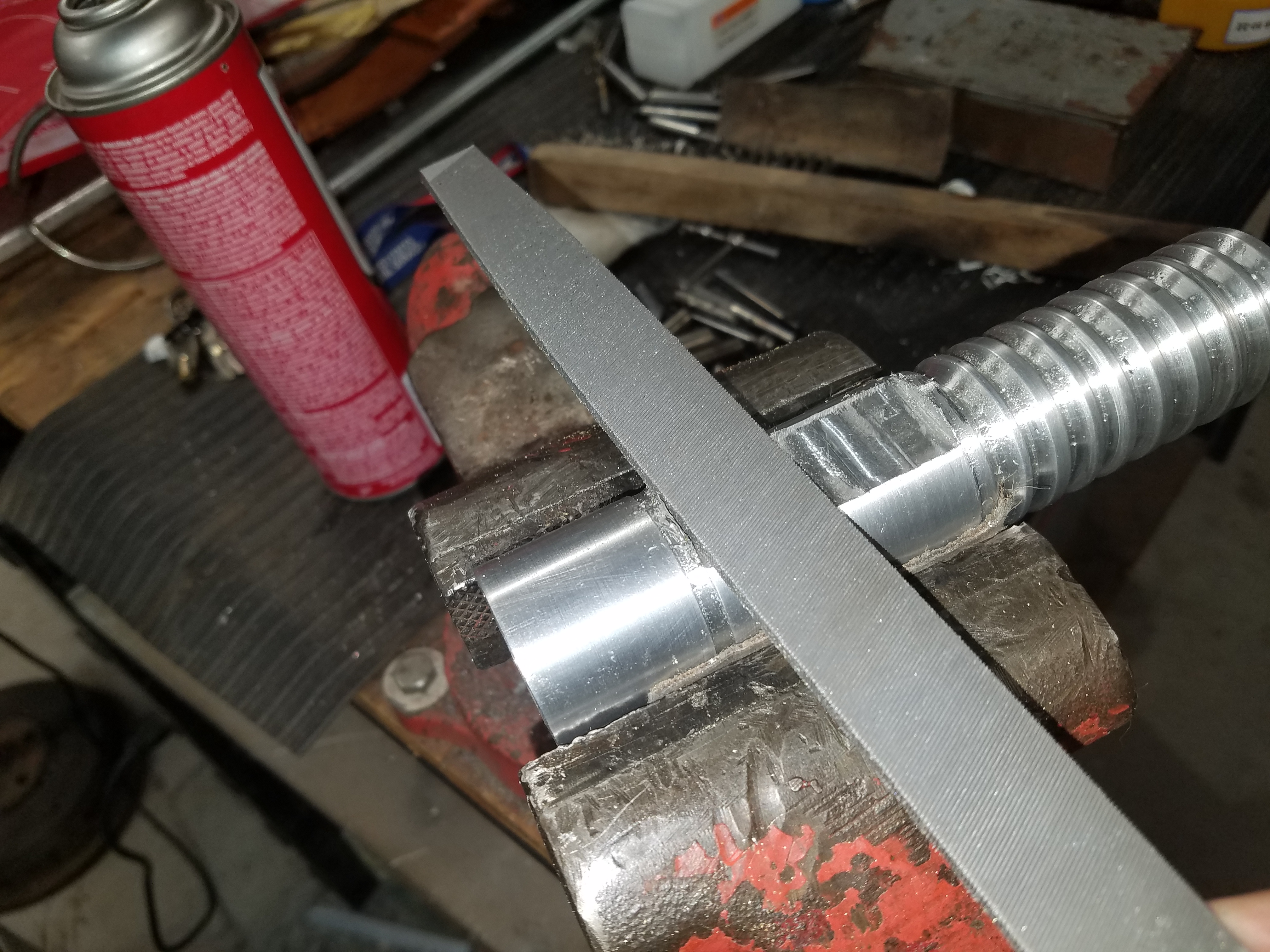

I still need to hollow it out. I'll also machine a flat on the saber where it mounts,then drill and tap holes to screw it to the main saber. I may also machine a hole into the actual saber hilt for wiring access if someone desired to utilize it.
Ok, did the steps in the previous post

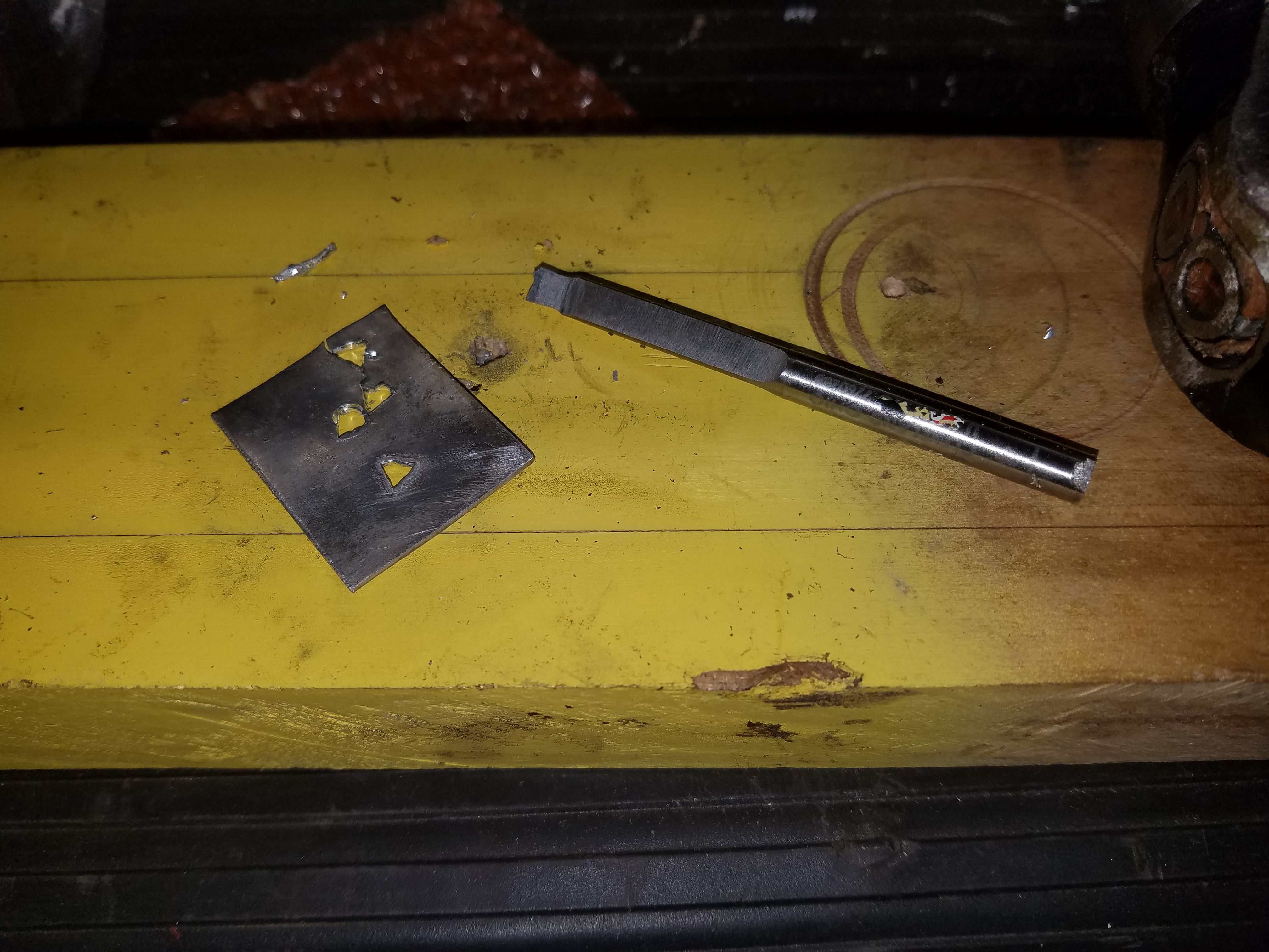

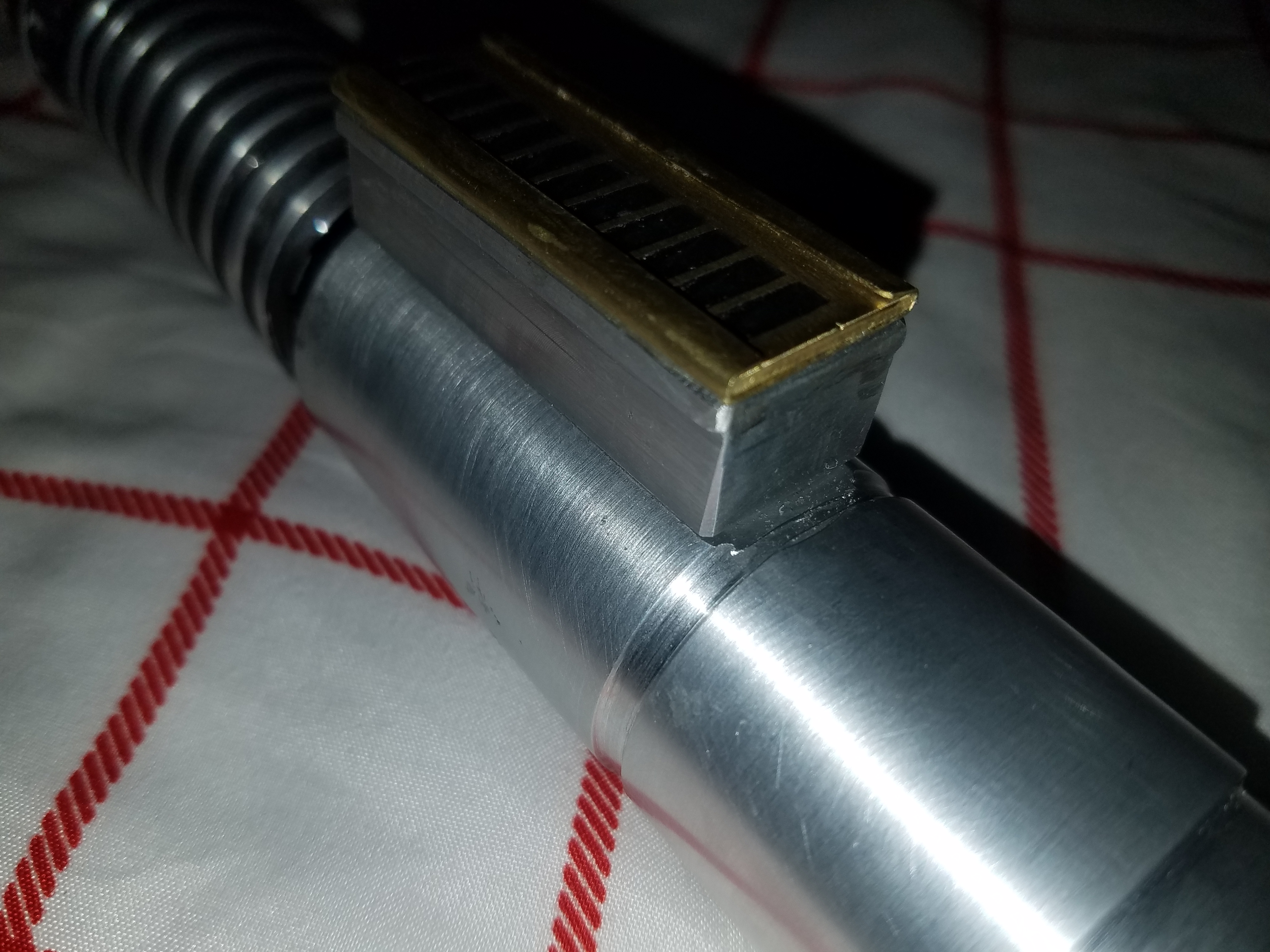

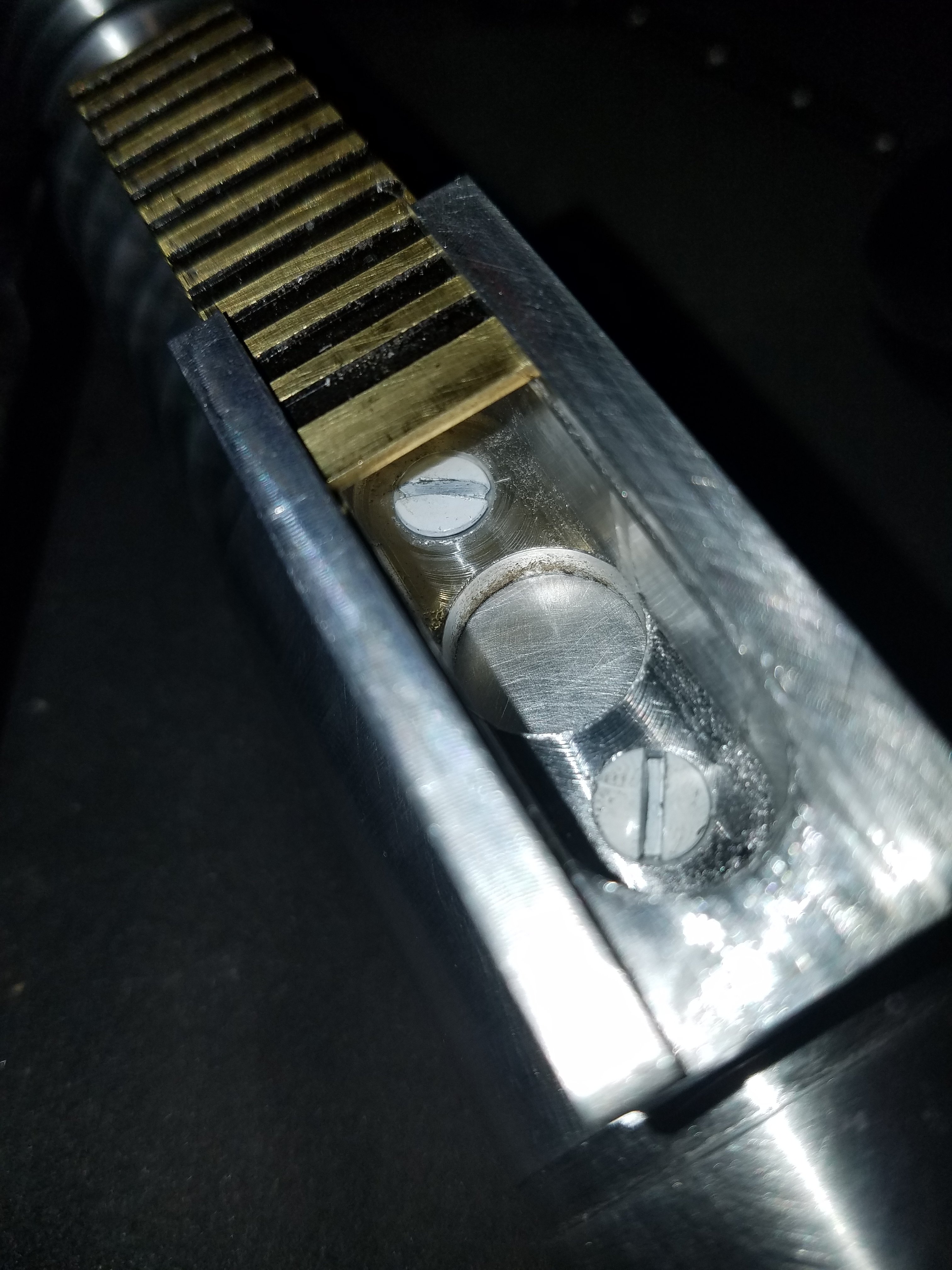

Ok, got an idea for doing the triangles from this AvE video: https://www.youtube.com/watch?time_continue=761&v=v68KtZ_NBP4 Skip to the last 1/4 of the video to see the actual making of the triangular broach.
And using some of the triagular LEDs from here https://thesaberarmory.com/product-category/components/leds/
I also milled, lapped and filed a small chunk of steel for the button.

well, gave a quick proof of concept, ground down a small chunk of tool steel to a 5mm triangle shape and sharpened the end of it to attempt broaching. This I just did with a hammer holding it in hand like a nail. for the final part I'll create a jig to hold it in a press.
