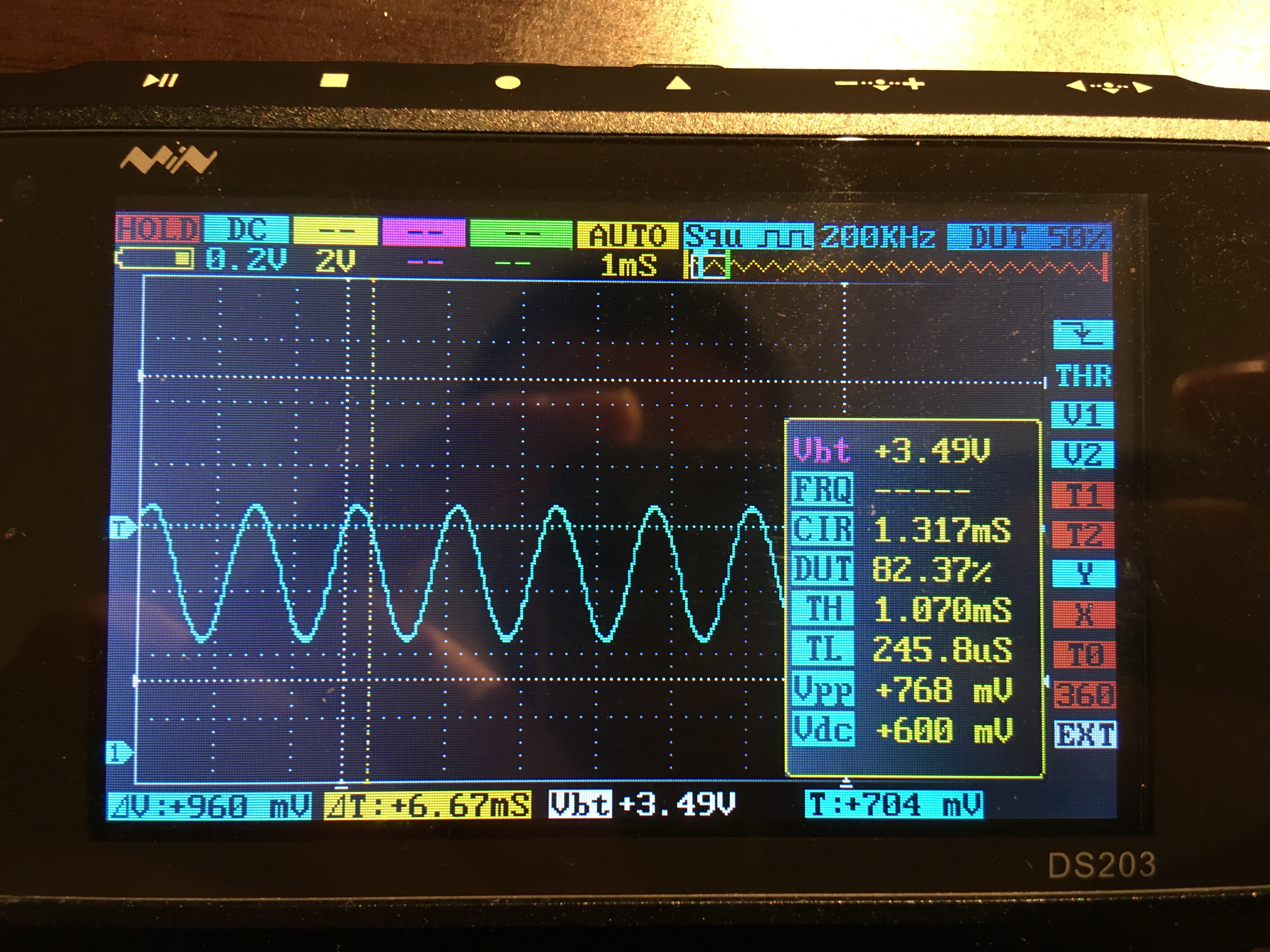

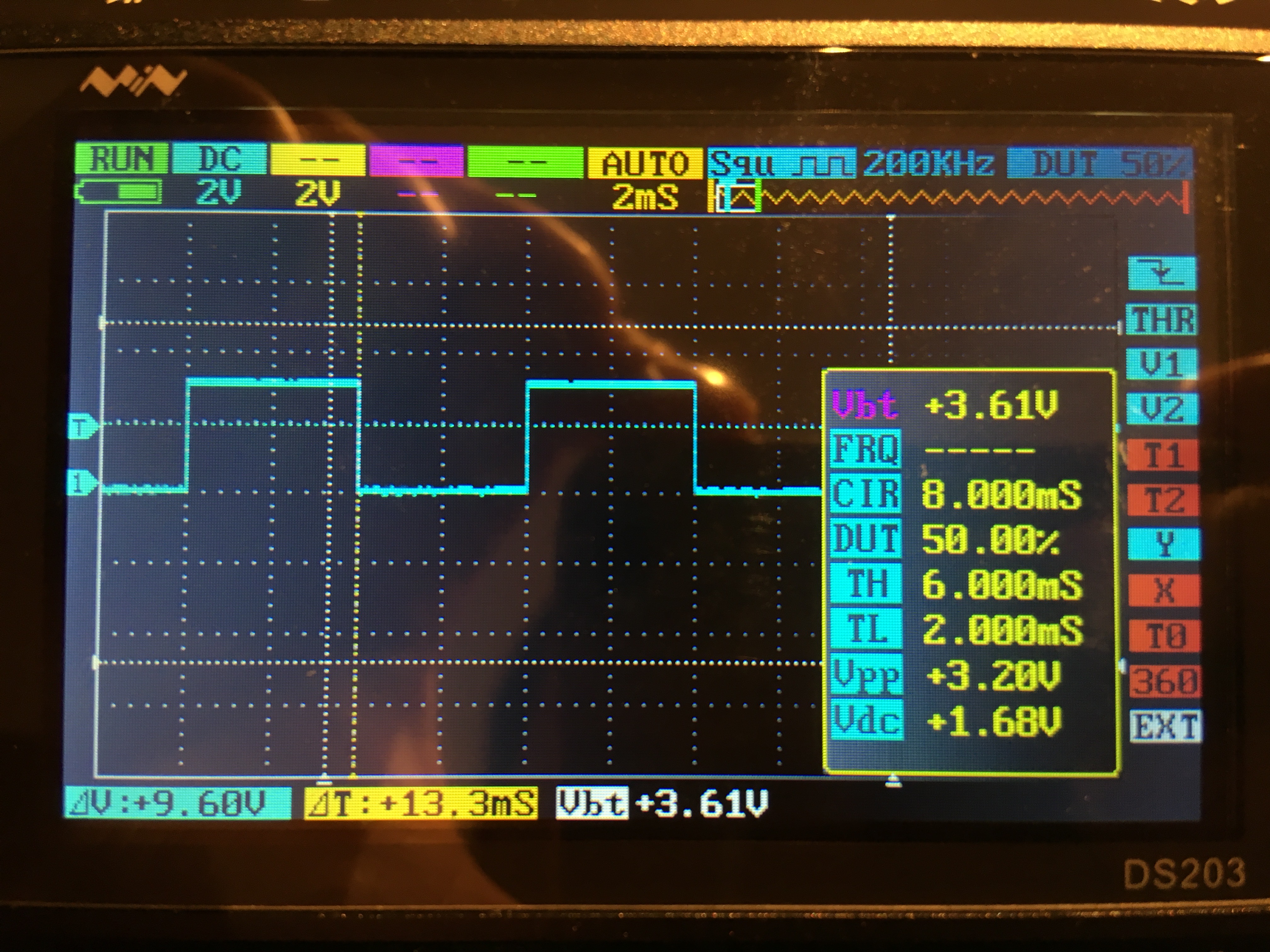

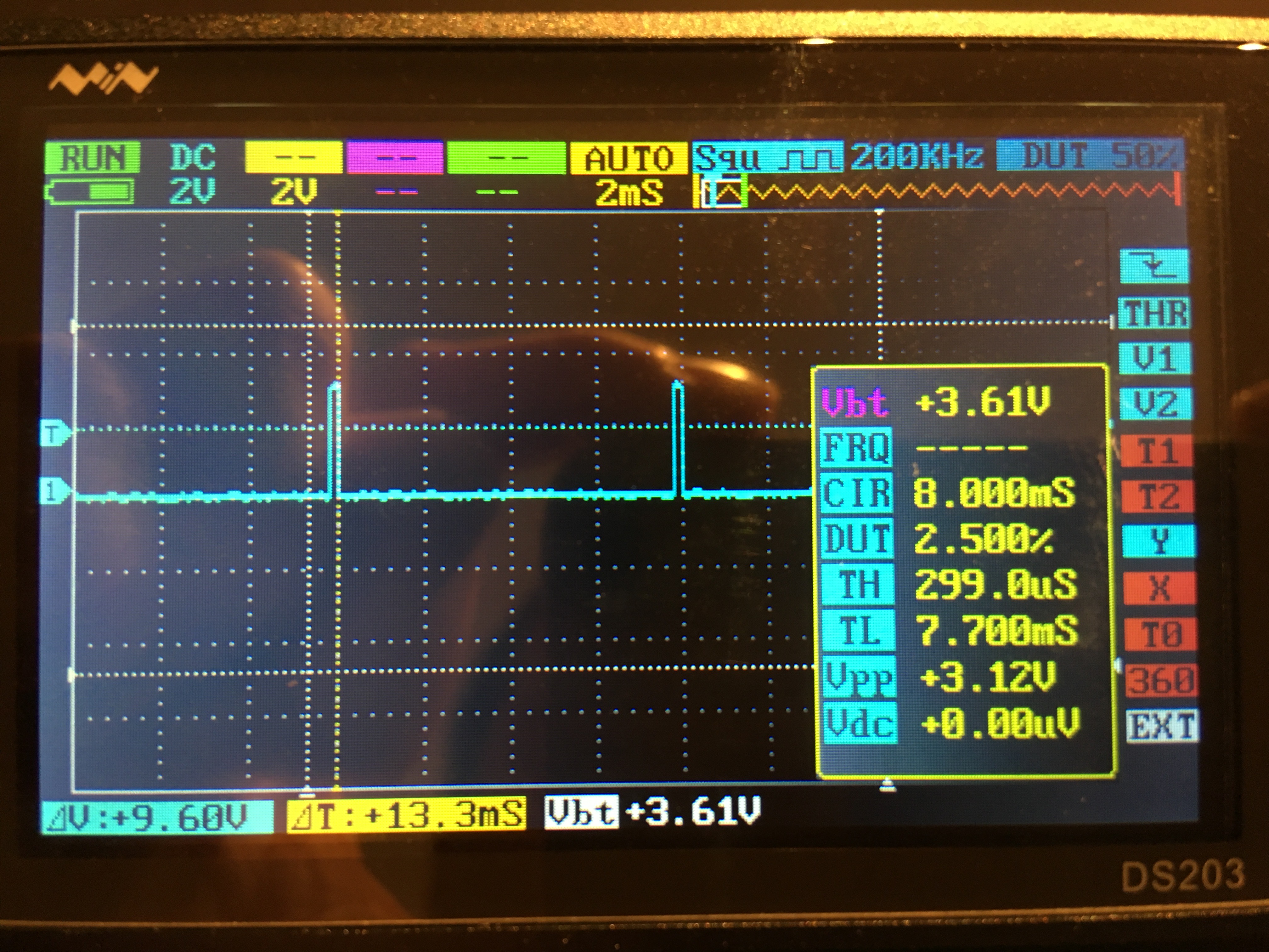

Ok. So I quickly installed the same audio library you are using and hooked the teensy up to my oscilloscope to learn how it's working. I don't have a speaker attached, so the waves might look much cleaner than with a speaker.
I let it play a frequency of 125Hz (which doesn't really matter, it looks the same for all frequencies) with different volumes. Although I didn't really understand the logic for the volume variable.
here is one screenshot for a volume of 10 (which I assume is full volume):
(sorry for the photo... I'm currently unable to screenshots from my scope..)
So what does this picture tell us? First: it's a square wave with a peak to peak voltage of 3.3V which is the supply voltage of the teensy.
Now the same frequency with a volume of 2:
As we can see here, the peak to peak voltage stayed the same. The only thing that changed is the duty-cycle of the output signal meaning that the average voltage and therefore the audio volume is lower. That's a good way to reduce the volume on a piezo buzzer, not so much on a speaker. A conventional speaker will try to move in a uniform sinus wave up and down. If it is given short pulses like these, it will not move in a sinus pattern.
I would assume that this (combined with it being a square wave) explains why you get more frequencies on your spectrum analyzer than you wanted. I guess you know how square waves are basically many sine waves at different frequencies put together? That's why a square wave sounds horrible to the human ear. Here is a good explanation (at the bottom of the page): https://en.wikipedia.org/wiki/Square_wave To illustrate it further, check out this tone generator where you can switch between square and sine wave on your pc speakers (be careful, it's loud): http://www.szynalski.com/tone-generator/
How to solve this problem? Well, you are in luck! The teensy has a Digital to Analog Converter built in which can output real sine waves :D
Like this:
I have done this with the default teensy audio library (which installs itself when you install the teensyloader) and puts the sine wave out at pin 14. I haven't tinkered a lot with it as this was merely a proof of concept. There is a documentation right here: https://www.pjrc.com/teensy/td_libs_Audio.html For my quick proof a concept I have thrown together to of the example scripts from the library itself ("ToneSweep" as a wave generator and "passthroghMono" to look how to get it to output through the DAC).
The main downside with this aproach is that you will need an amplifier to drive the speaker because the DAC can only drive 1mA. More on this is discussed here: https://forum.pjrc.com/threads/28581-Connecting-a-Speaker-to-Teensy-3-1-DAC-A14
I don't know how advanced you electronics skills are, if you need help with an amplifier circuit I can look around for a fitting one.
With this aproach, you should have quite a bit more control over what frequencies are really sent to the speaker.
Thank you for sharing your knowledge here. I didn't know most of this, so the primer is appreciated. That tone generator put the outputs in pretty good perspective.

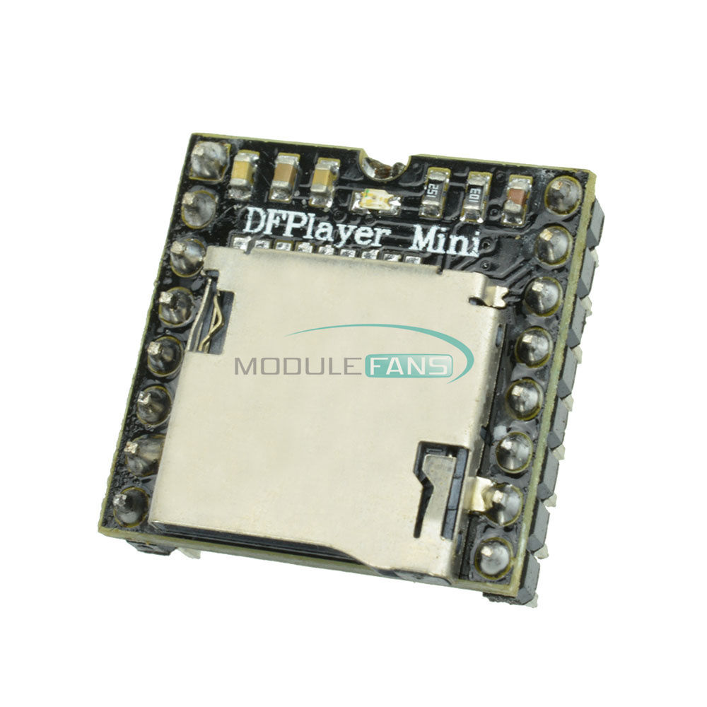

Fantastic work, love the level of detail...... For the audio issues, have you looked at "DFPlayers"? They are small mp3 players with a built-in 3 watt amp. Take a look at the data sheet and see if it might help, I'd be happy to send you one to experiment with, just send me a PM. I'm using them in my Space 1999 Comlock build, but without a micro controller, I'm using the AD module key configuration. Love your work very much.....
https://www.ebay.com/itm/TF-Card-U-...842193?hash=item28101a2ad1:g:MjkAAOSw42dZJqYi
  • DFPlayer Mini Manual.pdf
That looks really interesting, and if I'm reading the datasheet for it correctly it could be controlled by an arduino or similar microcontroller, at least in the sense of being able to send it signals to pick and play tracks off the card. I don't know if I necessarily want to introduce an SD card assembly into this whole situation, as then getting and formatting each card becomes extra steps and expense. I definitely appreciate the offer of sending one my way, but I suspect it wouldn't find its way into this particular project, so I won't put you out by asking. Thank you for the offer all the same.
