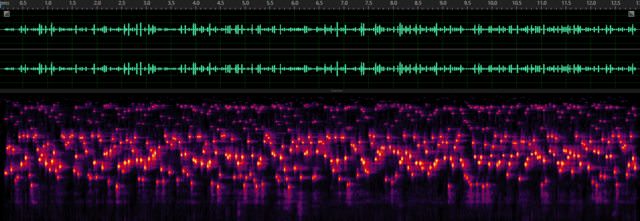

OK. This is a totally fair critique, but I'm not sure which direction to go to improve it yet. Lets talk about this bit in particular.
The "scanning" audio is something I made up outright. The Teensy can play audio files through the speaker if they are formatted correctly and stored in flash memory, but they take up a ton of space - comparable to bitmap graphics - and would be somewhat poor quality without a dedicated sound board. The way I've been generating sounds with this setup is the same as what you could do with a piezo buzzer, basically - just tell it to oscillate one of the output pins at a certain frequency for a certain duration. For example, the current scanning sound effect code is a loop that simply calls a line:
tone(TONE_PIN, random(3000,8000), 20);
This is basically an instruction to generate a random frequency between 3000hz and 8000hz and push it out to the speaker pin for 20 milliseconds. Not fancy on its own, but when you are hitting that line in a quick loop it makes that tinkling cadence that currently serves as the scanning audio. It actually looks really neat on a spectrum analyzer, because you can see the individual points representing the random frequencies it's generating:
http://i.imgur.com/SdJ4s83l.png

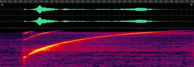

Likewise, the startup whine is simply a climbing frequency that increments throughout a loop and ends up being a fairly good logarithmic curve:
http://i.imgur.com/C7q4P4ml.png
All this is to say that whatever audio I end up using will probably have to be generated in this fashion, out of basic frequencies. Asking for it to produce something like a "bass" sound is a challenge. According to the datasheet, the speaker itself has an effective range in which it can generate audio from as low as 200Hz to as high as 20,000Hz, but my observations are that lower Hz values tend to be quieter. Just as a quick test I knocked the frequency range down by an order of magnitude, to 100Hz-300Hz, and did a quick recording. I know this isn't necessarily what you guys were after, but it's just a demonstration of the output at the low end:
https://youtu.be/qlggp2P2UuA
I don't honestly recall any sound effects playing during the scan in the movie. I will confess that I've just grabbed a totally garbage theater-cam download of 2049 to check as a reference. It actually does seem like there is a sound, but it's almost the same exact noise as my start-up whine sound effect:
https://youtu.be/RloHtvZ-ymM
That is... disappointing? Because while I can make it make that noise easily - just re-use the same sound as plays during the start-up whine - that'd be a bit underselling what the device is capable of. Still, my gut tells me that I should probably just use the wind-up whine for the scan to match the screen accurate audio.
Don't get me wrong it wasn't a criticism, more an observation. Let's be honest, the original prop made no noise at all and it was all added in post prod. So you're doing something far beyond what even the original device was capable of, and that is to be applauded. But... If there's ever potential for a replica to be just that little more authentic, i'll always push for it.
To me, the scanning noise definitely sounds like a fairly drawn out climbing frequency with some sort of modulated noise going on underneath the whine also, but my ears definitely hear a sequence of beeps and chirps at the end of the climbing 'whine' as K concludes his scan (confirming a successful match perhaps?) It's really difficult to tell with that quality of audio, but perhaps for the scan noise you could string two sequences together? Once climbing 'whine' whilst the button is held, than a sequence of random beeps once the button is released and the display appears?
Again, it's difficult to suggest much with confidence without a really clear version of the audio in that scene.

I grabbed @Candykiller's file and dragged it into an audio editor so I could check the frequencies out.
You can actually isolate just one of those lines, which is something I didn't know until this morning. It helps make analysis a little simpler.
That single line ends up sounding like this:
http://tindeck.com/listen/pzjqx
I actually think it goes on for too long. I know the wind-up audio in the scene in the film does drag out over a few seconds, but I want to get this thing played and done with inside of 3 or 4 seconds so that the device can move on to doing other things, rather than keeping the user waiting prior to doing a scan.
