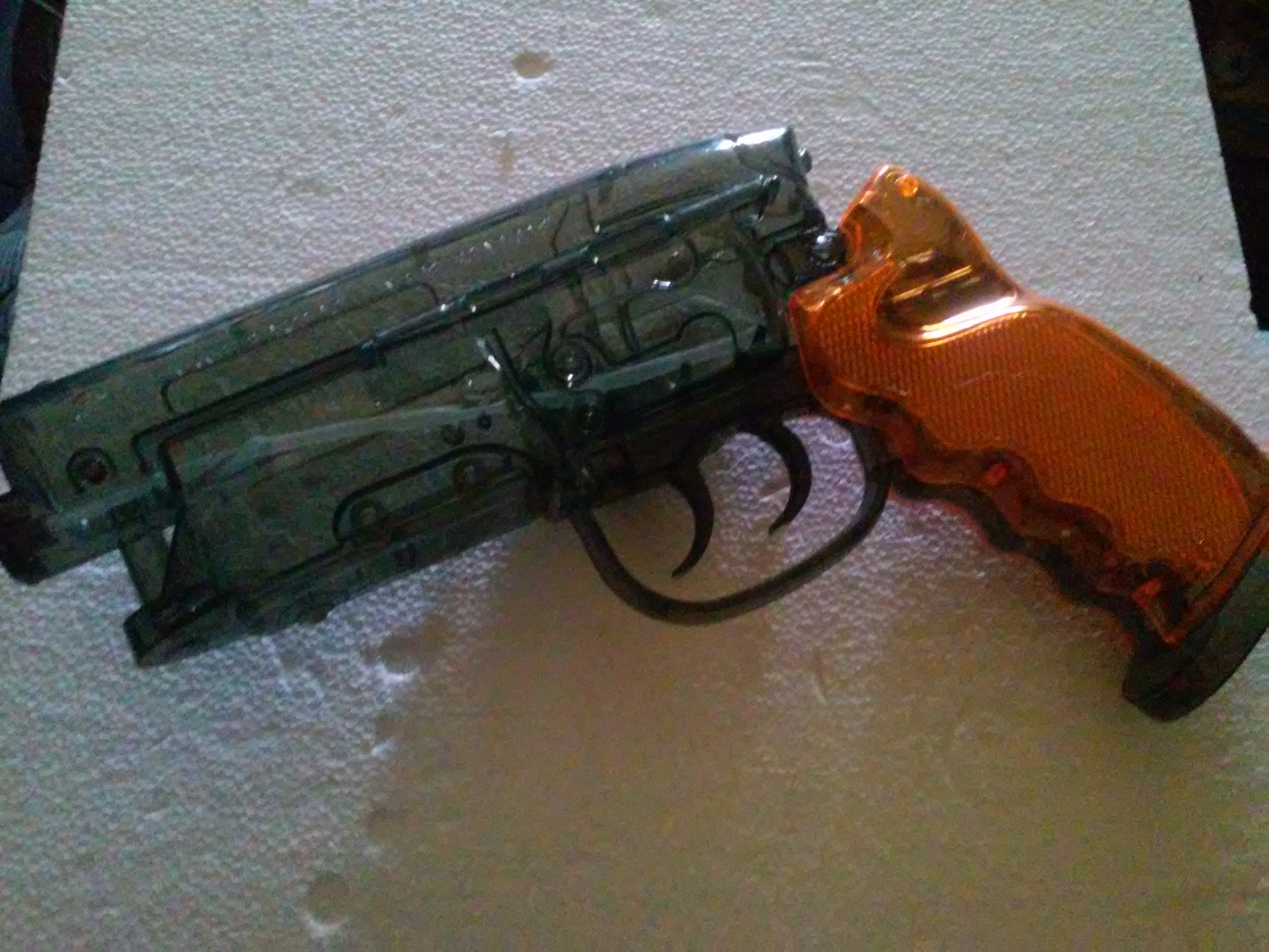

So I figured I'd start a seperate thread on my Fullcock Blade Runner squirt gun. What are my plans? It will have working red and green LEDs, a complete paint job, hopefully resin cast amber grips, a removable magazine housing the battery, hinged trigger, and quite possibly sounds and and muzzle flash. Some of this will depend on my budget though.

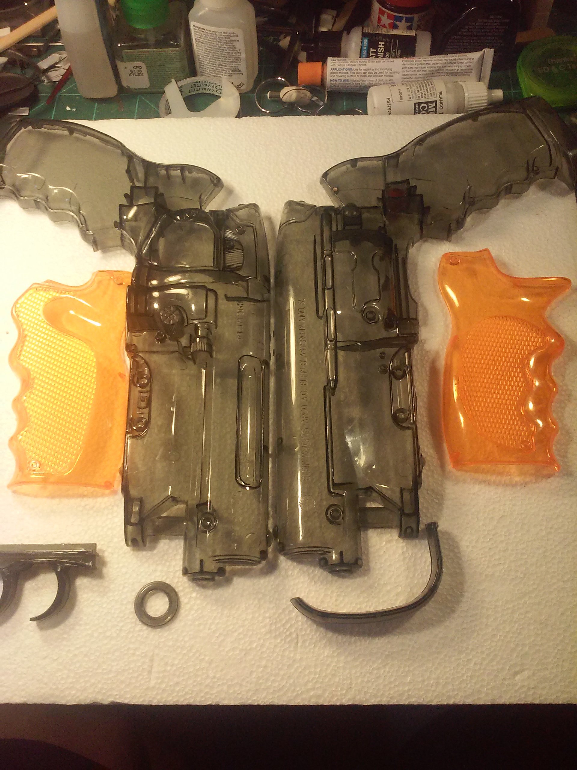

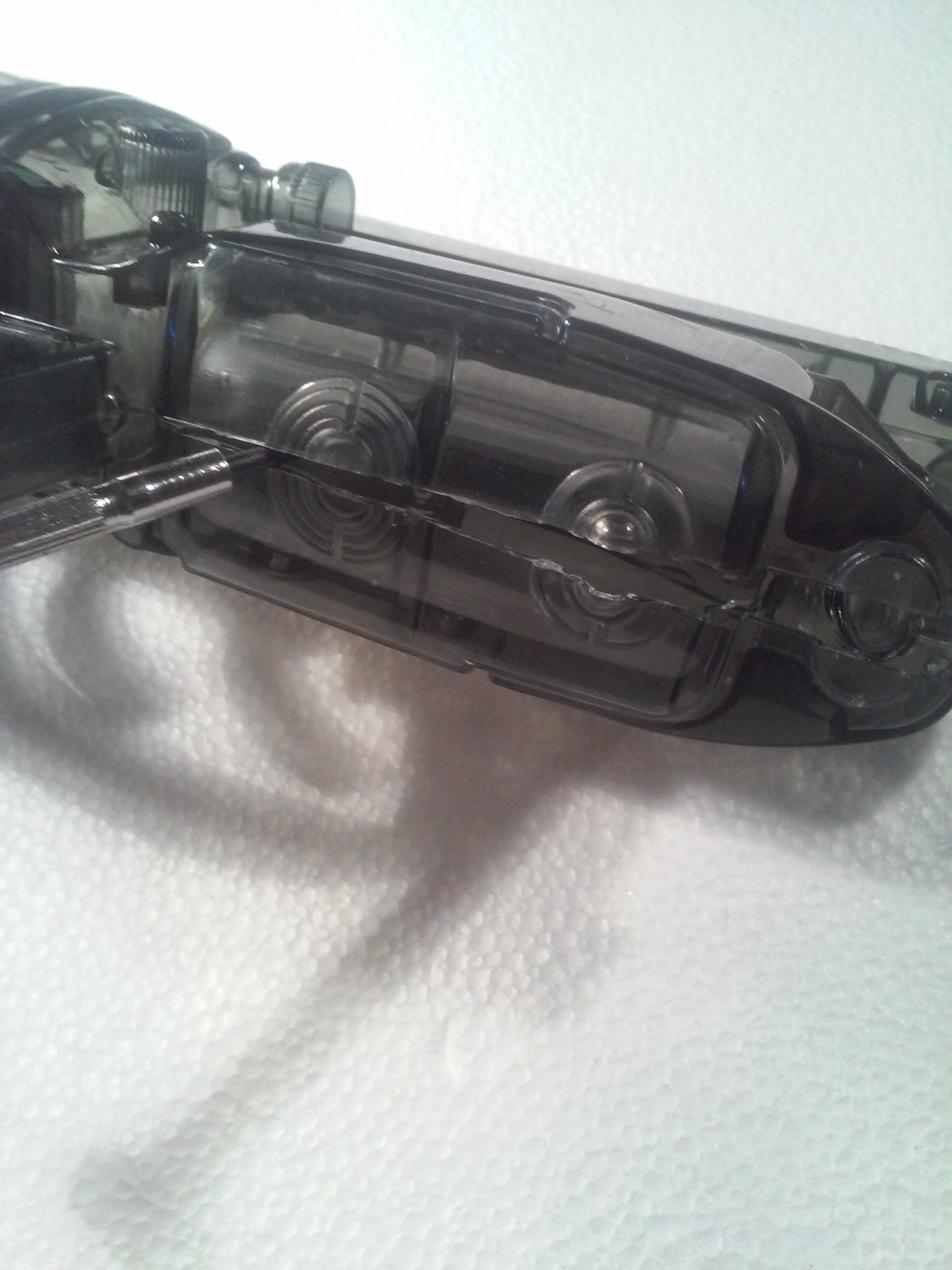

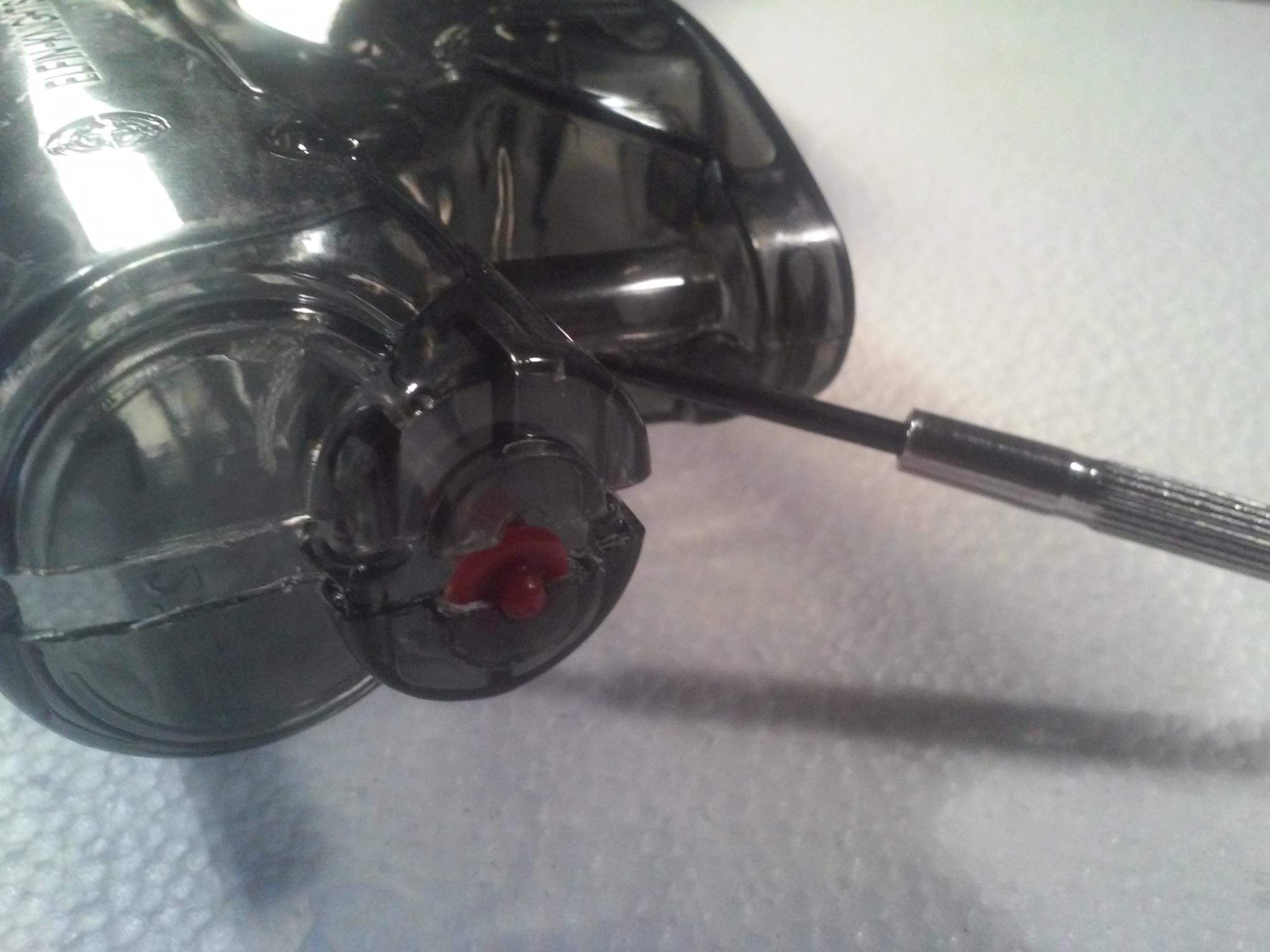

The first step is taking the gun apart. I started by rocking an Xacto blade back and forth over the pins. I then used a small flat head screwdriver to pry the parts apart. While the grips came off easily, the body was a different story. It was glued really really well, especially around the water chamber. There was some plastic casualties but nothing a modeler can't fix!
The pictures explain the process and show where I currently am. Stay tuned for more updates as progress continues.

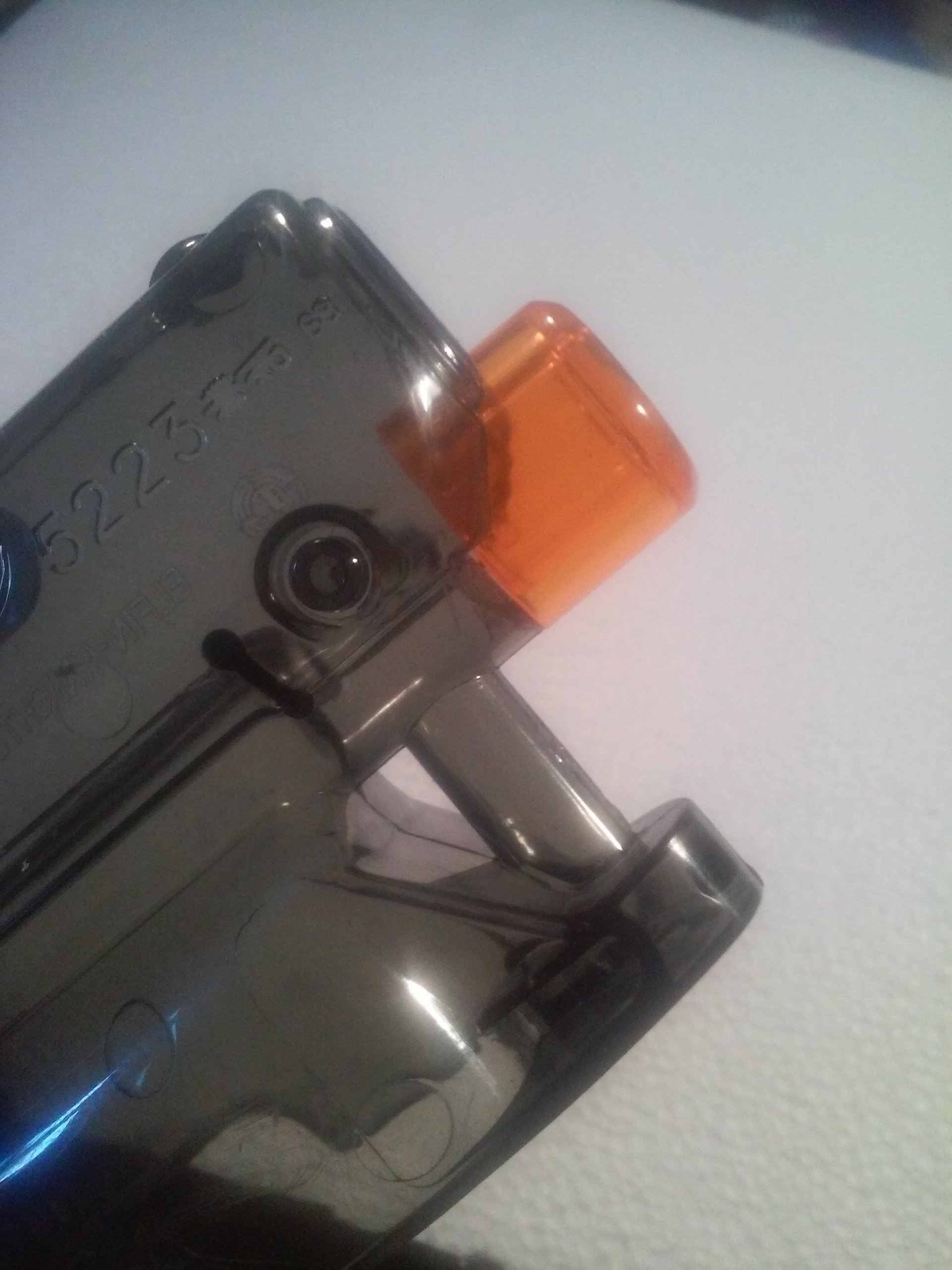

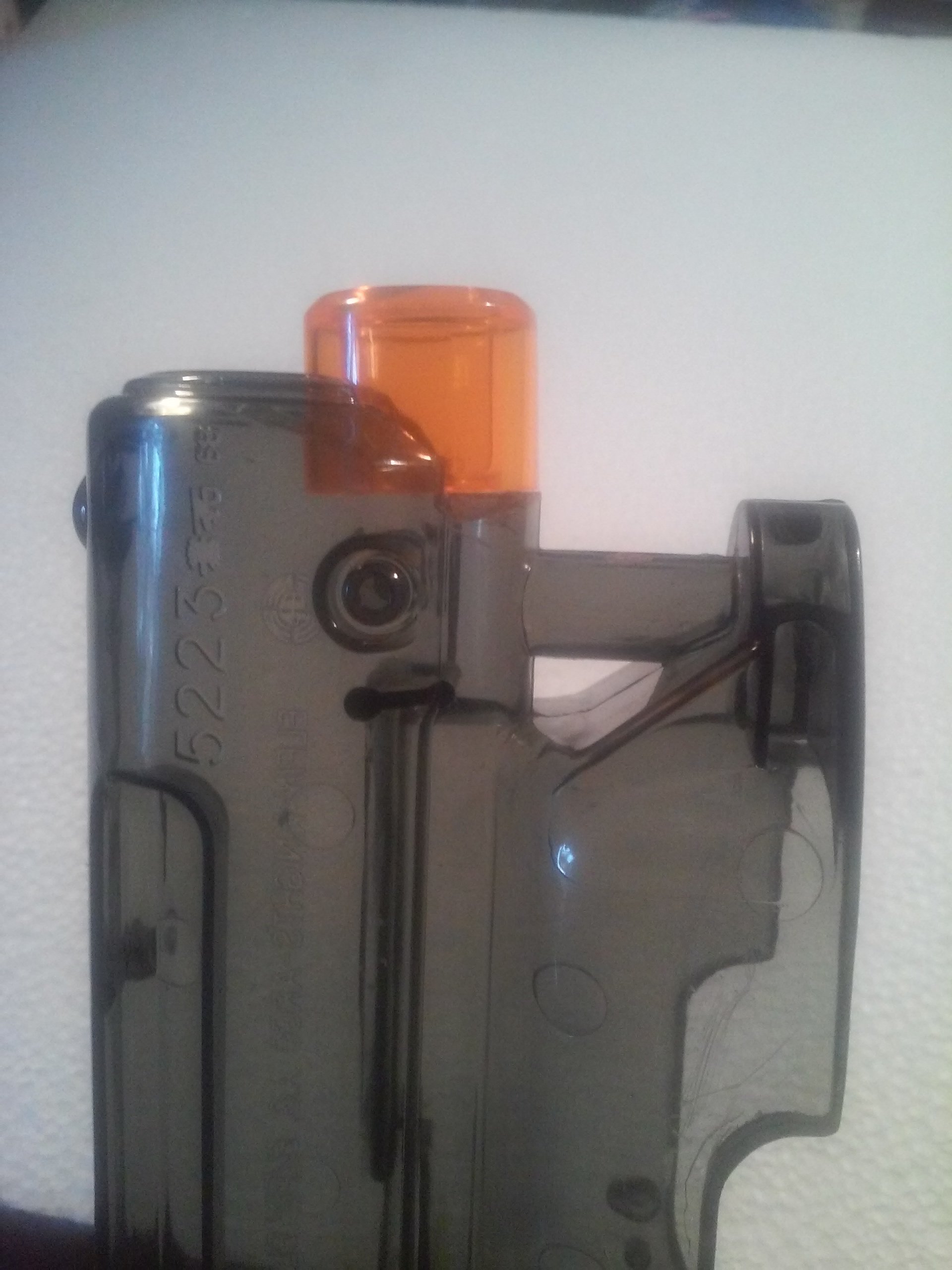

I used the orange barrel piece as the new lower barrel. I used my trusty Dremel with a sanding drum and removed material until the Orange plug fit. I did it this way instead of trimming the orange plug as I I had more control over holding the body of the gun.

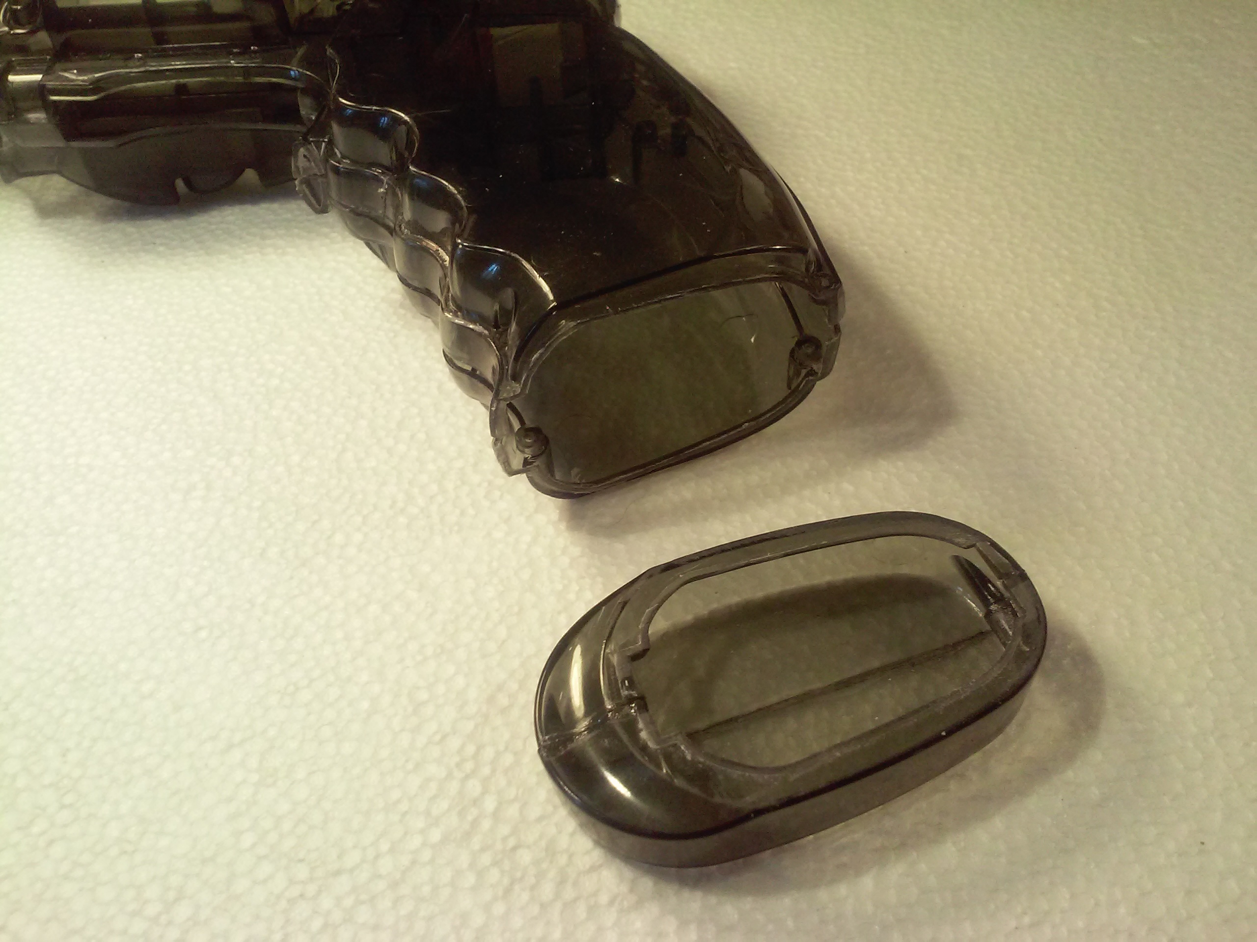

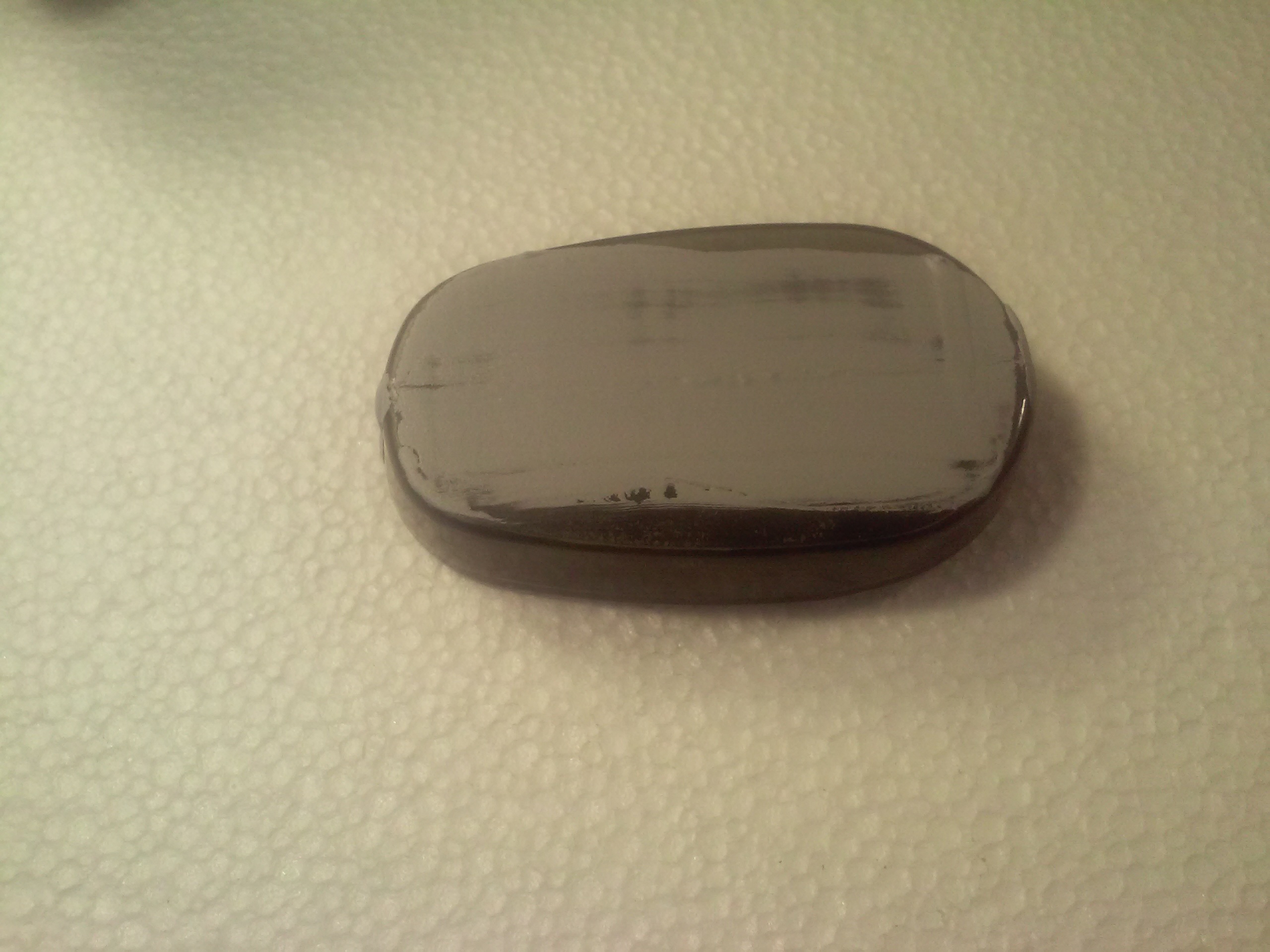

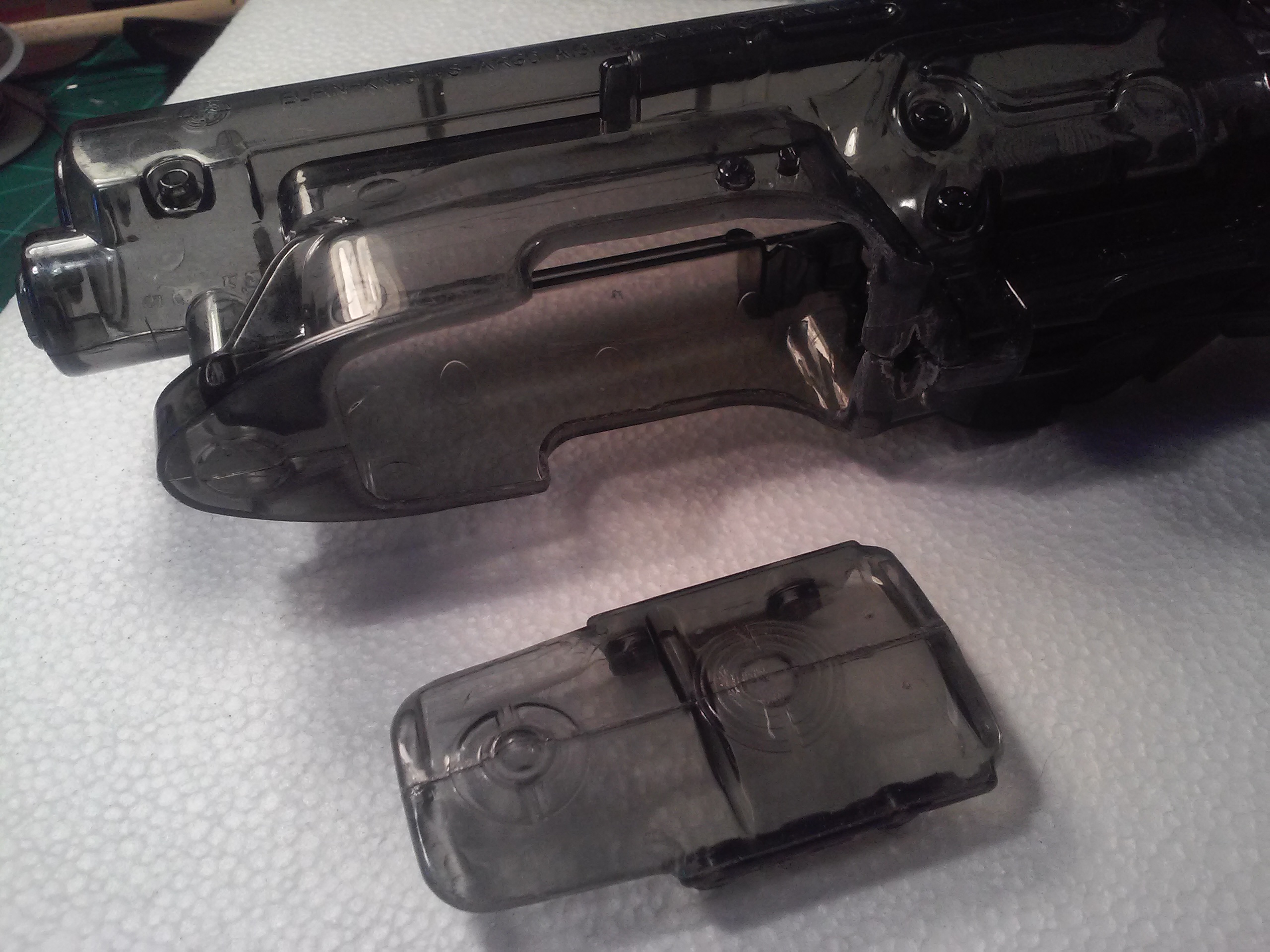

I stared at it for a long time figuring the best way to remove it. I used a small ball grinder in my Dremel to thin the plastic from behind where the LEDs are. For the front area of the mag I just used a razor saw. Now I just need to build up a box out of sheet styrene and install the LEDs.
I decided not to try and separate the trigger guard as mine was glued soo well! I just cut it off and will reattach it near the end.

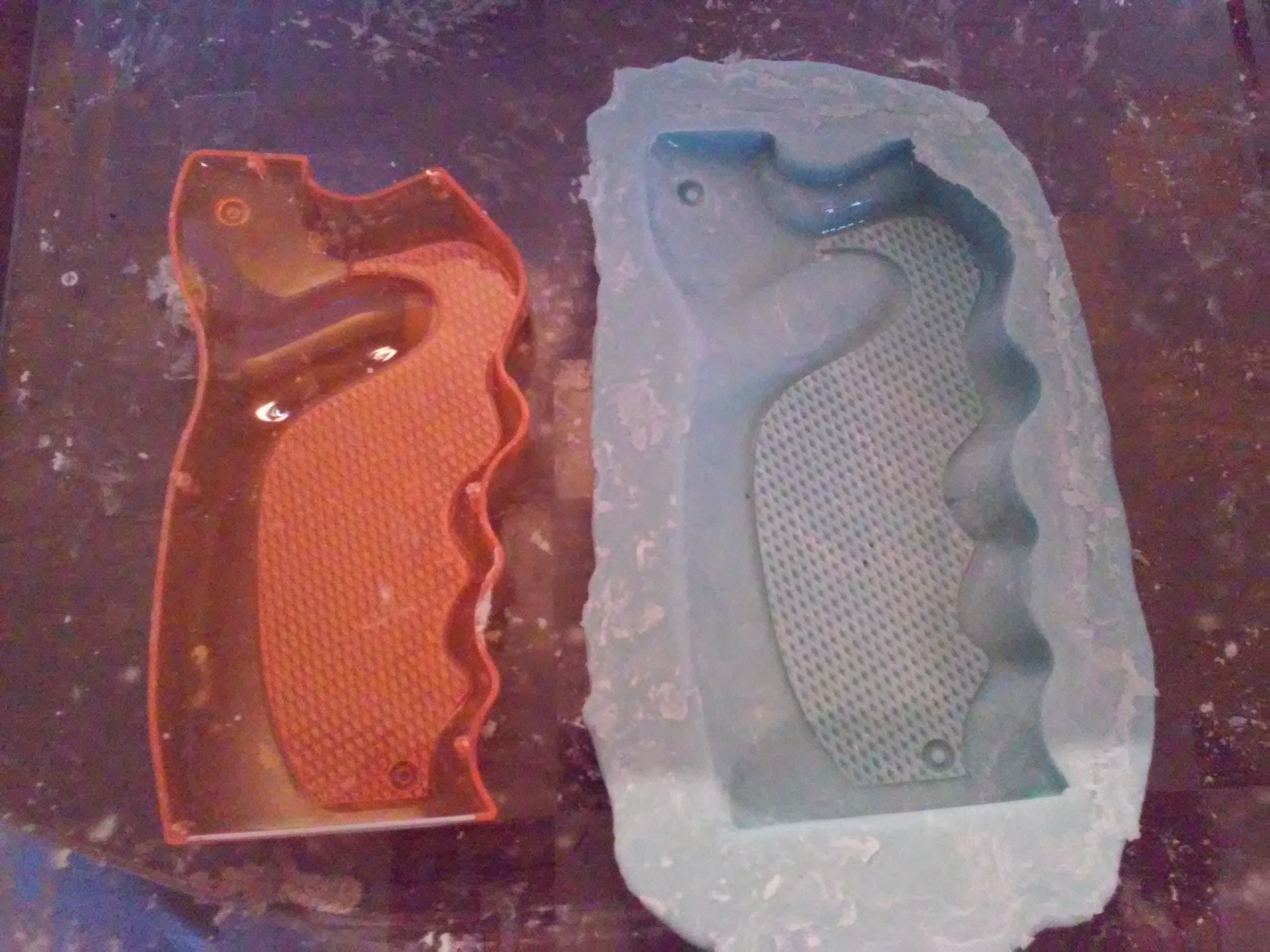

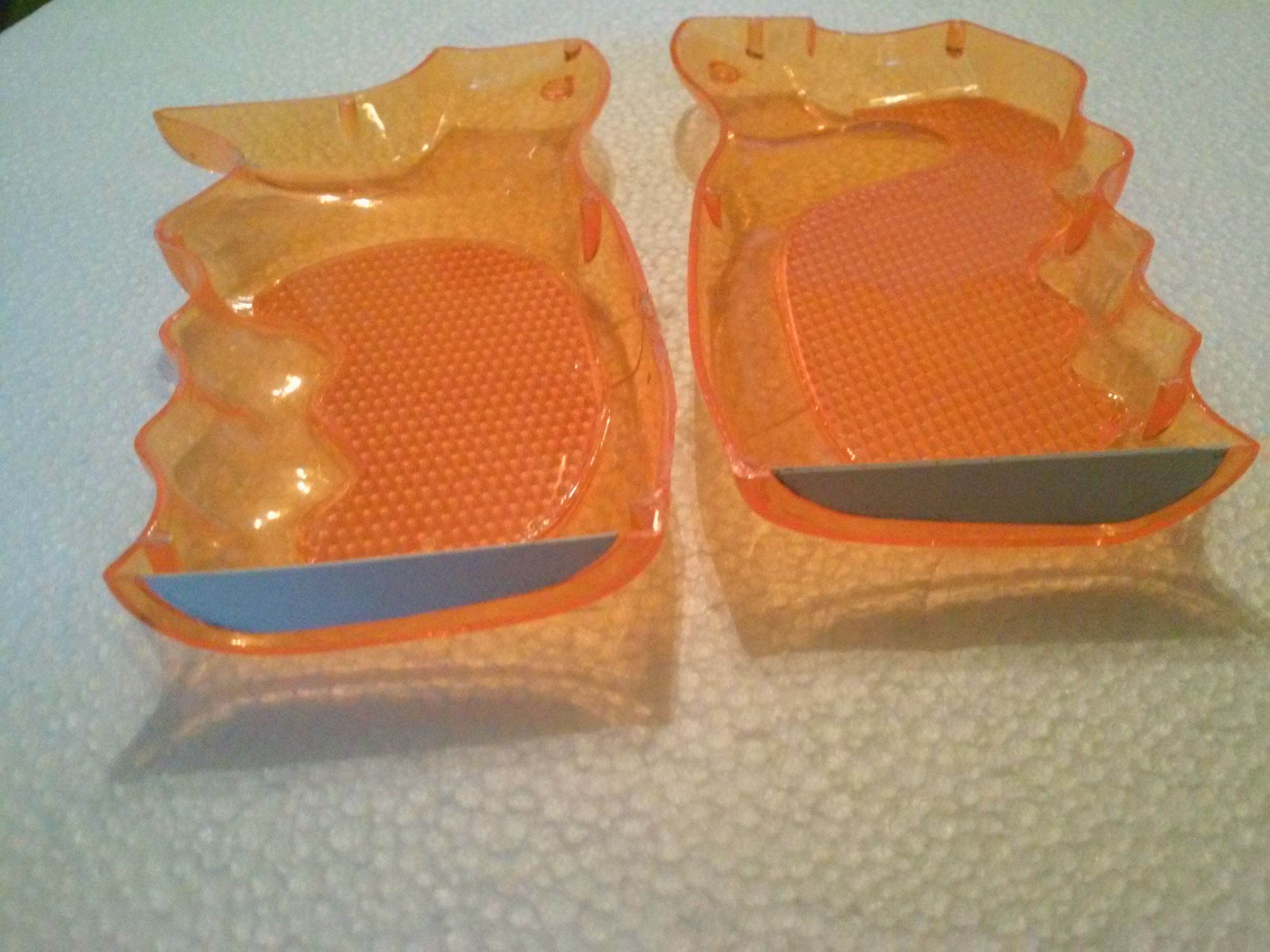

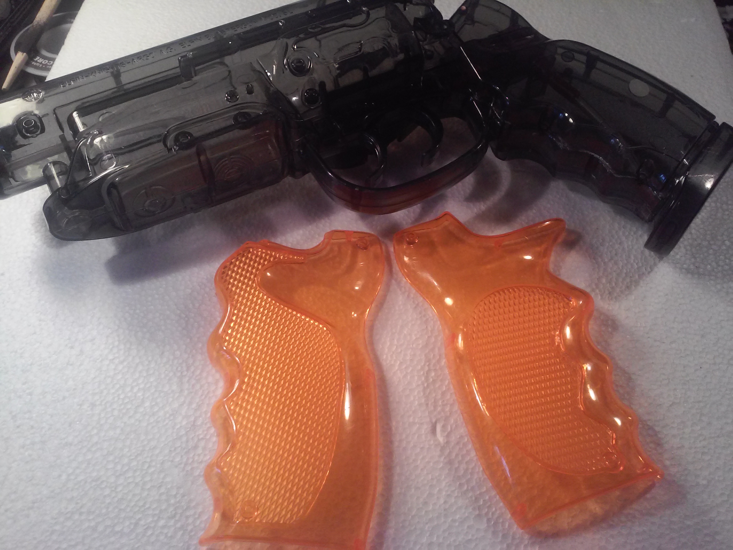

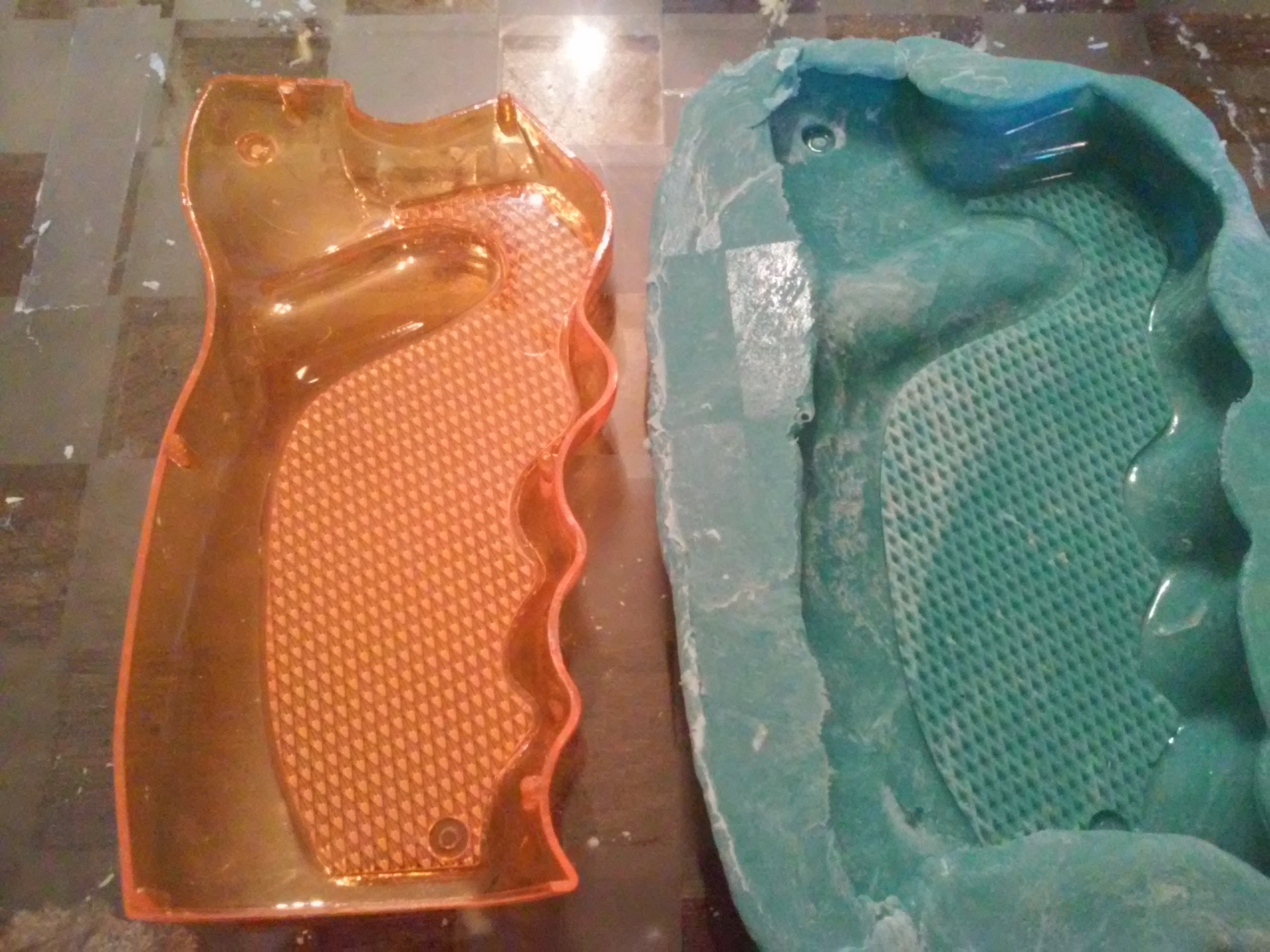

Silicone, clear casting resin, food coloring, and corn starch. I'm all set. The first mold was not useable. Forgot to plug the bottoms of the grips, corrected that for round 2. Had a small bubble as well. Second try is currently setting up.

Saw the same / similar video on YouTube regarding those ingredients . The clear casting resin wasn't mentioned though . Guess it makes sense that you'd want the grips hard and not rubbery . Was it a simple process - casting the resin , and could you elaborate on what / how you did it ?
Realise there'd be other videos on YouTube explaining this , but , what you've done looks good and is more specific to this build .
Cheers Ged
I posted a video in the other thread. You take 100% silicone #1, and food coloring and mix it up. The coloring activates the silicone to start hardening, you have 10 minutes. Then roll the silicone blob in corn starch so it looses its stickiness. Once it turns to a relatively non stickey glob your ready to press it over your grip. In ten minutes it has fully set and you have a useable "rubber" mold.
LOL!! , thanks , that's the video I was referring to in my post . Still gotta ask though , the video guy doesn't go on to cast clear ' resin ' , and you have . So was wondering what the steps for that involve ? Resin just poured into mold after it's been made - No other steps ?
Ged:thumbsup
Haven't poured resin yet. But yes, just pour, let set, pop out. Need to pick up food coloring today to make the amber color. I only had blue, green and red. Stay tuned, I'll post on this tonight.
Dunno how food coloring will turn out but they do specifically make resin tints sold at any craft store for that brand you're using.
Thanks for reply @Robiwon . Looking forward to your update .
Just one thing , on the other PKD thread - some people mentioned that using resin to add weight to the blaster may not be advisable due to it getting ' hot ' - a temperature / chemical thing right ? . If so , aren't you concerned that the ' heat ' from the resin will distort the rubber mold ? Apologies in advance if this is all irrelevant , and isn't a factor with this technique .
