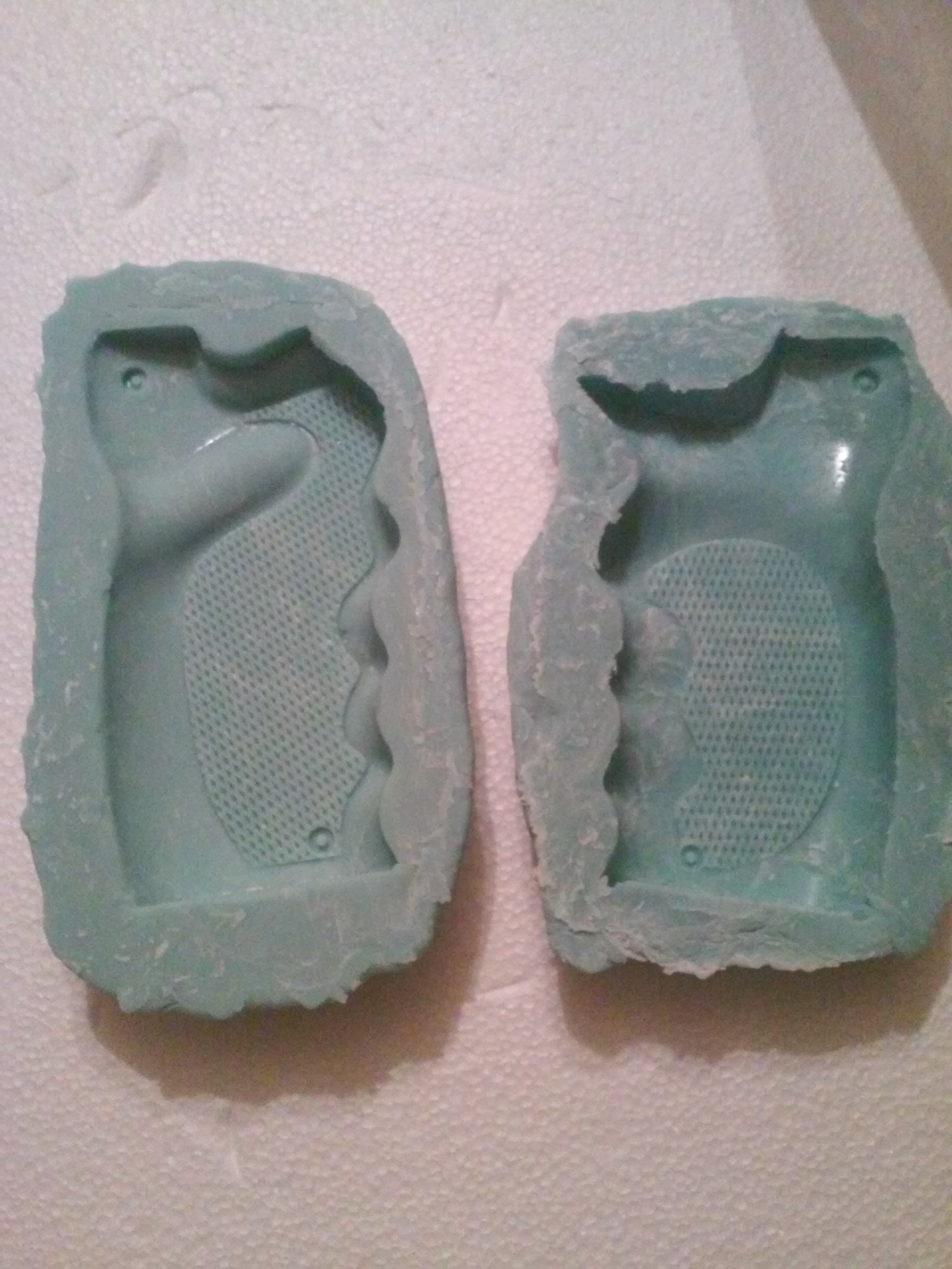

Haven't poured resin yet. But yes, just pour, let set, pop out. Need to pick up food coloring today to make the amber color. I only had blue, green and red. Stay tuned, I'll post on this tonight.

Finally got the second grip cast. Picked up some amber resin tint at Hobby Lobby tonight as well. I'll cast the grips tomorrow. Fingers crossed....

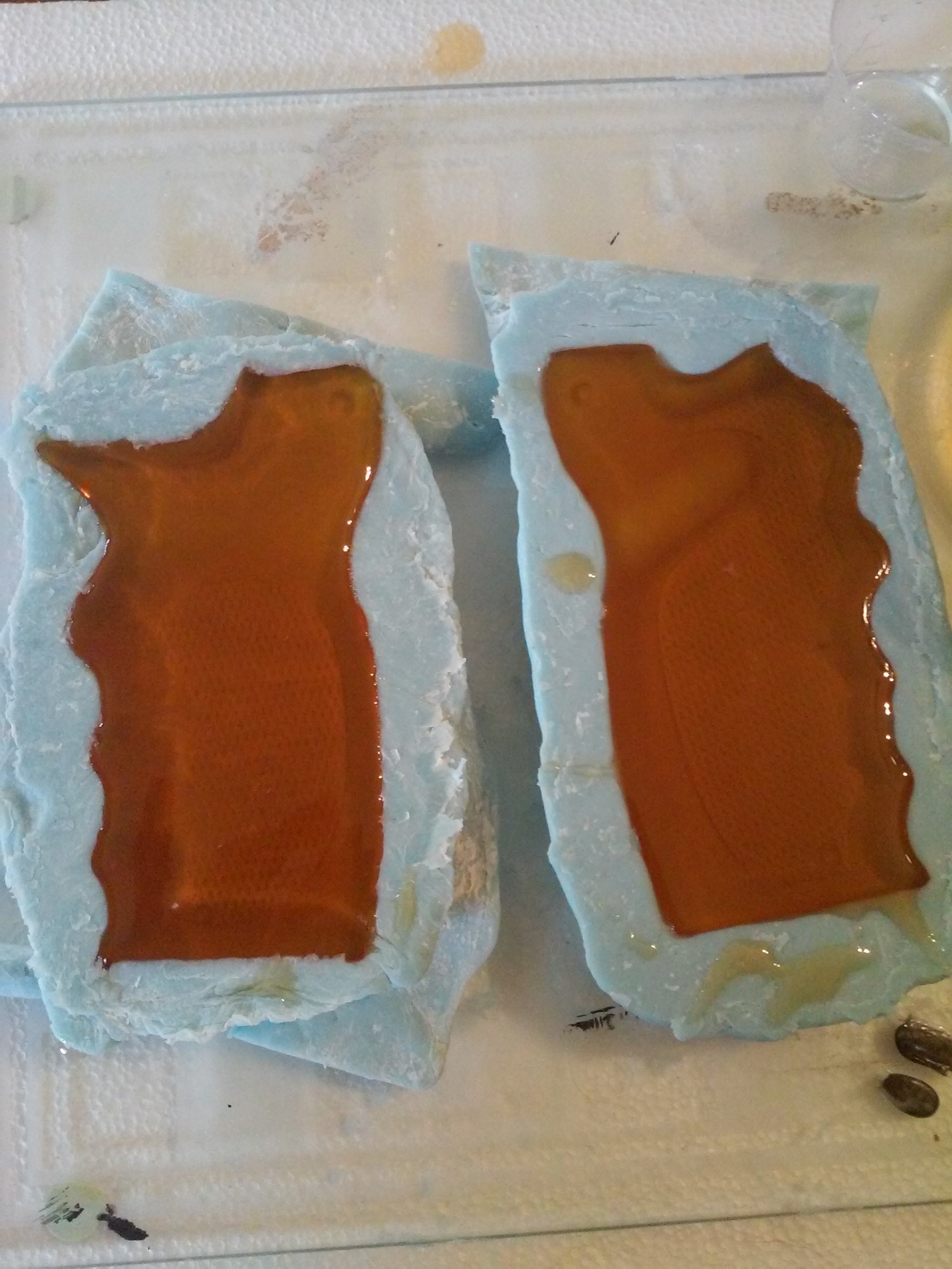

Well, we will know in 18-24 hours how successful my first time at resin casting was! I like the color, straight from the bottle.

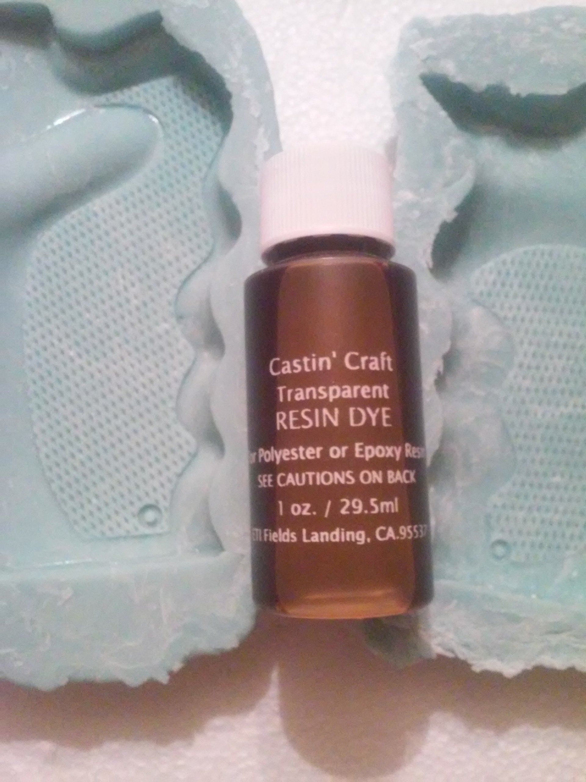

p.s., is there a specific name ( colour ) for the dye you've used ?

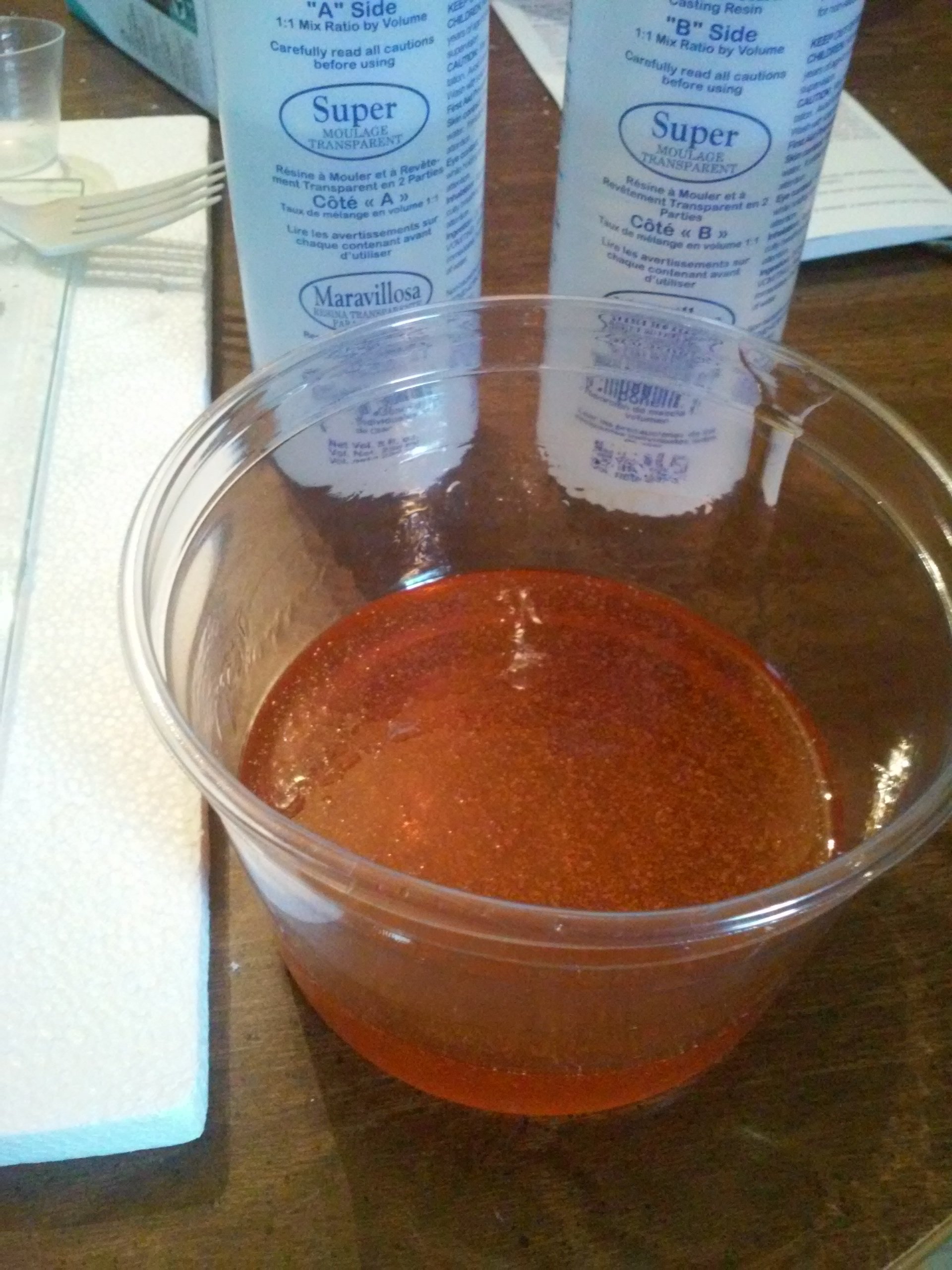

What's the working time on that resin? And did you have trouble with lots of tiny air bubbles being trapped in it?
Not sure what the working time is, but I will say it is plenty! I mixed three cups of A and B each, and that was plenty with a bit left over. The color on the bottle is amber. I added probably 10 drops until I was happy with the color. There were lots of tiny bubbles, a few I had to help come up, but it seems they have all popped after a few hours. The left over resin in the mixing cup is already semi hard.
Trust me, I was a bit scared. But it seems to be working!

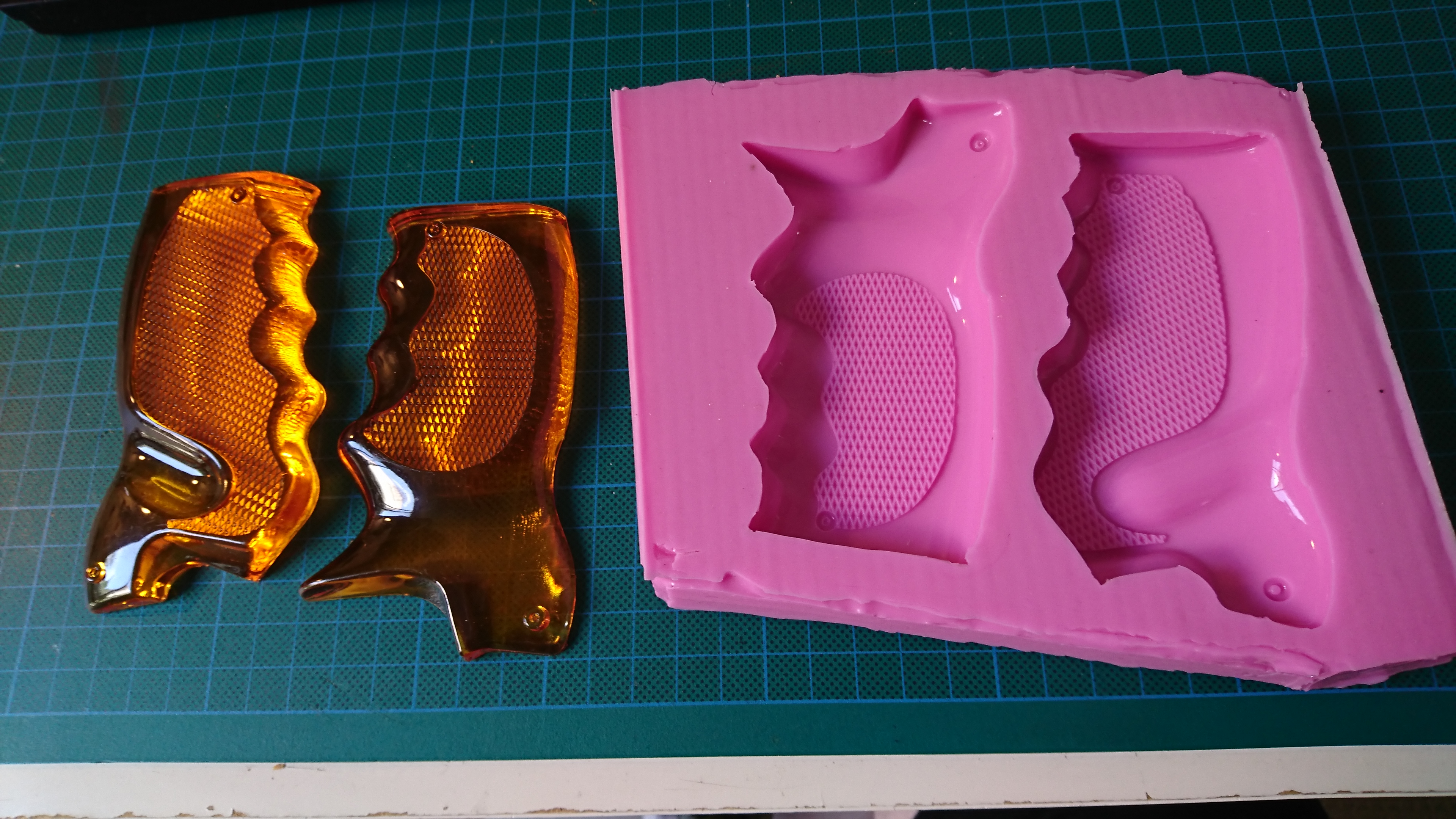

Hijack away my friend. Your grips look fantastic! What was your process?
Cool, thanks Robiwon.
I pretty much followed same process as you, but put both grips in a shallow box. I closed out the ends of the grips exactly like you did.. I used PinkySil (2 part silicone) and Epoxy Resin Casting Kit, with a orange resin tint, 8 drops (into part A first), per 120 mil total (A+B) - Both silicone and resin is form Barnes supplies here in Sydney.

P.S. one thing is that the resin takes longer to cure if you add lost of tint, I had to leave mine overnight.. Box says that it should cure in 3 hours..
Those grips look fantastic, sla73
Thanks for the tip on Barnes, i have one here in Brisbane too
Can i ask what amount of tint you used in the resin? That color depth is spot on.
Just updated my previous post David re tint amount.. And cheers dude.. I totally lucked out on the colour, this was my very first cast, ever
