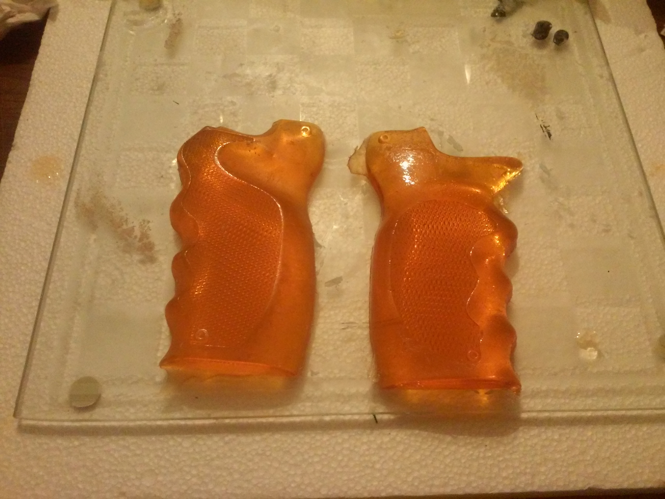

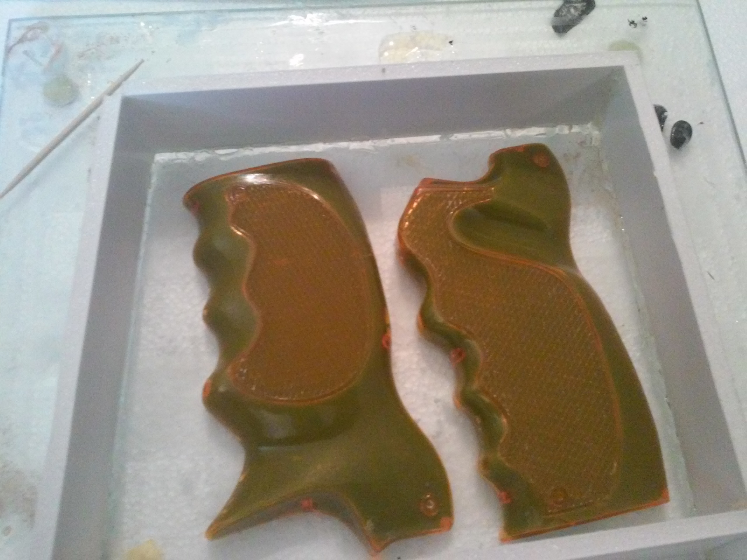

Going to invest in proper mold making compound. While the silicone caulking method worked, I did not get a smooth shiny surface on my parts. I attribute that to the caulking having corn starch in it. This would be good for solid parts but not transparent. They did come out good otherwise. Need to clean up the edges where it ran over. I'll call these Just a test and do another set in a "real" mold.
I think for the next set though I'll add a drop or two of red tint to my amber to get a richer color.

Yea man, good decision. I was blown away with the detail the pink silicon picks up!
See if you can just smooth it out with polishing compound. Even the urethane cast ones you get from kit builders come slightly frosted and requires a bit of compound and elbow grease to get it clear.
Beautiful grips sla 73 and Robiwon: good results since you've used the "Poor Man's Silicone". Cleaned-up, they'll be ace!
Yeah, I'm going to go ahead and finish these as useable pieces. Trim them, fit them, and see what I can do to gloss them up. But I will also still invest in the proper mold stuff.
After being out of the mold now for 24 hours, one grip is now completely cured. The other is almost there. Feeling better about these now. Going to park them in the sun today while at work. Should be fully cured by tonight.
I had the same issue with another manufacturers clear resin years ago. The area exposed to open air while in the mold cured perfectly, while the side touching the mold never fully cured. That side remained tacky for years.
After leaving my grips outside in the sun while at work, I'm happy to report that both grips are fully cured! Mike Salzo posted on my FB page that the mold itself, the silicone caulking, and the fact I didn't let the mold cure and gas out likely caused my issue with the resin not curing.
Lesson learned. Let your molds cure for two days before pouring resin!

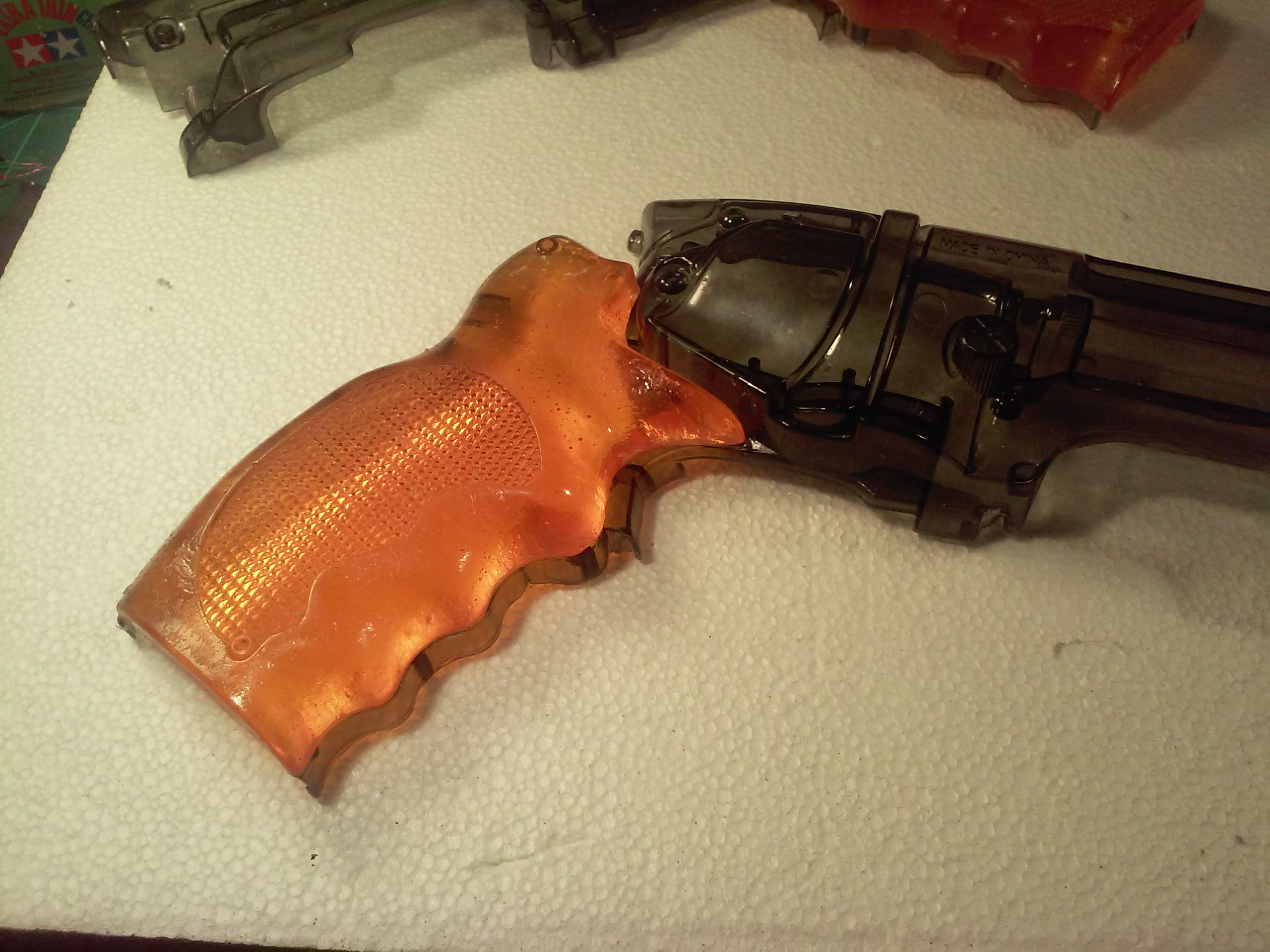

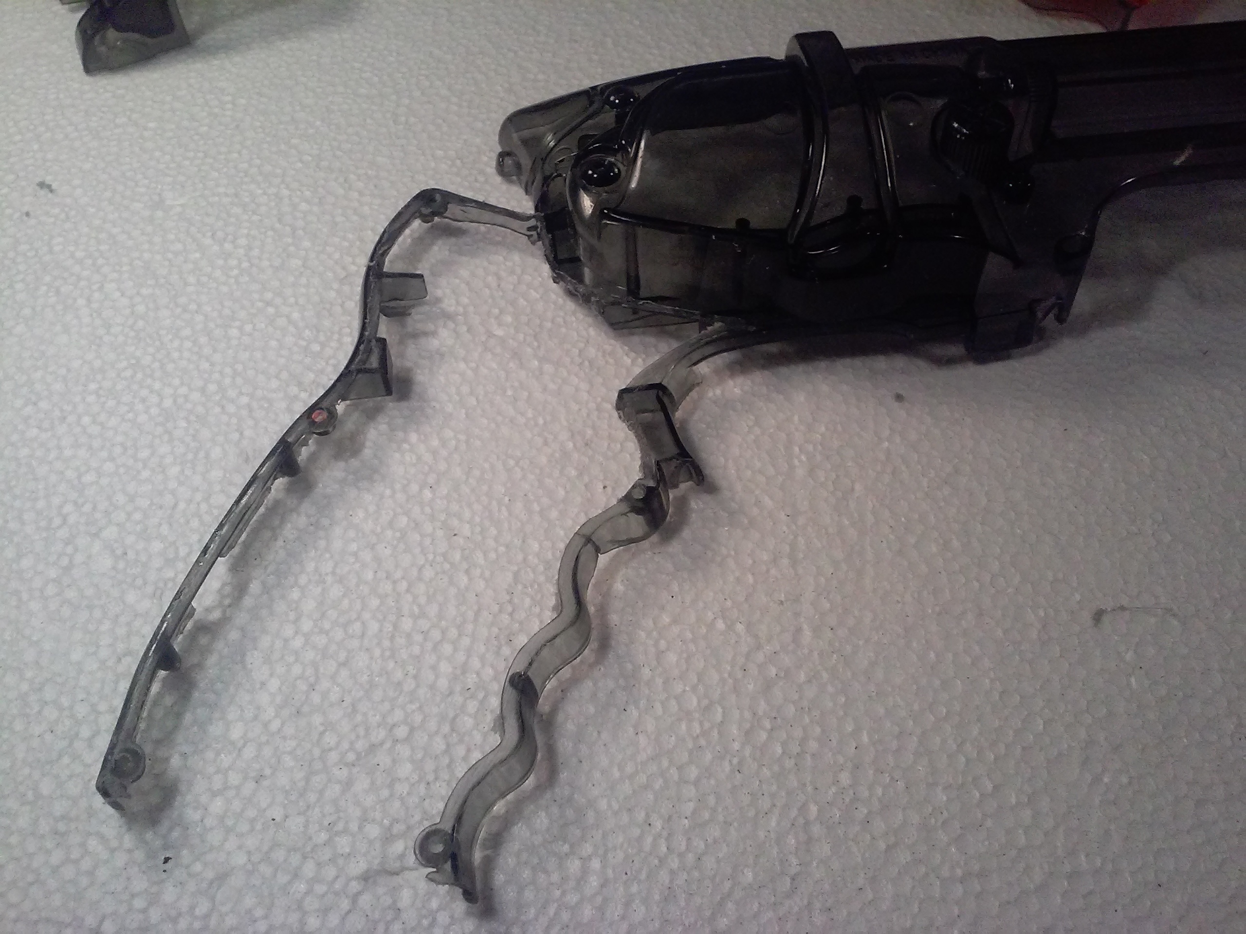

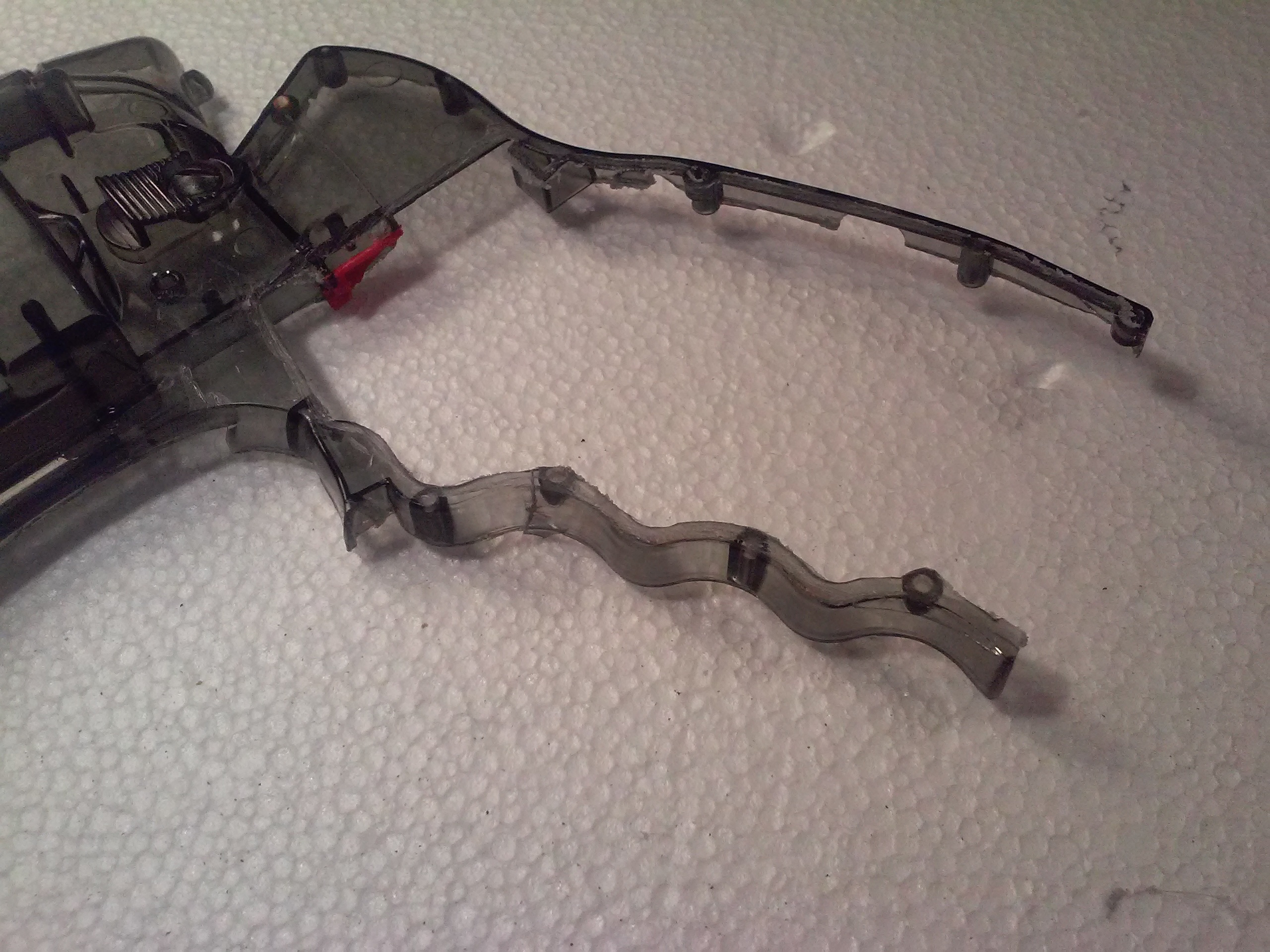

Now I need to clean them up and cut out the water tank from the guns frame.

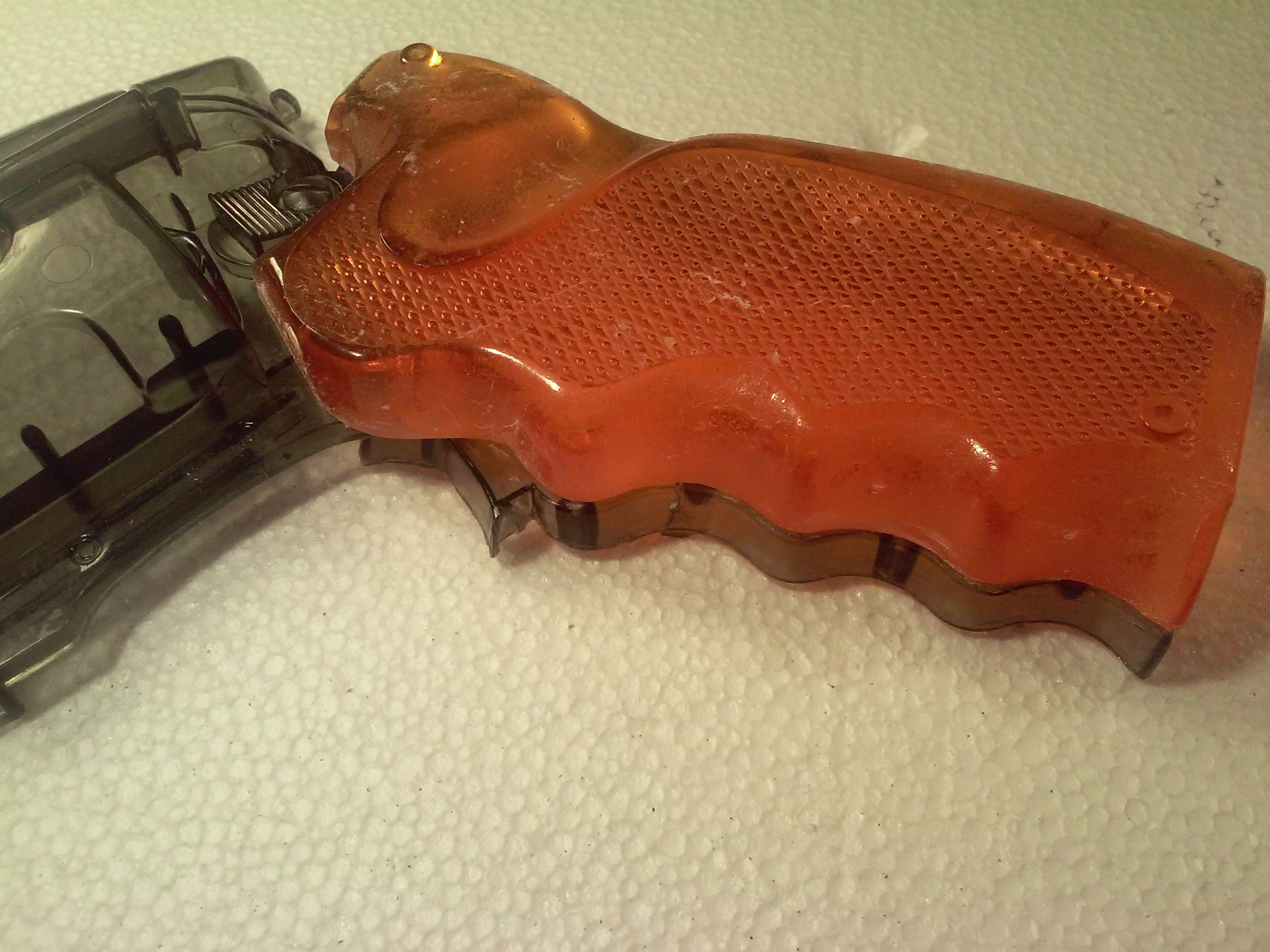

Cut off wheel and sanding drum in my Dremel made short but nervous work of the grip frame area. Grips trimmed for basic test fitting. Looking good!

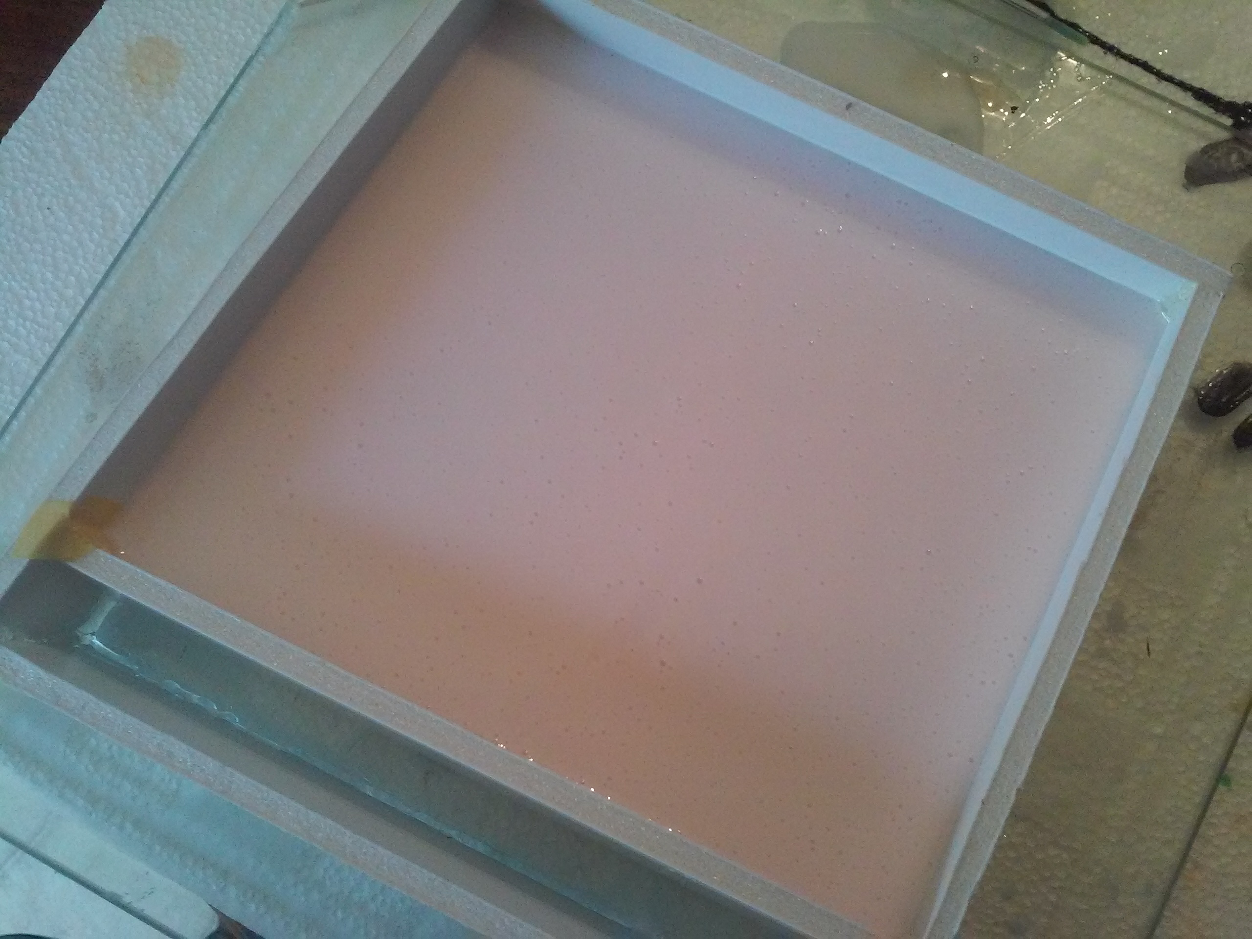

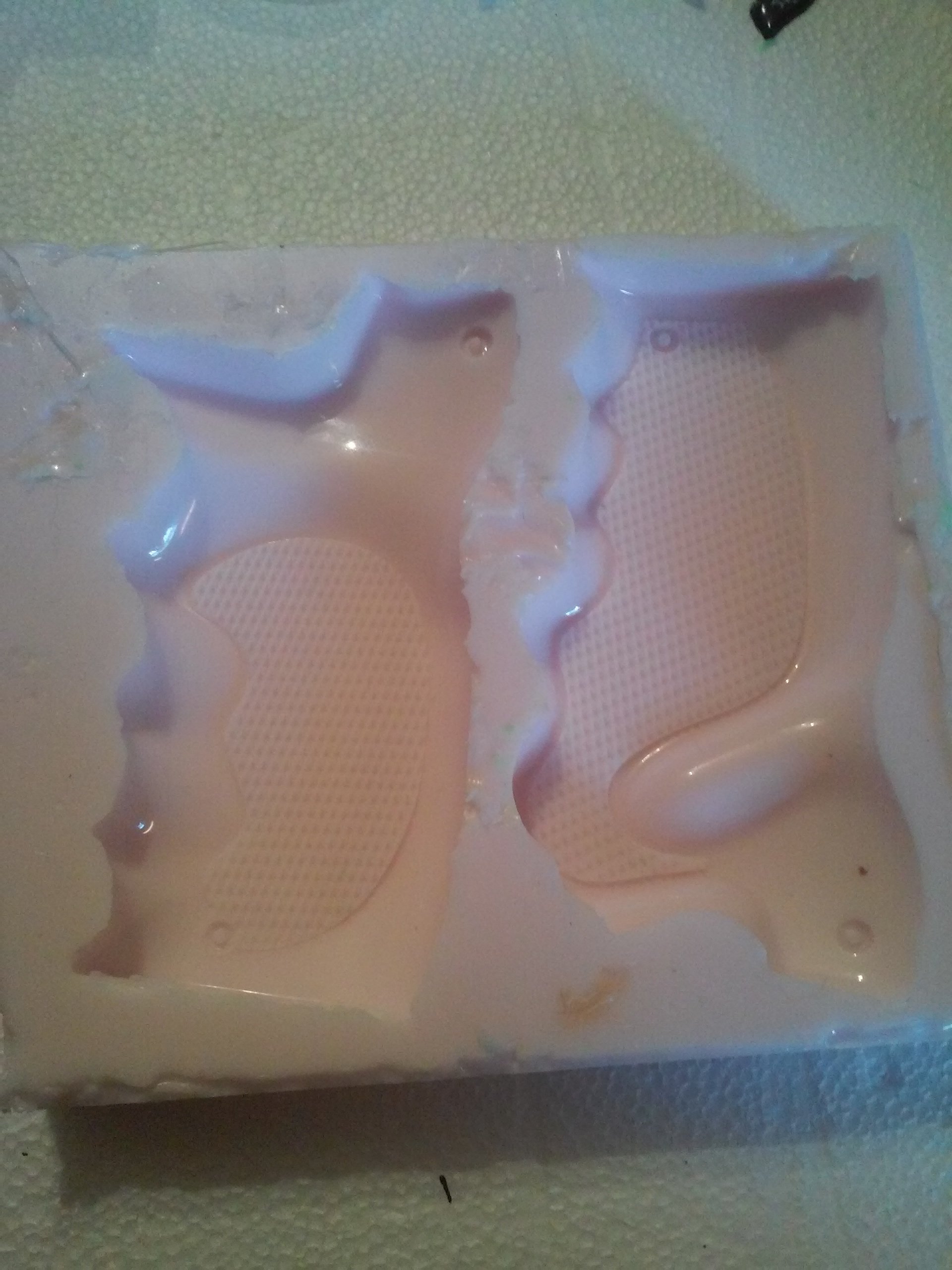

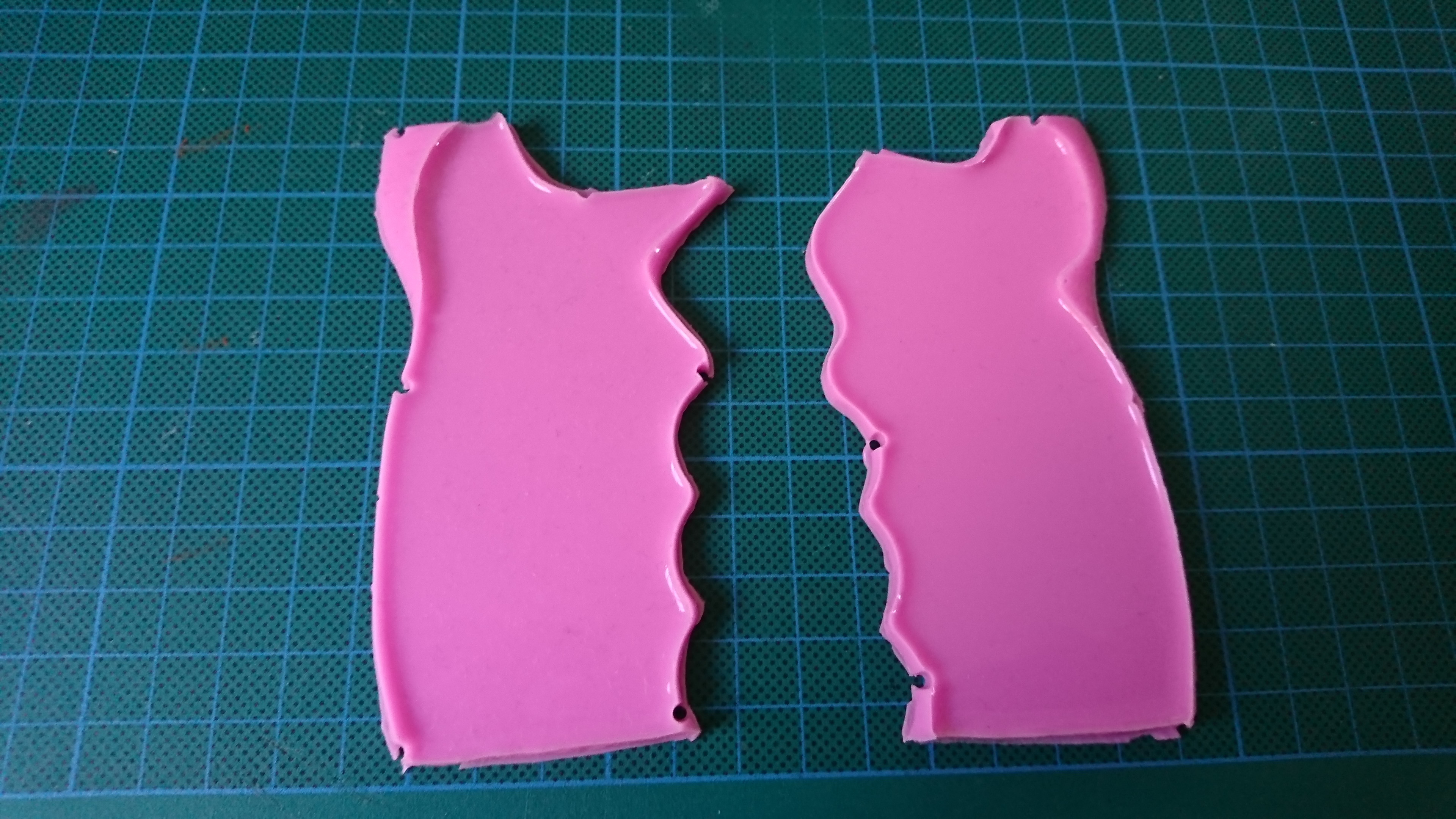

Picked up some proper mold making material today. Built my mold box, filled the grips with playdough, and poured my rubber. We will demold in 12-18 hours....l

Robiwon, Did you cut the nibs off the inside of the grips?.. For my mold box I used corrugated cardboard for the base and pushed the grips into the cardboard.. I had a small amount of leakage but the flap that was created was easily removed. Bonus was that This also gave me a fill line for the resin..
Cheers bryn
Yes, I removed the pins so they would sit flush to my glass base. Anxious to see how they turn out tomorrow.
Molds turned out perfect. Now the hard part, letting them sit for a few days before pouring resin.
I also picked up some red dye to add to the amber for a richer color.
