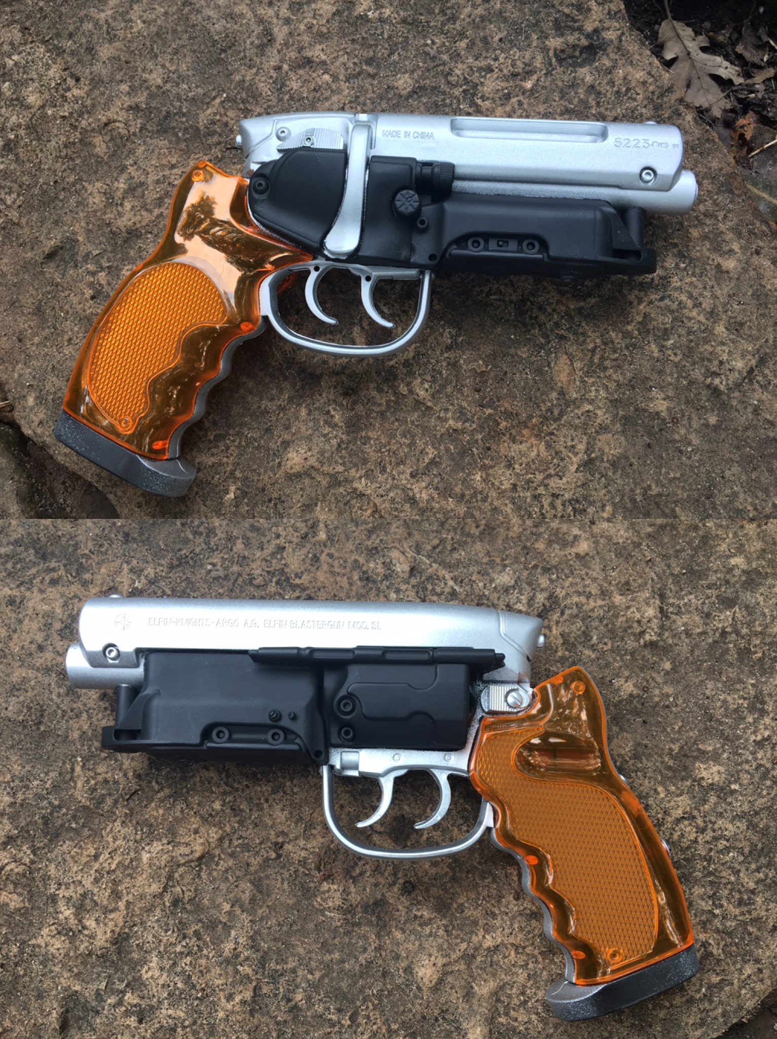

Thanks! Not sure. The only thing I did differently this time from any other times I've used the same primer is that I suspended it from a piece of string, outside. For some reason this put "texture" in the primer. I sanded some away, but didn't want to go too heavy for fear of losing some detail

So as you can see the metallic paint didn't peel. However, I do have lots of little spots where the silver snuck through the tape.
So after all the mending I'll have to do, I think I'll be okay with it. Then on to weathering.
Or I'll dislike it and start all over hahah
Thanks, mate :cheers I'm partial to it if I'm being honest.
Thinking I'll darken the barrel, trigger guard, triggers, frame, and butt. Then weather it all. And here's to hoping that I can clean up whats needed so I don't have to star over.
ill look into better tape and when I'm finished decide if I want to re-do.

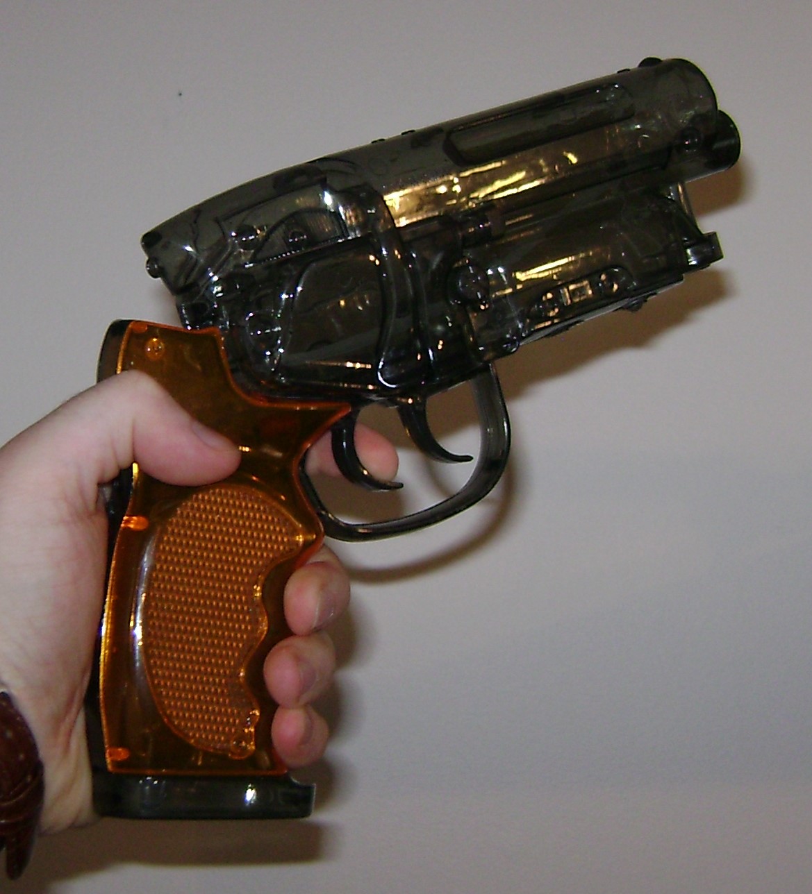

My clear black/amber grip pistol arrived in the mail today (does happy dance) :D Dang, it's kewl:
I'm so excited to receive this, as I've never owned (and therefore never held) a Blade Runner pistol before. It's impressive, even for just a toy water gun.
