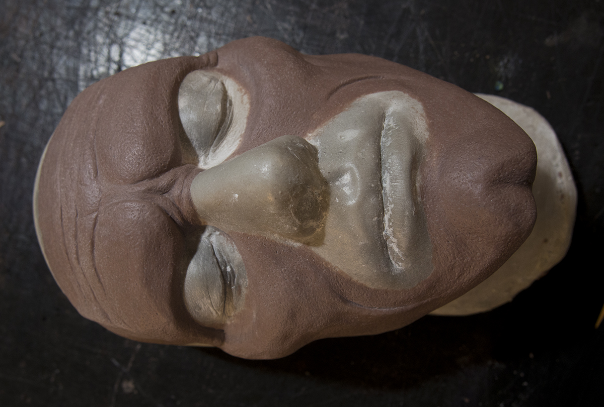

Then I started working on my face piece - I decided to go with only two pieces, I later discovered that perhaps a separate chin piece would have been a little more easier when applying the makeup.
These are the blocked volumes

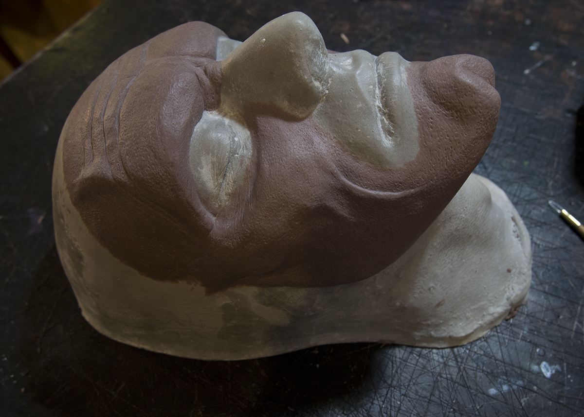

then I started adding some texture in it - Looking at the images of the original makeup, I found out that a general pore texture is what he seems to have in pretty much any area. Anyway, I decided to adding pores without stamps, by hand, to have a slightly more realistic look.
At this point, I was ready to cast it in Ultracal. I added flashing to my sculpture - I forgot to take photos of this passage - and then released the positive.
The lighter clay is the clay I used for my flashing. You can see that I left some contact area on the neck and on the lateral edges. You can also see my eye-keys.

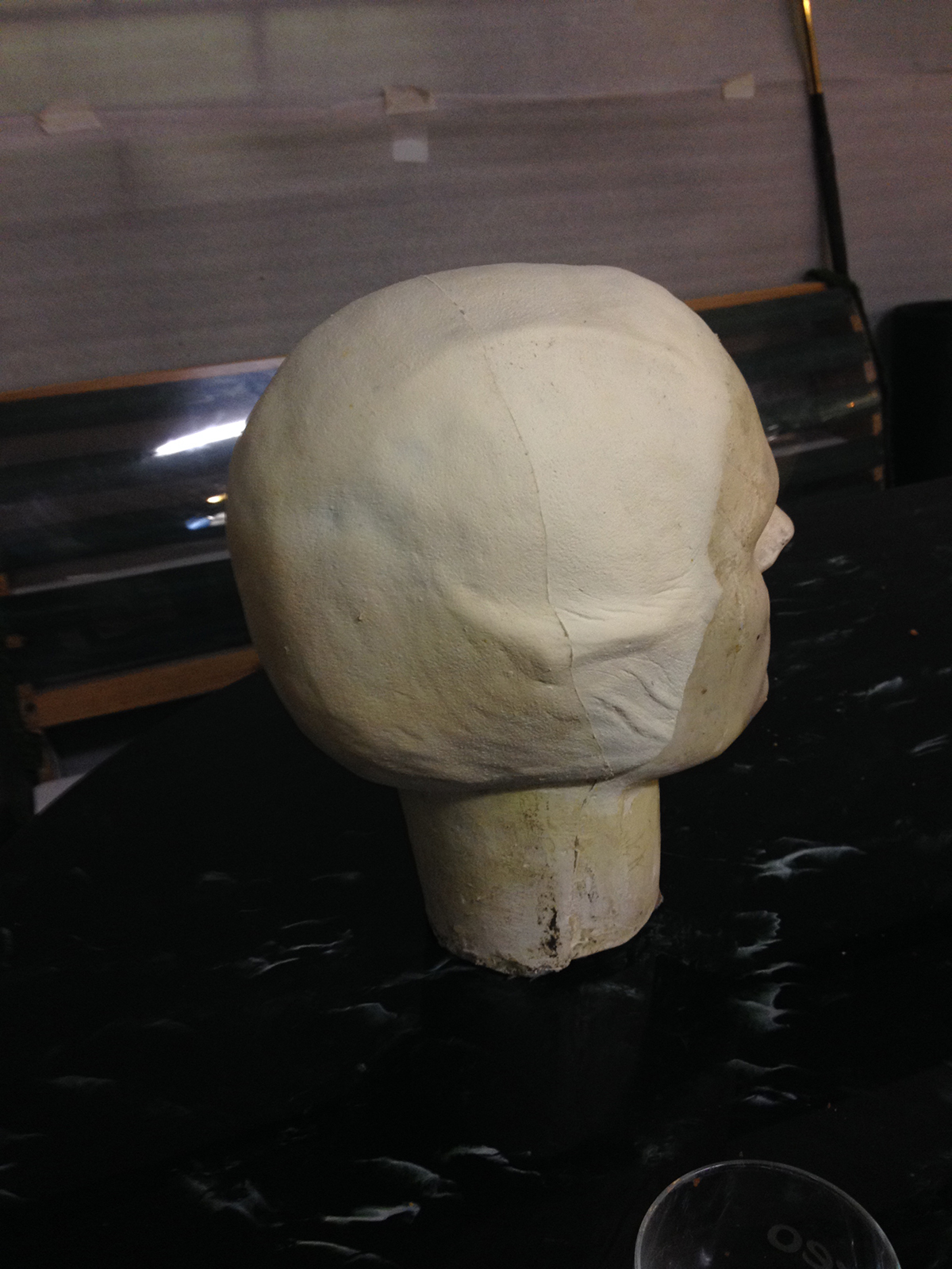

Then, i began sculpting my cowl piece. Same process, except that I used a general size mannequin head.
This time I needed to creat a two-part head mold. Again, I currently have no photos of the process (I begin working faster due to my deadline)
It has been made in Ultracal, too.
