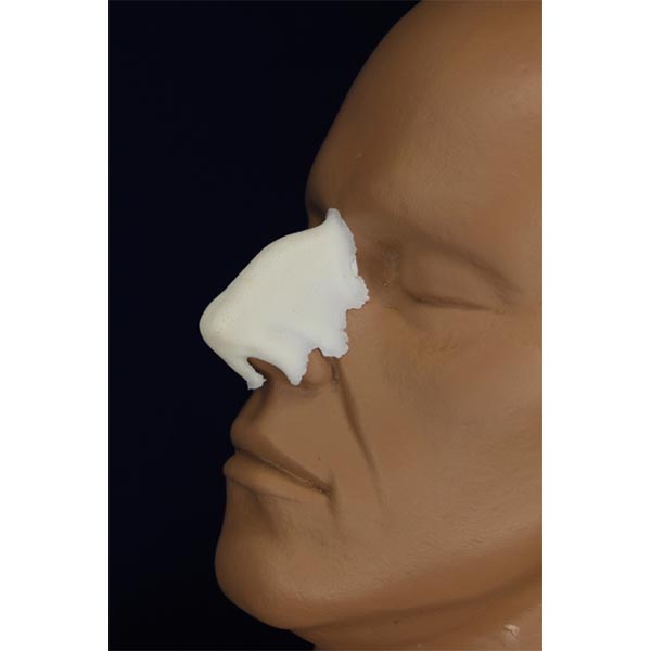

If the above is your piece, the main area you'll have trouble with is the underside of the nose where it meets your top lip. For this section, I'd probably get most of the nose on and secure and then apply glue to both your face where it meets and the piece. Let that dry and then carefully (making sure it's in the right place) contact the two surfaces together. That'll get you a better bond than just gluing as you go.
If the piece is made for a your face then the edges should be pretty good. If not and it's more generic, offer the nose up before you even open the glue and take note of any areas that it doesn't quite fit. When you then come to glue these down later you'll have an idea of which bits might need a gentle tug to get them to lie down nicely. You'll have more luck hiding tricky edges in the corner of the nose and underneath than you will smack in the middle of your face around the top edge.

I often cut pieces about when I'm working with foam so it's entirely doable but be aware whatever you cut away will leave a ledge as your blending edge will be gone. This is harder to disguise the larger the ledge is. Bondo, being made of prosaide is air-drying and doesn't dry well in thick layers.

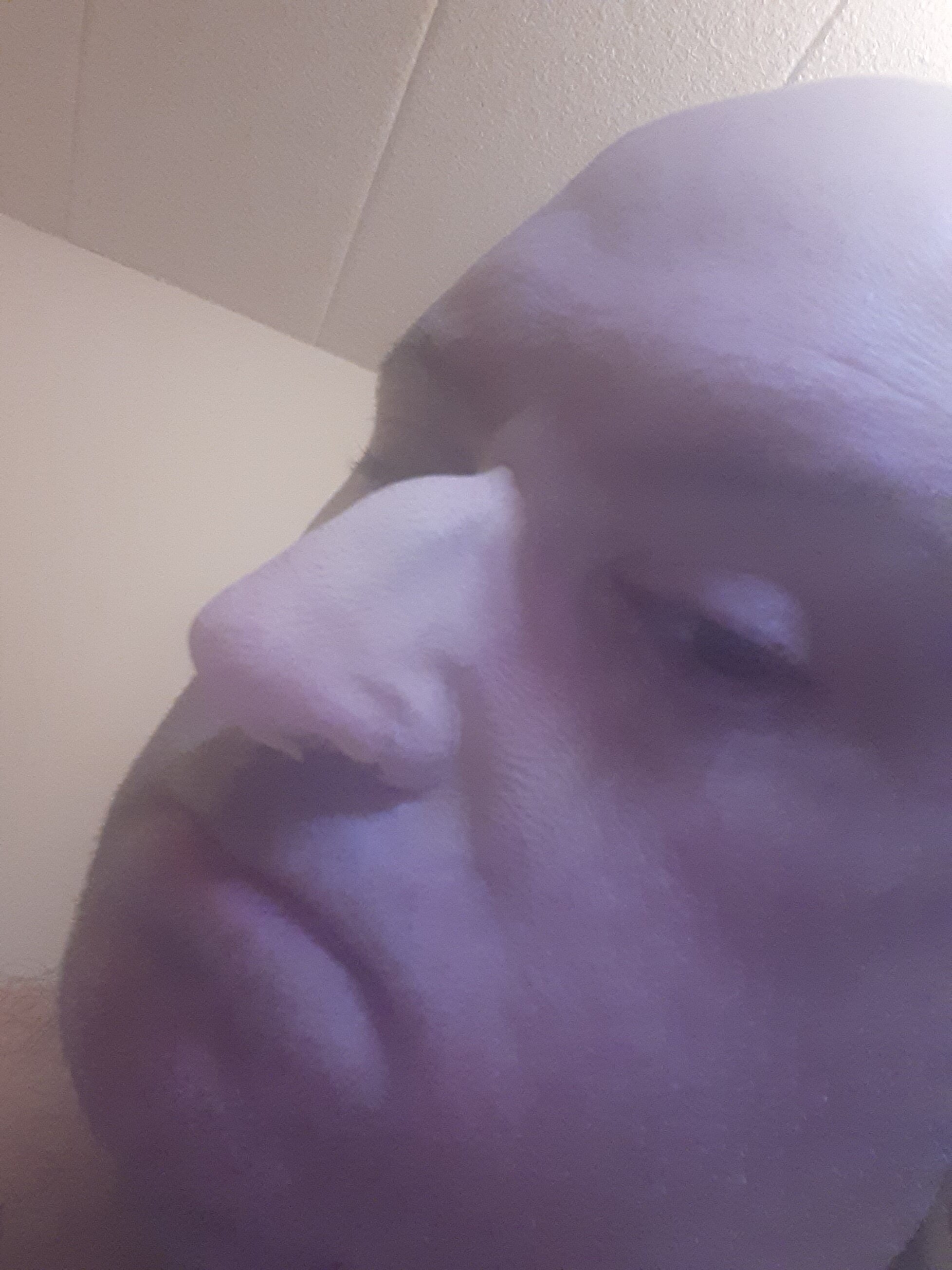

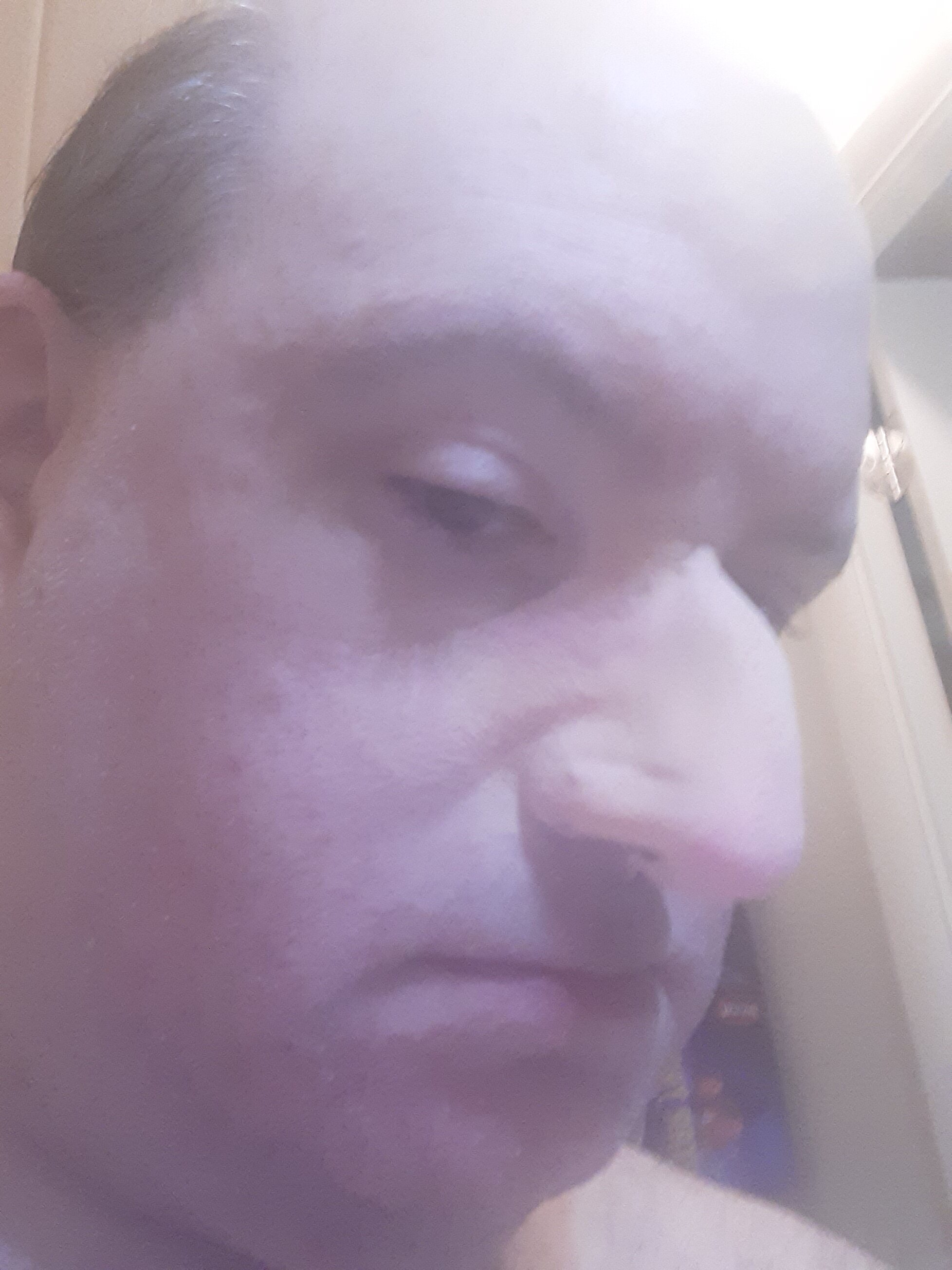

Meant to do this over the weekend. We did a test of the nose. I bought 2, and may buy at least 1 more. First attempt wasn't bad, apart from the greasepaint not matching my skin tones. We're buying another set to experiment with. And my girlfriend goofed with the pros aide and spread it out to almost my cheeks, which caused issues with the edges when we went to glue them down. But it did turn out better than we both expected.
In all seriousness, if you offer up the nose and powder round it fairly liberally, you'll see exactly where you need to glue to. Save your cheeks and whatnot.
