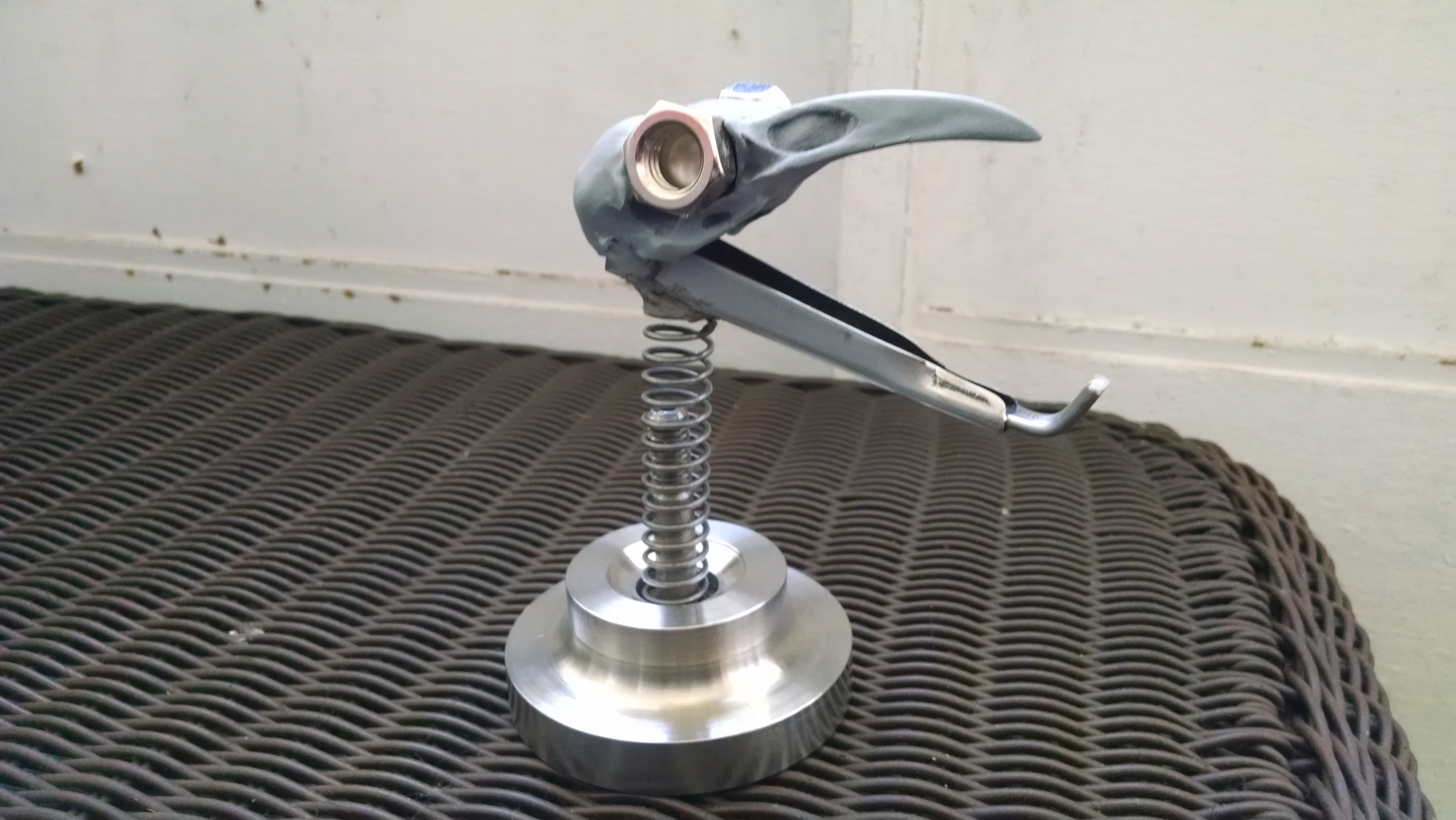

I have been following this thread and everyone did a great job providing the information to recreate this crafty dash ornament. I wanted to share my submission to the table and thank everyone for their hard work.
Looks great Magnum! Did you use a real wiper for the lower jaw?

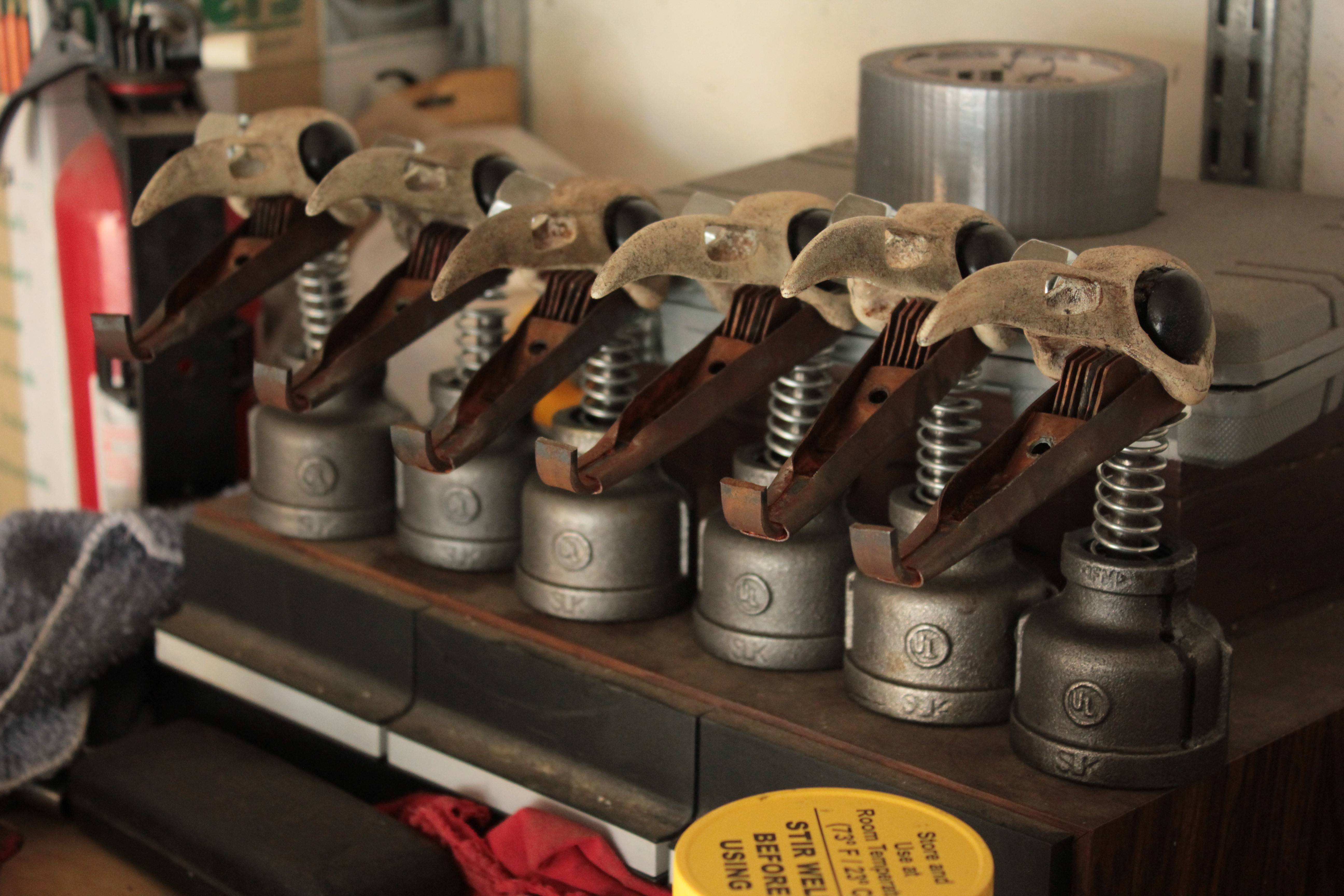

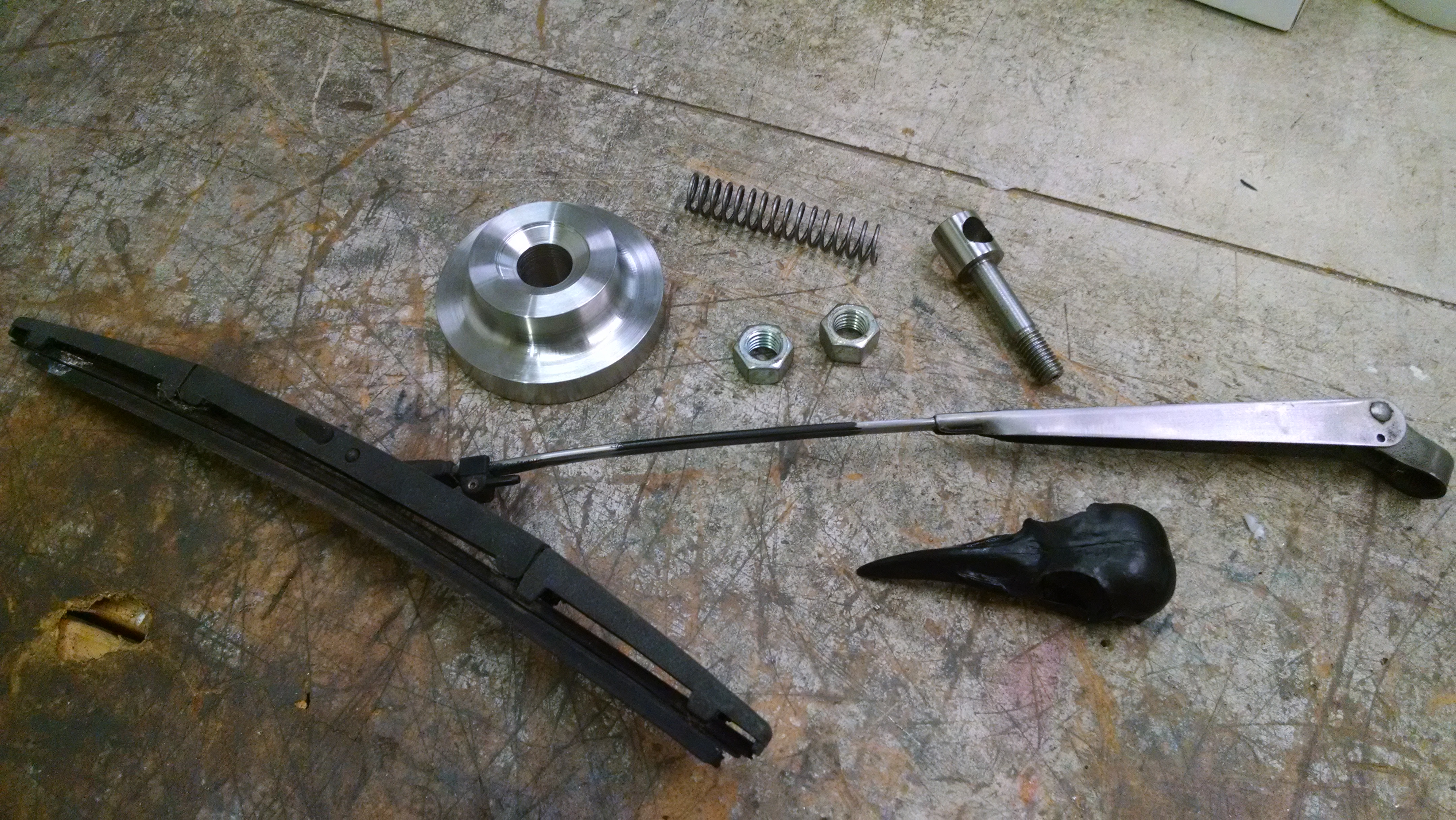

I did, the skull is a resin raven head from amazon, lower jaw is a rear window wiper blade from a jeep cherokee, his eyes are 1/2 13 acorn nuts, the base is stainless steel turned to shape, the pin was scrap and just a random spring. Here are some other pics of the work in progress.

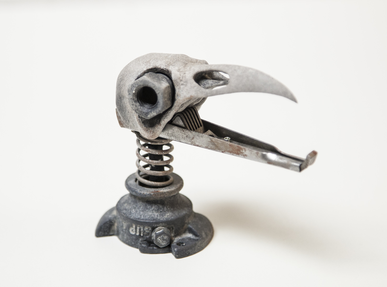

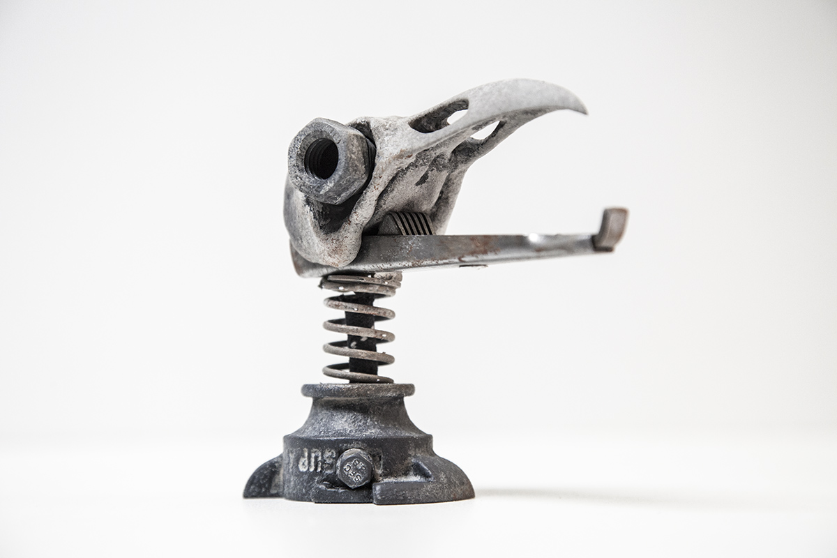

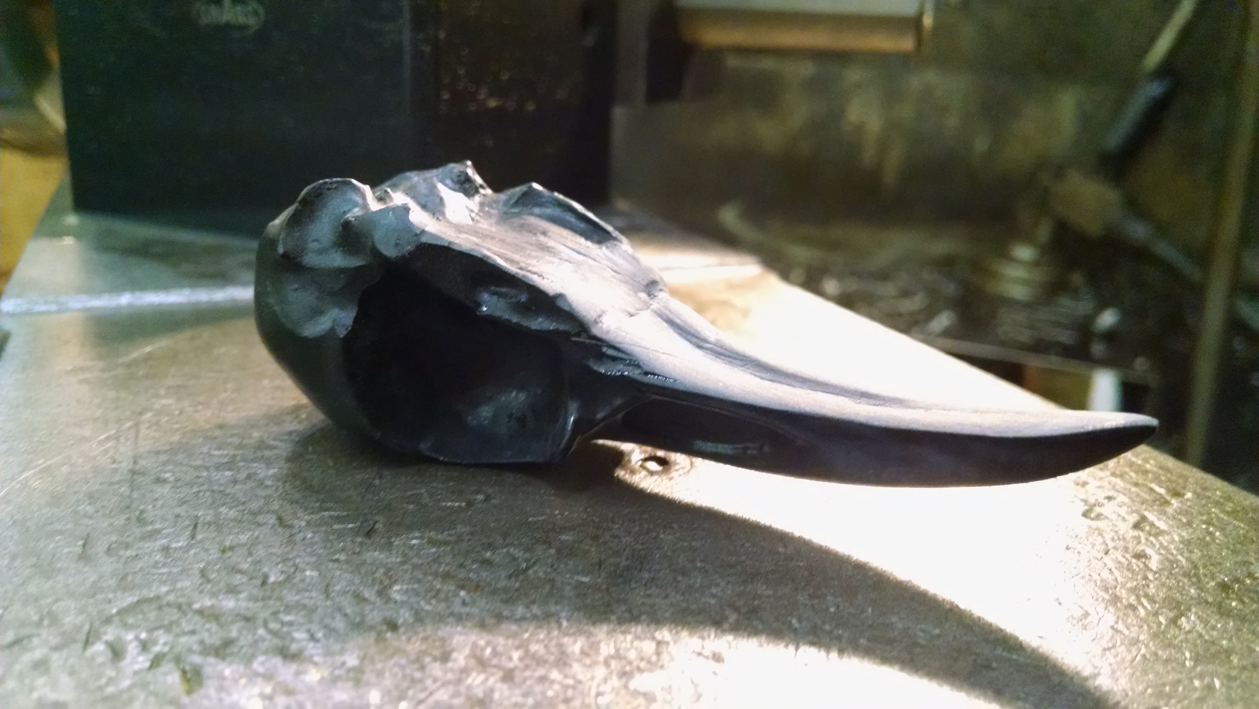

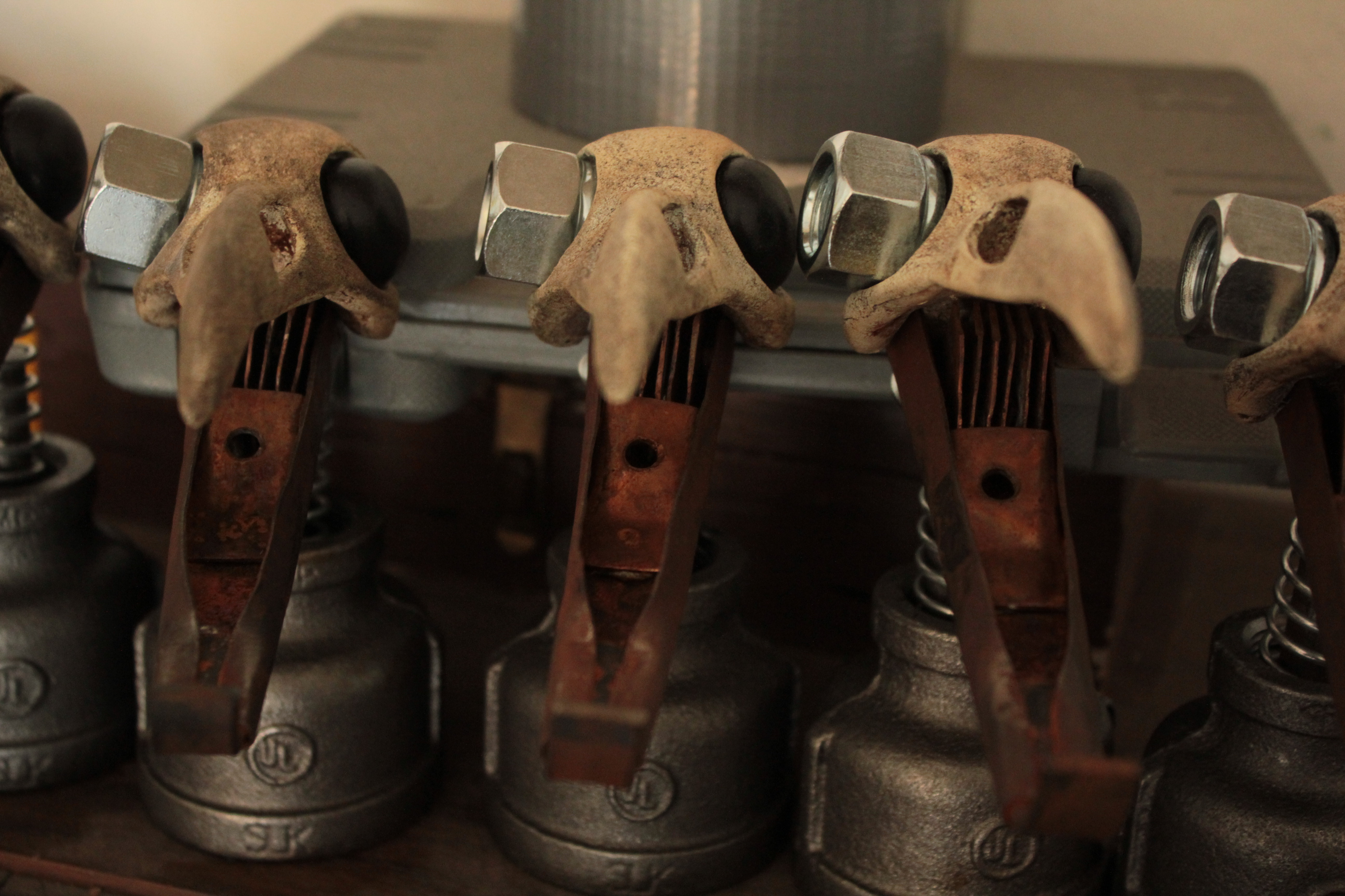

Just finished these up for the last group of people who ordered them through my Etsy shop and they're all updated with the new rounded "left eye".
But, whether fortunately or unfortunately, they aren't the perfectly rounded green-painted-black marbles or eyes (or whatever they are) as the original seems to indicate. No, because of my skull, I had to settle for something that I could get away with within budget and still, at least, resemble the original thing.
They're casts of modified carriage bolts I picked up from the hardware store. They're hemispherical so they sit better against the "eye cavity" of my bird skull. Same goes with the nut; can't use an acorn nut, gotta stay true with the hex.
One thing that I'm not going to change in light of the new stuff discovered in this thread is the guide rod. It's practicality of helping keep my bobble stable (from wobbling so far it becomes unbalanced) is too handy to sacrifice. It's going to remain a steel rod, for me.

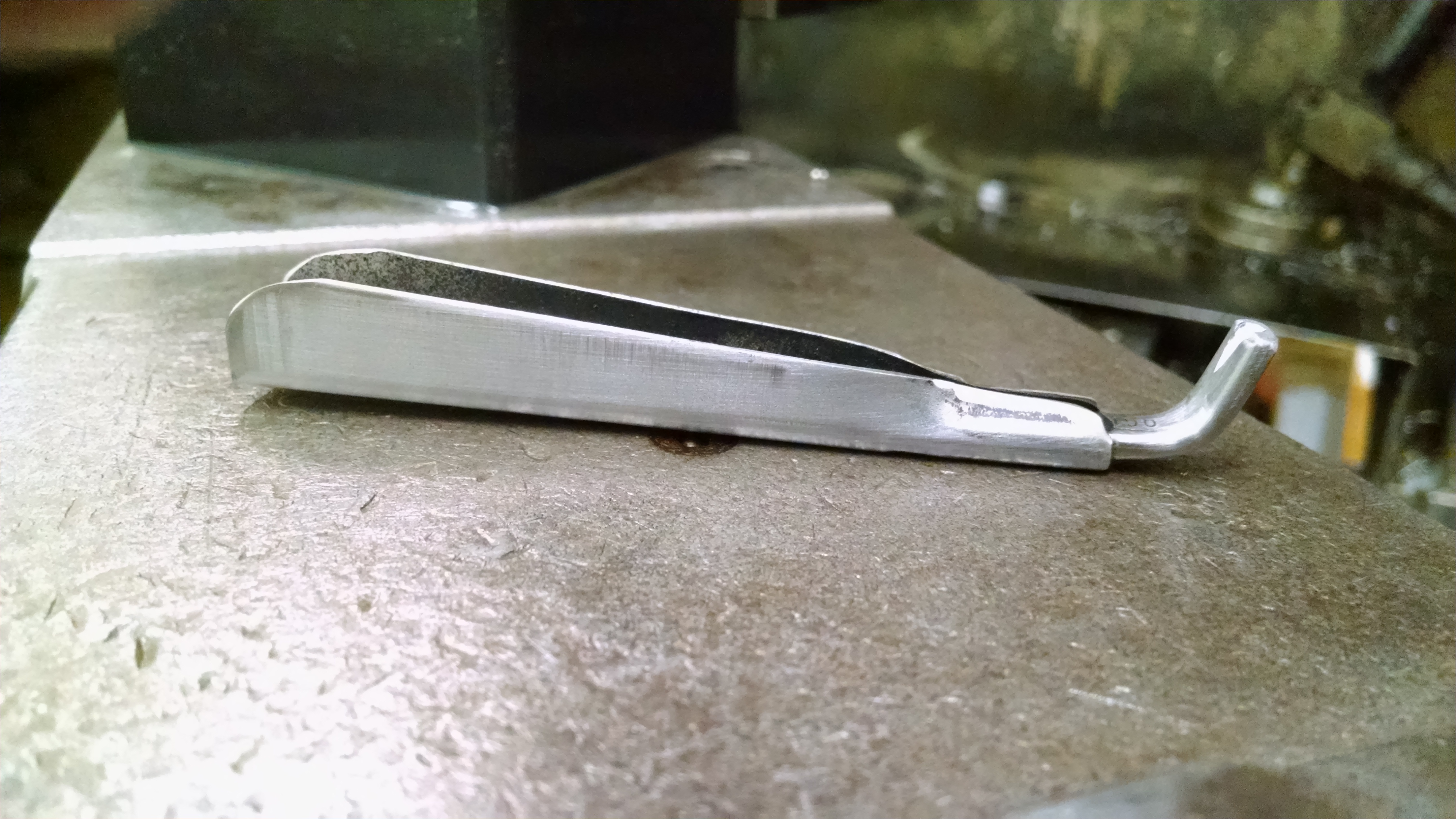

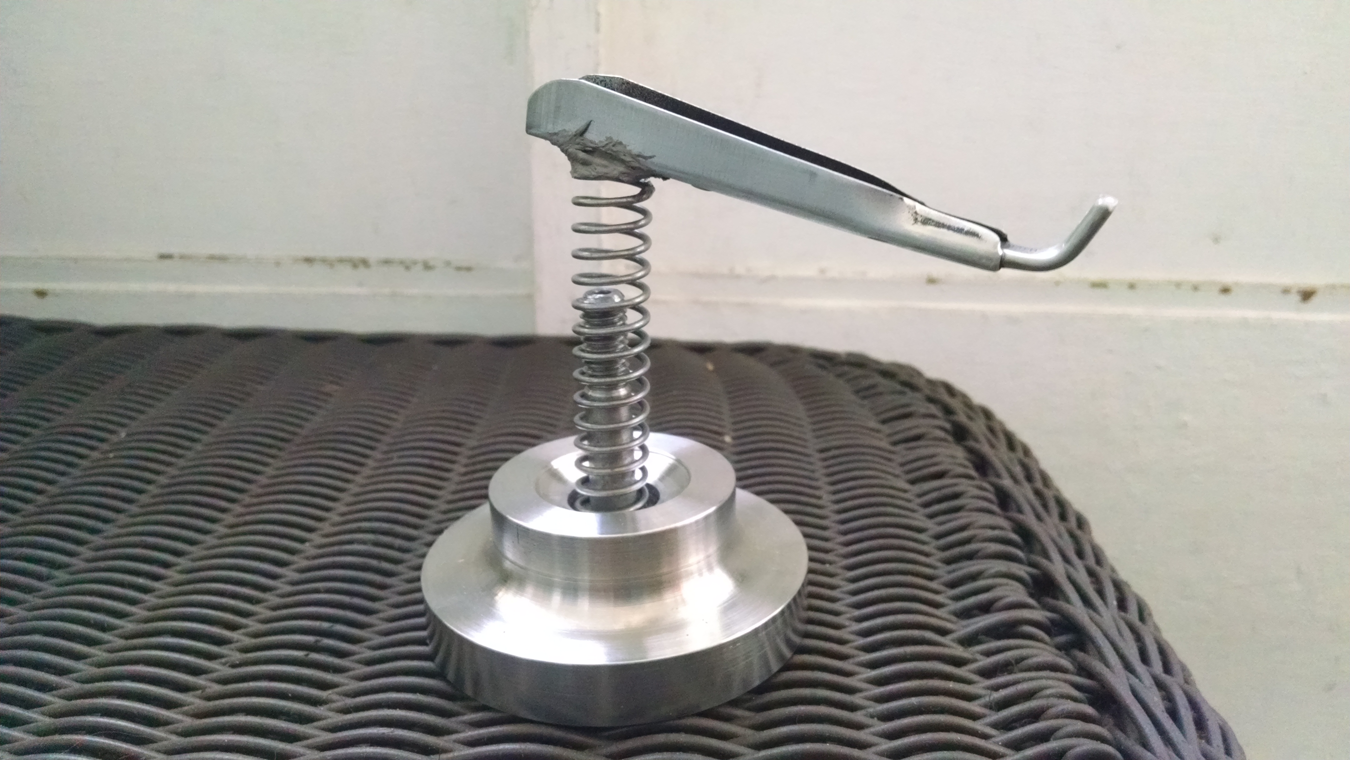

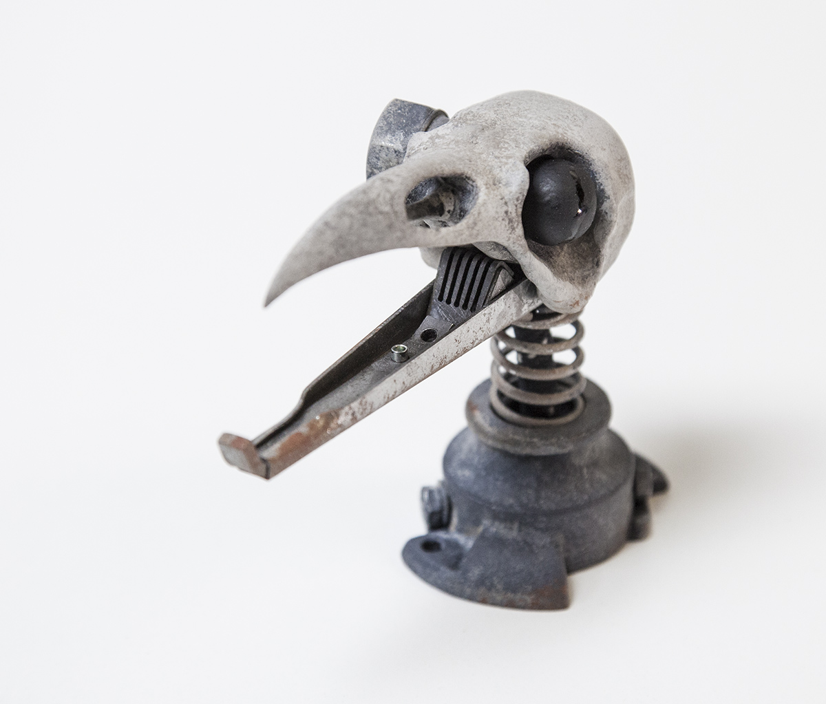

A lot of blood sweat and tears on this little dude, as you all know I'm sure! Mostly tears though. Couldn't find a 100% match for the wiper, and I'm all about accuracy, so the lower jaw is completely patterned and water cut from steel - real acorn nut eye, clear cast marble for left eye. I sculpted the skull and cast from Task 6 from Smooth On. Ordered a length of the custom braided double straight tracer ignition wire I mentioned a while back and that's the 'guide rod' down the middle. Base is urethane resin with an m5 bolt. A whole lot of setup for such a little, seemingly harmless prop! Whew.
Good job Logan looks the dogs doodahs .It has been a liong bumpy road this little fellah.I am relieved its all over the bloody thing sent me nuts.I am now onto other things Soooooo Good job everyone there are some nice bobbleheds around now . We maybe closet anoraks but theres not much we cannot sort out between us.
