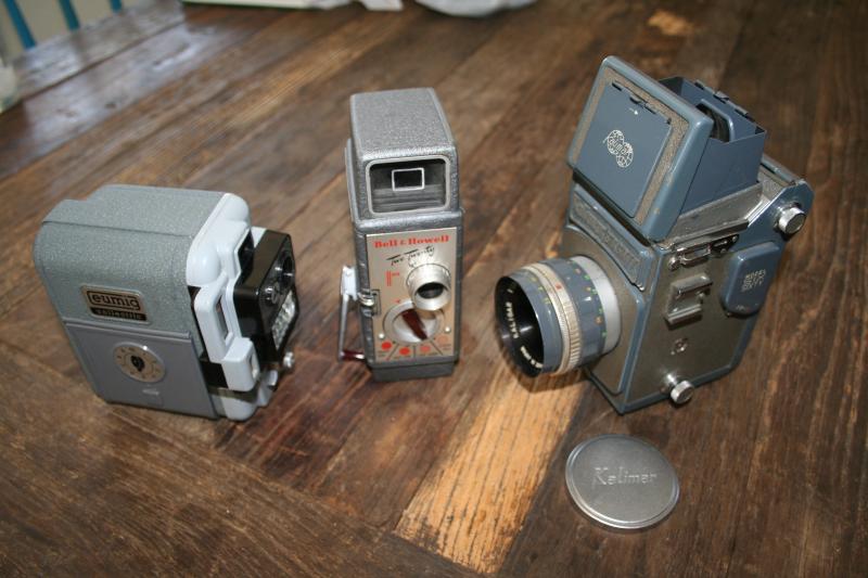

Thought I'd try my hand at a Macrobinocular build with my step son Stone. I was 7 when ANH came out in theaters and I saw it 22 times. As a kid, I thought these were so cool and futuristic. As an adult, they are still cool but I was laughing at the fact that they are built out of 5 vintage cameras. I started hunting eBay and found the Eumig unilectric and the Bell & Howell Two Twenty easily and for cheap! The Seagull 4A TLR wasn't hard to find, just hard to find one with an aluminum knob, not all black plastic. The Kalimar Six Sixtys pop up rather often but are CRAZY expensive. I've been fortunate, I found the B & H for $20.00, the Eumig for $40, the Seagull for $130, and the Kalimar for $145, all including shipping. I also purchased one of Russ Rep's aluminum lens plates he had left over. The Seagull and the lens plate will be shipped tomorrow which only leaves me the second Kalimar and a transition box. There are some fantastic "How To" threads here to disassemble the Eumig and tip on the Seagull and Kalimar part removal. Here's my start and hopefully later tonight I will start stripping the Eumig.

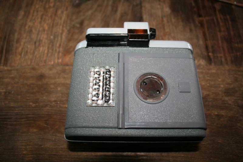

Referred to Clutch's Eumig breakdown thread and my son and I got our Eumig torn down. Great thread Clutch, thanks! We kept the yellow/orange needle in the black window as well. I cut part of the base of the needle off, shortened the needle itself and hot glued it in place. We got the clear bubble piece glued in place too. We're ready for the Kalimar breakdown and to add the RussRep lens plate once it arrives. I'll post a few pics tonight when I get home.

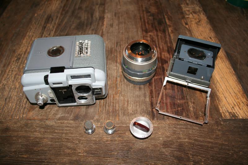

Here's some progress pictures. I tore down the Kalimar. One of the pop up knobs had a screw that had been glued in....nightmare! I finally gave up and cut the Kalimar body apart to get the knob section out and then Dremeled the screws from the back side so I didn't damage the button face. Not sure if I need the chrome part below the view finder. I need to really look at other member's build pictures. Still waiting for lens plate, Seagull camera, and the transition box.

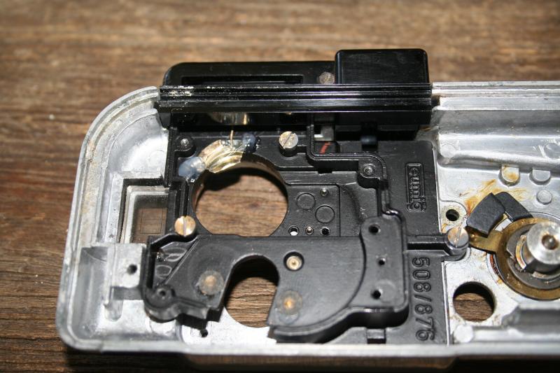

Check out Clutch's tear down thread again. I pried it apart and cut off my needle arm, left enough of the silver tab to hot glue it in place - the needle is fix and no longer moves. I shortened the needle too. I put the black piece that drops in the channel of the Eumig and then glued the needle piece on. Here's a picture of the back side

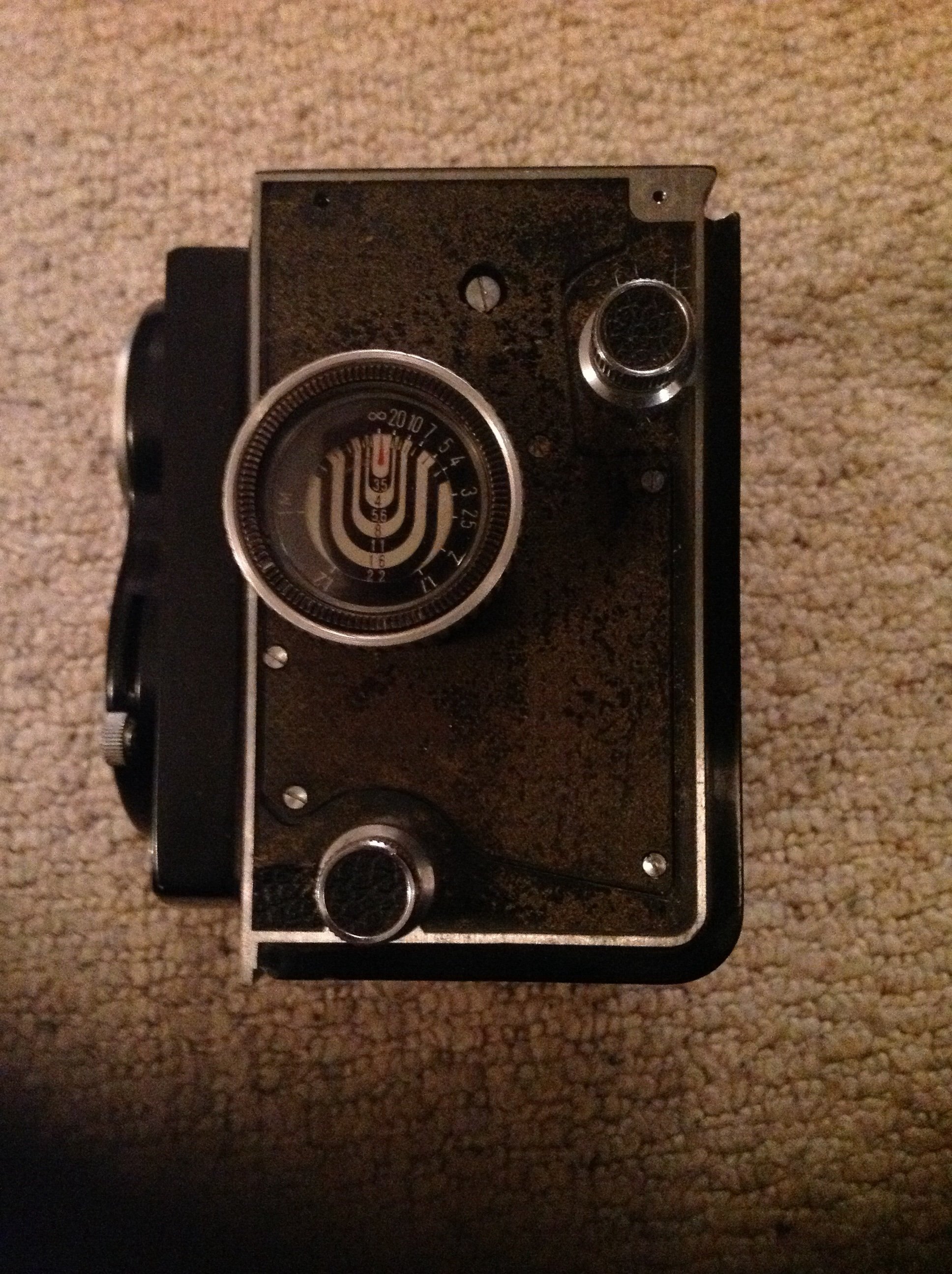

Cool thanks, I've got it stripped but ran out of superglue would you believe. I've also done the seagull, remove the chrome strip at the top (2 screws) remove the leather from the side with the knob, remove all the screws you can see. I had to break the back part off from around the knob. Then unscrewed the small black ring from the face, the glass ect falls out, popped the bell knob in and screwed it back together

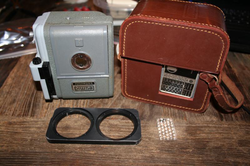

Nice to come home to Russrep's lens plate and the new Eumig. I tore down what I needed to on the new Eumig, swapped the light grey face on from the old one, and glued the clear bubble panel on. I have a few questions for everyone who has built these Macros.....
1. How did you mount the aluminum lens plate to the Eumig?
2. Did you recess the lens plate for the 8 lens screws to sit flush with the back of the lens plate where it mounts to the Eumig?
3. Where can I find the small taps for the lens screws?
