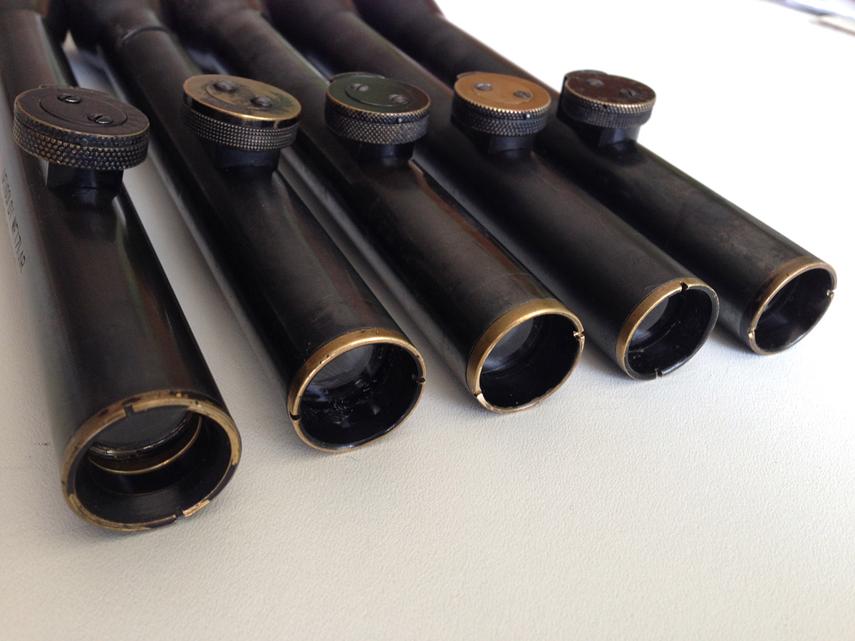

OK, so I've been crazy busy and lucky lately. None of these came cheap, but in the quest for prop accuracy I carry on.

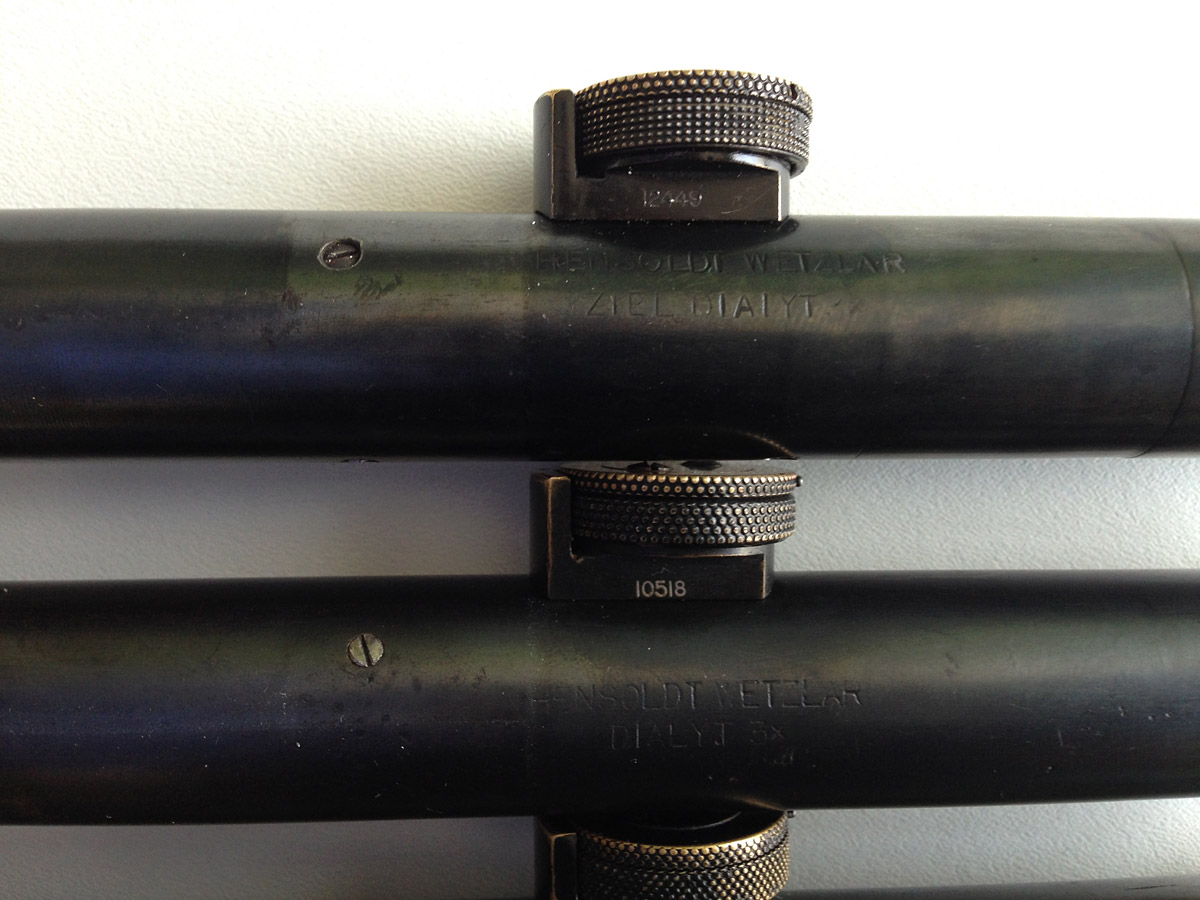

With so many weird variations on the hensoldt wetzlar Ziel Dialyt 3x scope, I've come across a few different ones. All the correct model... all different, and no parts are interchangeable on them due to tiny variances in tolerances and parts.
They ARE all the same size and shape though... You'll see a DEC replica at the bottom, which has the correct bell dimensions, windage knob, and everything is spot on to my examples except the barrel length is different. Go figure. It's supposed to be based on a real scope, so I don't doubt there's more variations out there.
One of these (which is for sale when I get time to post it) has/had an adjustment knob for focus. I removed it for these pics... and the windage knob on that one is HARD as heck to move and stuck. The hole for the adjustment notch though would be covered on a blaster by the mount rings anyway.
This cross hair WAS straight when I got it.. but the heat from the torch to remove the claws warped it. I'm not brave enough to gut it to try to fix it either... Oh well.
replica by DEC

Very cool, Scott! I can't believe you managed to get your hands on so many!
FYI, it's not too hard to straighten out the cross hair. I had to do it in mine. Just keep good track of how everything comes apart and it goes back together easily.
Re: Han Solo ANH DL-44 SCOPE: All my Hensoldts
One came today actually. ^_^
Ok man, you gotta tell me how to do it then. Please....

wow...nice,
...and yes, the replica dims were taken off a real, accurate vintage HW. Interesting variations... for a precision instrument.! : )

Very nice collection of Hensoldts! Sorry in advanced, but I have to ask; would any ever be for sale? :thumbsup
You've accumulated a fine collection of scopes.
The comparison images shown are quite educational. It's certainly interesting to see how they varied.
Those are beautiful. I would love to get my hands on one. Anyone know why there is so much differentiation in scopes?
I'd love to know too... just whacky why they're all so different. Different knobs, cross hairs. One of mine even had a super thick front lens ring, that I lathed down.
Markus, post your pics here, and take some new ones. This can be the catch all Hensoldt thread. Or your thread... either way.

Is it just me or does the DEC bell seem to have a slightly sharper transition where the bell tapers? The taper of the originals seem slightly rounder in these pics.
