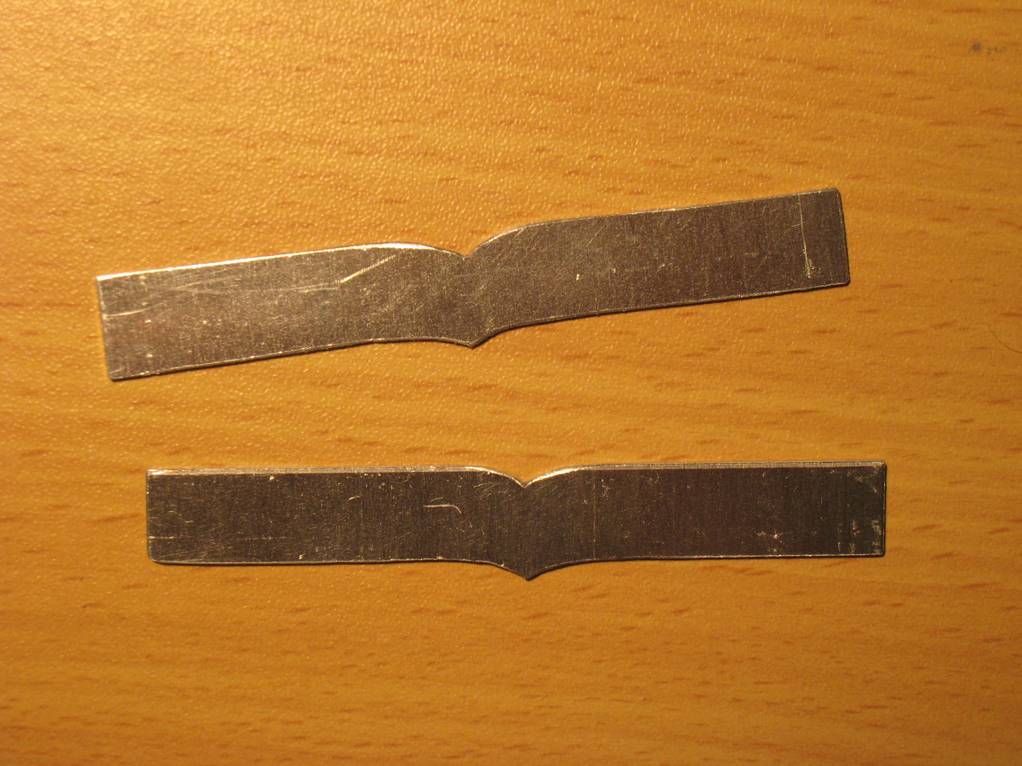

Here are my first two holders cut out of 1 mm thick alu sheet.
The alu looks pretty scratched up close but it's not that bad actually. Still, I'll have to polish the holders after installing them - maybe with leather?
I am also yet to bend any of them. Maybe when I get a really poorly cut piece. But otherwise, I am waiting for the belt to begin any bending.
