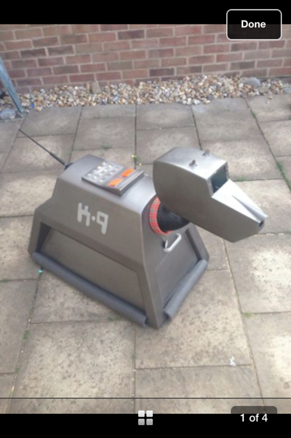

I have just got myself a static fiberglass K9 and wondered if you have still have your plans of how you put the lights in and motorised him.
Any help you could give would be great.
Thanks.
John

Does anyone know someone who would take my model on as a project?

I live in Brighton and there seems to be no one in the area to customise my K9 for me. (yes I have tried google)
Do any of you guys know anyone looking for a project? I am willing to travel (within reason) to try and get him sorted.
Thanks
