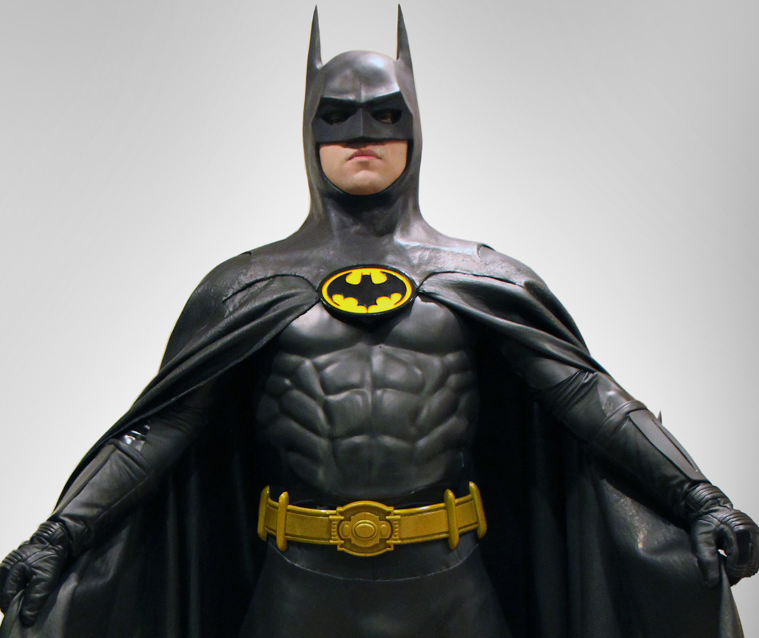

It's been years since my last update and I have been carefully studying the movie suit more and more while reworking bits and pieces, such as my belt, gloves, cowl and armor. I've remounted it all to a new under suit I sewn up myself (getting better at it..lol) which is now a two piece instead of one whole under suit. It still follows majority of the design pattern of the real under suit, only that I can unlatch it in case i needed to use the men's room. :p

So much work has gone into this hobby. But this is it. I'm done with it. If I ever wear another Keaton bat suit again, it will have to be a foam cast armor or some kind of flexible foam with either a thin skin of latex or urethane rubber. Not doing this rigid rubber stuff anymore.
I hope you all enjoy the pics below.

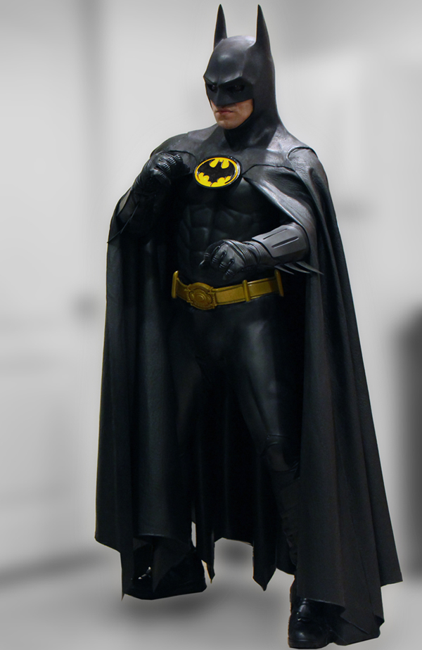

My very first suit was made of urethane, which was back in 2009. The urethane armor was nice but too big for me, as it was sculpted to fit bigger guys around 6 feet tall or something close to that. I'm only 5'8 with no shoes on. My boots give me about and inch and a half of height, so I end up being almost as tall as Michael Keaton was at the time, which according to his actual body cast, was 5'9 (with no shoes on either). Anyways, I then obtained a latex set of the same mold which has shrunk down about 5 percent (maybe more). These fit my body much better although they were cast too thick and rigid, to be honest. The armor you see up here is actually the same one I used in the earlier posts I made a couple years ago. All I did was remove all the old layers of plasti dip, and re-painted it. Then I went in with a Q-tip dipped in armor all and drew around the muscles to accentuate the cuts, as well as add a slight sheen in between while the rest of surface is more flat and rubbery looking.
The arm and calve pieces here are actually urethane. The cowl is a new one, also made of urethane, which I ended up reworking to look more like it was fresh out of the oven (foam latex). I made the ears more straight and refinished the face and buffed some of areas above the face to help it react with light and bring out certain details, like the heavy brows and round dome on top of the head, etc.
Im no longer going to wear this suit as it is too uncomfortable. Unless I can get these pieces made in softer polyurethane foam skinned with a thin layer of latex, I'm done wearing the bat suit for good. I've had a nice long run with it so I'm ready to move on. But if I can get a softer suit made, then I'll keep that torch burning for one more year. :thumbsup

Hey Darctic, thank you. That's my paint job on a rigid urethane strap and resin buckle with pods. It's a mix of bronze, chrome yellow and a darker bronze pigment mixed in a clear flexible base paint.
One thing I've learned about this stuff is that it's not as easy as just grabbing parts and gluing them on. You really have to know where the parts sit and how to finish them up so they look legitimate. Took me a lot of tries to figure it out. It also helps to stay in shape. Last year, I managed to gain a few pounds and a gut. So I worked it off for 2 months and ate mostly salads with protein on the side. Eventually, my handles disappeared and my gut has diminished quite a bit. I still have more work to do on myself but at least I got to slip into my suit without any trouble. I really love the 89 bat suit. More than any other bat suit made. Part of it is design, the other part is nostalgia.

Thank you gentlemen. I agree, they're a pain to get in and out of. Takes forever. The shoe's original color were black. So no dyes involved. For the silver soles however, I did paint them with flexible paint made for vinyl upholstery. The paint works fine on the sides of the shoes but of course, as you can already imagine, scrapes off the bottom of the soles after walking in them. I only recently learned of Angelus paint for shoes and wonder if that's more durable over time and abuse. I've seen the UD 89 boots and they look pretty good too.
Hey Collector, you'll want to buy some swedish tracing fabric. This is for your boot tops pattern. Then either some upholstery faux leather or real leather (you can manufacture a set of boot tops from some used black leather pants). If you have a place where they can sew it on for you, then just take your stuff there with a print or two of the real bat boots (or even mine here) and they'll sew it right onto your shoes for you. Otherwise, you'll either want to glue them on to your shoe, which is what I did or buy yourself a sewing awl and good luck.
I have several large pics of my boots from different angles I can PM you with, to help give you an idea of what the pattern looks like around the shoe. I own a sewing machine, so I actually sewed the two halfs of one boot top from the rear region and used strong glue (you can use leather glue or even a rubber toughened gel super glue, to attach them to the ankle region of each sneaker.) I cut the tongue out of my Nikes and glued in a long flat boot tongue strip from the same faux leather I used for the tops, underneath the shoe. I'm not sure if anyone else ever did this but I did it so my boots would look less puffy from that area. I also hacked out the foam sponge neck around the ankle area and only left the thin leather outer region in which my boot tops were glued to. This helped my ankles look nice and tight like the real boots. I gotta get back to work in a minute but when I return, I'll send you that pm with the pics. :)
