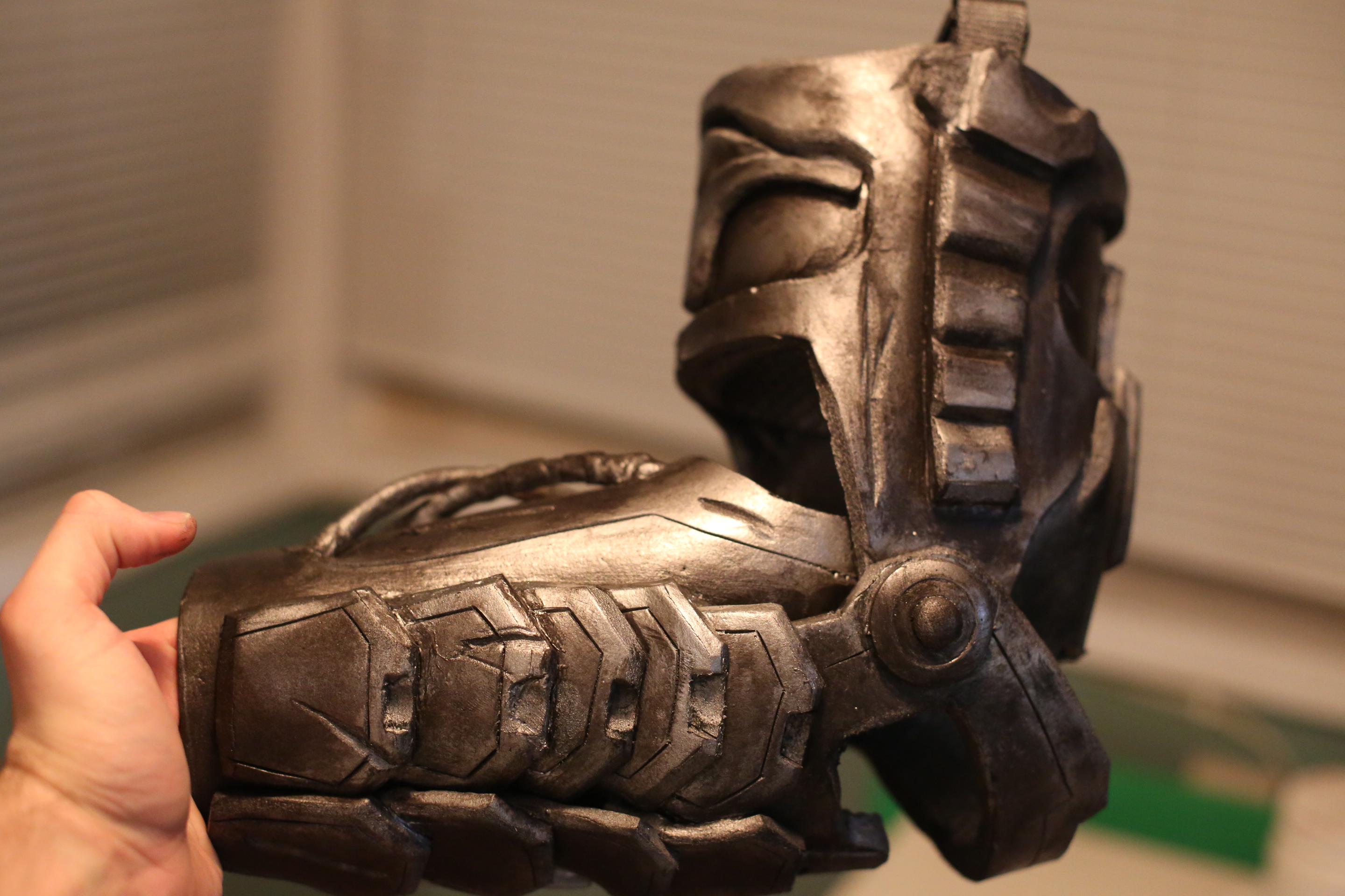

The costume is all foam. 1mm, 3mm craft foams, and thicker floor mat foams. There are two different types, one is the large roll floor mat foam which i used for the arm pieces, then the thicker square pieces.

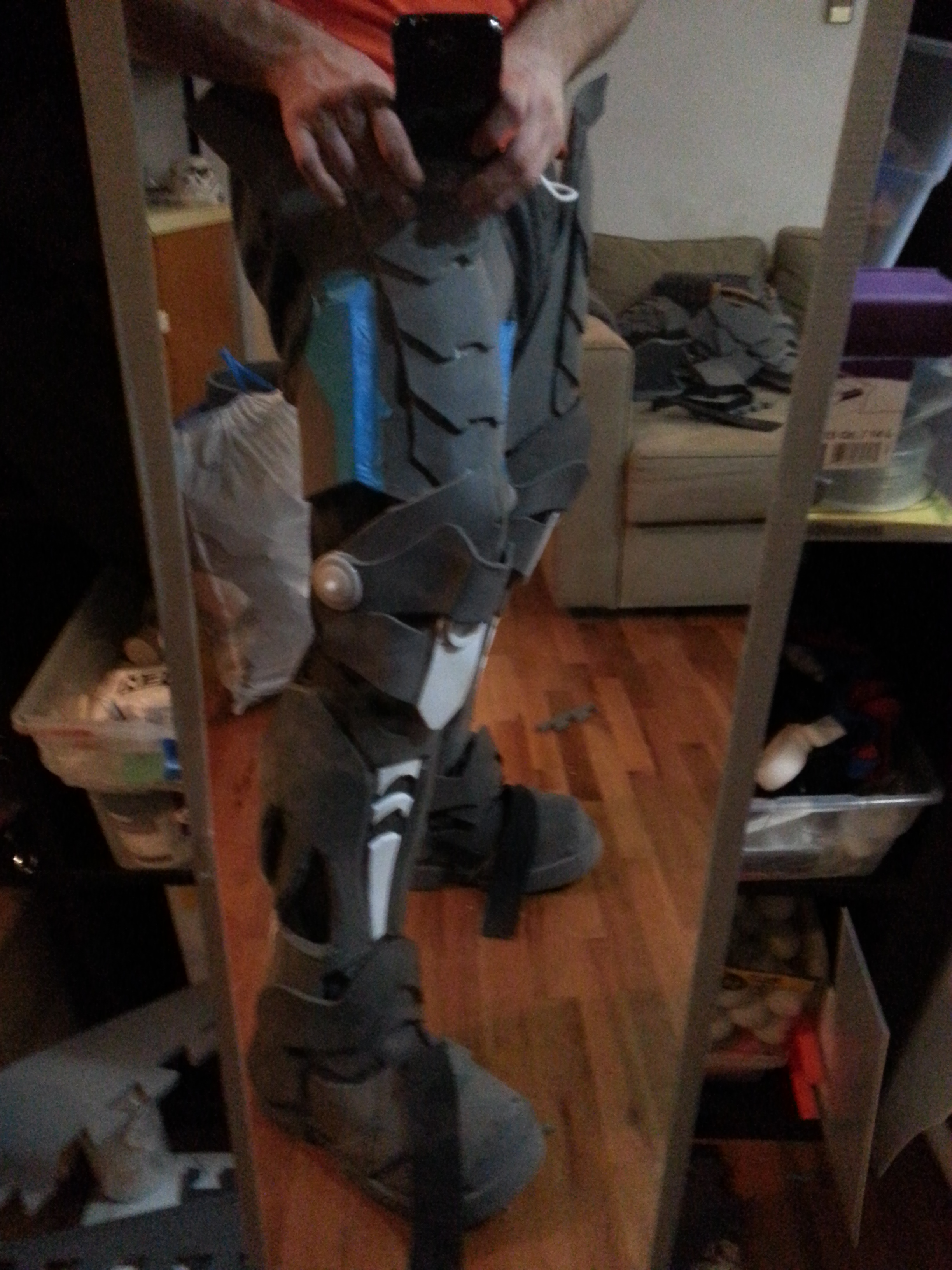

the elbow and knee joints articulate thanks to 'doll joints' which you can buy super cheap on amazon. This makes the arms and legs very easy to walk in and they function 'as they should'

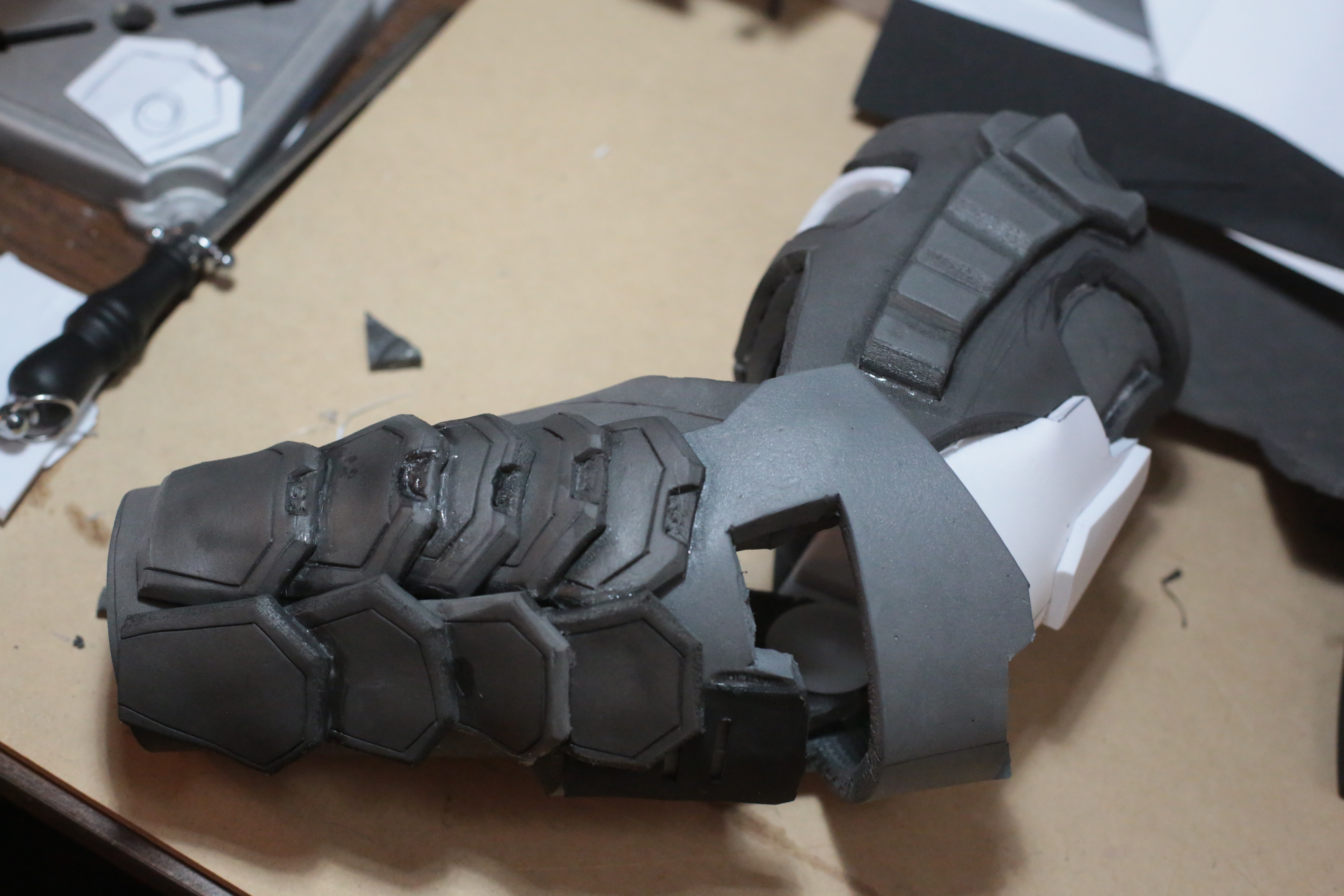

Here is a picture of the arm before painting.

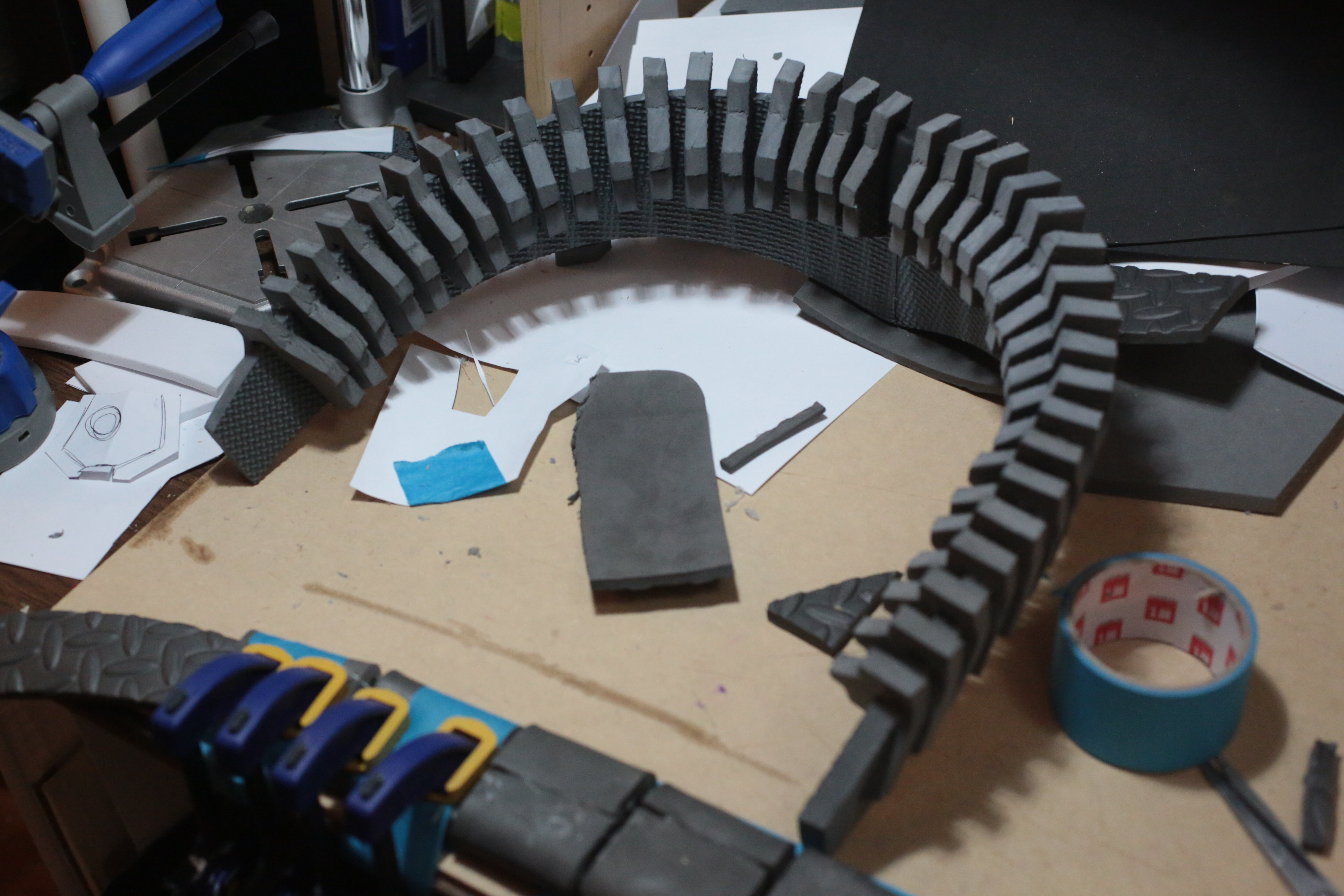

Neck Piece WIP

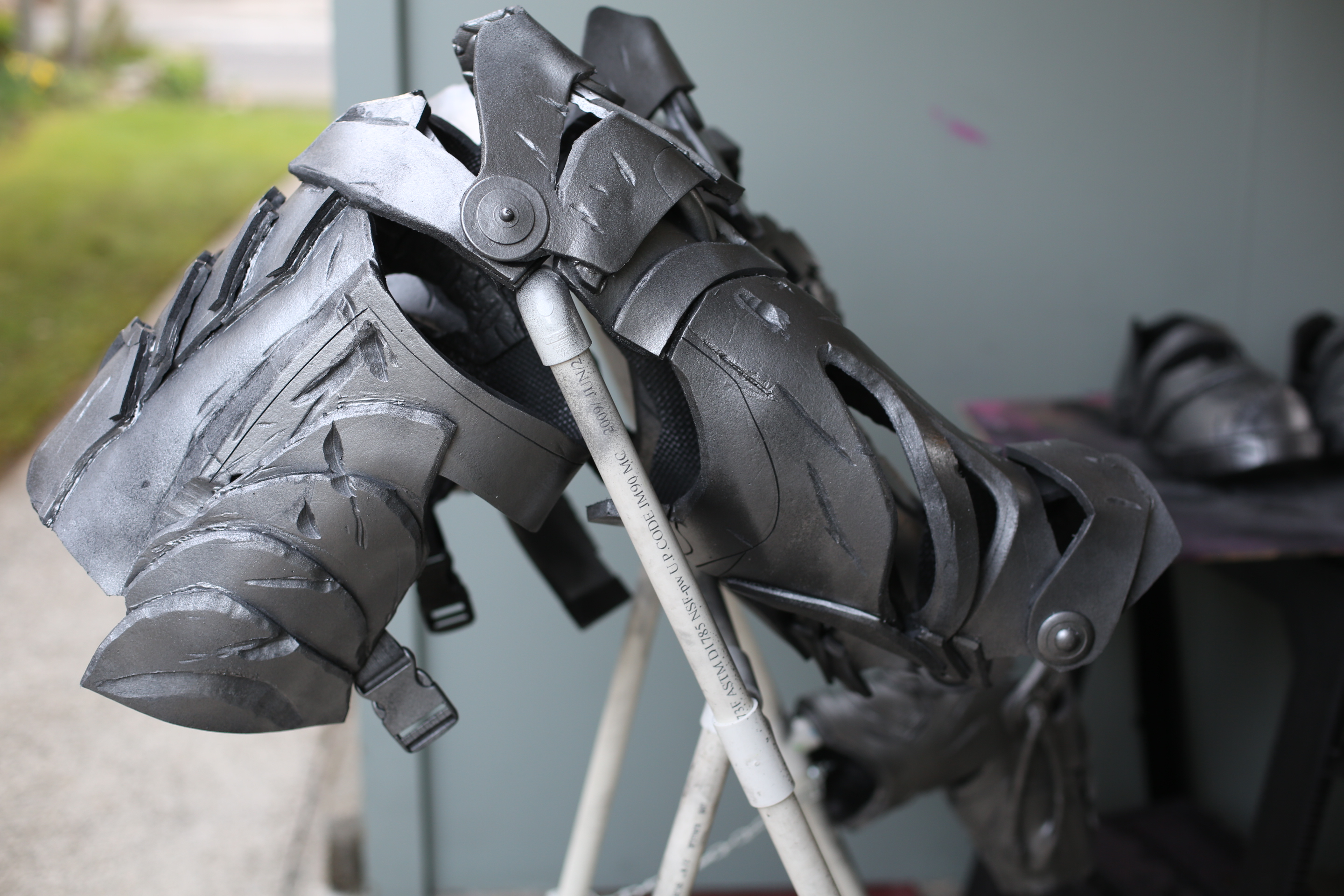

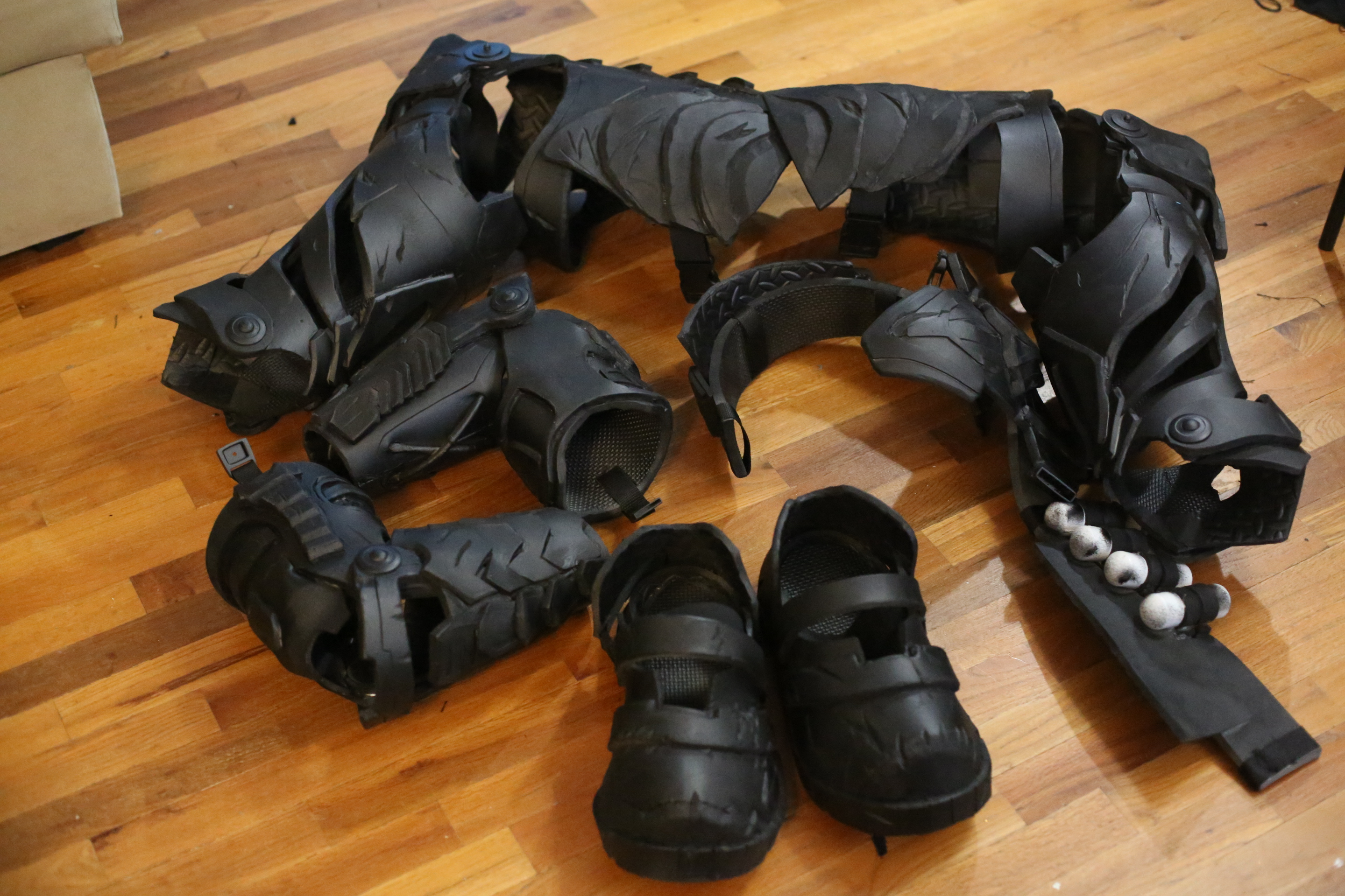

All the armor bits dipped and ready for paint

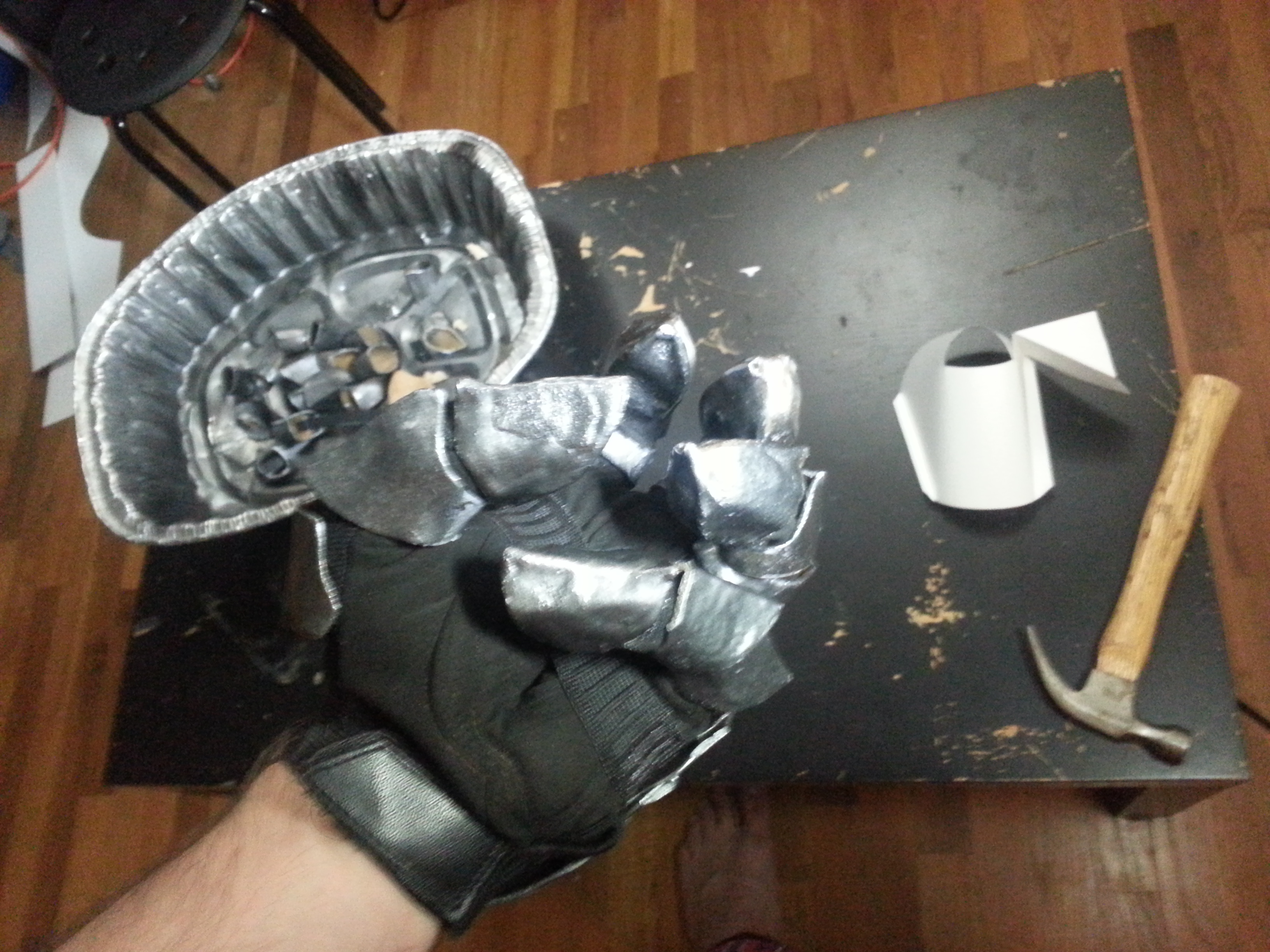

More WIPs

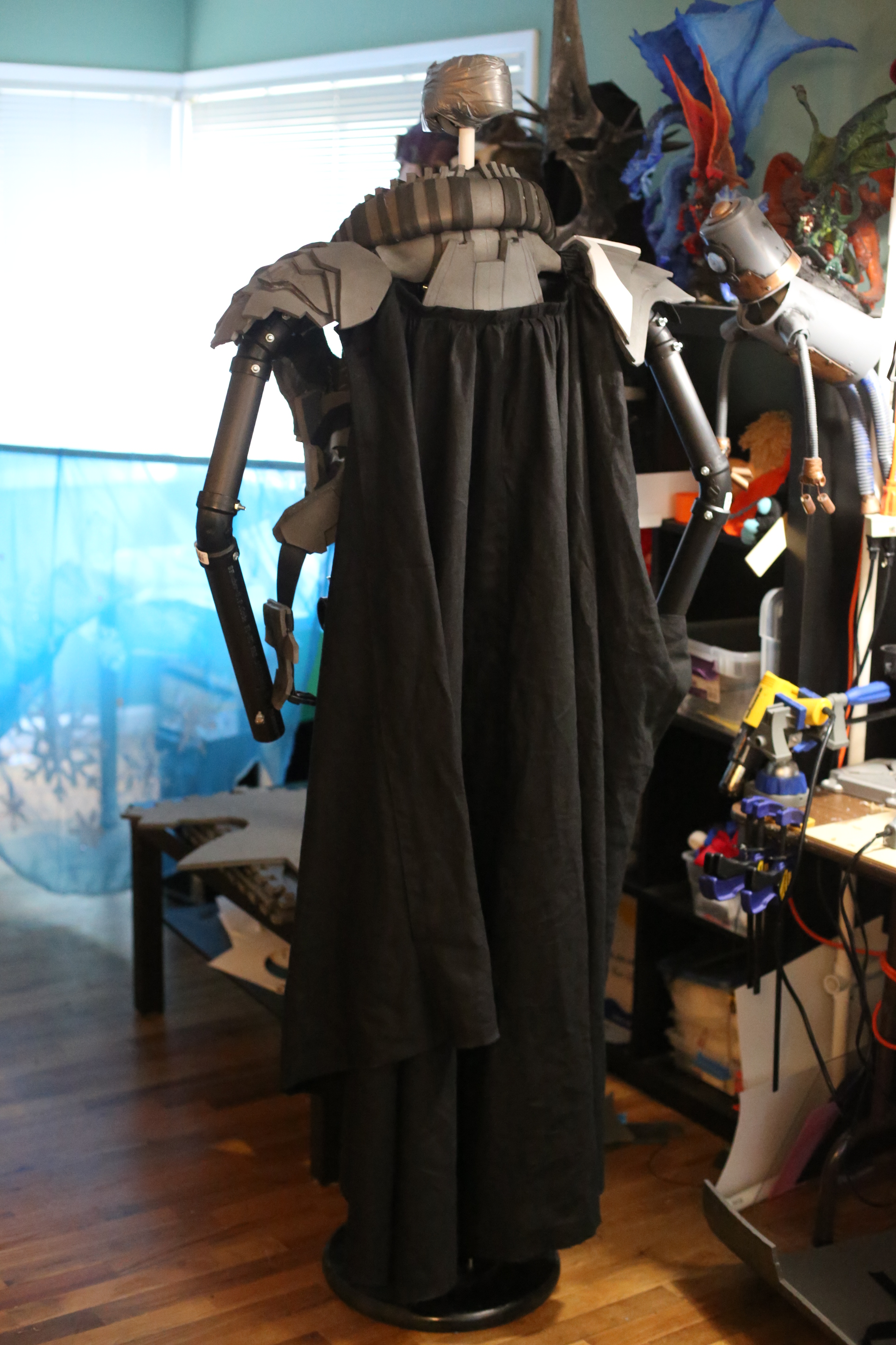

The cloak is two giant pieces of linen stitched together. I'm finding that you really want a full half circle for a cloak, otherwise it comes out looking too short.
2014-03-21 21.15.34.jpg2014-03-19 23.55.48.jpg2014-03-17 00.20.37.jpg2014-02-15 01.54.34.jpg2014-02-01 11.56.52.jpg2014-01-17 00.28.49.jpg2014-03-23 01.58.51.jpg
