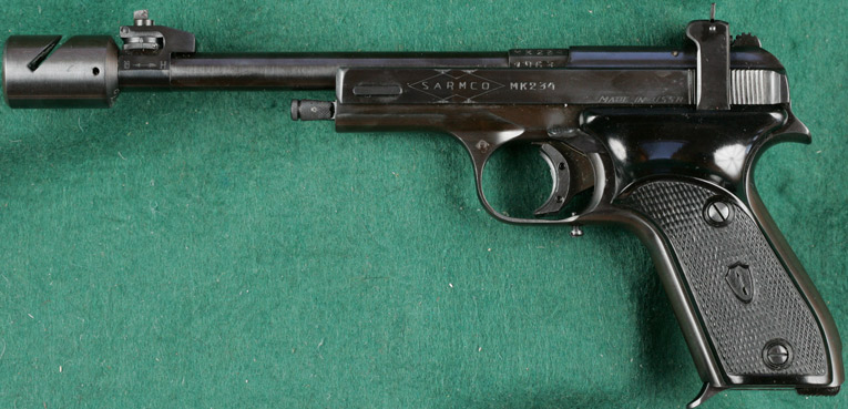

So, to begin the DDC Defender uses a Margolin .22 target pistol. I went searching around for replicas of this pistol and (from the looking around I've done) I can't seem to find one. I did find some real ones but those go anywhere from $600 and above which equals out of my budget. But then thd9791 (the person who got me into this mess lol) suggested using a Denix p38 replica instead!
Since I'm not gunning (ha, gunning) for absolute accuracy, this might be the way to go for me. I mean, they look pretty darn similar shape wise even though there are some obvious differences. I would just have to find a way to extend the barrel of course and add on the little piece below it. I'll also have to find a replica part of the sight(?). I'm not quite sure if that's called that (my gun terminology is pretty minimal) but I know the piece on the end of the Margolin is called the muzzle break? Maybe? If I'm wrong please correct me!

For "gun" vocabulary you can use Rear Sight for the back piece. That little V groove on top is literally a place to sight your target from the back of the gun. The thing on front I think is called a compensator...the thing with the dial, but thats usually where front sights are (little fins) so you can call it that if its easier :lol

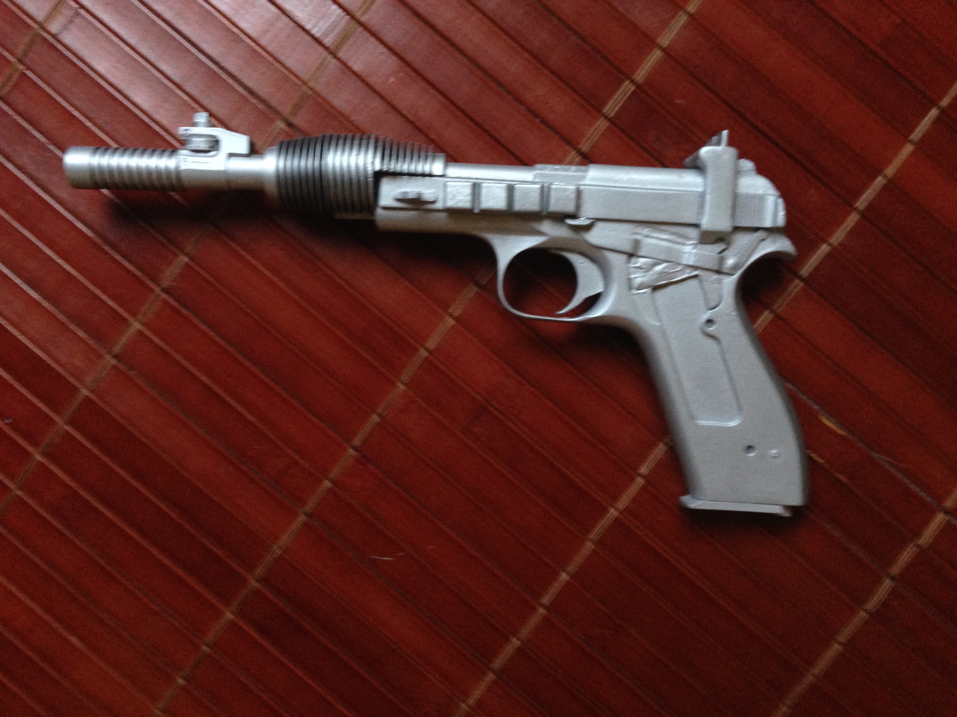

Unless you absolutely must have metal, a Rubies DDC is a far better and more accurate base item for conversion than any P38 replica. It's very close in size and detail to an actual Margolin with only a few things that need to be corrected (it's based on the MR replica). Just chop off the ANH barrel, fill it with resin, and it's a great heavy duty base. :)
Check out this thread for more info and comparisons between the Rubies and the Margolin: http://www.therpf.com/showthread.php?t=241937
Here's one I did based on a Rubies (the bumpers pictured are the wrong size and have since been replaced):
I used a resin cast from a real Margolin. Thanks OdiWan72
At the risk of being all spammy, what model/size of bump-on did you end up using? I've got some of the smaller, less-accurate ones coming from eBay but would love to upgrade if possible.
They came from an eBay seller in the UK - remarkably the same seller still has them listed!

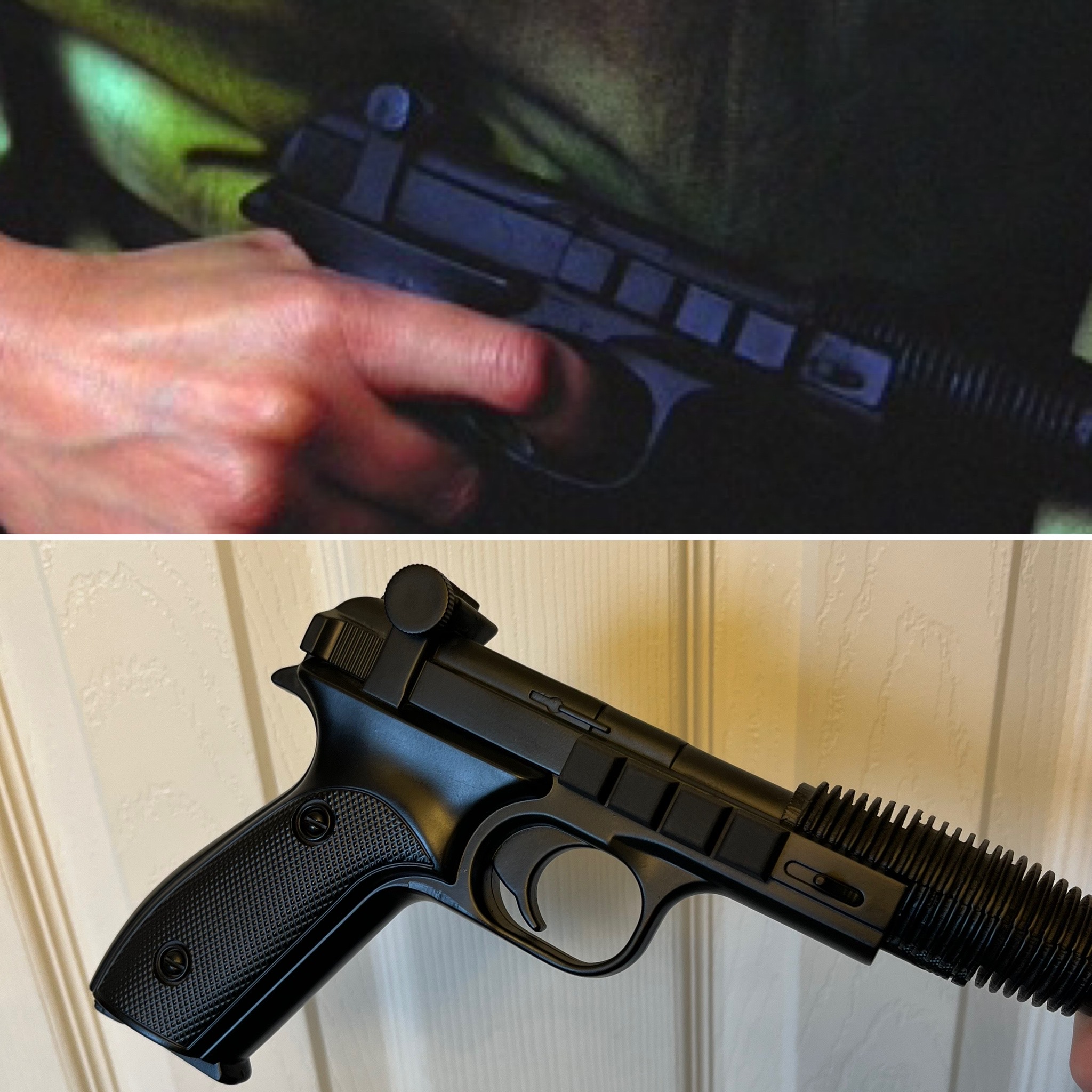

Here's a slightly shorter version, but the taller seems better?:
They're positioned a touch low on my build but here's a comparison. They might benefit from a semi-gloss clear coat too but I didn't want to risk it turning tacky:

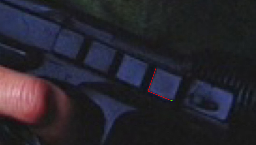

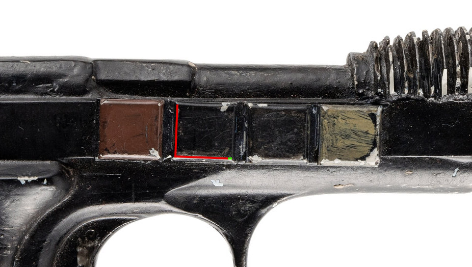

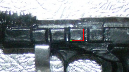

Looking through the reference, I think the reason your bumpers overhang too much at the bottom is that the ones on the screen-used blaster aren't square! From the above screencap, Heritage auction, and supposed 1st-gen casting on YourProps.com. The red lines are the same length, with the green showing the difference:
It's not much, but it adds up over the length of four bump-ons.
In addition, the flatter bump-on looks more correct to me, assuming this image is indeed of a direct casting:

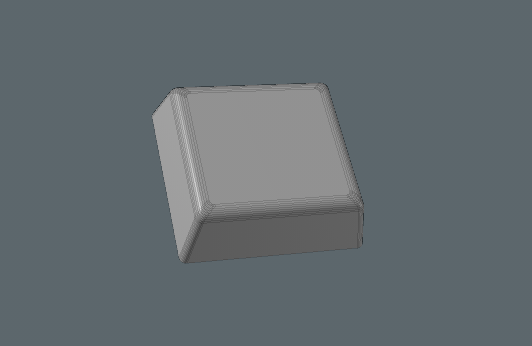

Taking the ebay auction dimensions of 12.7 mm x 3.5 mm (rounded up to 4mm for safety), I treated the long axis as 12.7mm and got 12.3 mm for the shorter axis. I built a quick and dirty 3D model for 3D printing.
Or this all-in-one, with idealized spacing based on the Heritage photos.
Attached here for anyone who wants them.
  • Bump-Ons_v002.obj
  • Single_Bump-On_v001.obj
Wookiepedia had some images I hadn't seen before under "X-30 Lancer," which is apparently the Legends name for this version of the blaster. It shows clearly that the bump-ons are the same height as the triangular sticky-outy-bits at the front of the slide. (I have no idea what those parts are called.) On the Rubies those parts are 6.5 mm tall. So I've updated the files, if anyone needs them.
  • Bump-Ons_v003.obj
  • Single_Bump-On_v002.obj
