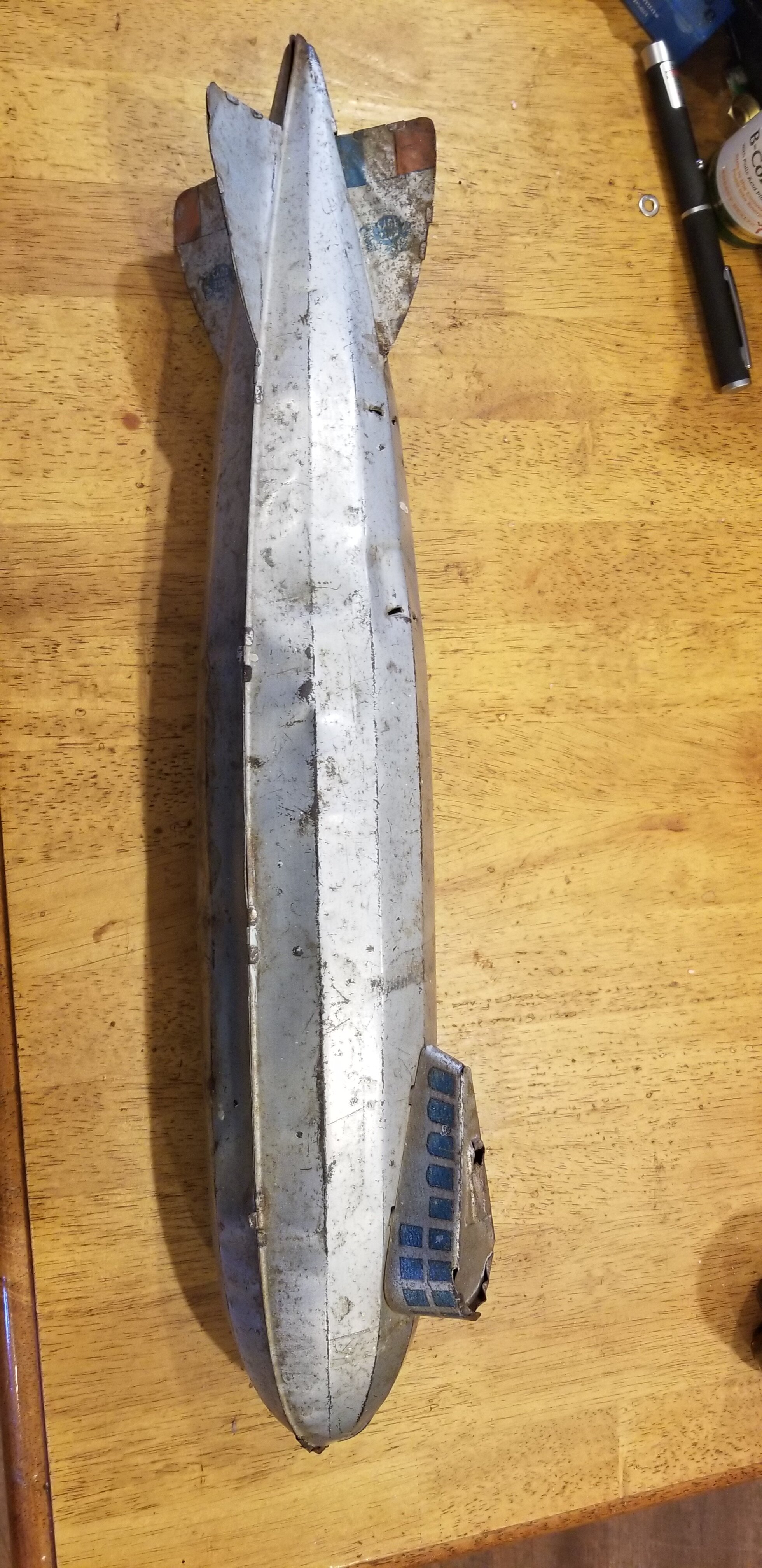

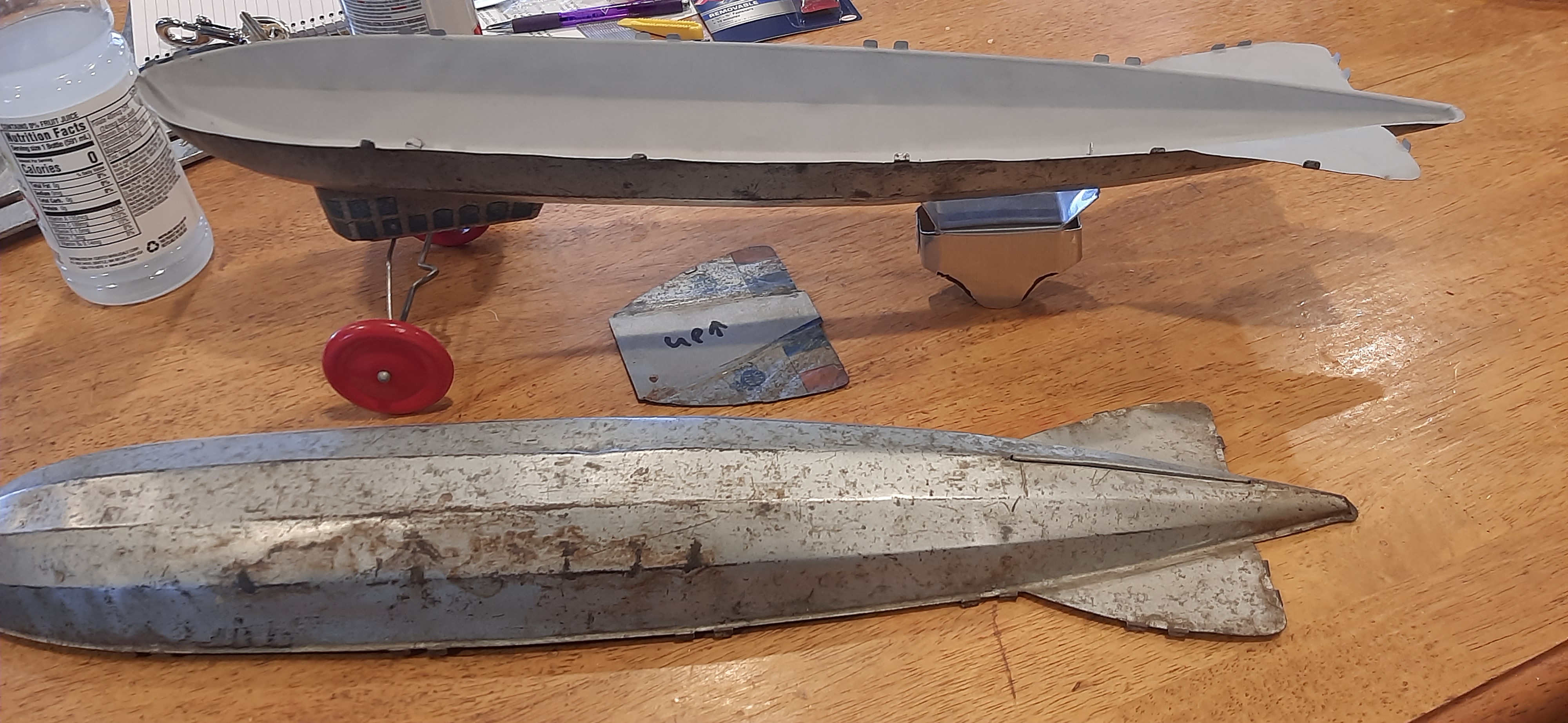

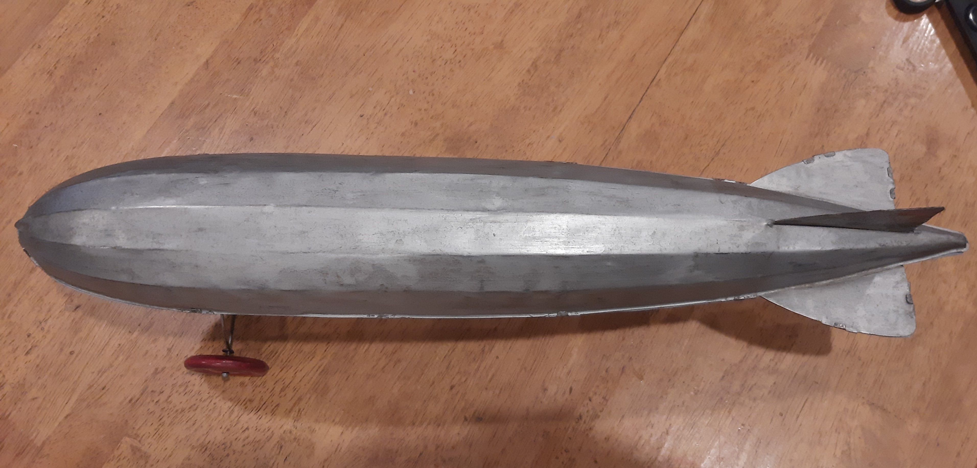

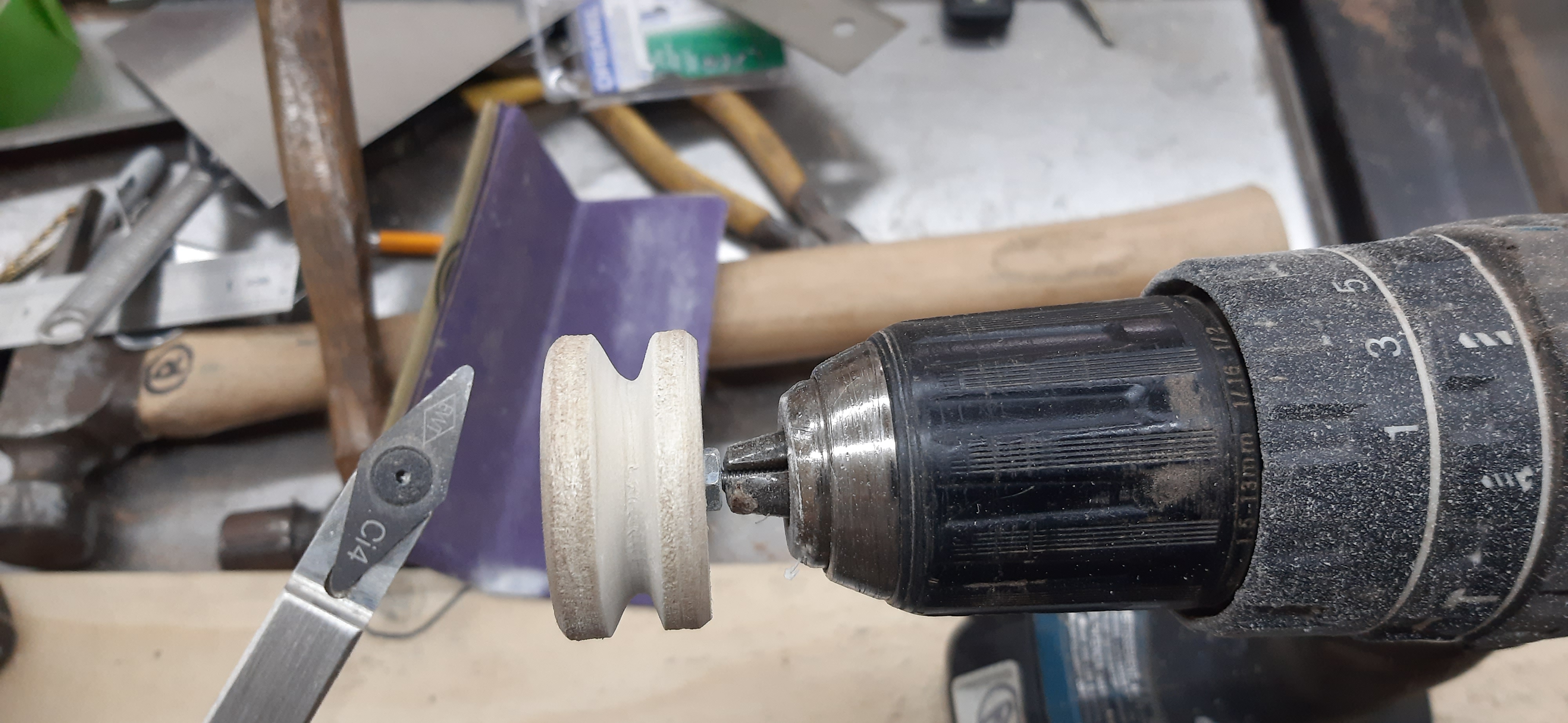

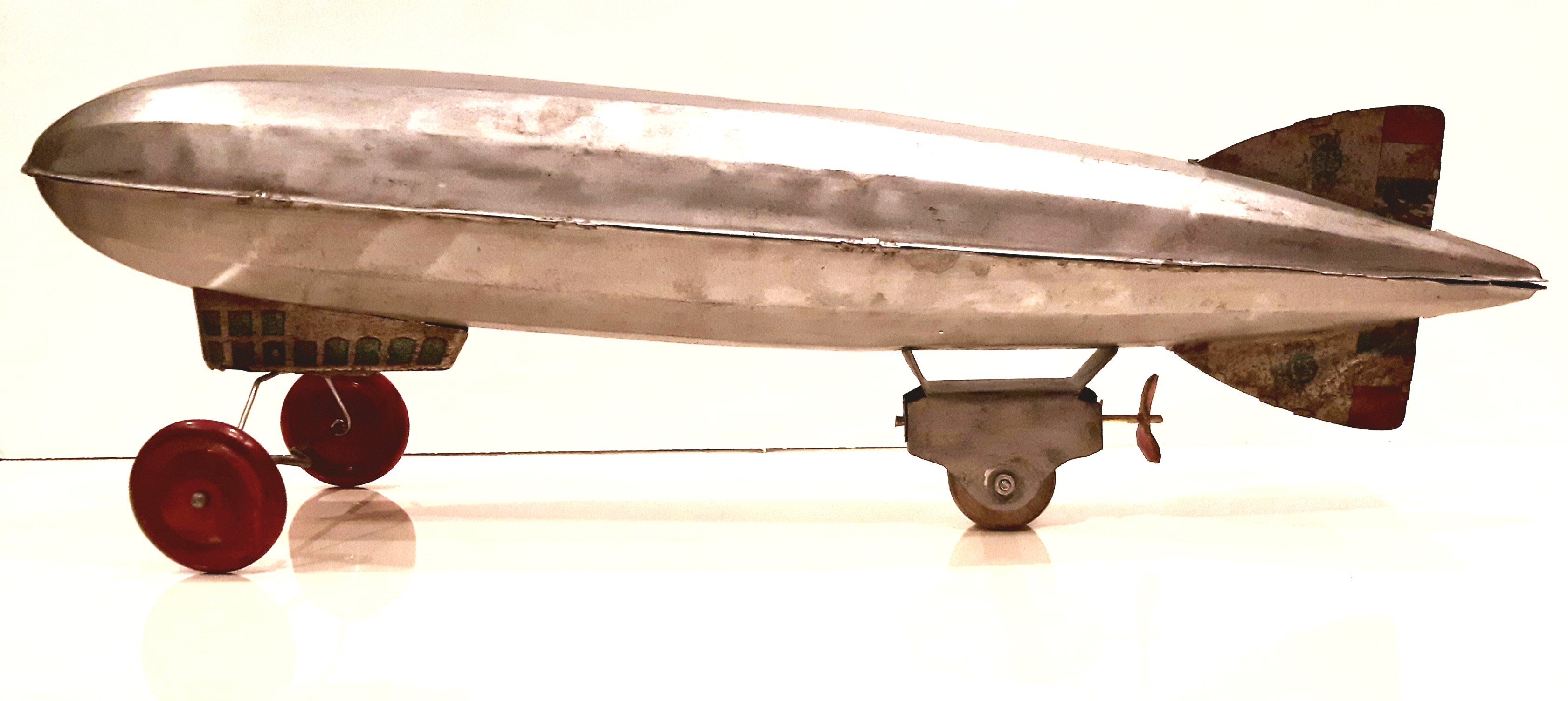

Progress on the zeppelin is slow but steady. Here is a recap to where I am now.
-Zeppelin opened up
-tail and gondola removed
-dents hammered out
-inside hull and gondola soda blasted
-inside hulls and gondola primed
-beginnings of front wheel axle support created
-replacement tin wheels ordered
-tin wheels painted red
-starting work on main front axle
Note- I cant reassemble the hull halves until I finish the front axle and wheel assembly which connect to the gondola which has to be fastened to the bottom hull from the inside. Even after that the whole rear wheel assembly needs to be made from scratch and attached to the lower hull from the inside too. I am still trying to get some more measurements for that rear part because it is made from one piece of folded tin. I am playing around with some card stock at first to mock up all the bends I have to do before trying it on the tin.
Back to back updates!

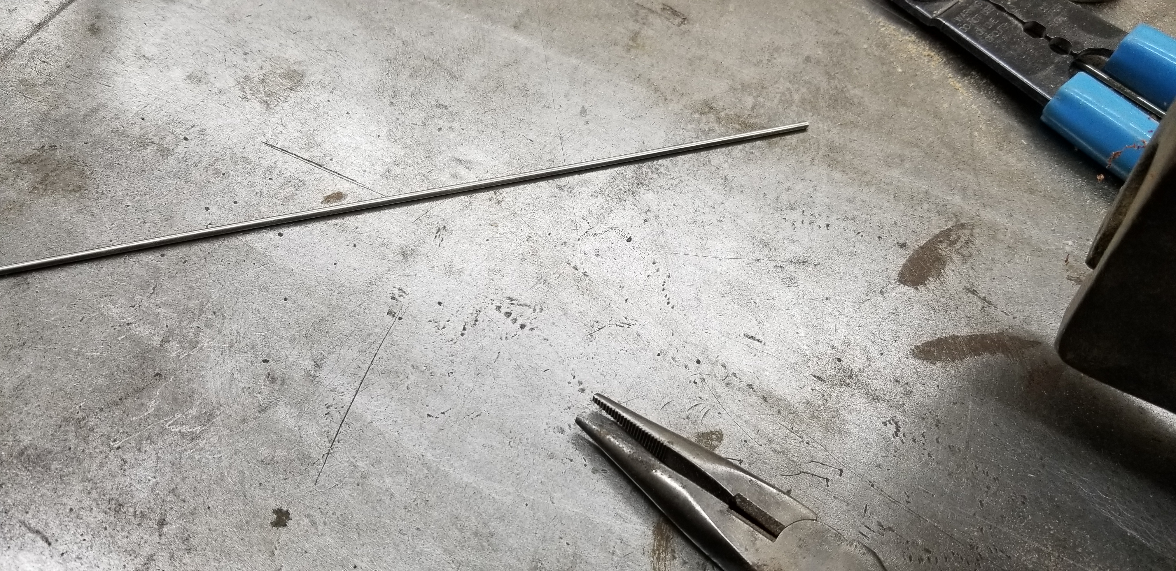

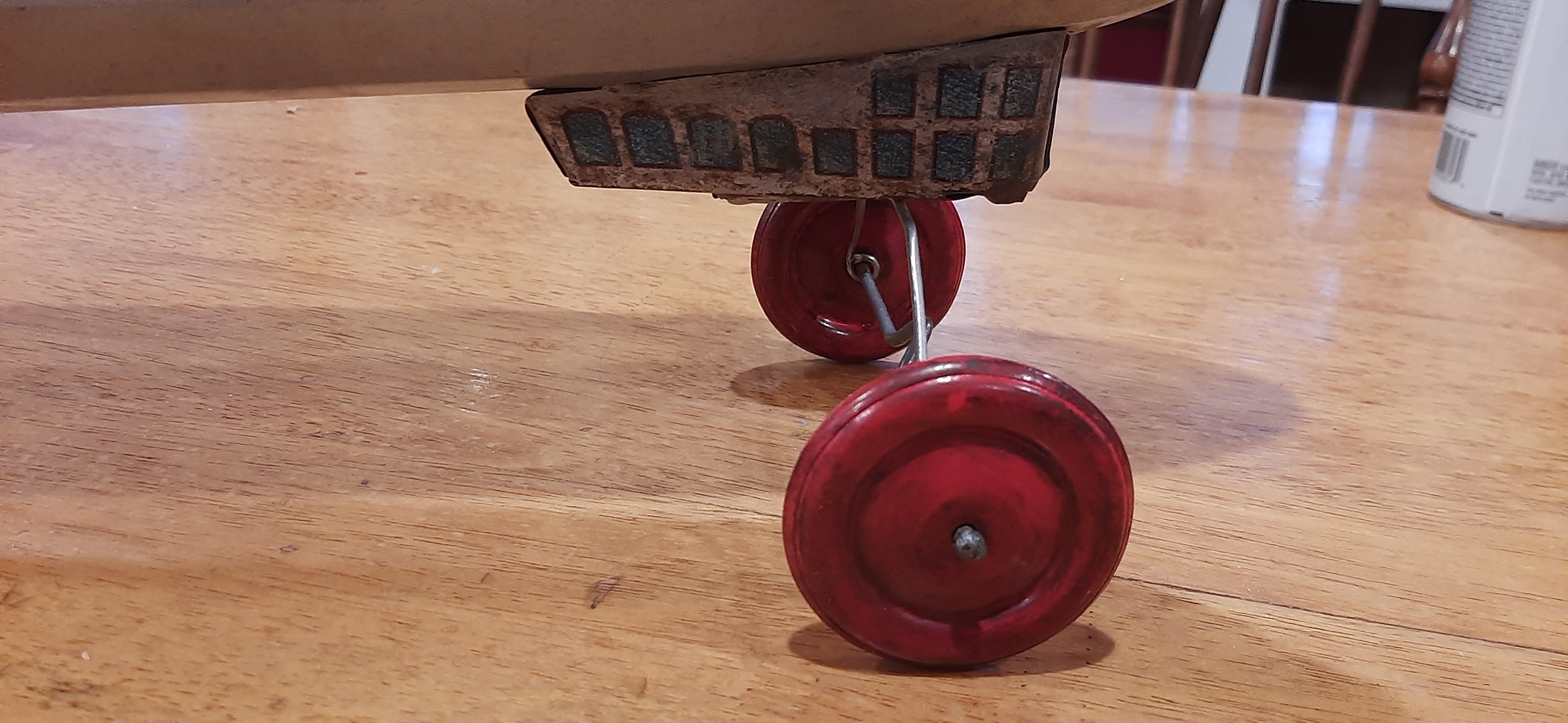

Just got to test fit my front axle and wheel assembly tonight. I am very happy with the results. I have to dirty up the metal and scuff up the wheels but I think this will help the piece significantly. The last two pictures are of an original assembly

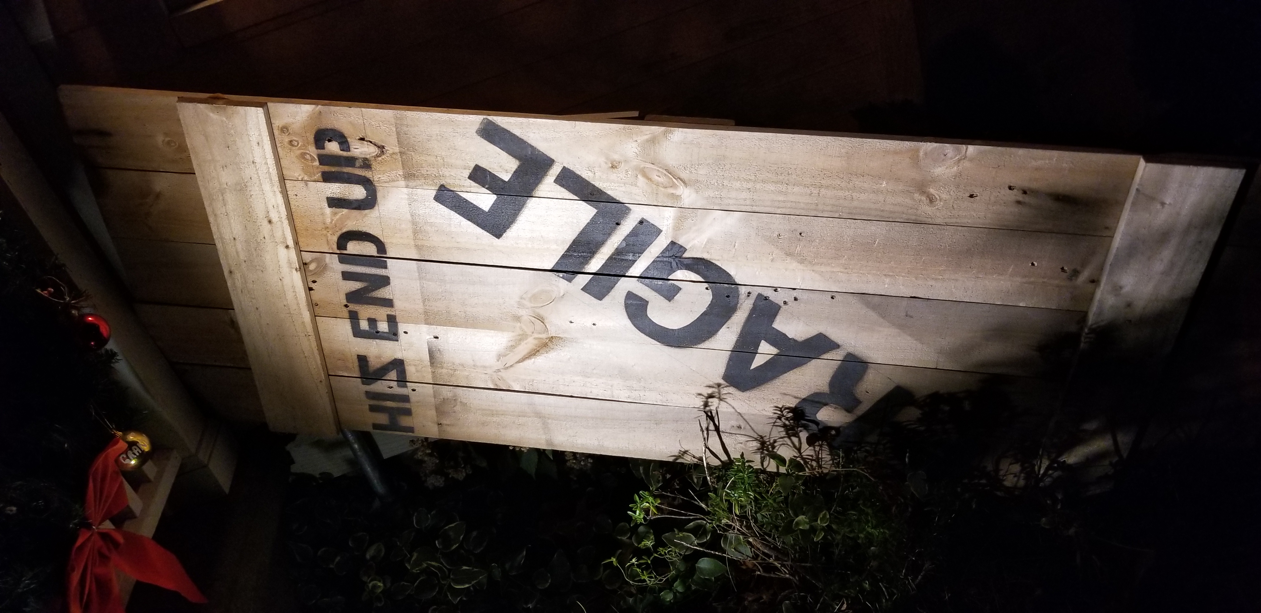

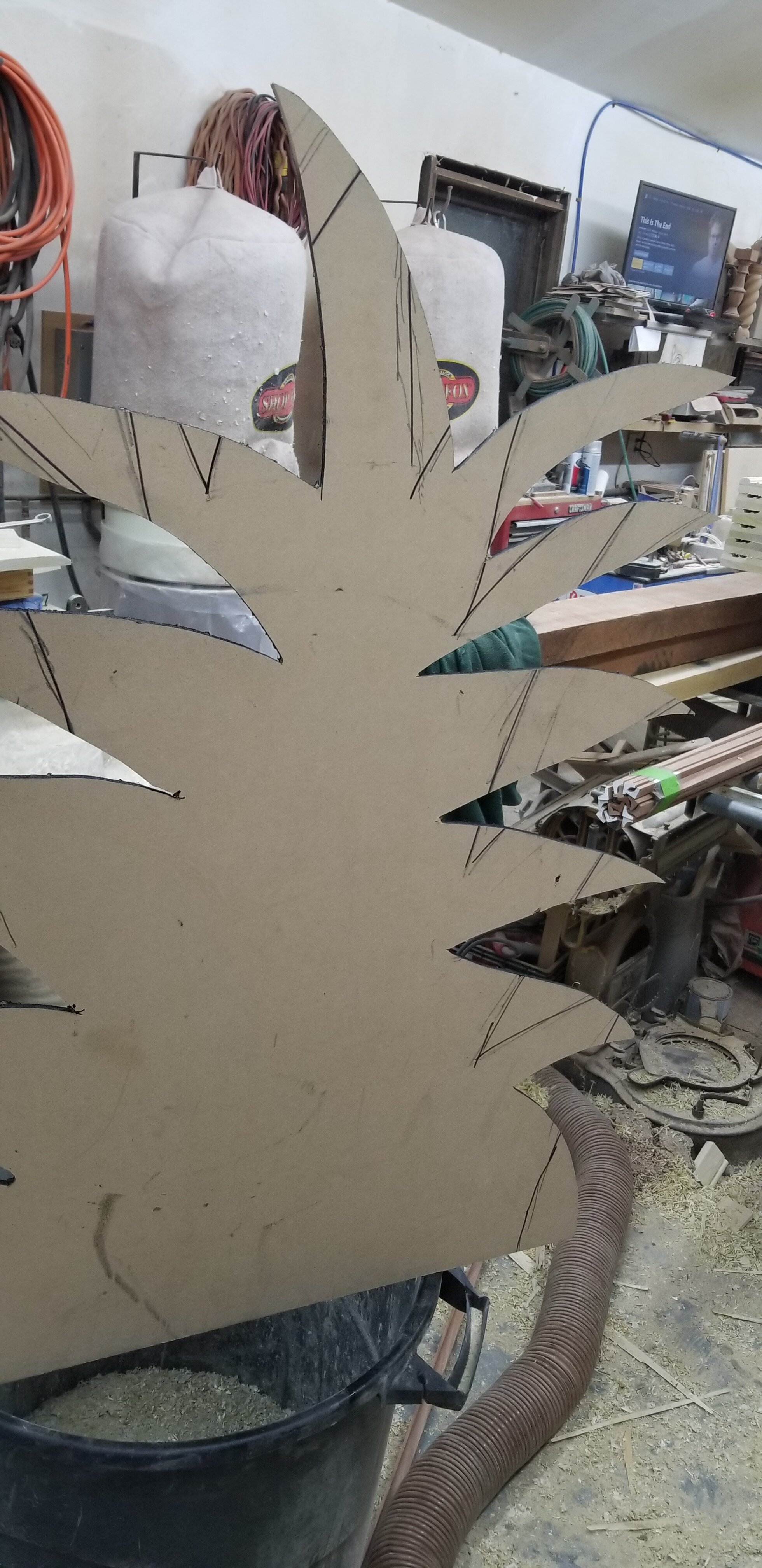

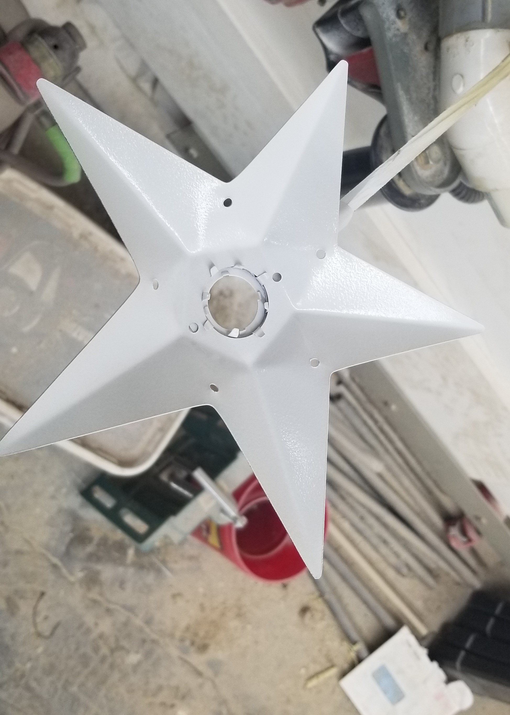

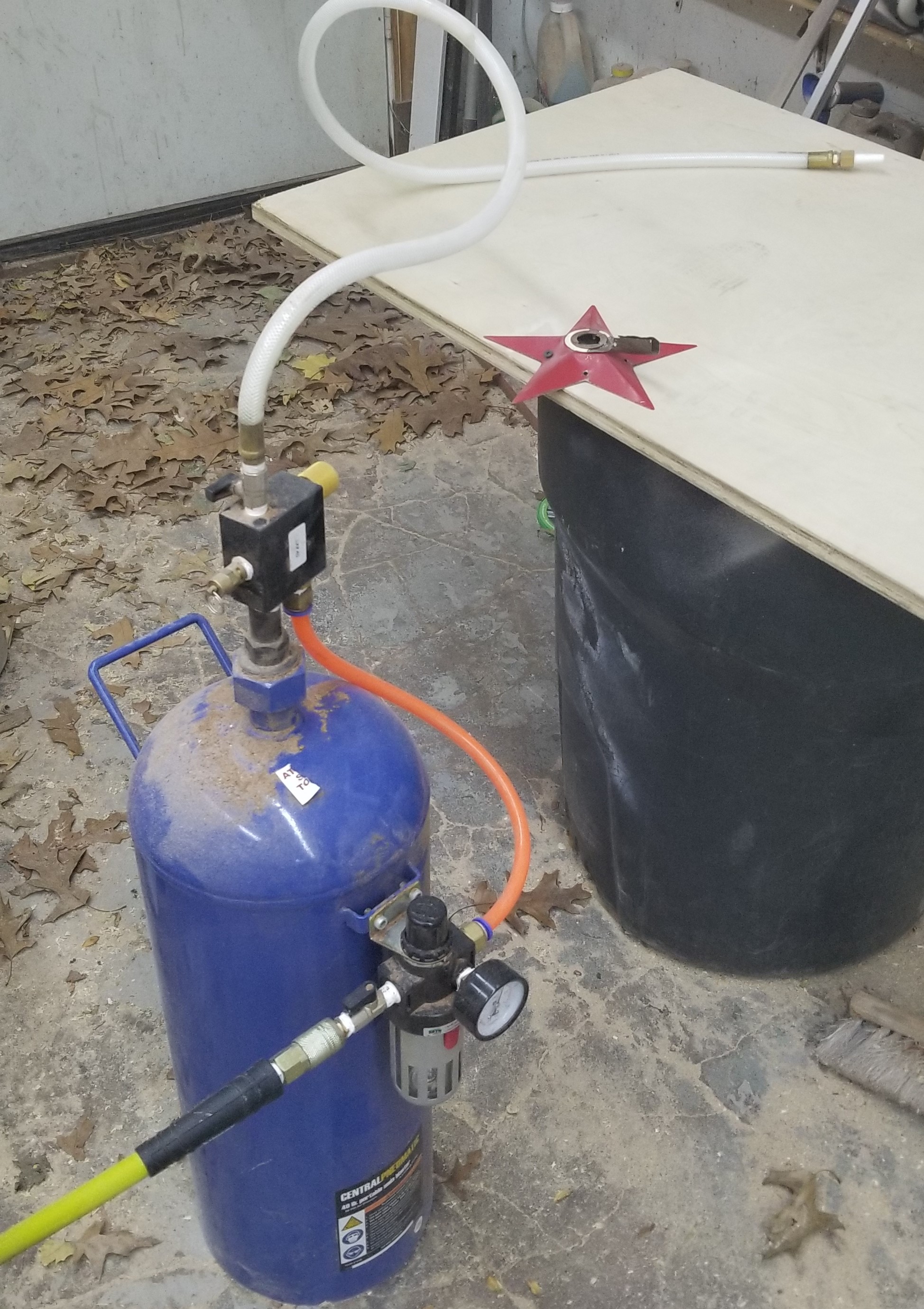

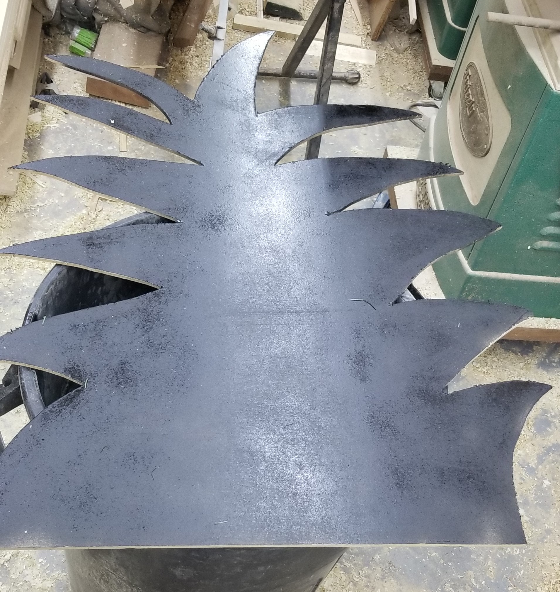

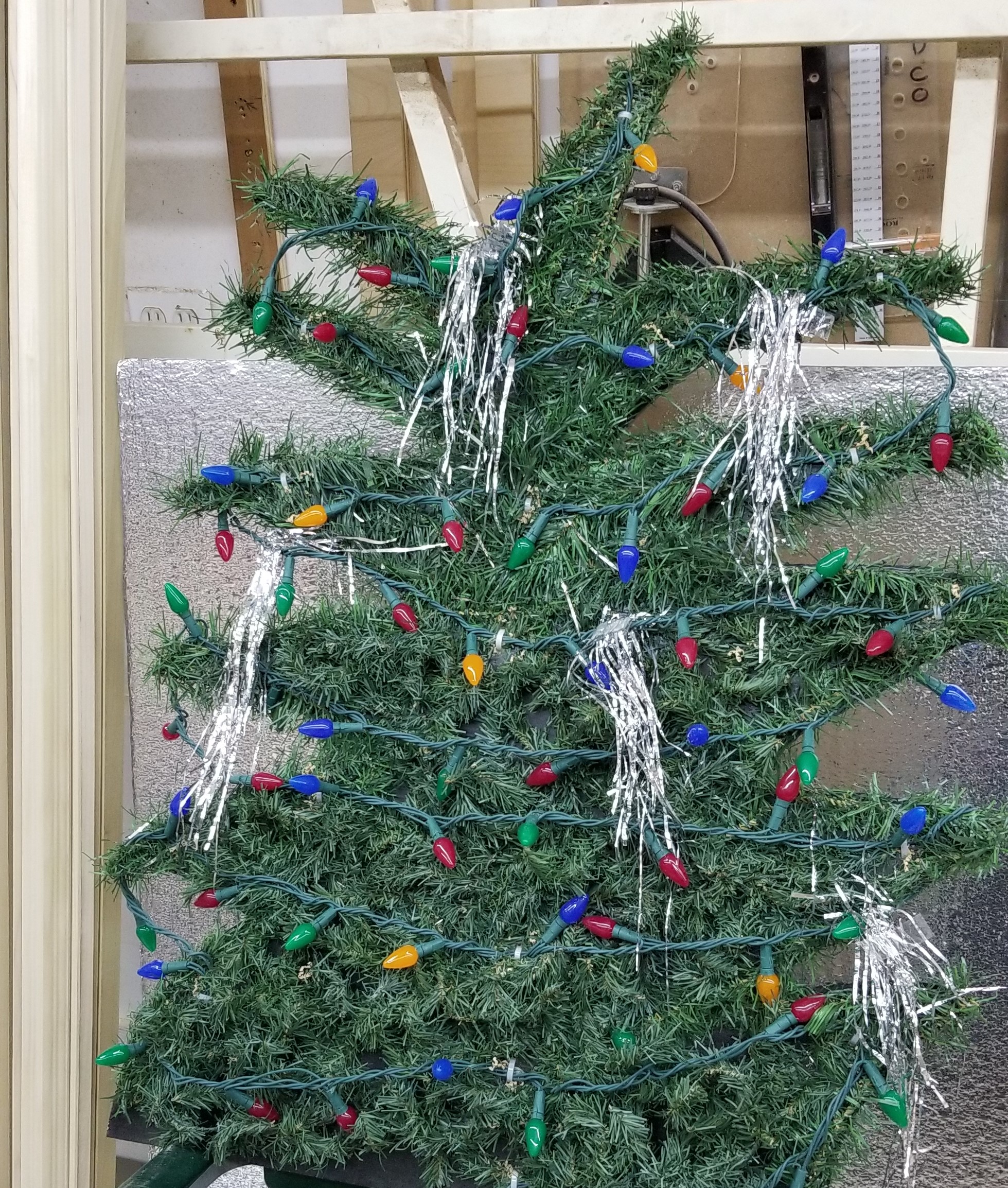

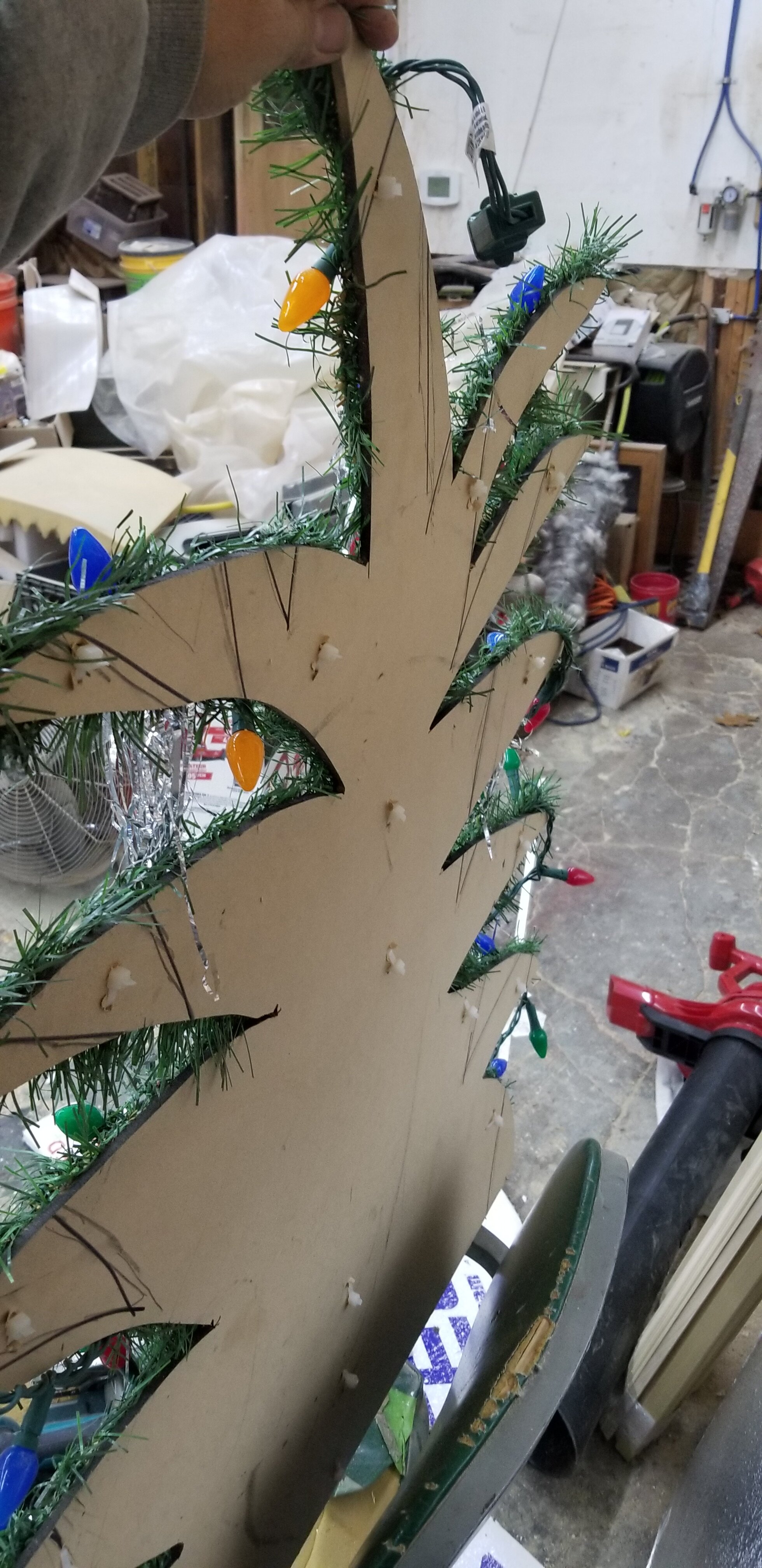

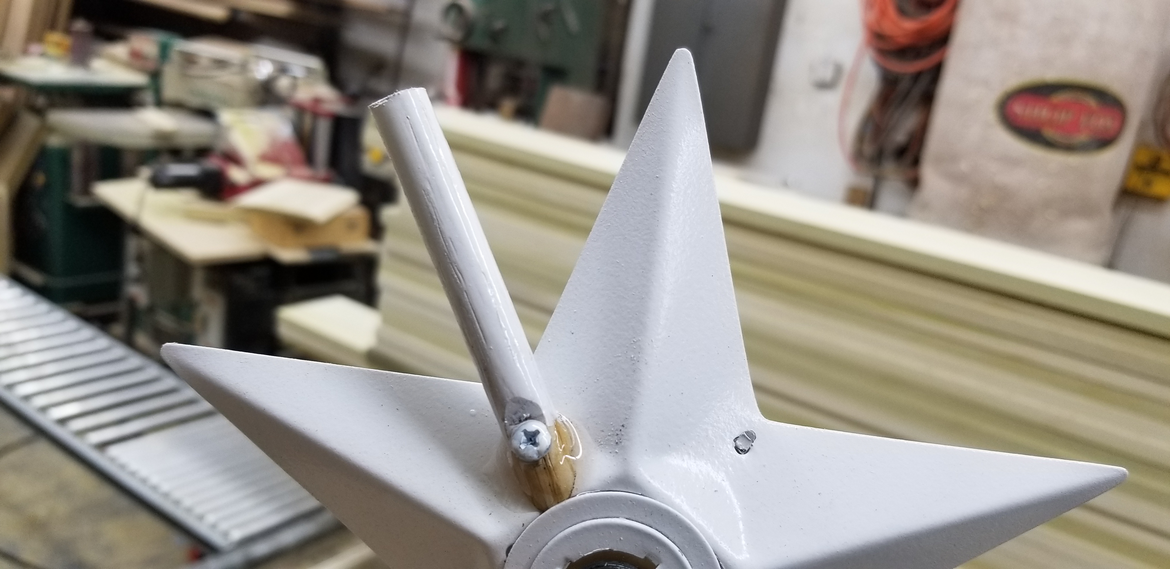

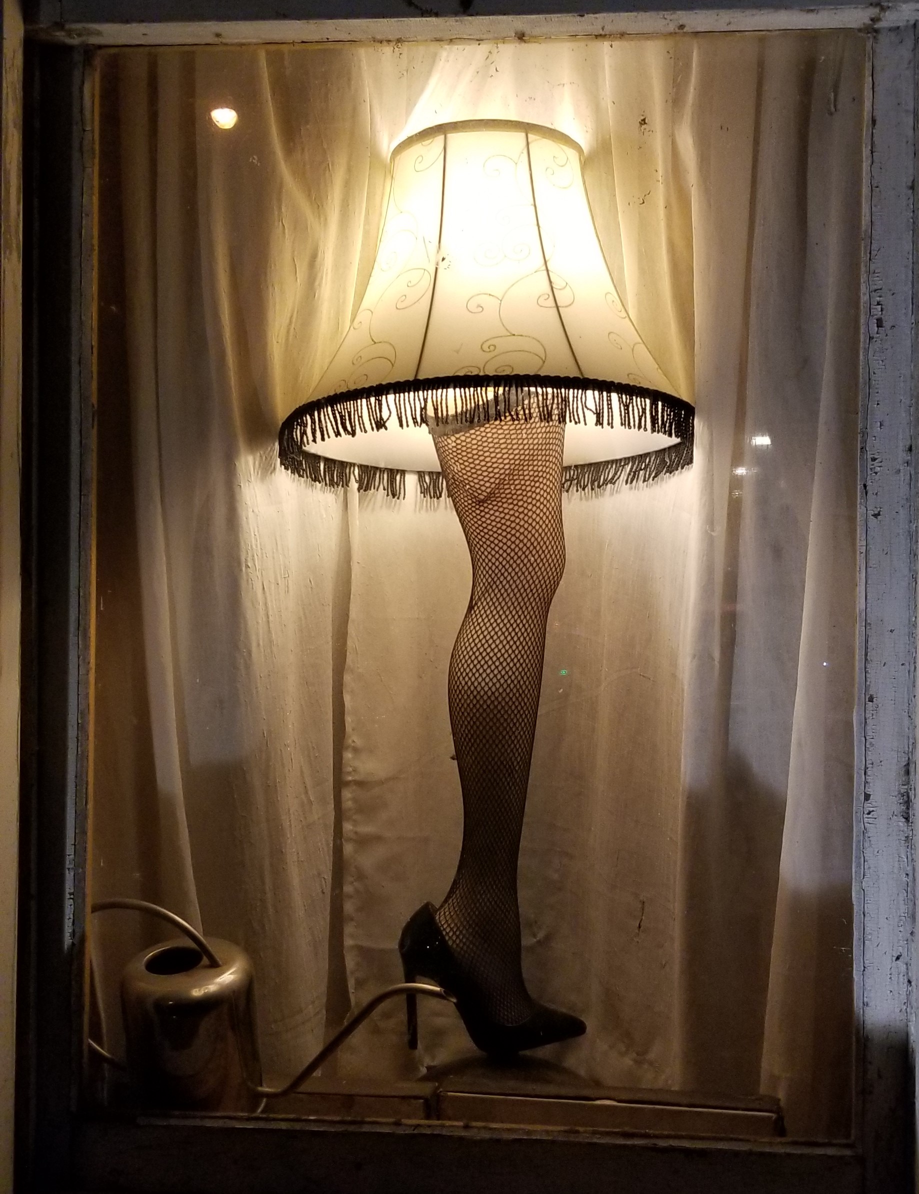

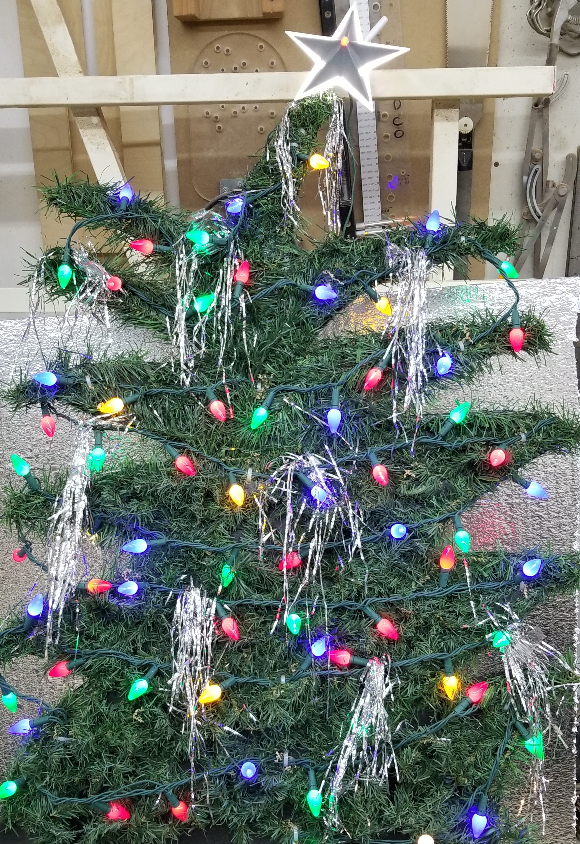

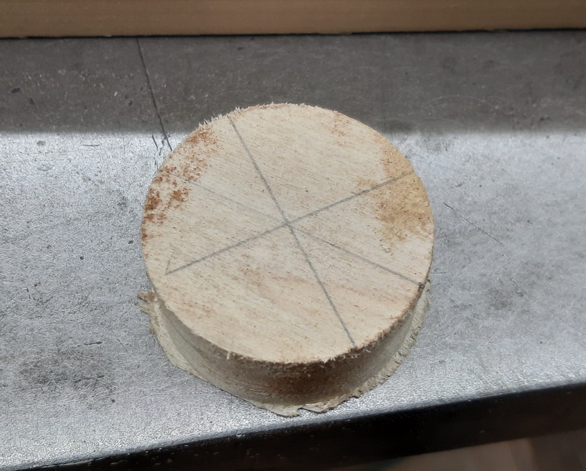

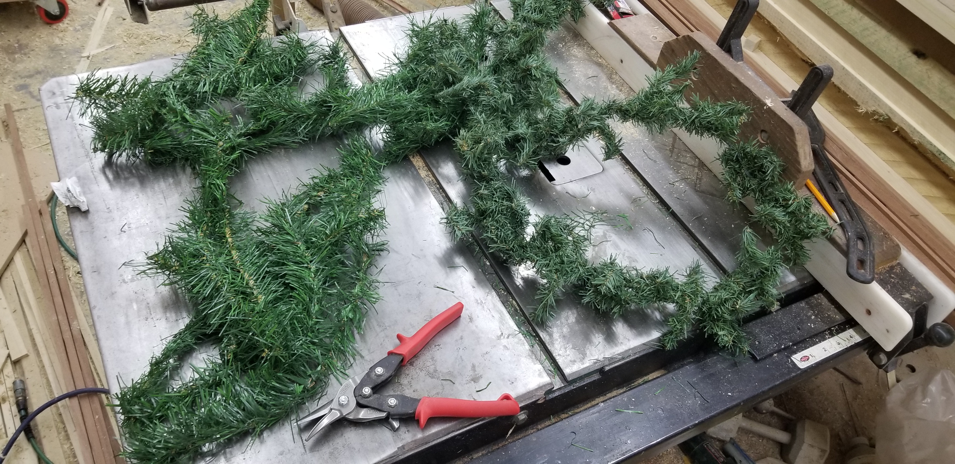

Zeppelin project on hold until I get some crucial measurements for rear wheel assembly. In the mean time I took some inspiration from user BossThreads and decided to make my own "perfectly straight star". I have all ready built a leg lamp and a crate lid but I felt that a tree in the window with the star would really dress up the house and finish the display. For those of you who are into duplicating things I will post the steps that I took to get this done. It was a lot of fun and once again thank BossThreads for getting me to think about this

Zeppelin project on hold until I get some crucial measurements for rear wheel assembly. In the mean time I took some inspiration from user BossThreads and decided to make my own "perfectly straight star". I have all ready built a leg lamp and a crate lid but I felt that a tree in the window with the star would really dress up the house and finish the display. For those of you who are into duplicating things I will post the steps that I took to get this done. It was a lot of fun and once again thank BossThreads for getting me to think about thisView attachment 1522552View attachment 1522553View attachment 1522554View attachment 1522555
That "fragilé" crate top is a fantastic idea. I've thought about recreating the whole crate to display a leg lamp on top, but this is much more practical (both for display and for storage(.

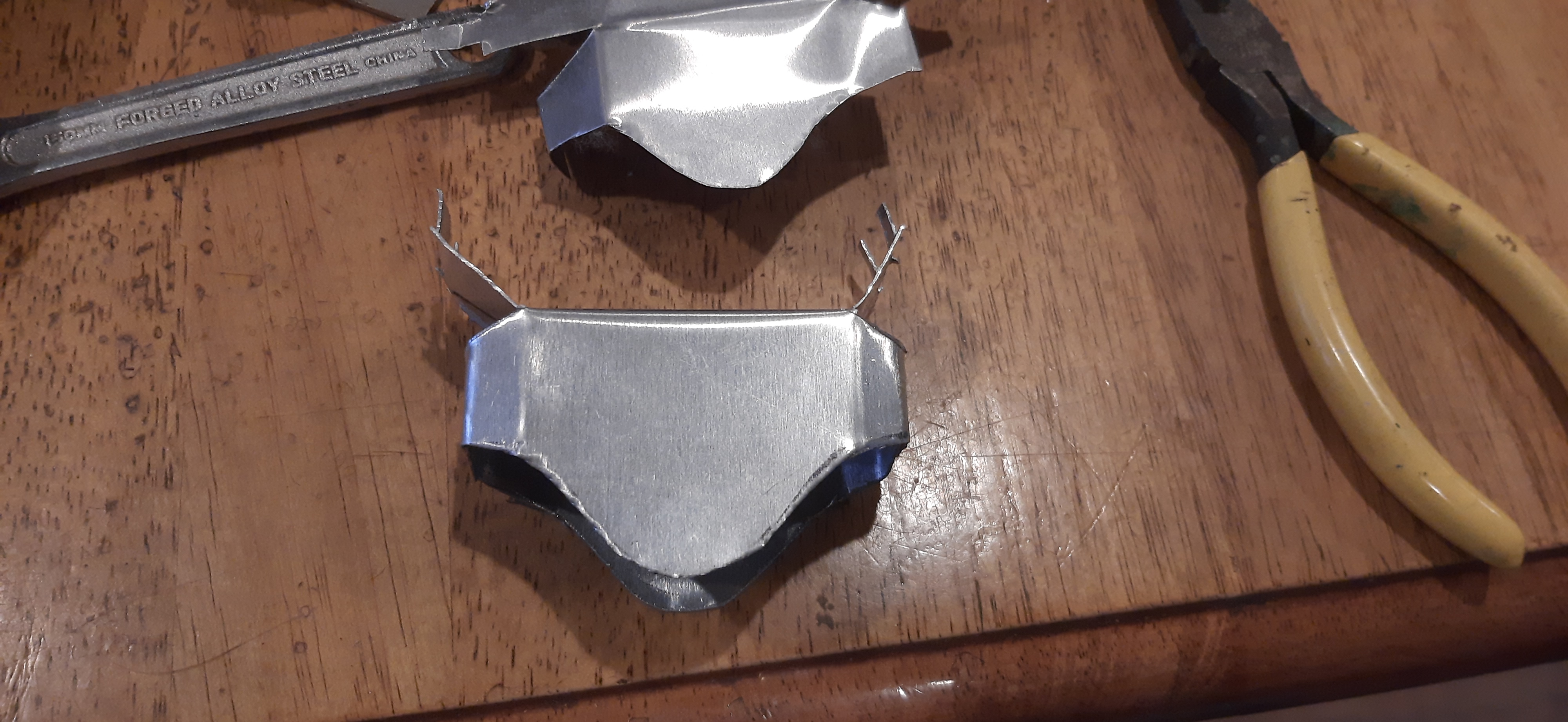

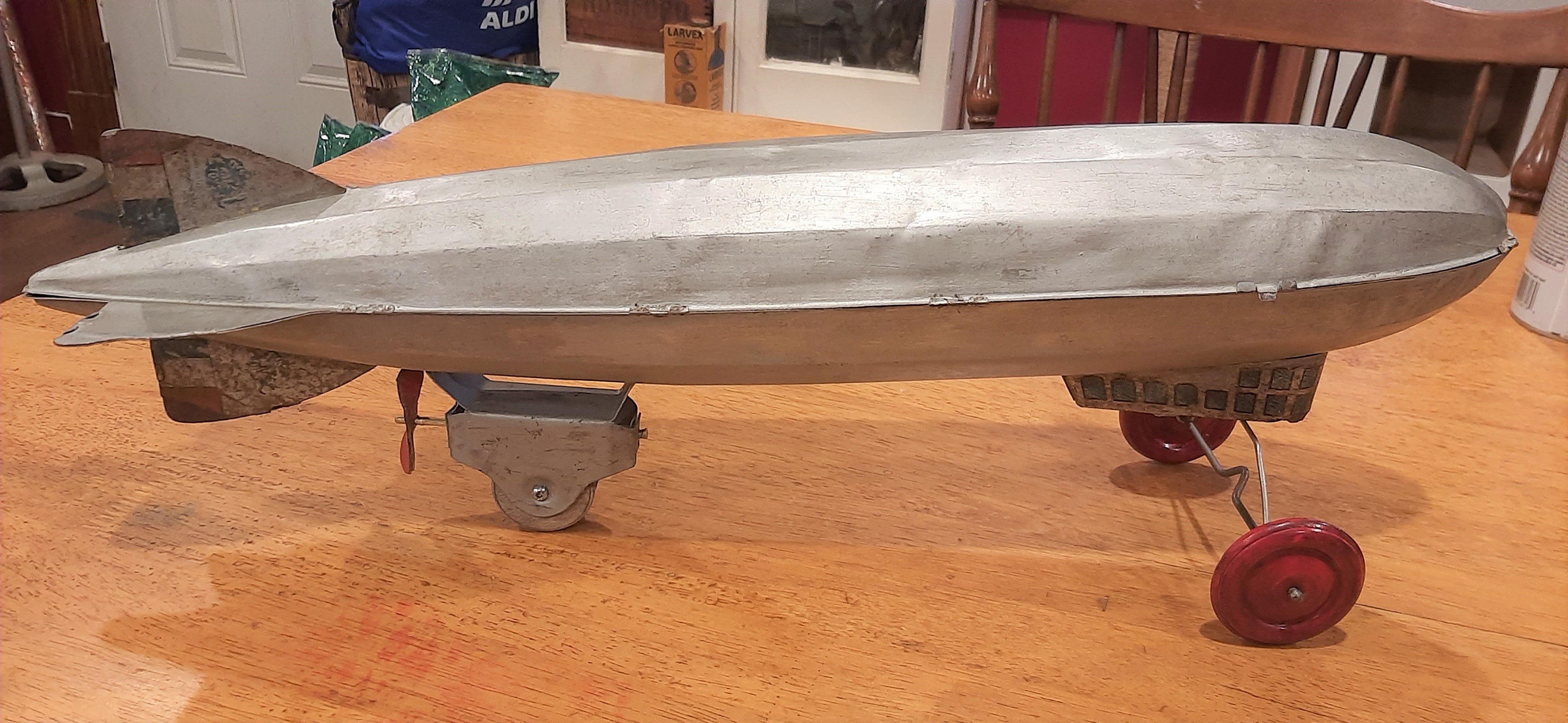

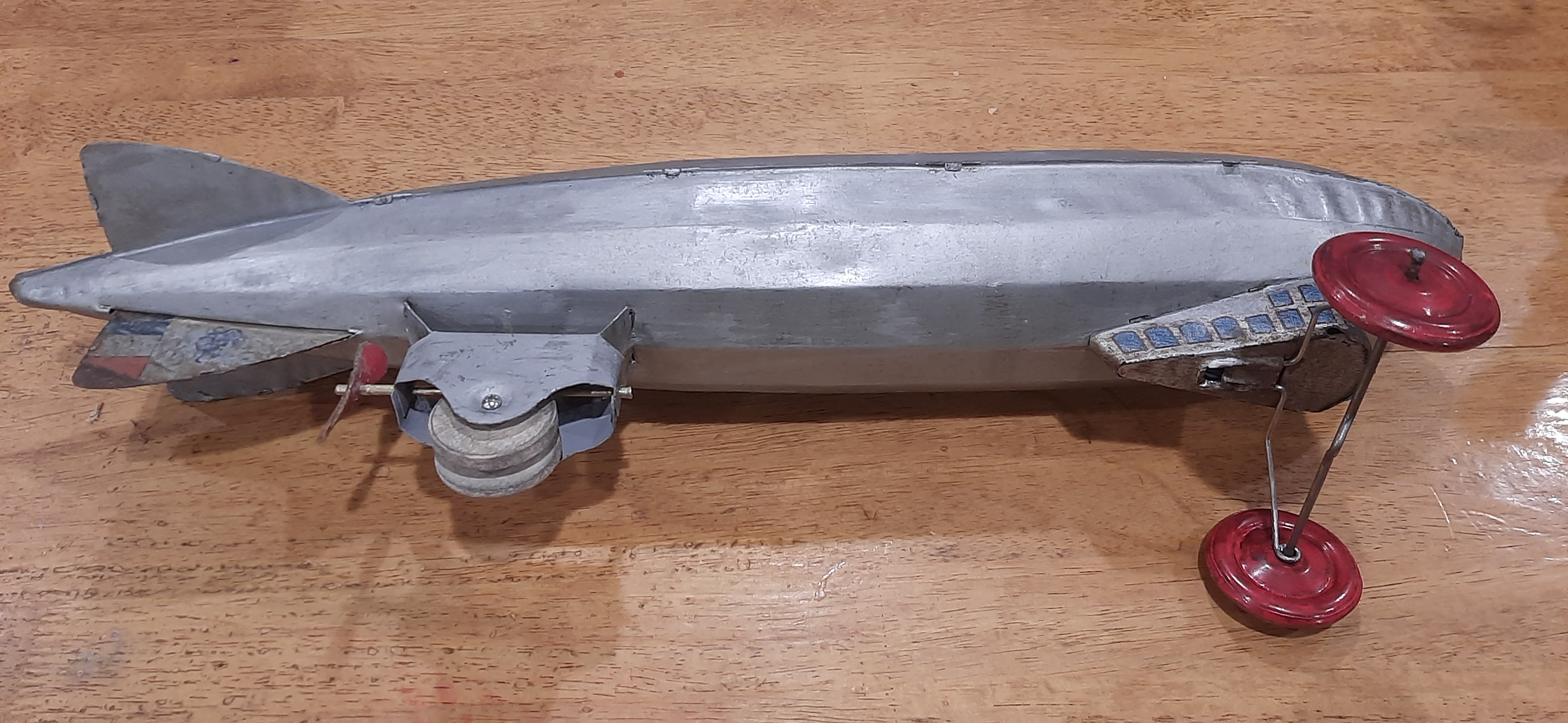

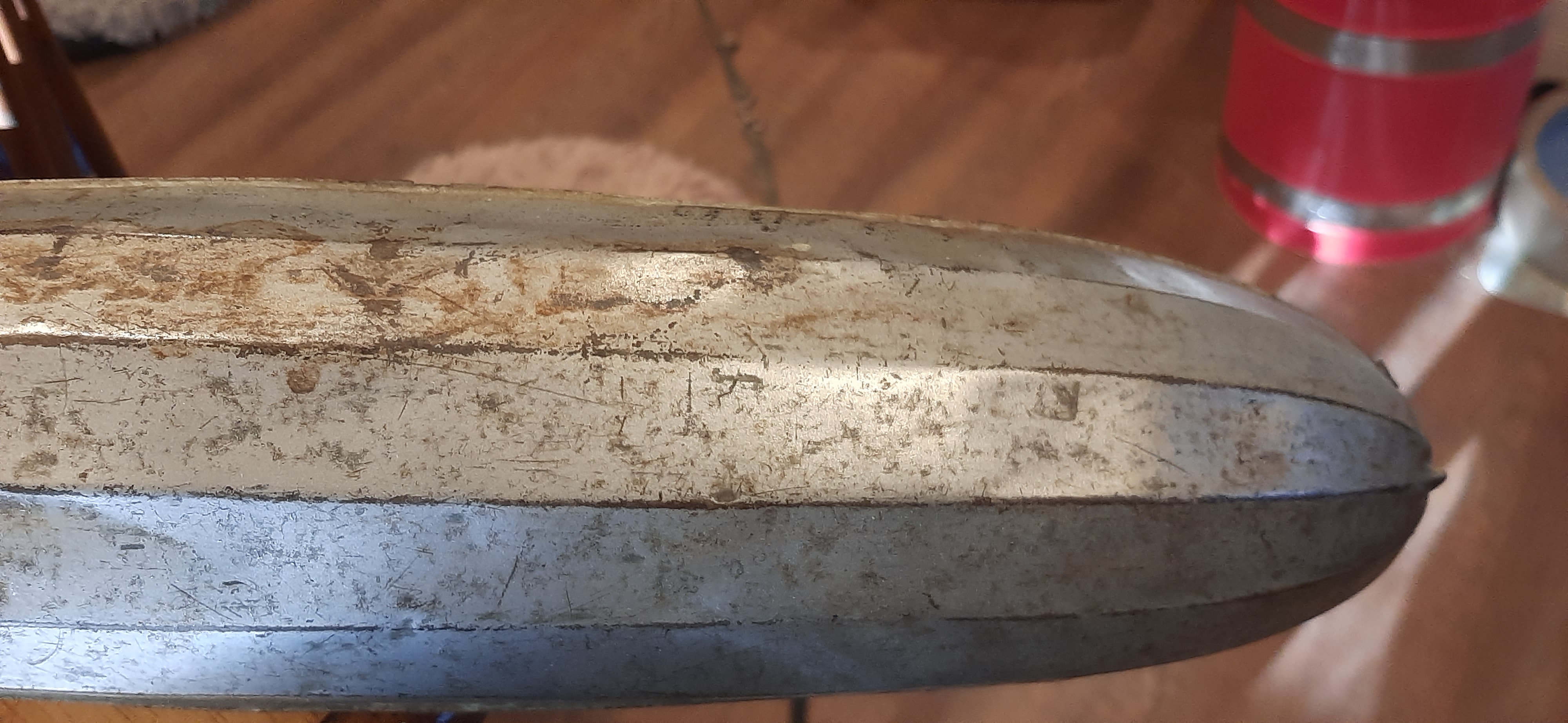

ZEPPELIN IS DONE!!!!

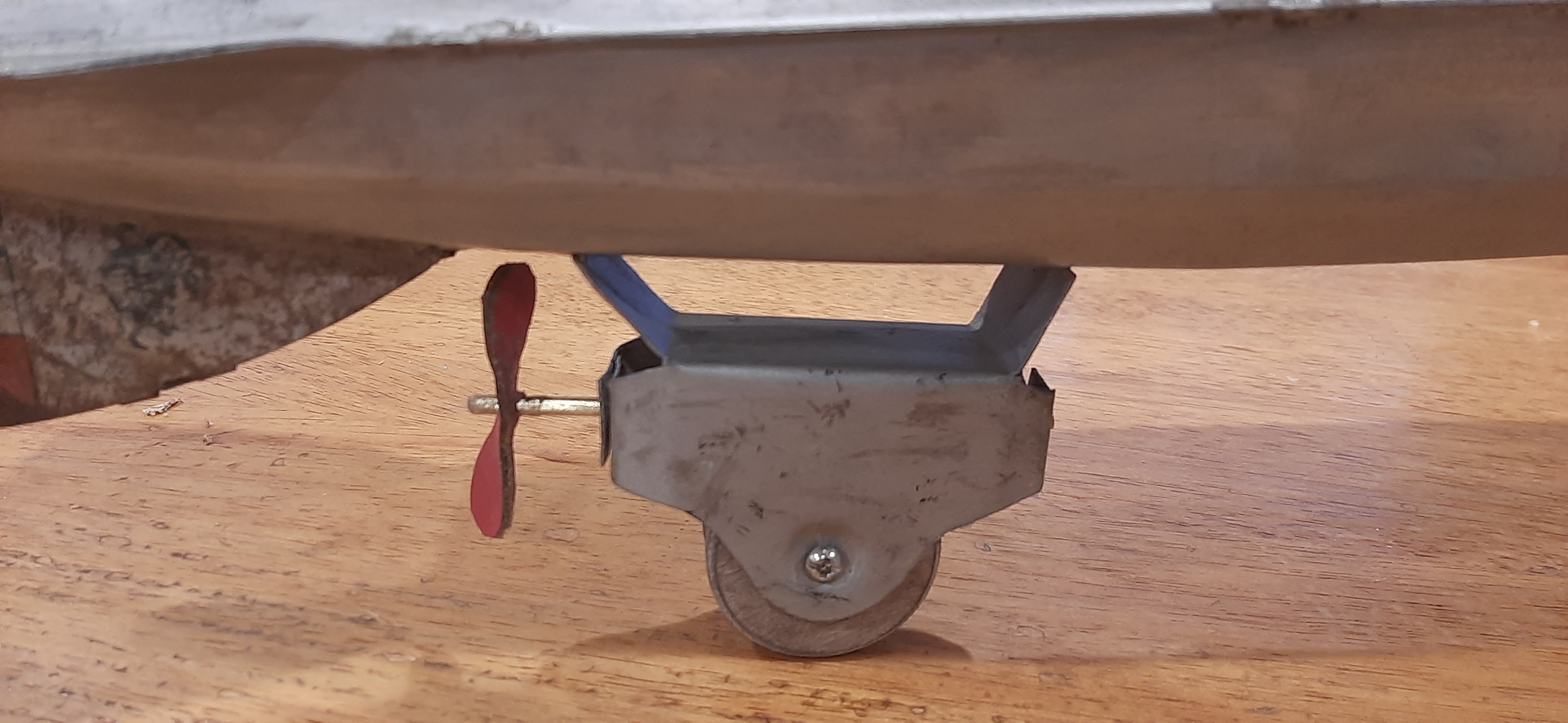

After more than a year I was finally able to create the last of the missing parts for the elusive Katz zeppelin. To refresh and round out the story, someone who visits this site had two of these. This one was his starter one and eventually he was able to get a complete one. This member had seen many of my posts regarding collecting and restoring ACS items and generously offered to sell me his starter one. As far as I am aware there are less than 10 known.
This one had a great hull and gondola but over the years the front axle, wheels and rear wheel assembly had become lost. I have detailed the dismantling of the piece and the recreation of the front axle and wheels but the rear wheel assembly was much more complicated. It mainly consisted of a single piece of steel that was folded origami style to hold a wood wheel and propeller. I had made as of my last post an aluminum template that I configured after getting some crucial measurements from the previous owners complete model.
Seeing that I was on an unpaid mandatory 5 day company shutdown next week I had planned to use that time to finish my project. I started yesterday by transferring the aluminum template onto the tin sheet I purchased. I bent up the steel, primed, shaped and drilled it for axle and prop rod. Seeing this done I fell into the "steel trap" and just kept going for the day. I next cut out a wood circle and turned it on my drill while holding a turning tool with a V cut profile. I made the leather propeller from a discarded wallet my wife had and made the prop shaft from some brass rod that I purchased that day.

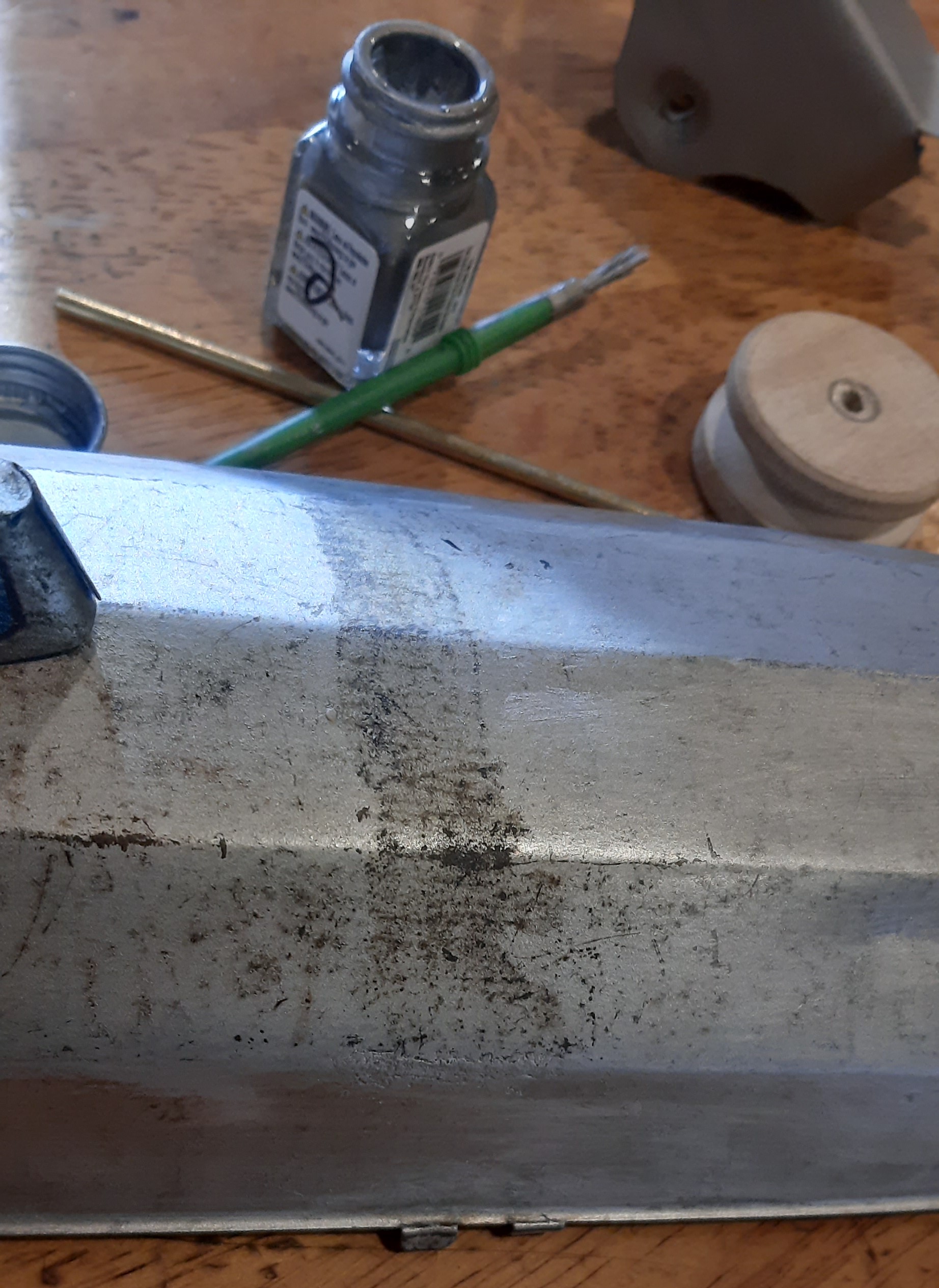

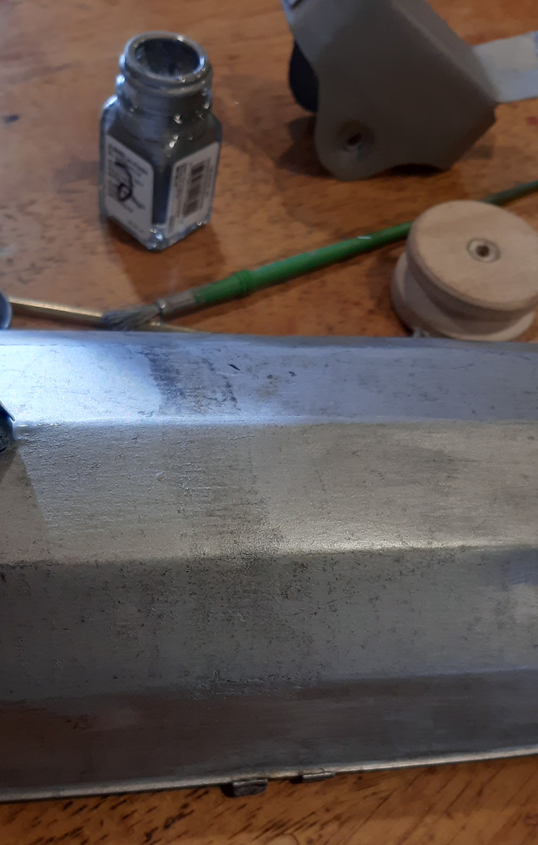

The last major thing was to touch up the paint a little. I did not want to paint the whole outer hull (I did paint the rusty inside areas) and lose the original stickers. I tried to do individual scratch touch ups but soon noticed that in the bright light you could see all the bumpy strokes. I came up with the idea of brushing model paint over a certain area and then immediately wiping it off with a cloth. This let all the scratches get filled in and placed a unifying opaque coating over the rest of the hull. I really liked the result. Next was a dry brush rub of black acrylic paint over the hull, wheels and rear wheel assembly to give the piece some age. I popped the completed rear unit onto the hull, folded over the little tabs and then put the two halves of the hull back together.
I am no toy restoration expert but I think this came out pretty good AND it was done just in time for Christmas! I have included pictures with this post and if you have any questions about anything I did please let me know. Thank you all so much for following this long but fun journey. -John

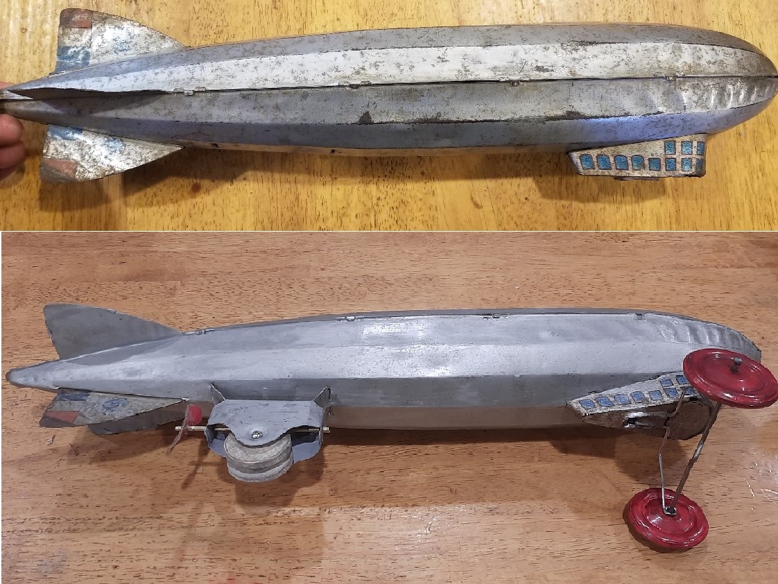

Tim. would it be possible to send me a few pics of the zeppelin from the underside of the rear wheel assembly. I do not know if you have seen my posts here but I am trying to rebuild that assembly for a zeppelin that a friend sold me. I am trying to see/confirm a few things. Did the zeppelin make a clicking noise form the gear in back striking against a metal tab? How does the V shaped whell interact with the prop shaft to turn it? I have my assembly built and installed on my zeppelin (see posts) but if I can go a step further and get the prop to spin that would be a home run. Thanks - John D
