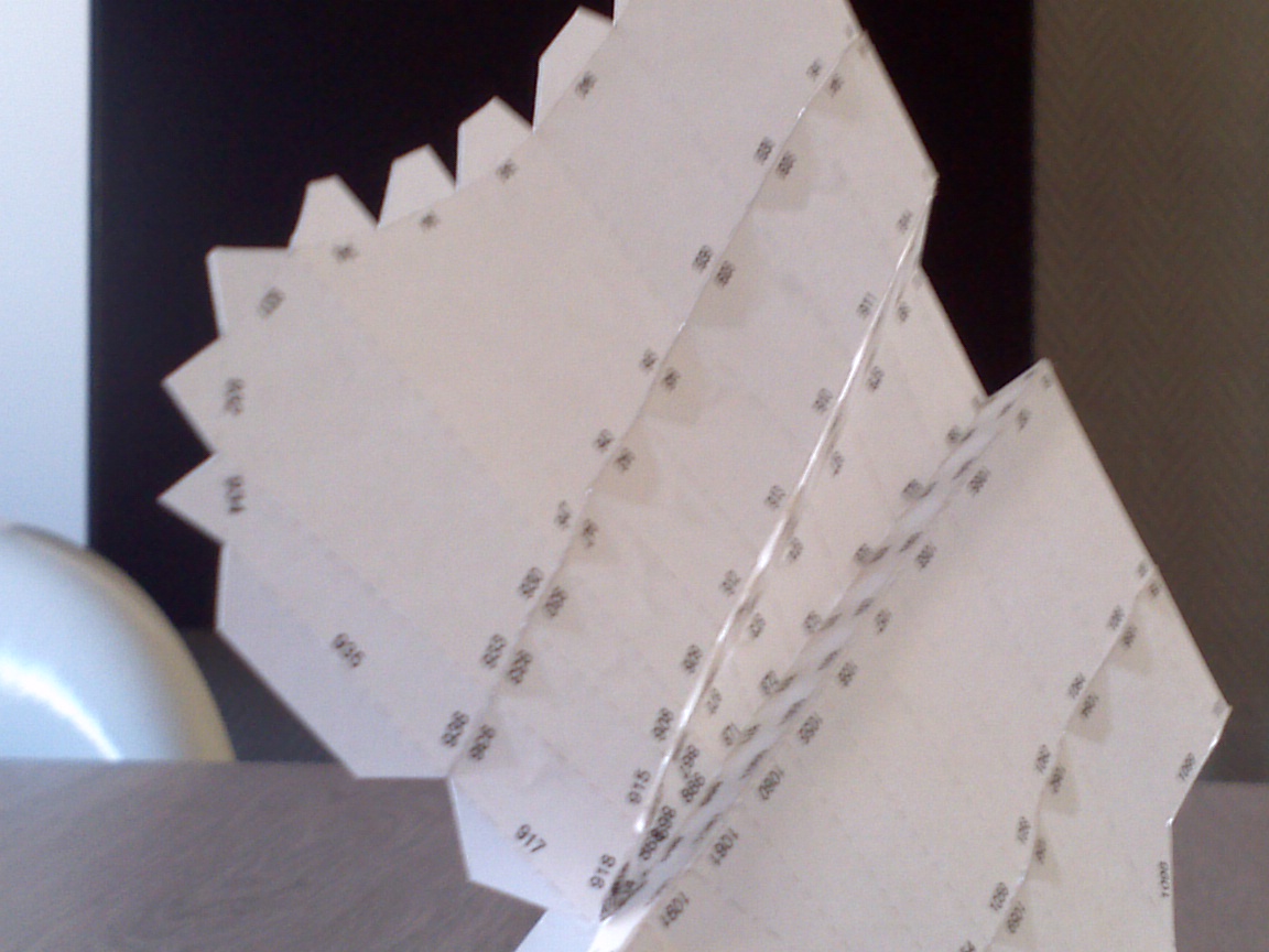

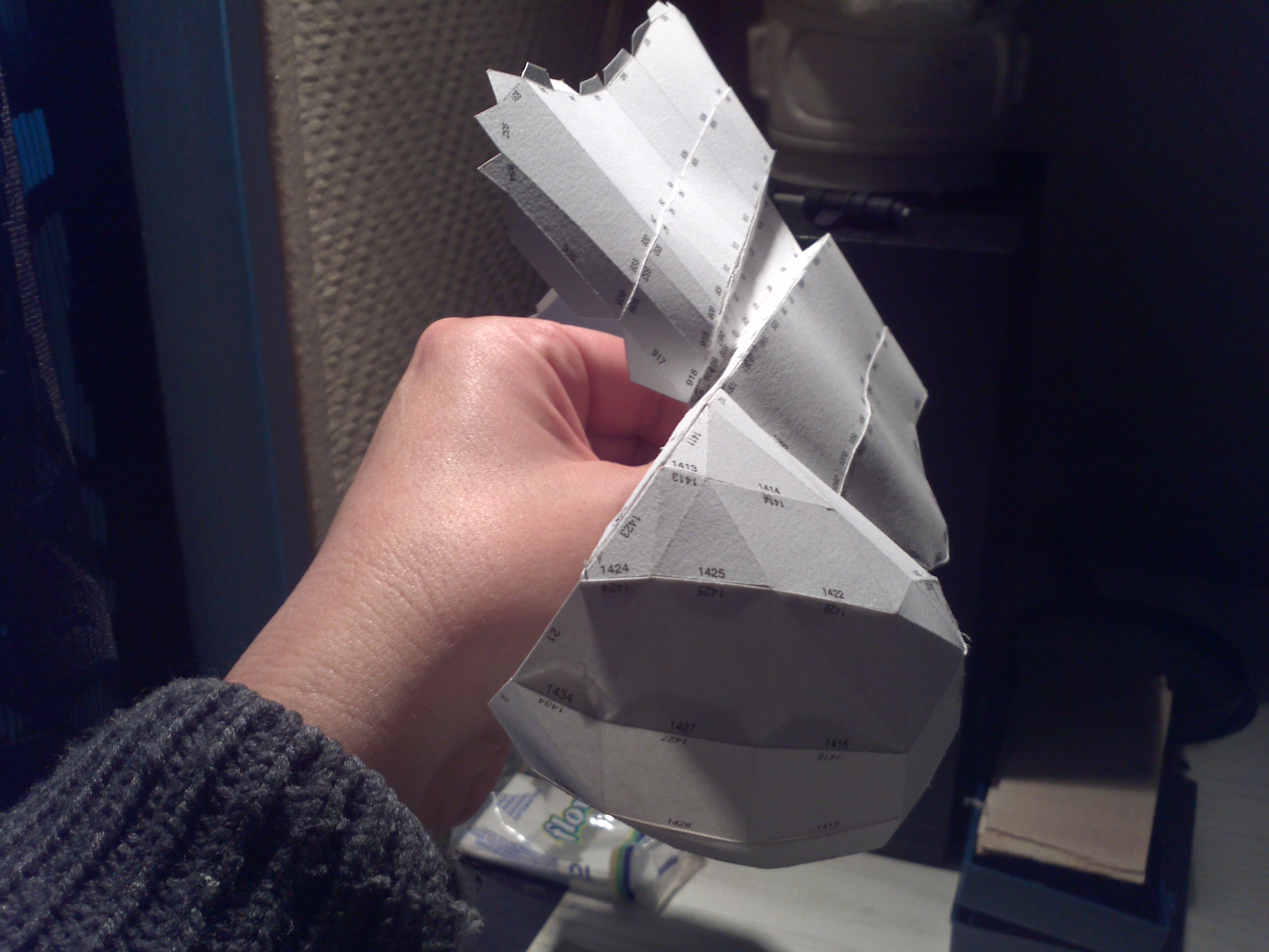

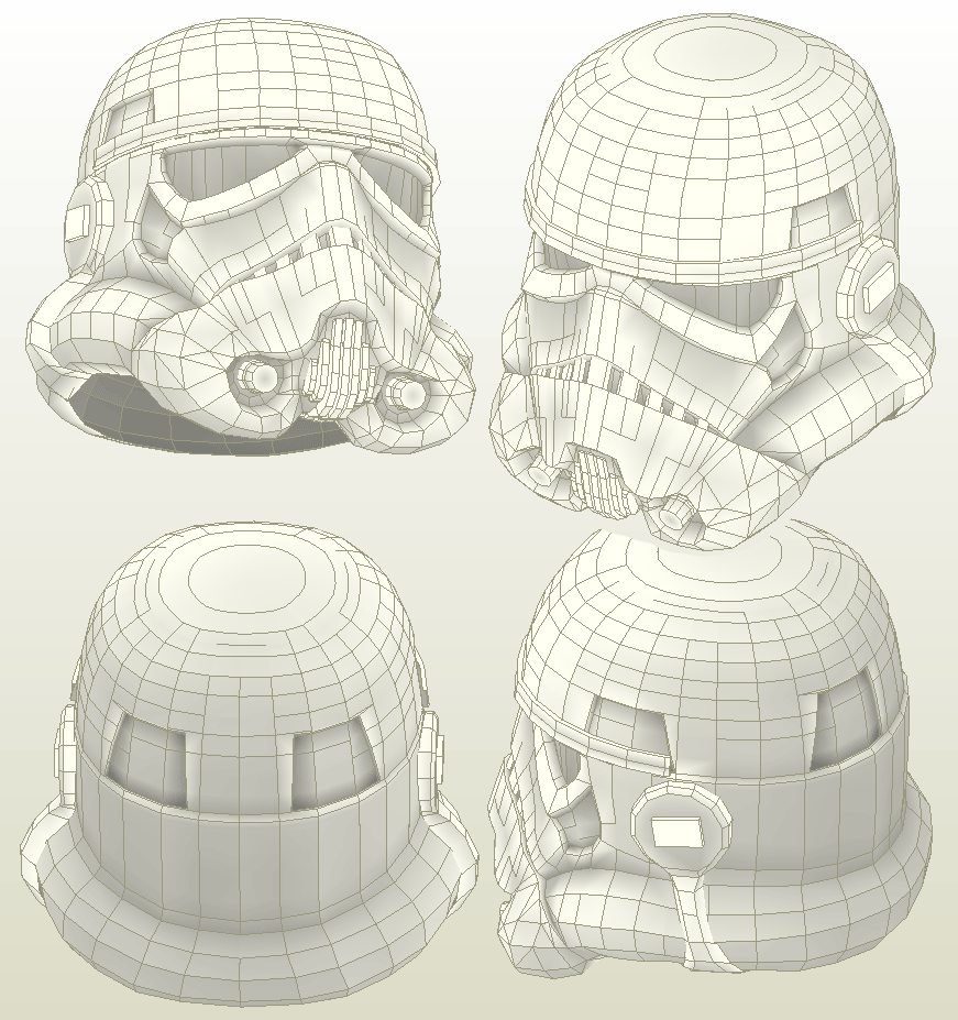

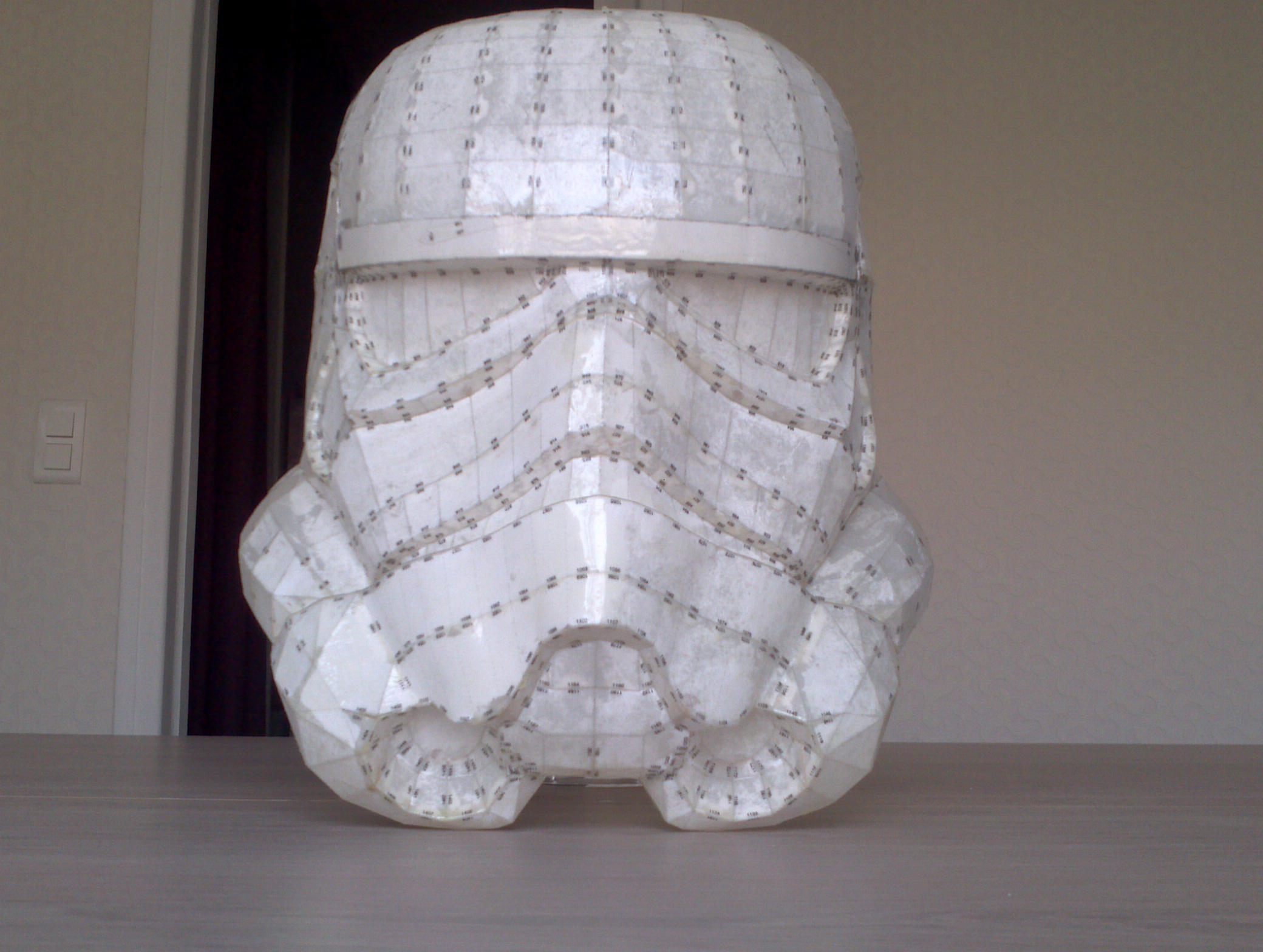

Hello everyone,
I wanted to have me as my helmet and especially to my hands.
The project started in December 2013.
some pictures ...
quelques photos... 2013-12-26_17-43-52_750.jpg2013-12-26_17-44-15_863.jpg2013-12-26_17-44-33_652.jpg2013-12-28_13-59-18_185.jpg2013-12-28_15-12-26_881.jpg2013-12-29_11-57-00_879.jpg2013-12-29_11-57-18_19.jpg2013-12-29_11-57-41_371.jpg

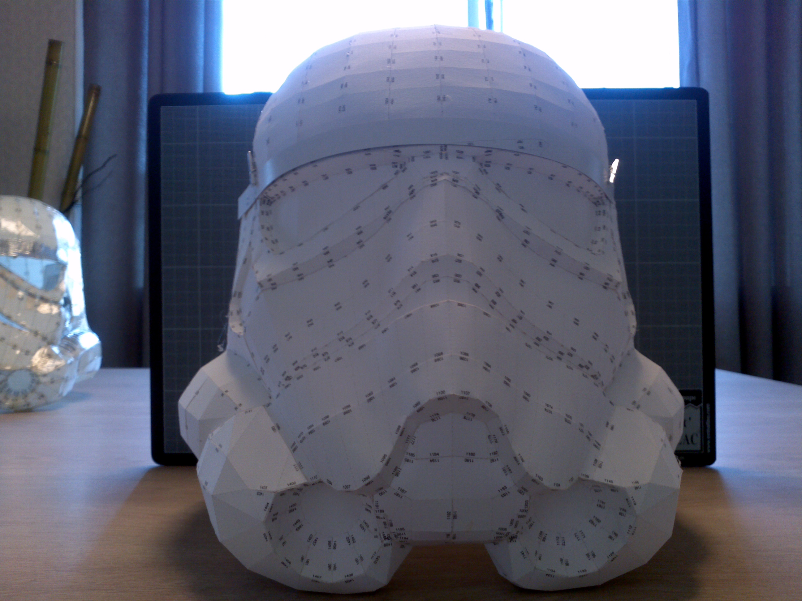

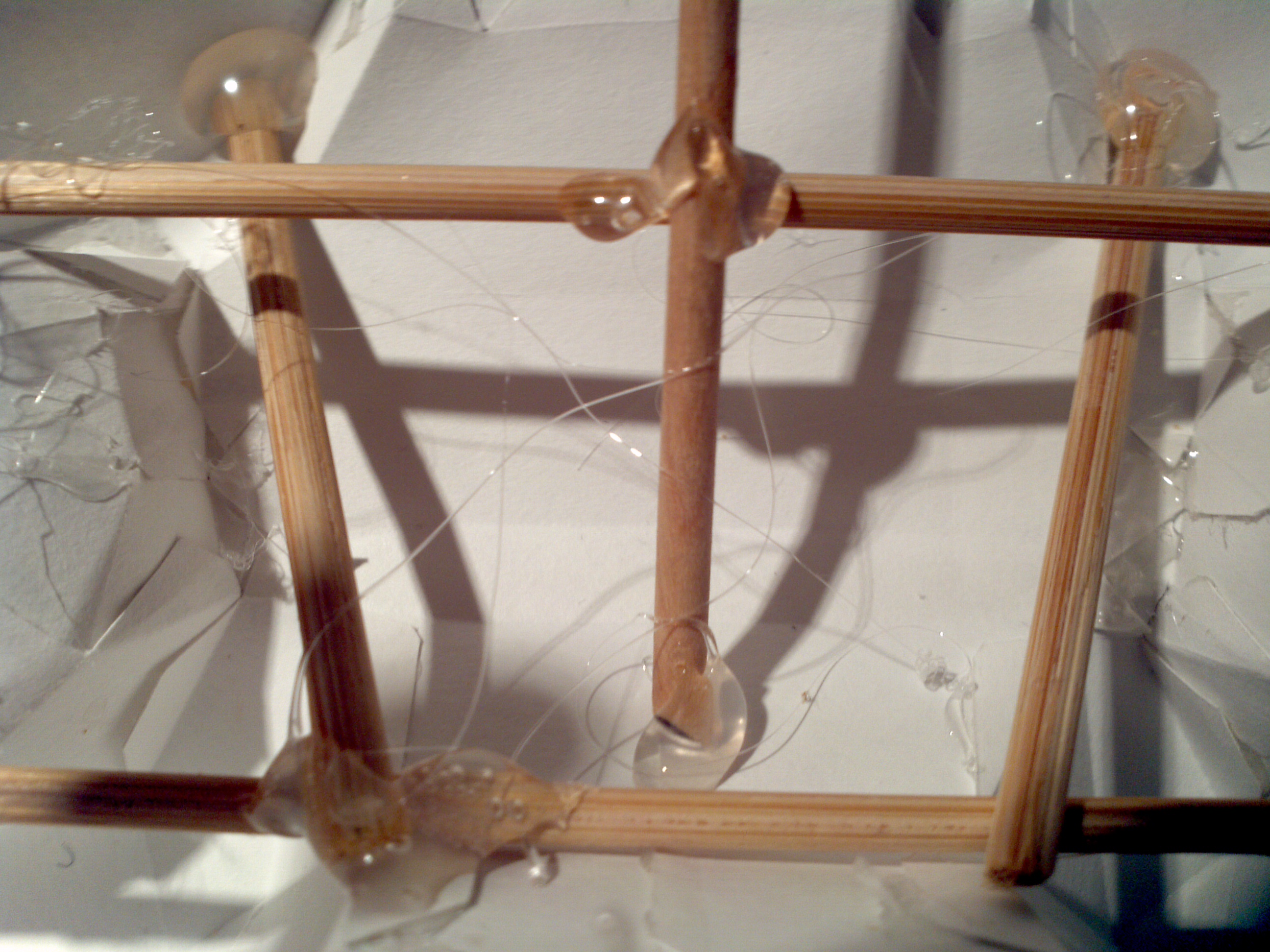

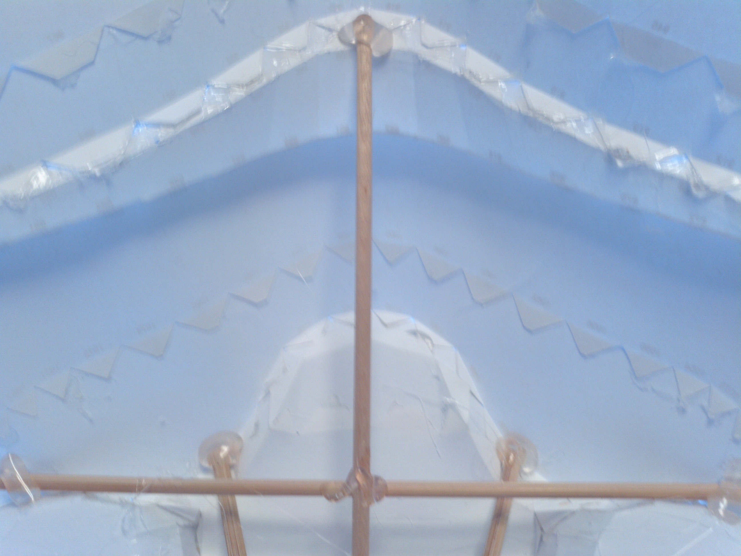

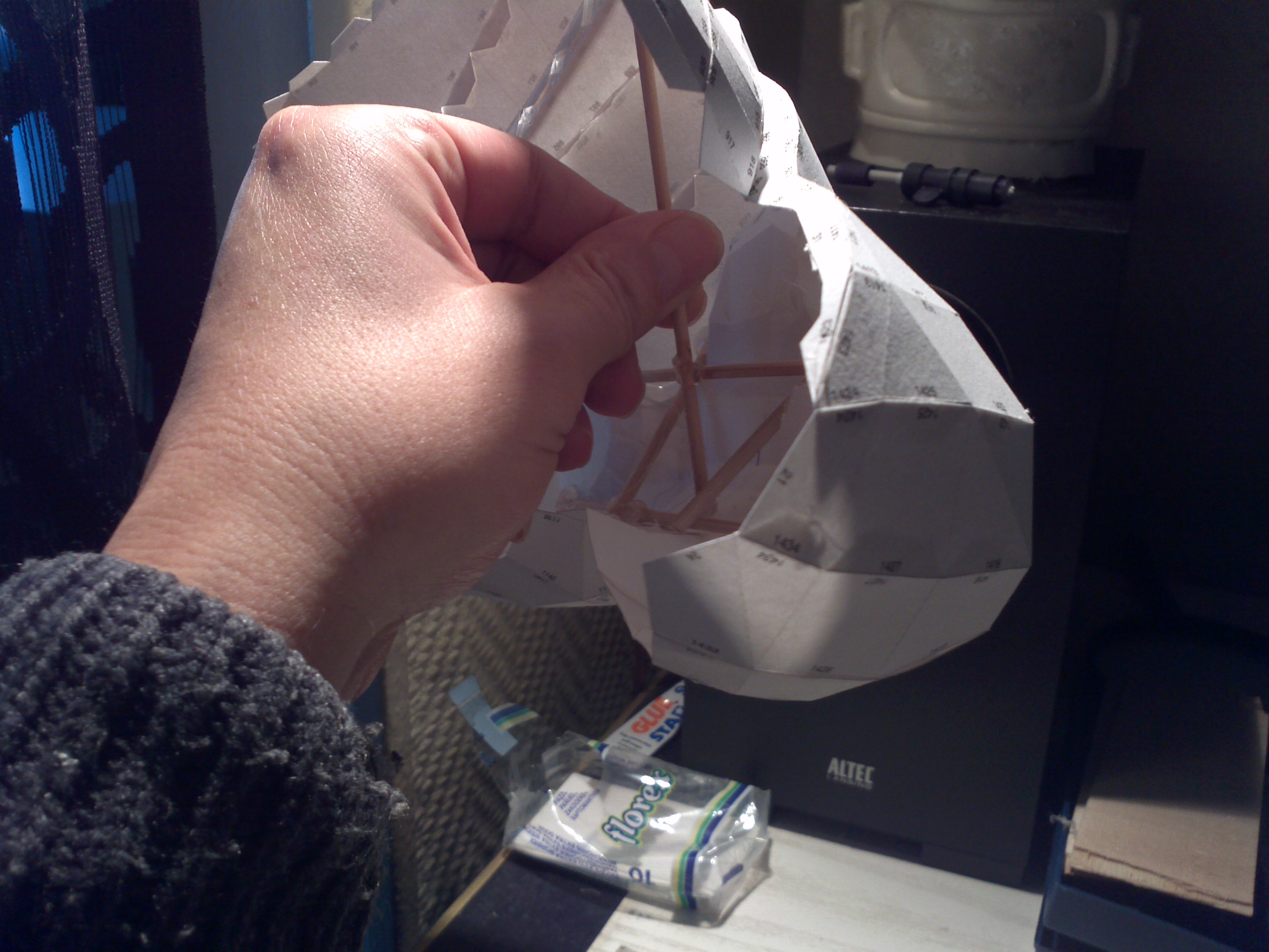

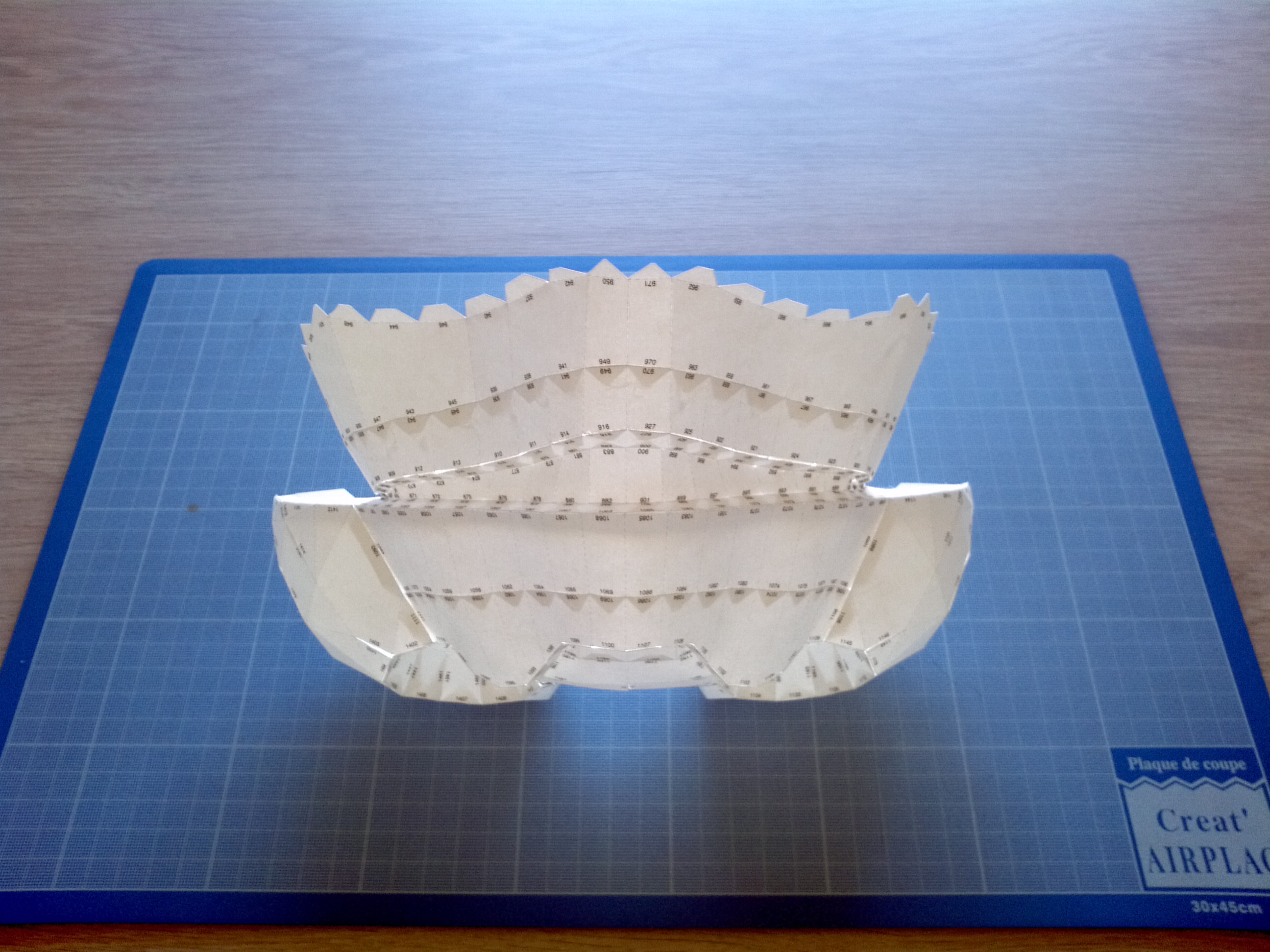

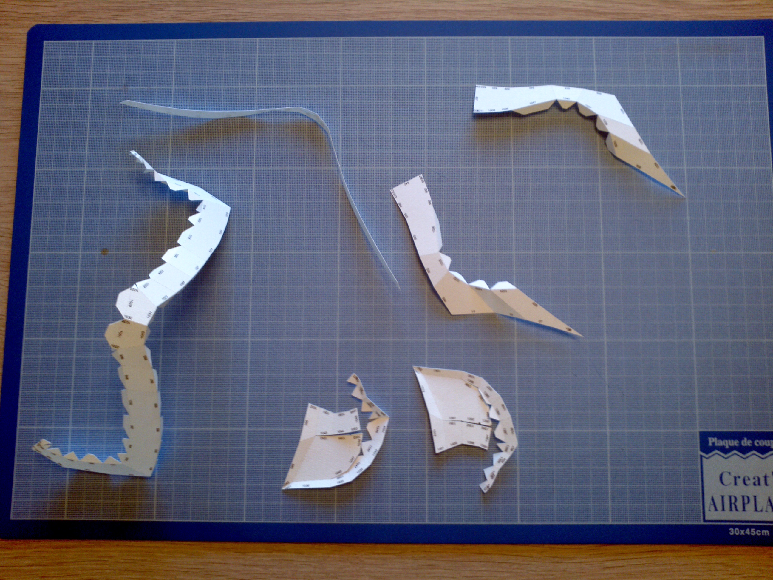

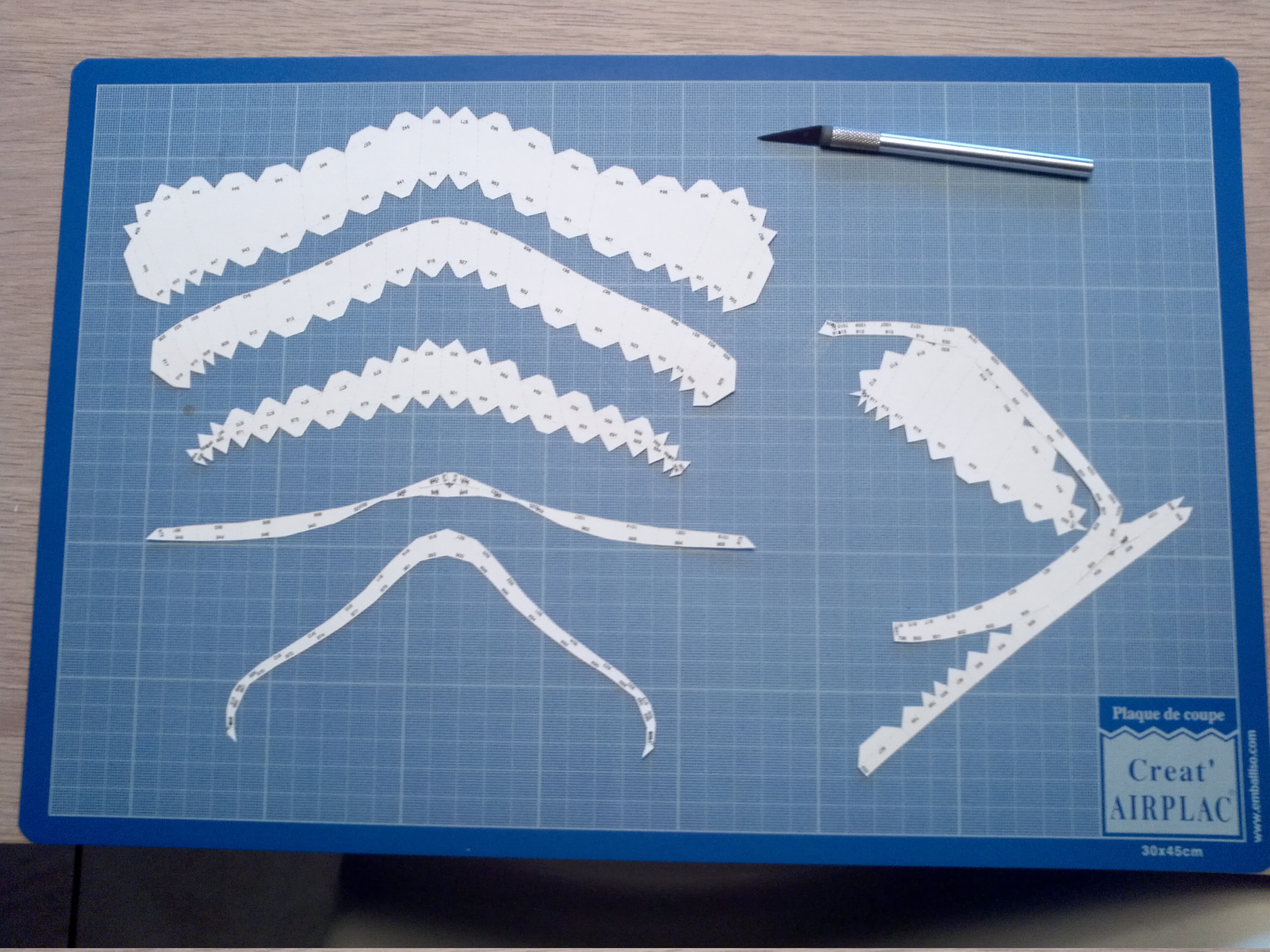

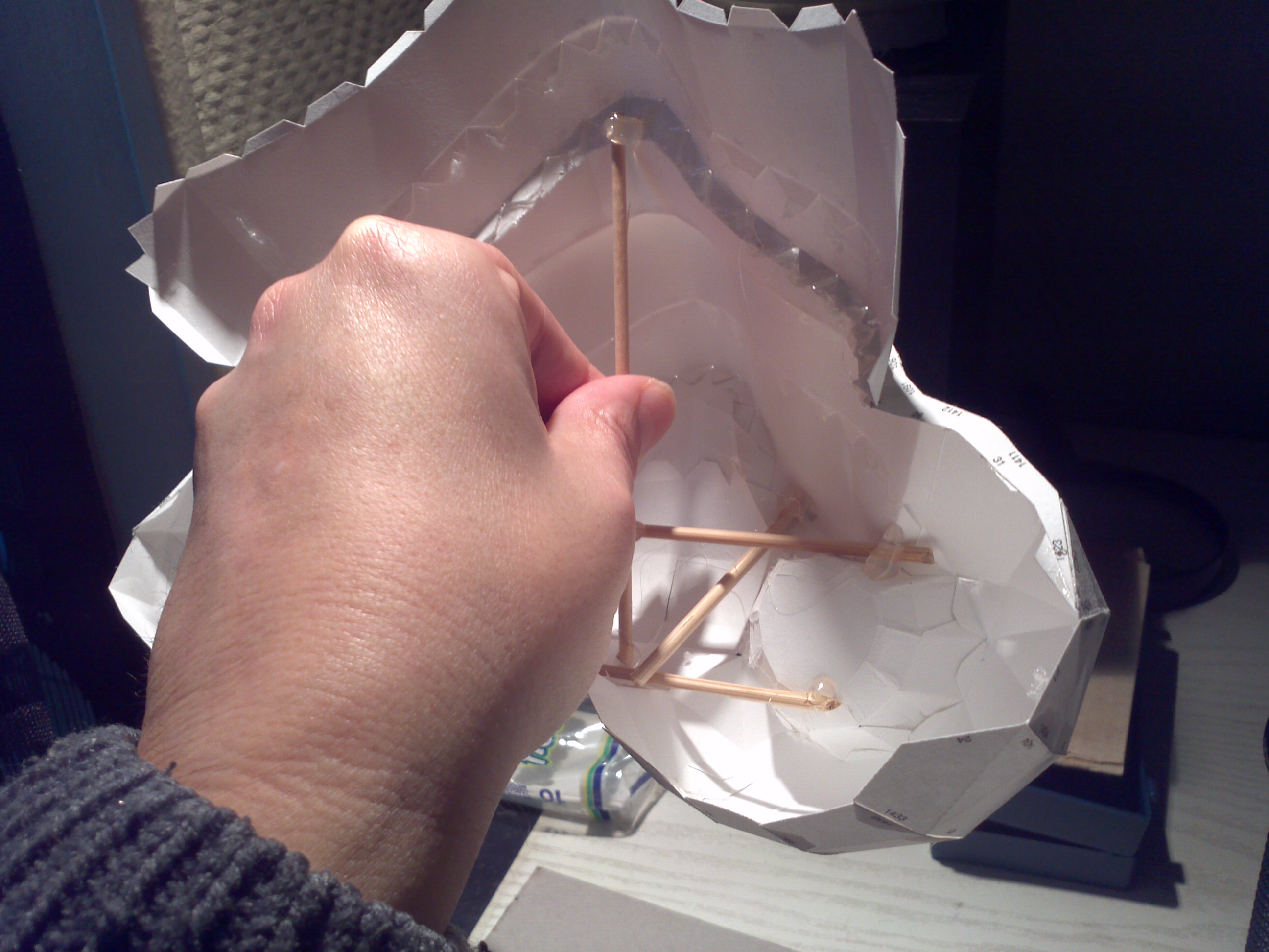

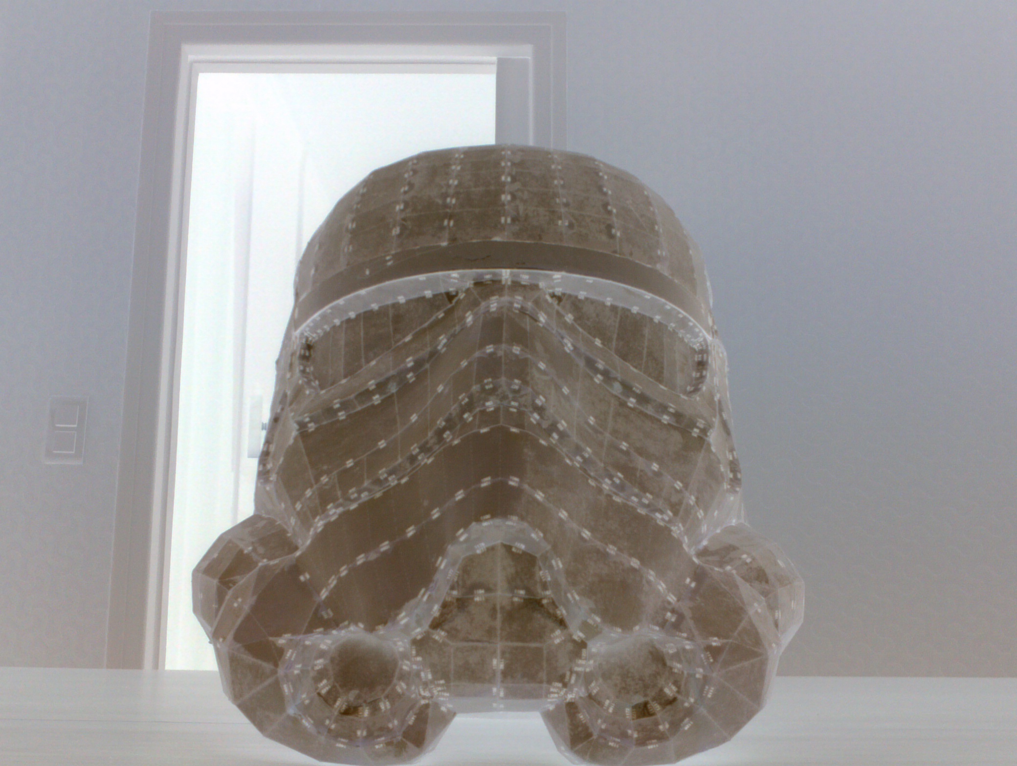

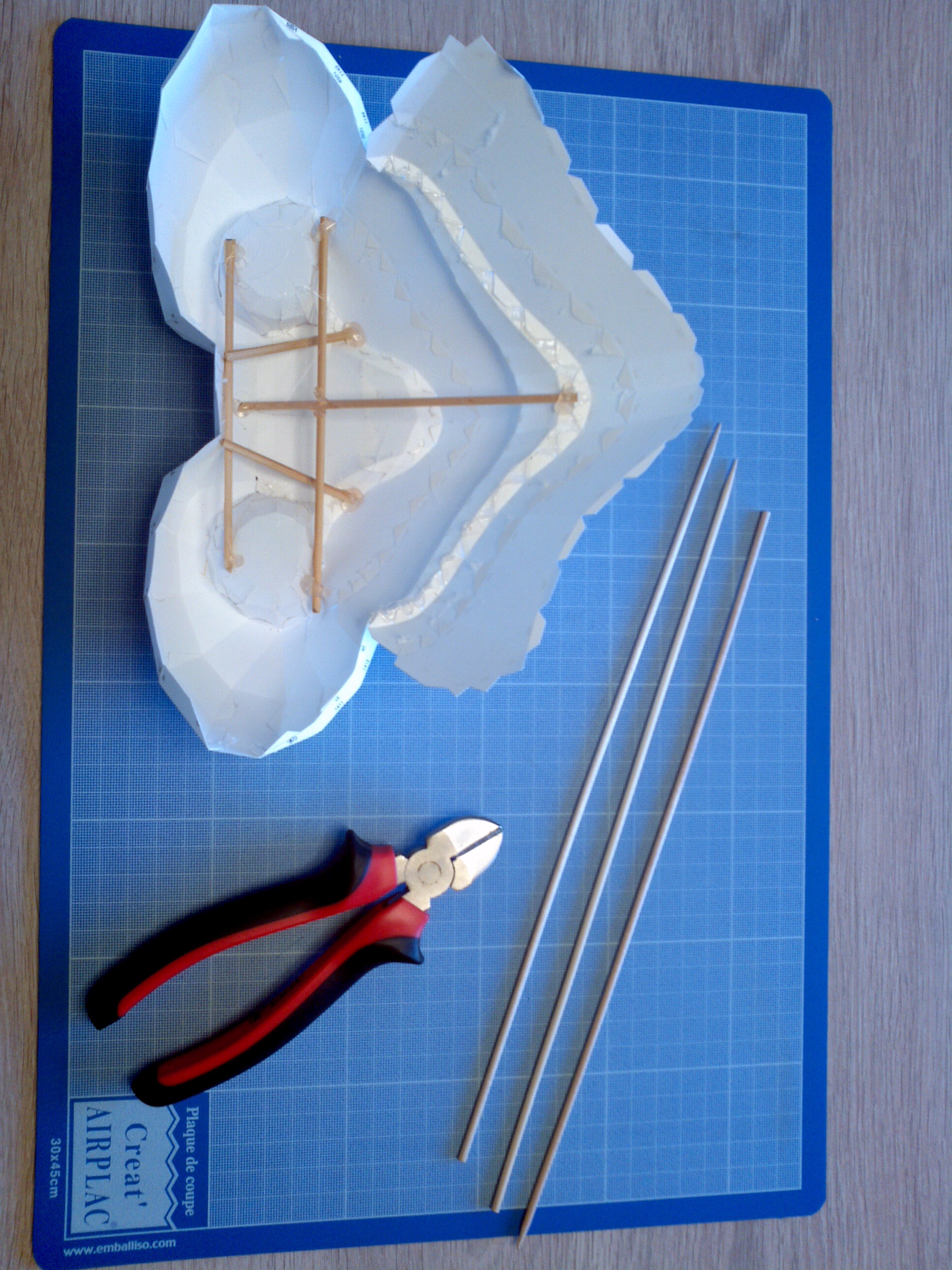

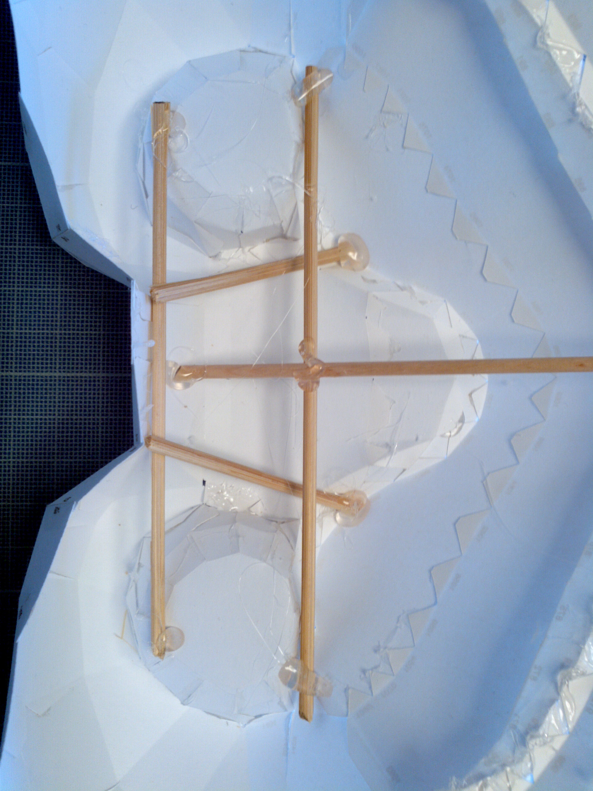

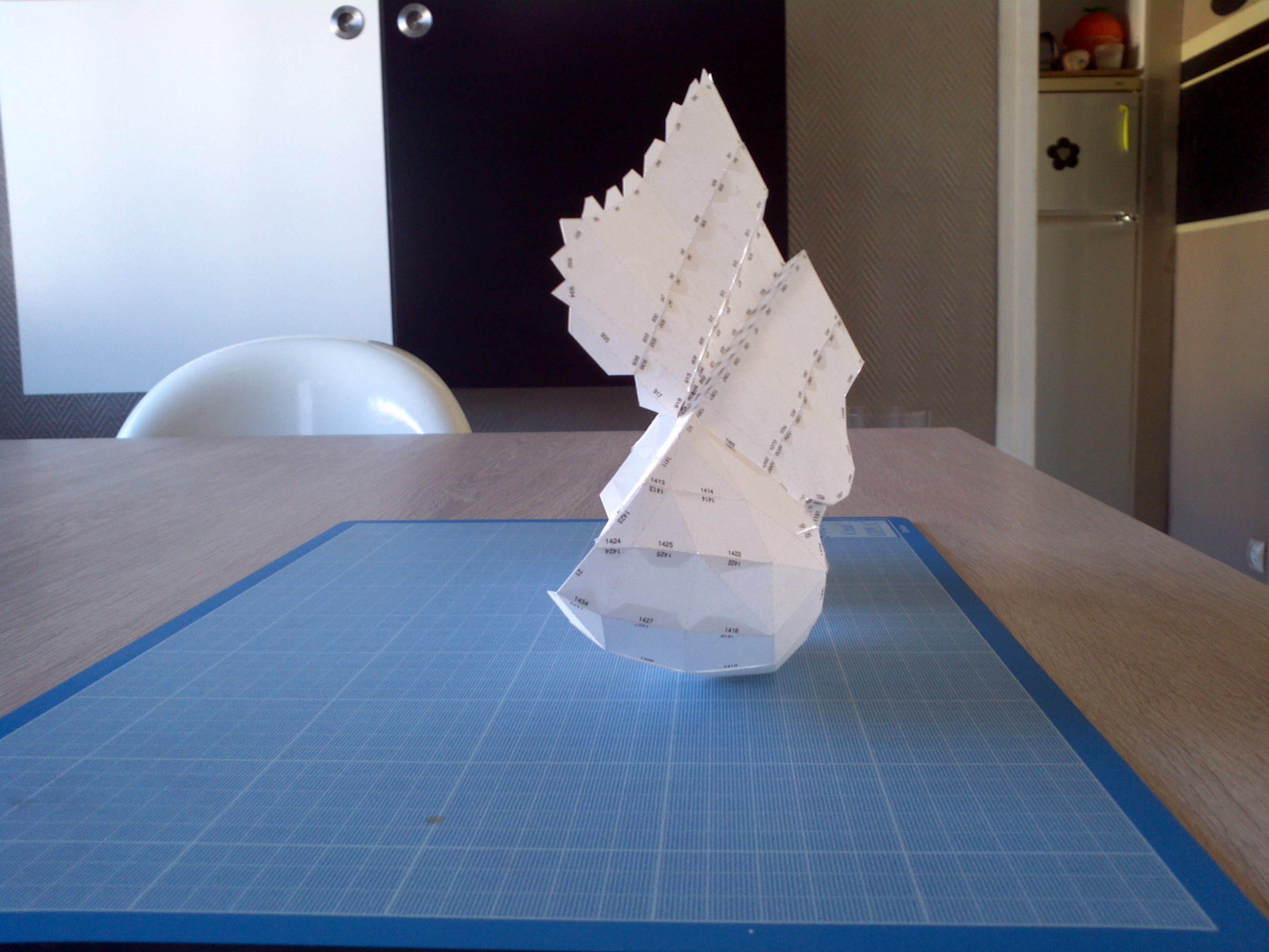

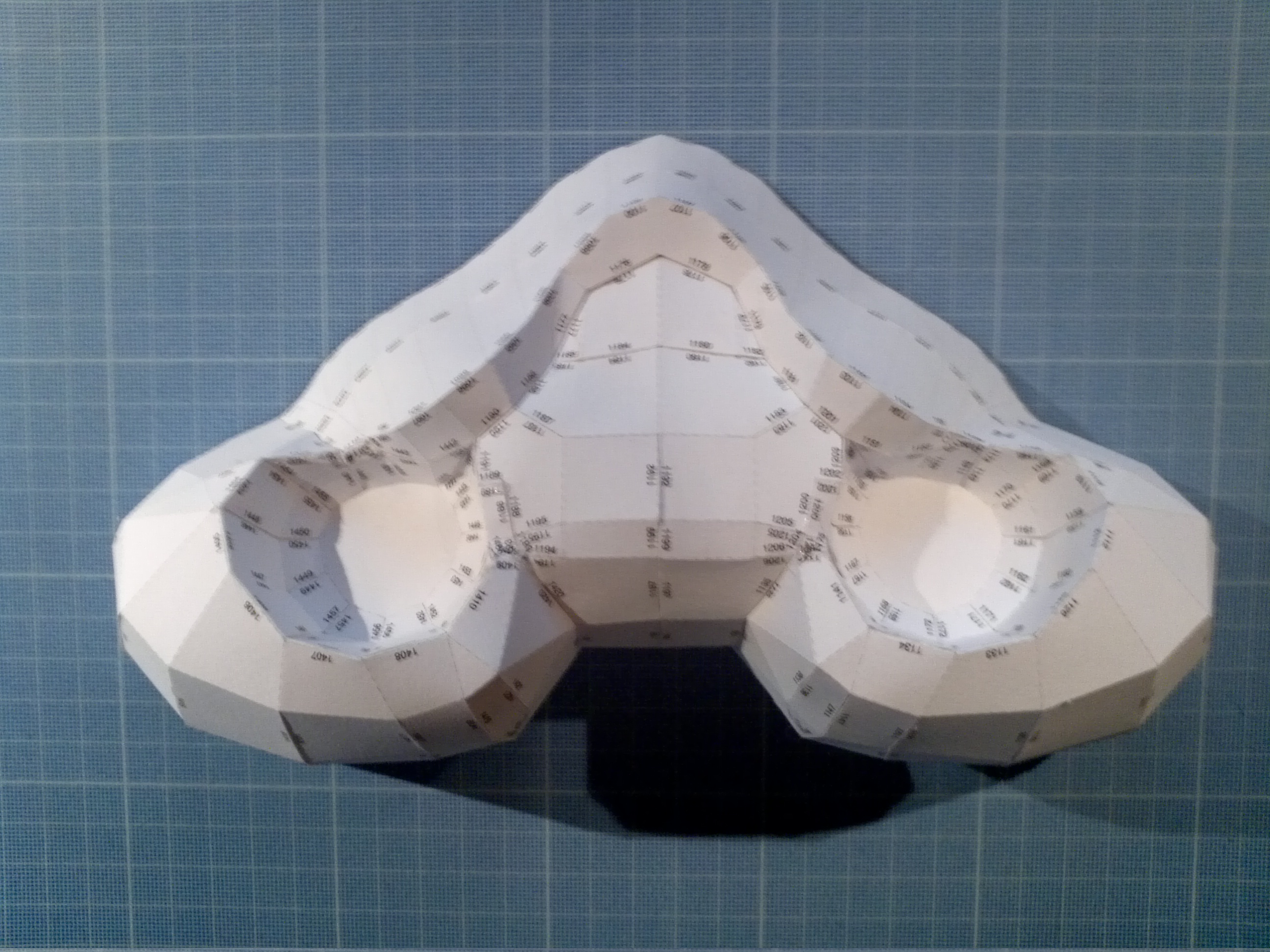

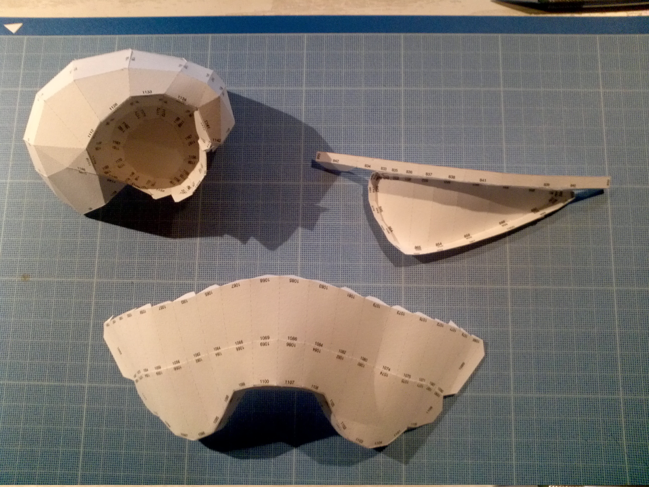

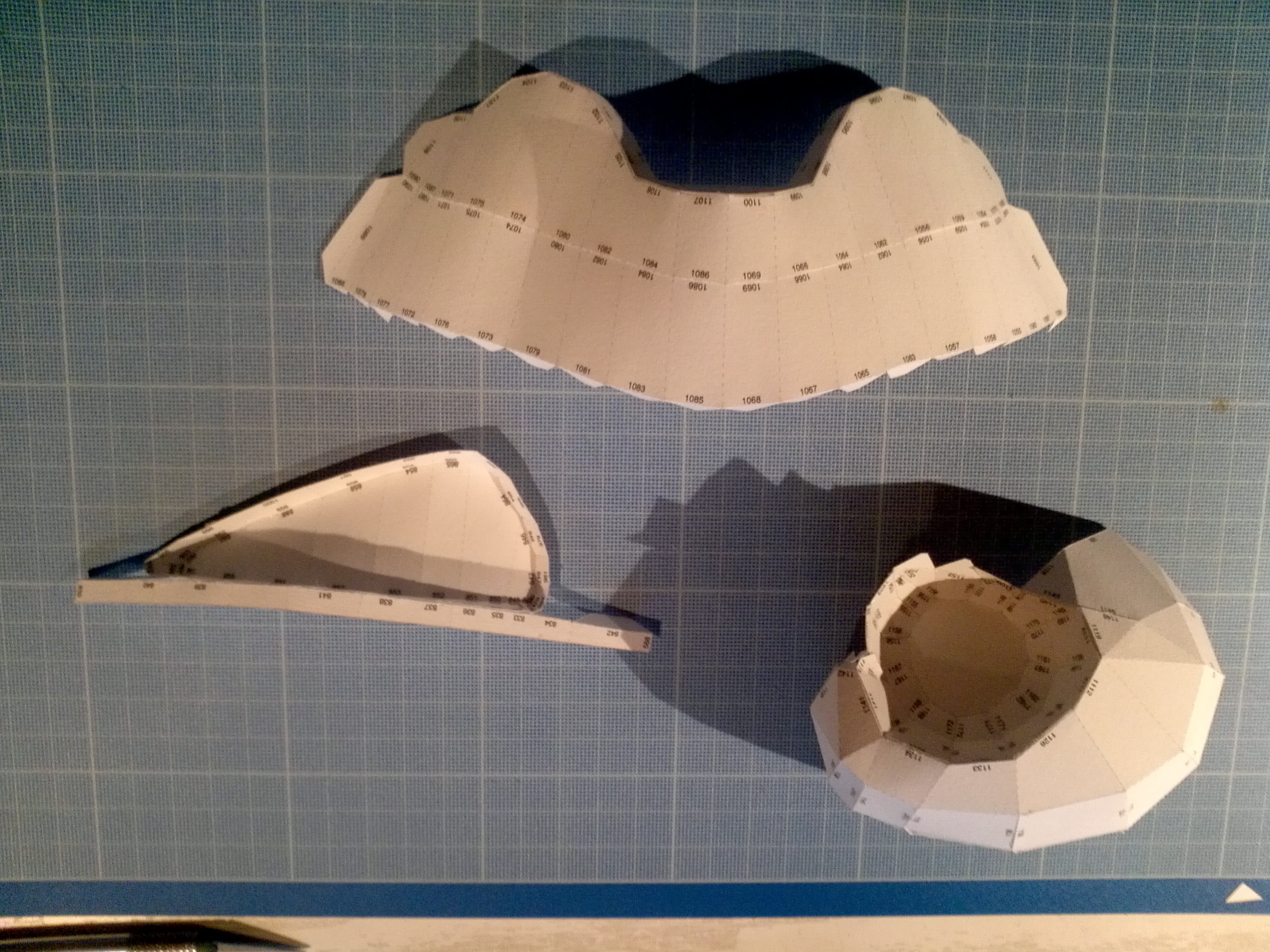

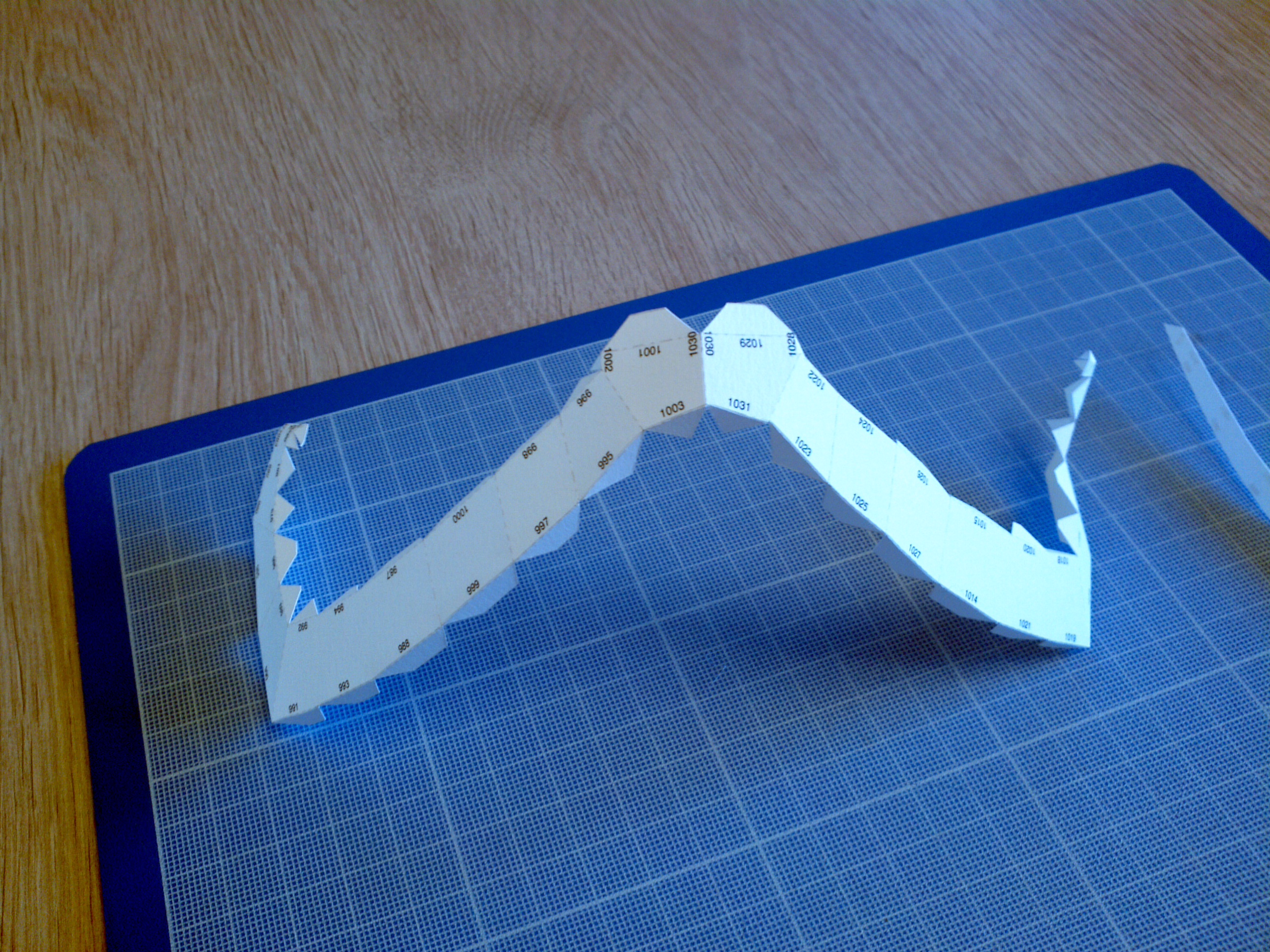

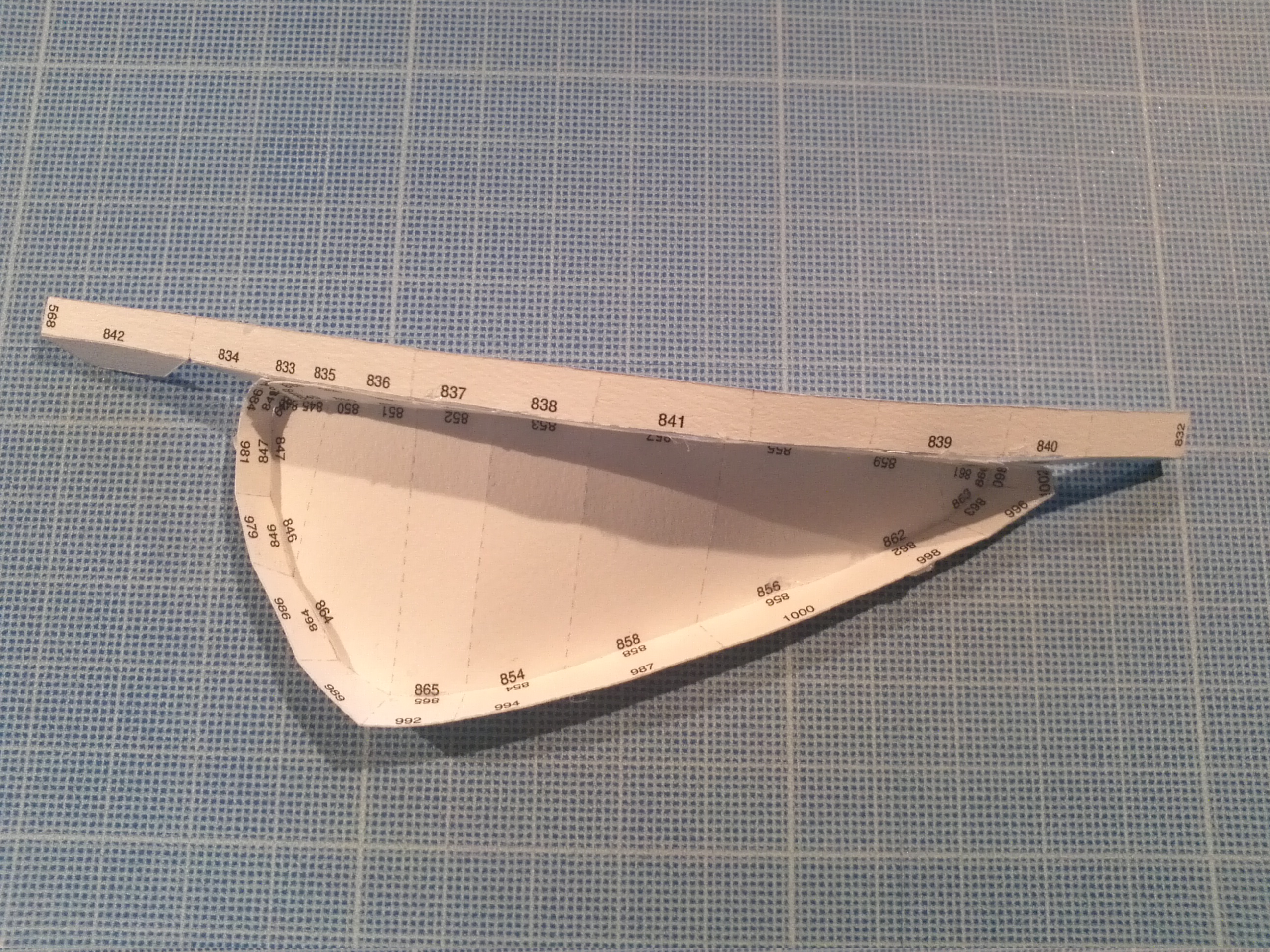

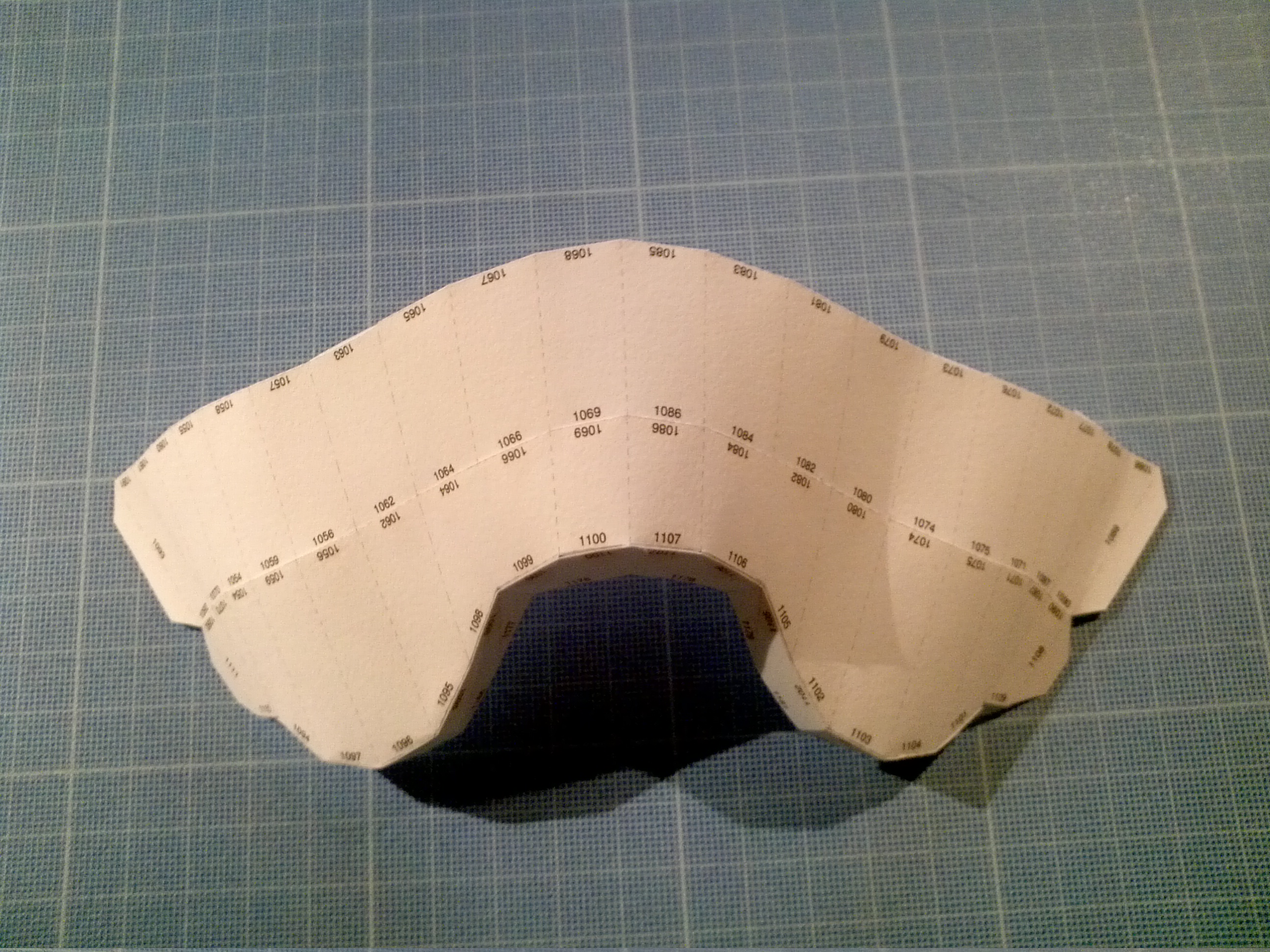

hello,
after some time has cut out, stick together, we are like this:

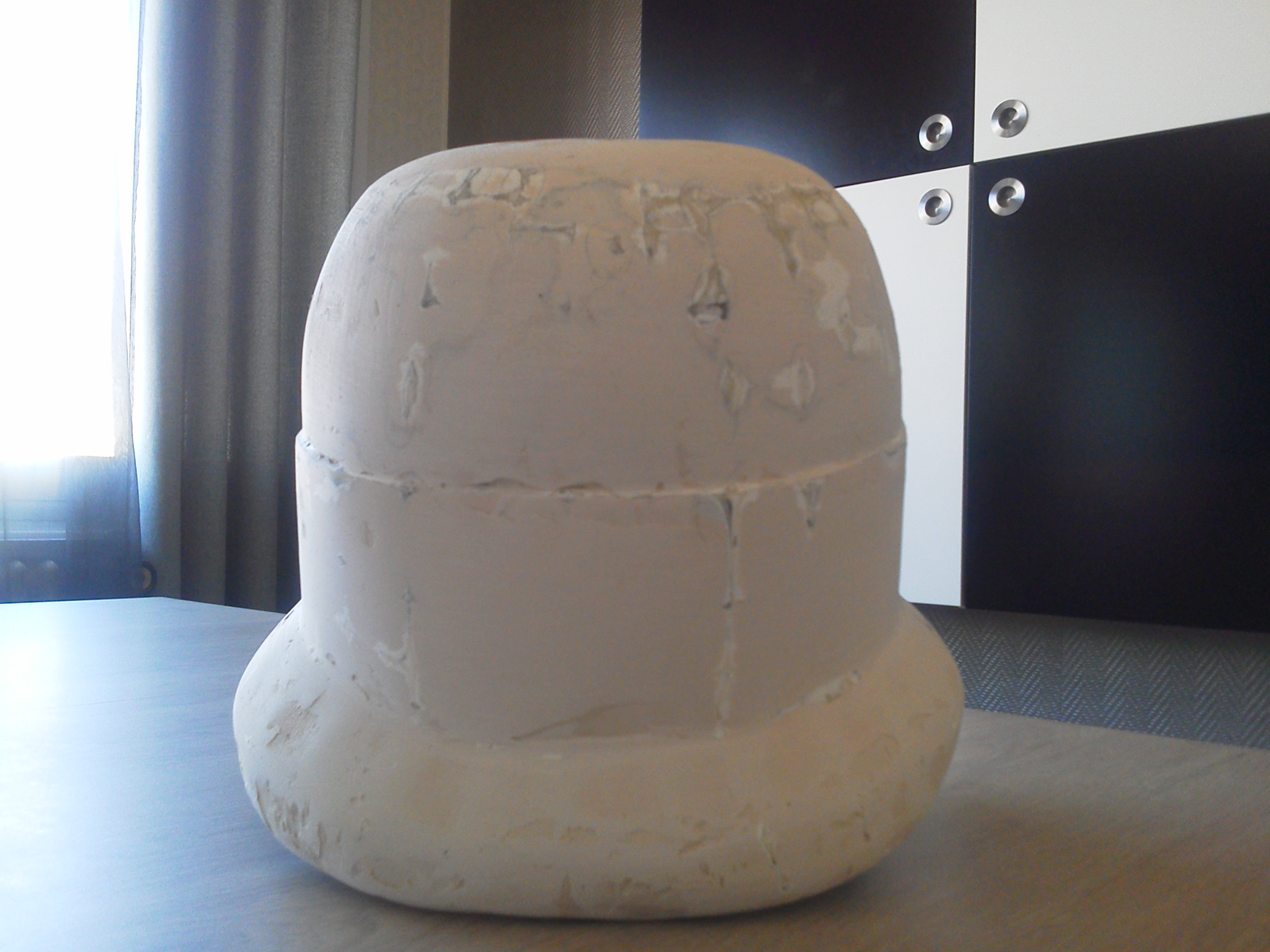

a photo in order to see the negative forms:2014-05-06_14-01-19_498.jpg
hello,

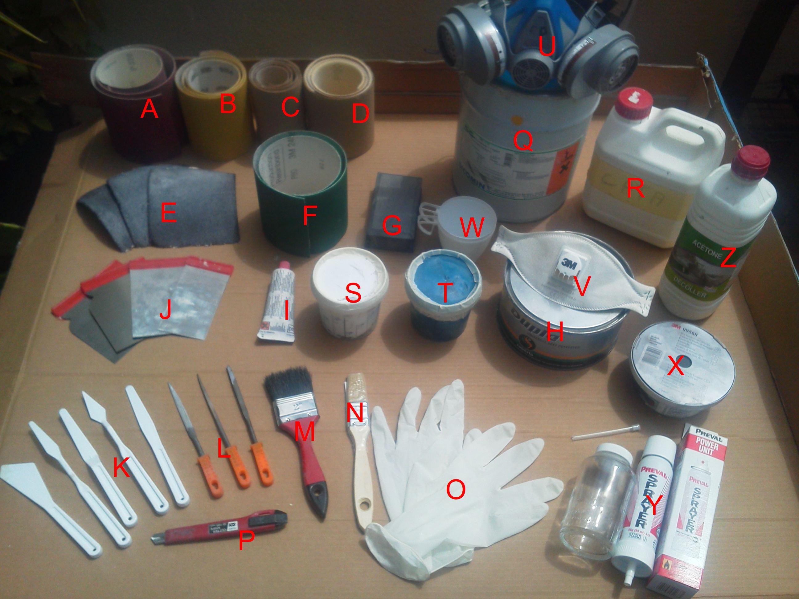

it is now time to attack has the most difficult but also the most exciting part, here are some tools and materials that I use.
Caution some products are specifically professional hence difficult to find commercially.
grain sand paper
A ......320
B ......320 velcro
C ......500
D ......800
E ......40
F ......80
G ..... a sand wedge
H ..... bondo
I ...... hardener for bondo
J ..... japenese blade
K ..... knives painter
L ..... small limes
M .... brushes to dust
N ..... small brushe for resin
O ..... latex gloves
P ..... cutter
Q ..... resin iso
R ..... catalyst for resin
S ..... white gel coat tickened
T ..... glue fibered
U ..... vapor mask
V ..... dust mask
W .... plastic cup for resin
X ..... witness sanding
Y ..... spray gun
Z ..... acetone

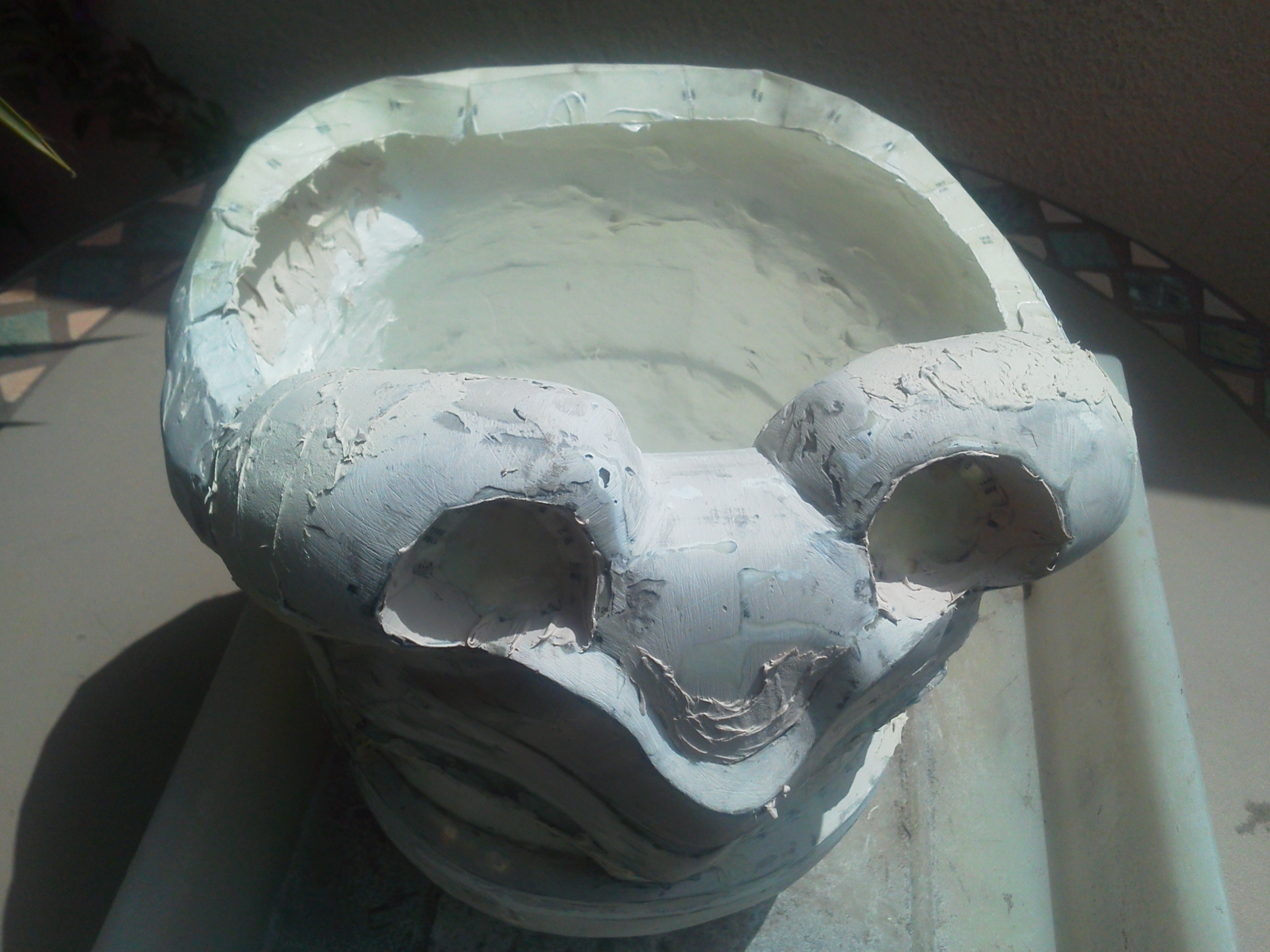

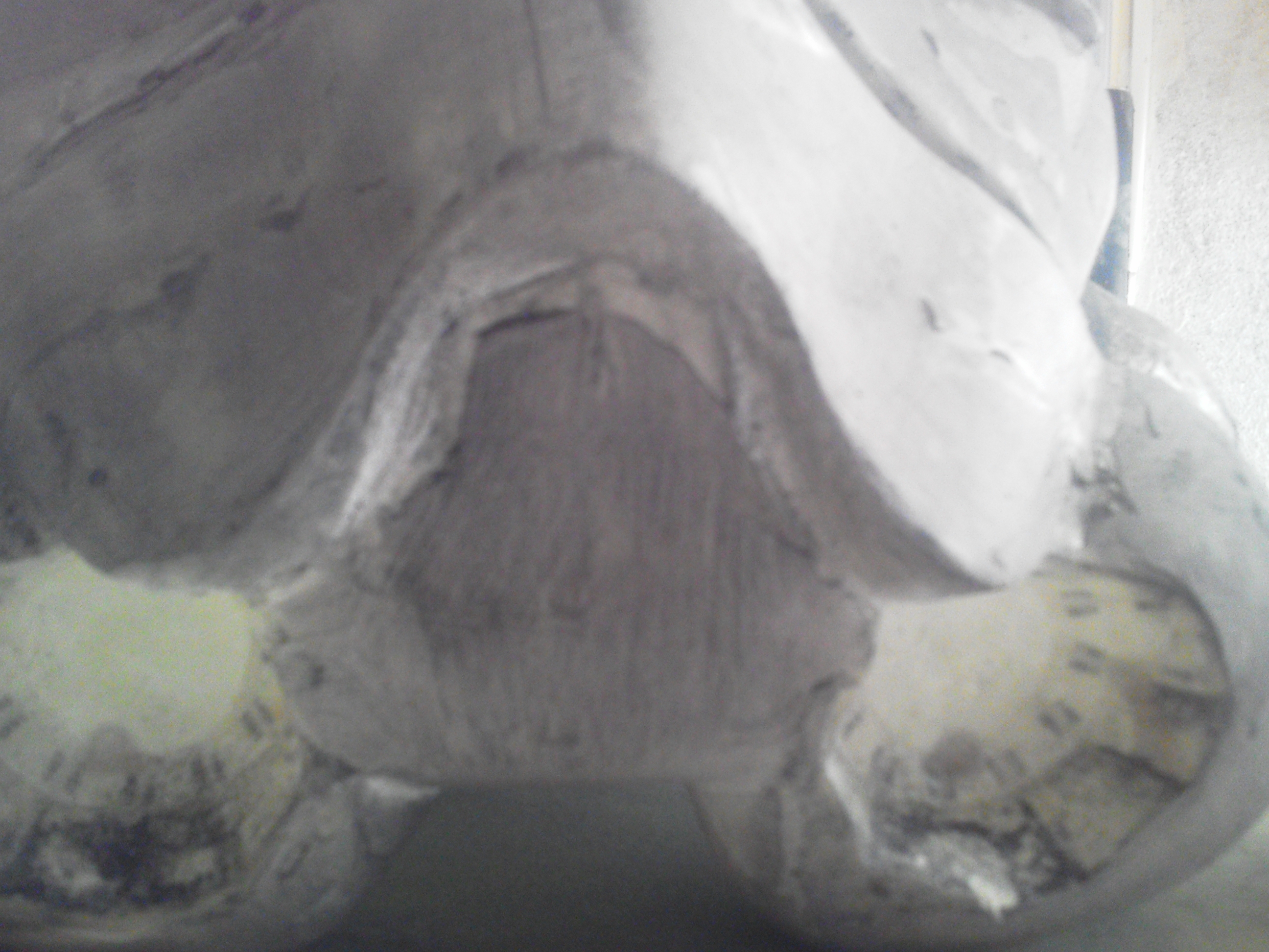

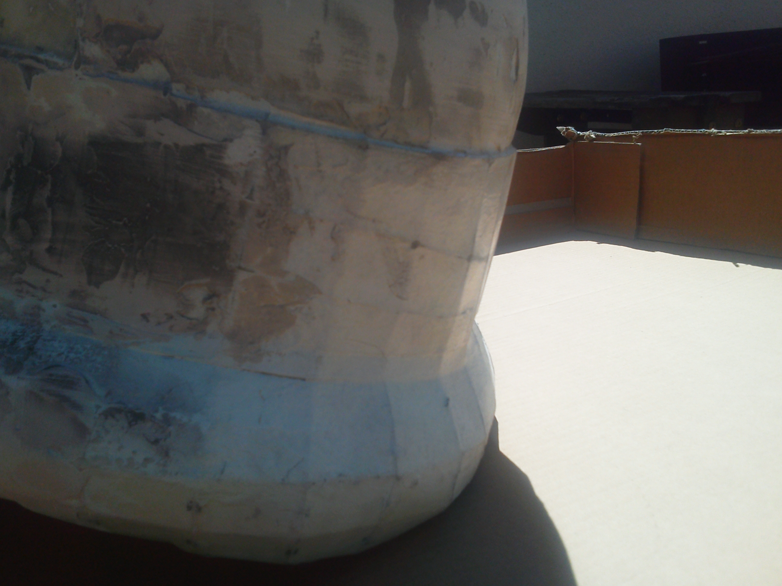

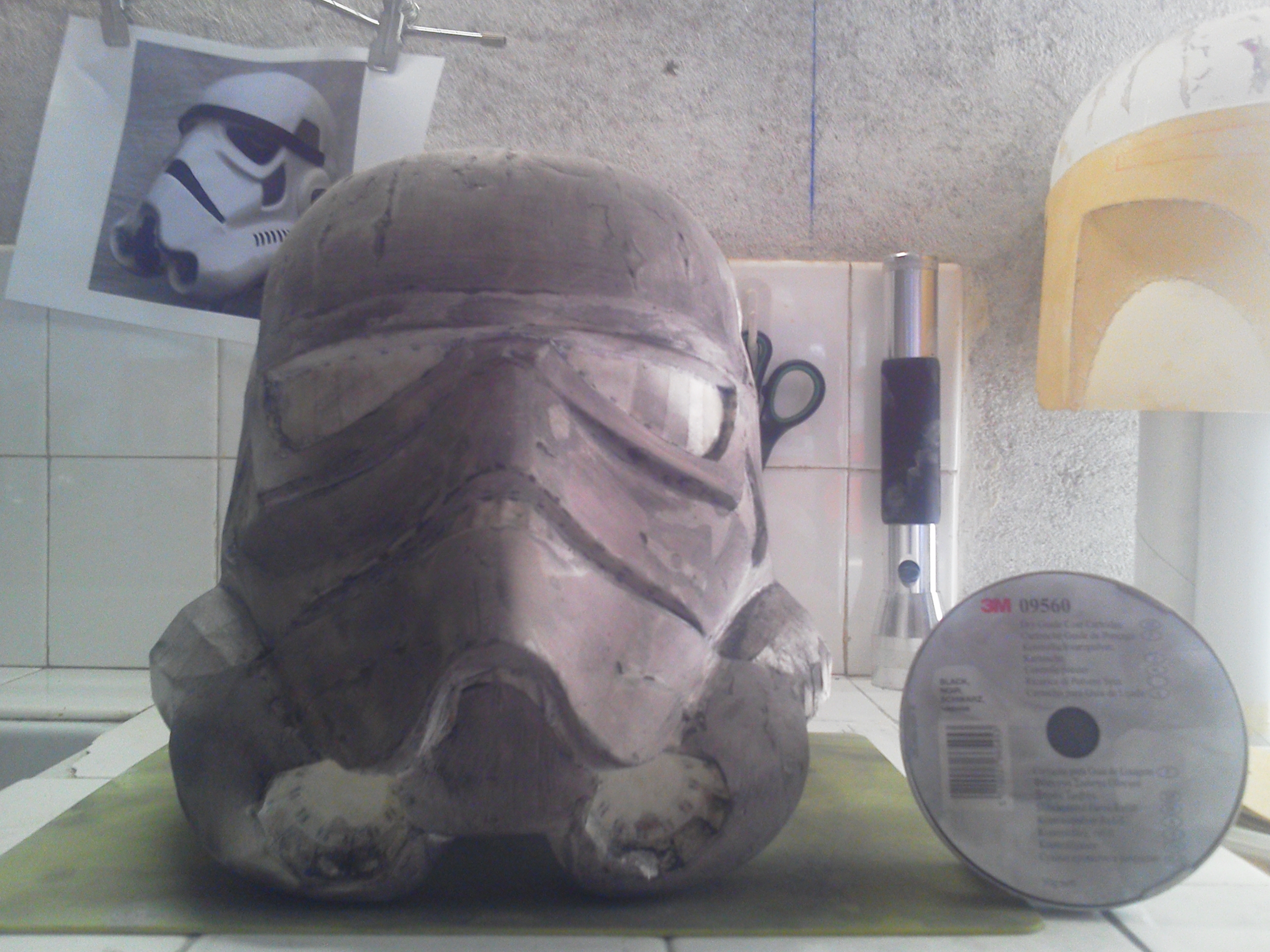

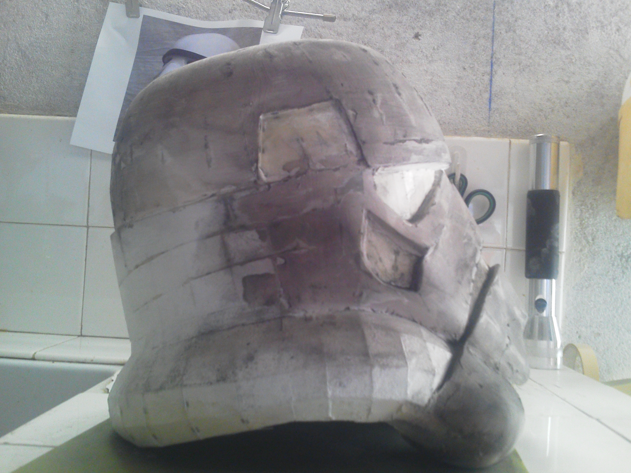

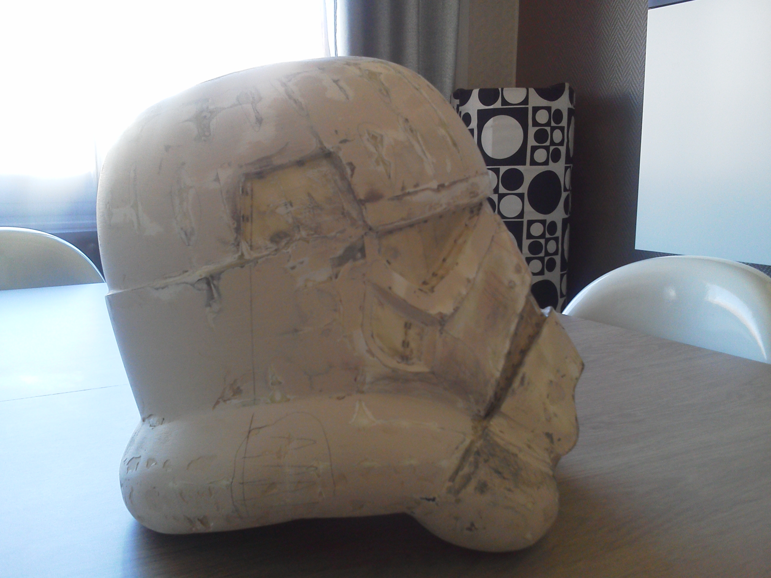

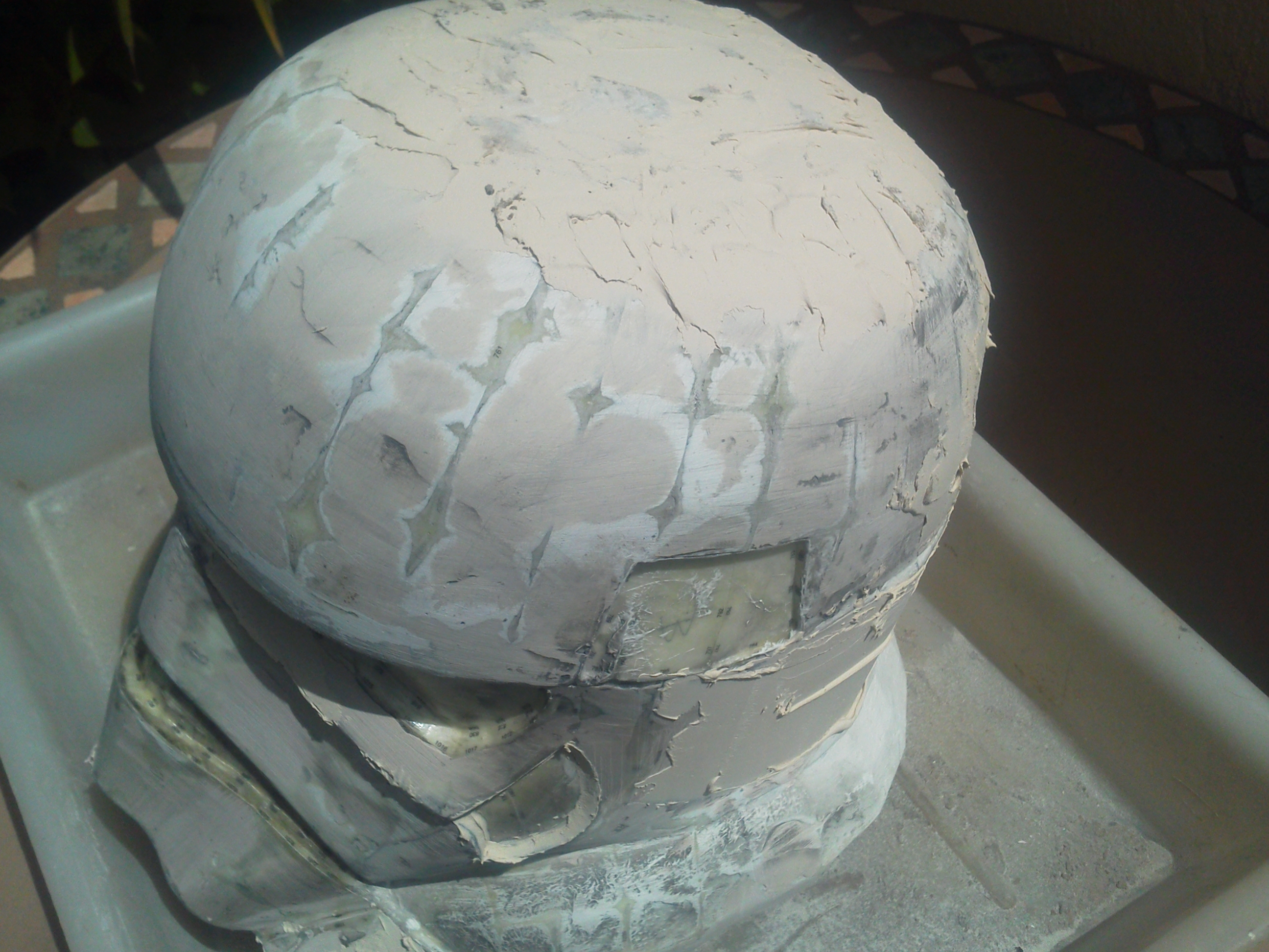

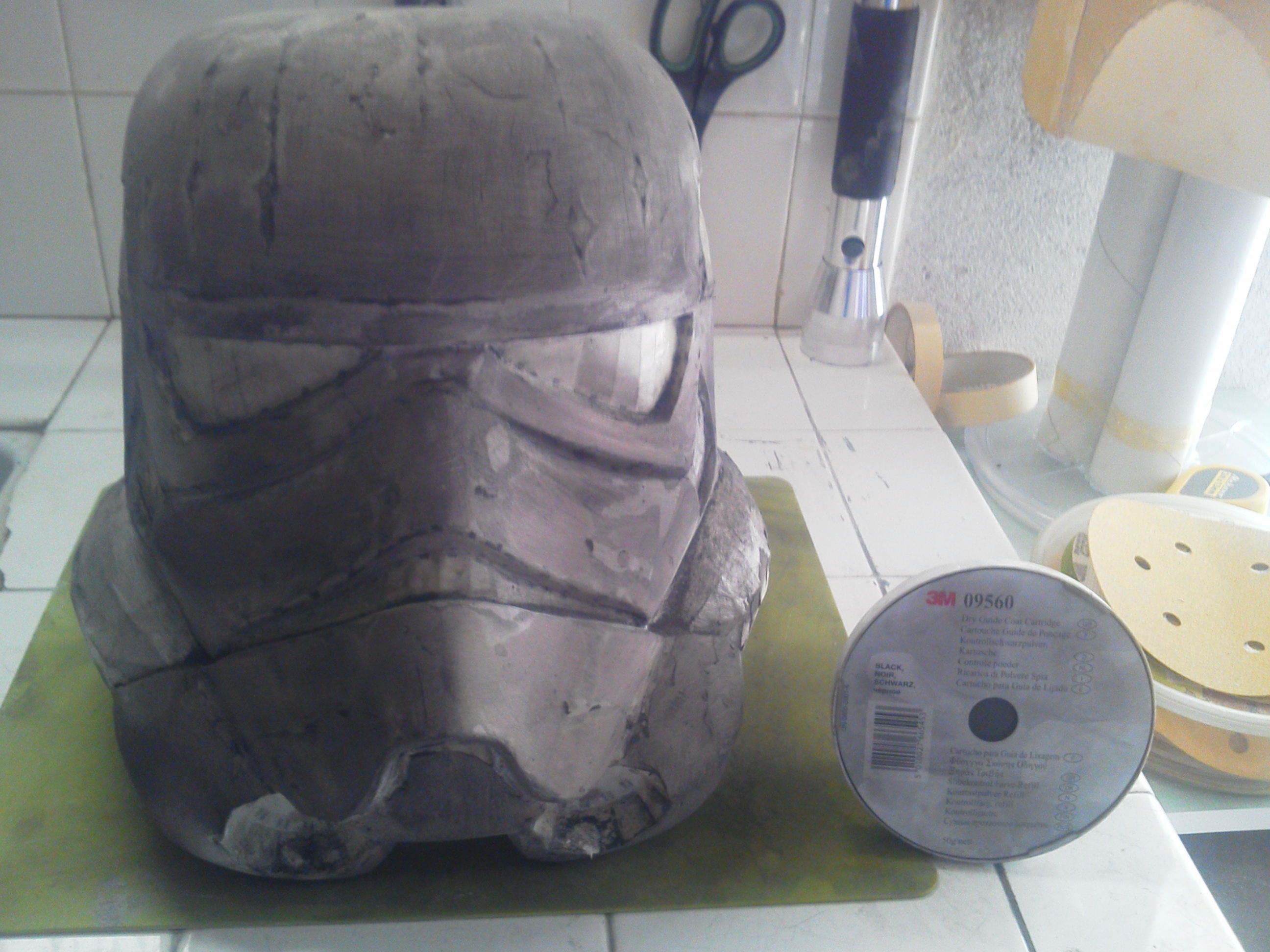

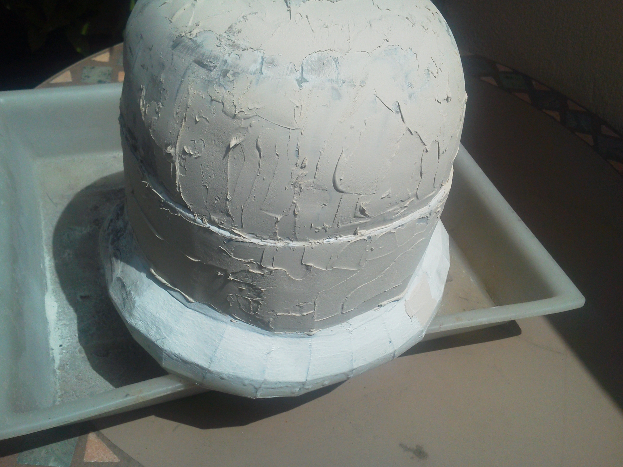

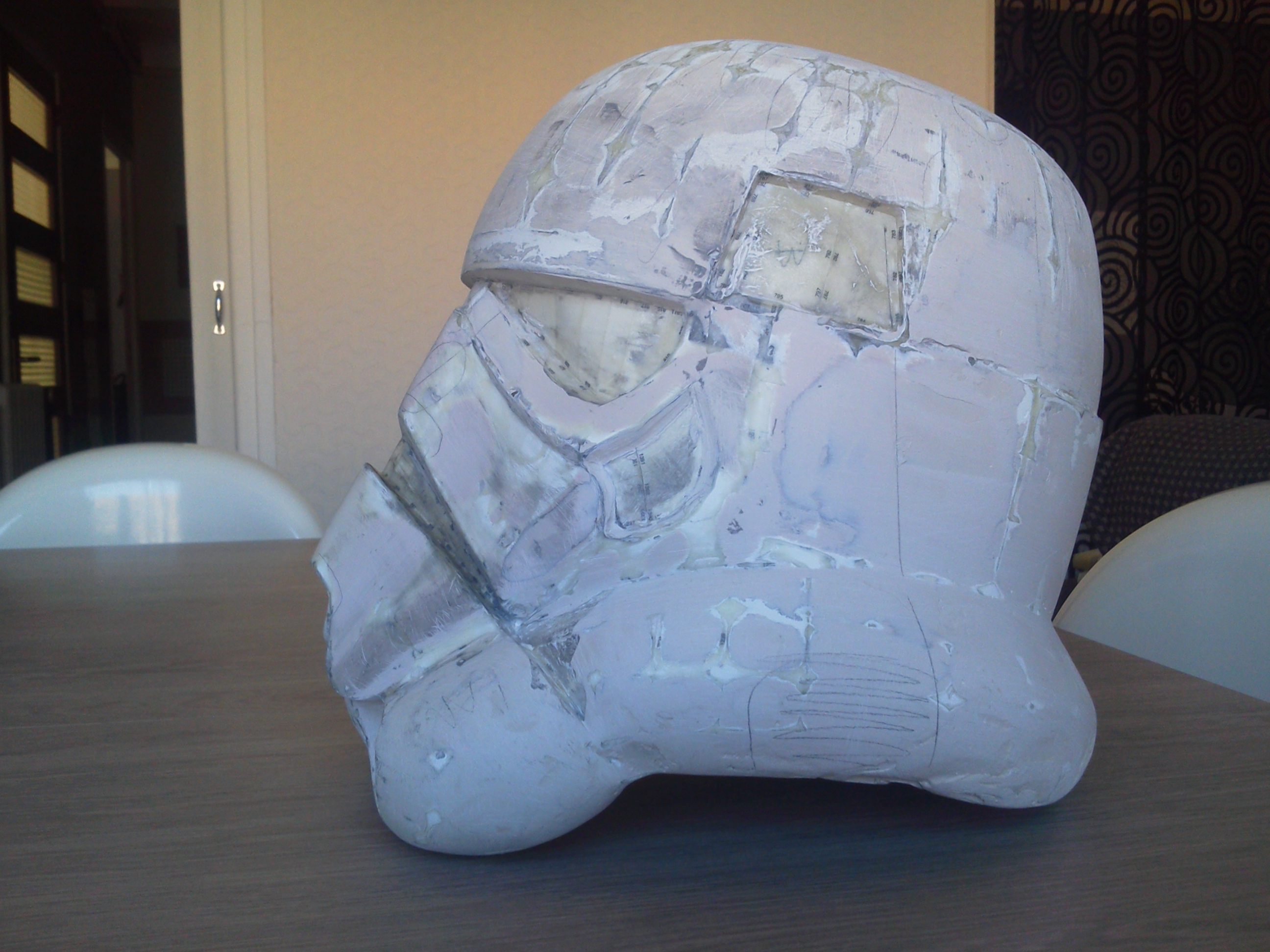

I continue,
IMG_20140518_160535.jpgIMG_20140518_160611.jpgIMG_20140518_160621.jpgIMG_20140518_160635.jpgIMG_20140518_160656.jpg

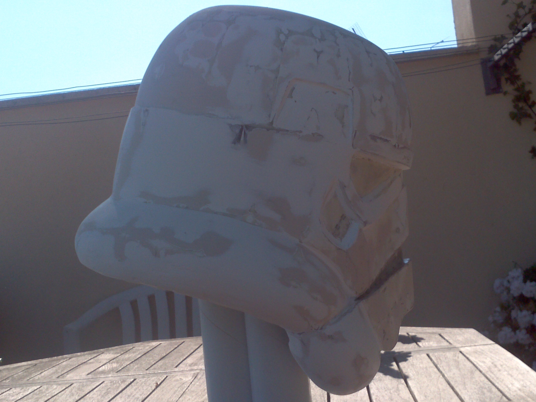

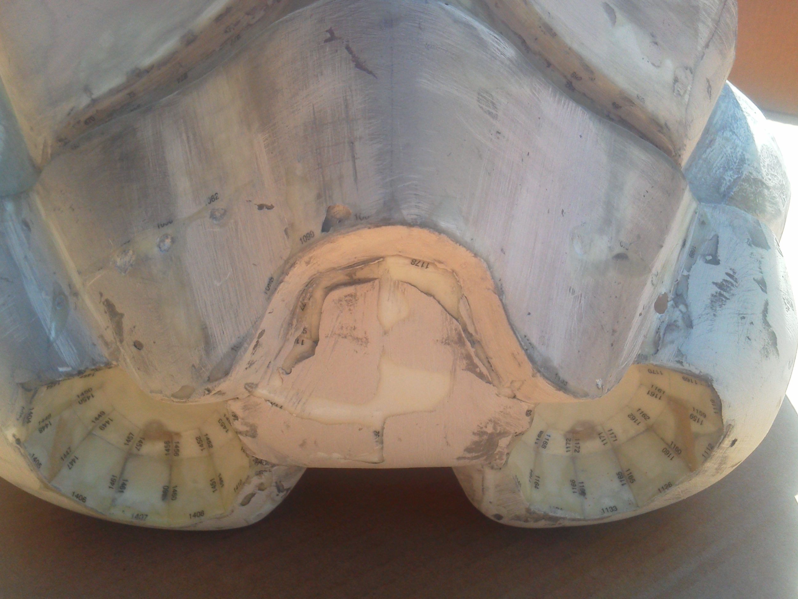

bondo thin layer to not lose too much as + black sanding witness
inside the helmet was resined the brushes, then a good layer of resin + fiberglass cut sequin + white gelcoat thickened, it reinforces and at the same time to have the matter below when sanding
in this picture we can see that the rear is distorted due the weight of the helmet, it does not matter we'll see that later
sanding, sanding, sanding, sanding....
I think finally be on track
I think being on the right track
Nice work, and a clean job with the bondo!
Can't wait to see the first coat of primer on it... ;)

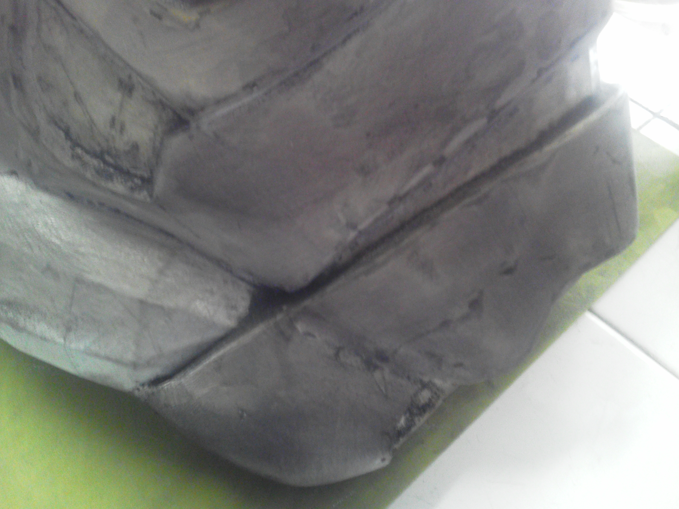

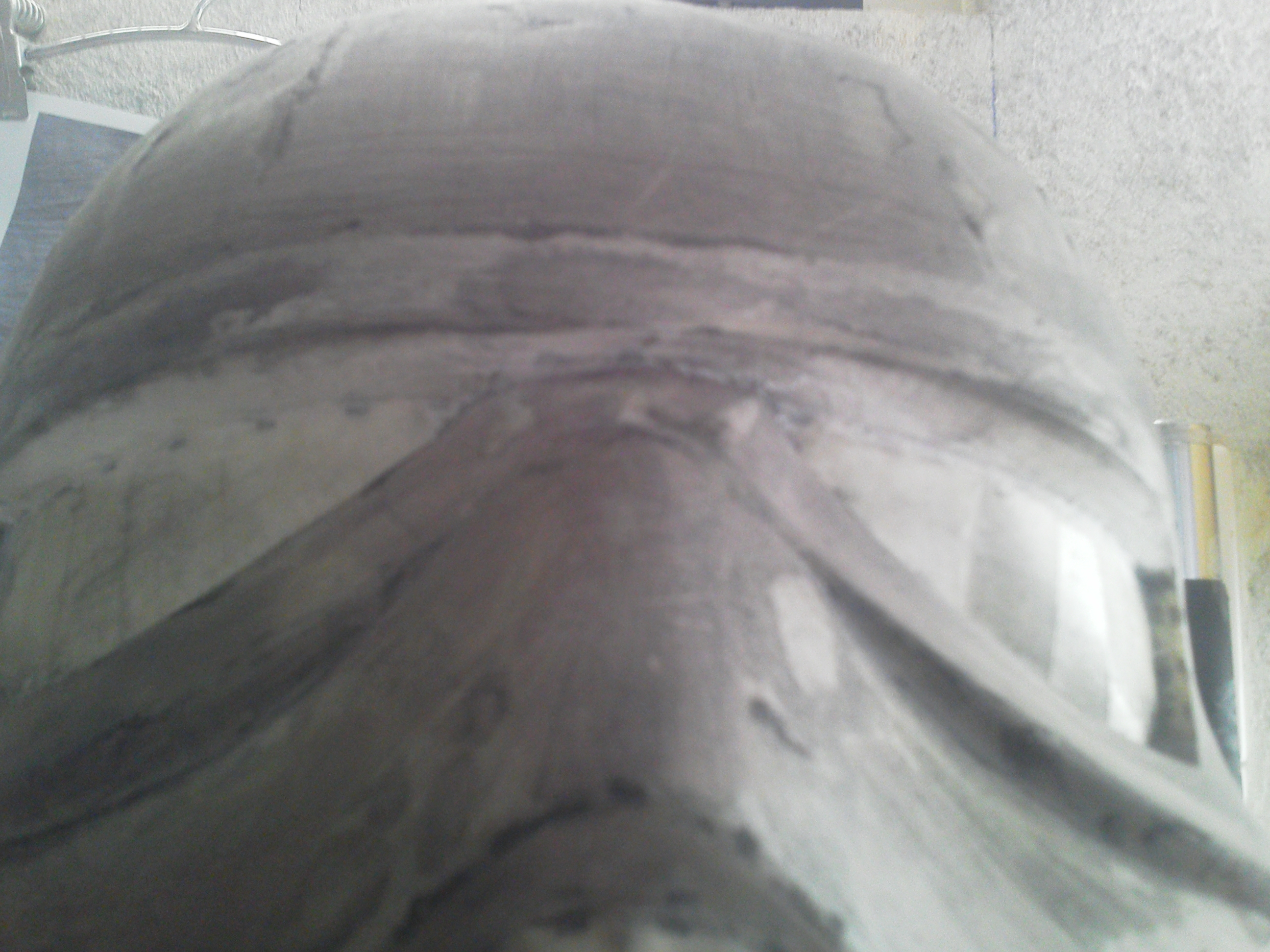

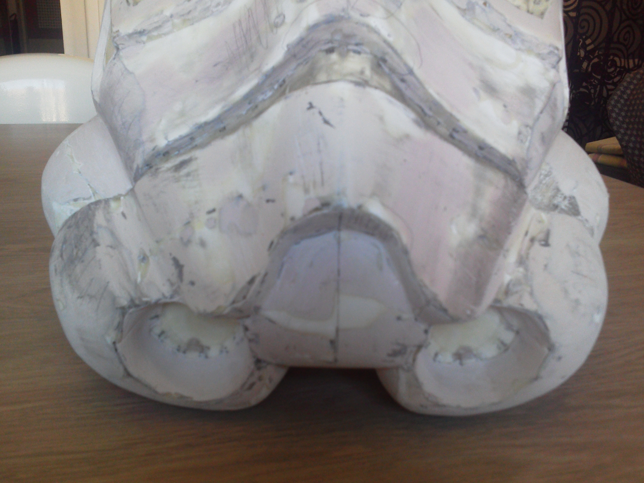

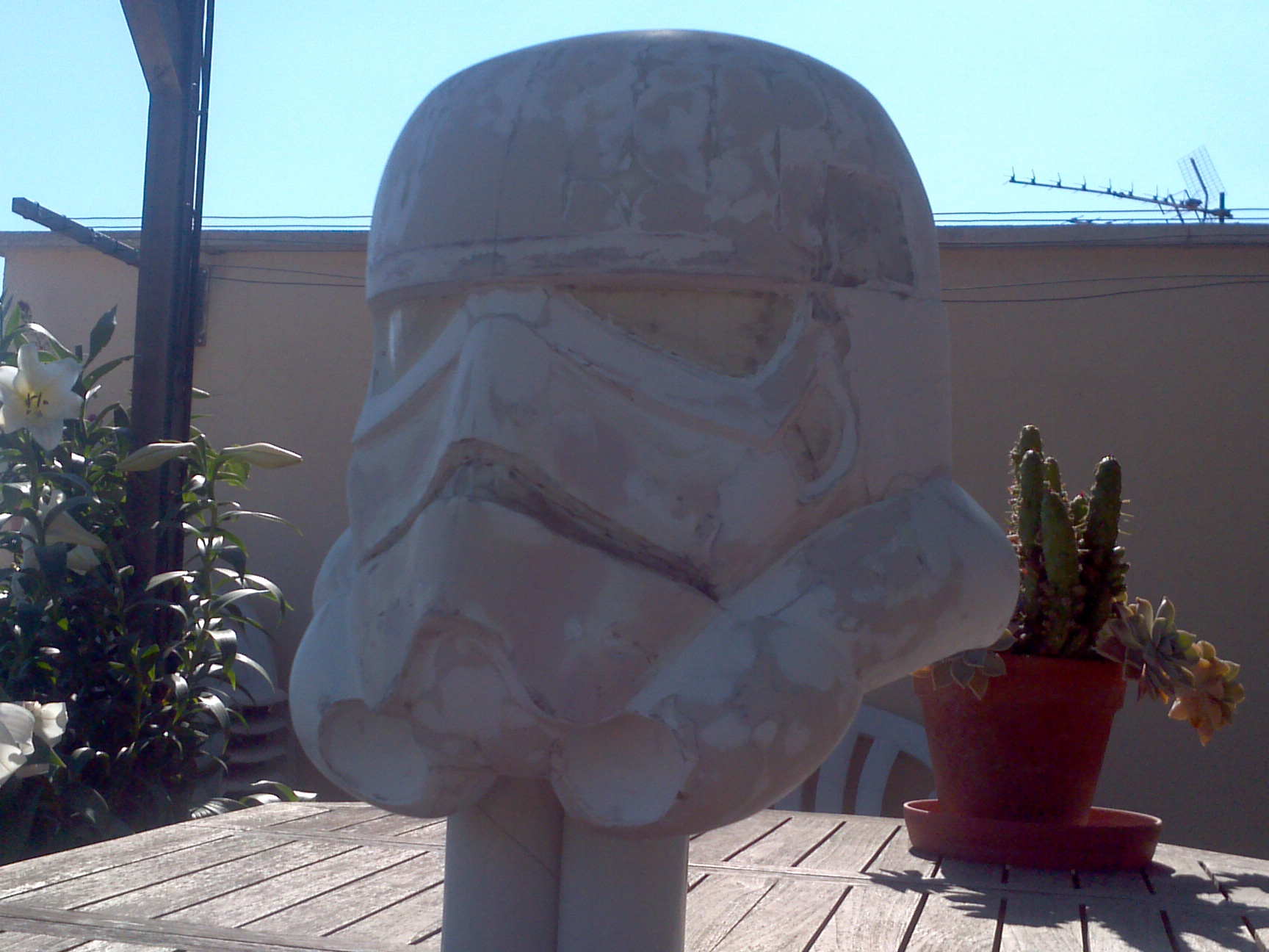

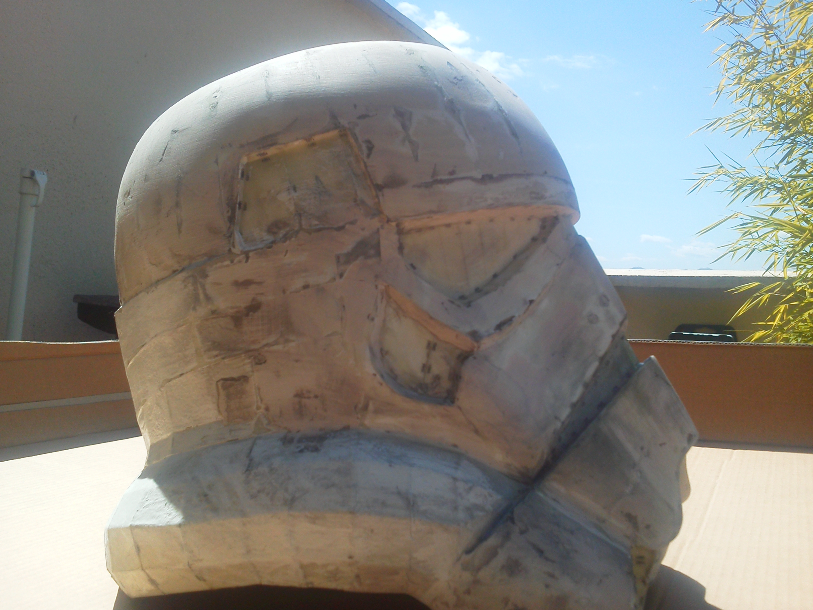

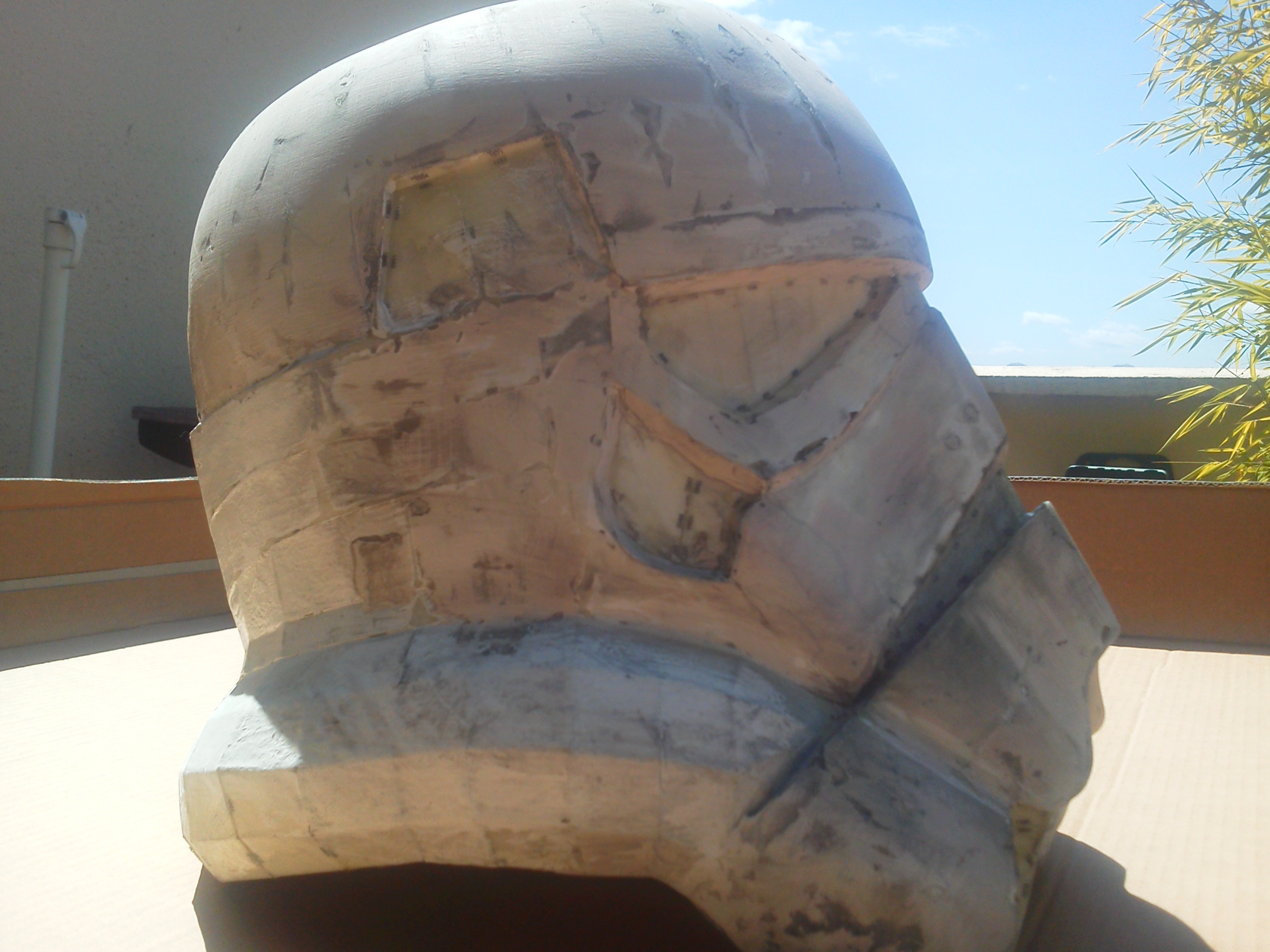

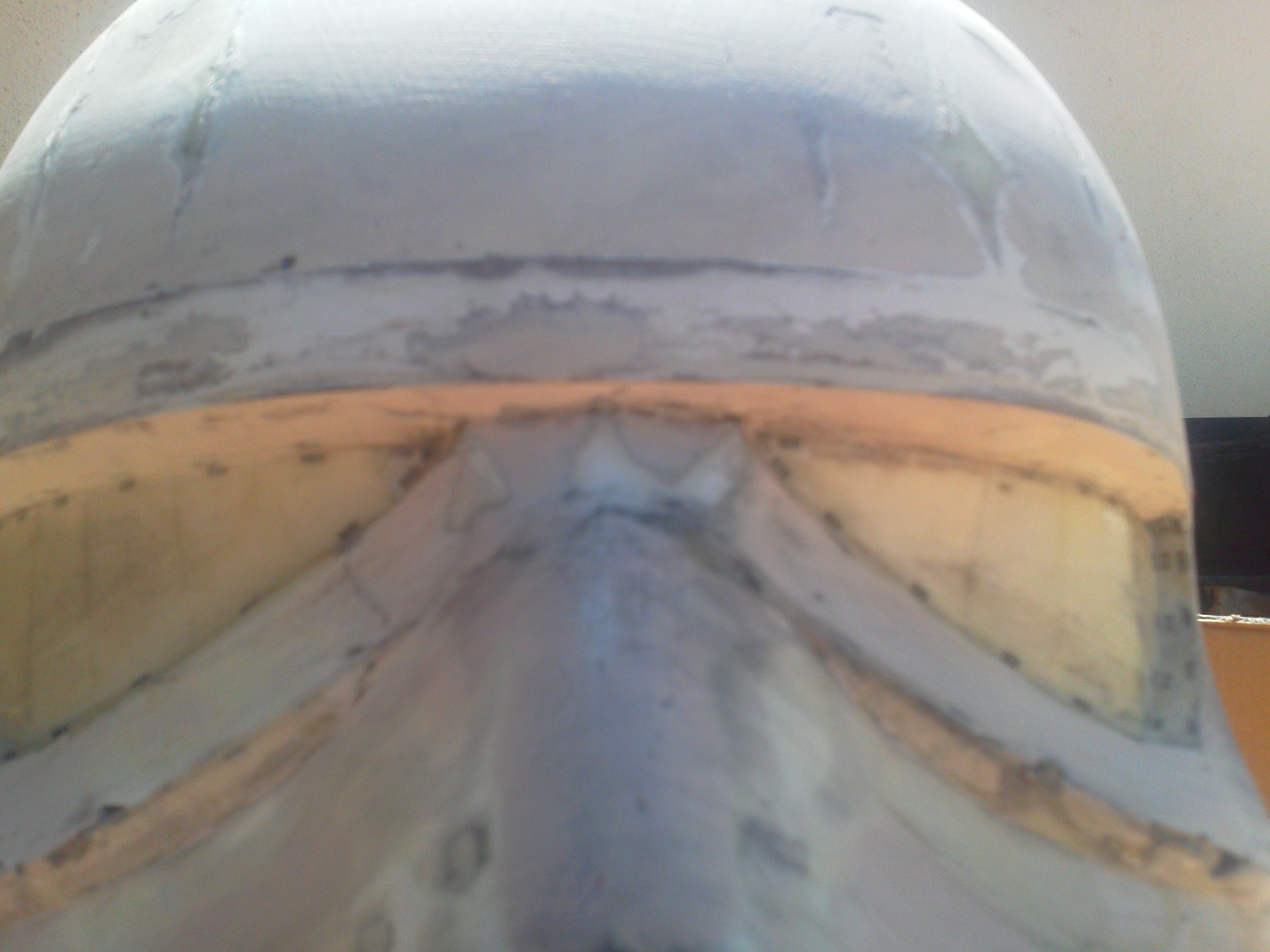

hello,

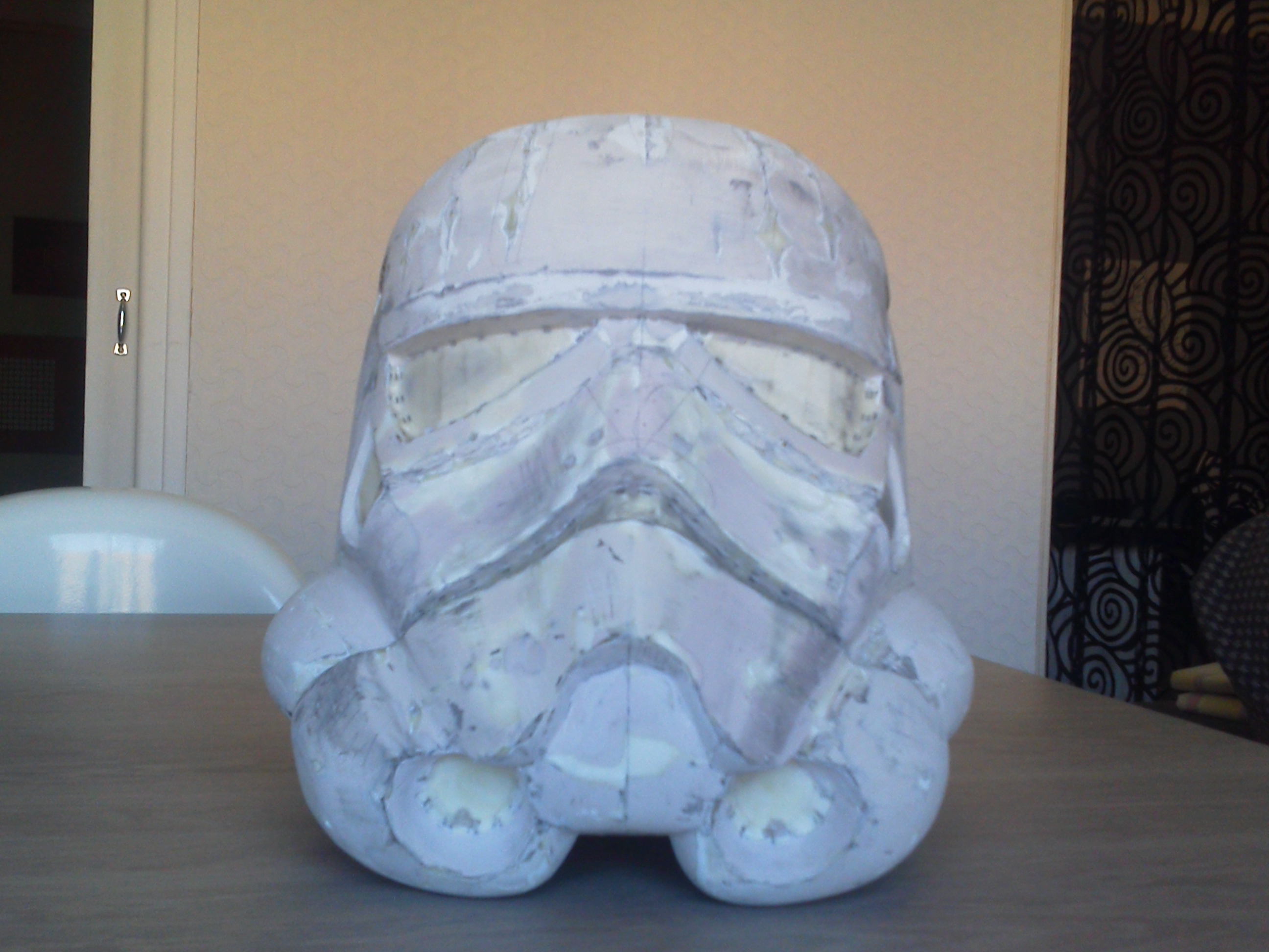

new update
IMG_20140529_144455.jpgIMG_20140529_144555.jpgIMG_20140529_144812.jpgIMG_20140529_144927.jpgIMG_20140529_145109.jpg
I think the shape is good, I can make the details.
I do not think the face was so difficult, there are many many details.
This looks fantastic! I'm currently working on one myself, and am about at the same stage in the process as you are. I agree that yours has a really good shape!
