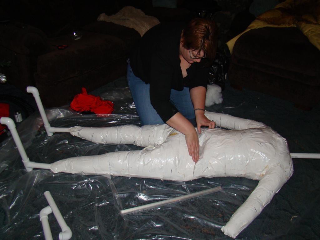

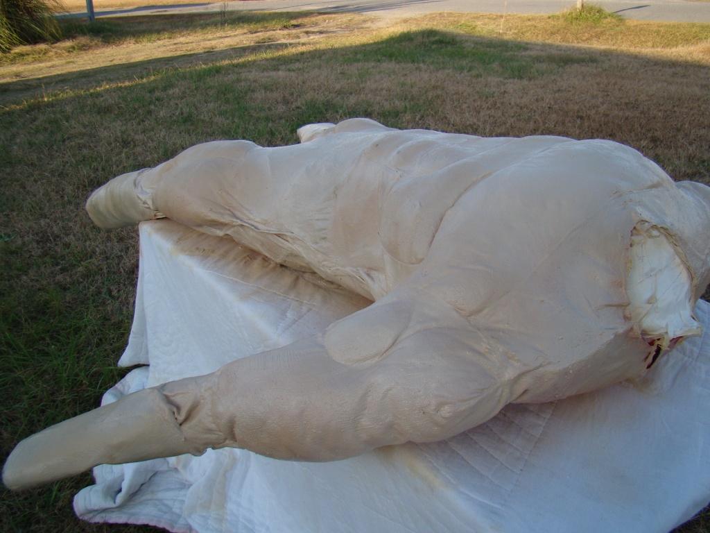

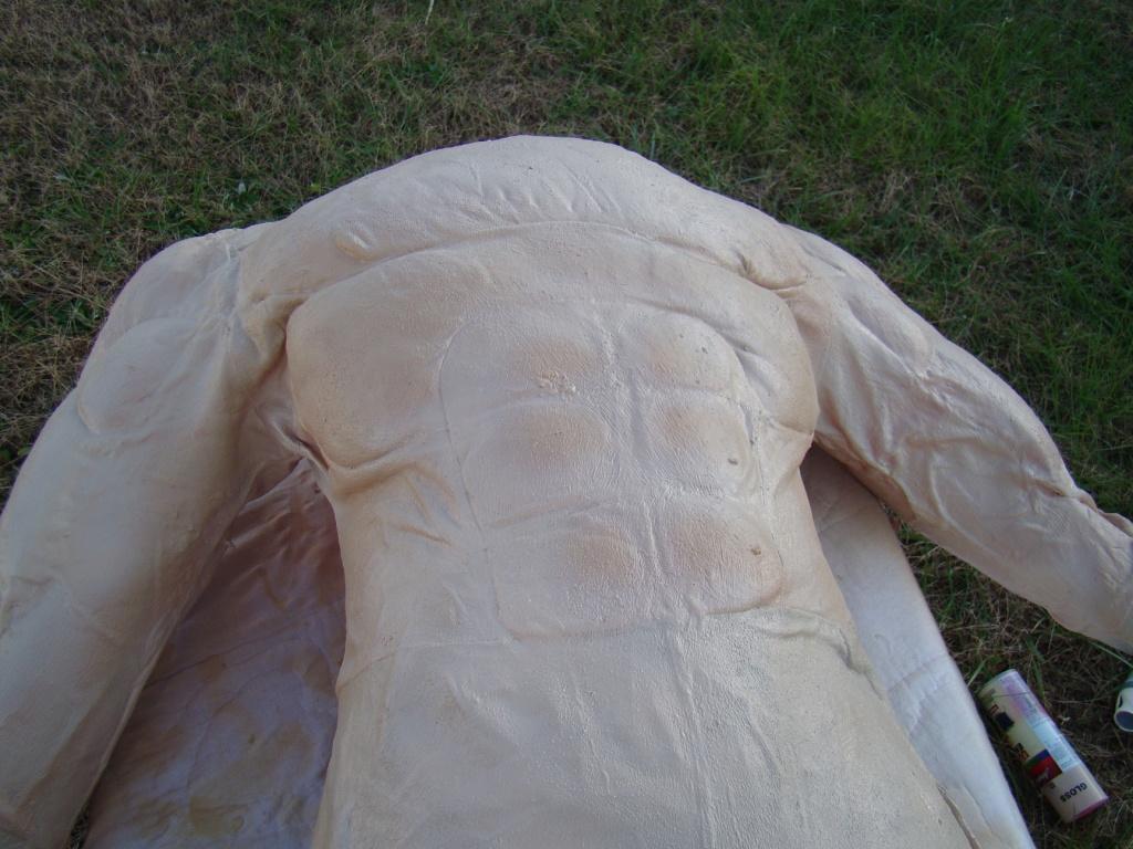

Well my first attempt at making a suit has gone well so far, the first thing i needed to do was make a duct tape dummy. For those who have done this before i commend you ! What a pain in the ass! Wrapping the suran wrap and the duck tape around me was fun, for the first 20 minutes or so, my wife was laughing the whole time. I lost all my happy feelings as i started to get extremely hot and dizzy from lack of oxygen. To top it all off we got down to the last arm and leg and ran out of duct tape!!!!!It was the longest 15 minutes of my life as my wife ran to the store. One roll of suran wrap and 6 rolls of duct tape later it was finally done. I ended up stuffing it later with poly-fill that is used for pillows, it gave it a very uniform shape.

Addition tips: I am new at using latex, here are some of the things i learned on the way.
I knew that weather has a big effect on the latex, but wow!!! the slightest degree change effects it curing. I started off in the yard, temperature was about 66 degrees, the latex was not drying that fast so i moved it into the house where it was about 70 degrees and it dried quickly. If you do it in the house make sure your in a well ventilated area, the latex is strong potent stuff! between the fumes and the beer i had a nice buzz lol.
On the duct tape dummy, i recommended about three people taping you up, it will speed up the process so you will not be in that miserable cocoon as long!!!

Wow. I am about to make a duct tape dummy too. Is it really that bad? I have to research it more. So you put on the suran wrap first then tape round it so the inside isn't sticky from the tape and you can stuff it?
Gah...
Gah...
Ok bud so heres what you do:
Take a roll of suran wrap, and have someone else (preferably a girl friend or wife) because of your crotch area lol ....and wrap your whole body with it as tight as you can without cutting off your circulation with the suran wrap. Then take strips of duct tape (not the whole roll and wrap it) and you lay it on the suran wrap with the pieces of tape (maybe a foot in length) going in different directions (kinda like paper mache) that way the tape kinda interlocks you know? Like hodge podge or whatever. Once the whole body is covered with both suran wrap and tape, have the person that is doing it to you to take a sharpie pen and draw lines down your arms and legs horizontally because the next step is to cut it vertically. You need to cut it at least as possible , but enough to where you can slip out of it. Think of it as a half shell back and front.
Once you slip your body out of it lay it down flat,remember those lines you drew? Well those are for reference, line the lines back up together then re-tape where you cut.
Now when you go to stuff it, the only hole you should have is the neck, no worries, start from the legs first with the stuffng and work your way up. Make a cut in like the knee area and begin stuffing, once the stuffing comes close to the hole just retape the hole and make another one higher up.
Now as far as stuffing , many people use different things, packing peanuts, paper, old clothes etc.
But since my dummy turn out really good for the first time i used poly-fill that is used for stuffing like pillows and stuff. It took me 3 50 oz bags of the stuff, but it was easy to work with and it turned out very uniform.
I hope this helps bud! Any more question feel free to ask.

Thats pretty cool, am about to start a duct tape dummy myself. So this thread is a great help. How long and wide was you duct tape rolls? I have found ones in my local store which is 50m X 5 cm, so just wondering how many I would need.
The other thing was, how thick did you make the layers on the dummy?

Hey bud, i used 1.88in x 20 Yd . 48mm x 18,28 m duck tape (white) not duct tape, this stuff was real tacky and strong, but regular duct tape will work too. I would get about six rolls man, you don't want to run out during the process!!!!
It was only one layer, but two layers in spots, try to get really good duct tape that is tacky, not the cheap sh@t!!
You can also keep the rolls of tape by a heat duct in your house, they will get warmer and become more tacky (but don't over heat them) You will see in time where you will need more tape in certain spots.

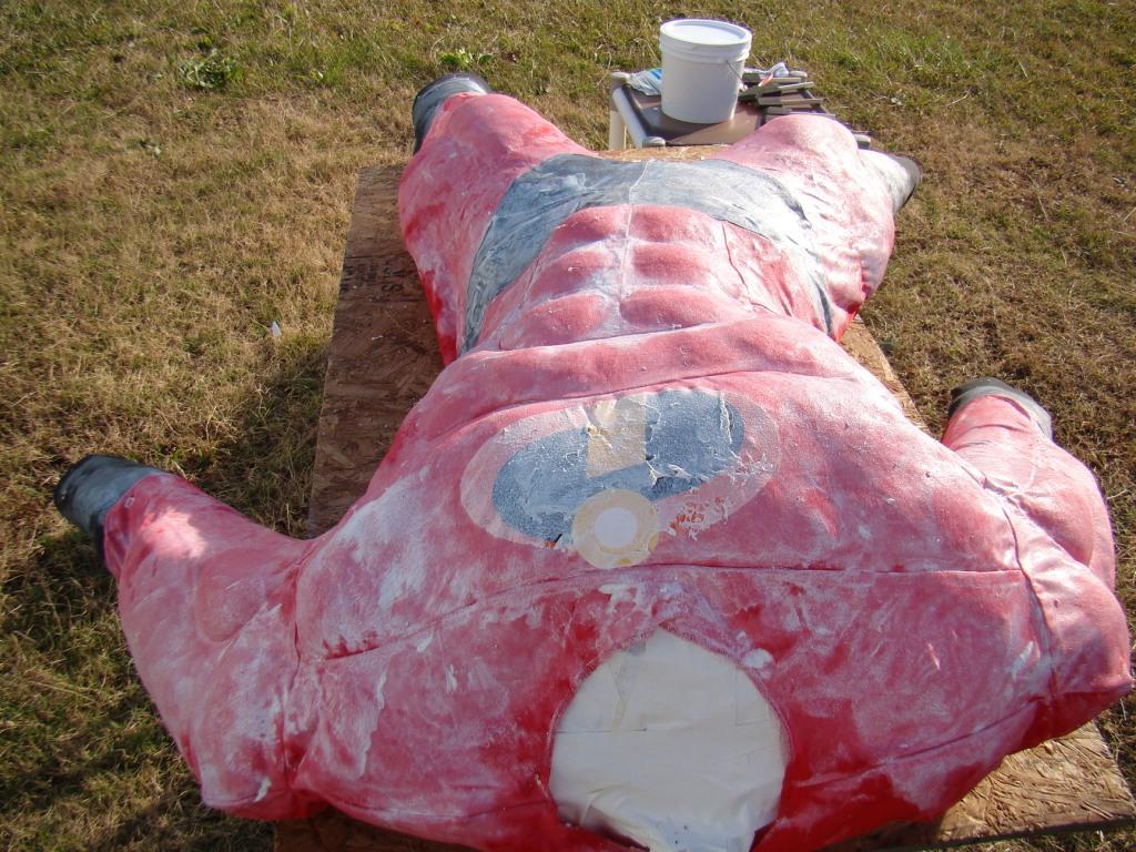

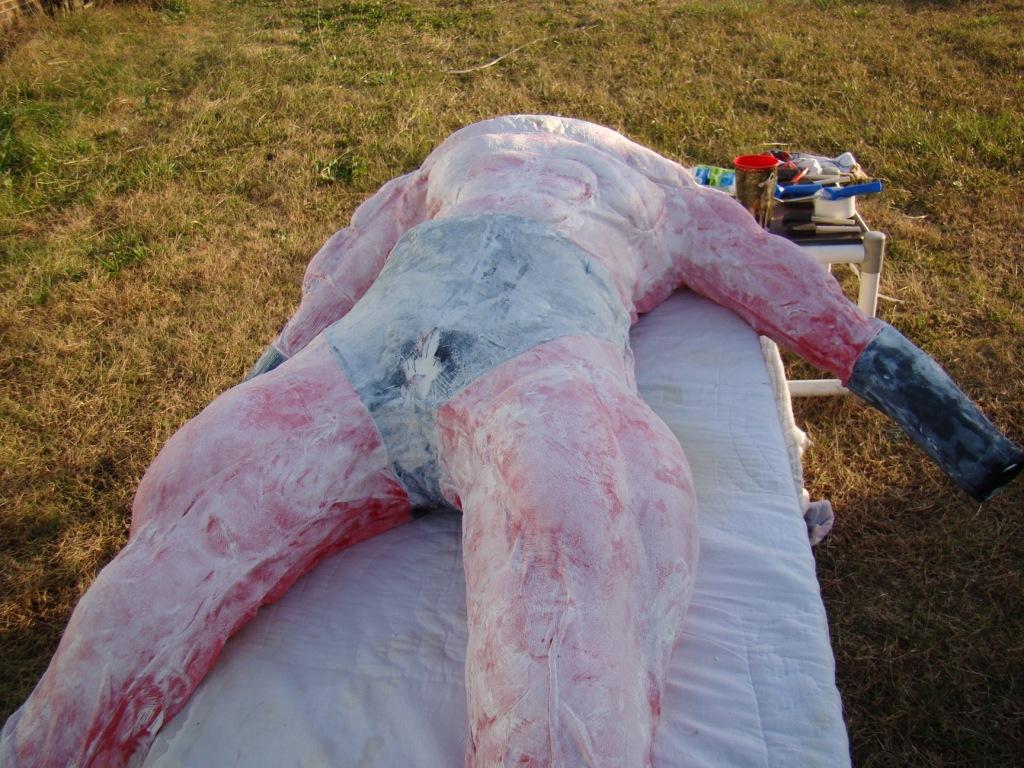

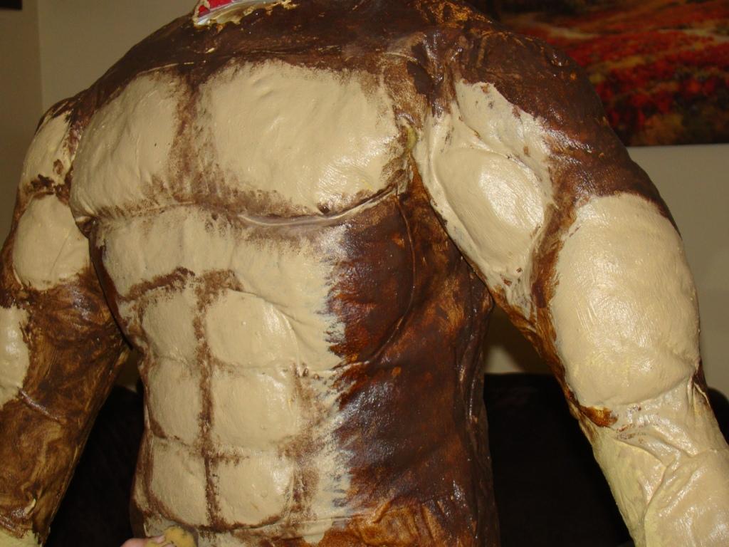

I just hit a major snag in the Mr. I suit
First let me start off by saying after you latex it, the latex will seep through the other side making the process of peeling the suit off the dummy not very fun. And i should have listen to the notes, i didn't mix my latex with some paint to hide the red more, after three layers the red was easily showing through. The latex dries almost clear, i figured i would be painting it so that would hide the red eventually. I am kicking myself now because my dumb ass sprayed the whole suit with regular tan spray paint, when i went to peel the suit off the dummy, all the paint started to chip and peel. I just spent 10 minutes vacuuming the chips off my floor. Well... live and let learn i guess, this is all new to me too. I don't have a air brush, what kind of paint should i be using? Do i need to completely strip the old chipped paint off because it is the base for the right paint? Oh god please help me save my project!! lol
Well i got my answer to my paint problem, im so mad at myself, thanks for the people that helped me on chat!

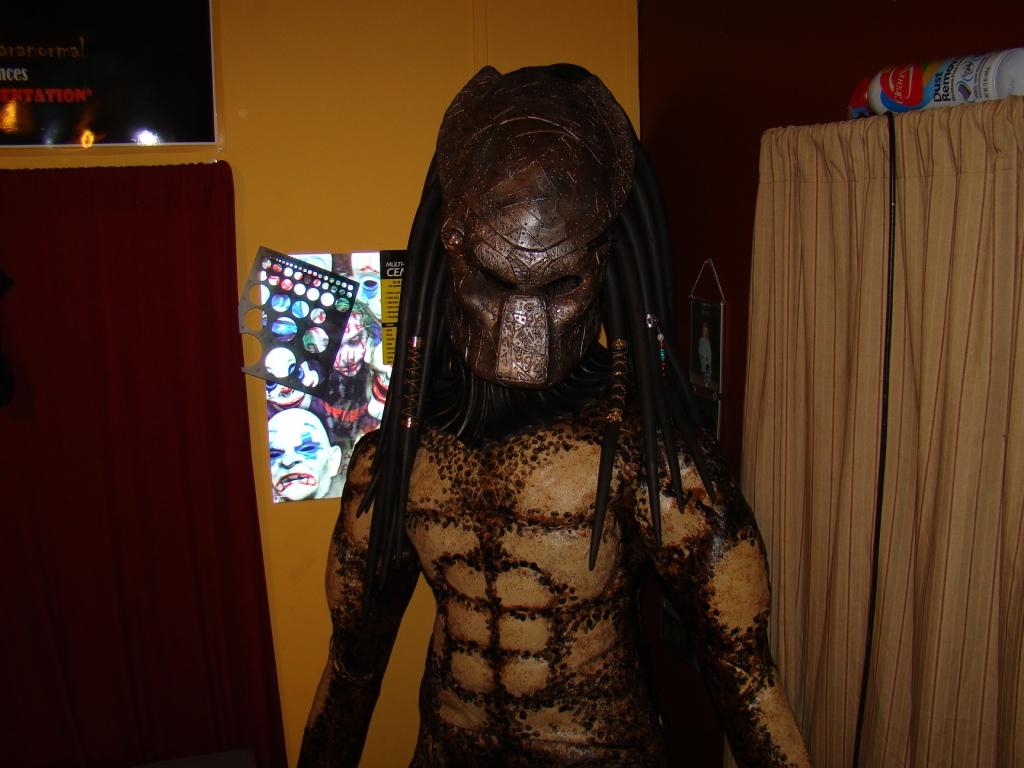

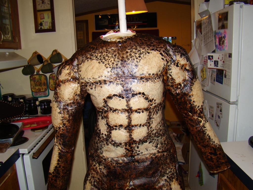

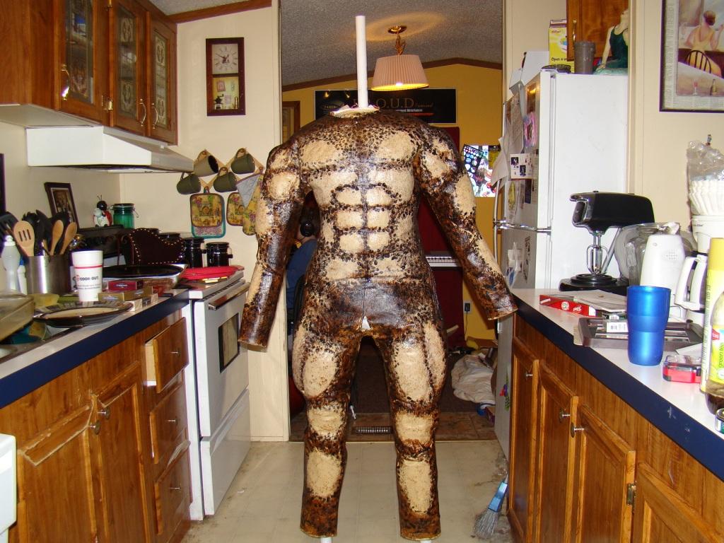

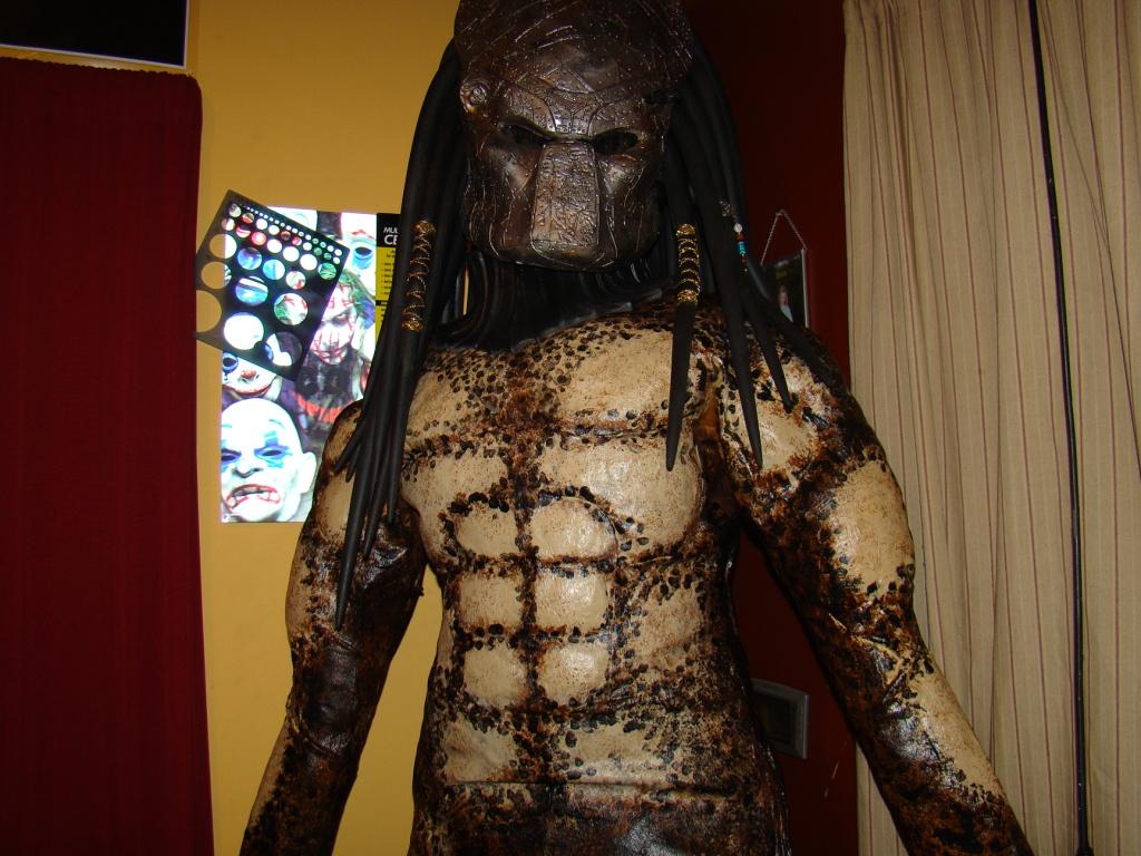

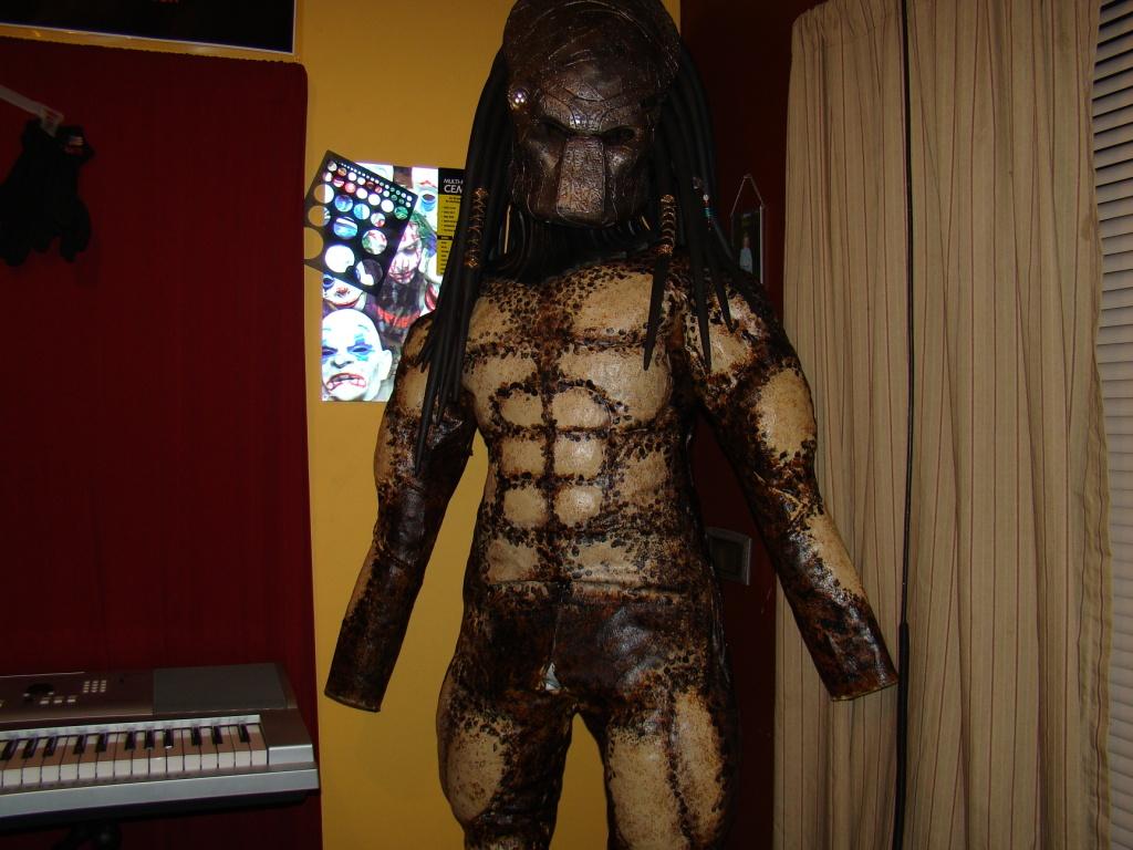

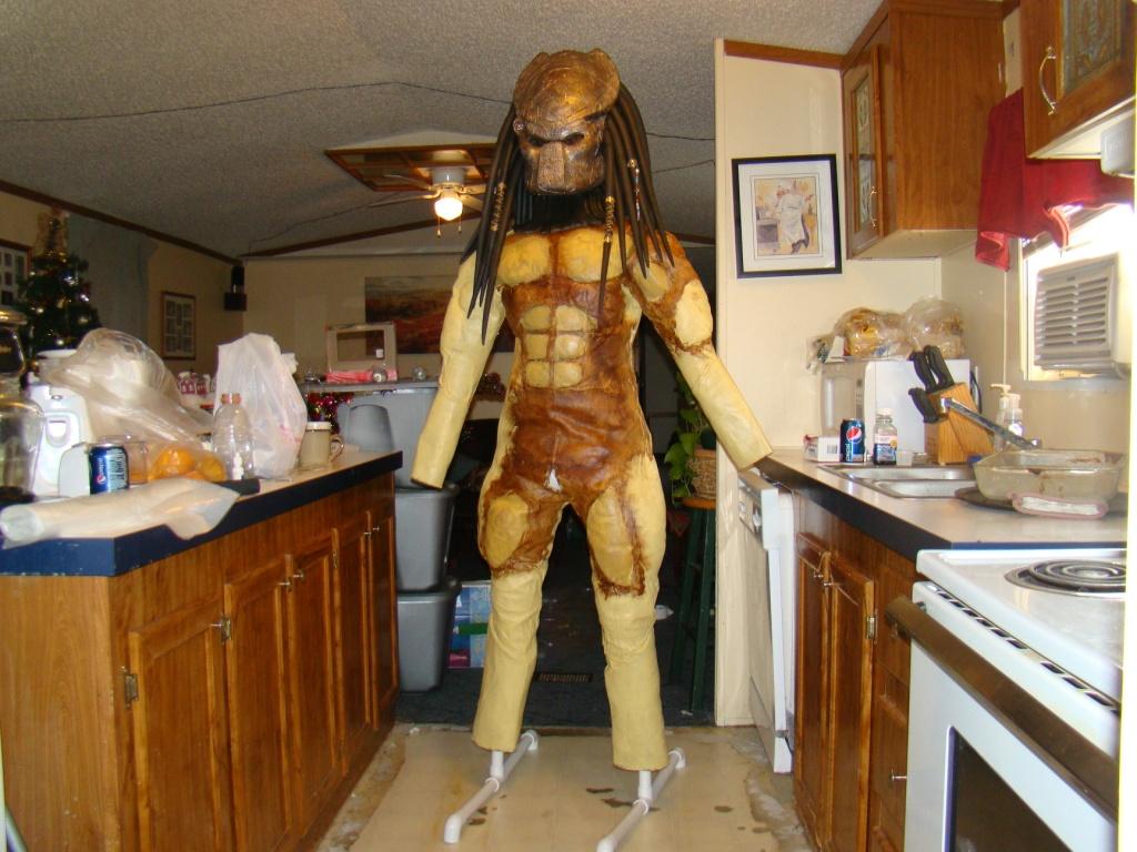

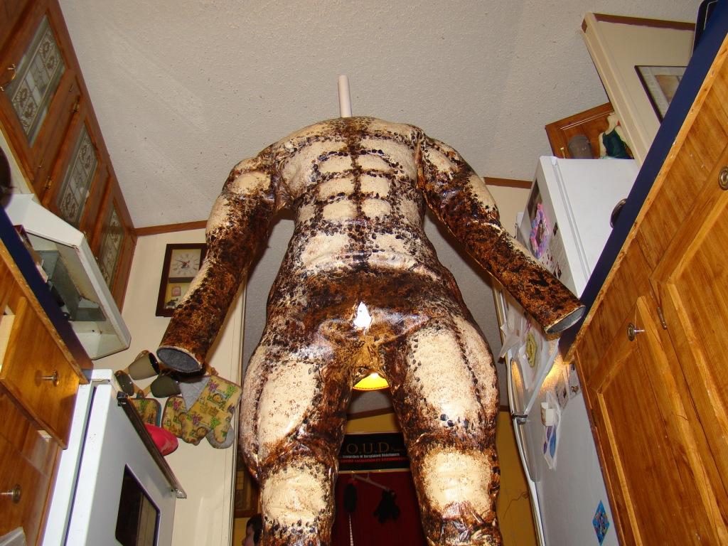

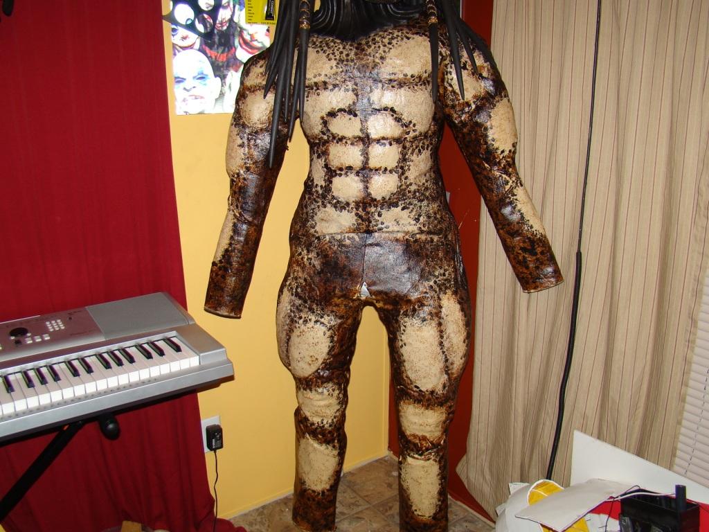

I made a stand and am starting paint up, unfortunately i do not have an air brush so i have to sponge it on. I will be the first to admit i cant paint for sh@t! so i did a little, but wife wife has taken the reins now. This is what i got so far.
Well done other than a few coats of permawet, i dont own an airbrush, so everything is sponged on layer by layer.
